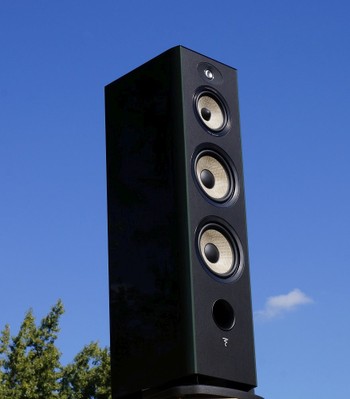

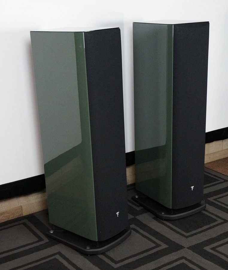

Focal Aria Evo X No.4 Loudspeaker Appearance

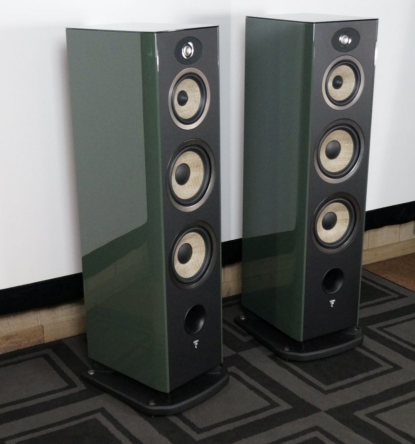

The Aria Evo X series doesn’t make any big changes to the aesthetic of the speakers except for a new finish option, “Moss Green High Gloss.” The review samples we received had this finish, and I have to say that it does look very attractive. It’s nice to have a loudspeaker come in a different color other than some variant of black or a woodgrain finish. ‘Moss green’ isn’t a loud green, so it shouldn’t clash with restrained interior decors. The gloss green finish only covers the side panels which have a slight curvature to them that narrows to the rear. The front and back baffles come in a leatherette finish, a material that looks and feels a lot like real leather but is actually a vinyl imitation. One thing I like about this leatherette material is that it does not catch fingerprints like gloss or smooth satin finishes. The speaker is topped by a glass surface with “Focal” printed underneath the front edge.
Evo X grille3  Evo X pair2
A grill can be used to hide the driver cones, and the grille has its own curvature which complements that of the speaker, so the grille of the Evo X No.4s don’t completely dull the look of the speaker. Without the grilles, the flax fiber of the cones present a striking appearance. I think the cones look cool, but I would understand those who would rather use the grilles to tone down the sight of the cones. The grille uses magnetic adhesion, so there are no grille guides and this makes for a cleaner front baffle. The speakers’ stand on an aluminum alloy base that is anodized with a black dye and gives the speakers a slight backward lean. I think most people will like the styling of the Evo X No.4s, but some will certainly prefer the look with the grilles attached so the speakers will draw less attention.

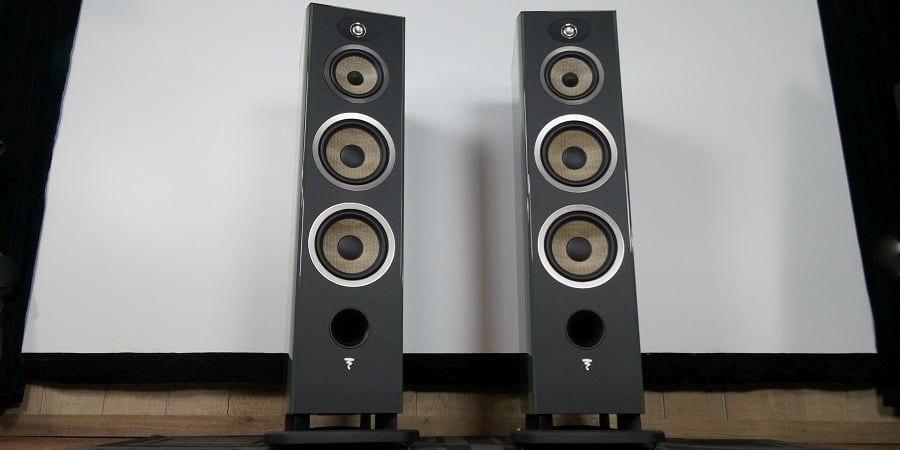

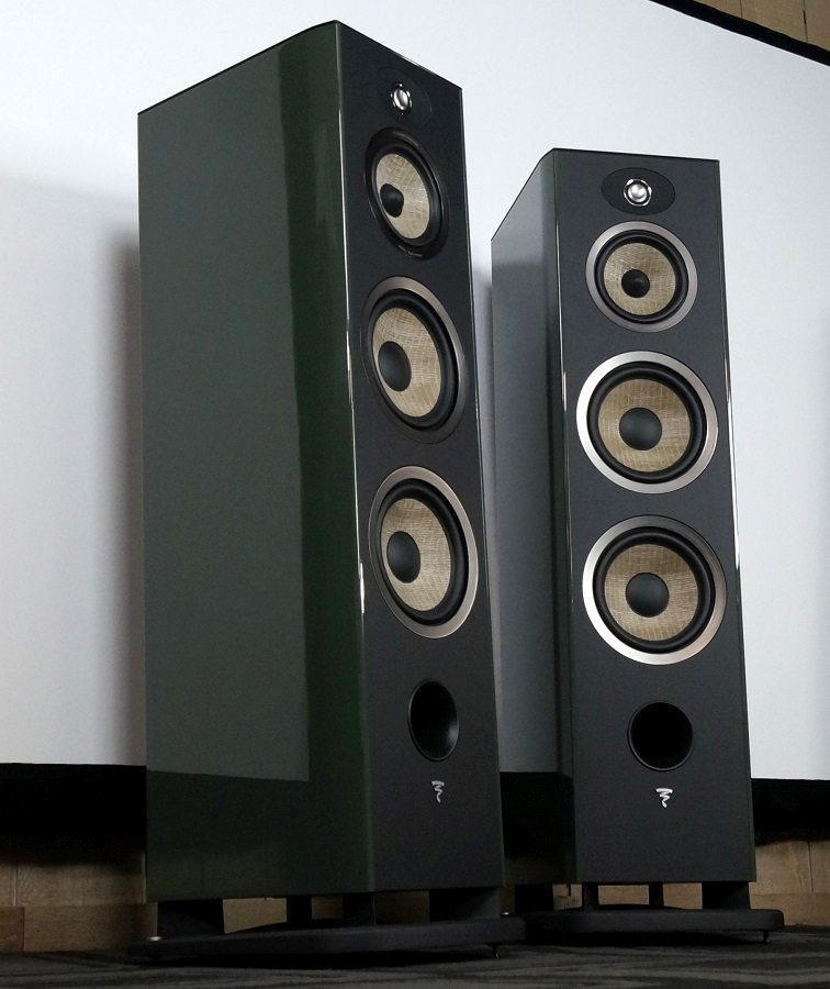

Focal Aria Evo X No.4 Loudspeaker Design Analysis
Focal’s Aria Evo X No.4 is the direct successor to the Aria 948. As was mentioned, the Evo X series doesn’t depart much from the Aria series’ overall design, and that is very much the case for these two models: both are three-way, dual-ported towers that use two 8” bass drivers, a 6.5” mid, and an inverted 1” dome. Given that they share so many of the same specs including weight, crossover frequencies, low-frequency extension, driver types, etc., I would expect the Aria Evo X No.4 to be more of a tweak on the existing design of the 948 than anything. That being said, what is involved in this design? Let’s start our discussion with the tweeter.

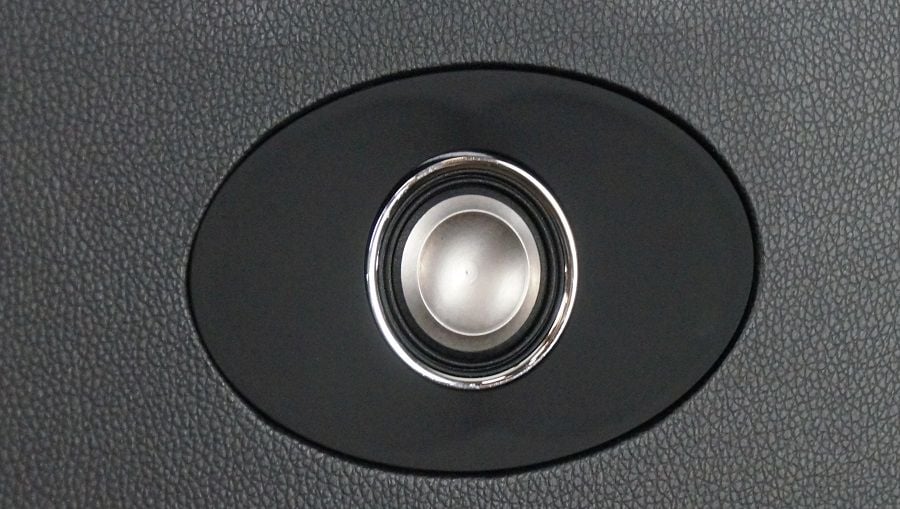

Evo X tweeter
Focal uses their traditional inverted 1” dome tweeter, the ‘TAM’ tweeter that we last saw in the Vestia line. Focal claims that the inverted dome shape helps to narrow directivity versus a normal convex dome. It also enables the use of a smaller diameter voice coil affixed directly to the dome, supposedly making the moving assembly lighter and more rigid. The ‘TAM’ dome composition is a mixture of aluminum and magnesium: aluminum for its stiffness, and magnesium for its damping properties. The tweeter has an M-shaped profile and was originally developed for car audio. The M-shape profile helps to stave off high-frequency bending modes, and Focal specs the speaker up to 30kHz within a +/-3dB window. The TAM tweeter is mounted in a shallow elliptical urethane waveguide to induce a wider horizontal dispersion and narrower vertical dispersion as well as reduce baffle edge diffraction. Narrow vertical dispersion may present a problem for lower seating positions since the tweeter is mounted a tad high at 44”. We will examine this in our measurements section.

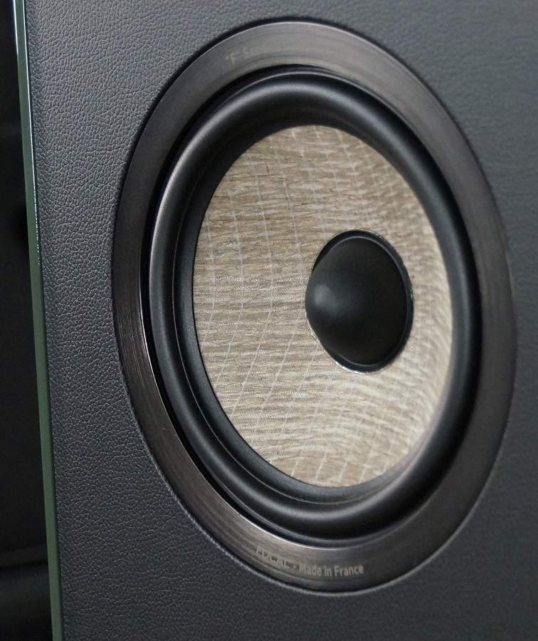

Evo X midrange cone2
Evo X rearMoving on to the midrange driver, the 6.5” cone is a multi-layer design where flax fibers are sandwiched between layers of glass fiber. This formulation, produced by Focal in-house at Saint-Etienne in France’s Auvergne region, makes for a stiff cone with wide bandwidth, yet is well-damped so there are no massive bending modes. The surround of the cone uses Focal’s TMD, ‘Tuned Mass Damper,’ which relies on the same principle that keeps skyscrapers and bridges stable during high wind or earthquake conditions. Small counter-weights that take the form of circular beads are molded into the mass of the surround and oscillate in opposition to high movement to help tame wild swings that  degrade the midrange’s frequency response, especially around the 1kHz to 2kHz band. The mid-range driver’s use of Focal’s TMD technology is a feature new to this series of Aria speakers.
The two 8” bass drivers also use the Flax cone composition. They cross over to the midrange at 280Hz, and the midrange crosses over to the tweeter at 2.6kHz. Focal uses only a single set of five-way binding posts, so these speakers are not able to be bi-amped or bi-wired, which in my opinion, is a good thing. Bi-amping and bi-wiring are far more often opportunities for error than opportunities for sound quality improvement. The low-end is shored up by two double-flared ports: a 3” diameter by 3 1/2” length port mounted at the bottom panel and a 3” diameter by 4 ¾” length port mounted on the front baffle. While ports with these dimensions do not promise extremely deep bass extension, the difference between the ports’ length should give port-generated output more bandwidth than if they had the same dimensions. The magnets of the motors in the bass drivers have been increased by 40% over the previous Aria speaker series.

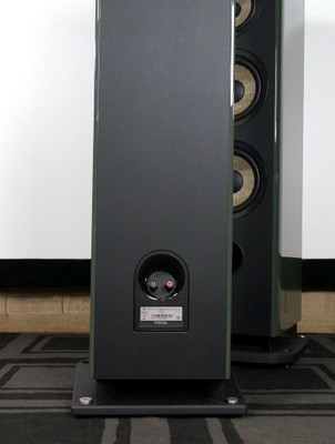

Exo X base

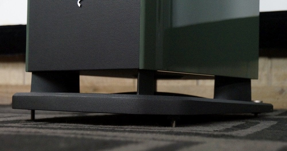

The MDF enclosure is a fairly hefty one at 77lbs., and seems to have a reasonably good build quality. The paint finish is of excellent quality and must contribute a significant part of the speaker’s manufacturing cost. As was said before, the base is an aluminum alloy, and it anchors the speakers nicely to the floor. Users have the option of using either rubber pads for feet or spikes. The spikes have the advantage of individual adjustability to achieve an even footing on uneven surfaces. The grilles use acoustically transparent fabric over a plastic molded piece that has a hexagon mesh pattern. It does the job of protecting the speakers well, but it probably adds some diffraction to the speaker’s acoustic response, although probably not enough to have a serious audible impact.

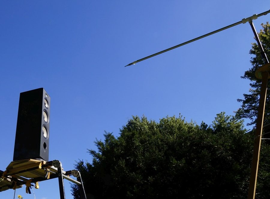

Focal Aria Evo X No.4 Loudspeaker Measurements
Evo X no4 outdoor testing

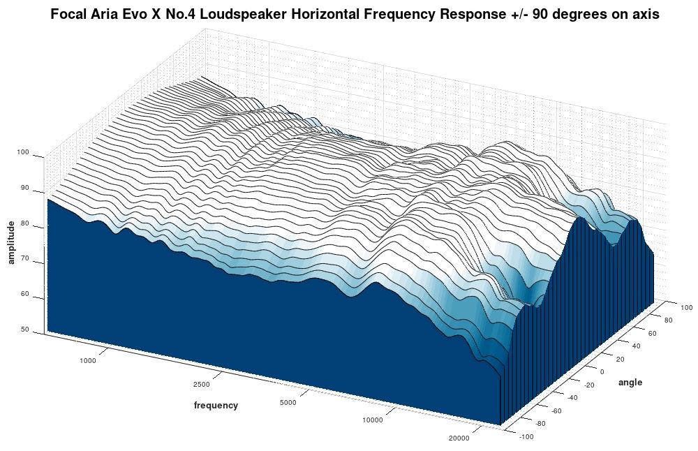

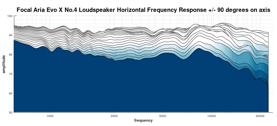

The Focal Aria Evo X No.4 Tower was measured in free-air at a height of 4 feet at a 2-meter distance from the microphone, with the microphone raised to an 8’ elevation that was level with and aimed at the tweeter center. The measurements were gated at 8 milliseconds. In this time window, some resolution is lost below 400 Hz, and accuracy is completely lost below 200 Hz. Measurements have been smoothed at a 1/12 octave resolution.
No4 3D waterfall horizontal response
No4 2D waterfall response

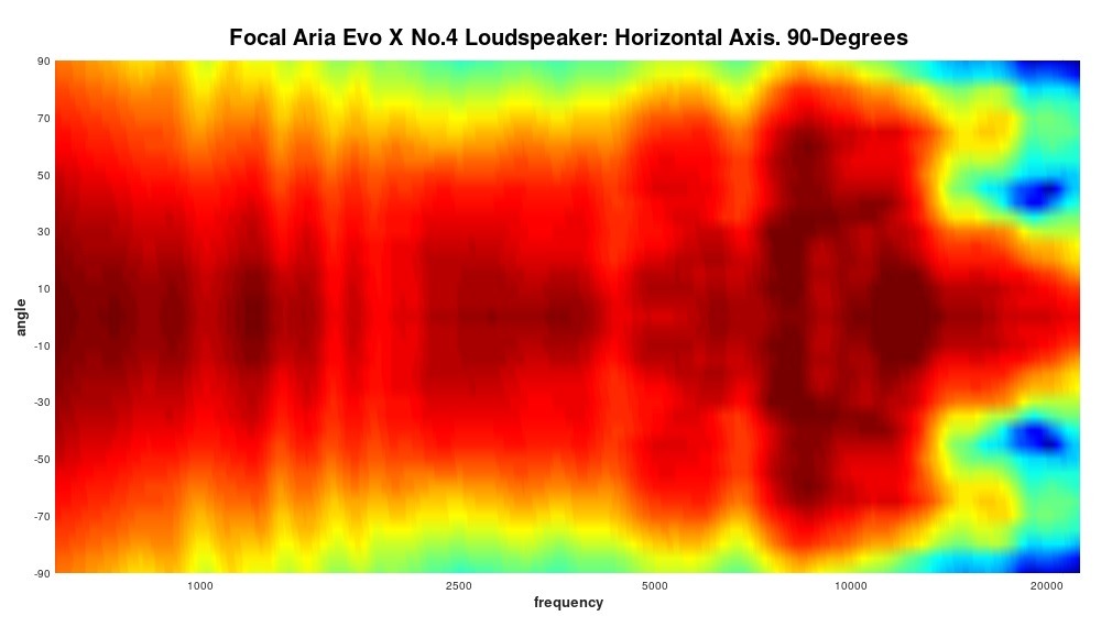

The above graphs depict the Aria Evo X No.4’s direct-axis and horizontal dispersion out to a 90-degree angle in five-degree increments. Information on how to interpret these graphs can be read in this article: Understanding Loudspeaker Review Measurements Part II. On-axis, we see a pretty neutral response, but as we move off-axis, the tweeter does expand its dispersion around 8kHz which lifts up treble frequencies. Normally, we see the dispersion expand at the crossover point to the tweeter, but that isn’t what is happening here since the frequencies at which the tweeter is flaring occur well above the crossover. My guess is that this off-axis flare is due to an interaction between the inverted dome and waveguide. I wouldn’t expect this to have a major effect on the sound for any listeners seated near the on-axis response because as frequencies rise, they become more susceptible to loss by scattering or absorption. That means they will be more greatly attenuated by any potentially reflective absorptive surface than lower frequencies. For this reason, these speakers should be toed-in to face the listening position directly. Having them face outward could make for a bright sound signature.
No4 Polar Map
The above polar map shows the same information as the preceding graphs but depicts it in a way that can offer new insight regarding these speakers’ behavior. Instead of using individual raised lines to illustrate amplitude, polar maps use color to portray amplitude, and this allows the use of a purely angle/frequency axis perspective. The advantage of these graphs is they can let us see broader trends of the speaker’s dispersion behavior more easily. More information about interpreting this graph can be read in this article: Understanding Loudspeaker Measurements Part II.
Here we can see that the No.4s are a relatively wide dispersion loudspeaker, meaning they project sound at over a fairly wide angle. What is interesting to see is that the directivity matching between the midrange driver and tweeter looks quite good, but the tweeter itself doesn’t really maintain a consistent directivity at the upper end of its bandwidth. It flares outward at around 8KHz. In a reflective room, that could make these speakers somewhat bright, but I don’t think it will have a major impact on the sound in a normally furnished room so long as the user is listening on-axis. At around 15kHz, the dispersion constricts again to what would be normal for a dome tweeter. In my own listening room, I didn’t feel these speakers were bright, although I have textured wood wall paneling which probably is somewhat absorptive as well as a lot of bookcases and shelves which would be diffusive, so my environment may be well suited for taking the edge off of this kind of dispersion pattern.

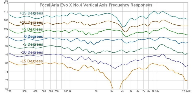

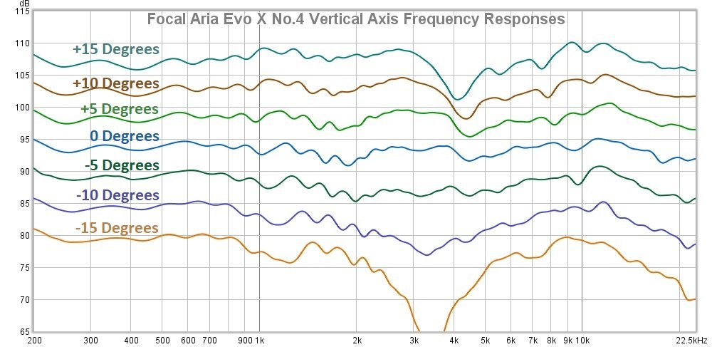

No4 vertical responses
The above graph shows the Aria Evo X No.4’s responses along its vertical axis out to 15 degrees. The reference axis is the tweeter with positive values being above the tweeter and negative values below. Here we get a better look at how flat the on-axis response is. We also see that it doesn’t change much at a +/- 5 degree angle above or below the tweeter. At +/-10 degrees, we do start to see some deformation due to a crossover null as each driver’s bandwidths overlap, thereby beginning to cause a phase conflict. At -15 degrees, the phase conflict is almost in full effect, and we can see this by the massive hole in the response just above 3kHz. The lesson here is that the No.4s should be listened to at or around the tweeter’s height. The problem is that the tweeter is mounted somewhat high. Low-slung seating at a close proximity would be a bad idea with these speakers. At a far listening distance, low-slung seating should be OK. Focal recommends a listening distance of three to five meters. At three meters, a -10 degree angle from a 44” high tweeter is about two feet in height. So, for Focal’s prescribed use, the vertical dispersion presents no problems. However, one thing Focal can do to make the No.4s friendlier to lower seating positions at closer distances, without sacrificing any acoustic performance, is simply swap the positions of the midrange driver with the tweeter. They do this already in their higher end Kanta, Sopra, and Utopia speakers. I think it would be beneficial for the Aria Evo X series as well.

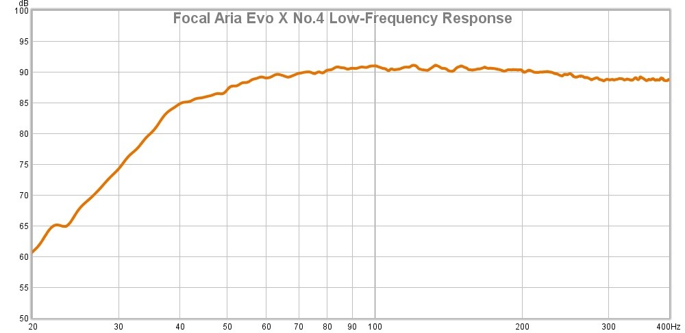

no4 low frequency response
The above graph shows the Aria Evo X No.4’s low-frequency response captured using groundplane measurements (where the speaker and microphone are on the ground at a 2-meter distance in a wide-open area). The No.4 holds a very flat response down to the port tuning frequency of about 37Hz. Below the port tuning frequency, we see the typical 24dB/octave fourth-order rolloff that is characteristic of ported loudspeakers. Even though this is a large tower with two 8” bass drivers, we don’t get a tremendously deep-digging speaker, although room gain will give a little bit of extra extension. As I mentioned previously, I did manage to get usable bass down to 30Hz from the No.4s, although it was noticeably more powerful above 40Hz, and here we can see why. The No.4s pack a punch, but they don’t dig to subterranean depths. For home theater, I would add a subwoofer to this system.

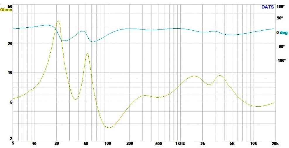

no4 impedance2
The above graph shows the electrical behavior of the Aria Evo X No.4. Focal specifies this as an 8 ohm nominal load, but that looks like a real stretch to me. They also specify the impedance minima to be 2.5 ohms, but I didn’t measure it to be quite that low. While most of the range stays well above 4 ohms, the dip at 100Hz might hit cheaper amplifiers pretty hard, especially if played at loud levels. The problem is that the range around 100Hz is heavily used in all types of content, and the dip could pull a lot of power. This will create a lot of heat in amps that don’t have good thermal management. Premium AVRs and outboard amps specified for 4 ohm loads should be fine with these speakers, but I would definitely not run them on budget AVRs. This shouldn’t be a problem since I don’t think many people buying $6k speaker pairs will run them with entry-level AVRs.
I measured the sensitivity to be 89.5dB at 1 meter for 2.83v which is a bit off from Focal’s spec of 92.5dB. However, they don’t state the voltage or context for their measurement.. Either way, this is a big tower that doesn’t need a ton of power to get loud.
