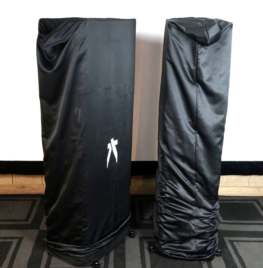

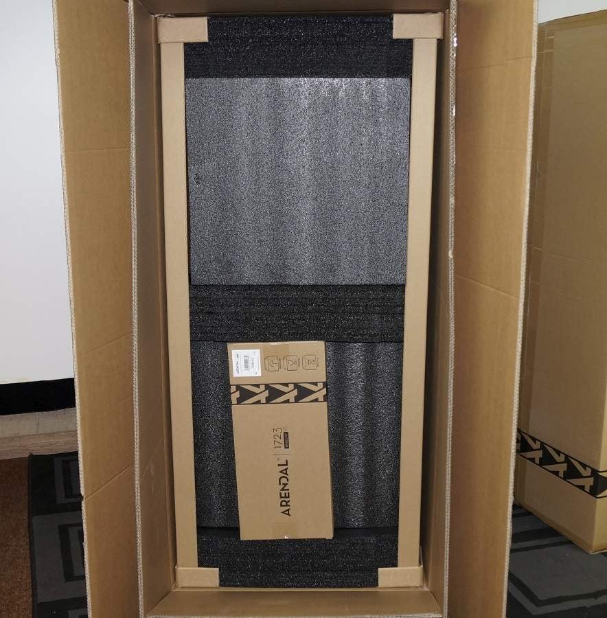

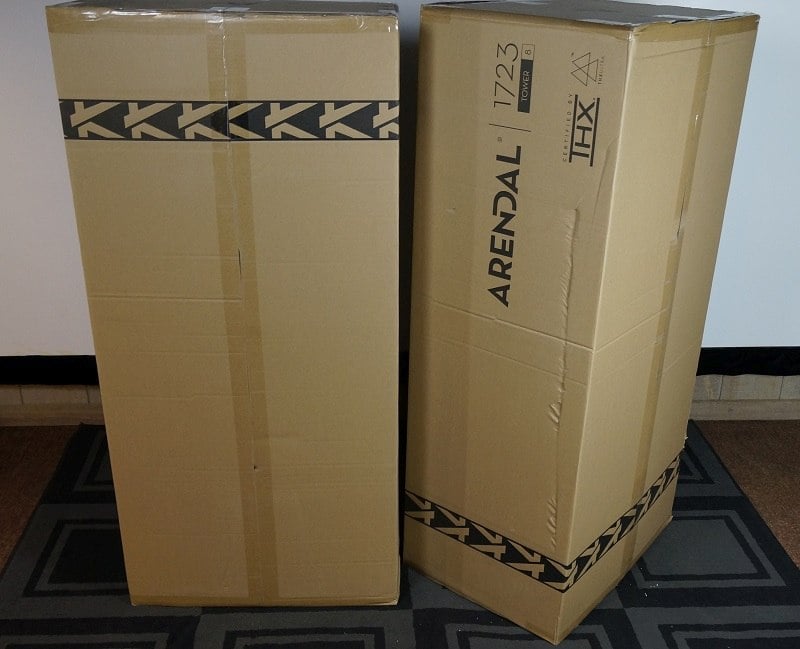

The 1723 Towers arrived at my doorstep in two enormously heavy and large boxes. The speakers were double-boxed, and the interior box was lined with edge protectors and corner protectors. One interesting detail is that Arendal has put a plywood board inside the outer box at the top and bottom of the package. If the box is dropped and hits a vertical end, the plywood will disperse the force of the drop over a large section of the packing. The speaker weighs so much that it might not need a big fall to cause damage on a vertical drop, so this seems like a very good idea.
Underneath all of the cardboard, the speakers were totally covered in polyethylene blocks. The speakers themselves were wrapped in nice drawstring fabric sleeves that felt like high-quality polyester. Arendal includes white cotton inspection gloves for unpacking the speakers without getting fingerprints on them. In the unpacking process, I left the sleeve on and rested the speakers on some of the foam packing blocks on the floor so I could install the outriggers. After installing the outriggers, I stood the speakers up and removed the sleeve. The packing is very good, but it needs to be so in order to ship these heavy speakers with a reduced risk of damage. It is not easy or inexpensive to ensure that speakers such as these will reach their destination with low damage risk, but Arendal has made this effort.

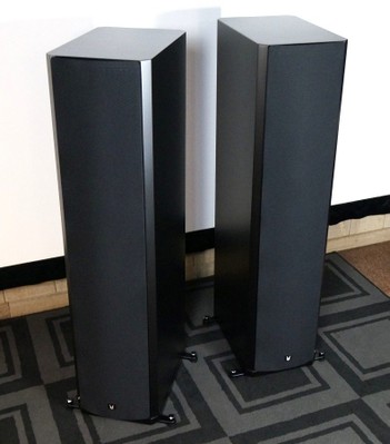

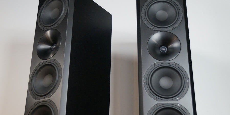

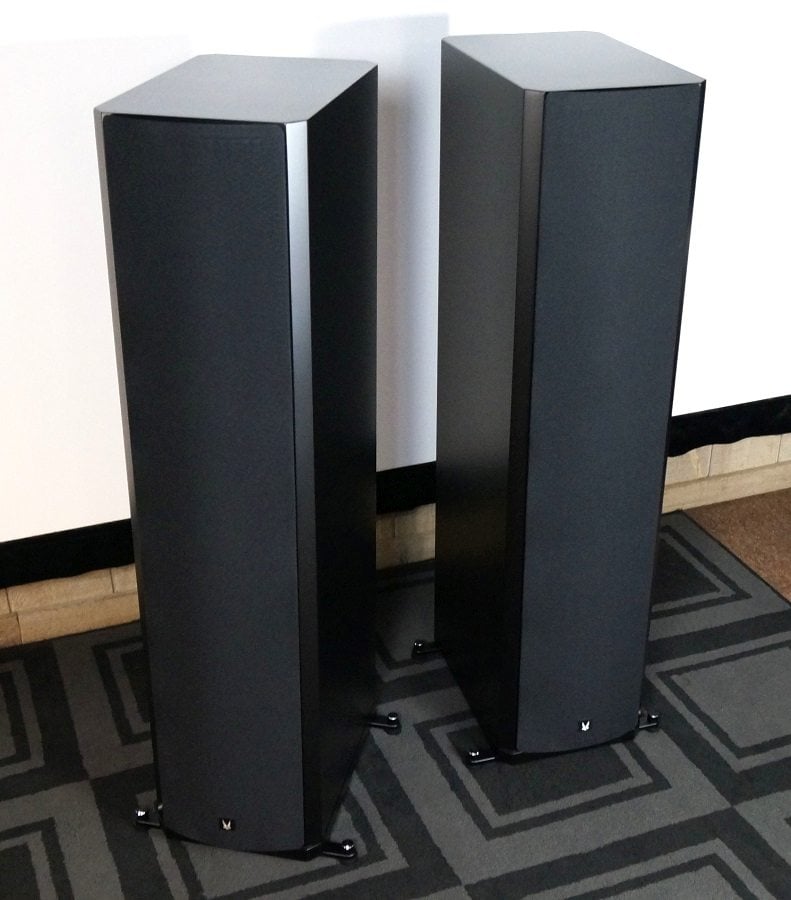

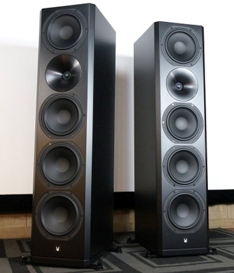

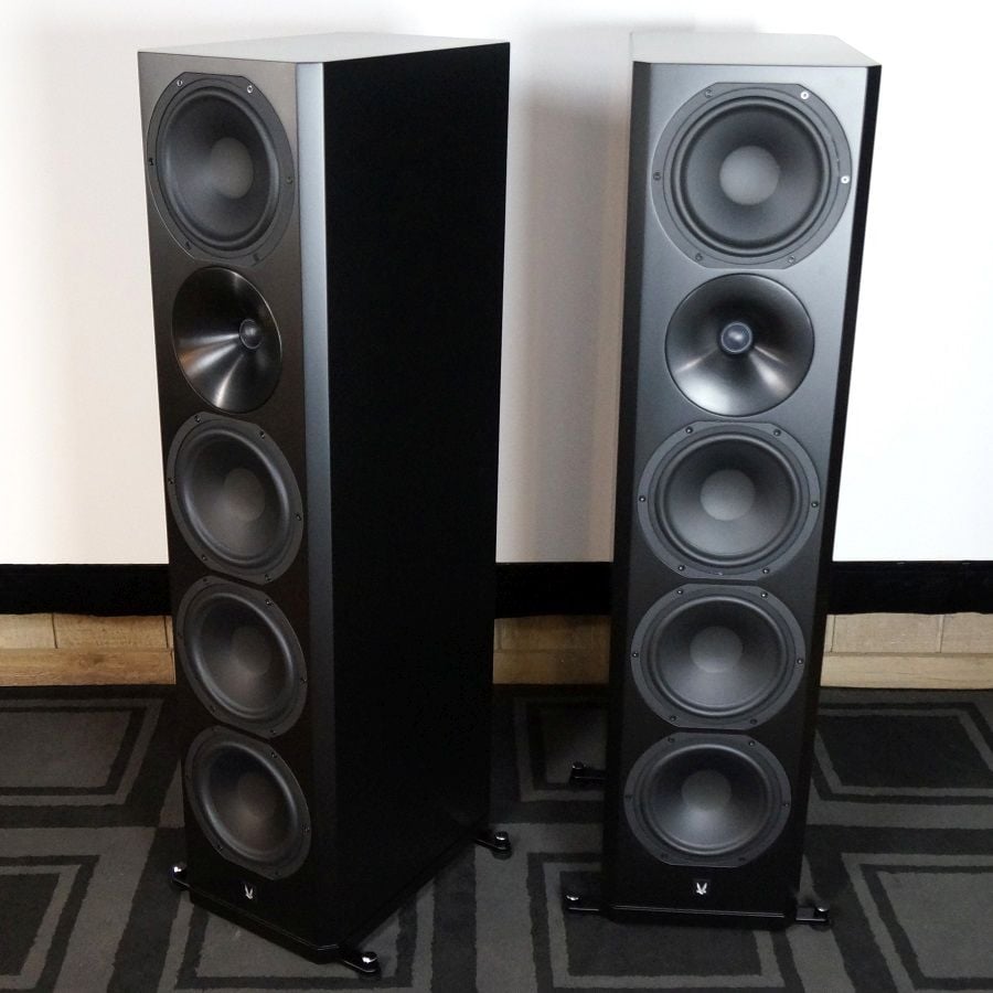

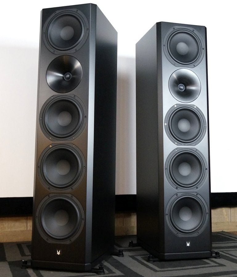

Once unpacked, the 1723 Towers stand as handsome but somewhat imposing black monoliths. I received the satin black finish, but they can also be had in satin white, gloss black, and gloss white. These aren’t small speakers, so they won’t go unnoticed in anything but very large rooms, and for that reason, they need to look nice. The good news is that they do look nice. The front baffle is mostly just an array of 8” woofers with a circular waveguide nesting a tweeter. While that might seem busy-looking, the drivers themselves are finally simple and clean-looking, so the sum total aesthetic falls on the minimal side. The vertical edges have a 90-degree chamfer, and the speaker has a 2.5-degree tilt, and these attributes help to give the speakers a sleeker appearance. For those who don’t care for the appearance of the drivers or who have to protect the cones, the supplied grille does a good job of hiding the entire front baffle of the speaker. The grille has a rounded shape, so it isn’t as boring as most grilles, and I think the 1723 Towers aren’t bad-looking with the grilles installed at all.

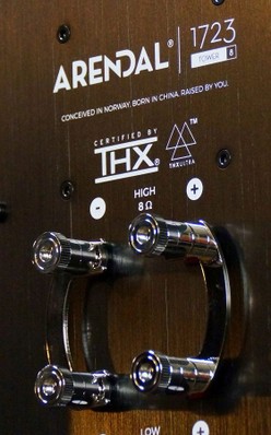

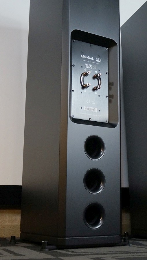

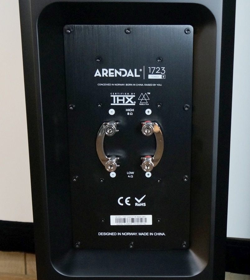

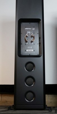

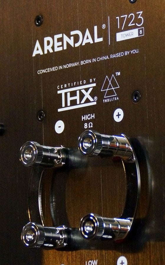

Mention should be made of the rear of the 1723 Towers; Arendal provides a very high-end-looking brushed aluminum terminal plate that is sunk into the cabinet. The chrome binding posts and jumpers also add to this high-end effect. The outriggers and feet also have a finely machined appearance that gives a sense of solidity. The whole speaker looks terrific from any angle.

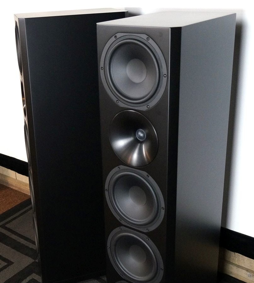

To state the 1723 Tower’s design very simply, it is a 2.5-way vented floor-standing speaker that uses four 8” woofers and a waveguide-loaded tweeter, but, of course, there is much more to it than that. Let’s start our discussion of its particulars at the top of the frequency band by talking about the tweeter. Since it’s the same tweeter as the one used in the 1723 THX Monitor, we will just borrow our description from that review:

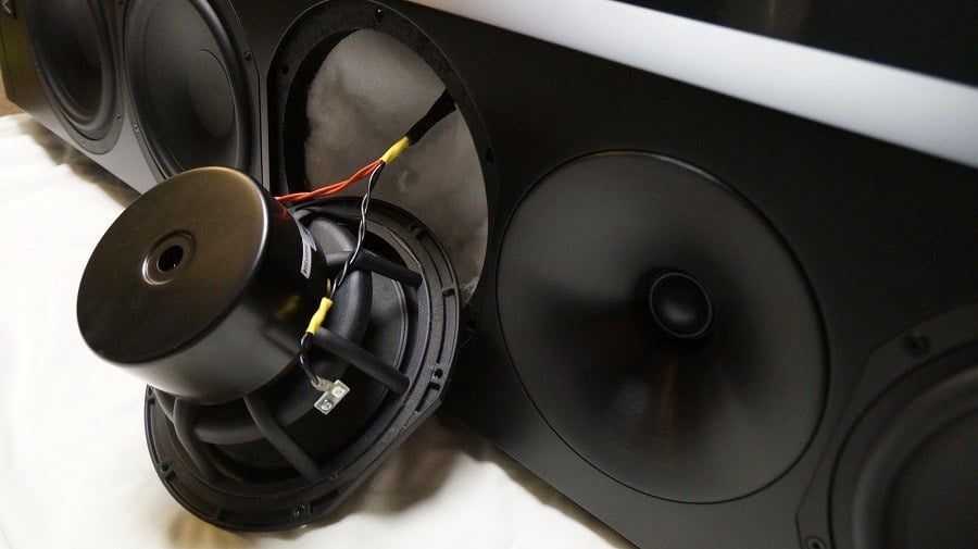

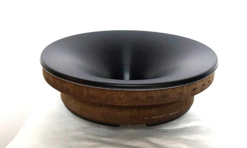

The tweeter is a 1.1” synthetic soft dome loaded into a spherical aluminum waveguide. The waveguide should help control dispersion by constricting the lower end of the tweeter’s band but also widening the high end. This is done so that the dispersion remains more consistent than what normally occurs for dome tweeters without a waveguide, which is a very wide dispersion at their lower end that ends up becoming narrow at the top of the tweeter’s frequency range. Arendal’s literature states that the tweeter uses a neodymium ring magnet, copper and aluminum shorting rings, ferrofluid cooling, as well as an aluminum heatsink and a damped rear chamber to mitigate resonances from backwave radiation.
Removing the tweeter, we can see that the waveguide is reinforced by some MDF-type wood that must have been CNC cut to shape to fit. We also see that there is a bucking magnet on the back of the tweeter, possibly to increase sensitivity and to help contain the magnetic field of the neodymium magnet in the motor. The neodymium magnet is a very large one and holds an extremely powerful magnetic field. This is a very heavy-duty tweeter that should be capable of a far greater dynamic range than a normal dome.

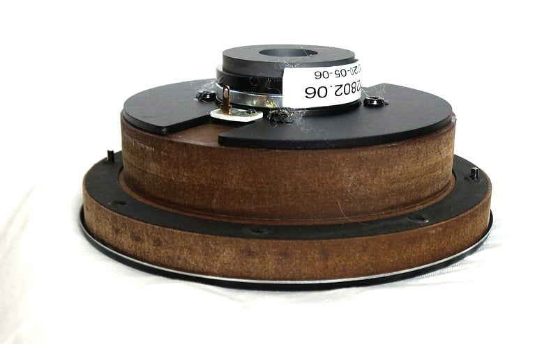

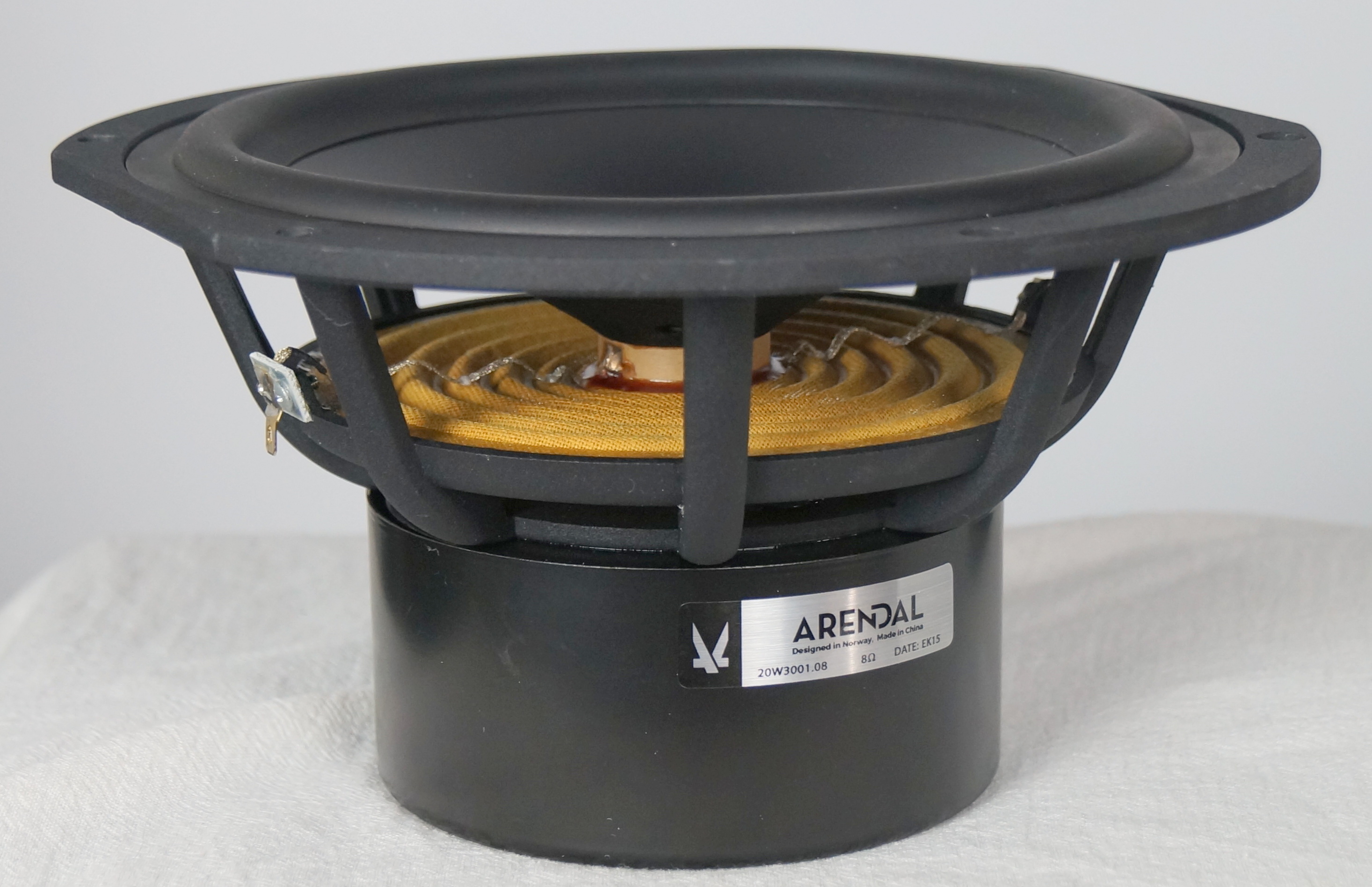

Removing one of the 8” bass drivers, I was surprised at how heavy it was. It’s a pretty serious chunk of iron, and the four of them have to constitute a large fraction of the 1723 Tower’s weight. The bass drivers use long pulp fiber cones with an inverted dustcap and a nitrile-butyl rubber surround. The suspension has been optimized using finite element analysis for linear travel in both directions. The frame uses a cast aluminum eight-spoke basket. The voice coil uses copper-clad aluminum wire for a good balance of low weight and conductivity. It appears to have a 1” diameter voice coil, a shielded motor, and venting done under the spider as well as the pole piece. Shielding can keep more of the magnetic flux within the motor assembly, but it isn’t seen much anymore since it was mostly used to prevent stray magnetic fields from interfering with the picture of CRT screens. There is also an aluminum shorting ring used to reduce inductance thereby increasing bandwidth and lessening even-order distortion products.

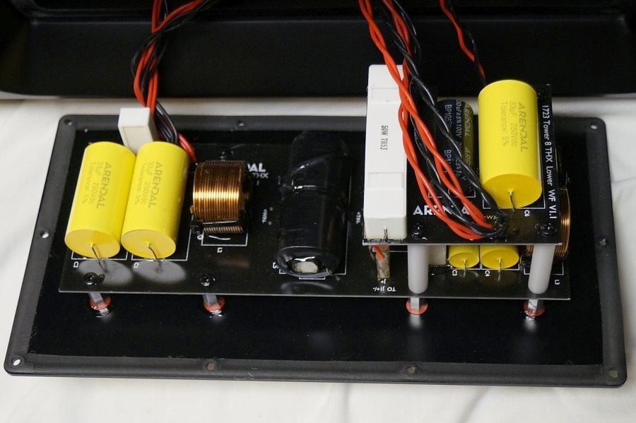

The crossover frequency from tweeter to woofers happens at 1.5kHz at a 24dB/octave slope. The slopes are electro-acoustic so the drivers’ natural roll-off plays a role in the filtered slope. The lower two bass drivers are low-pass filtered at 120Hz, a very low frequency for a passive filter. A 120Hz filter requires a large inductor value and will have some insertion losses. The Arendal 1723 Tower S also had a very low filter, and what I said about it also applies to the full-size 1723 Tower:
The phase rotation of such a low crossover might make it tricky to precisely integrate a subwoofer for those who intend to do that. In fact, crossing these over a subwoofer would give the bass drivers such a small bandwidth that it wouldn’t be worth it. I would calibrate these to be used as a full-range speaker if I wanted to use a subwoofer. So I would not run the 1723 S Towers as ‘Small’ speakers.
Arendal specifies their crossovers to use heavy-gauge air-core inductors, polypropylene capacitors, high-power resistors, thick PCBs, and twisted-pair multi-strand wiring, and, from taking a look at the crossover circuit, it is no joke; these are some beefy capacitors, inductors, and resistors. Arendal provides dual binding posts for bi-amping and bi-wiring. I think this might have made sense if it was the top two woofers and tweeter being a separate circuit from the lower two woofers, but Arendal has chosen to simply make the tweeter separately powered from all of the bass drivers with the jumpers removed. In my opinion, this is a mistake since the four bass drivers can handle far more power than the tweeter. For this reason, I recommend that the 1723 Tower be powered with a single channel of amplification, so leave the jumpers installed. The binding posts look nickel-plated but are actually plated in rhodium, which was chosen for its conductivity, corrosion resistance, and hardness.

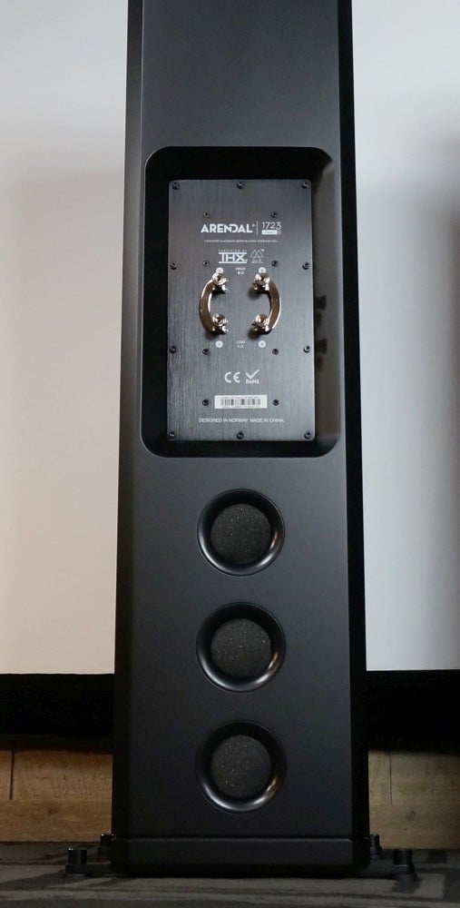

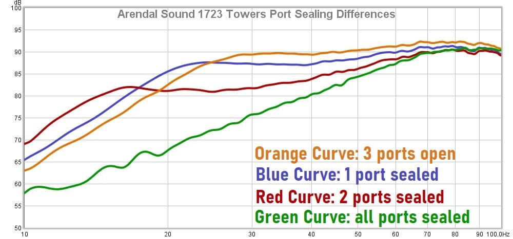

One unusual aspect of the 1723 Tower’s design is its support for variable tuning. It has three ports, each flared at both ends and measuring 6” deep and 2.5” in diameter. Arendal provides port plugs for different port tuning frequencies and suggests sealing ports for deeper bass. Indeed, sealing ports will lower the overall tuning frequency and thus the bass extension of the speaker but not without a cost. The trade-off is that the speaker will have less port-generated output. Sealing some of the ports also increases the chances of port turbulence occurring at higher output levels.
Arendal Sound Variable Tuning
The late Steve Feinstein, Audioholics contributor and loudspeaker expert, was adamantly opposed to variable port tuning systems, insisting that ported loudspeakers had a single optimum tuning frequency based on internal volume and driver parameters, and that variable tuning simply allowed the speaker to be operated outside of optimal performance. For that reason, I always called such designs the ‘Steve Feinstein Special.” While he greatly admired Arendal (evidenced by his glowing review of the 1961 Towers), he would have been fiercely critical of this design decision. For my part, I think it’s fine so long as the user understands the trade-offs involved. I would not run the 1723 Towers in a single port open mode since the risk of port turbulence is quite elevated. I would also not bother to run them in a sealed configuration because it is nonsensical to buy a large tower speaker and then just throw away the deep bass extension and output granted by its large size.

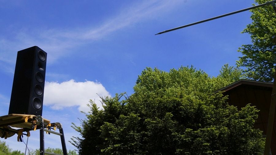

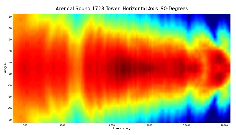

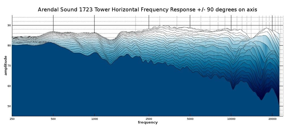

The Arendal Sound 1723 Towers were measured in free-air at a height of 4 feet at a 2-meter distance from the microphone, with the microphone raised to an 8’ elevation that was level with and aimed at the tweeter center. The measurements were gated at 8 milliseconds. In this time window, some resolution is lost below 400 Hz, and accuracy is completely lost below 200 Hz. Measurements have been smoothed at a 1/24 octave resolution.

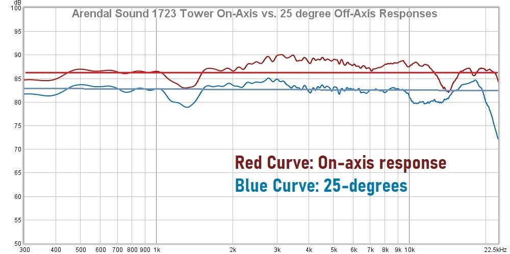

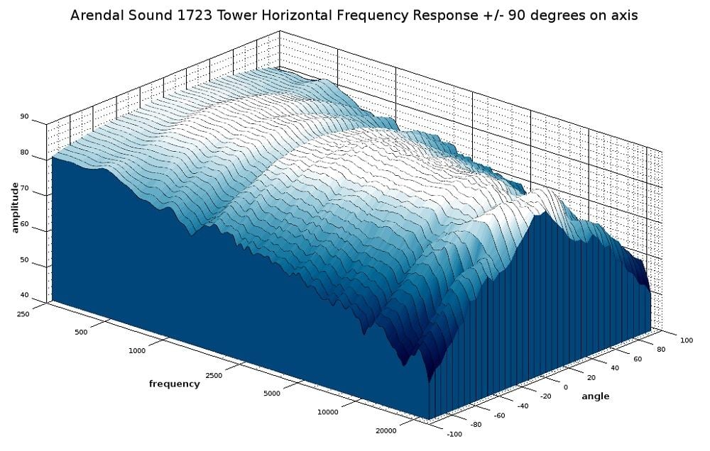

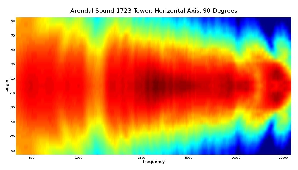

The above graphs depict the 1723 Tower’s direct-axis and horizontal dispersion out to a 90-degree angle in five-degree increments. Information on how to interpret these graphs can be read in this article: Understanding Loudspeaker Review Measurements Part II. Much of the bandwidth of the 1723 Towers is reasonably linear, especially on the tweeter, but there are some anomalies worth mentioning. We do see a dip at the crossover frequency, so it’s not quite a seamless blending of the tweeter and woofers. It’s not severe and shouldn’t impart much of an audible impact on the sound. However, what will have a much more audible impact is that the tweeter seems to be a couple of decibels hot near the on-axis angles. I sensed this in my own listening, and while it didn’t sound offensive, it isn’t my preferred loudspeaker voicing. However, it doesn’t extend to off-axis angles, and positioning the speaker to face the listener at a 20 to 30-degree angle puts the tweeter’s output on par with the woofers for a balanced sound. This can be done by angling the speakers to face outward in parallel vectors or they can be angled at a severe inward toe-in. In my listening, I opted for an inward toe-in because that sharpened up the imaging considerably compared to a parallel angling.
The above graph gives us a better look at how the on-axis response compares to the 25-degree response in the 1723 Towers. In this graph, we can see that the tweeter is a bit hot relative to the midrange woofers at an on-axis angle. However, it does calm down by 25 degrees off-axis. Of course, users could always equalize the speaker for a neutral response if they wanted to have the speakers facing straight toward them, but angling the speaker is essentially also a form of equalization. For those who can bi-amp, they can also knock down the level going to the tweeter by about two to three dB, and that will have a similar effect.
The above polar map shows the same information in the preceding graphs but depicts it in a way that can offer new insight regarding these speakers’ behavior. Instead of using individual raised lines to illustrate amplitude, polar maps use color to portray amplitude, and this allows the use of a purely angle/frequency axis perspective. The advantage of these graphs is they can let us see broader trends of the speaker’s dispersion behavior more easily. More information about interpreting this graph can be read in this article: Understanding Loudspeaker Measurements Part II.
Arendal Sound 1723 Optimal Speaker Positioning
Here we see that the directivity of the 1723 Towers is very nicely controlled. There is some waist-banding at the crossover, but that only occurs over a narrow bandwidth. The waveguide does a beautiful job of controlling the tweeter’s dispersion. This makes a time-intensity trading style of placement possible, and that can bring some major audible advantages. For those who want to learn more about time-intensity trading, Audioholics has a great YouTube discussion that explains this: Finding the Loudspeaker Sweet Spot. This is the type of placement I chose for my listening, and I was very pleased with the sound of the speakers. As I said in my listening description, it provided some absolutely top-notch imaging. An obvious attribute that can be gleaned from this graph is that the 1723 Towers are not wide dispersion speakers. They should have wide enough coverage for any reasonable listening area, but listening positions at far angles may be left with a fairly muted treble sound. I would try to listen within a 40-degree angle of the speaker’s firing direction.

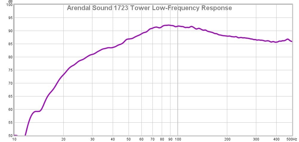

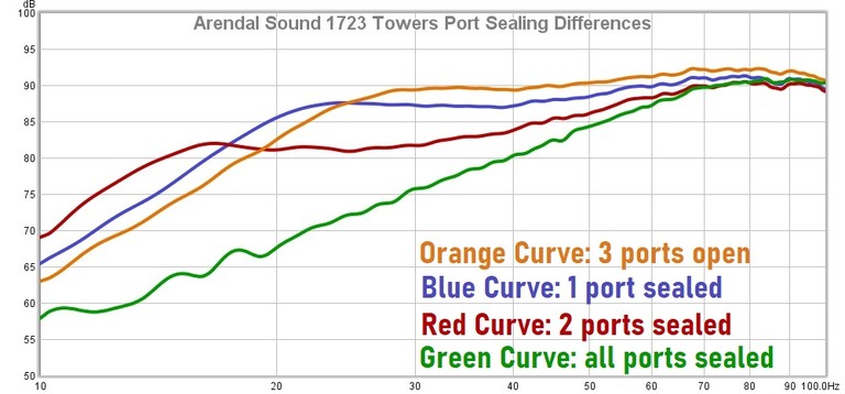

The above graph shows the 1723 Tower’s low-frequency response captured using groundplane measurements (where the speaker and microphone are on the ground at a 2-meter distance in a wide-open area). This response was measured with all ports open. We do get an elevation centered around 100Hz, but I didn’t notice excess bass in my listening. Curiously, the recently reviewed SVS Ultra Evolution Pinnacle speakers shared a similar type of elevation, but a bit lower in frequency, and I did notice it in that speaker. I would guess it is due to the way that the SVS speaker’s rear-firing bass drivers play in my room as well as the slight frequency offset. Either way, it is not a massive bass bump, and many people tend to prefer a slight rise in bass anyway. The low-frequency response starts a gradual roll-off at around 70Hz until we get to the port tuning frequency in the mid-20Hz range. That is very typical of many tower speakers since having a flat response down to port tuning often leads to too much bass boost thanks to room gain. The port tuning frequency is quite low, well below 30Hz, so these speakers should dig into very deep frequencies in-room. No subwoofers are needed with the 1723 Towers!
The above graph shows the low-frequency response differences of the 1723 Towers for different configurations of port sealing. These measurements were taken at 1 meter from the rear of the speaker. Sealing ports make the low-frequency extension deeper but at the cost of headroom. In other words, the speaker will play deeper, but it won’t play those deep frequencies as loudly. Also, as was discussed before, sealing ports increases the chances of port turbulence occurring, so long as all ports are not sealed. That makes leaving only a single port open particularly vulnerable to port turbulence, at least in comparison to leaving all ports open. Of course, sealing two of the three ports reduces port volume by 66% with a corresponding reduction in headroom. Sealing two ports does shift the port tuning frequency below 20Hz, effectively moving it into infrasonic ranges. I would encourage users to use an all-ports open configuration or seal a single port. Sealing two ports compromises the headroom too much and greatly increases the chances of port turbulence. Sealing all the ports just knocks out a huge amount of headroom and extension, and what is the point of buying such large tower speakers if you aren’t going to take advantage of their low-frequency extension?

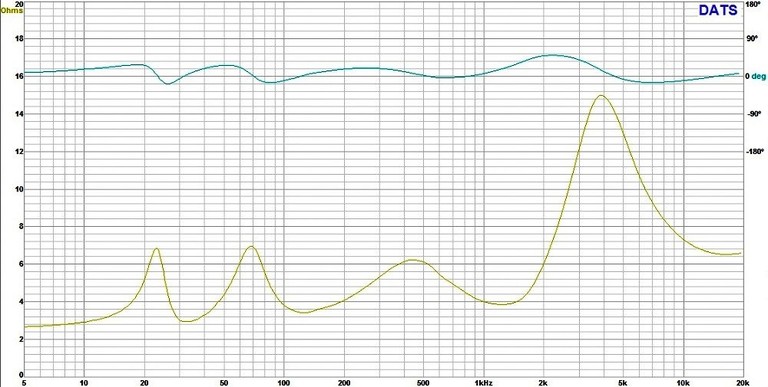

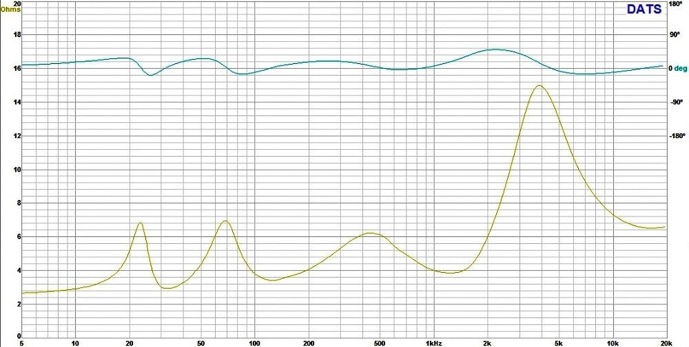

The above graph shows the electrical behavior of the 1723 Tower. Arendal specifies this to be a 4-ohm nominal load, and our measurements would corroborate that. The minimum occurs at port tuning, just above 30Hz, and it touches 2.8 ohms. Such a low impedance minimum might sound tough, but it happens at a frequency that is seldom used in normal content, so I don’t regard this electrical load as particularly hard, although these speakers will be a tough load on cheap amps. Users will want a decent amp anyway but more to achieve its output potential than to cope with a stiff electrical load. It’s interesting to note that the low-frequency saddle peaks are about the same height, and that indicates that the cabinet tuning is a good match for these bass drivers.
I measure the sensitivity to be 91dB at 1 meter for 2.83v. That is fairly close to Arendal’s spec of 92dB for 2.83v at 1 meter. As one would imagine, it’s not an insensitive tower speaker, and it can get loud without needing a ton of wattage.

Beyond the sound, the 1723 Towers look nice as larger tower speakers go. With the grilles applied, they have a pleasing minimalist appearance, and without the grilles, the drivers all present an elegant symmetry. The build quality is extremely good for the price point. In fact, I can’t think of any other loudspeaker brand that can match its build quality for the same cost. They are built like tanks and will last a long time if not abused. Their weight is a testament to that.
