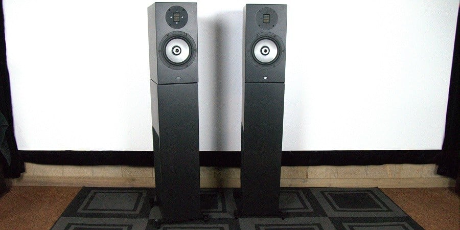

RBH Sound Signature 61-SFM/R Appearance

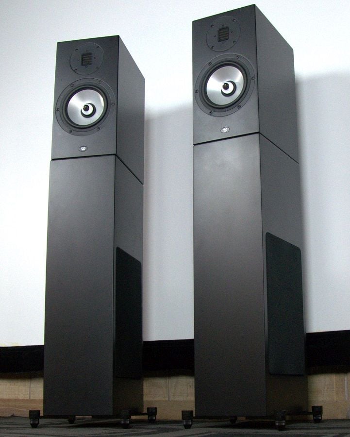

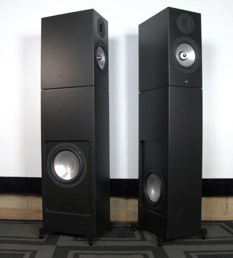

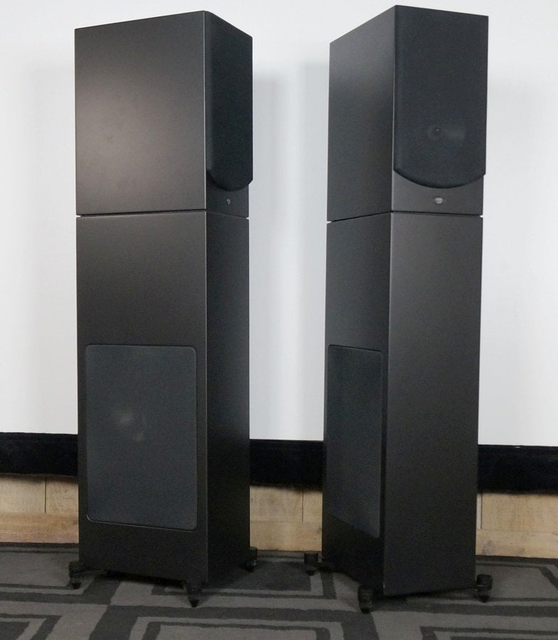

The RBH Sound 61-SFM/R has a fairly straightforward appearance. It doesn’t try to hide its boxiness with rounded corners or a curved section of the cabinet; in fact, it embraces its boxiness for a minimalist aesthetic. Its visual simplicity enables it to fit in well in a wide variety of interior designs. It can be had in a satin white or black finish, and the version I received was satin black. The satin finish is high quality, but it must be said that, as with all smooth satin blacks, fingerprints do show up easily when the surface is touched with bare hands. For this reason, I think RBH should consider including some cotton inspection gloves for the unpacking and setup of the speaker. This would be an inexpensive addition and give the unpacking experience a more deluxe feeling.
61 grilles off  61 grilles4

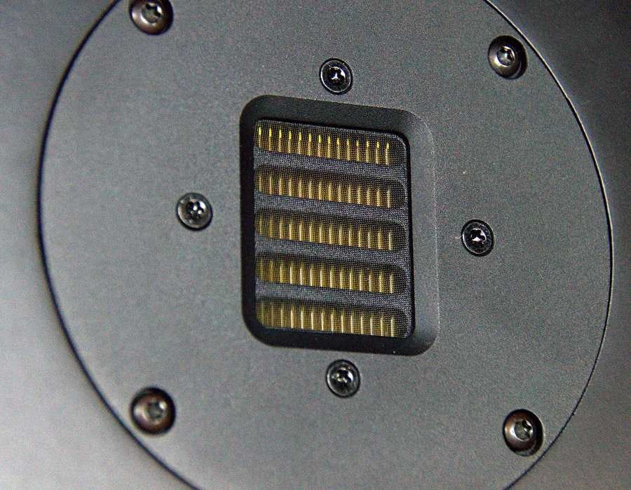

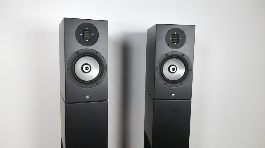

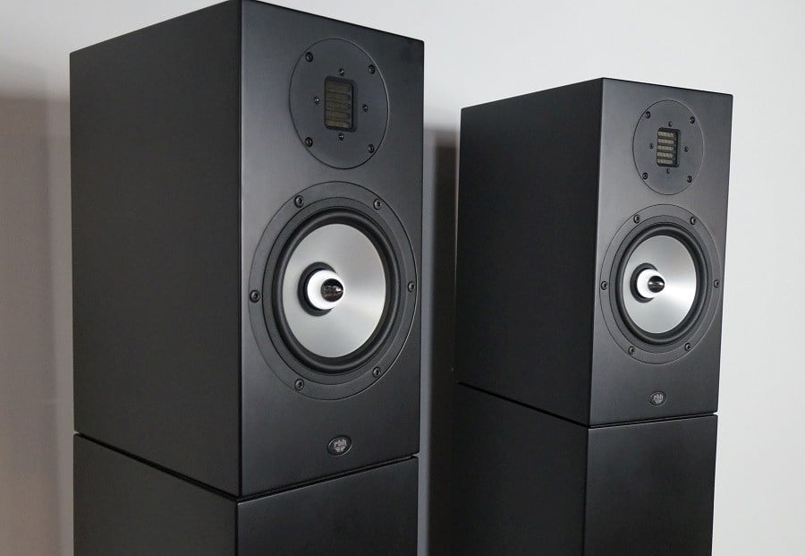

The AMT tweeter and aluminum midrange woofer are mounted flat on the front baffle. Otherwise, the front baffle is featureless except for a small RBH badge below the midrange woofer. The bass drivers are mounted on the sides of the lower section of the speaker. The bass driver cones have their own grilles that cover them on both sides of the cabinet, and the tweeter/woofer section has its own grille that hides those drive units. With grilles on, the speaker looks rather muted. Taking the grilles off does give it more personality. The 61-SFM/R is so simple in appearance that it still has a clean look without grilles, especially since the magnetically attached grilles do away with the need for grille guides to mar the front baffle. Outriggers with big spiked feet do lend it a more substantive styling. One interesting way the appearance can be changed is that the aluminum woofers can be had in either metallic or anodized black. If it were me, I would go with black cones for the satin black finish and metallic cones for the satin white finish. Overall, the 61-SFM/R has a clean, minimalist design that few people would have problems with.

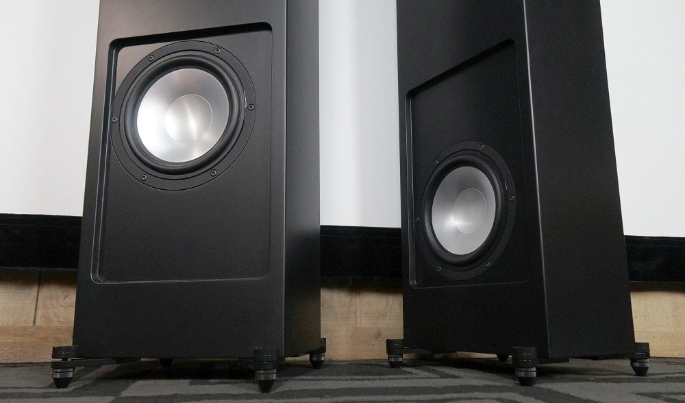

Taking a broad view, the 61-SFM/R is essentially just a bookshelf speaker (the 61-SF/R in this instance) mounted on dual-opposed 8” bass drivers passive subwoofer acting as a speaker stand. This can be a very capable design if handled well, so the details matter for this loudspeaker. Let’s begin our discussion of the 61-SFM/R at the top of the frequency band with the tweeter. The tweeter is a 1” AMT. AMT tweeters can range in quality and don’t really have any visible design cues that can be used to determine how good they are. RBH Sound has had great success with AMTs in the past, so I trust that this one is good, although not every AMT from every manufacturer that has run across my path has been great.

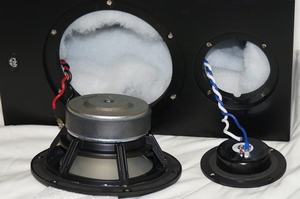

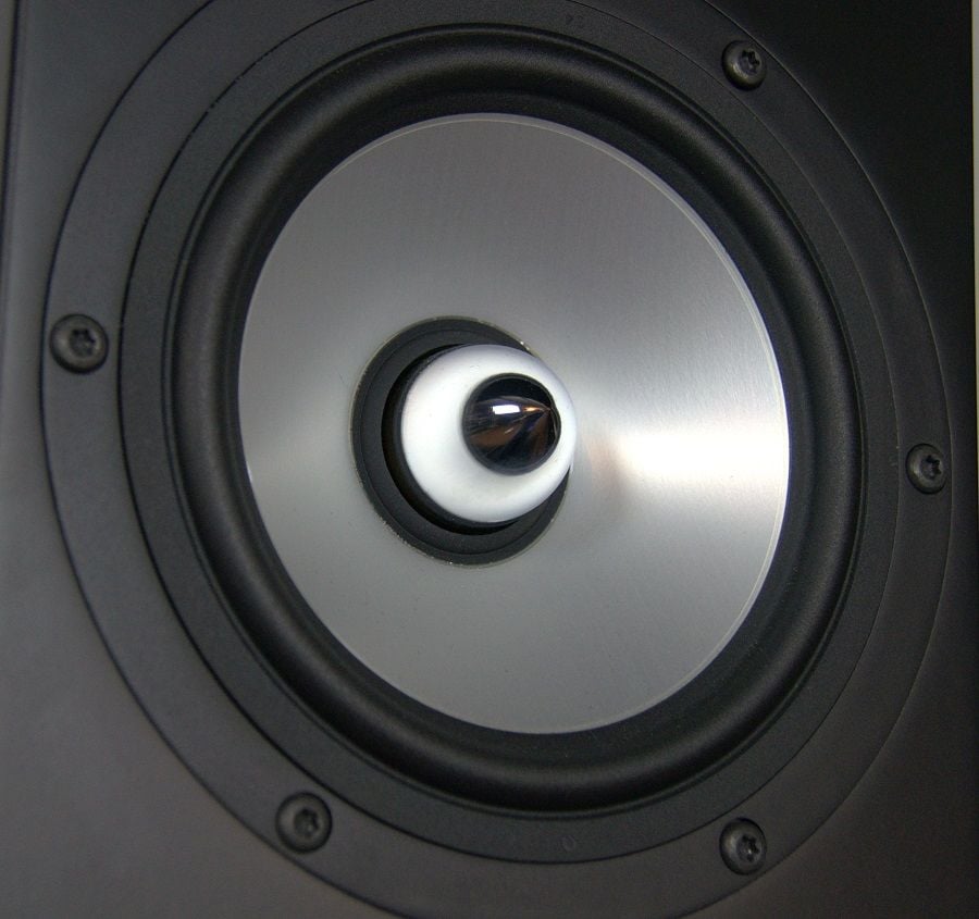

The midrange uses an aluminum cone as so many RBH Sound speakers do. It has a solid non-ferrous metal alloy phase plug with a cast aluminum basket. The motor uses a ⅞” thick magnet with a 4” diameter and has a slightly bumped-out backplate for higher excursions. The bass drivers similarly use aluminum cones with a cast aluminum frame. They have ¾” thick by 4 ½” diameter magnets and a bumped-out backplate with cooling done through the pole piece. Two bass drivers have about the same surface area of an 11” cone, so the 61-SFM/R should have a good amount of low-frequency thump. The dual-opposed mounting of the bass drivers is a good idea here since they cancel out each other's inertia, so the bass module section of this speaker will not have any rocking motion from the moving mass of the woofers. That makes it an inert and unmoving stand for the bookshelf speaker section.

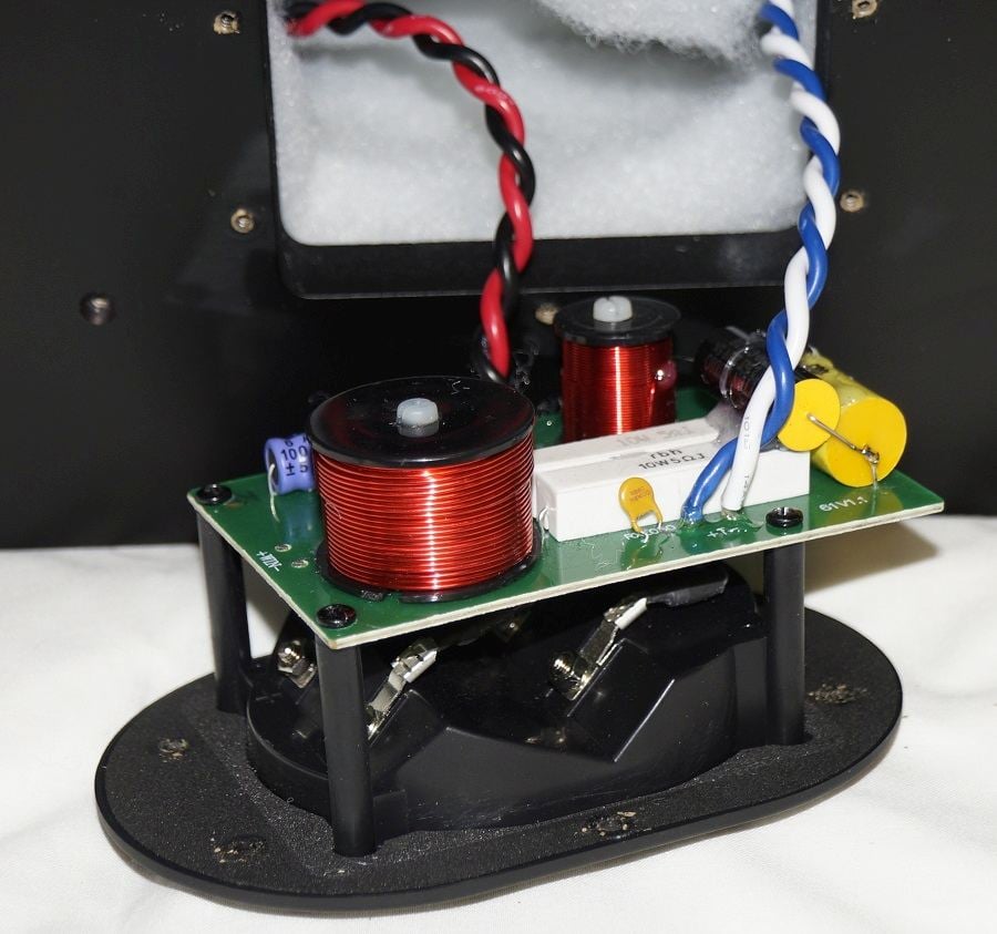

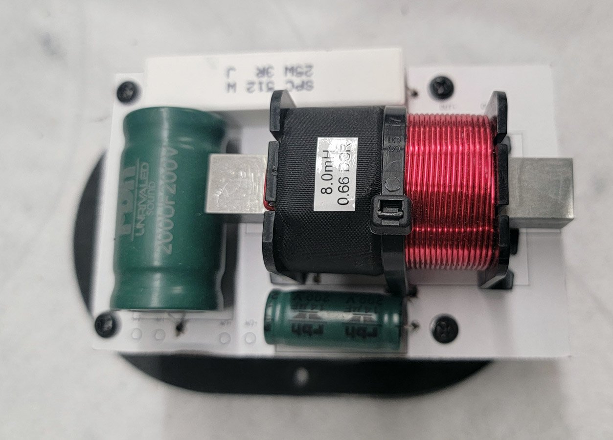

The 61-SF/R bookshelf speaker section doesn’t have a whole lot of crossover elements, but the elements it uses are high quality, with four large poly-film capacitors, two air-core inductors, and two beefy resistors. As with other RBH Sound speakers, we see the use of a self-resetting poly-switch which protects the tweeter by raising resistance above certain electrical current levels that would place the tweeter in danger.
RBH Sub Xover
RBH Sound 88-MS Bass Module Crossover
According to Shane Rich, Technical Director of RBH Sound, for the 88-MS bass module, the filters are in effect 1st order to within an octave or so of the crossover point and then transition to second order. Because the crossover is low order, the phase shift is minimal and the 8” drivers actually still have usable output beyond 200Hz, allowing for ample dynamic range. Shane claims having the lower crossover point also minimizes phase shift in the vocal region (which would be more noticeable) and is optimal for better imaging.

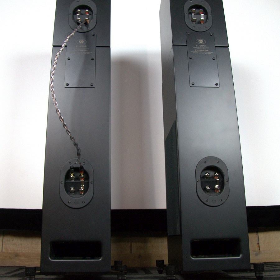

The wiring of the speaker is a bit more involved than typical passive speakers. Users need to attach the speaker cable to the lower pair of binding posts of the bass module section and then wire that section to the bookshelf section via the bass section’s upper binding posts. RBH provides the wires to connect the two sections together. The bass module can be made to have more or less bass depending on how it is configured. There is a single jumper on the right pair of binding posts, and if left installed, users will get an even level of bass with the bookshelf portion. Remove the binding post and the user will get increased bass output from the bass module. For a lowered bass level, users can remove the jumper and connect the positive input to the upper positive binding post. If that all sounds convoluted, RBH Sound does provide a diagram that makes it easier to follow.

The enclosure is made from ¾” high-density fiberboard. The structure is inherently well protected against cabinet vibrations since it is more like two separate speaker cabinets than a single one. The bookshelf segment of the cabinet has a window pane brace in it and lots of Dacron-type acoustic stuffing. It rests on the bass section on top of a soft material that damps vibrational transfer. The two sections are attached together with a plate that screws into the rear panels of both sections. The bass section has acoustic foam pads lining the walls. A rear-mounted slot port adds rigidity to the bass section as well as adds weight for a lower center of gravity. The 61-SFM/R uses spiked feet mounted on some outriggers. They can be individually adjusted to have a solid footing even on an uneven surface.

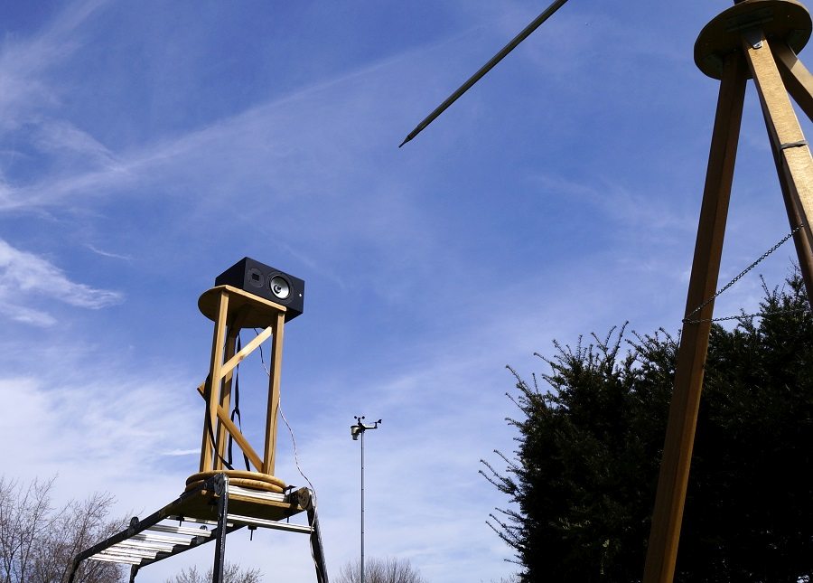

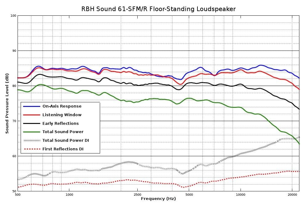

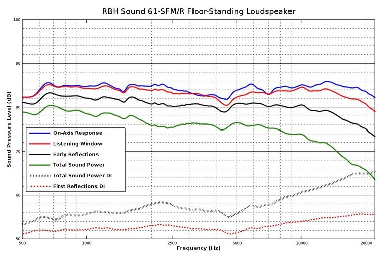

The bookshelf speaker part of the RBH Sound 61-SFM/R speaker, the 61-SF/R, was measured in free air at a height of 7.5 feet at a 1-meter distance from the microphone, and the measurements were gated at an 11-millisecond delay. In this time window, some resolution is lost below 250Hz and accuracy is completely lost below 110Hz. Measurements have been smoothed at a 1/24 octave resolution. Since our frequency band of interest is well above the crossover frequency to the bass module, we opted to measure the bookshelf speaker part alone because it should measure nearly identically as the fully-assembled tower, yet the higher elevation we can give the bookshelf speaker will allow us to have better resolution down to lower frequencies.
61 spin o rama
The above graph shows the direct-axis frequency response and other curves that describe the 61-SFM/R’s amplitude response in a number of ways. For more information about the meaning of these curves, please refer to our article Understanding Loudspeaker Measurements Part 1. The measurements presented by the speaker are overall good. There are some minor ripples across the on-axis response that are mostly due to baffle reflection and diffraction since we don’t see them on the early-reflections curve, and the nature of those qualities are inherently less audible than if they were resonances, not that they would be majorly audible attributes even if they were resonances. The listening window curve and early reflections curve stay within a fairly tight +/-2dB window until very high treble frequencies which do not matter as much. Those metrics are the chief determinants of sound character, and that denotes a fairly neutral sound for this speaker.

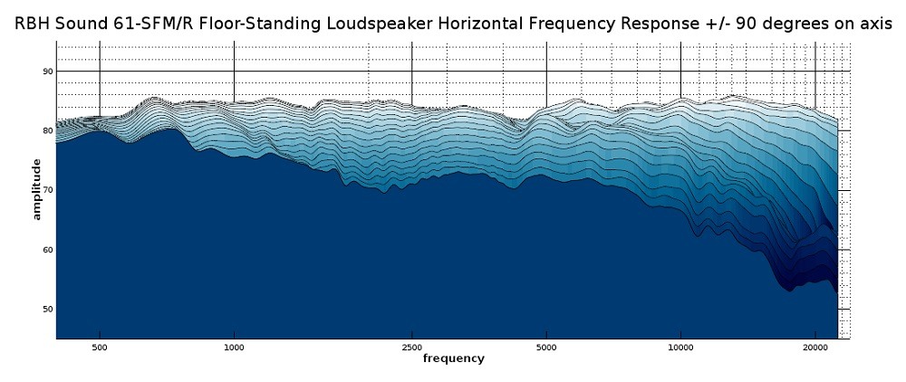

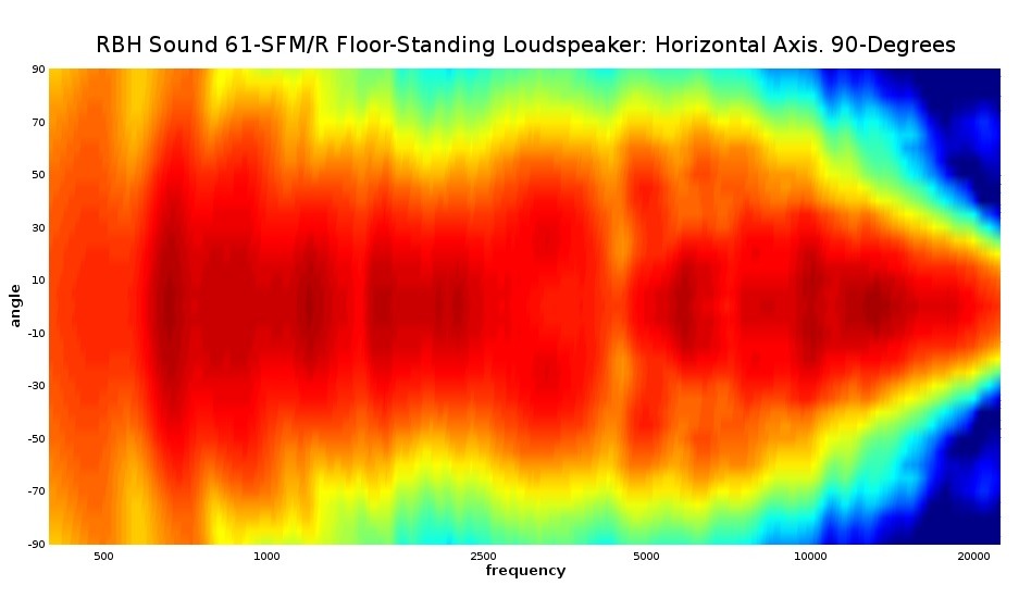

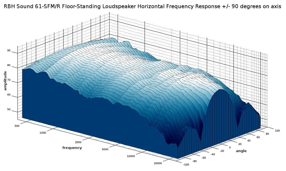

The above graphs depict the speaker’s lateral responses out to 90 degrees in five-degree increments. More information about how to interpret these graphs can be read in this article: Understanding Loudspeaker Review Measurements Part II. In these graphs, we get a closer look at the lateral behavior of the 61-SFM/R. The off-axis responses correlate pretty closely with the on-axis response with a few small exceptions. That means that this speaker should sound very similar over a broad area. Higher frequencies do attenuate a bit as we move off-axis, so those who want a warmer sound merely have to angle the speakers outward to face a parallel direction. That should put the listener within a 20 to 30-degree angle where frequencies above 4kHz are shelved a bit. Above 10kHz, the tweeter does start to narrow its dispersion, and users who want to be met with very high treble should have the speaker roughly face the listener.
61 sfmr Polar Map
The above polar map graphs show the same information that the preceding graphs do, but they depict it in a way that can offer new insight regarding these speakers’ behavior. Instead of using individual raised lines to illustrate amplitude, these polar maps use color to portray amplitude, and this allows the use of a purely angle/frequency axis perspective. The advantage of these graphs is that they can let us see broader trends in the speaker’s behavior more easily. For more information about the meaning of these graphs, we again refer the reader to Understanding Loudspeaker Review Measurements Part II.
In this graph, we can see that the 61-SFM/R has a fairly wide dispersion overall, and listeners will be hit with a full sound all the way up to 10kHz out to a 60-degree angle. These speakers offer good coverage over a broad area. We do see some slight waist-banding around the 2kHz region where the woofer is beginning to constrict its dispersion, but as the tweeter takes over, the dispersion pattern widens up a bit more. This is a fairly mild directivity mismatch between the tweeter and woofer and is pretty commonly seen with 1” tweeters (dome or AMT) when paired with a 6.5” woofer. It’s not going to result in any major coloration in sound and is worth noting more for academic curiosity rather than any audible consequence. This mismatch might have been solved by using a 5.25” or smaller woofer but that would sacrifice dynamic range, and the lessened dynamic range is more likely to interfere with the sound than a mild directivity mismatch. Something else to note is the tightening dispersion above 10kHz; while AMT tweeters can have this effect, it is much milder than dome tweeters, so this constriction of output would have been more severe if RBH had used a typical dome tweeter.

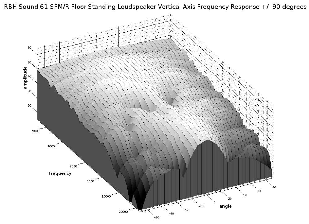

61 sfmr 3D Vertical Waterfall Response
The above graph shows the 61-SFM/R’s response behavior along its vertical axis where zero degrees is directly in front of the tweeter, negative degree values are below the tweeter, and positive degree values are above the tweeter. This speaker doesn’t allow for a whole lot of vertical movement before the woofer starts to fight with the tweeter, so we get about +/-5 degrees of vertical angle before crossover nulls kick in. Listeners should ensure their ears are at or near the tweeter’s height. That is true for most speakers, but it is especially true for these. It shouldn’t be a problem since the tweeters have about a 41” height which brings them up to an approximate ear level of most listening positions.

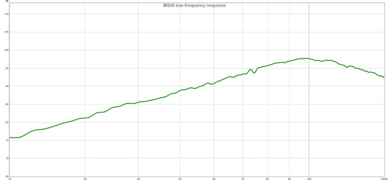

ms88 response

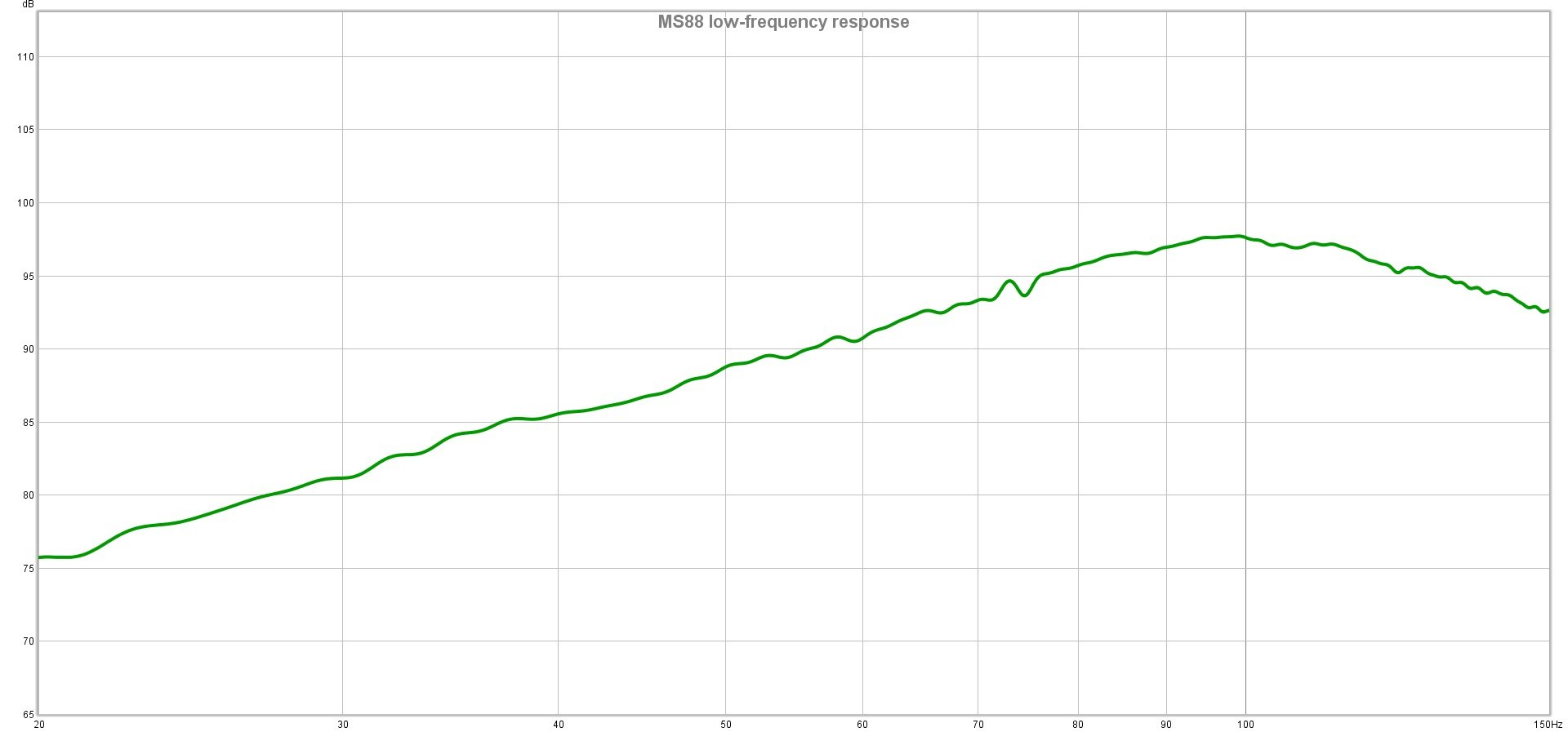

The above graphs show the 88-MS low-frequency responses that I captured using groundplane measurements (where the speaker and microphone are on the ground in a wide-open area). The MS-88 is the name of the bass module used in the 61-SFM/R. It should be noted that given the distances and crossover frequencies between the midrange driver, bass drivers, and port location, this is not an easy loudspeaker to get an accurate low-frequency response, and the port’s contribution is probably underrepresented. That being said, we can still get an idea of the extension of the 61-SFM/R. Port tuning seems to be around 30Hz; indeed, in my listening room, I could get a strong response down to 30Hz but not much below that range. The system looks to have a small bump at around 100Hz, but I didn’t notice any bass particularly thick in that range. The port is possibly a bit underdamped, but most people’s room gain will shore up lower frequencies to be on par with the mid-bass levels. This is a strategy for an even bass sound used in many floor-standing loudspeakers, and it is a sensible one. My own listening room, which does not benefit from a lot of room gain, still overboosts the bass in loudspeakers that have a flat response down to low frequencies. The bass module allows the user to change bass levels by the presence of a jumper on the positive terminals, but I found that it only changed output by about 2dB.

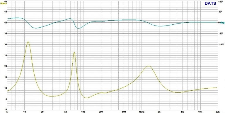

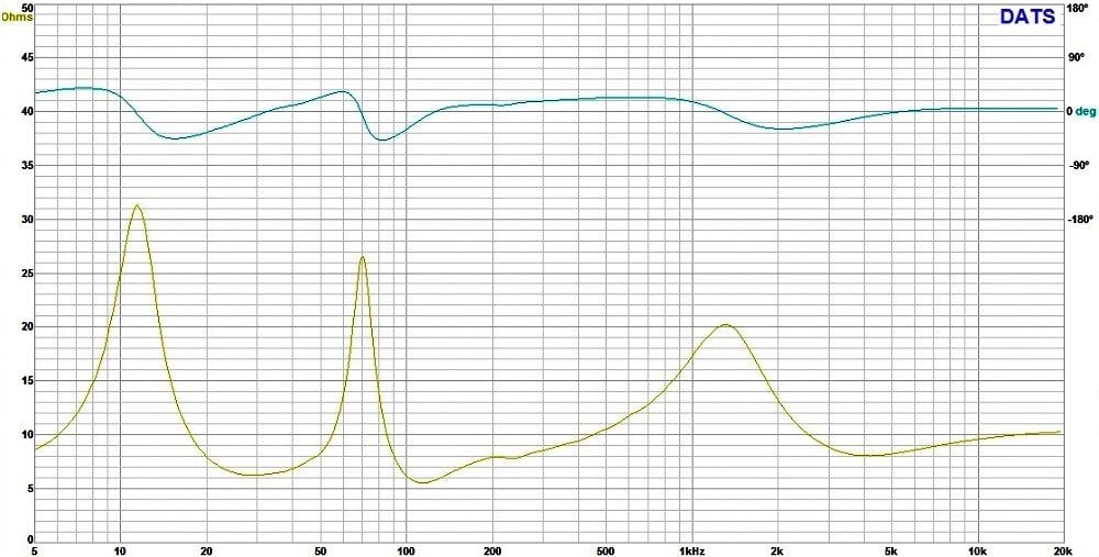

 61 impedance
The above graph shows the electrical behavior of the 61-SFM/R speakers. RBH Sound specifies this as a 6-ohm nominal speaker, and that is correct.  This is a relatively benign electrical load for nearly any amplifier. One notable attribute we can see is how far down in frequency the lower peak in the low-frequency saddle. This is a result of the very low tuning of the port, and we can see from the minima of the saddle that enclosure tuning is about 30Hz. There is not much else unusual to note here, despite how unusual the design is as a whole.
