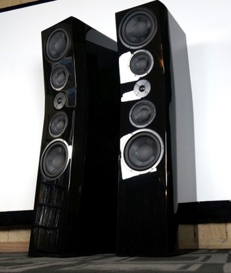

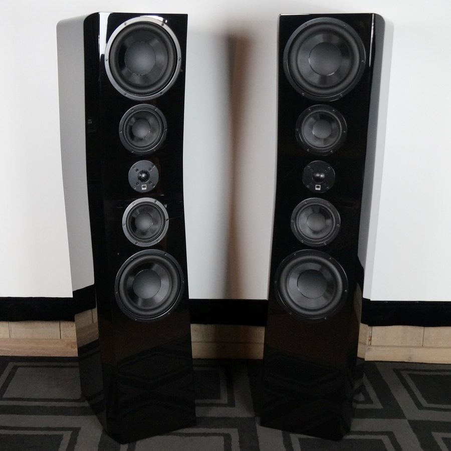

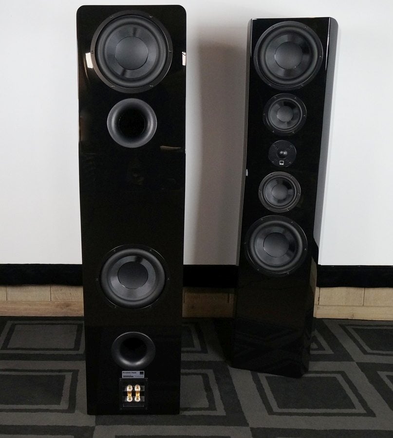

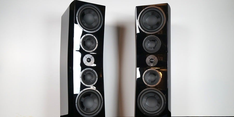

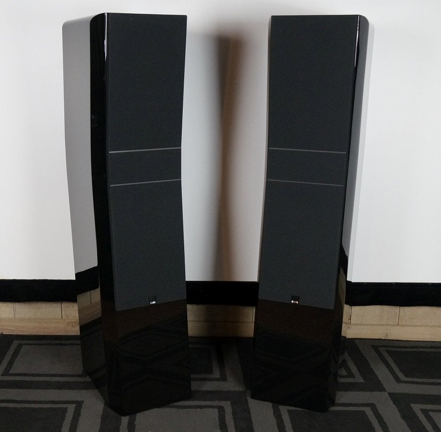

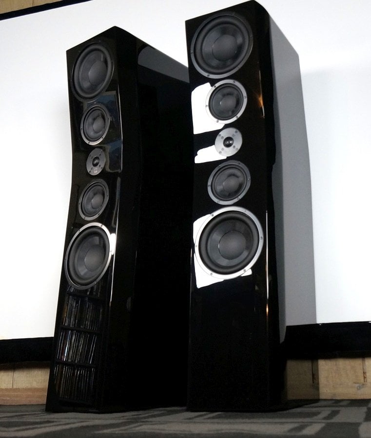

Once unpacked, the Ultra Evolution Pinnacle towers stand as a pair of gleaming, angular obelisks. They have a slightly hunched posture due to the cabinet bend at the tweeter. The cabinet shape is a distinctive stylistic choice and will certainly make SVS’s speakers stand out from the crowd in its market segment. I received the gloss black finish, but the Ultra Evolution speakers can also be had in gloss white and a black oak veneer. A very gradual chamfer at the front edges of the cabinet gives the Ultra Evolution Pinnacle speakers an almost aerodynamic touch. There are a lot of drivers on display: two midranges, two 8” bass drivers, and a dome tweeter. The beefy surrounds and matte dustcaps of the woofers have a muscular look, and these speakers do look like they pack a lot of firepower. What accentuates this brawny look is that, at seated height, these large speakers look like they are looming over you with their hunched-over posture. Another interesting design cue is the protective cover of the tweeter has an interesting irregular webbing pattern, but it is only noticeable when examined closely.
With a 50” height, the Ultra Evolution Pinnacles are big speakers, so anyone who orders them and hopes that other household occupants won’t notice the new additions to the living room is in for a rude awakening. The grilles do a bit to make the speakers more innocuous by hiding the drivers, but they can not mask the sheer size of the speakers. The good news is that they are fairly stylish without being gaudy or splashy, and I do think they pulled off a unique aesthetic yet still look nice. Loudspeaker buyers who need something more modestly sized are in luck; SVS also has the Ultra Evolution Titans and Ultra Evolutions Towers which are smaller floor-standing speakers then the Pinnacles but share most of the same design.

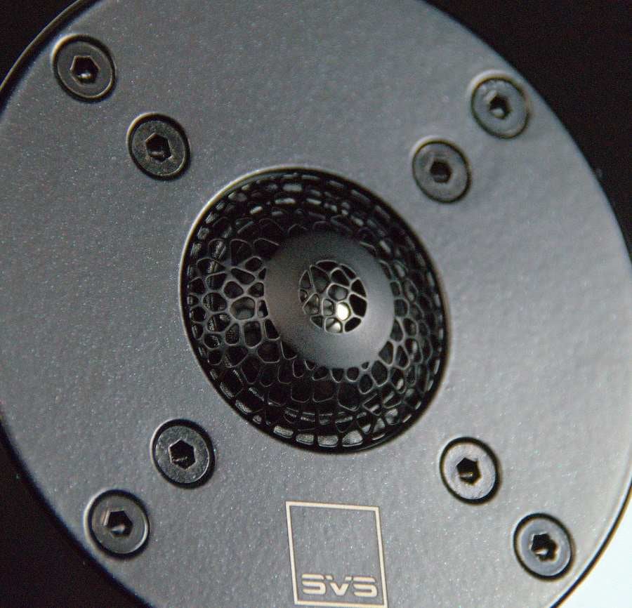

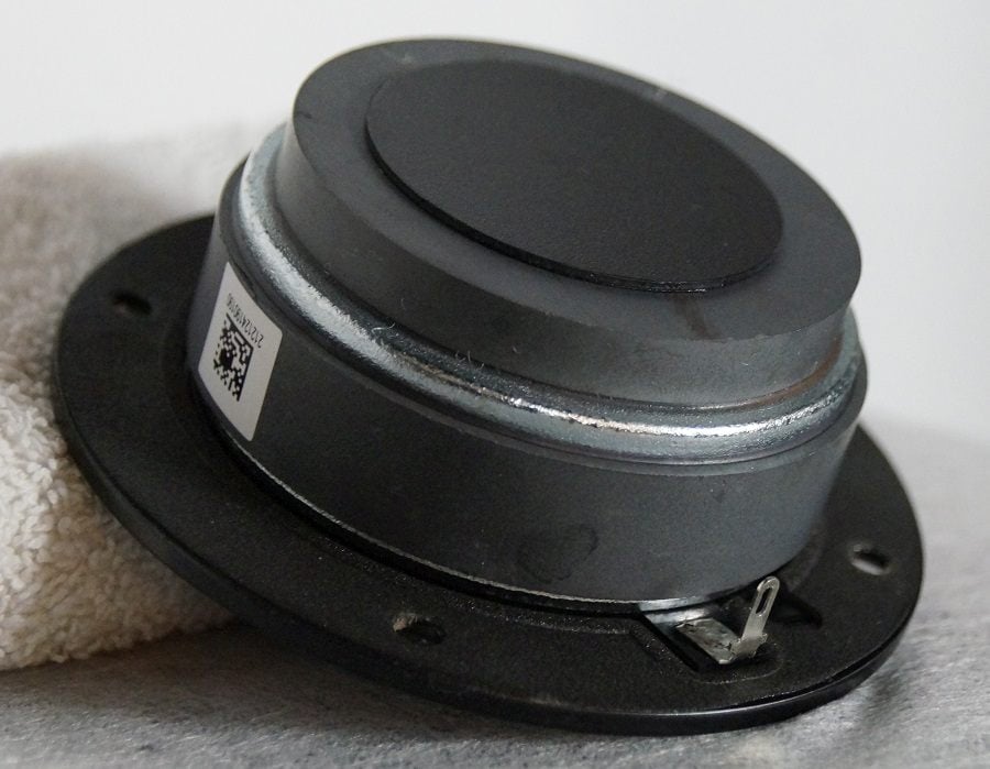

Getting into individual components, let’s start at the top of the frequency band as we normally do and talk about the tweeters. SVS uses an aluminum dome with a vapor-deposited diamond coating. Vapor-deposited diamond dome tweeters have been around for a while and were most famously used in Bowers & Wilkins 800 series speakers. Those speakers have a considerably higher cost than SVS’s Ultra Evolution series, and it is surprising to see them used here. Vapor-deposited diamond should not be confused with a straight-up diamond dome tweeter, and such tweeters exist (one example: the SEAS T29D001 which alone typically retails for considerably more than the cost of the entire Ultra Evolution Pinnacle speaker set). The deposited layer of diamond on the aluminum dome of the Ultra Evolution speakers should increase its Young’s Modulus (Young’s Modulus is the property of how easily a material can scratch or deform and is essentially how its stiffness is calculated). In theory, this would help the tweeter maintain its linearity out to higher frequencies than if it were simple aluminum.
The tweeter dome is covered by a protective cover that SVS calls the ‘organic cell-lattice diffuser.’ It seems to serve the same function as a phase lens on typical dome tweeters in that it blocks soundwaves emanating from the front of the dome to interfere with waves emanating from the edges of the dome. This interference could cause comb-filtering in very high frequencies without the phase lens. The tweeter motor uses a good-sized ferrite magnet measuring in at 9/16” thick with a 2 3/4” diameter, and this should help its thermal handling beyond the small neodymium of typical dome tweeters. It also uses a small bucking magnet, possibly to increase sensitivity by giving pushback to stray magnetic fields.

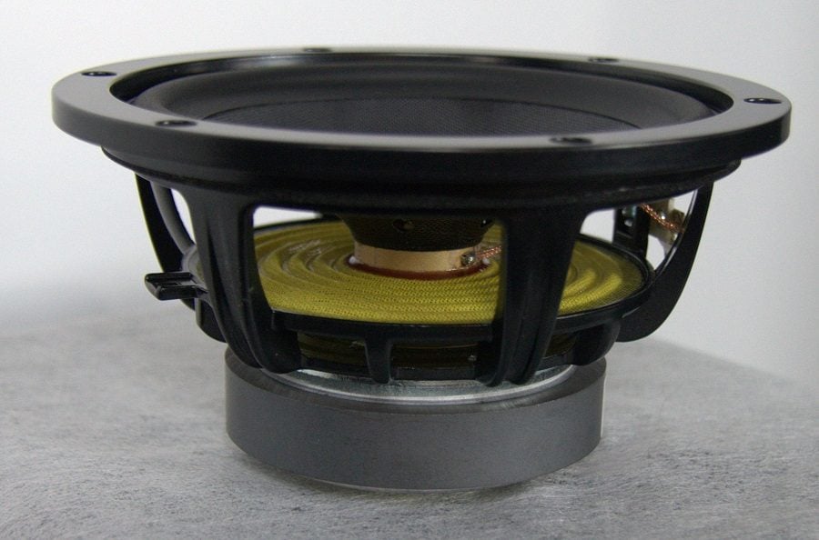

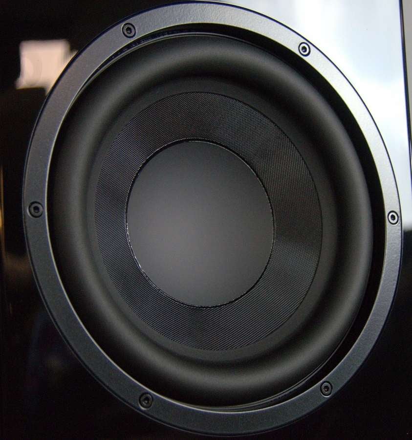

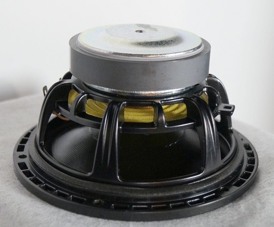

Moving down to the midrange drivers, SVS uses two 5.25” woofers with composite glass-fiber cones. This cone composition has become quite popular in recent years thanks to its combination of high stiffness and low weight. Two 5.25” midrange cones should give the Pinnacle plenty of midrange dynamics and would have the equivalent surface area to a cone of just over 7” diameter. It should also increase the sensitivity as well, so the tweeter does not have to be padded down as much for a linear response.The motor magnet is 9/16” thick with a 3 ⅛” diameter and is mounted to a cast-aluminum basket. The former is made from Kapton, and the backplate is slightly bumped out to give the former a bit more excursion room. Venting is done in the basket frame under the spider.

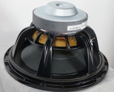

Pinnacle bass cone   Pinnacle Bass driver

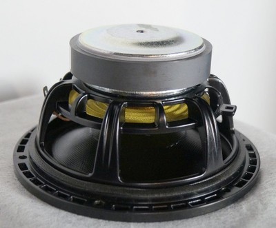

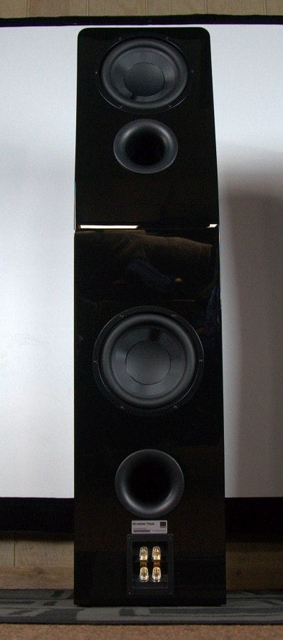

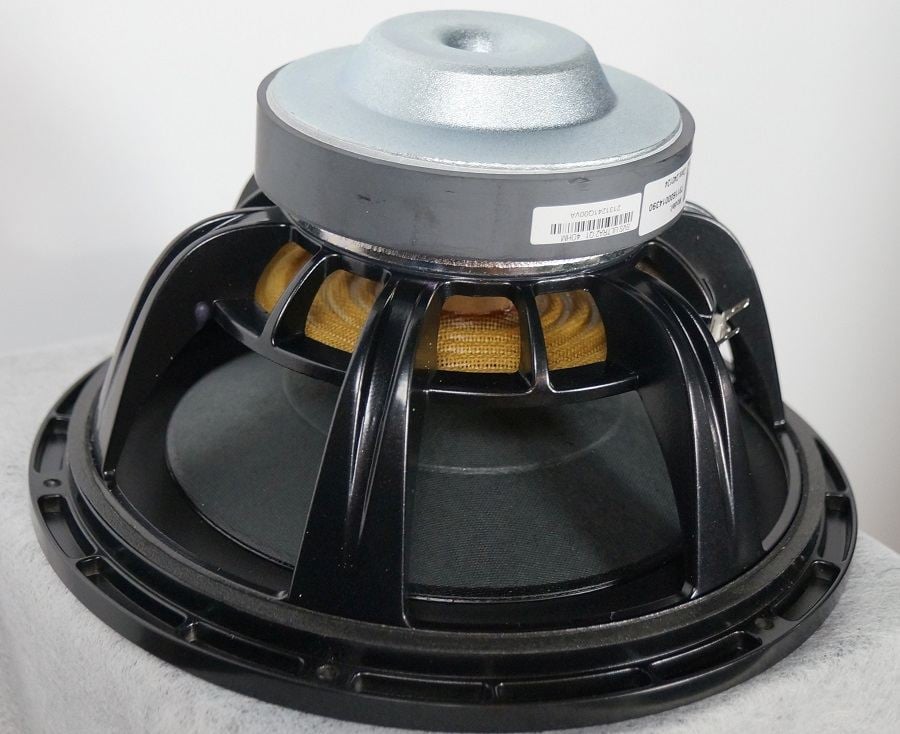

Pinnacle rear3The 8” bass drivers also use composite glass-fiber cones, and there are four of them: two on the front and two on the rear. The rear drivers are mounted in an opposing configuration with respect to the front drivers, and this should go a long way toward canceling out rocking motions caused by their moving assemblies. The bass drivers will have far more moving mass than the midranges or tweeter, so that should make the Pinnacle enclosure quite inert. The bass drivers also use a cast aluminum basket, and venting is done in the frame under the spider and also through the pole piece. The motor uses a 1” thick magnet with a 4 ¼” diameter. It has an aluminum voice coil with a highly bumped-out back plate to enable large excursions. Four 8” cones add up to a lot of surface area and are equal to a 16” cone, so the Ultra Evolution Pinnacle should be capable of some serious low-frequency output if supplied with enough amplification.

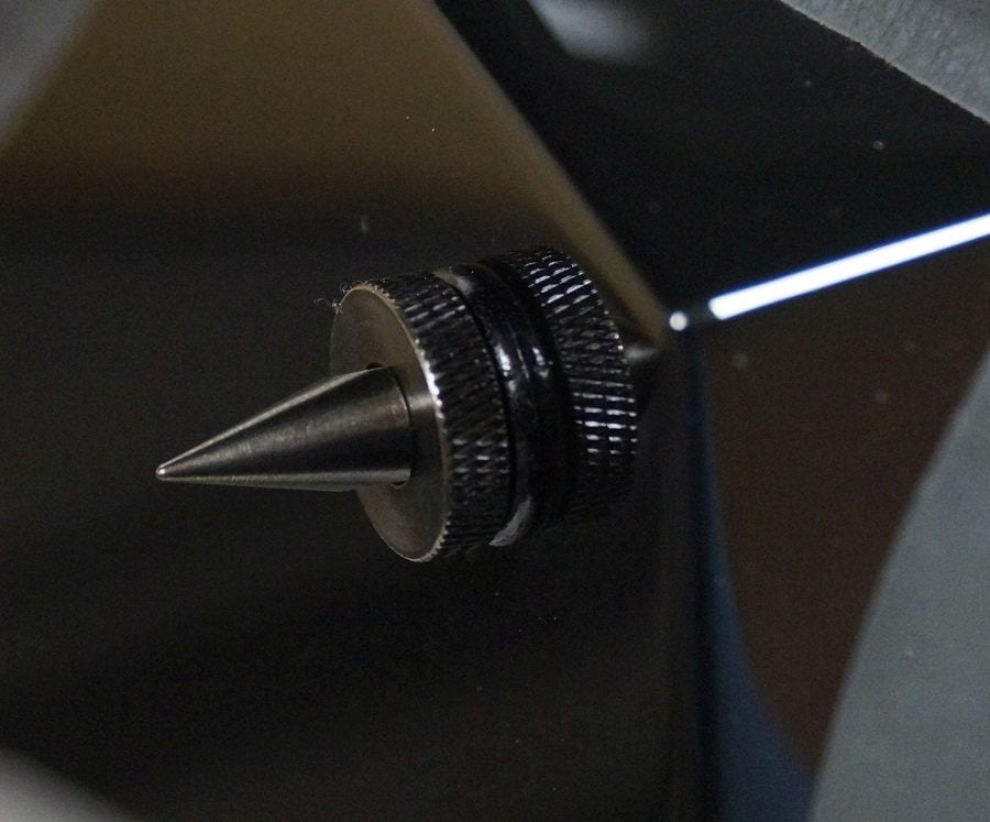

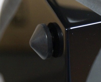

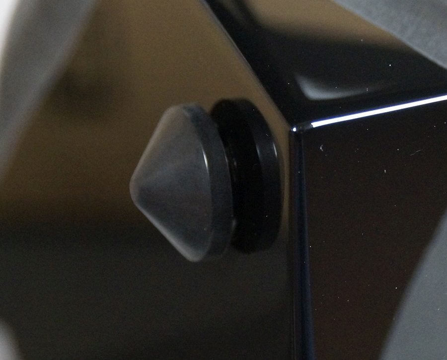

Pinnacle rubber feet      Pinnacle spiked feet
Regarding feet, users have a choice of spiked feed or rubber cones. I do appreciate the choice that SVS gives us here. Spiked feet will give somewhat better footing on carpeted surfaces, but my preference would still be for rubber feet. There is much less chance of toe-impaling with rubber feet. Spiked feet on such a heavy speaker should be handled carefully, and I would avoid their installation if the user has children around. The feet attach directly to the bottom of the speaker. While the stability of the speaker seems good, I would have liked to have seen outriggers used on a 50” tall speaker. Outriggers can give the speakers a wider stance and greater stability.

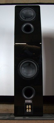

SVS’s marketing leans hard into the acoustic advantages of the cabinet’s shape with the bend on the tweeter and has exclamations about time alignment based on the tweeter’s position. The idea is that the points of acoustic emission, which are usually assumed to be the voice coil, are all lined up so that the wavefront of the speaker is more synchronous versus a typical loudspeaker where the voice coils have different depths relative to the front baffle of the speaker. I'm not convinced that the benefits of this design would lead to a noticeable improvement in sound quality, but Gene is a big proponent of time-aligned speakers, provided they don't compromise other areas of performance. On a technical level, there might be a slight but demonstrable improvement between the midranges and tweeter, if the microphone was placed in a precise position in an anechoic chamber. At the very least, it doesn’t hurt anything, and it does give the speakers a unique and interesting look.
One of the problems with SVS’s claims is that the rear-firing bass drivers take the entire bass section of the speaker out of the conversation for time alignment since they do not share the same voice coil depth as the tweeter, midranges, or front-firing bass drivers. Furthermore, the difference in depth between the tweeter and midranges would amount to much less than a single millisecond, a very small increment of time, and that is assuming the listener is listening with ears right on tweeter height at a far enough distance. And that all ignores the chaos that happens to acoustic phase in a normal domestic room. If SVS were to consider optimizing time alignment further, perhaps they could explore raising the mid/tweeter crossover frequency to a level higher than 1.8kHz. With a crossover frequency set at 1.8kHz, there might be a noticeable phase shift, approximately 180 degrees, right within the heart of the frequency range for human speech. The good news is that it won’t be a big problem if the crossover circuit is well-executed. The bad news is that it contradicts the rationale for the cabinet shape.
Manufacturer’s response to our time-alignment comments:
Time alignment is effective in the direct (un-reflected) field of the speaker.  SVS does not claim to time-align or phase-align the reverberant field of the room, which will naturally vary with the room dimensions, loudspeaker placement and any acoustic treatments in the room.
 In the direct field, above around 100Hz, the SPL output from the front woofers is notably higher than the rear woofers.  Further, by virtue of the psychoacoustic ‘precedence effect’, it is this direct, early, high-level wavefront from the front-firing woofers which dominates the listener’s perceptions of bass imaging, localization and timing.  The rear woofers do not detract from the time-alignment, and they contribute increased SPL, mechanical force-cancelling, and a spatially well-distributed bass array, achieving both ultra-low cabinet vibration and smoother in-room bass response.
 The baffle offset in the Ultra Evolution Pinnacle creates a 13-degree phase-shift at 1800 Hz (between tweeter and midrange), which is not only measurable, but also subjectively significant.  The phase shift (in degrees) at the woofer/mid-range crossover point is obviously less, but time alignment is not just about the crossover phase-relationship – it is also about synchronizing arrival time - introducing a constant delay to better align the pass-band impulse response of the woofers, mid-range drivers and the tweeter.
 The driver array acoustically centers the tweeter, mid-range drivers and woofers in a common point in space, creating a coherent and faithful acoustic image.  We specifically designed our new diamond-coated tweeter for higher power handling and enhanced motor/suspension excursion to allow for a deeper 1800 Hz crossover frequency, which is hugely beneficial in achieving excellent dispersion characteristics, reduced directionality, and a seamless transition to the midrange drivers.  Overall these design elements deliver the many benefits of a triaxial design, without any of its drawbacks.
SBIR Advantages of SVS Bass Alignment
Curiously, while SVS touts the enclosure shape benefits for time-alignment which I believe are of little benefit in practice, they don’t mention a major advantage of the bass driver’s placement for dealing with ‘SBIR’ effects such as ground bounce cancellation which would have a significant benefit in practice. SBIR stands for ‘Speaker Boundary Interference Response,’ and it is cancellation effects when the direct sound of the speaker collides with the reflected sound from nearby surfaces, and the timing difference between those two paths causes phase conflicts that create peaks and nulls in the low-frequency response. It occurs most in lower frequencies, so the placement of the bass drivers has a big impact in this regard, especially from the floor reflection of the bass drivers which is often termed ‘ground-bounce cancellation.’

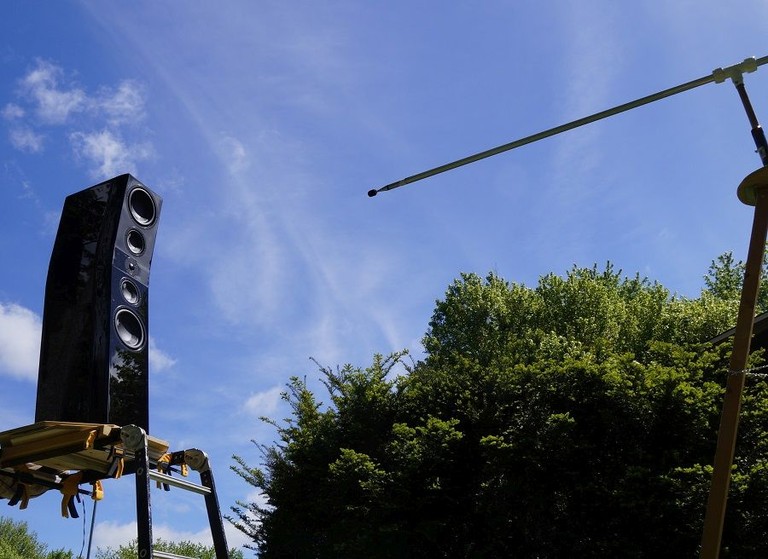

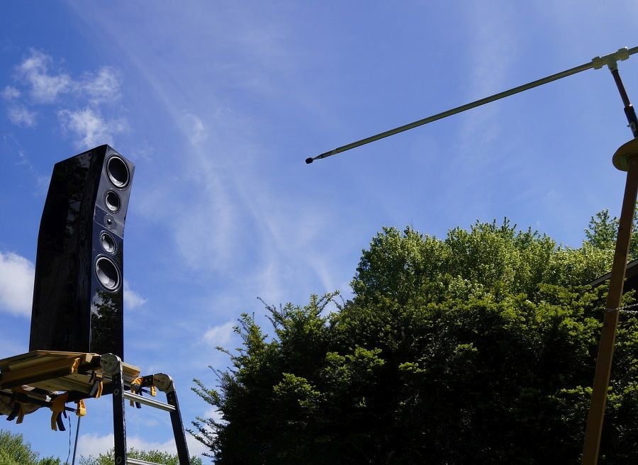

The SVS Ultra Evolution Pinnacles were measured in free-air at a height of 4 feet at a 2-meter distance from the microphone, with the microphone raised to an 8’ elevation that was level with and aimed at the tweeter center. The measurements were gated at 8 milliseconds. In this time window, some resolution is lost below 400 Hz, and accuracy is completely lost below 200 Hz. Measurements have been smoothed at a 1/24 octave resolution.

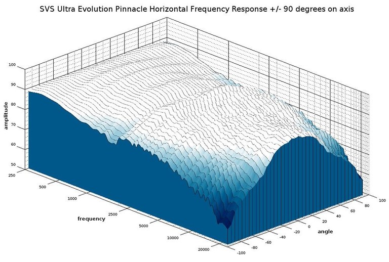

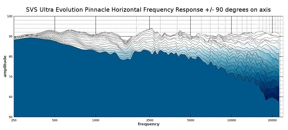

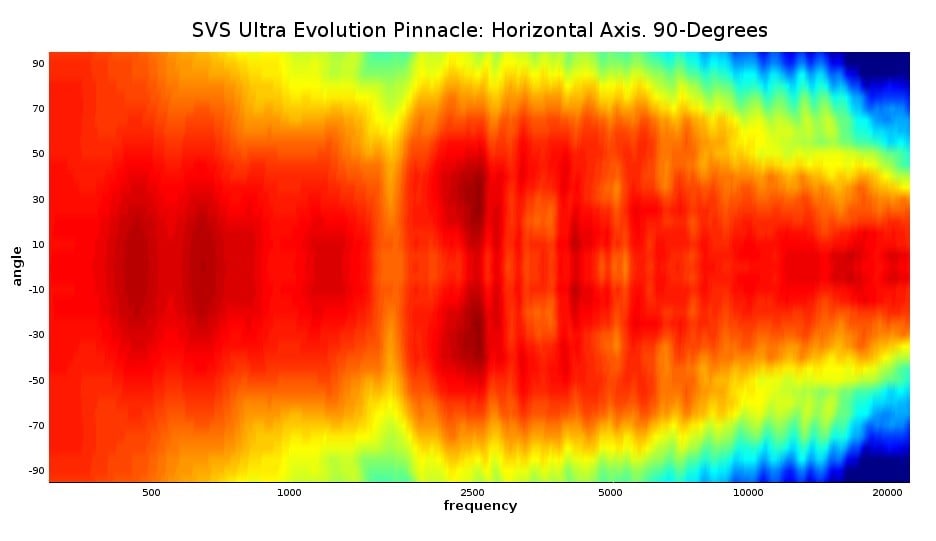

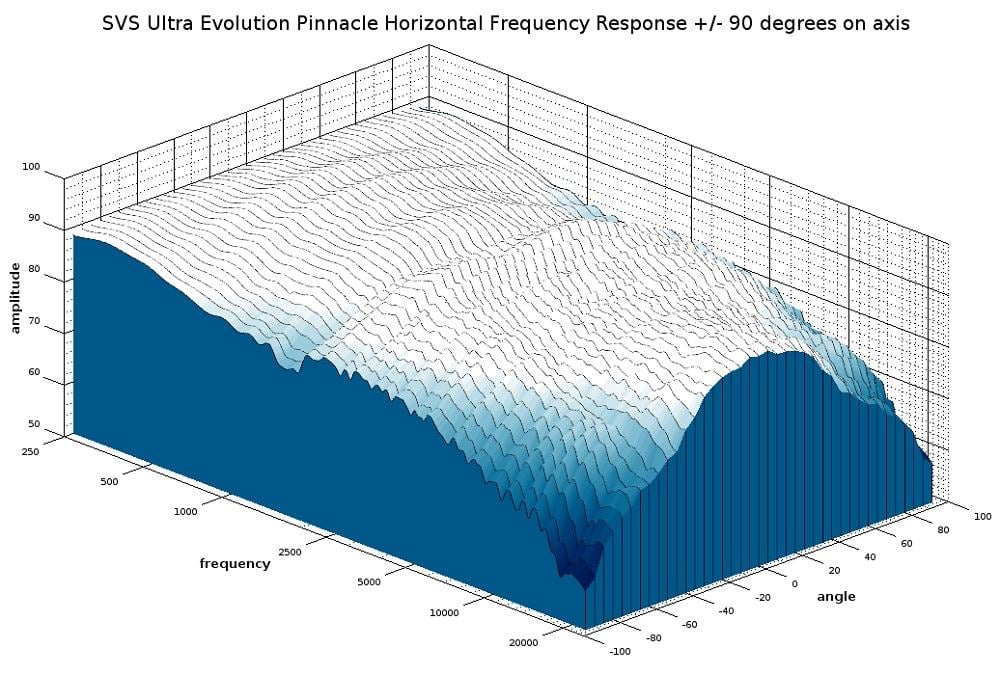

Ultra Evo 2D waterfall response
Ultra Evo 3D waterfall response
The above graphs depict the Ultra Evolution Pinnacle’s direct-axis and horizontal dispersion out to a 90-degree angle in five-degree increments. Information on how to interpret these graphs can be read in this article: Understanding Loudspeaker Review Measurements Part II. The measured results are generally quite good. There is a slight flaw in the form of a dip followed by a peak in the crossover frequency between the tweeter and midranges, but if the angled graph is examined closely, this dip/peak mostly only occurs at off-axis frequencies. It only starts to become pronounced at the 20-degree angle and outward. At and near the on-axis angle, it is scarcely there. If I had to guess the cause, I would say that it is a result of how the tweeter is interacting with the front baffle of the cabinet. The tweeter’s behavior above 3kHz is very good at all angles. The midrange also seems to be well-behaved, although it looks to be voiced a decibel or two more than the tweeter. That might lend a warm sound signature to the overall presentation in comparison to a totally neutral loudspeaker. Outside of the off-axis dip/peak at the tweeter/midrange crossover, the response correlation going from on-axis to off-axis is good. The bottom line of these graphs is that the Ultra Evolution Pinnacles will give the most balanced presentation when toed in to face the listener directly.

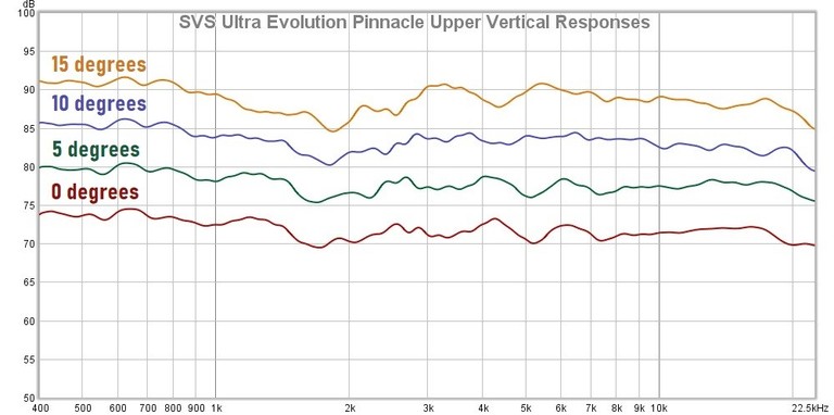

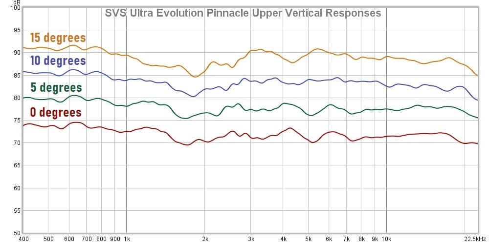

Pinnacle vertical responses
The above graph is a sampling of some of the vertical angle responses at and around the on-axis angle. These are all angles at or above the tweeter axis since few people are likely to listen to the Ultra Evolution Pinnacle at a height lower than the tweeter. The on-axis response presents us with a nicely flat response, save for some elevation of the midrange woofer. The response stays fairly neutral until we get up to the 15-degree angle where the midrange woofers begin to nullify each other’s response through phase conflict. This is expected behavior of this type of design, and the good news is that few people would be listening at such a high angle. Most listeners will be at or below the 10-degree angle unless they are seated very close to the speaker. Some MTM designs can inflict off-axis phase cancellations at much closer angles, and thankfully SVS has kept that problem at bay for any reasonable listening angle. The bottom line of this graph is that as long as the listener isn’t seated at an unusually high angle with respect to the Ultra Evolution Pinnacle, they will be met with a full and balanced sound.

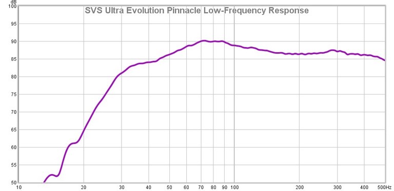

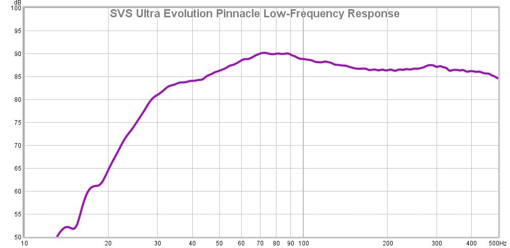

Pinnacle Low Frequency Response
The above graph shows the Ultra Evolution Pinnacle’s low-frequency response captured using groundplane measurements (where the speaker and microphone are on the ground at a 2-meter distance in a wide-open area). We can see that this speaker maintains a strong response down to 30Hz, and in-room that will be even lower. I would guess that most users will have a strong in-room response down to the mid-20s. As I have mentioned earlier: the Ultra Evolution Pinnacles do not need the assistance of a subwoofer. In this graph, we can also see a bump in the response centered at around 75Hz, and this is indeed an audible artifact of the speaker. It isn’t enough to constitute a major coloration of the sound, but it is certainly present as a bit of extra oomph in bass instruments. It is not enough to be intrusive on most recordings, and I think that many listeners will like slightly elevated bass. This extra bass bump combined with the slight elevation of midrange energy will definitely pull the Ultra Evolution Pinnacles back from having an aggressive sound, and they should sound somewhat laidback compared to total neutrality. In other words, this should be a pretty easy speaker to listen to, and those who want a crisper and more forward sound will want to equalize it to raise the treble a bit.
The 75Hz bass bump would probably be lost for those who run auto-EQ calibration programs such as Audyssey or Dirac Live in favor of the program’s target curve, so I think many users will get a more tamed bass response whether they want it or not. Of course, they can always add it back in with tone controls.

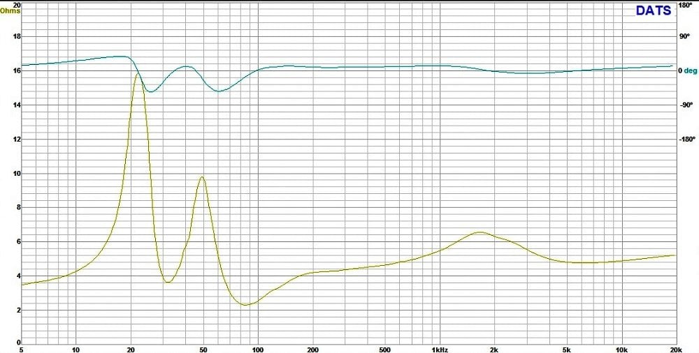

evo pinnacle IMP
The above graph shows the electrical behavior of the Ultra Evolution Pinnacle. The impedance is fairly normal except it does take a brief dip below 3 ohms at around 85Hz. That can be a tough load for cheaper amps, and I wouldn’t try to power this thing with an entry-level AVR (not that anyone paying $5k/pair for speakers will run them with an entry-level AVR). SVS specifies this speaker to be 6 ohms nominal, but with that 85Hz minima, this really should be considered a 4 ohm speaker. I measured the Ultra Evolution Pinnacle’s sensitivity to be 88.9dB at 2.83v for 1 meter which is a tad better than SVS’s spec of 88dB. That is not an unusual sensitivity for this type of loudspeaker, although I am a bit surprised it isn’t higher given how large it is. Still, 88.9dB sensitivity isn’t bad, and this speaker doesn’t need tons of wattage to get loud.
