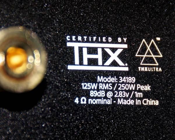

Many people think that THX certification is simply a stamp of approval for a certain level of performance, but there is more to it than that. THX is intended to encompass the entirety of a listening/viewing experience, and the certification is a mark that the component will behave in a way that fits in with a THX environment. You can have a multitude of THX-certified components without having a THX-certified system or a THX-level experience, so an individual component such as a loudspeaker or amplifier is just one piece of that puzzle. The performance targets of a THX-certified speaker means that it will behave in a very predictable manner when installed in a THX system, and the whole experience will add up to what the artists intended. It’s a way of ensuring that you are experiencing what you are supposed to experience and eliminating variables that impede the intended experience.
That being said, even when not installed in a THX environment, THX certification is still a desirable attribute, in that you know you will be getting fairly accurate sound or video reproduction equipment. That is one of the aspects of the Monolith THX-365T and THX-365C that we will be looking at. What is the level of accuracy needed to secure THX certification? What are the performance metrics needed to acquire this piece of the THX puzzle? In other words, how good does a loudspeaker have to be for a THX experience?

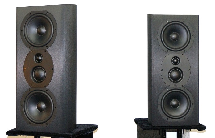

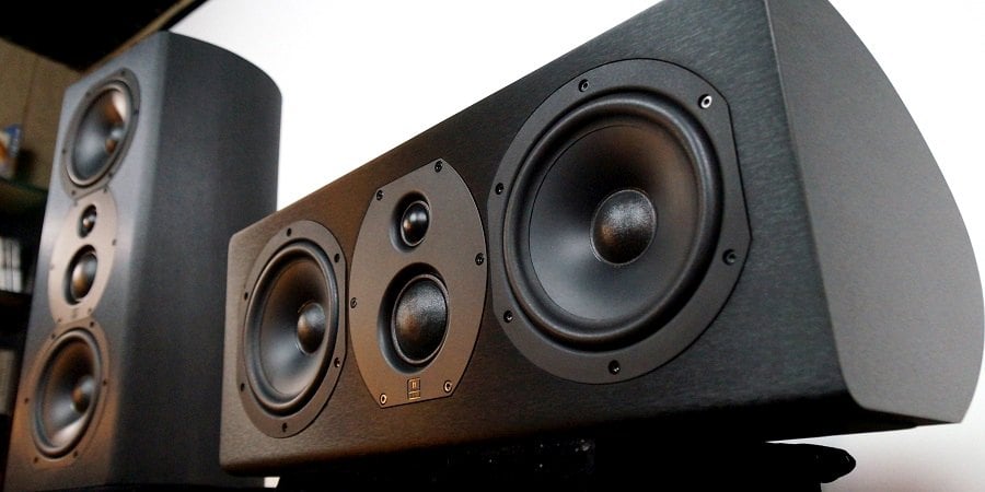

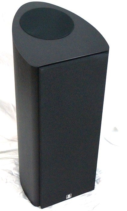

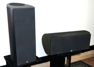

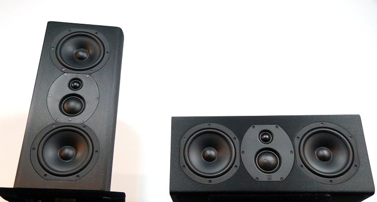

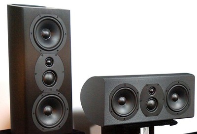

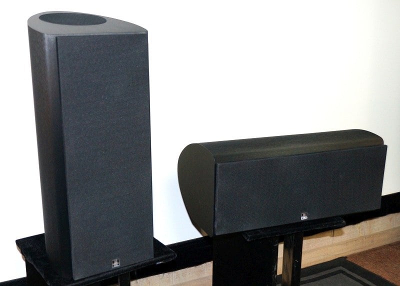

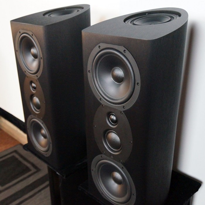

Once out of the packing, THX-365T and THX-365C speakers proved to have a rather elegant shape. They have a rounded cabinet that tapers off toward the rear. The angled top of the THX-365T is reminiscent of the speaker design from Sonus Faber, but Monoprice uses this shape for a far more practical reason; there is an embedded Dolby Atmos speaker at the top of the speaker, and the angled cabinet aims it such that ceiling reflections would be heard as Atmos ‘height’ channels. We will dig a little more into that in the design overview section of this review. The finish is a slick, semi-wood grain textured vinyl wrap that is sleek yet does not allow fingerprints to stand out. It’s a nice looking finish even though it is probably a low-cost one; I have seen it used on other budget speakers before.
With the grilles on, the Monolith THX speakers are inoffensive but indistinct rounded enclosures. With the grilles removed, the speakers have a lot more character with the drivers exposed, and I think they look better. The dustcaps of the woofers and domes of the midranges and tweeters have a satiny, slightly glittery texture that gives them a subtle but noticeable distinction against the flat black of the driver frames. These are large speakers, but one aspect about them that softens their appearance is that there are few hard edges anywhere on them. It’s all circles and rounded organic shapes. This is in contrast to the Monolith THX subwoofers that have a more mechanical and angular masculine aesthetic. The Monolith THX speakers look much more refined than the Monolith THX subs.
Like the Monolith THX subs, these particular Monolith THX speakers are rather large. Monoprice calls the THX-365T a ‘mini-tower,’ but in reality, it’s just a large bookshelf speaker. That isn’t to undersell what it is, but it will be used in the same way as bookshelf speakers are, so there is no need for a new speaker type classification, in my opinion. Their large size might make them a non-starter for those looking for unobtrusive speakers, but their stylish design goes a long way toward making them ingratiating in a home setting. Speakers with the performance goals that the Monolith THX speakers have cannot really be placed in a small package, so anyone who wants THX Ultra certification has to be prepared to find a place for largish bookshelf speakers. Personally, I think they look very nice. Their size may preclude them from finding a place in a finely decorated living room, and they don’t have a luxury-class finish, but they shouldn’t be a problem in a family room, media room, office, or especially a home theater room.
Design Overview

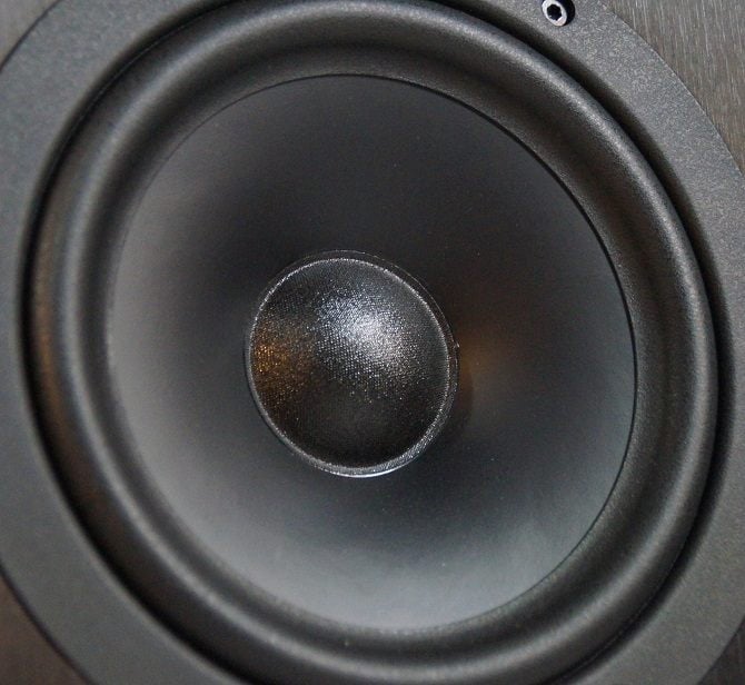

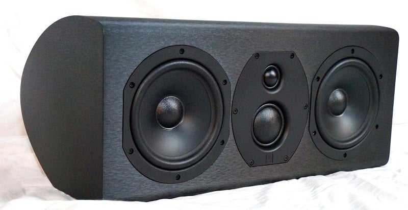

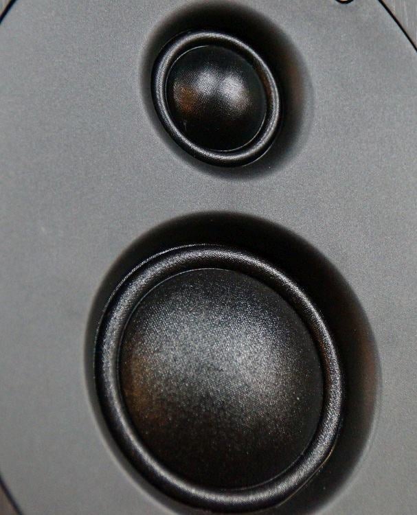

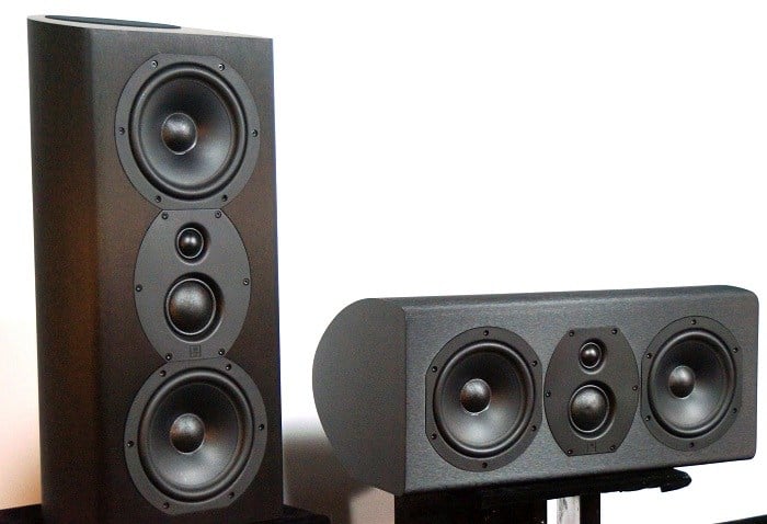

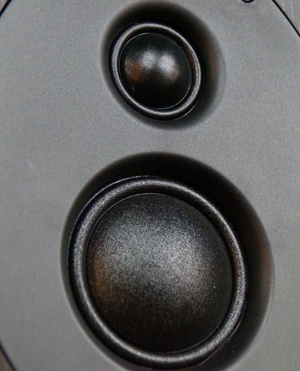

The Monolith THX-365T and THX-365C are both rather heavy-duty three-way bookshelf speakers and center channel speakers. Both of them are THX Ultra certified, and that means they should be able to achieve THX Reference level loudness at a distance of 12 feet within a 3,000 cubic foot room, so they do need to be very capable speakers. The specs are on their side toward this end, however. They use two 6.5” bass drivers, a 2” midrange dome, and a 1” dome tweeter. Furthermore, the THX-365Ts have an Atmos speaker installed at the top, which gives them two channels of speaker in one cabinet. One thing I found is that the midrange driver is rather vulnerable. It uses a silk dome that is very soft and can easily be damaged by kids and rambunctious guests and pets. The speakers should be used with caution around pets and people who are not careful. Leave the grilles on in those instances.
The 6.5” woofers use long-fiber pulp cones in stamped steel baskets with some chunky ¾” x 4” magnets in the motor. The midrange and tweeter use silk domes and are each housed in their own enclosed space in a plastic enclosure. The structure of the midrange is much more like that of a traditional dome tweeter on a larger scale rather than a usual midrange cone. All of the drivers use shorting rings which reduce even-order distortion as well as extending their operational bandwidth. The drivers are crossed over at 550 Hz and 1.9 kHz using fourth-order slopes. The choice of a 1.9 kHz crossover seems like an unusually low crossover for a three-way speaker. While midrange driver can certainly handle higher frequencies than 1.9 kHz, I am told by the speakers’ designer that the crossover frequencies were chosen because they added up the the best performance overall when looking at on and off-axis response and distortion performance. Altogether the quality and quantity of drivers on the Monolith THX speakers seem to be unexpectedly good considering the pricing.

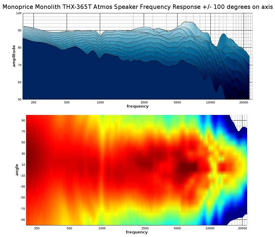

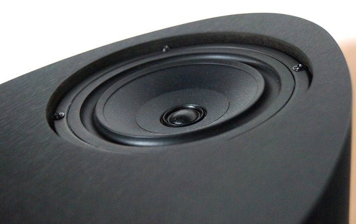

The Atmos Driver
The
Atmos driver in the THX-365T is a coaxial driver that uses a 5.25” pulp fiber
woofer with a 0.6” silk dome tweeter mounted in the center of the woofer cone.
It’s internal cabinet space is closed off from the rest of the internal speaker
space, so it has its own sub-enclosure. It uses a third-order crossover at 3.8
kHz. I would expect the reason for such a higher crossover is to have a
narrower directivity. Wide dispersion sound probably isn’t a great idea for an
Atmos-module type speaker since the listener should only be hearing reflected
sound from the speaker and not direct sound. For those who don’t know, Atmos
speakers try to simulate sound coming from above by bouncing sound off of the
ceiling that hits the listener instead of just projecting sound directly to the
listener. The wider the dispersion of the speaker, the more direct sound that
will hit the listener instead of direct sound. If the listener hears too much
direct sound coming from the Atmos speaker, that would create a mess out of the
intended Atmos effect. For this reason, listeners using the Atmos module should
listen to this speaker with ears level with or below the tweeter. The higher
the listener is in elevation with respect to this speaker, the more sound they
will hear directly from the Atmos driver which will degrade the intended
effect.

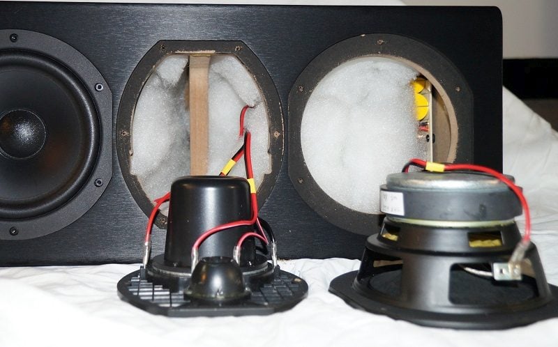

The
cabinet uses ¾” high-density fiberboard (HDF) paneling all around. Most
speakers in this class use MDF instead of HDF. The advantage of HDF in speaker
construction is that it will be less resistant to moisture effects than MDF and
is a stiffer, denser material. The disadvantage is that is doesn’t damp
acoustic resonances as well. The curvature of the cabinet should help to reduce
internal standing waves which will help to eliminate resonances. There is also
a window brace in the middle of the cabinets which will help to keep the panels
inert. The cabinet is filled with stuffing which will help damp internal
acoustic energy. The THX-365T uses some small rubber dimples as feet, and the

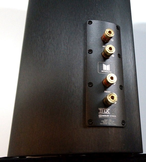

THX-365C center speaker uses a flat rubber mat. Both use five-way binding posts
that protrude from a rear-mounted plate.
Both speakers use sealed designs so there are no ports Sealed designs are preferred by THX (although not required) in order to achieve the 12dB/octave slope needed for a THX speaker/subwoofer crossover, because a sealed design has a natural 12dB/octave slope low-end rolloff that is much more difficult to achieve in a ported design, and a sealed design has a much more predictable phase response. Given that THX specifies an 80 Hz crossover, I wouldn’t expect the Monolith THX speakers to have very much bass output below that point. These speakers are intended to be used with subwoofers, and I would expect the low-end rolloff to occur around 80 Hz.

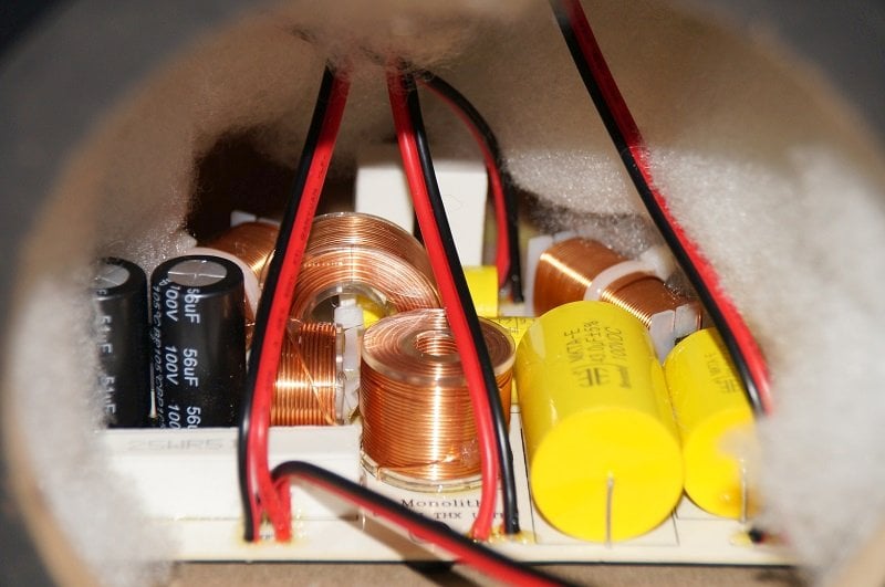

The Monolith THX speakers use an 11-element crossover with some reasonably solid-looking components. Taking a peek at the crossover for the regular non-Atmos part of the speaker, we see two iron core inductors, three air-core inductors, two electrolytic capacitors, four film capacitors, and three largish resistors. Monoprice’s crossover spec claims fourth-order slopes, and the plethora of crossover elements plus the acoustically sealed drivers should be able to add up to such steep filters.
There is a lot that I like about the design of the Monolith THX speakers. One thing is the arrangement of the tweeter and midrange on the center speaker. By relegating only the bass drivers to horizontal alignment, this center speaker should be mostly free of the off-axis lobing that occurs with traditional ‘MTM’ center speaker design which simply places a tweeter between two woofers (the problems with that design approach can be read about in our article detailing the difference between horizontal vs vertical speaker designs and in our article about center channel design considerations. I like the three-way design of the THX-365T speakers; that can do a better job of controlling directivity and it should have a wider dynamic range with better power-handling versus an ordinary two-way bookshelf speaker. I like the idea of putting dual woofers in the THX-365Ts, and furthermore, the placement of the second woofer above the tweeter; this placement pushes the Atmos speaker above the ear height which should help to keep all of that sound as acoustic reflections where they belong. Spacing the woofers apart helps to mitigate ground-bounce cancellation a bit as well, and it does better at keeping the acoustic center of the speaker squarely around the tweeter and midrange where it should be. All in all, the THX-365T and THX-365C are a lot of speaker for the money. But are they too good to be true for the price? Let’s take a listen to hear what they can do...

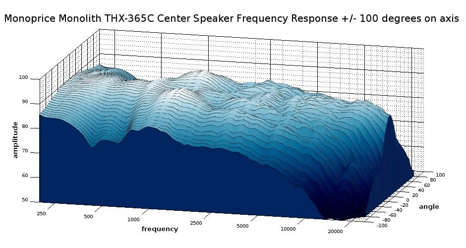

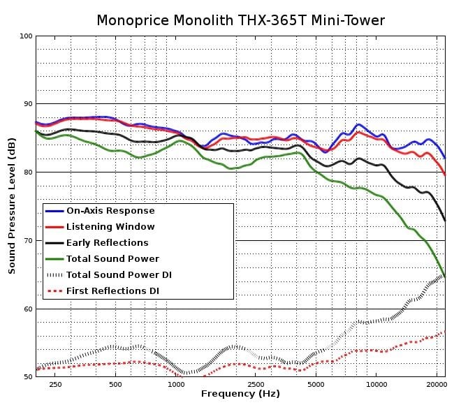

Monoprice Monolith THX-365T and THX-365C Measurements & Conclusion

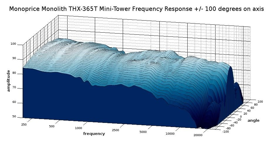

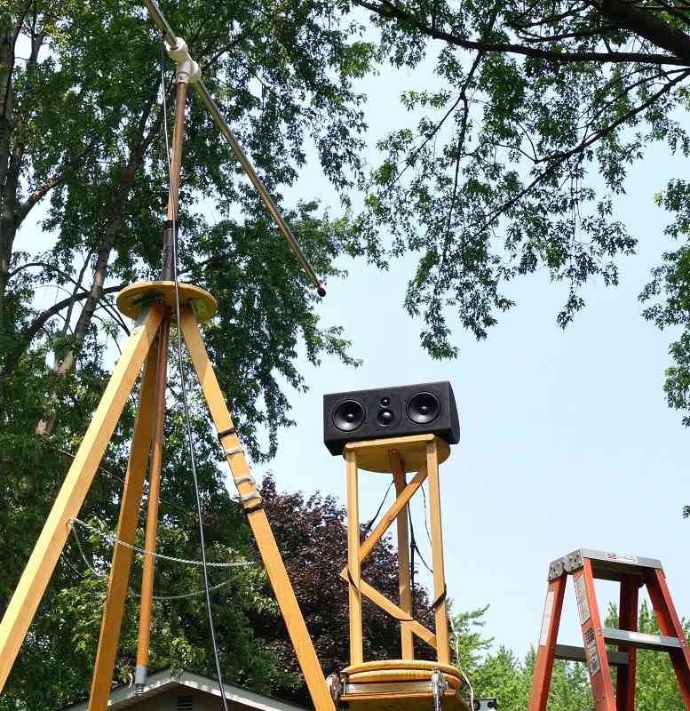

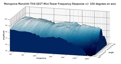

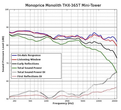

The Monoprice Monolith THX speakers were measured in free-air at a height of 7.5 feet at a 2-meter distance from the microphone, and the measurements were gated at a 9-millisecond delay. In this time window, some resolution is lost below 250 Hz and accuracy is completely lost below 110 Hz. Measurements have been smoothed at a 1/12 octave resolution.
Outdoor Measurement Platform with Monolith THX-365C Speaker

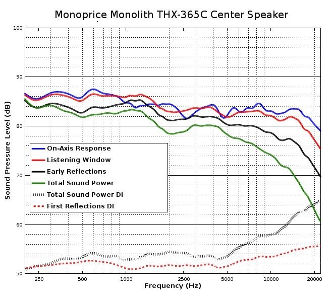

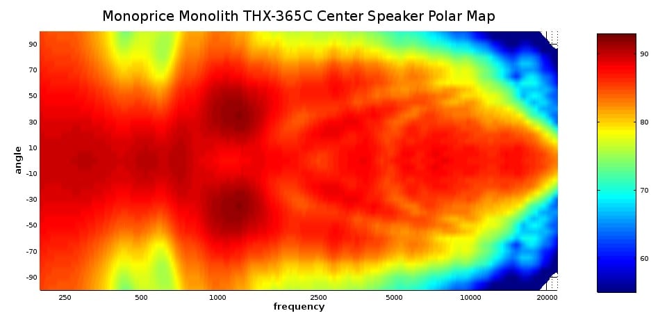

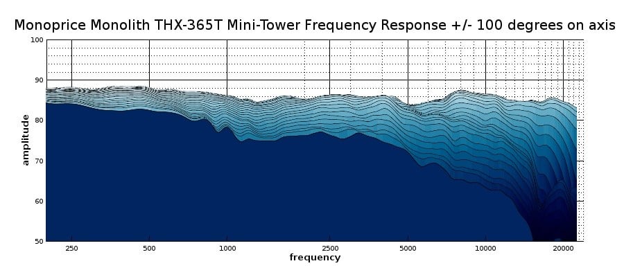

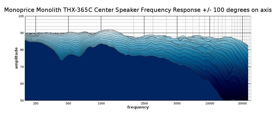

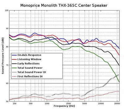

The above graph shows the direct-axis frequency response and other curves that describe the speakers’ amplitude response in a number of ways. For more information about the meaning of these curves, please refer to our article Understanding Loudspeaker Measurements Part 1. While the responses that I measured don’t exactly match the responses that are seen on the product pages for these speakers, they are nonetheless good overall. The responses are fairly neutral, but they do have a very slight downward slope; that will be their chief audible distinction from perfect neutrality. The THX-365T Mini-Towers do have a minor peak centered around 9 kHz, but that won’t be very audible. These speakers may have a slightly warm or laid back sound compared to many other speakers because there is a bit more energy in the woofer and midrange dome bands than the tweeter’s band. We can see that these are both relatively wide dispersion loudspeakers because the early reflections curve tracks the on-axis response and listening window response very closely until upper treble frequencies. This can also be seen in the directivity indexes; the dispersion of these speakers will begin to narrow above 5 kHz. For the most part, however, both speakers provide a very good response and should sound great to most ears except maybe for those listeners who are looking for a bright sound.
The above graphs depict the Monolith THX speakers’ lateral responses out to 100 degrees in five-degree increments. More information about how to interpret these graphs can be read in this article: Understanding Loudspeaker Review Measurements Part II. Once again, we see how well behaved these speakers are, but these graphs show us how well the horizontal off-axis response correlates with the on-axis response in greater detail. As the directivity indexes suggested, these speakers hold a nicely uniform axial response up to 5 kHz where the tweeter does roll-off quite a bit more at farther off-axis angles. We do see a slight amount of off-axis cancellation from the woofers in the center speaker, but it is extremely mild compared to what occurs in most two-way center speakers. This response from this center speaker is very good and places it among the best center speakers we have measured to date.

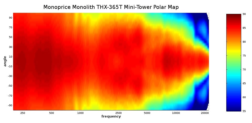

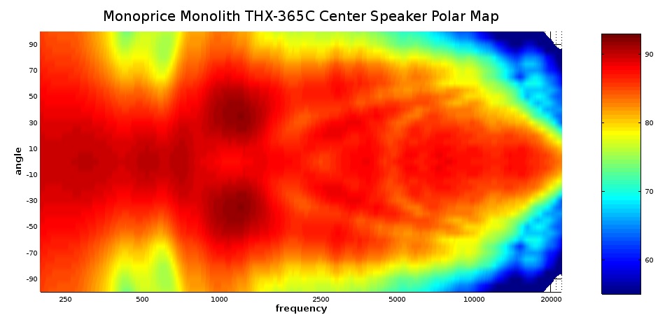

The above polar map graphs show the same information that the preceding graphs do but depict it in a way that can offer new insight regarding these speakers’ behavior. Instead of using individual raised lines to illustrate amplitude, these polar maps use color to portray amplitude and this allows the use of a purely angle/frequency axis perspective. The advantage of these graphs is they can let us see broader trends of the speaker’s behavior more easily. For more information about the meaning of these graphs, we again refer the reader to Understanding Loudspeaker Review Measurements Part II. In these graphs, we can better see the breadth of dispersion of the Monolith THX speakers. Again, we see a very wide dispersion pattern out to 80-degrees that extends up to 5 kHz, but here we also get a better look at the width of dispersion at the top end of the treble response. Listening is best done within a 30-degree angle from the front axis, but that is pretty much within the range of most people’s normal listening positions anyway. There are some directivity mismatching issues with the center speaker at around 1.5 kHz and below that are inevitable byproducts of aligning two woofers on a horizontal plane but then spacing them apart, but it is mild in this design compared to most other center speakers.

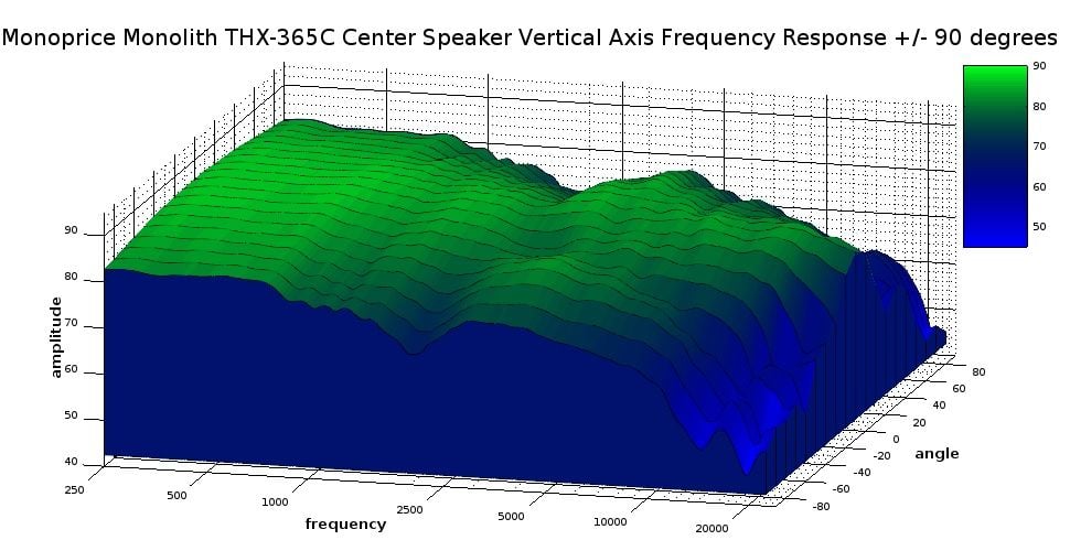

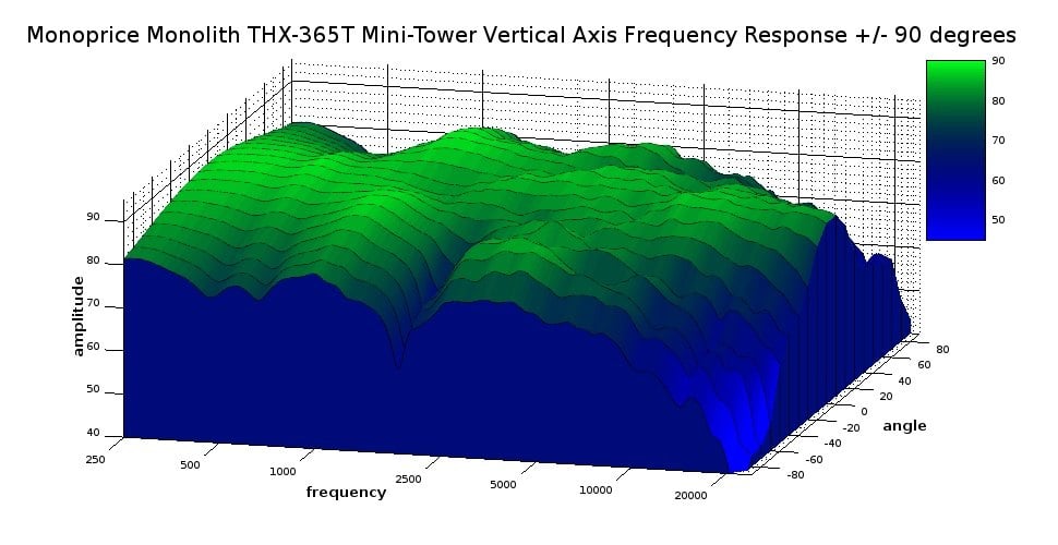

The above graph shows the Monolith THX speakers’ response behavior along its vertical axis where zero degrees is directly in front of the tweeter, negative degree values are below the tweeter, and positive degree values are above the tweeter. It should be said here that the vertical response isn’t nearly as critical as the horizontal response, so an imperfect vertical dispersion is much less of a problem. The responses seen here are unusually good for this type of speaker. There are lobing nulls caused by conflicting drivers off-axis, but they are very moderate compared to what is normally seen. These speakers actually have a relatively wide vertical angle off-axis where no severe nulls occur. They will probably never be listened to at an odd vertical angle, but it doesn’t hurt to have a good off-axis vertical response due to the consistency in sound from the acoustic reflections from the floor and ceiling.

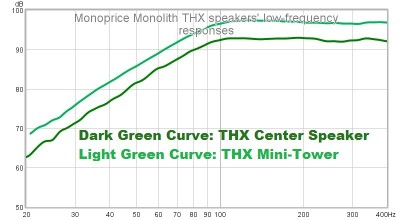

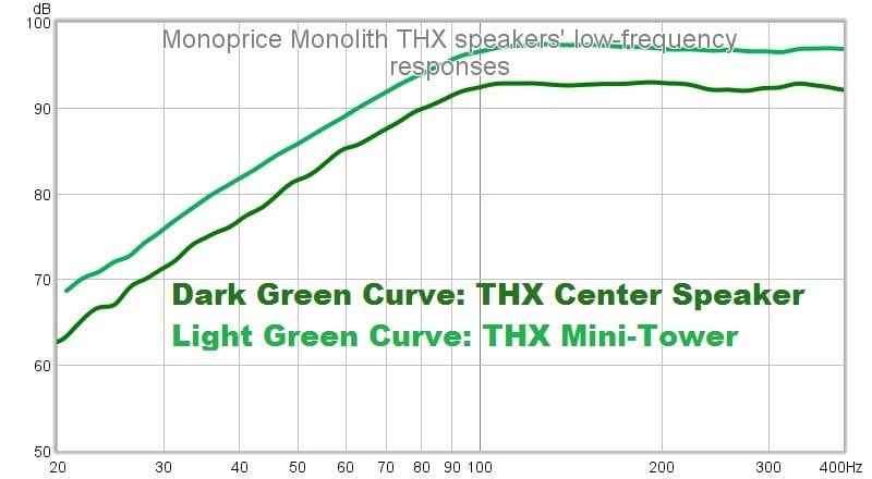

The above graphs show the Monolith THX speakers’ low-frequency responses that I captured using groundplane measurements (where the speaker and microphone are on the ground in a wide-open area). While I included the responses of both the Mini-Tower and Center Channel Speaker, I didn’t need to since they both measure almost exactly the same. That is not surprising given the similarities in design for low-frequency output. The low end here is pretty much textbook THX bass response with a 12 dB/octave roll-off occurring just above 80 Hz. As was mentioned before, the sealed enclosure provides for a much more predictable phase response in this region which makes it a lot easier for a THX processor to blend the subwoofer with the speakers at the crossover. The bass response here is beautifully flat out to 400 Hz. This speaker is behaving exactly how one would hope for and expect in this range.

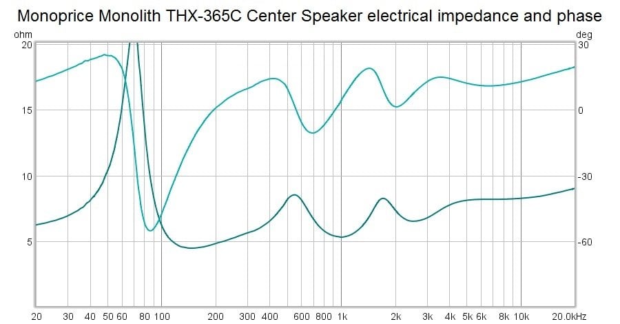

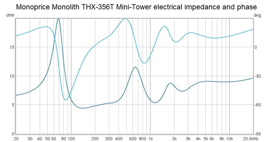

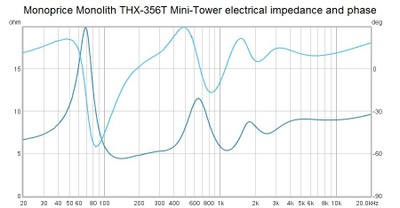

The above graphs show the electrical behavior of the Monolith THX speakers. Again, there is not much point in posting both graphs since they are so similar, but we have done so any way to demonstrate their similarity. Monoprice specs these as 4-ohm speakers, and in that they are correct. The impedance never dips down below 4 ohms, but the steep phase angle at the impedance minima between 100 Hz and 200 Hz may be a tough load for cheaper amps. Budget amplifiers should be OK with this load if it isn’t played loud, but who buys THX speakers to only be played at soft volumes? Outside of a small but important frequency band between 100 Hz and 200 Hz, the electrical load is fairly easygoing. I wouldn’t task an entry-level AVR amp with running these speakers, but a mid-level AVR should be OK.
I measured both the Center Speaker and the Mini-Tower’s sensitivity at 91.0 dB for 2.82v at 1 meter. That is certainly an above-average sensitivity for a bookshelf speaker but not so surprising for large and powerful speakers such as these. While the lower impedance does play a role in that, this higher sensitivity will help alleviate the electrical load that these place on amplifiers. These are relatively sensitive speakers and don’t need a lot of electrical power to get loud.
Atmos Speaker Measurements
For those who are curious about the performance of the Atmos speaker, the above image contains a couple of measurements to give an idea about their behavior. These were taken with microphone at a 1-meter distance and cover the vertical axis, but with a coaxial driver like this, the horizontal axis measurements should be very similar. We see a surprisingly well-controlled on and off-axis response out to 5 kHz. The on-axis response does get a bit peakish from 6 kHz to 7 kHz, although the off-axis response holds pretty steady out to 8 kHz. The lack of upper treble is not likely a serious issue here since this speaker banks on reflected sound, and high treble would get the most severely attenuated by reflections anyway. The electrical impedance measurements didn’t contain anything worrisome, and sensitivity was measured at 87.9 dB at 1 meter for 2.83v, which is fine.
Editorial Note On Atmos-enabled Speaker Frequency Response
The Dolby Atmos-enabled speaker is supposed to employ a complex 7-element crossover network to shape its response using a HRTF to enhance the height effect. The peakiness in frequency response noted in the measurements may be a deliberate design attempt to accomplish this goal. Research has found this may NOT be necessary since each individual has their own unique HRTF response and artificially mimicking this in a loudspeaker design can be hit or miss as a result.
For more information, see: Are HRTF really necessary in Dolby Atmos Speakers?
One possible concern that a response like this could cause is that it is a relatively wide dispersion response. The problem is one we mentioned before; in a top-mounted Atmos speaker, the listener ideally shouldn’t be hearing any sound directly from this speaker. The sound heard from this channel should only be arriving at the listener as an acoustic reflection from the ceiling, but, with such a wide dispersion pattern, if the listener is at a slightly high listening angle with respect to the speaker, they could be hearing a significant amount of direct sound from the Atmos speaker which could ruin the intended effect of sound coming from above. To ensure that this doesn’t happen, make sure that the listener’s ear height is below the top front edge of the cabinet. Ideally, the listener’s ears should be level at a height somewhere around the tweeter’s or midrange driver’s elevation. If used at the correct height, the measurements here indicate that this speaker should be able to do its job well as an Atmos height speaker that uses reflections within the limits of such designs.

Another disadvantage might be their lack of low bass output. However, their low-end response is a deliberate design goal of these speakers, and they would not work as well otherwise. Besides that, if they did have a deeper bass response, that would lower their sensitivity which is not a trade-off worth making for high dynamic range speakers that are intended to be used with subs. So again, this isn’t a criticism so much as it is a notice for those who are looking to their speakers to handle full-range sound: these are not the speakers for that application.
