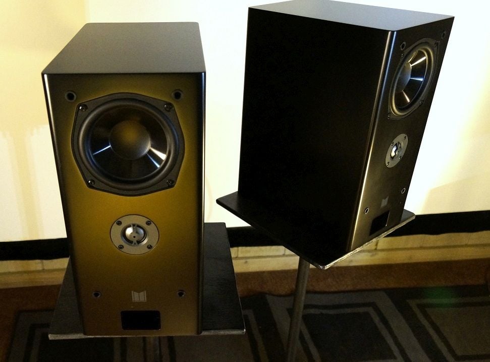

In the world of home audio, Monoprice has established a reputation of providing low-cost electronics accessories such as cables, wall mounts, adapters, and so on. However, with the launch of their Monolith series of higher-end home theater gear at the 2016 CEDIA Expo, Monoprice looks to be trying to break away from their reputation as merely a source for very low cost products and instead become a destination for high-performance speakers and amplifiers as well. We acquired a pair of their new Monolith K-BᾹS bookshelf speakers for review, and now we'll see how serious Monoprice is about making headway into the realm of hi-fi speakers.
Appearance

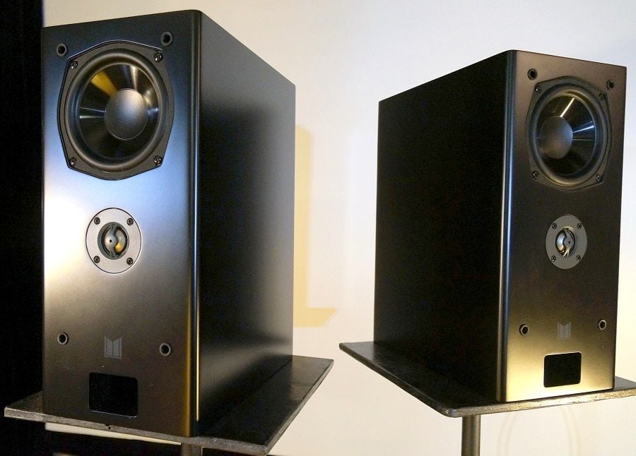

The K-BᾹS speakers arrived sensibly packed with a large stiff foam blocks on the top and bottom of the speakers. The speakers were covered with a soft plastic bag to protect it from moisture and scuffs. Unpacking revealed a tall but narrow black speaker with a nice satin black finish and rounded edges. With the grille on, the K-BᾹS looks rather plain: just a black box. Removing the grille certainly gives this speaker more personality, as the woofer, tweeter, and Monolith emblem are unmasked. There isn’t much more to say here; overall the appearance is not bad at all, if not exactly dazzling. They look like a pretty typical bookshelf speaker. They don’t have a lot of pizzazz, but they are polite and clean-cut.

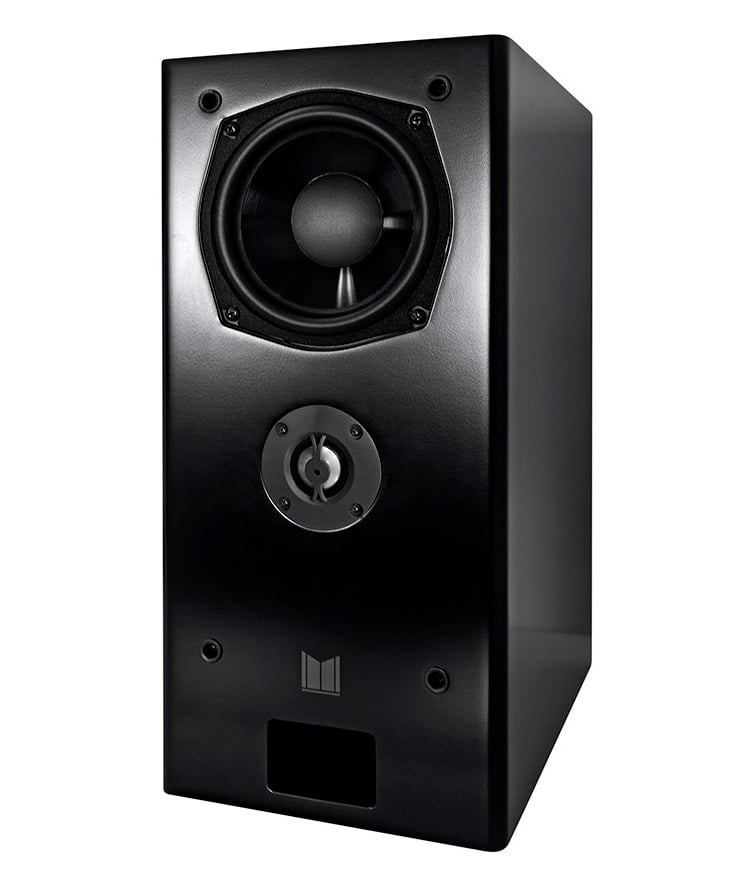

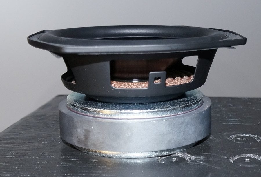

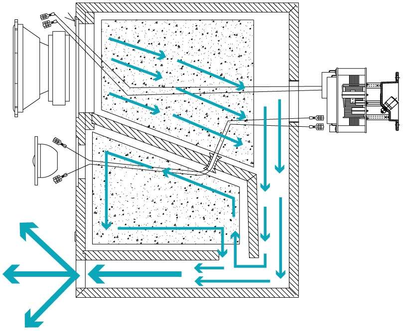

K-BASsystemC.jpgHere is where things get a bit more interesting. Monoprice claims a frequency response of 39 Hz to 20 kHz in a +/- 2.2 dB window. Now, a lot of manufacturers make bass extension claims that just aren’t plausible, especially for bookshelf speakers, and, given the bass specs of a speaker like this (a 5.25” polypropylene woofer) I would not believe a response like that on the face of it, but this frequency response window is strangely specific. What’s more, the K-BᾹS sports a design that could, in theory, reach very low for its size. The K-BᾹS uses a patented inverse horn design from speaker designer Phil Clements, which is a special enclosure design that allows relatively small cabinets and drivers reach much deeper frequencies than is typical for their size. Atlantic Technology speakers also uses same design in their H-PAS speaker, so it is no coincidence that the K-BᾹS speakers bear a strong resemblance to some of the Atlantic Technology speakers.

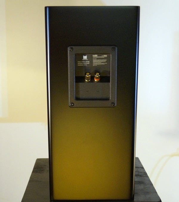

Within the cabinet, the backwave pressure caused by the rear-facing side of the cone get squeezed through a progressively smaller space as it travels toward the port. This squeezing increases air pressure as the pressure waves move through the cabinet. The pressure waves also pass by a chamber that acts as a Helmholtz Resonator. Helmholtz Resonance is the physical principle behind the phenomena where, when you blow air over the top of a bottle or jug, a distinct sound is produced, and it is how ports produce sound on conventional bass reflex speaker designs. The heightened flow of pressure waves amplify the sound produced by the Helmholtz Resonance in the K-BᾹS enclosure. Furthermore, the chamber by which the Helmholtz Resonance is created is heavily damped with Dacron, which helps to filter out harmonic distortions that might have developed from previous chambers. By the time the pressure waves exit the port on the K-BᾹS, they have been increased in amplitude and lowered in frequency, so the system can produce deep bass very efficiently.

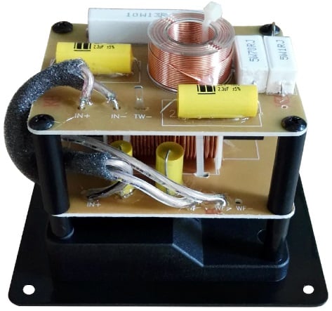

For those of you who made it through that last paragraph, coMonolithcrossover.jpgngratulations; you are well on your way to a degree in acoustic science! Everyone else can just take away the idea that the flow of sound waves within the cabinet are carefully controlled to optimize low frequency efficiency and extension, so this bookshelf speaker might actually be capable of its claimed low-frequency extension. The high frequencies are taken care of by a 1” ferrofluid-cooled titanium dome tweeter. The 5.25” woofer has a beefy motor that is needed to push the rear pressure waves through the various chambers. For a design like this to work best, the woofer needs some “working” distance in the interior of the cabinet from the port, so the tweeter is positioned below the woofer. The tweeter and woofer are given separate printed circuit boards on the crossover in an effort to reduce crosstalk. The crossover chokes are wound using large diameter wire, which Monoprice claims will enable these components to resist adding any coloration to the signal. The crossover uses low-loss polyester capacitors and inductors with the “highest grade” core material for 1st-order low pass and 2nd-order high pass signal separation between the drivers at 3 kHz.

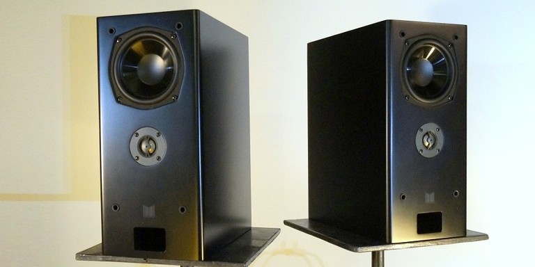

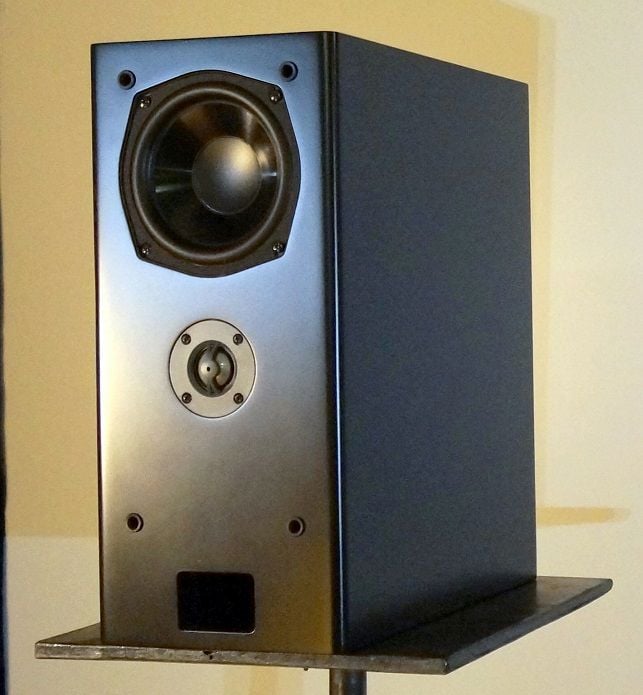

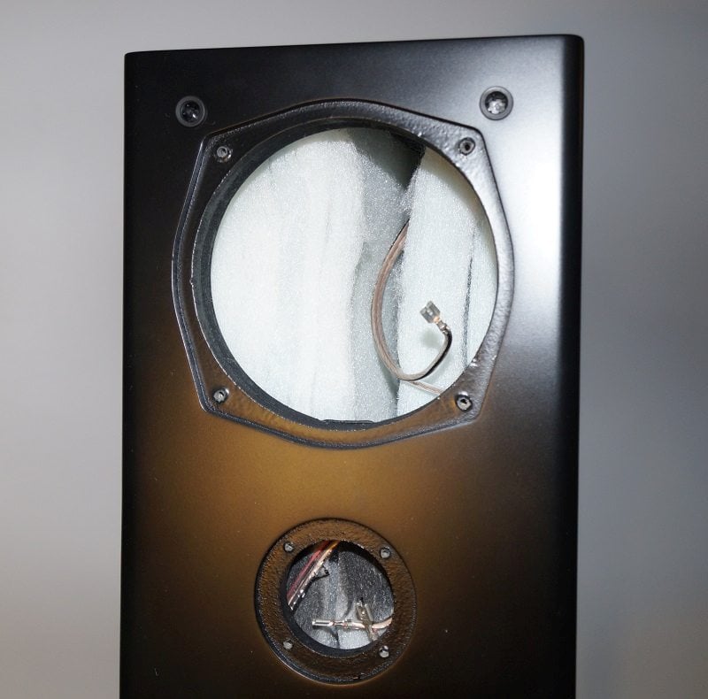

The cabinet itself is relatively sturdy, with a ¾” thick front baffle and ½” thick sidewalls. The interior chamber paneling does serve very effective double-duty as bracing to reduce cabinet resonance. The cabinet is generously stuffed with Dacron in order to damp resonances as well. The speaker terminals are a pair of sturdy binding posts. The cabinets do not come with feet attached, but Monoprice has included small rubber dimple ‘stickers’ that can be attached and used as feet. Overall, the design looks to be solid, with a reassuring attention to detail.

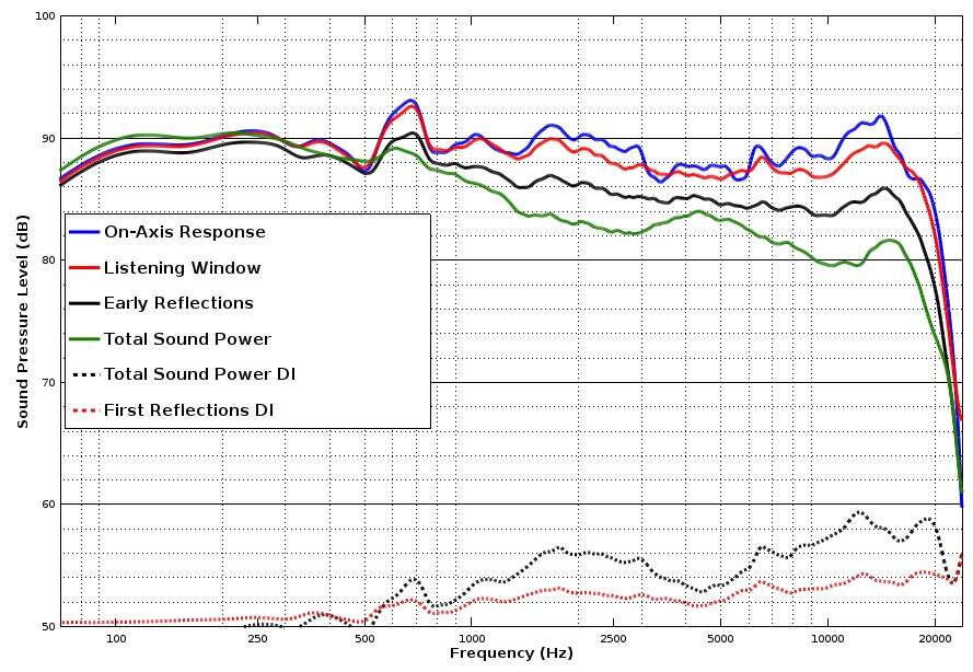

Monoprice has thrown their hat into a crowded ring of bookshelf speakers of similar cost, but there are certain features of the K-BᾹS speakers that help them to stand out. First, there is the low frequency extension; the K-BᾹS speakers have a very good response down to the low 40 Hz region- without the need for qualifiers such as “usable output”. Extension below 50 Hz is not easy to come by in bookshelf speakers in this price point and especially this size. Anyone looking for an affordable bookshelf speaker system that has to get by without a subwoofer would do well to strongly consider these.
Another admirable feature of the K-BᾹS speakers is the nicely uniform horizontal off-axis response. As mentioned before, the ‘Early Reflections’ curve can be a good predictor of in-room response, and the K-BᾹS speakers have a very smooth ‘Early Reflections’ measurement. These speakers do not need a heavily treated room to sound good; they will sound fine in a typical room. The good off-axis response was surely responsible for the excellent imaging that the K-BᾹS speakers projected. Another benefit of the uniform off-axis response is how much it broadens the coverage of area with good sound. The response out to 40 degrees off-axis is very good, so there is an 80 degree angle of decent coverage. If you have a wide area of seating that you want good sound for, or if you move around a lot when listening to your system, those circumstances make these speaker a good choice. A uniform off-axis horizontal response makes the sound better not just for one location but all of them. Because of this, the K-BAS speaker’s sound can compete very well with speakers that are quite a bit more expensive.

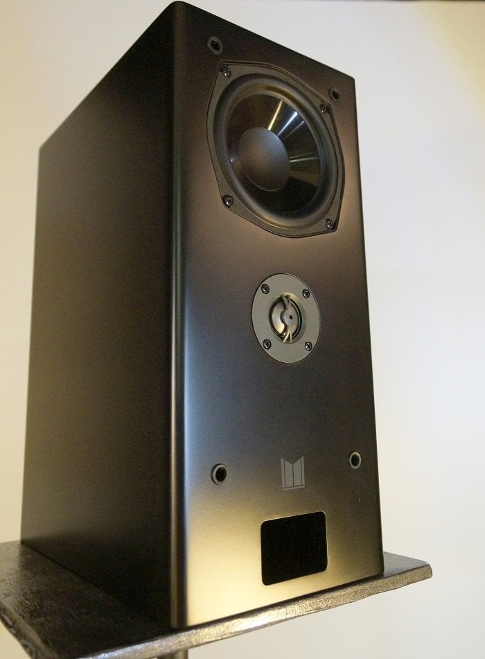

K-BAS-single2C.jpgThere is a lot to like about the K-BᾹS speakers, but for the sake of balance, I will go over some of the areas I would like to see some improvement, although I have to admit my criticisms are rather minor. First of all, while the on-axis frequency response is balanced overall, it does have some wrinkles that could stand to be ironed out. To be sure, I didn’t hear any clear flaws in my listening sessions with the K-BᾹS speakers, on the contrary, I thought the overall sound was nicely balanced, but the case might have been the content I used wasn’t majorly affected by incongruities the K-BᾹS frequency response, minor though they were. I think a more likely case is that the good off-axis response negated the shallow 3-6 kHz dip on-axis, and that the 700 Hz peak was too narrow and not high enough to significantly color the sound for me.
I also think that while the stock finish is not bad, having other finishes available for the K-BᾹS speakers would go a long way to making them more visually appealing, like perhaps some real wood finishes, or gloss finishes like pearl white. That would, of course, hike the prices of those speakers, but the extra options would be nice. One thing I will mention again here, even though this is not a gripe, is that these speakers are not suited for outrageous, headbanging, THX Reference level sound output. 84 dB sensitivity with a 8 ohm nominal impedance with a nominal power capacity of 50 watts mean that these speakers will safely able to run at around 100 dB at 1 meter outdoors continuously, maybe, (assuming typical content is being played back and not test tones) and around 105 dB peaks at 1 meter outdoors, maybe. The boundary gain of having to pressurize a smaller space means that it will be able to get a bit louder than those outdoors figures, but this is speculative; if you try running your K-BᾹS speakers at these levels and destroy them, I will not be held responsible! This is not a complaint against the speakers though, since few people will run them at these loudness levels, and few bookshelf speakers are designed to operate at levels much louder than that. I only mention this to caution those who like to listen at loud volumes in large rooms that there are more suitable speakers than the K-BᾹS.

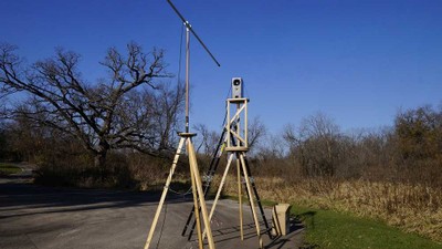

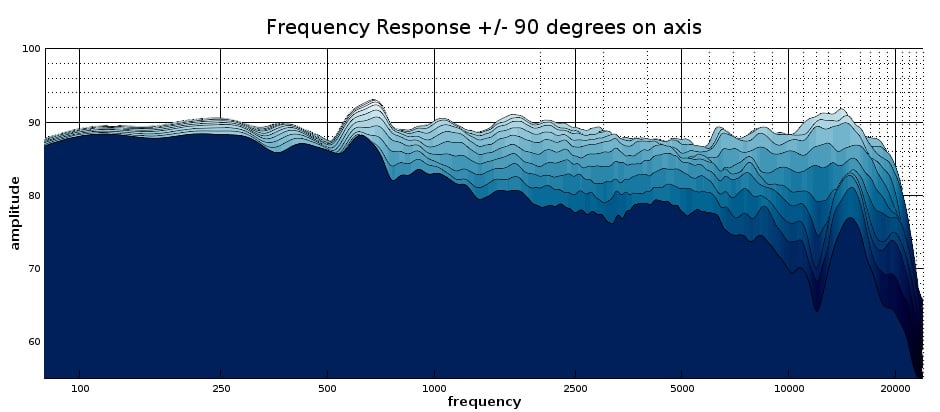

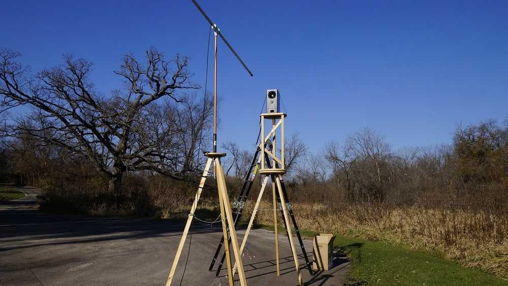

The Monoprice K-BᾹS speakers were measured in free air at a height of approximately 9 feet and gated at 14 ms. At this window gate, some resolution is lost below 140 Hz, and accuracy is completely lost below 70 Hz and so that range should be ignored. The microphone was placed 1 meter away from the speaker at a height level with the tweeter.
Monoprice K-BAS Frequency Response Curves

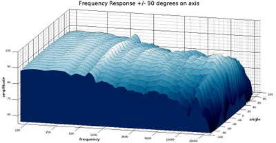

The Monoprice K-BᾹS speaker measures well, although there are some slight imperfections. Most visible is a 3 dB, high-Q resonance around 700 Hz. This resonance may have high enough of a Q and low enough amplitude to be inoffensive, and in my listening I did not notice anything amiss in this region. What is likely to be more audible is the 2 dB dip from 3 kHz to 6 kHz, but since this doesn’t show up in the curves involving off-axis responses, I don’t think it is a problem. The scale of this graph and the low amount of smoothing (1/24 octave) make it a bit unsparing of any irregularities. The ‘Listening Window’ is exceptionally smooth above 800 Hz, which means this speaker should have a wide ‘sweet spot’ at least out to 30 degrees to the sides of the speaker, and it should be good for situations that need good coverage for that broad a listening area. The ‘Total Sound Power’ curve and its corresponding directivity index would seem to indicate some extra off-axis energy from 3 kHz to 6 kHz, which may mean those frequencies will be more reflected off-axis than neighboring frequency bands. However, the ‘Early Reflections’ curve is very smooth, and this bodes well for the end results since ‘Early Reflections’ can be a good predictor of the room sound, so extra off-axis energy from 3 kHz to 6 kHz is not something to be overly concerned about. For a good explanation of these curves and their significance, we refer the reader to this Audioholics article: Objective Loudspeaker Measurements to Predict Subjective Preferences.

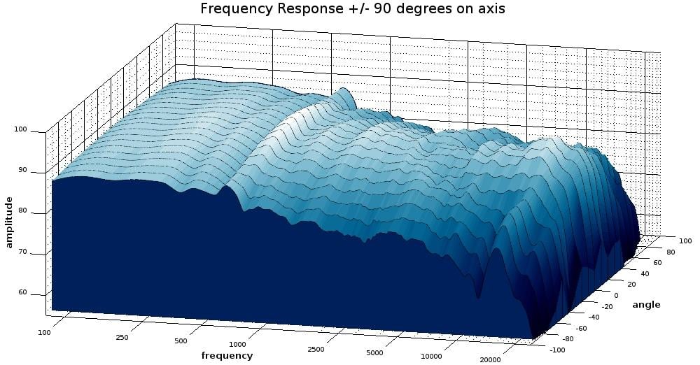

 Monoprice K-BAS Bookshelf Speakers horizontal frequency response +/-90 degrees from axis: 3D view
Monoprice K-BAS Bookshelf Speakers horizontal frequency response +/-90 degrees from axis: 2D view
Looking at the K-BᾹS speakers’ horizontal dispersion pattern, we see a relatively uniform off-axis dispersion pattern. After 40 degrees off-axis, a dip develops at 12 kHz, but that is too high a frequency for that to be a problem, especially that far off axis. At 90 degrees we see a bit more energy forming from 3 kHz to 6 kHz, and this does explain the bump in the ‘Total Sound Power’ curve in that region, but up to that point the response in this region is nicely flat. This is the dispersion pattern of the woofer starting to tighten up before playback is handed off to the tweeter, which will have wider dispersion in this frequency range. The fact that we have to wait until 90 degrees for that to become evident means the woofer and tweeter are well-mated at the 3 kHz crossover point. Overall, this is a very nice response, and bodes well for those who need a speaker that sounds good in more than just one listening position.

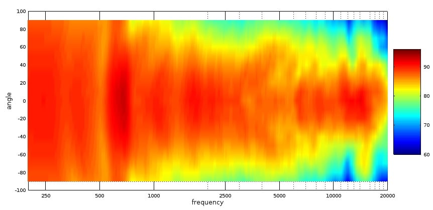

Monoprice K-BAS Bookshelf Speakers Polar Map
The colorful chart above is really just presenting the same data as in the two horizontal dispersion graphs above it, only shown from a top-down view and using color to indicate amplitude instead of raised lines. Presented in this way, we can more easily see certain trends from the other graphs. For example, we do see a slight narrowing of dispersion above 6 kHz. We see a hint of the 3 kHz crossover point from the slight waist-banding around that region, but it is pretty well controlled. We can more easily see the uniformity of the dispersion out to 40 degrees; past that point, there is more energy under 6 kHz, but it keeps a relatively smooth dispersion down to 1 kHz. The bottom line is essentially the same as we have seen so far; good coverage out to 40 degrees off-axis, so very good speakers for covering a wide area with decent sound and not bad control of sound outside of that point.

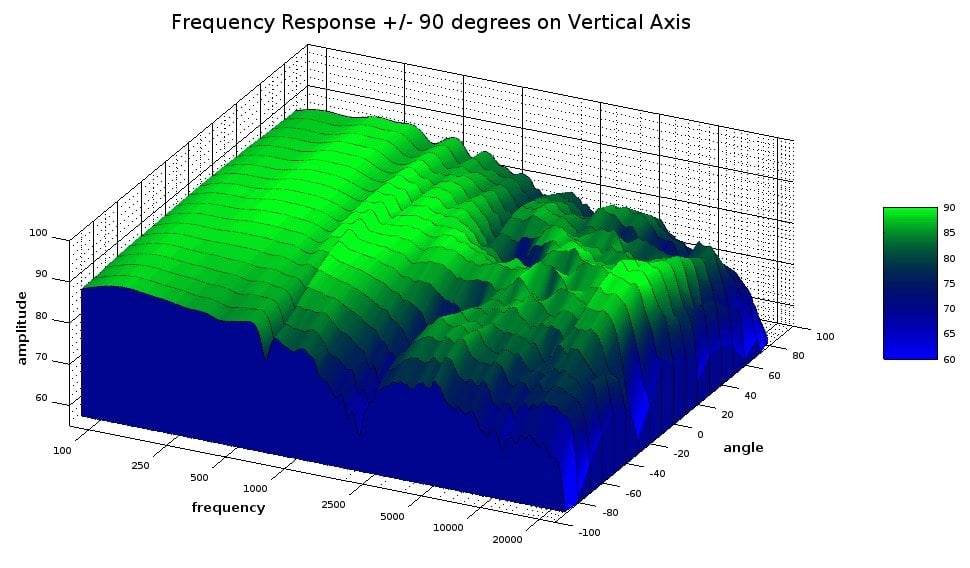

Monoprice K-BAS Bookshelf Speakers vertical frequency response +/- 90 degrees from axis: 3D view
The above graph displays the dispersion of the K-BᾹS speakers on its vertical axis. Before you panic, it should be said that the vertical dispersion isn’t nearly as important as the horizontal dispersion. This is a very typical pattern for this kind of bookshelf speaker. We see a narrow strip of a regular response on-axis, but lobing effects quickly create deep nulls as the response goes past ten degrees off axis in either direction. This is the result of the woofer and tweeter cancelling out each other’s sound around the crossover point; this is inevitable with this type of driver layout. On this scale, the negative degrees are below the tweeter, and positive degrees are above the tweeter. What this graph says is that, as with most speakers, the K-BᾹS speakers should not be placed on their side and are best listened to with the tweeter roughly at ear level.

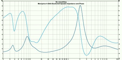

Monoprice K-BAS Bookshelf Speakers Impedance and Phase
I blasted these speakers pretty hard and didn’t sense any obvious distortion or compression.

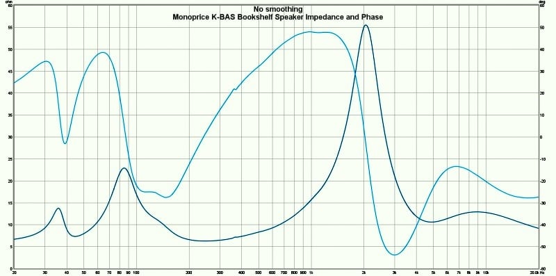

The impedance graph of the K-BᾹS speakers show a fairly benign electrical load. Our own measurements seem to be a couple of ohms above that of Monoprice’s. They claim an impedance minima of 4.2 ohms, but we measured a 6.2 ohm minima, although our profile shape matches theirs. Either way, most amplifiers will have no problem with these speakers; even an entry-level AVR should be able to run them fine. According to our measurements, these can easily be characterized as an 8-ohm speaker. Our sensitivity measurements showed the K-BᾹS speakers to have a 84 dB for 2.83v at 1 meter. Monoprice has these speaker spec’d at 87 dB sensitive, but they do not say if that was taken at 1 watt or 2.83v, although either way would not match our results. If that spec was taken at half-space, it would match our results, and sometimes manufacturers measure sensitivity at half-space without declaring it in the specs. We have to stress that, while that 84 dB sensitivity might seem low, it is very typical for a bookshelf speaker of these specifications, and many manufacturers have ways of stretching the sensitivity measurement. This is a speaker that can get loud, but it is not a speaker that one would want to use as mains for a big, dedicated theater room. I blasted these speakers pretty hard and didn’t sense any obvious distortion or compression. However, there is only so much a bookshelf speaker with a 5.25” woofer can do. I think these would get more than loud enough for most people’s tastes.

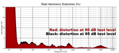

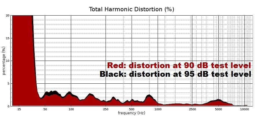

Monoprice K-BAS Bookshelf Speaker total harmonic distortion
The above graph depicts the total harmonic distortion of the K-BᾹS speakers at 90 dB and 95 dB sweep levels. This level of distortion looks very good for this loudness level, especially in lower frequencies. The only thing in here that could come close to being audible is the bump almost touching 3% around 700 Hz, and it would have to be using a pure tone in laboratory conditions to be heard. The third harmonic is the dominant harmonic throughout this distortion profile, but the second harmonic does crop up at the 700 Hz bump, which is almost entirely second order harmonic distortion. The ridges of distortion in lower frequencies would be totally inaudible, since human hearing is much less sensitive to distortion in that band. The beefy midwoofer driver looks to be paying off in these tests. This speaker could have taken higher levels than this and still retained its composure, but the point was already made. This is a fine showing, and the K-BᾹS speakers can stay clean at relatively loud levels.
