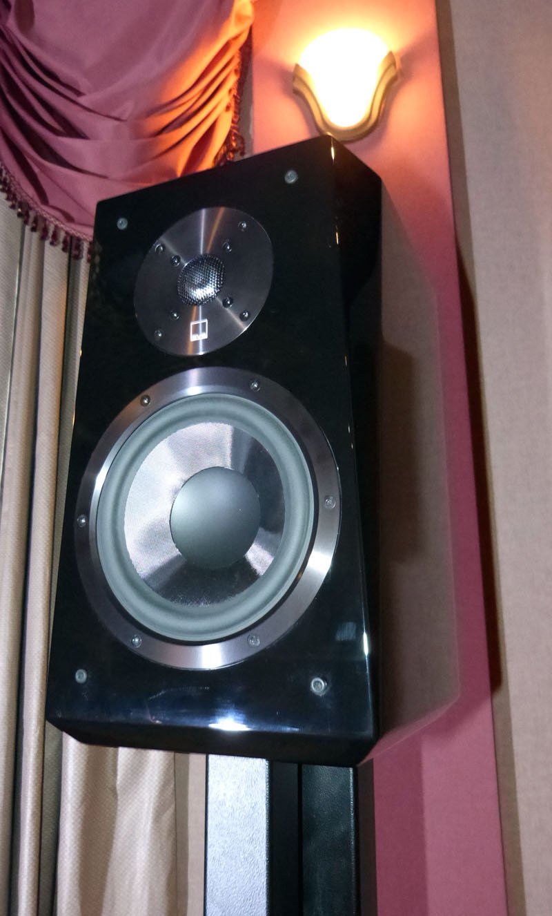

Design Overview

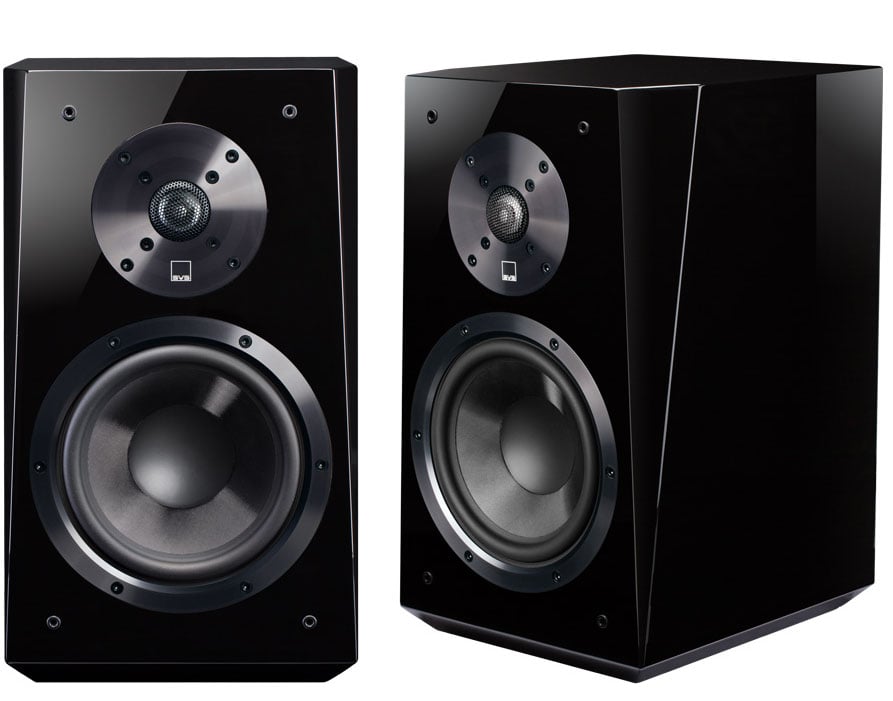

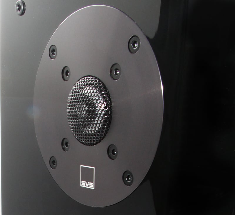

The SVS Ultra bookshelf speaker is a two-way, rear ported speaker with a 6.5” glass fiber cone and 1” aluminum dome tweeter. In reality the woofer cone material is nothing more than treated paper upon closer inspection but glass fiber sounds more interesting so I’ll give it to them. The woofer has a nice cast basket frame, substantial motor structure and a vented former to help reduce turbulence at the gap and also provide some degree of cooling for the voice coil. The 1” aluminum dome tweeter features a ferrite motor structure, a plastic phase plug to reduce high frequency break-up mode, and a metal screen to protect it from curious children with prying hands. The crossover is a 2-way, 2nd order electrically symmetric HP and LP featuring an air core inductor and poly capacitor on the tweeter circuit and rugged iron core choke on the woofer. The metalized padding resistor on the tweeter is on its own standoff to improve heat dissipation. This is a little detail often forgotten by lesser designed products. The cores are all orthogonally oriented to reduce crosstalk coupling and the speaker wires are encased in foam padding to eliminate mechanical buzz in the cabinet.
SVS Ultra Drivers
SVS Ultra Internal View

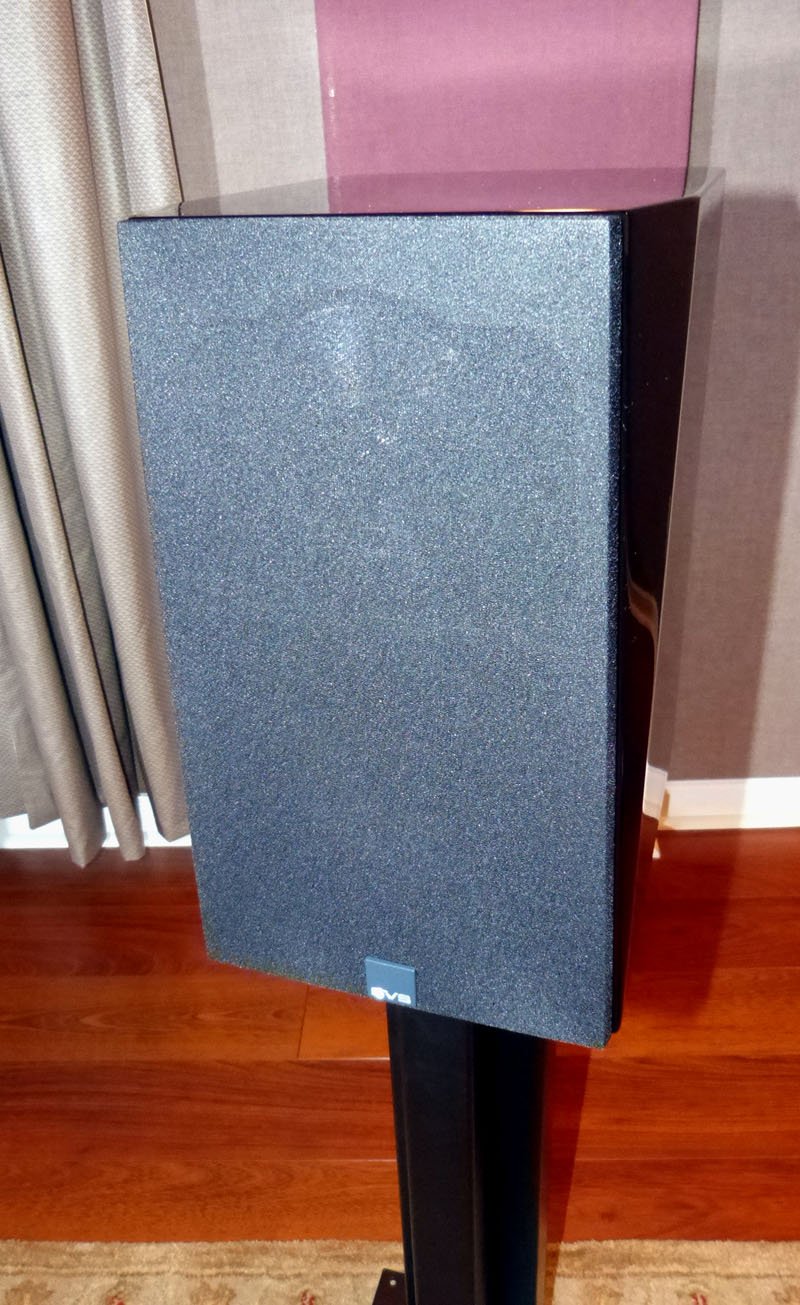

The cabinet is constructed of ¾” MDF instead of the standard 5/8”, with a full 1” thick front baffle where rigidity is needed most, especially since both drivers are countersunk and flush mounted into the baffle to reduce diffraction. The cabinet is further stiffened with a generously sized brace that is firmly affixed to all surfaces instead of the cheap stick style bracing often found on less costly speaker systems. The cabinet is generously stuffed with insulation and I actually had to remove some of it to get a peek of the crossover. The outer surfaces are radiused to reduce diffraction and the grille is constructed of thick MDF instead of cheap flimsy plastic. This provided excellent rigidity and allowed for the grille to be tightly fit onto the frame to reduce losses.
SVS Ultra Bookshelf Back View
The SVS Ultra bookshelf speakers come standard as bi-ampable or bi-wireable, a feature many competitors either lack or charge a premium for. We chose to single amp the speakers for our listening tests.
SVS utilized the National Research Council (NRC) anechoic chamber in Canada to measure and test the Ultra speakers in addition to voice tuning it in real rooms. This speaker has all of the right parts to make for a good quality design with solid engineering principles to back it up.
The SVS Ultra bookshelf speakers come in three finish options {black oak veneer, white or gloss black} and all finishes are real veneer, not vinyl wrap. SVS doesn’t up charge for any of these finishes. Ours came in gloss black which looks exquisite and I highly recommend choosing this finish.

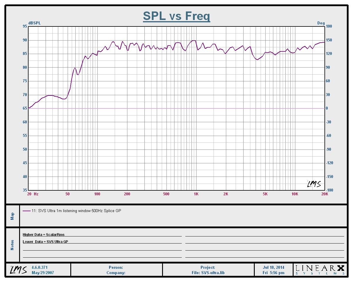

SVS Ultra Bookshelf Listening Window Response – 1 meter in-room summed with GP
I measured the SVS Ultra bookshelf at 1 meter in-room on-axis, +-30 deg off-axis horizontal and +- 15 deg vertical off-axis to derive the listening window response. The curve was then spliced with a groundplane measurement at 500Hz to eliminate room effects below the transition frequency. Port contribution was not fully captured but I estimate the -3dB pt to be around 50Hz based on this measurement and the impedance measurement. I confirmed SVS’s sensitivity rating of 87dB was accurate and the speaker measured very linearly throughout the entire audio bandwidth which explained why it sounded mostly neutral in our listening tests.

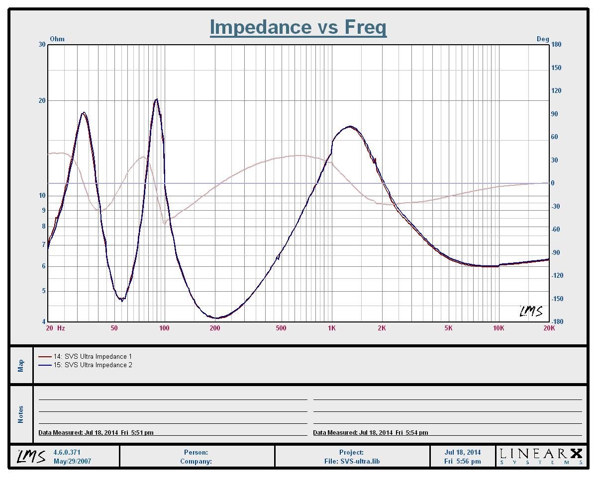

SVS Ultra Bookshelf Impedance and Phase
The Ultras are rated at 8 ohms but in reality they are 4 ohm speakers. There is no hiding this fact. I suspect SVS rated them 8 ohms for marketing purposes and because of their high sensitivity making them an easy load to drive. Notice how both speakers track very well in this measurement indicating parts tolerances are very tight.
