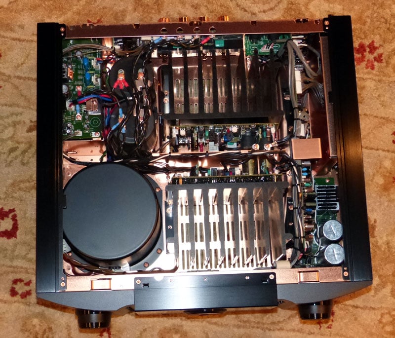

Marantz PM-11S3 Top View with cover removed
Only top shelf parts are used throughout the design including an oversized 950 VA toroidal transformer wound with OFC (Oxygen Free Copper), thick extruded aluminum heatsinks to cool the output devices, huge power supply capacitors hand wired with thick twisted pair cabling rather than soldered into a PCB board and trace routed, 5mm thick solid aluminum top panel for increased rigidity. The chassis also features a dual layer bottom panel for additional strengthening, while all internal chassis surfaces are copper plated for maximum resistance to RF and electrically induced interference.

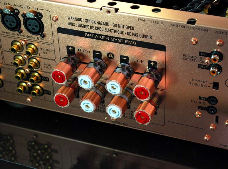

Marantz PM-11S3 Backview
The PM11-S3 sports six selectable analog RCA inputs and one balanced input. I was mildly disappointed that the preamp outs are only RCA level but even if they were balanced, the design topology from input to output is only single ended like most integrated amps and preamps on the market these days. The PM-11S3 comes with a detachable two-prong power cord.

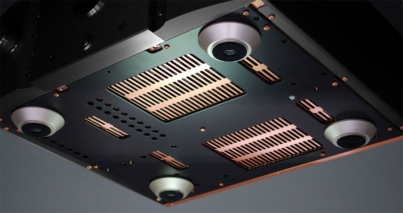

Bottom View of Marantz PM-11S3
Marantz provisions the ability to chain multiple PM-11S3’s together to bi-amp or run a complete multi-channel system through the F.C.B.S system that allows up to 4 PM-11S3’s to be ganged together under single control.

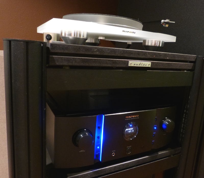

Set-Up
Setting
up the Marantz PM-11S3 was a breeze. No
need to configure an OSD, bass management, etc.
This is just a plain two-channel analog integrated amp meant to do one
thing, deliver pristine analog audio. As
such, I connected up my Marantz TT-15S1 turntable and Oppo BDP-105 Blu-ray
player via the balanced analog connections.
Oddly, Marantz still uses the old balanced connection scheme that
reverses the hot/cold polarity so I simply flipped the configuration in the
Oppo OSD setup to accommodate this to avoid a polarity shift. I didn’t have any full range speakers on hand
to evaluate the PM-11S3 other than my $50k/pair of Status Acoustics 8T
reference set. I was a bit apprehensive
about making this connection since the 8T’s dip down to high 2 ohm region and
are quite a difficult load to drive. The
PM-11S2 had a very sensitive overload protection circuit that would trip at
high listening levels on virtually all 4 ohm speakers I’ve tested in my
reference room. I was interested to see
how the 11S3 behaved in this regard. I
wired up the speakers with Kimber 8TC cables and Bluejeans interconnects were
used for the balanced cables fed to my Oppo BDP-105.

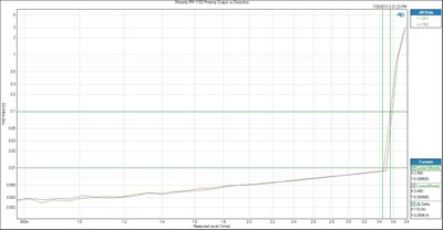

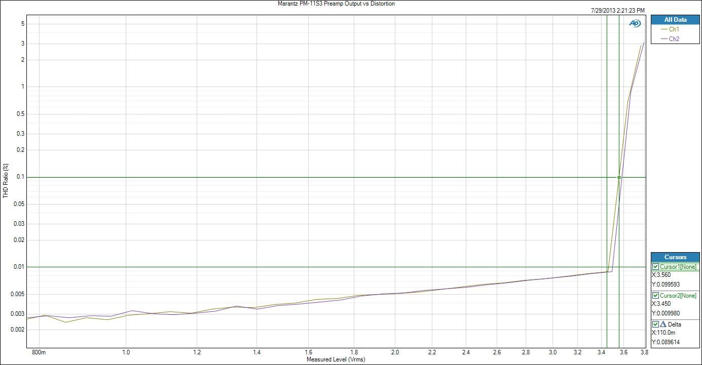

Preamp Output
Marantz PM-11S3 Preamp Voltage Output vs Distortion (1kHz)
I did some quick spot-checking on the Marantz PM-11S3 preamplifier gain structure to ensure it had enough output voltage to feed external amplification should the end user’s system power requirements increases with a more demanding speaker system or listening preference. I measured 17.7dB voltage gain from the preamp outputs of the PM-11S3. It was able to output 3.5Vrms unclipped which should be enough to drive virtually any modern amplifier into clipping. Interesting, however, was that the PM-11S2 was able to muster a bit more output voltage than the 11S3 and at a lower distortion (.005% IMD on the 11S2 vs .01% IMD on the 11S2) but this is mostly academic.

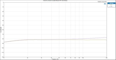

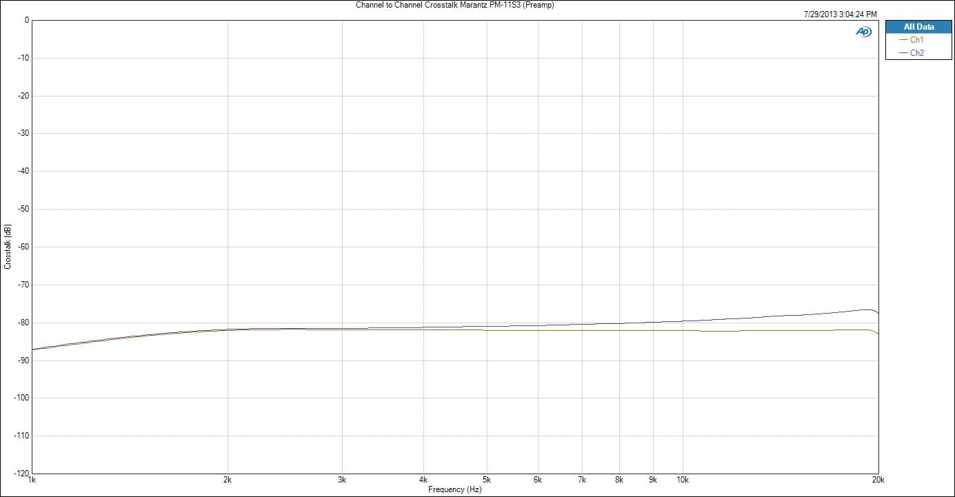

Crosstalk
Marantz PM-11S3 Channel to Channel Crosstalk
The PM-11S3 exhibited excellent crosstalk performance as can be seen in the above graph. Channel-to-channel isolation was about -80dB out to 20kHz.

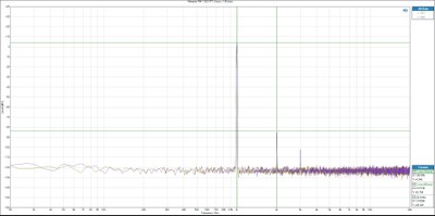

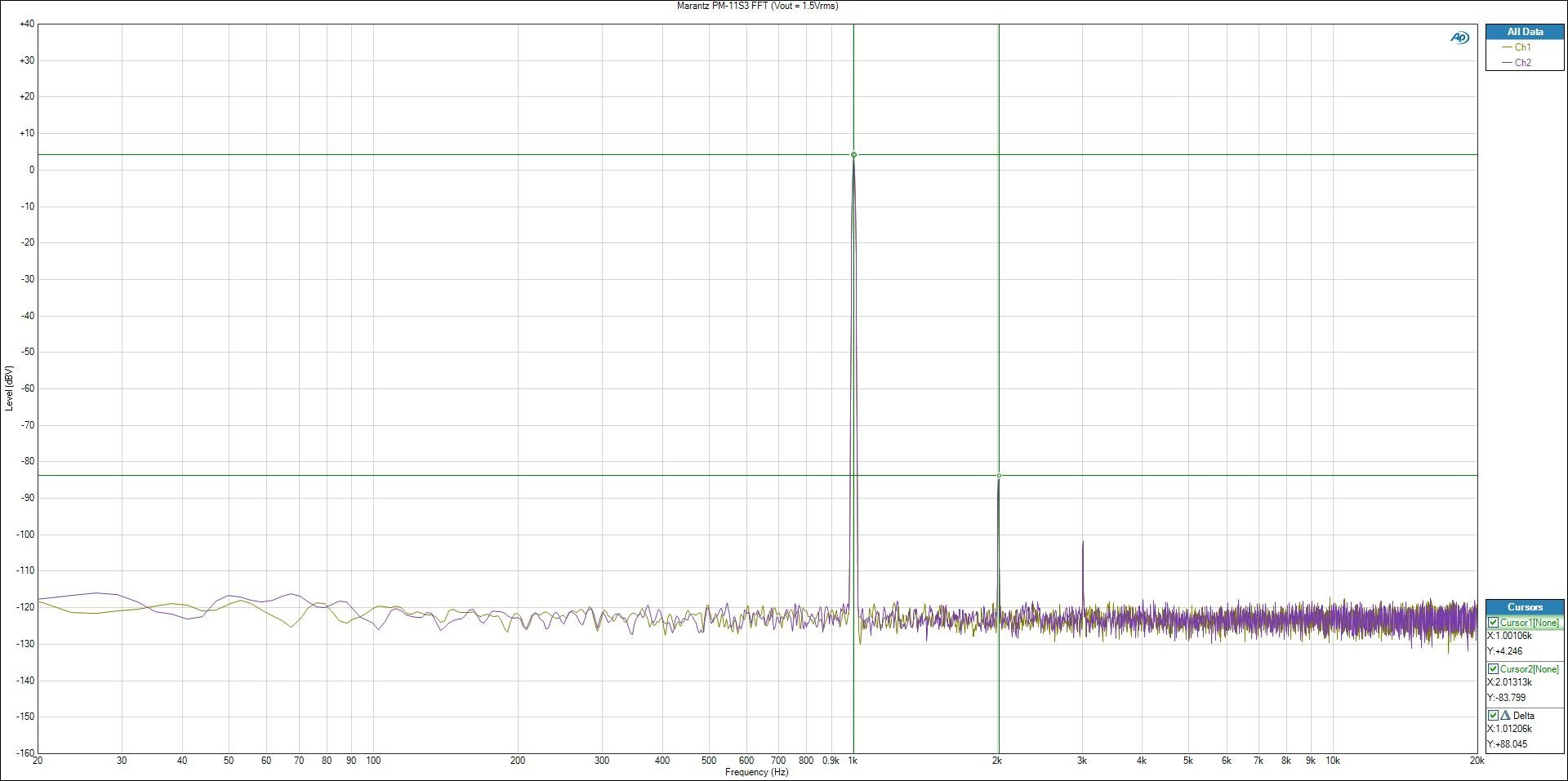

FFT Distortion Analysis
Marantz PM-11S3 FFT Distortion Analysis 1.5Vrms
I ran FFT distortion plot on the PMS-11S3 at 1.5Vrms output. The 2nd order harmonic was dominant at -88dB below the fundamental. At 3Vrms, more harmonic byproducts were produced but the dominant 2nd order harmonic was still -82dB below the fundamental. Surprisingly however, the PM-11S2 FFT distortion analysis was a great deal lower. On similar tests the PM-11S2 measured a whopping -20dB lower in distortion. It seems apparent to me that the 11S2 employed higher quality op-amps for the pre-outs.

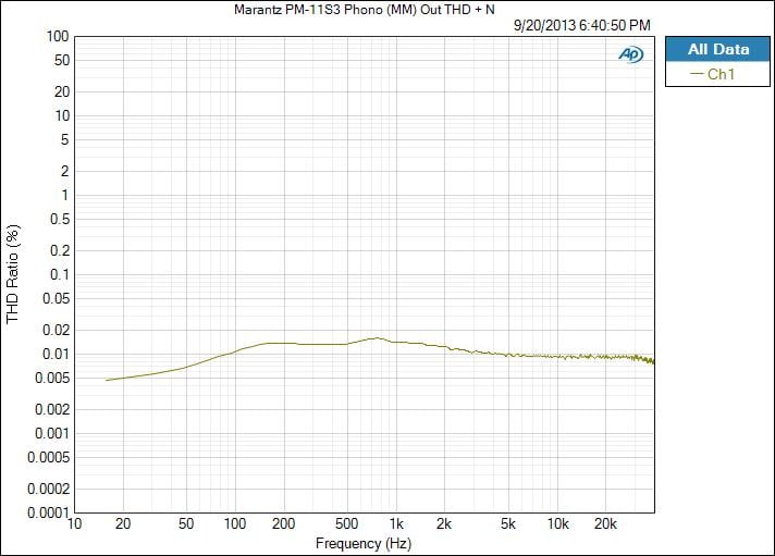

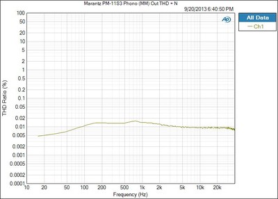

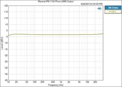

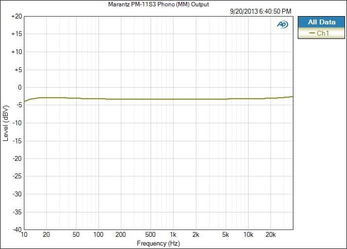

Phono Output (MM) Frequency Response and Distortion (THD + N)
Marantz PM-11S3 Phono Pre-out Frequency Response
Using the original 3-time constant RIAA curve, I EQ’ed the AP to get the expected flat response of the phono preamp. As you can see the PM-11S3 produced very linear results here. I measured the same type of response from the older PM-11S2 as well. I drove the input with 10mVrms and cranked the volume up to -20dB. This resulted in an unclipped output about 675mVrms from the analog outputs.

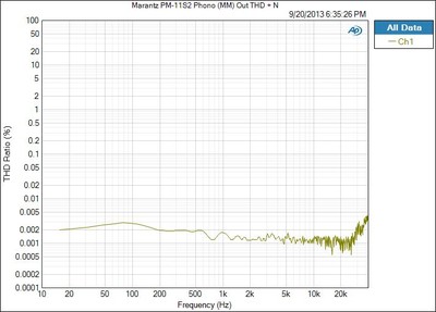

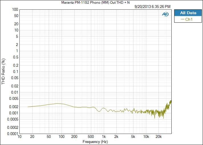

Marantz PM-11S3 Phono Pre-out THD + N Distortion Test
Marantz PM-11S2 Phono Pre-out THD + N Distortion Test
Despite the fact that both the PM-11S3 and PM-11S2 were driven with the same signal levels, the 11S2 clearly exhibited lower distortion. Regardless, the 11S3 still produced solid results and I believe that the more robust analog preamp section not the phono preamp alone contributed to the lower distortion in the 11S2.

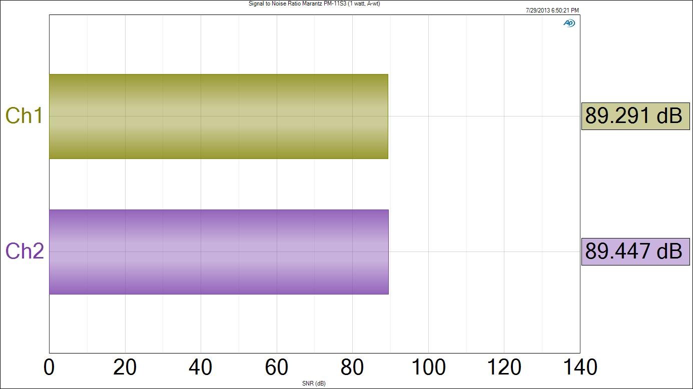

Signal to Noise Ratio
Marantz PM-11S3 SNR (A-wt) @ 1 watt
With 265mV input and 2Vrms from the preamp outputs, I measured an SNR of 88db (no filters, no weighing) and 96dB A-wt. From the entire preamp to power amp stage, I measured 81dB unweighted and 89dB at 1 watt A-wt. These are very good (thought not the best I’ve measured) numbers indicating a solidly low noise floor whether used as a dedicated preamp or integrated amp function.

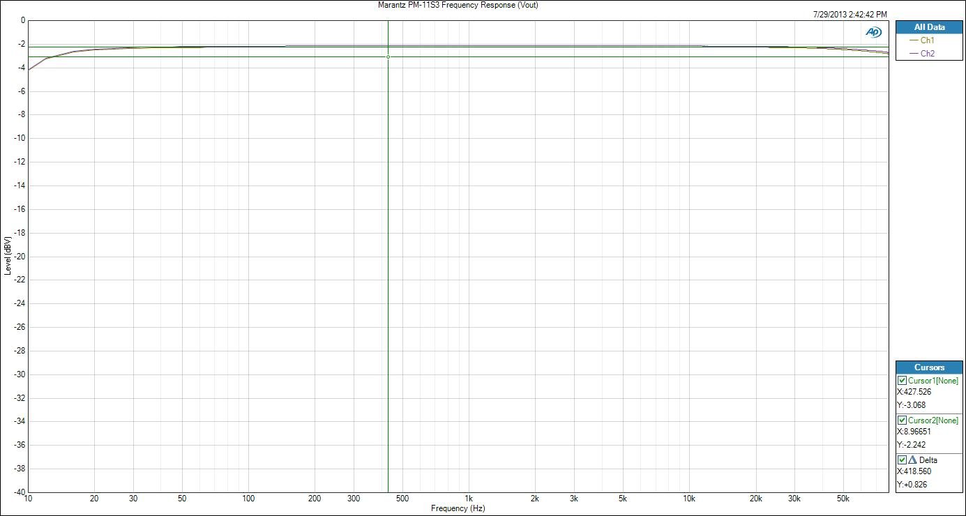

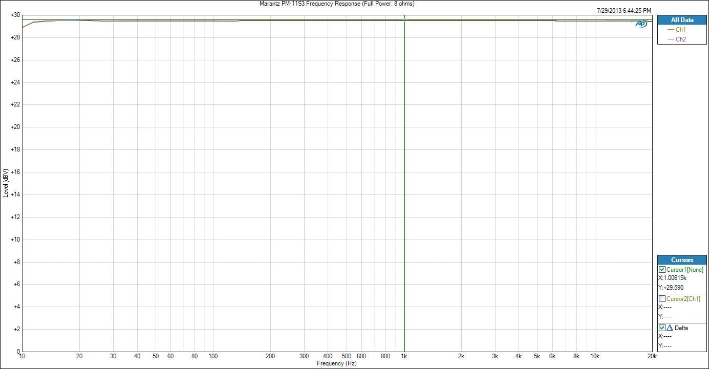

Frequency Response
Marantz PM-11S3 Frequency Response
The ruler flat frequency response (-0.8dB at 60kHz and -1.5dB at 10Hz) of the PM-11S3 indicated excellent bandwidth linearity. Interestingly the PM-11S2 didn’t exhibit the slight low frequency rolloff below 20Hz that the 11S3 did.

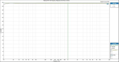

Marantz PM-11S3 Full Power Bandwidth Continuous Sweep (200 watts, 4 ohms)
The Marantz PM-11S3 exhibited excellent bandwidth linearity even at high output levels; in this case 113 watts/ch into 8 ohms and 200 watts/ch into 4 ohms continuously with both channels driven..

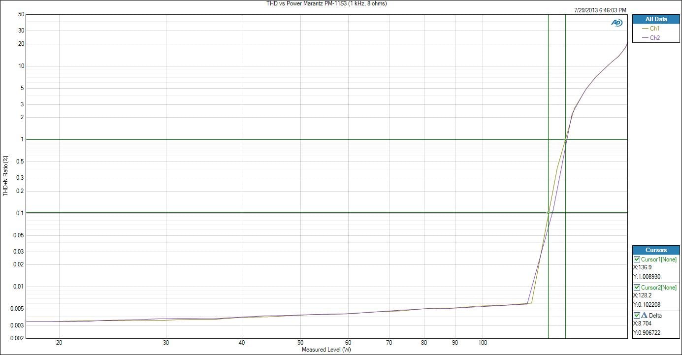

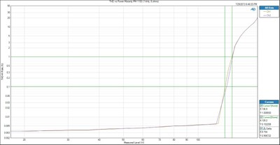

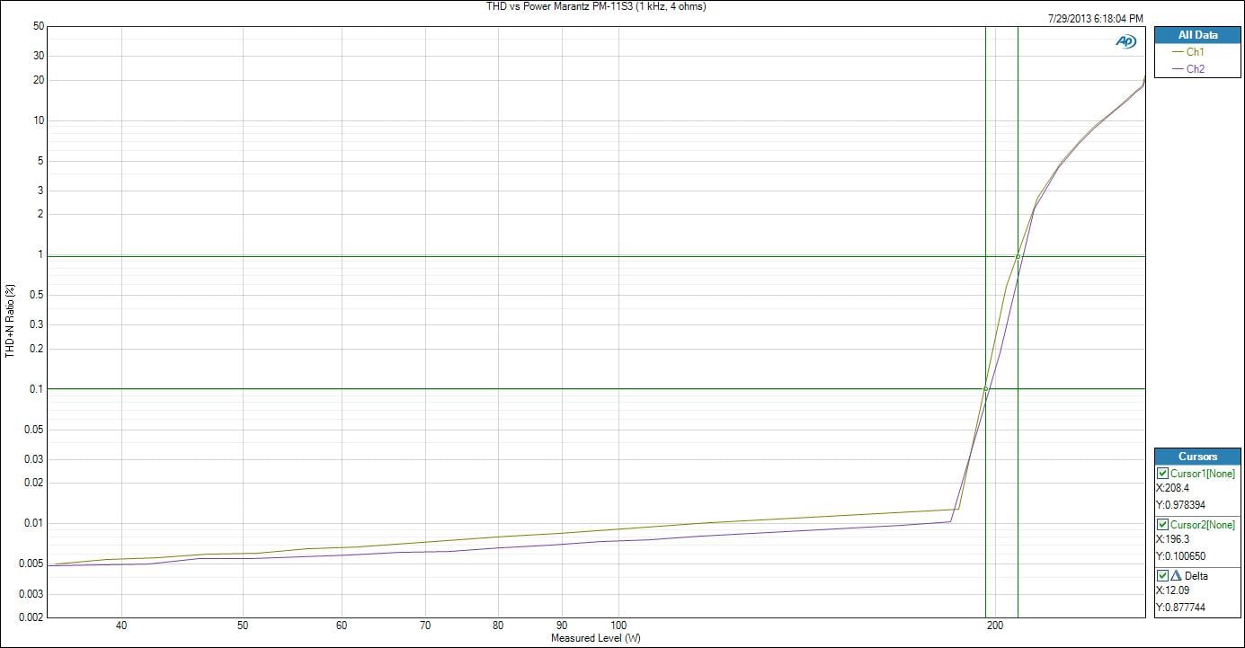

Marantz PM-11S3 1kHz Power Test
Top Pic: 8
ohm load; Bottom Pic: 4 ohm load
The PM-11S3 produced excellent results with our 1kHz power sweep test. Into 8 ohms, I measured 137 watts (1% THD + N) and 128 watts (0.1% THD + N) with both channels driven. At 4 ohms, I measured 208 watts (1% THD+N) and 196.3 watts (0.1% THD+N) with both channels driven. Notice the baseline distortion is slightly higher when driving a lower impedance load, but it’s still darn respectable.
The PM-11S3 slightly outshined its PM11S2 predecessor as it consistently produced between 6-7% more power for all of these sweep tests under the same load and distortion conditions.

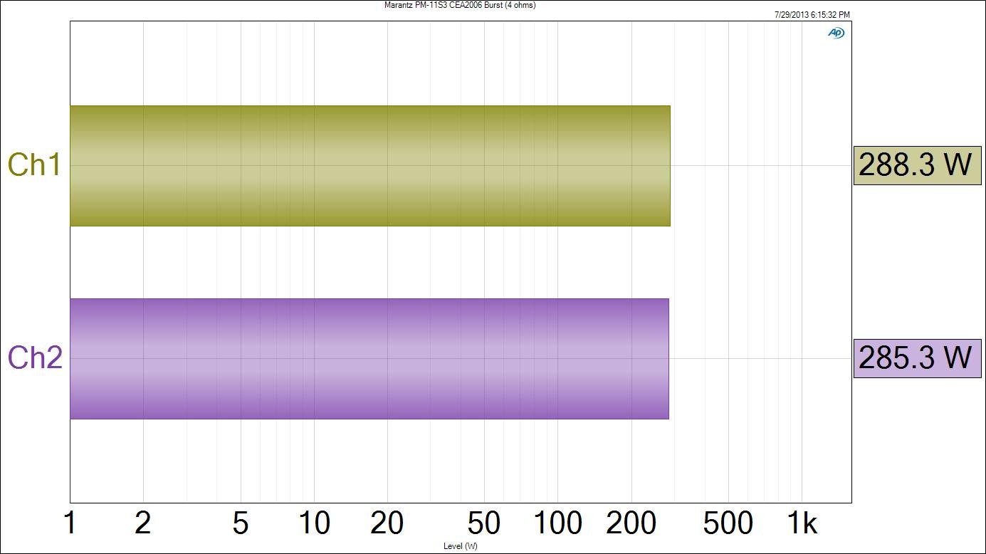

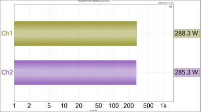

Marantz PM-11S3 Dynamic Power Test (1kHz); 4 ohm load
The CEA-2006 burst tests simulate musical program material. The PM-11S3 produced some fine results for which is no surprise for a product of this caliber. At 8 ohms, it was able to deliver 169 watts/ch and 285 watts/ch into 4 ohms; both channels driven at 1% THD + N.
