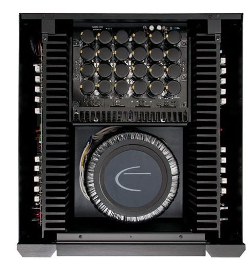

Emotiva XPR-1 Top View with cover removed
You can see the layout is very clean and symmetrical. It basically takes two amplifier channels and bridges them together to form a fully differential amplifier stage from input to output. In fact, if you use the balanced input on the XPR-1, the signal remains differential all the way to its output driving the speaker. Thus the loudspeaker has no ground reference. All things being equal, differential topologies are superior to single ended designs, because they offer better noise immunity (up to a 6dB improvement) and lower distortion.
The XPR-1 features
a massive centralized power supply to feed this baby all of the power your wall
outlet can deliver. There is a preamp
stage consisting of high quality op-amp amps that gets bypassed when using the
amplifier’s differential (balanced) input.

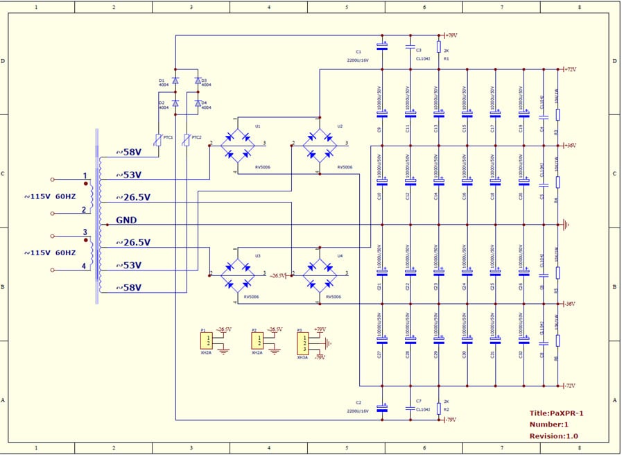

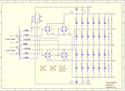

The Power Supply
The Emotiva XPR-1 is quite an innovative amplifier design. It is a class A/B amplifier topology with a Class H modulating power supply. Unlike many of the high-efficiency Class H pro amps that utilize SMPS power supplies, Emotiva spared no expense and instead employed a much cleaner traditional linear power supply with a 30lb 2.5kVA transformer and 24 10,000 uF capacitor bank. Unlike their original MPS-1 amplifier that employed a Class H topology where only one high voltage rail was used while the output modulated above the input signal, the XPR-1 employs two rails. The low rail is set for +-36V allowing the amp to operate as pure Class A/B up until about 200 watts or so. Once the power levels go higher, the output rail modulates above the incoming input signal to achieve over 1 kilowatt of power into an 8 ohm load off of +-72V rails. I’m sure some forum sharpie will note that +-72V isn’t a high enough supply rail to reach the 1000 watt power level but they would be mistaken once they considered the fact that the output stage of the XPR-1 amplifier is differential, essentially bridging two channels together. Thus the output stage feeding the loudspeaker sees no ground reference allowing the amp to swing virtually the fully difference between the +- rails (144V – minus losses). This effectively doubles the total voltage swing which has the potential of increasing the power output fourfold in the process. You never really achieve a 4x increase in power for bridged amplifiers, else it would either burn out the output devices or be current-limited by the power supply or wall voltage. In reality, the bridged configuration doubles the power in this case. As you can see, there is plenty of rail voltage to do well over 1 kilowatt of power in this configuration.
Emotiva XPR-1 Power Supply
Another trick feature of the XPR-1 is how the capacitors are distributed on the power supply. First let me point out that the capacitors are actually manufactured by Emotiva for the XPR series of amplifiers. They are designed to be extremely low ESR and low ripple. The 24 10,000uF caps are only rated at only 50V but there is method to their madness here. The low rail actually sees a bank of 6 of these caps in parallel for a total power supply capacitance of 60,000uF or 120,000uf between the +- 36V rails. The high rails see a series-parallel combo for an effective capacitance of 30,000uF per rail or 60,0000uF between the +- 72V rails. Using multiple smaller caps lowers the profile of this already beastly amplifier and also reduces ESR, especially for the low rail to minimize ripple for the lower power levels where the most control is needed to keep things sounding crystal clean. The resistors on the output of the power supply are used for discharging the caps once the power supply is shut down.

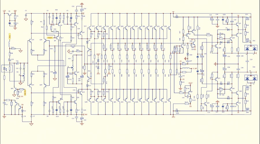

Emotiva XPR-1 Amplifier Topology
Emotiva XPR-1 Amplifier Schematic
This circuit topology represents one half of the two differential amplifiers (mirror amplifier) with bipolar transistors. There are a total of 36 (18 per phase) 250 watt ON Semiconductor output devices in XPR-1 amplifier. By bridging two amplifier channels together and making the second channel of the bridged pair 180 degrees phase inverted, the load sees double the voltage compared to a single ended amplifier design. The positive cycle of the input wave is handled by upper amp and the negative cycle is amplified by the lower differential amp with 180 degree phase shift. The output of each differential amp (in upper & lower stage) is connected to the bases of bipolar transistor in the Darlington scheme shown in the figure. This configuration gives a much higher current gain. The resistors connected to the emitter of each transistor provide intrinsic feedback to control the currents flowing through the transistors. In addition, two differential op-amps are employed. The input signal is connected to the inverting and non-inverting pin of each op-amp. Depending on the polarization of the input signal (+/-) the output of one the op-amps would “turn on” while the other would “turn down” at the same time. The output signals of the op-amps would switch on/off the MOSFETs connected to the “high rail” potentials in order to synchronize the applied voltage to the input signal. This increases the efficiency of the circuit while avoiding any power loss. In other words, when the input signal amplitude goes high, the upper op-amp switches on the upper MOSFET connecting the upper high rail voltage to the circuit and amplifying the input signal. This circuit is an adaptive design.

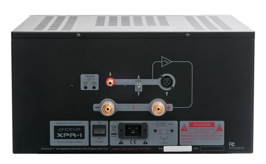

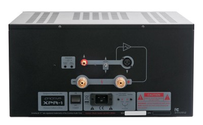

Emotiva XPR-1 Backview
The back view of the XPR-1 is a bit pedestrian, but the connector
spacing is well laid out and sturdily assembled. The XPR-1 accommodates unbalanced and
balanced inputs which is switchable via the rear panel switch. Personally I would have liked to see a more
robust toggle switch that required more effort to toggle to avoid accidental
switching when reaching behind your rack to organize cabling. The balanced connectors were not the locking
type found on other high end amps, but they hold the cable snugly nonetheless.
The speaker terminals are audiophile-grade 5-way binding posts. Many high power amps won’t accept banana plug terminations but the XPR-1 does. The connectors are spaced about 3” apart and fully encased in plastic. These are great countermeasures to ensure no chance of arching between the speaker leads. There are two 3.5mm triggers (input and output) and a master on/off switch.
The power receptacle will only accept a 20A power cord which Emotiva provides. Before installing this amp you will have to make sure you have a true dedicated 20A line or have a qualified electrician install one for you. The XPR-1 employs an auto-commutator which senses the line voltage and auto switches between 120V / 220V depending on what you feed it. Power mongers wanting to squeeze out every gut wrenching watt the XPR-1 can deliver will opt to install a 220V line for this amplifier.
Like all other Emotiva products, the XPR-1 has full third party CE and FCC / RoHS certification. Unlike many companies that self-certify, Emotiva makes it a point to have this done independently for complete regulatory compliance and safety. This is an expensive and lengthy process but demonstrates how far Emotiva is willing to go to tighten up the product design.

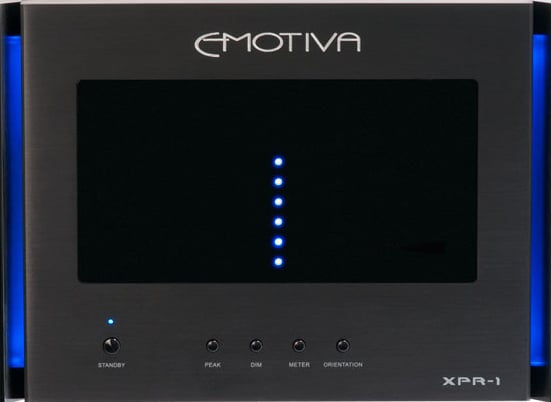

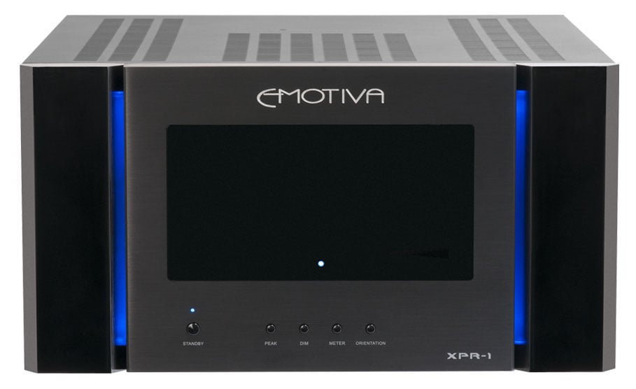

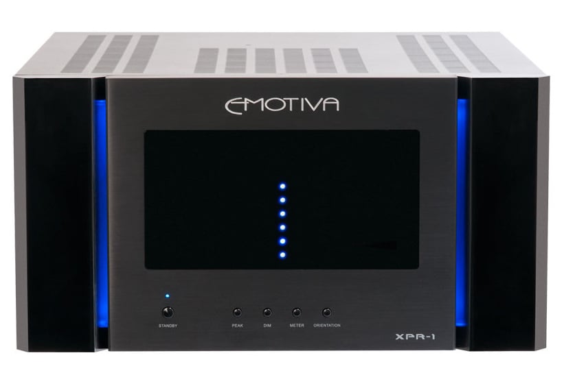

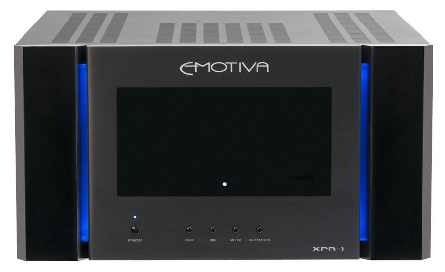

Emotiva XPR-1 frontpanel View
The front panel of the XPR-1 is very posh. It fact, it’s arguably the nicest looking
amplifier Emotiva has built to date in my opinion. The XPR-1 has a precision-machined, 1” billet
aluminum, multi-element faceplate, with laser embossing. There is a giant glass
faceplate flanking the center with variable intensity blue metering that can be
oriented for left, right or vertical display.
The meter can be set for fast or slow response or defeated
entirely. The LED meter will turn red
under fault conditions right before the amp shuts down. The defeatable blue accent lighting on each
side of the front panel really adds a touch of class to the product. A soft touch power button with inrush
limiting located on the front panel along with the buttons to change the
function of the LED display.

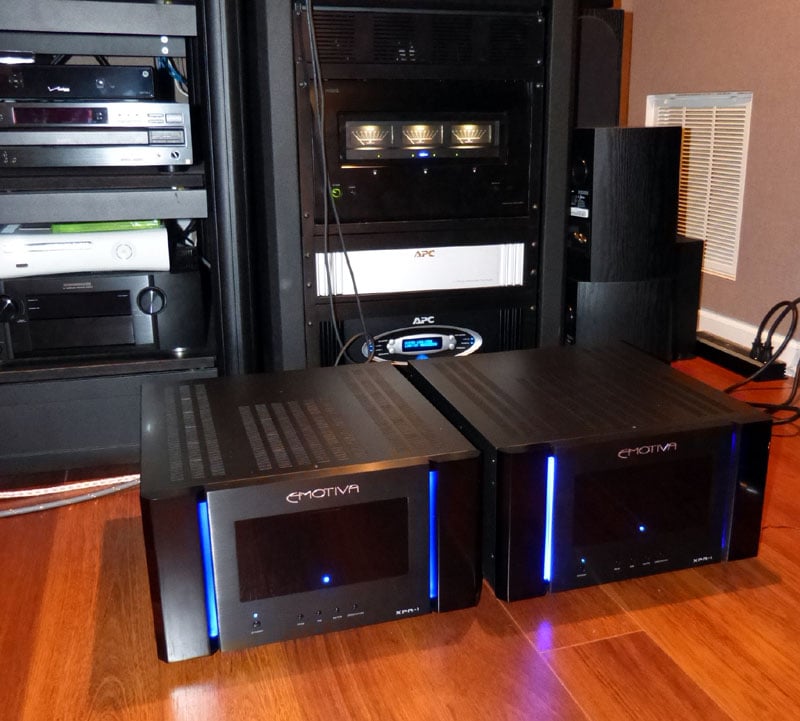

Set-Up
Slinging
a pair of XPR-1’s around is no easy feat.
These 100lbs+ beasts require two people to move them into position if
you value the health of your spine. I
positioned both amplifiers on the floor next to my Middle Atlantic rack that
houses most of the equipment in the 6,000 ft^3 Auralex acoustically treated Audioholics
Showcase Home Theater Room. I connected
the XPR-1’s to both my two-channel system and multi channel system. For two-channel, I ran unbalanced to my
Marantz PM-11S2 integrated amp with my Marantz TT-15S1 turntable and balanced
to my Oppo BDP-105 Blu-ray player. For
multi-channel, the XPR-1 was connected up to my Denon AVP-A1HDCI processor for
a fully balanced connection from source device to the speaker outputs! In both systems, my Status Acoustics 8T
speaker system was used for evaluation.
All interconnect cables were Bluejeans cable and speaker cables were
Kimber 8TC with WBT banana compression terminations.
Switching between two-channel and multi-channel systems was as easy as flipping the XPR-1 backpanel switches from unbalanced (two-channel) to balanced (multi-channel). I would caution any end-user connecting two preamps to the XPR-1 in this fashion to ALWAYS turn off the unused preamp. I measured the switch to provide about -60db of isolation, but it’s still a good idea to only have one active preamp powered on when connecting multiple preamps to a common amplifier via its various input connectors.

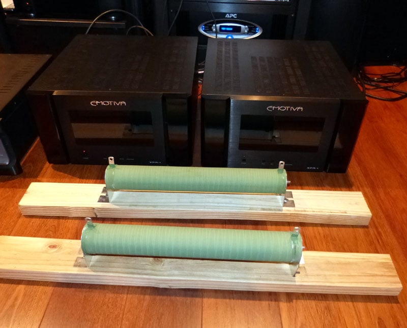

High Power 8 Ohm Test Loads
Before getting into all of the power tests, I did a quick check to see how green friendly the XPR-1 amp was. I measured roughly 50 watts idle power consumption which is very low for an amplifier of this power capability. Even with almost 10 watts of pure class A bias, this amp is efficient!

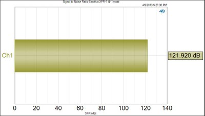

Signal to Noise Ratio

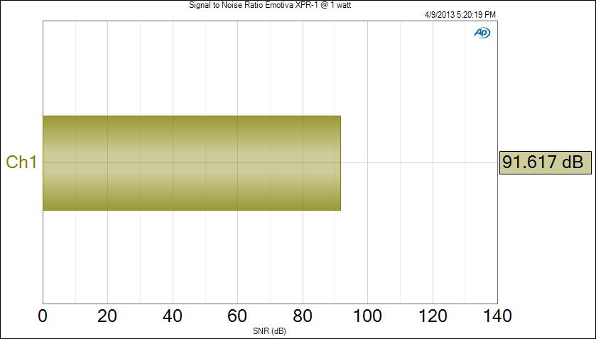

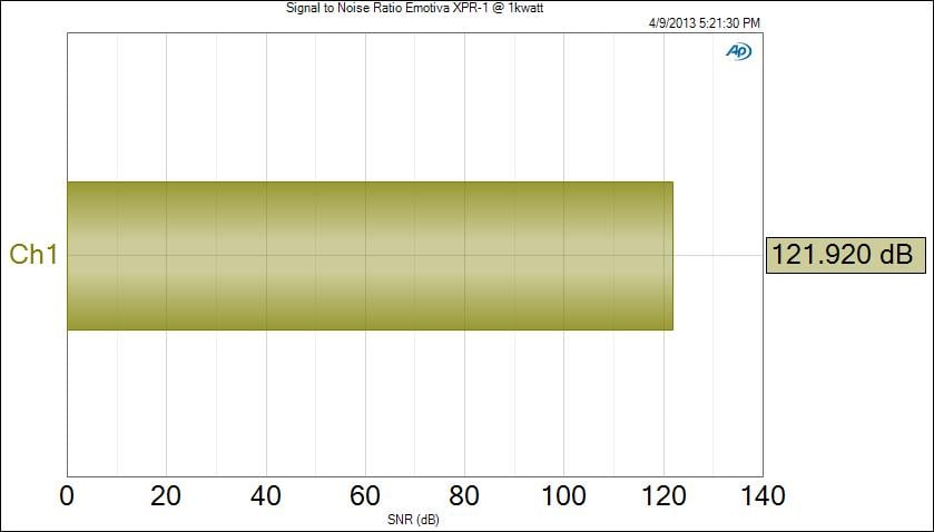

Emotiva XPR-1 SNR (A-wt) @ 1 watt (top pic) and 1kwatt (bottom pic)
The XPR-1 exhibited a very good low noise floor. At 1 watt I measured 91.6dB (A-wt) and 89dB with only a 20kHz filter engaged. Emotiva specifies 93dB (A-wt) which is close to my measurement. The small improvement with A-wt filtering engaged indicated this amp exhibited a very low out of band residual noise. At rated power (1kwatt), I measured 122dB (A-wt) which is significantly better than Emotiva’s published 118dB figure.

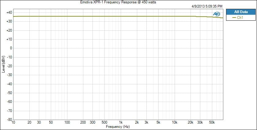

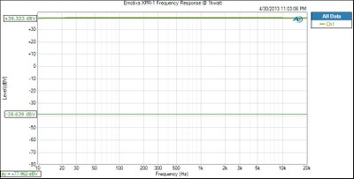

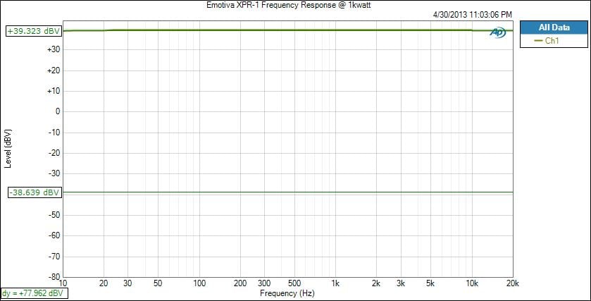

Frequency Response
Emotiva XPR-1 Frequency Response @ 450 Watts
The frequency response of the XPR-1 is ruler flat at virtually every power level from 10Hz to the limit of my measurement system (80kHz). This measurement was taken at 450 watts into an 8 ohm load! No slew-rate induced distortion was present here.

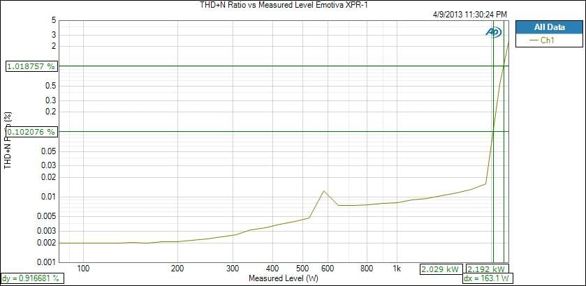

Emotiva

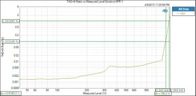

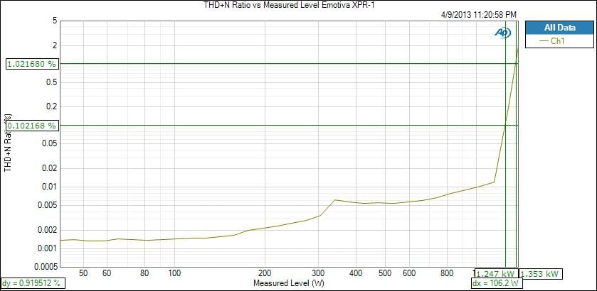

XPR-1 1kHz Power Test
Top Pic: 8
ohm load; Bottom Pic: 4 ohm load
The power sweep tests revealed the Emotiva XPR-1 to be the most powerful amplifier we’ve ever reviewed to date! The XPR-1 maintains Class A/B operation right up to the Class H switch point which can be seen as a bump in the above 1kHz power sweep tests at about 340 watts (8 ohms) and 500 watts (4 ohms). The XPR-1 is essentially identical in performance to their Class A/B XPA-1 amplifier below these switch points. The modest rise in distortion once engaged in Class H is a small trade off to pay for doubling available amplifier power.

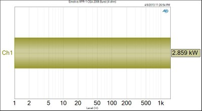

Emotiva
XPR-1 Dynamic Power Test (1kHz)
Top Pic: 8

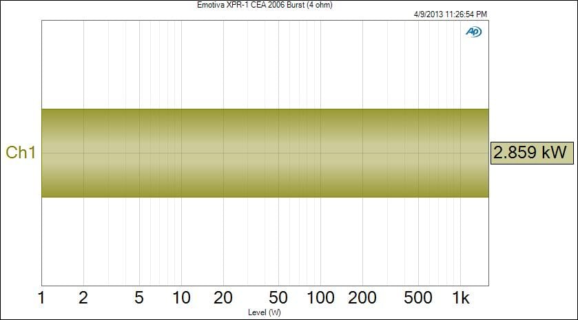

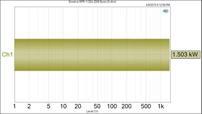

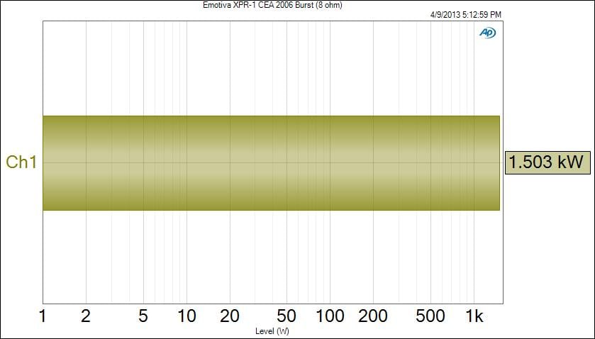

The CEA-2006 burst tests simulate musical program material. The power levels achieved by the XPR-1 for these tests are legendary. Into 8 ohms, the XPR-1 produced over 1.7 dB of dynamic headroom for 8 ohm loads and 2.13 dB for 4 ohm loads. A large power supply, lots of output devices and most importantly a very robust design really pulls off wonders here.

1 | Dynamic PWR | 1.5 kwatt | 8 ohms | 1% |
1 | Dynamic PWR | 2.86 kwatt | 4 ohms | 1% |

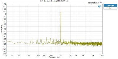

FFT Distortion Analysis
Emotiva XPR-1 FFT Distortion Analysis
(Top
pic: @ 1 watt ; Bottom pic: @ full power

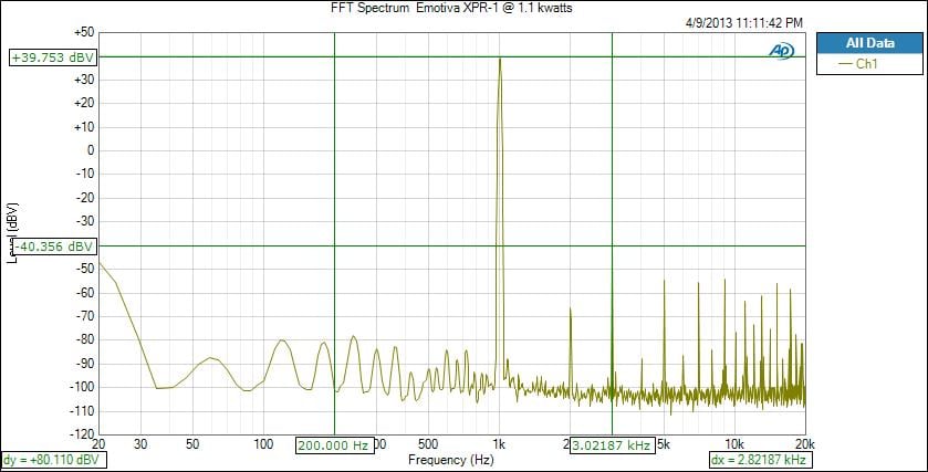

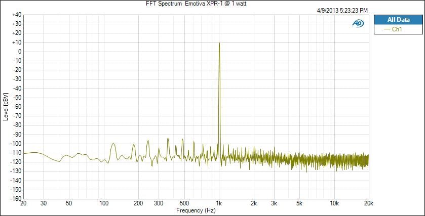

I ran FFT distortion plots at 1 watt (top pic) and at 1.1 kilowatt (bottom pic) to determine how clean this amplifier really is.
At 1 watt, the spectral distortion was below the noise floor of my measurement equipment which is another way of saying “awesome”! I did detect some residual noise -80dB down at 63kHz but not even you dog would be able to hear that.
At 1.1 kilowatts the XPR-1’s odd order harmonics dominated with the 3rd harmonic still being an impressive 80.1dB below the fundamental. I spot checked lower power levels (where the amp spends most of its time). I found the 3rd harmonic at 115 watts to be 97dB below the fundamental and at 300 watts the 3rd order harmonic was -91.7dB. This is darn good performance and really illustrates the distortion reducing benefits of a fully differential circuit topology.
