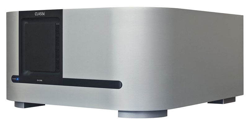

Classe CT-2300 Two-Channel Amplifier Design Overview
Classe electronics are designed and engineered in Canada and built at a state of the art facility in China. They offer two versions of this amplifier, the rack mountable CT-2300 (MSRP: $6,500) and the stand alone CA-2300 (MSRP: $7,000) Delta series. Both amps share identical internal components only the Delta version offers spruced up cosmetics since it’s meant to be out in the open as a showpiece instead of rack mounted and out of sight like the CT series. The $500 difference in cost between the two units reflects Classe’s extra manufacturing cost for the fancier housing. The CT-2300 was sent to me because it’s more readily available, but had I been on the market to buy this amp, I’d have opted for the CA-2300. In my opinion, it’s well worth it if you’re thinking about showcasing this amp out in the open. It just looks awesome.
Classe CT-2300 (left pic); CA-2300 (right pic)

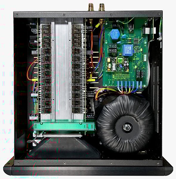

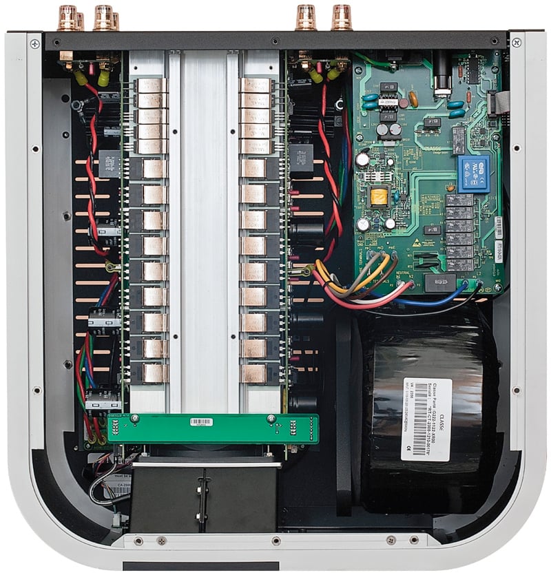

The Classe design goal for their Delta/CT series was to produce an amplifier module that would be as simple and compact as possible. Signal paths were kept as short as possible to preserve fidelity. Their 6 layer PCB board ensures this, and Classe claims these are their finest sounding and performing amplifiers they’ve built to date.
The CT-2300 employs a class AB amplifier topology with 18 bipolar devices per channel and 67,200 uF of capacitance (12 x 5,600uF) per channel. Ganging up multiple smaller caps is a great way of not only saving space but also lowering ESR (Effective Series Resistance) since each capacitor in parallel halves resistance while doubling in capacitance value assuming the same values are used throughout. The power capacitors are rated at 100V / 85 deg C. The voltage rating is plenty big to meet the 300 watt continuous rating (and 87.5V DC rail voltage), but I was a bit surprised Classe didn’t employ 105 deg C parts. 85 deg C is pretty much industry standard, but some companies go that extra mile and use higher temperature parts for increased longevity. As an EE myself that loves to overdesign stuff, I appreciate those little details. The amplifier topology is differential through the entire circuit path all the way to the final current stage. The power transformer is a torodial type rated at 2356VA which is nice and meaty. I have no doubt based on the sum of the parts thus far that this amplifier has a pair of cojones.
Classe talks about the CT-2300 requiring a break in period of up to 300 hours for the capacitors to fully form to provide the best audio quality. While there is some merit to this, I often feel manufacturers exaggerate the break in periods as a talking point for salespeople to convince their unwary customers debating on returning the product that performance will get even better over time. Take it with a grain of salt. Break in is real for bass drivers and to some extent capacitors. If someone tells you speaker cables break in too, suggest to them a healthy dose of Audioholics rehab and send them to our Cable University section of the site. Thermal equilibrium is however a different matter and Classe recommends a warm up period of 10-15 minutes before conducting critical listening. I do this with pretty much all amplifiers I listen to and also let them run 30 minutes loaded at 1 watt prior to engaging bench tests.
Classe has designed the CT-2300 amplifier to be safe from various fault conditions such as output overload, DC offset and the AC mains operating out of their nominal range (for 120V models that +15% to +10%). I find it commendable that the fine folks at Classe put forth so much effort to engineer proper protection into this amplifier. I was a bit surprised that the CT-2300 wasn’t switchable between 120/220V operation. I’ve reviewed much less expensive amplifiers that not only were switchable, but were also auto-detectable switchable.
A unique feature of this amp is how Classe chose to keep it running cool. Their proprietary method is what they refer to as ICTunnel. Their ICTunnel system is said to operate like the human hypothalamus which regulates body temperature. The ICTunnel utilizes an aluminum bonded-fin heatsink. It exploits the principle of low thermal mass, so it heats quickly but can also be cooled quickly. Inside its relatively small sized chassis are heatsink fins providing nearly 31 square feet of surface area. The fins are closely spaced to each other to maximize the surface area inside the tunnel, but not so close as to heat each other up. In conjunction with the critical spacing of the fins, a low noise fan along with pressure and temperature sensors maintain the amplifier's target temperature.
ICTunnel allows the amplifier to reach thermal stability within 15 minutes from power up. Once thermal stability has been reached, the heat sensors and the fan will keep the operating temperature stable regardless of how long the amp will be used (hours, weeks, months). The amp will also run cooler than a conventional amplifier using heat sinks which is a very important factor for both sound quality and long term reliability. The front face plate protruding nature is a result of the shape of the air intake that has been designed to allow air to circulate freely in the IC Tunnel while keeping turbulences and the resulting noise low. I even measured the idle power consumption when plugging this amp into my ACP S20 power conditioner and it was well under 100 watts. This is a lot of cool (no pun intended) tech for an amplifier and it works per my testing.

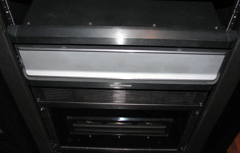

The CT-2300 includes adjustable rack rails to accommodate racks of different depth. I didn’t use them in my Middle Atlantic Rack since I already had a shelf in place. But, for those wishing to install the amp into their racks with the included rails, simply loosen the screws, extend the rails to the desired depth, fix to the front and back of the rack, and then re-tighten the screws. The user manual gives clear instructions and illustrations on how to do this and most consumers purchasing this amp will likely have a professional installer (recommended) do it for them anyways.

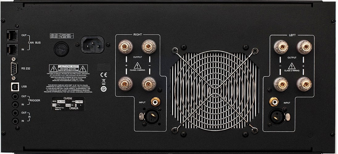

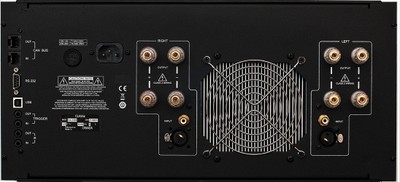

Classe CT-2300 / CA-2300 Back View
A good portion of back panel real estate of the CT-2300 is dedicated to fan exhaust for the ICTunnel system. The CT-2300 has quite a lot of connection points for a two-channel amplifier. That’s because it sports CAN-Bus controls to interface to other Classe products, USB & RS232 for firmware updates and to interface with Crestron/AMX devices, 3.5mm +5V trigger inputs/outputs, two sets of WBT 5-way speaker binding posts for bi-wiring, balanced and unbalanced input line level connections and a 3 prong power receptacle with a supplied 2 meter 14awg 3 prong power cord. The balanced input pin assignments are in compliance with AES14-1992 where pin 1 is Signal ground, pin 2 is Signal+(non-inverting) and pin 3 is Signal- (inverting). Make sure to check the polarity of your mating preamp when making your connections. I have found some gear flips pins 2/3 which would essentially flip the phase of the signal between the preamp and power amp.
CAN-Bus will allow a Delta or CT series Preamp/Processor touchscreen to:
Display status information for every connected unit, including amplifiers which do not have a touchscreen display.
Create a “PlayLink” that allows an SSP or Preamp to automatically switch to the correct input when a Delta series source component starts playback.
Adjust the global system brightness.
Configure the entire system to go in and out of standby at the touch of a button and also bring individual components in and out of standby.
Mute any connected unit

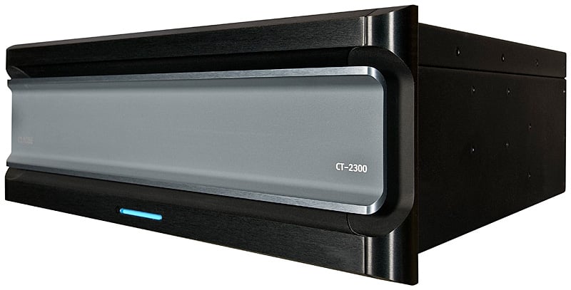

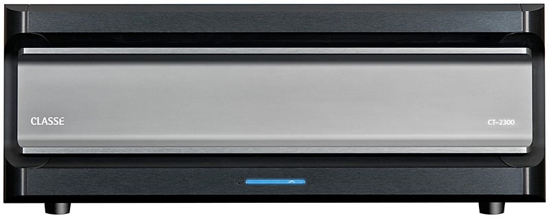

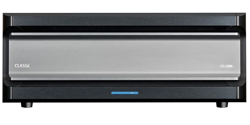

Classe CT-2300 (left pic) & CA-2300 (right pic) Front Panel View
The Classe CT-2300 won’t win any beauty prizes but the CA-2300 probably could. Both units are exceptionally crafted as expected for products of this price class. The only front panel user interface is the front panel illuminated button which serves as a status indicator and on/off switch.
On (dim red) = standby
Flashing blue (on power-up) = initialization
On(blue) = operating normally
Flashing (after power-up) = AC mains voltage out of range
Flashing (alternating red/blue) = the air intake filter needs to be cleaned
Slow flashing (red) = protection circuit(s) engaged

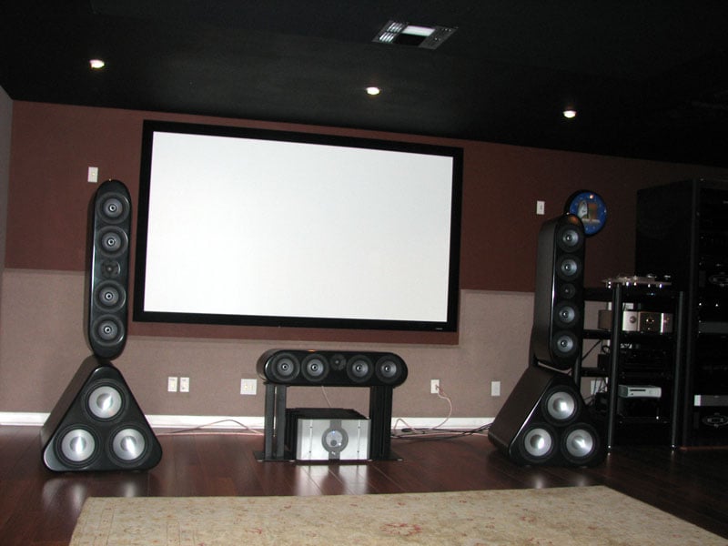

The 90lbs CT-2300 was as brute to haul up the flight of steps for
testing in the Audioholics Showcase Theater room. I connected the
CT-2300 to my Denon AVP-A1HDCI A/V processor via Bluejeans Cable
balanced interconnects and Kimber 8PR speaker cables with compression
WBT banana plugs to the new Status Acoustics 8T speaker system I
currently have under review. The source devices included the Oppo
BDP-95 and Yamaha MXC-2000 MusicCAST system. The listening space is
a 6,000 ft ft^3 room that is moderately acoustically treated,
courtesy of Auralex Acoustics.

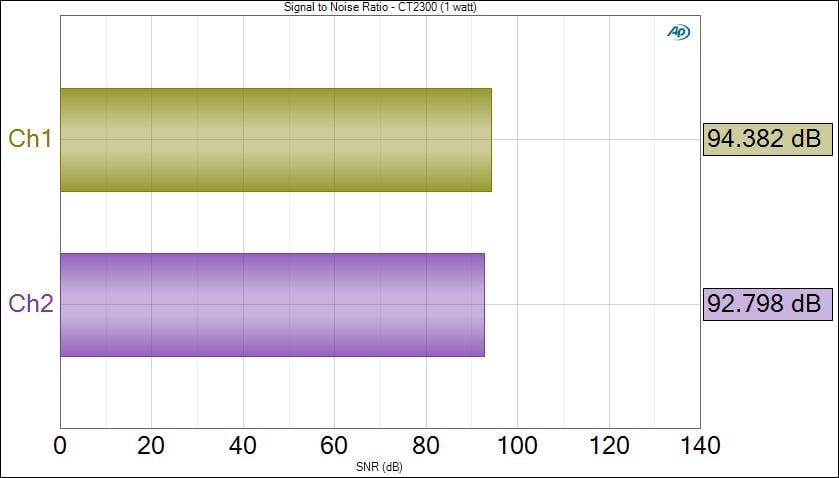

Signal to Noise Ratio
Classe CT-2300 SNR @ 1 watt (A-weighted)
The CT-2300 exhibited a very good low noise floor. At 1 watt I measured 94dB (A-weighted) and 92dB with only a 20kHz filter engaged. The small improvement with A-wt filtering engaged indicated this amp exhibited a very low out of band residual noise. At rated power, I measured 117dB which is slightly better than Classe specs the CT-2300 at.

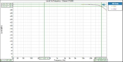

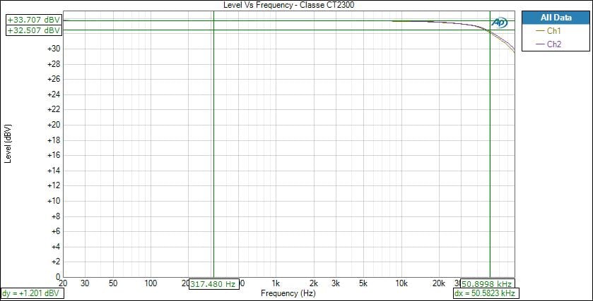

Frequency Response
Classe CT-2300 Frequency Response @ Full Rated Power
The Classe CT-2300 exhibited ruler flat bandwidth from 10Hz to 30kHz with a gradual roll-off of about -1dB at 50kHz and about -3dB at 80kHz which is what Classe specs this amp at. Frequency response linearity between both channels at 1 watt and full power was +-0.1dB for the entire audio band which was excellent. This indicates very tight tolerances in parts selection and excellent overall engineering.

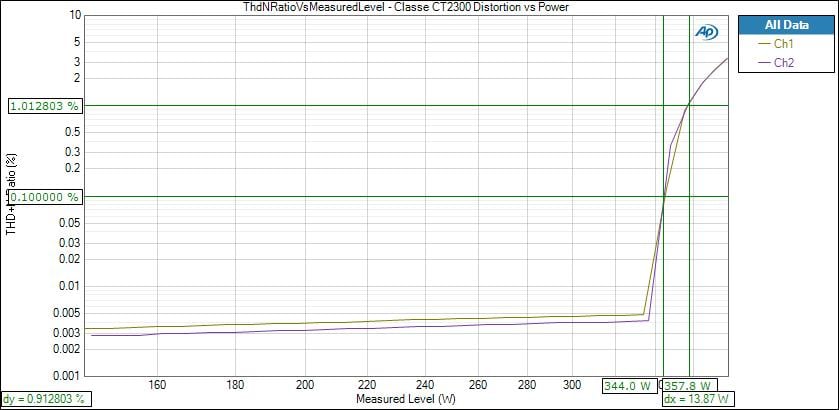

Power Measurements

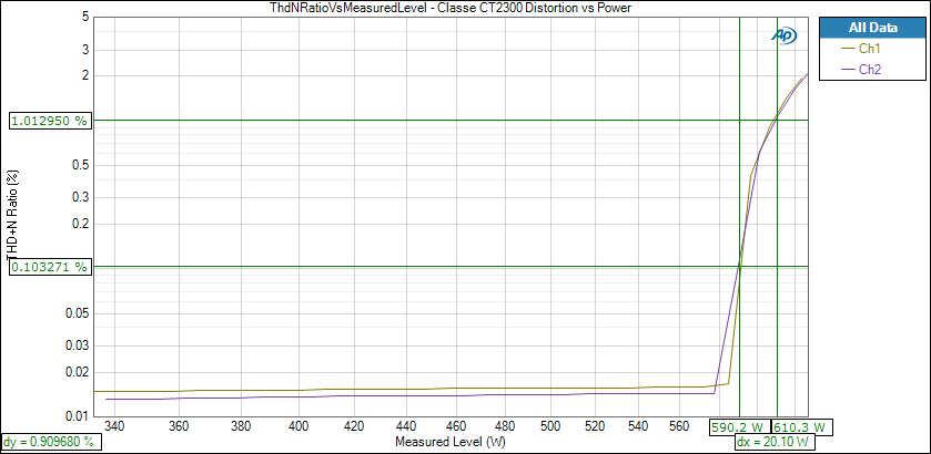

Using our Audio Precision APx585 8-channel HDMI analyzer, I conducted a full barrage of multi-channel amplifier tests on the Classe CT-2300. We tested power using three methods all of which were taken at < 0.1% THD + N:
Continuous Full Power Bandwidth (CFP-BW) from 20Hz to 20Khz into 8 and 4-ohm loads (up to two-channels)
1kHz Power Sweep vs Distortion (1kHz PSweep) - popularized by the print magazines, this is an instantaneous power vs distortion test at 1kHz. The problem with this test is it often masks slew related and or frequency response problems some amplifiers exhibit at the frequency extremes, and thus inflates the measured power results. It does provide an instant gratification # for consumers to argue over on the forums so we are now incorporating this test to please the masses.

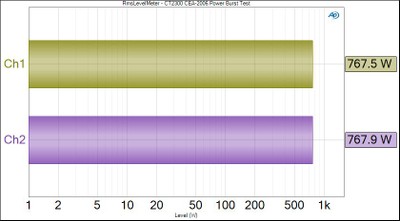

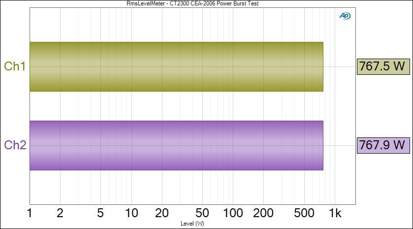

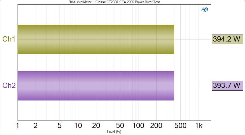

Dynamic PWR - 1kHz CEA-2006 Burst Method testing. This is a dynamic power measurement adopted from the car industry similar to IHF method only a bit more difficult for an amplifier and more representative of real musical content.
Keep in mind most review publications don't do continuous power measurements and they usually publish power measurements into clipping at 1% THD + N. Our measurements are very conservative as we use a dedicated 20A line with no Variac to regulate line voltage. We constantly monitor the line to ensure it never drops more than 2Vrms from nominal which in our case was 120Vrms.
For more info on amplifier measurements, see: The All Channels Driven (ACD) Test
Classe
CT-2300 1kHz Power Test
Pic: 2CH driven, 8 ohms; Bottom Pic: 2CH driven, 4 ohms
Classe
CT-2300 Dynamic Power Test (1kHz)
# of CH Test Type Power Load THD + N 1 CFP-BW 360 watts 8 ohms 0.1% 2 CFP-BW 340 watts 8 ohms 0.1% 1 CFP-BW 670 watts 4 ohms 0.1% 1 CFP-BW 700 watts 4 ohms 1% 2 CFP-BW 590 watts 4 ohms 0.1% 2 CFP-BW 610 watts 4 ohms 1% 2 1kHz Psweep 344 watts 8 ohms 0.1% 2 1kHz Psweep 357 watts 8 ohms 1% 2 1kHz Psweep 590 watts 4 ohms 0.1% 2 1kHz Psweep 610 watts 4 ohms 1% 2 Dynamic PWR 394 watts 8 ohms 1% 2 Dynamic PWR 767 watts 4 ohms 1%
Classe CT-2300 Power Measurement Table
Classe rates the CT-2300 as follows:
300 watts x 2 continuous @ 8-ohm
600 watts x 2 continuous @ 4-ohm
Classe doesn't specify at what frequency they rate their power output, but I assume they mean 1kHz which is how most manufacturers specify all channels driven power claims. They also don’t specify the power level or test conditions the specified distortion of 0.002% was conducted at.
The amp protection circuits shut down the CT-2300 when sweeping at full power (2CH driven) starting at 10Hz, but was fine when I raised the start frequency to 20Hz. This is something that would never happen in real world usage. It’s a smart idea to build in protection like this to increase longevity and reduce failures when reviewers (like myself) attempt to break products during our bench testing.
My measurements revealed that the CT-2300 is a true powerhouse and lives up to the published power figures Classe specified for this amplifier. Since we don’t use a Variac to hold line condition constant, it’s very difficult to get accurate distortion measurements at full rated power. Although the amp was showing 1% distortion driven at full power into 4 ohms, the analog waveform was still very smooth and unclipped.
The CT-2300 produced virtually identical full power bandwidth and 1kHz power sweep tests indicating that the power supply and output devices were robust enough to deliver full rated power at any audio frequency, not just a sweet spot. This is just one of many hallmarks indicating the CT-2300 is a seriously great amplifier. The dynamic power results were likely limited by the wall current of my test setup. I suspect under ideal test conditions, the CT-2300 would have more available dynamic power. At these power levels, who cares? The CT-2300 could drive virtually any speaker load. I didn’t need these test results to be convinced after just a few short listening sessions powering my new Status Acoustics 8T reference speakers.

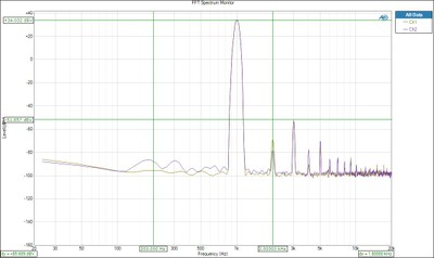

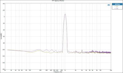

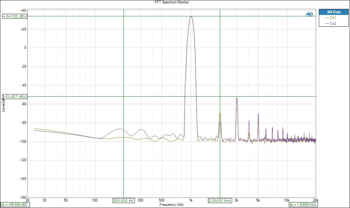

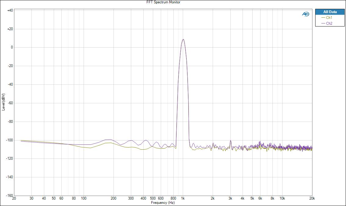

FFT Distortion Analysis
Classe
CT-2300 FFT Distortion Analysis
(Top
pic: @ 1 watt ; Bottom pic: @ full power)
I ran FFT distortion plots at 1 watt (top pic) and full rated power (bottom pic) to determine how clean this amplifier really is. At 1 watt, the spectral distortion was below the noise floor of my measurement equipment which is another way of saying “awesome”!
At 316 watt, I observed the 3rd harmonic (34.032 + 51.67)dBV being 85.7dB down from the fundamental or 100*alog^-1(-74.1/20) = .0052% The odd order harmonics start dominating as the amp starts hitting the rails and becoming slew rate limited at very high frequencies. This is really a great result and shows how over designed this amplifier really is. When I lowered the power level to 300 watts (rated power) the 3rd harmonic dropped and the FFT looked excellent; perhaps one of the best results we’ve seen from any amplifier to grace our test bench.

It is important to note that with the faceplate installed, the CT-2300 won’t flush mount to your rack like other component gear often does. While there is nothing wrong with that, it may look a bit odd like it does in my case having one of your components in your rack protrude while the others do not. It also makes it easier for an envious audiophile friend to pull a heist on you when you’re not looking so watch out.
If you’re planning on installing this amplifier on a shelf or floor mounting it, I’d suggest considering spending the extra $500 for the CA-2300 version. An amp that performs this good deserves to flaunt its stuff in fancy clothing.
