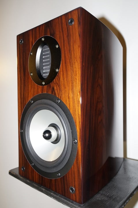

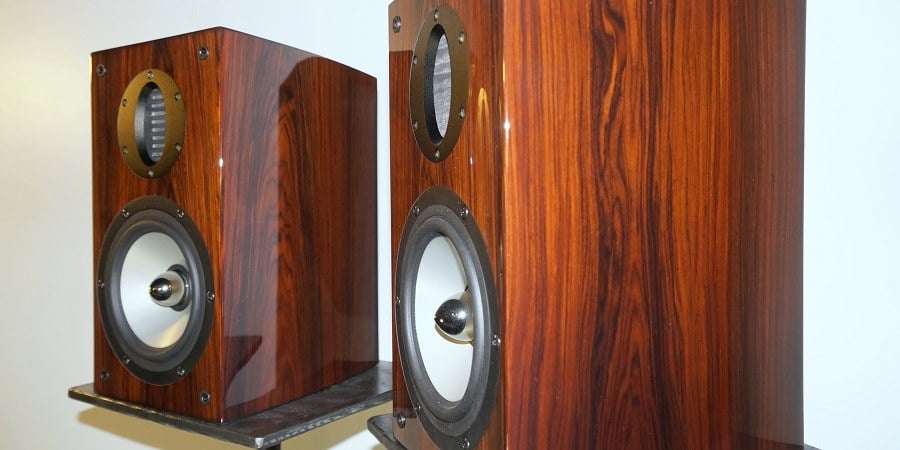

Appearance

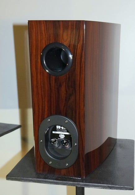

The SV-61R speakers arrived at my doorstep packed fairly well. The box was lined with cardboard edge protectors on all edges. Two thick foam pieces sandwiched the speaker and protected it from shock or deep box punctures. It was covered with a white cotton back to protect it from moisture and scuffs. The speaker itself took me by surprise by the elegance of its finish when I unveiled it. The high-gloss rosewood may be the most luxurious finish on any speaker I have had in my home to date. It was very polished and high-end but without being over-the-top at all. The curvature of the cabinet side-panels made the appearance of the speaker all the more alluring.

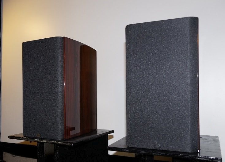

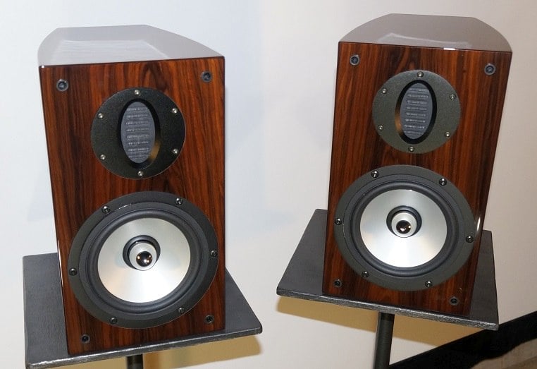

However, the grille very much diminishes its charms. To be sure, the SV-61R does not look bad with the grille, but it does look quite a bit duller. I know a grille is a standard accessory to speakers these days, but so long as the drivers and baffle do not look too mechanical, grilles seem to serve little purpose outside of a minor amount of protection for the drivers. Grilles almost always hurt performance as well, by creating additional diffraction surfaces. Without the grille, the SV-61R looks sharp; against the lustrous rosewood baffle, the glistening aluminum cones, and the round, dark AMT tweeter frame serves as a staid counter-balance to the sparkling phase plug. With the grille on, front of the speaker just turns into a flat, black rectangle. Use this speaker without the grille if you can!
One small criticism I have is that I would expect a speaker of this price point to have magnetic grilles. That way you can rid of the grille guides for a cleaner front baffle, and it also makes for an easier attachment and removal of the grille. Hopefully, RBH will consider this small alteration in future production!

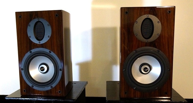

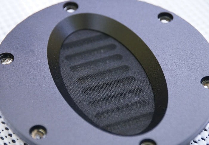

The SV-61R doesn’t look to make any radical departures in design from conventional two-way bookshelf speakers, aside from using higher-end components. There is certainly nothing wrong with that, since, if implemented well, it is a proven design that can bring terrific results. The SV-61R uses an AMT tweeter, which is a folded-ribbon design that has become a popular tweeter type in recent years. I will describe the AMT function by simply quoting from our description from the last Audioholics review of an AMT speaker (Monoprice Air Motion speakers):

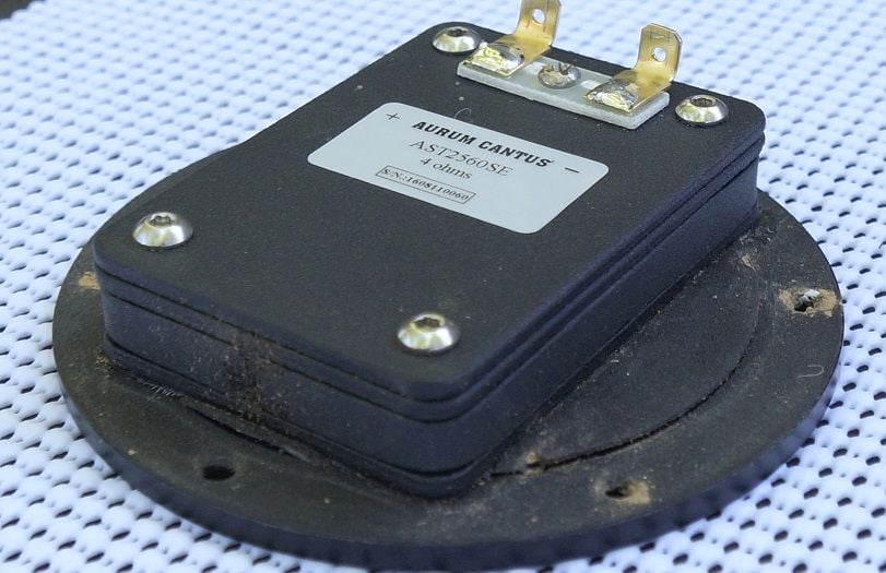

“AMT stands for “Air Motion Transformer”. As opposed to conventional dome tweeters that pistonically oscillates a little dome, AMT tweeters contract and expand the folds of a pleated membrane to produce sound. To explain using an example, imagine the folded surface of a half-closed curtain- then line the interior folds of the curtain with conductive rods on adjacent sides of the folds, and set two powerful magnets on the sides of the curtain. Run some alternating current through the conducting rods and their newfound electromagnetic field will rapidly collapse and expand the folds of the curtain, and, in doing so, squeeze air in and out of the folds thereby creating pressure waves that we experience as sound.
A major advantage in this design is that since the folds of the diaphragm are much deeper than they are wide, air is ejected out much faster speed than the vibration of the diaphragm itself- as much as five times faster. Another advantage is the very light mass of the diaphragm that makes it very easy to move and to change direction since it does not have the momentum of the weight of typical dome tweeters. These elements give AMT tweeters an extended response well into ultrasonic frequency ranges. Also, since AMT tweeters can have a relatively large surface coupled with the air, they can have a very wide dynamic range.”
RBH Sound had eschewed AMT tweeters until recently because they felt the available AMT tweeters were not outperforming the ScanSpeak dome tweeters that were used in their Reference speakers. That changed when they co-developed an AMT tweeter with Aurum Cantus which had performance characteristics that warranted inclusion in their flagship speakers. The tweeter used in the SV-61R is a part of Aurum Cantus’ ‘Aero Striction’ line of smaller AMT tweeters, which have relatively smooth, linear responses, high sensitivity, and very little stored energy, which makes for a good transient response.

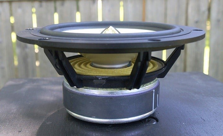

The SV-61R woofer is also a noteworthy addition. It is based on a design that has been evolving since the mid 90’s that has an extended high-frequency response. RBH claims its aluminum cone has great damping properties that can maintain its pistonic motion at high SPLs. The version used in the SV-61R has a few differences from the standard version, with the most remarkable difference being the gleaming, mirror-textured phase plug. The phase plug is more than just a pretty adornment; it reduces interference of sound waves produced by different sections of the cone and so enables a smoother response. It also improves power-handling by reducing thermal compression by venting the voice coil.

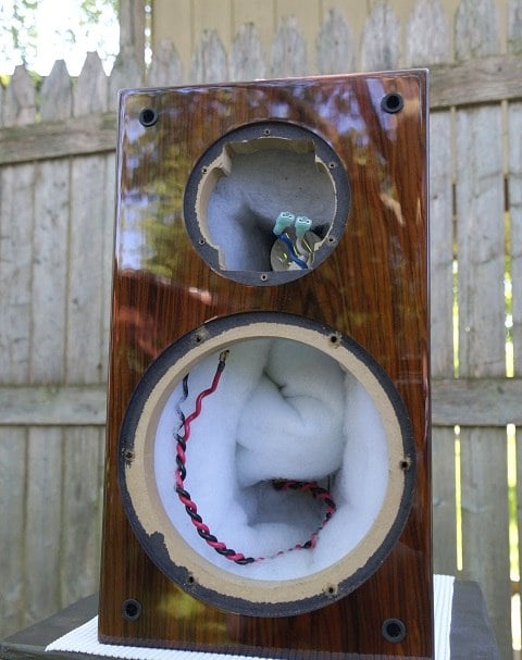

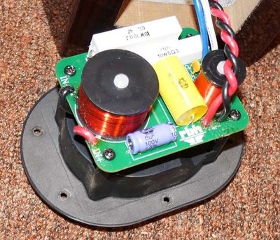

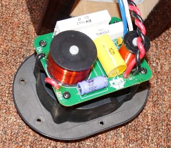

The crossover also shows an attention to detail befitting a speaker of this price point. On the crossover board, we see four chunky propylene capacitors (two on top, and two on the reverse side of board), a polyfuse used for tweeter protection, two beefy-looking inductors, and two resistors. The crossover between drivers is spec’d at 2700 Hz with a 2nd-order (12 dB/octave) slope. RBH uses high-quality metalized capacitors, low DCR coils for the midwoofer, and 14 AWG cable for wiring to the drivers.
The cabinet is of sturdy construction. The front baffle is 1” thick MDF, and the other panels are all 3/4” thick. There is a ½” thick window brace between the tweeter and woofer. It is generously stuffed with Dacron. Supposedly, the curvature of the side-panels can help reduce resonant peaks from internal standing waves. The back of the SV-61R has a rear-firing port and a terminal cup with some heavy-duty binding posts.

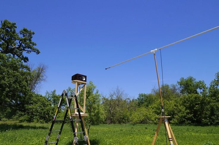

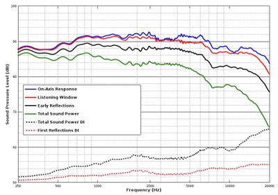

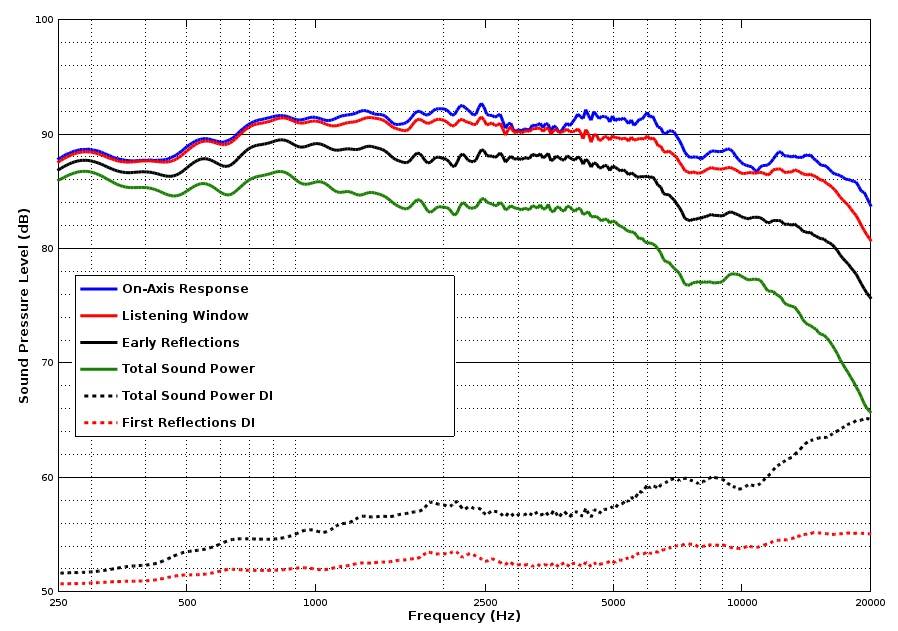

The RBH SV-61R bookshelf speakers were measured in free air at a height of approximately 7.5 feet and gated at 9 ms. At this window gate, some resolution is lost below 250 Hz, and accuracy is completely lost below 110 Hz and so that range should be ignored. The microphone was placed 2 meters away from the speaker at a height level with the tweeter. All measurements are unsmoothed.
RBH SV-61R Bookshelf Speaker Response Curves

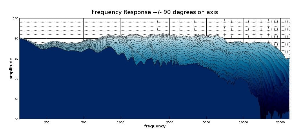

The SV-61R speakers have a very good response overall. They are a tad soft in upper treble frequencies, taking a 3 dB dip above 7 kHz with respect to the rest of the response, but that isn’t an audible character that I noted when I was listening to them. Note the marvelously flat response from 600 Hz to 6 kHz. There is very little evidence of the 2700 Hz crossover point between the drivers. This is a crossover done right. One admirable trait is the similarities of the early reflections curve and listening window curve to the direct axis curve. This means the speaker will sound the same even well away from the direct axis angle. Another aspect to note is the very gradual rise on the directivity index curves; it is mostly pretty flat up to 5 kHz. This means that the directivity, or the off-axis energy, does not change substantially within that frequency band. More evidence of this property will be seen in the polar map graph below. For a good explanation of these curves and their significance, we refer the reader to this Audioholics article: Objective Loudspeaker Measurements to Predict Subjective Preferences.

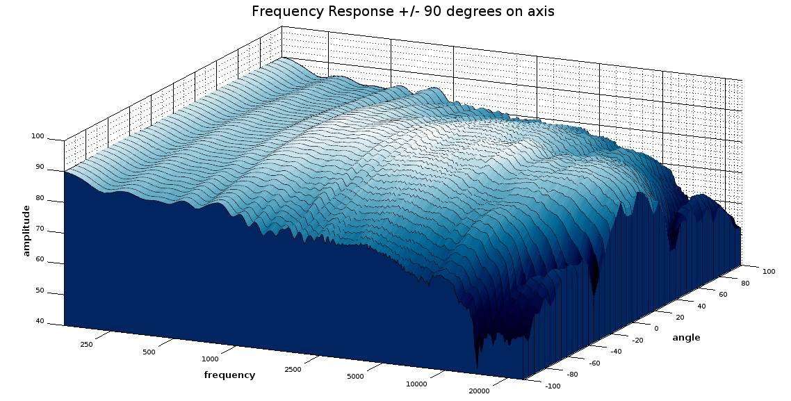

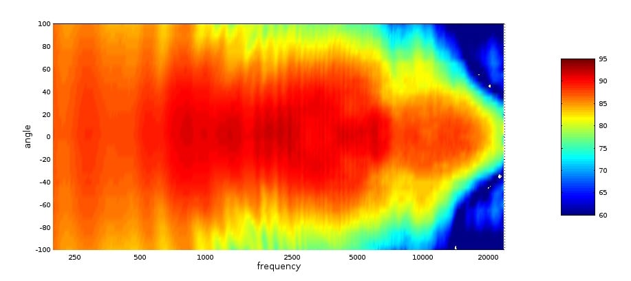

RBH SV-61R Bookshelf Speaker horizontal frequency response +/- 100 degrees: 3D view
RBH SV-61R Bookshelf Speaker horizontal frequency response +/- 100 degrees: 2D view

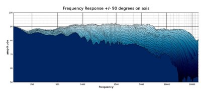

The above graphs depict the SV-61R’s axial response out to 100 degrees in 5-degree increments. Again, we see the terrifically neutral power response from 600 Hz to 6 kHz. The response drops a bit below and above that band, but still remains flat after the drop. The off-axis response beautifully mirrors the direct response and does not significantly change in shape except for a gradual narrowing of directivity. This dispersion behavior is textbook perfect for this type of design and design goal. The dispersion is wide and uniform in shape. This is a speaker that will sound the very close to the same on and off-axis. It will cover a very wide listening angle with essentially the same sound quality. If you have a broad listening area, this speaker is a great choice. Furthermore, the acoustic reflections of the speaker in the room, which is most of what we hear in normal listening situations, will not have deviations from the sound character from the direct axis response. So, this speaker will sound great in almost any room. You do not need a room with heavy acoustic treatments to get the SV-61R speakers to sound good. They are designed to sound good in any normal domestic environment.
The flattest response occurs on direct axis, but those who want to shave a little energy off the high frequencies for a warmer sound can toe them in or out by 20 or 30 degrees or so and that may subdue some of the treble energy. My advice is to listen to them on direct axis, and, if possible, with grilles removed. As with so many other speakers, the grilles do put some nicks in the treble frequencies from diffraction effects, although those negative effects aren’t really that audible. However, for the absolute best response, leave the grilles off.

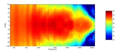

RBH SV-61R Bookshelf Speaker Polar Map
The above polar map of the horizontal dispersion of the SV-61R speakers depict the same information as the two waterfall graphs above, but tells the story in a different way that can offer further insight regarding its behavior. We see again the fabulously controlled dispersion up to 6 kHz. Dispersion tightens a bit above 6 kHz but still maintains a respectably even response up to 20 kHz out at a 40-degree angle away from the direct axis. The story here is that the SV-61R speakers have a very uniform response over an 80-degree angle from the front of the speaker. If you listen anywhere within that angle, the speaker will not change much in sound character. These are not speakers that have a small ‘sweet spot’ or a single narrow position of good sound and not really anywhere else. All you have to do is sit somewhere in front of them and they will sound good. Again, listening on direct axis would be best, but you lose relatively little by sitting 25 or even 35 degrees off axis.

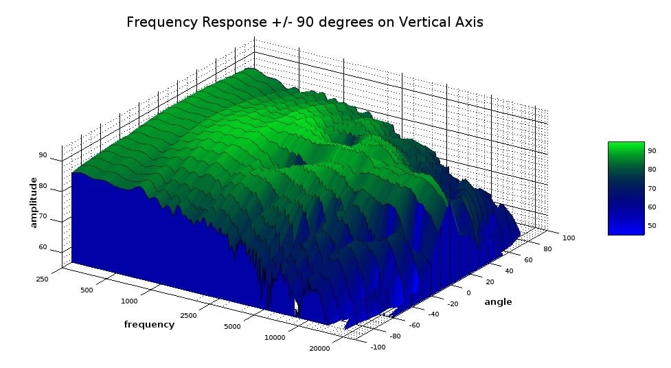

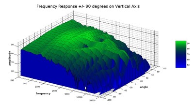

RBH SV-61R Bookshelf Speaker vertical frequency response +/- 90 degrees: 3D view
The above graph depicts the SV-61R’s frequency response behavior on the vertical axis, so zero is directly ahead of the tweeter, -90 degrees facing the top of the speaker, and 90 degrees is facing the bottom. Uniformity in dispersion on the vertical axis isn’t nearly as important as it is for the horizontal axis, but it certainly does not hurt to have well-behaved vertical dispersion performance, and the SV-61R speakers do well on this front. We do see some notches centered at 2.5 kHz at the 20-degree angle that are interference effects from the tweeter and woofer canceling each other out. This is common and will affect any speaker that has drivers separated by a distance that lay on the same plane. As with many other speakers of this type, these should be listened to with the tweeters at or near ear level.

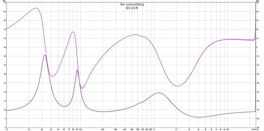

RBH SV-61R Bookshelf Speaker Electrical Impedance and Phase
The SV-61R’s impedance curve exhibits an overall benign load. Impedance stays above 8 ohms until up to 3 kHz. At its lowest, it dips down to 6 ohms from 4 to 5 kHz, but the phase angle is not extremely steep around this minima, so this is not a particularly taxing load at any one point. All steep phase angles occur at high impedances, which makes for an easy amplification load. We can see from the dip in the low-frequency saddle that the port tuning frequency is 60 Hz. This speaker can be easily run on any amplifier and has no special amplification requirements at all. This is evidence of smart design and well thought-out engineering.

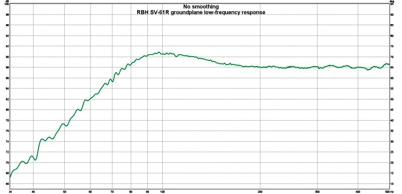

RBH SV-61R Bookshelf Speaker low-frequency response
Since the 7.5 foot elevation of our free-air testing doesn’t allow us to get a sense of the low-end response of the SV-61R speakers due to the acoustic reflections of long wavelengths of low frequencies, we conducted ground-plane measurements which do give us a useful bass response. We can see the SV-61Rs have a slight 2 dB rise in the response centered at 100 Hz, but for the most part, the low-frequency response is quite flat. The low end starts rolling off at 80 Hz, so these are clearly intended to be used with a subwoofer with the normal 80 Hz crossover frequency. This is a very sensible design choice, since extending the low-frequency response lower would necessitate lower sensitivity or a larger cabinet and port.
