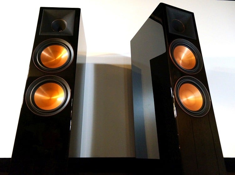

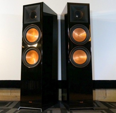

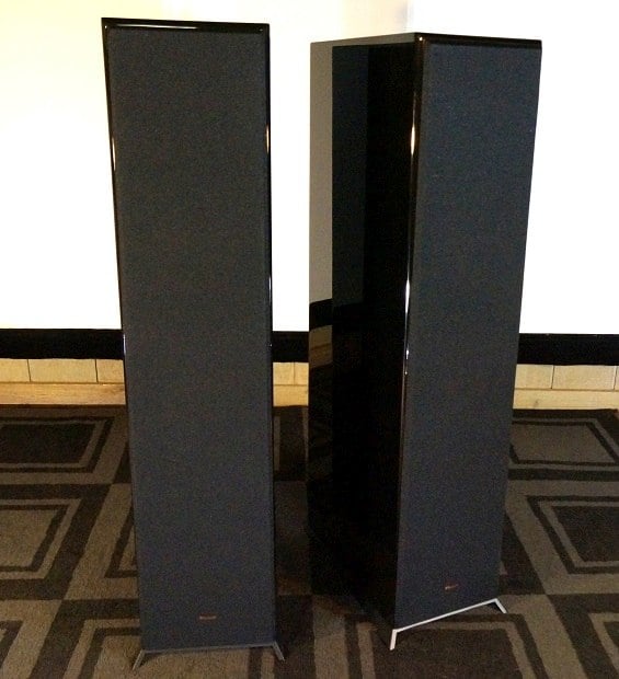

The RP-8000F is a bit larger than most tower speakers, but it is not gigantic as tower speakers go. With the grille on, our piano black RP-8000F is a gleaming, tall, black box. With the grille removed, we are presented with Klipsch’s hallmark copper cones and Tractrix horn-loaded tweeter. As always, the speaker has a lot more personality with the grille off. The feet are just rails that hold the speakers at a slight upwards tilt, so it does not stand at a perfect 90˚vertical angle. The frame of the cones has a copper ring around them, and there is a copper ring within the Tractrix horn; these rings add a nice bit of refinement.
Also adding a touch of class is an increased beveling of the edges moving up along the speaker’s height. The piano black finish, slightly angled stance, and gradual beveling give the speaker some style even with the grilles on. These touches along with the elegant copper rings lend it a degree of sophistication that makes this tower speaker look more attractive than many of the Klipsch speakers I have seen in the past. In fact, this is the nicest-looking Klipsch speaker I can recall seeing except for the discontinued Palladium series that were far more expensive. The overall effect is of something that is debonair yet powerful, almost like a well-heeled MMA fighter. The large 8” woofers and horn-loaded tweeter give it an undeniably muscular cast that can’t be ignored but they are implemented in a very attractive manner.

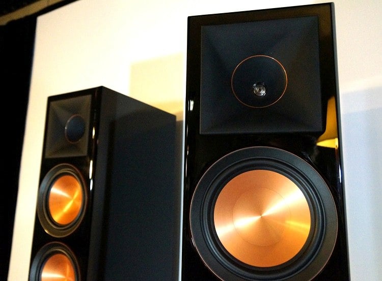

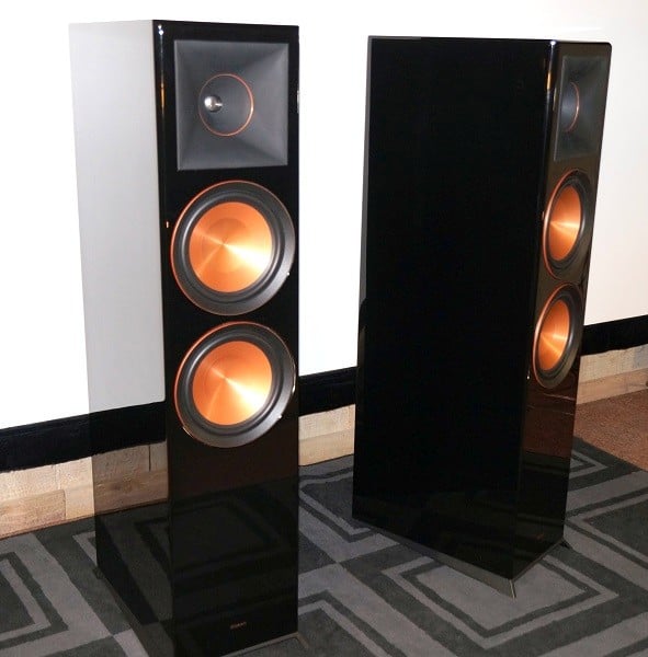

As a large tower speaker with two 8” woofers and a horn-loaded tweeter, the RP-8000F is bound to be a relatively powerful loudspeaker for home audio. More acoustic firepower is always a good thing, but what about the sound quality? There is a lot in its design to suggest that great care was taken into making the RP-8000F into a very high-fidelity speaker. Let’s start our discussion of the RP-8000F’s design with an attribute of speaker design that Klipsch has long been known for: the horn.

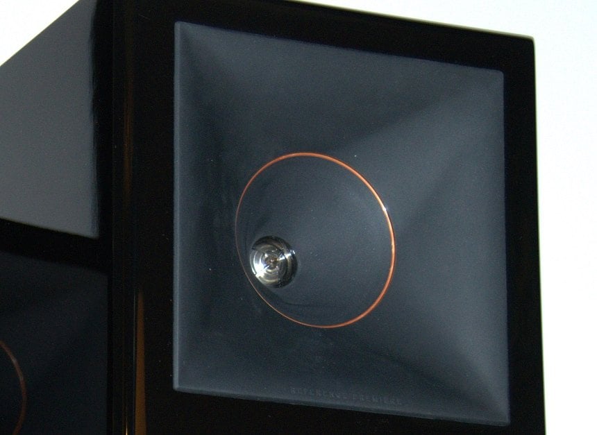

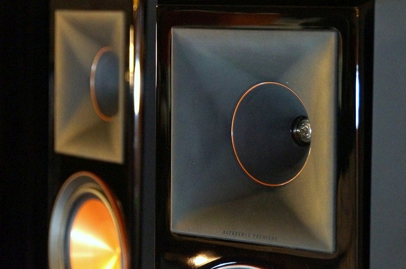

In horn-loaded loudspeakers, the geometry of the horn shape plays a big role in determining its sound character. The RP-8000F uses what Klipsch calls a “Hybrid Cross-Section Tractrix” horn. This geometry looks to be shared by all the Reference Premiere line but is different from the previous standard Reference line that also used a tractrix horn. I would guess that this new geometry offers some significant improvements over the older Tractrix horn shape since Klipsch has entirely abandoned that design in favor of its “Hybrid Cross-Section” tractrix design. A Tractrix is a geometrical term which signifies “the Catenary Involute described by a point initially on the vertex” to use one (very technical) definition. It is a shape that is used in loudspeaker horns under the assumption that the emerging pressure waves expand out from the transducer diaphragm as a spherical wavefront. As the wavefront exits the horn, it will constantly be at a perpendicular angle to the edges of the horn. This supposedly helps to reduce horn related anomalies such as odd reflections in the horn itself and also diffraction effects.
Klipsch has divided the RP-8000F horn into two sections by the copper ring embedded into the horn. The inner section is a conical plastic piece which serves as the throat of the horn, and the outer section, the mouth of the horn, is a softer silicone piece that takes on a more orthogonal shape. The softer silicone material of the mouth is used to avoid bell resonances in the horn. The throat of the horn is a round conical shape in order to reduce early diffractions as the soundwave leaves the tweeter diaphragm. The squarish mouth shape governs its dispersion pattern. A 1” titanium dome tweeter is used to load the horn, and it uses what Klipsch calls the ‘Linear Travel Suspension’ system which is a carefully designed suspension that allows for larger excursions of the moving assembly before the suspension thwarts linear motion thereby incurring distortion. Titanium seems like a natural choice for the diaphragm material since the horn-loading and lower crossover point might be more than softer dome types such as fabric could withstand. The rear chamber of the tweeter is vented to allow backwave energy to better dissipate instead of being reflected back into the diaphragm which would also increase distortion. The tweeter motor uses a ferrite magnet instead of neodymium, and this can help reduce effects of thermal compression since the larger surface area is able to radiate more heat than the smaller surface area of a neodymium motor.

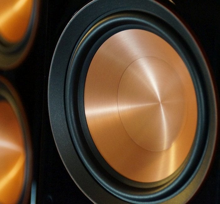

Two large 8” woofers take the bass duties as well as some of the midrange. Klipsch has named the woofer’s cone composition ‘Cerametallic.’ This seems to be an aluminum layer that has been hard anodized to form a ceramic coating which is stiffer than the aluminum substrate and also dyed a copper color. The ceramic coating makes the cone stiffer than pure aluminum thereby pushing breakup modes to higher frequencies that are easier to filter out by a crossover circuit. The aluminum layer provides a light but strong platform for the ceramic layer and also provides additional damping due to the differing densities of the materials. I can’t be sure of how well it works versus a plain aluminum cone, but I am sure Klipsch would not go through the trouble of anodizing all of their cones if the effects were insignificant.

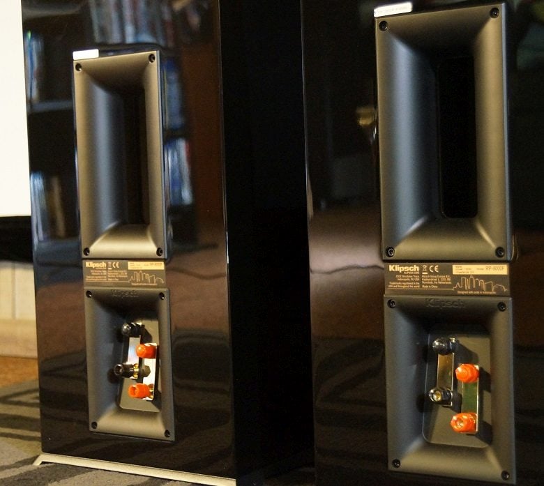

For deep bass, the bass drivers load a short, rectangular port that is flared on both sides using a tractrix geometry like the horn. I can’t think of a reason why a tractrix shape would have an advantage over a typical flare shape in a port, but it probably isn't significantly worse. I think that maybe someone over at Klipsch really likes the word ‘tractrix.’ The port is mounted right above the terminal cup that has dual 5-way binding posts for those interested in bi-amping. As I have said in previous reviews, I don’t believe that bi-amplification is a useful feature for conventional home audio speakers of this type, but Klipsch’s marketing research probably concluded that was a feature that consumers wanted, so they threw it in there. At least it’s not doing any harm except for a slightly higher cost.
I was not able to get a good look at the crossover since it wasn’t easy to disconnect from the rest of the speaker, but it uses a 1,750 Hz crossover frequency with a 4th order electrical high pass and a 2nd order electrical low pass that combine with the natural response of the drivers to give an approximate 6th order acoustical response. The horn-loading of the tweeter allows a much lower crossover frequency than traditional non-horn-loaded speakers since the horn provides more acoustic impedance against the diaphragm, or, to put it another way, the air within the horn provides more pressure against the tweeter diaphragm since it can only travel in a narrow, enclosed space instead of a free, open area. That extra force against the tweeter allows far more efficient low-frequency output from it because the greater pressure is a better match for the tweeter’s density than the more open air of a flat baffle.
The cabinet is a fairly heavy construction and comprises the vast majority of the speaker’s 60 lbs weight. The paneling and bracing all use ¾” thick MDF. There is a series of cross braces and also two vertical braces running up the sidewalls to reduce panel resonance. There is also a generous amount of stuffing filling the cabinet. As was mentioned before, instead of normal feet, the RP-8000F uses some cast aluminum rails that hold the cabinet up at a slight angle. Even with the slight angle, this tall tower speaker has a very stable stance. In fact, it feels more planted to the ground with better stability than most other tower speakers I can remember using. I wouldn’t mind seeing other manufacturers start using this type of feet.
The overall design of the RP-8000F suggests a speaker that is highly efficient and also one that has a relatively narrow directivity for a home audio speaker. The large size, large woofers, and horn-loaded tweeter should make for a high-sensitivity design. The large woofers and horn-loaded tweeter should also do a lot to restrict the sound to a tighter dispersion pattern than the typical speaker using domes or AMT tweeters on a flat baffle or that might be mounted in a shallow waveguide for some controlled coverage. This doesn’t necessarily mean that the ‘sweet spot’ or listening area is small, but it should make for a sound that is less affected by acoustic reflections from room surfaces. But, to get a sense of its sound character, let’s do some listening…

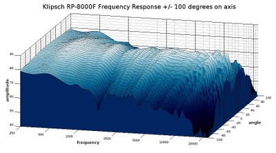

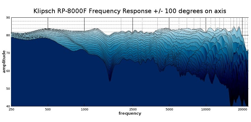

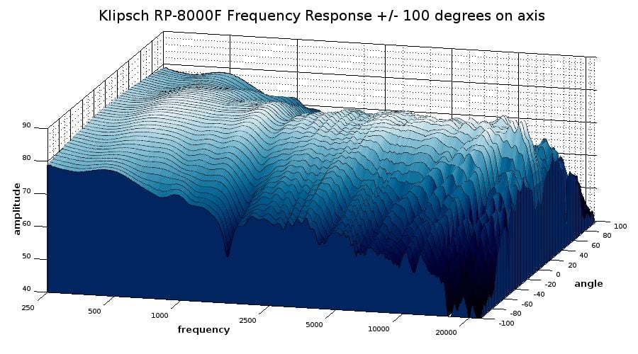

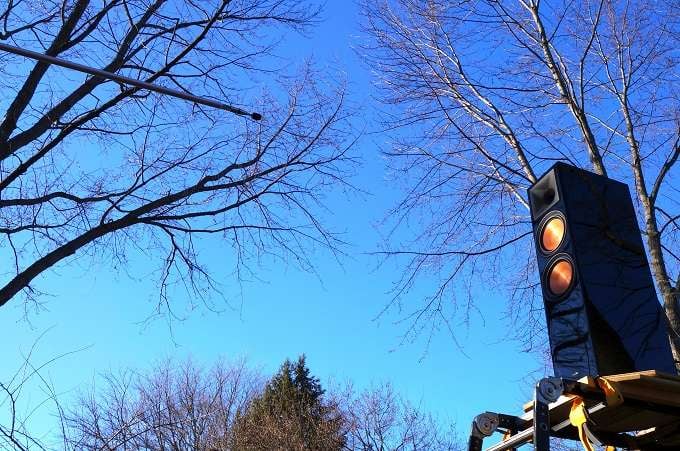

The Klipsch RP-8000F speakers were measured in free-air at a height of 4 feet at a 2-meter distance from the microphone, with the microphone raised to a 7’ elevation that was level with and aimed at the tweeter center. The measurements were gated at 5-milliseconds. In this time window, some resolution is lost below 400 Hz and accuracy is completely lost below 200 Hz. Measurements have been smoothed at a 1/24 octave resolution.
Klipsch RP-8000F Horizontal Response +/- 100 degrees
The above graphs depict the Klipsch RP-8000F’s direct-axis and horizontal dispersion out to a 90-degree angle in five-degree increments. The first thing to note is how remarkably flat the direct axis response is. For all of Klipsch’s reputation of having sizzling hot treble, it just isn’t here. This is a very neutral response. The region between 1.5 kHz and 4 kHz does have an approximately 2 dB shallowness, and that slightly recessed upper midrange might make the speaker sound slightly bright compared to a totally neutral response, but it wouldn’t be very noticeable otherwise. In fact, in my listening, I wouldn’t have characterized the speaker as ‘bright’, although not ‘warm’ either. It sounded neutral to my ears, and that is basically what is being displayed in these measurements. What’s more is that this midrange recession happens right below the range where most treble tone controls attenuate, so those who want a warmer sound can simply bring down the treble tone control by a few dB. One small blemish that we see in these graphs is there is a null around the crossover point that ends up turning into a fairly high Q dip at far-axis angles. This isn’t really a serious flaw since it is not a very wide bandwidth dip, and it doesn’t subtract much until one is very far off-axis, but I don’t think very many people are going to be listening to these things at angles greater than 50 degrees. It is an imperfection, but it isn’t likely to be very audible.
We do see some interesting diffraction effects occur off-axis at very high frequencies, and these may be coming from the interior of the horn. They are not likely to be audible at all for a variety of reasons. One reason is that they are far too narrow bandwidth to make a serious difference, and another is that, as diffraction effects, they change in frequency at different angles and different distances, so they would not be a persistent tonal effect. They also occur at such high-frequency bands that many people are not very sensitive at that range and wouldn’t be able to discern small ripples of such modest amplitudes. They are an interesting acoustic effect to observe in measurements but are not likely to mar the sound. The bottom line for this set of measurements is that the RP-8000F is showing itself to be a relatively accurate loudspeaker.

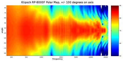

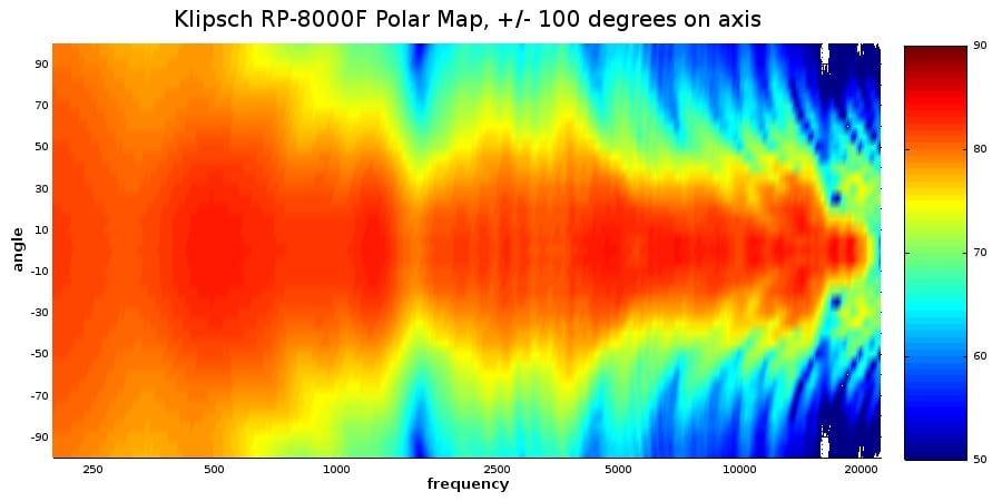

Klipsch RP-8000F Polar Map of Horizontal Response +/- 100 degrees
The above graphs show the same information that the preceding graphs but depict it in a way that can offer new insight regarding these speakers’ behavior. Instead of using individual raised lines to illustrate amplitude, these polar maps use color to portray amplitude, and this allows the use of a purely angle/frequency axis perspective. The advantage of these graphs is they can let us see broader trends of the speaker’s behavior more easily. There is a lot of good news in this polar map of the RP-8000F’s horizontal response. We can see that the hybrid tractrix horn does a pretty good job of controlling dispersion all the way up to nearly 16 kHz. Between 15 to 16 kHz, the tweeter is beaming pretty hard, so it is not really interacting with the horn anymore. That is not a big deal since not many adults can hear well at such high frequencies, but those who don’t want to miss this range should listen within a +/- 15-degree angle of direct axis. The horn keeps dispersion pretty stable within about 35 degrees of direct axis from about 2 kHz and above, with some minor flares near the bottom of its passband. Although there is waistbanding around the crossover frequency of 1,750 Hz, the 8” woofers are otherwise well-matched in directivity to the horn in this region in that they do not make for a dramatic shift in dispersion around the crossover point. An advantage with a relatively narrow dispersion pattern like this is that these speakers will not be as adversely affected if they are placed near a sidewall since there isn’t as much lateral acoustic energy to reflect off of nearby surfaces. The dispersion pattern here isn’t absolutely perfect, but it is pretty good, and the result is that listeners should experience a fairly consistent sound anywhere within a 30-degree angle of direct axis, which is an angle that will cover most listening positions in a normal room.

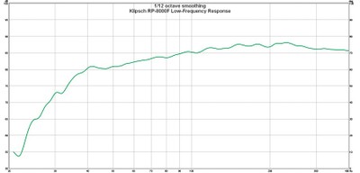

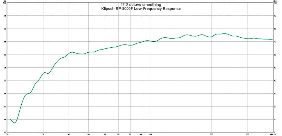

The above graph shows the Klipsch RP-8000F low-frequency response that I captured using groundplane measurements (where the speaker and microphone are on the ground at a 2-meter distance in a wide open area). In this response, we see a very slight roll-off from 200 Hz to just under 50 Hz, and 40 Hz is clearly the port-tuning frequency. In other speakers of this price class, we have seen a more aggressive roll-off down to port tuning so that the speakers do not risk overloading the low-frequency response of room and so the low end of their +/-3dB spec has largely been with room acoustics factored in. Klipsch seems to subscribe to this strategy but not nearly to the same degree, so their anechoic low-frequency response is less tapered off than other tower speakers in its class. The disadvantage is that a small room or congested area might boost the low-frequencies to an unnaturally bass-heavy sound. Klipsch may be betting that few people are going to place large tower speakers with dual 8” woofers in a small room, which is a sensible bet to make. With this kind of bass response, users may want to keep these speakers away from corners and side walls for the most natural bass sound.
The solid bass response down to 40 Hz means that for most types of music, the addition of a subwoofer is not needed. Room acoustics will likely take that response down a bit lower as well, and few types of music dig lower than the upper 30 Hz range. Pipe organ aficionados and bass-heavy electronic music fans may still want to use subs, since those music types do dip under the tuning frequency of this speaker. This kind of extension will not be able to capture all of the deep bass in many modern action or science fiction movies either. Nonetheless, the RP-8000F is a fairly capable speaker for low frequencies.

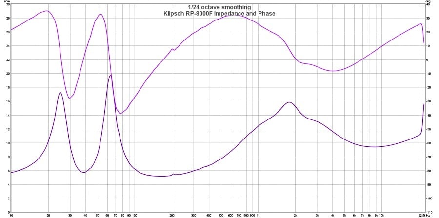

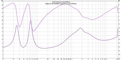

Klipsch RP-8000F Impedance and Phase Response
The above graphs show the electrical behavior of the Klipsch RP-8000F. Klipsch specifies this speaker with a nominal impedance “compatible with 8 ohms” which is a fairly ambiguous spec. I take that to mean you can safely use this speaker on amplifiers that are only rated for 8-ohm loads, and that is largely true. There isn’t much here that would be problematic for most amplifiers. The impedance minima occur at 160 Hz with 5.17 ohms, but the phase angle isn’t too severe. A more challenging point may be the port tuning frequency at 40 Hz which sees a 5.7-ohm impedance dip at a steep phase angle. That may be tough on feeble amplifiers if you crank them hard, but even an amp in a mid-range AVR should be able to handle these speakers without much of an issue. The use of a subwoofer here would make these speakers a much easier electrical load by alleviating the amplifier of having to power the port frequency range.
What helps to make the RP-8000F an easier load than many other speakers is its above average sensitivity. I measured its sensitivity as 92.1 dB for 2.83v at 1 meter. That isn’t bad; it’s better than most speakers in this type and price class. However, it is significantly below what Klipsch specifies for it which is 98 dB for 2.83v at 1 meter. That is quadruple the sensitivity that I measured. Klipsch is using an in-room estimation of sensitivity that factors in a quarter-space environment over a greater distance. It is true that the in-room sensitivity would be increased, but I think that should be stated in their specs if that is their reasoning for their sensitivity rating. We've seen this discrepancy in other Klipsch products so it doesn't seem to be a statistical outlier in how the brand rates sensitivity of their products.
