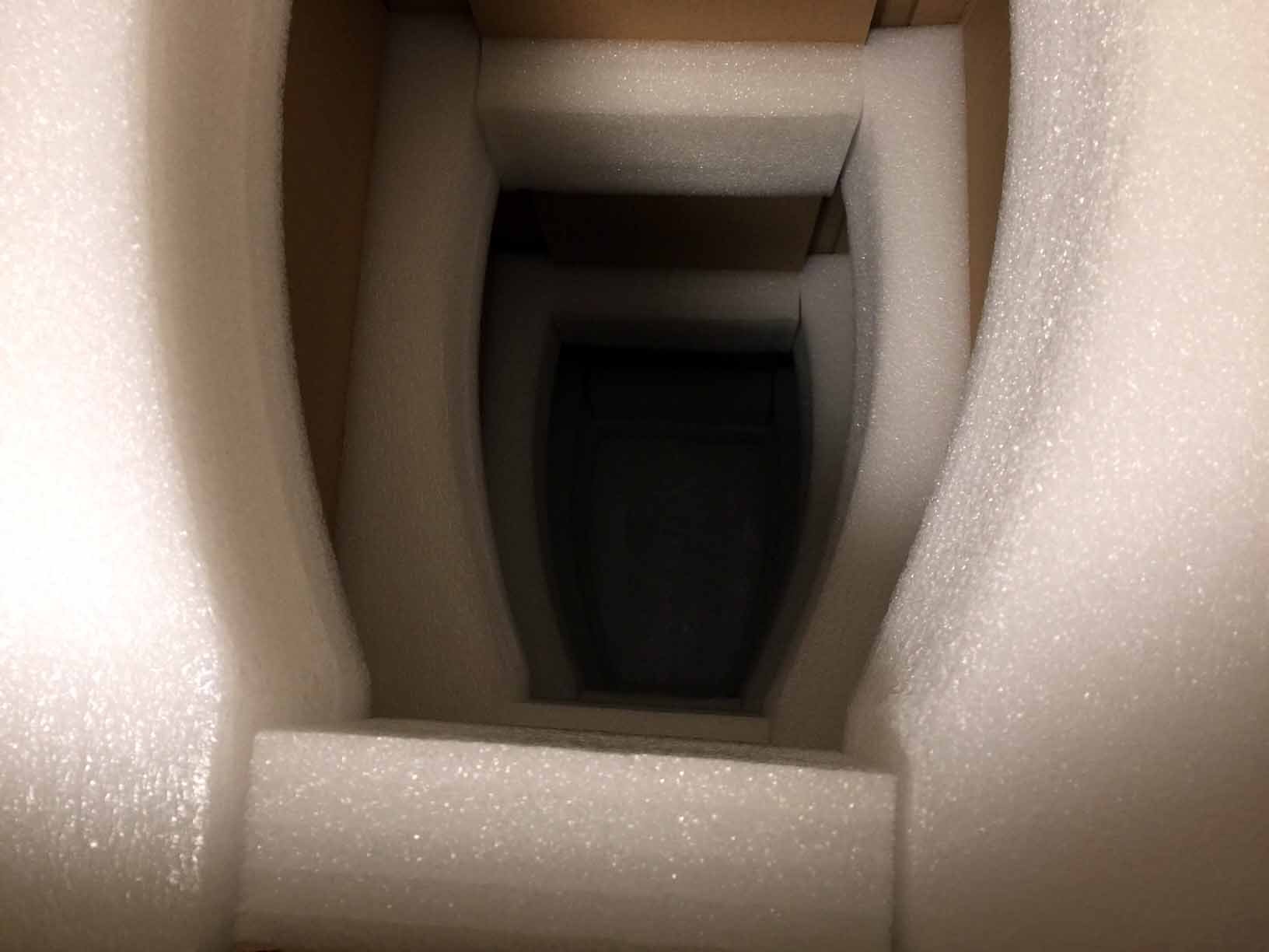

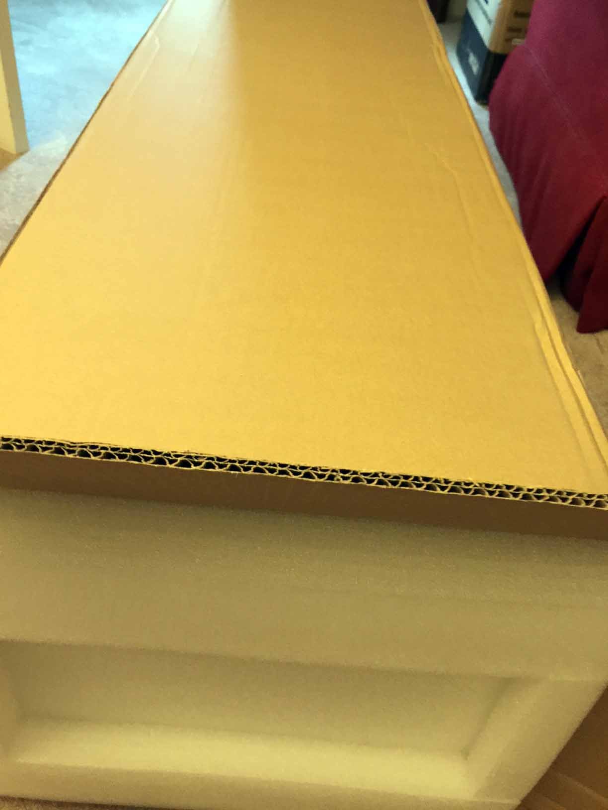

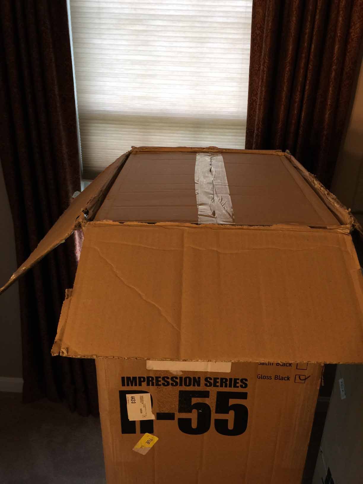

The packaging was fully up to the task of protecting the speakers, since they arrived in perfect condition after the long trip from the Audioholics Florida office to my MA listening room. They’d been opened and re-packed, so the packaging was very slightly compromised. Two of the carton’s flaps simply came off when I opened them, because they were weakened from having been opened and closed a few times already.
The R-55E’s were double-boxed in two light-duty corrugated cartons. Frankly, I was quite surprised at the dainty nature of the cartons. The cartons were surprisingly thin-walled and I was skeptical as to how they’d done such a good job protecting the speakers.
I got my answer when I looked inside the inner carton: Running the full height of the carton were four curved foam inserts that hugged the speaker quite securely and provided a good deal of a safety margin “buffer zone” between the speakers and the outer surface of the outer carton. The cartons themselves were not tasked with doing the heavy lifting of protecting the speakers: the protection was accomplished by the foam holding the speakers quite firmly, a good 3+ inches away from the outer surface of the outer carton. Well done, nice design. Obviously very effective, without needing heavy battleship-type armored cartons surrounding the speakers.
One thing the cartons could have used was oval handholds to make moving and lifting the speakers easier. I don’t know why all 4-foot+ tall speaker cartons don’t have handholds cut into them, other than the packaging designers simply didn’t think of it. Really no excuse, since many cartons do have them, so it’s not exactly a new idea. It would probably save the manufacturer money in the long run since there would be fewer dropped speakers and consequently less shipping damage claims.
Unlike the Paradigm Prestige 75F’s, which had a plain “stealth” outer carton and a nice 2-color-on-white inner carton, the RBH R-55E’s had a plain-Jane black print outer carton and a totally blank brown Kraft inner carton. Inthe final analysis, the customer doesn’t really care whether the cartons are fancy or plain, as long as the product is undamaged in shipping.
Outer Cartons (left pic) ; Inner Carton (right pic)

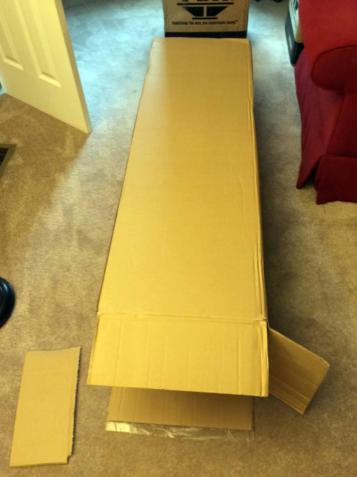

Cutting
open the outer carton on its end, laying it on its side and then sliding out
the inner carton is a job best done by two people. It’s easy to slide out the
inner carton if someone is holding the outer carton still. I managed it by

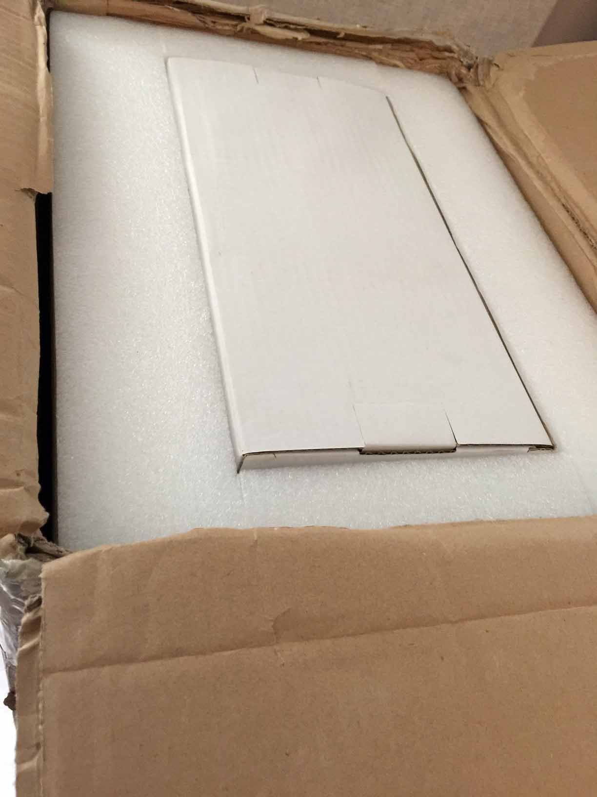

myself, but it was a little unwieldy. A nice white cardboard box nestled in the
foam endcap containing the outrigger feet and spike hardware greets you upon
opening the inner speaker carton. Nicely done. However, there was no
documentation of any kind with either speaker. I think these may have been
production-quality pre-production samples and the manual/feet instructions were
just not included. As I mentioned, these speakers spent a short amount of time
at the Audioholics offices in Florida before coming to me in MA, so perhaps
those careless bums in Florida simply forgot to include the manuals. No matter.

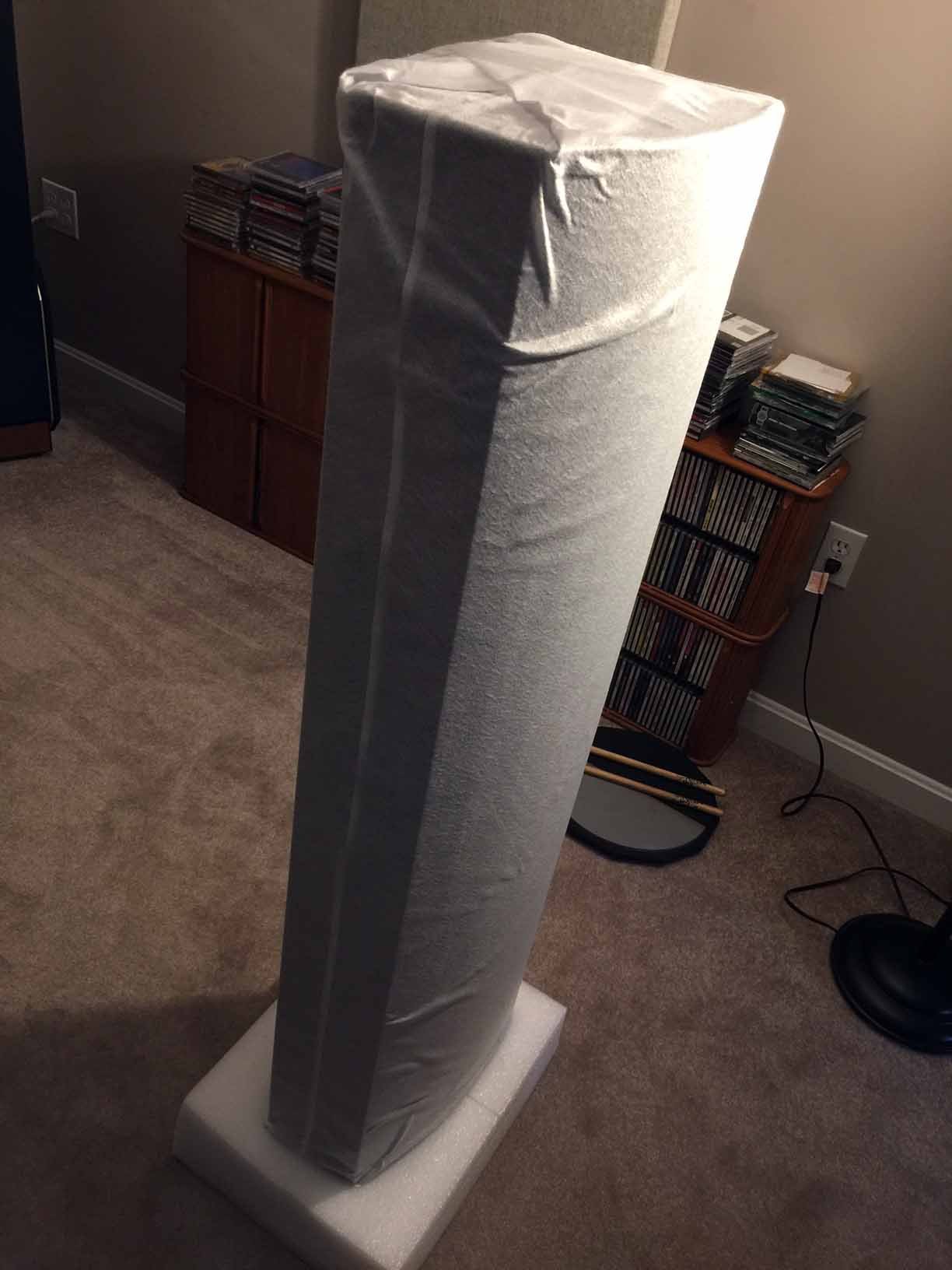

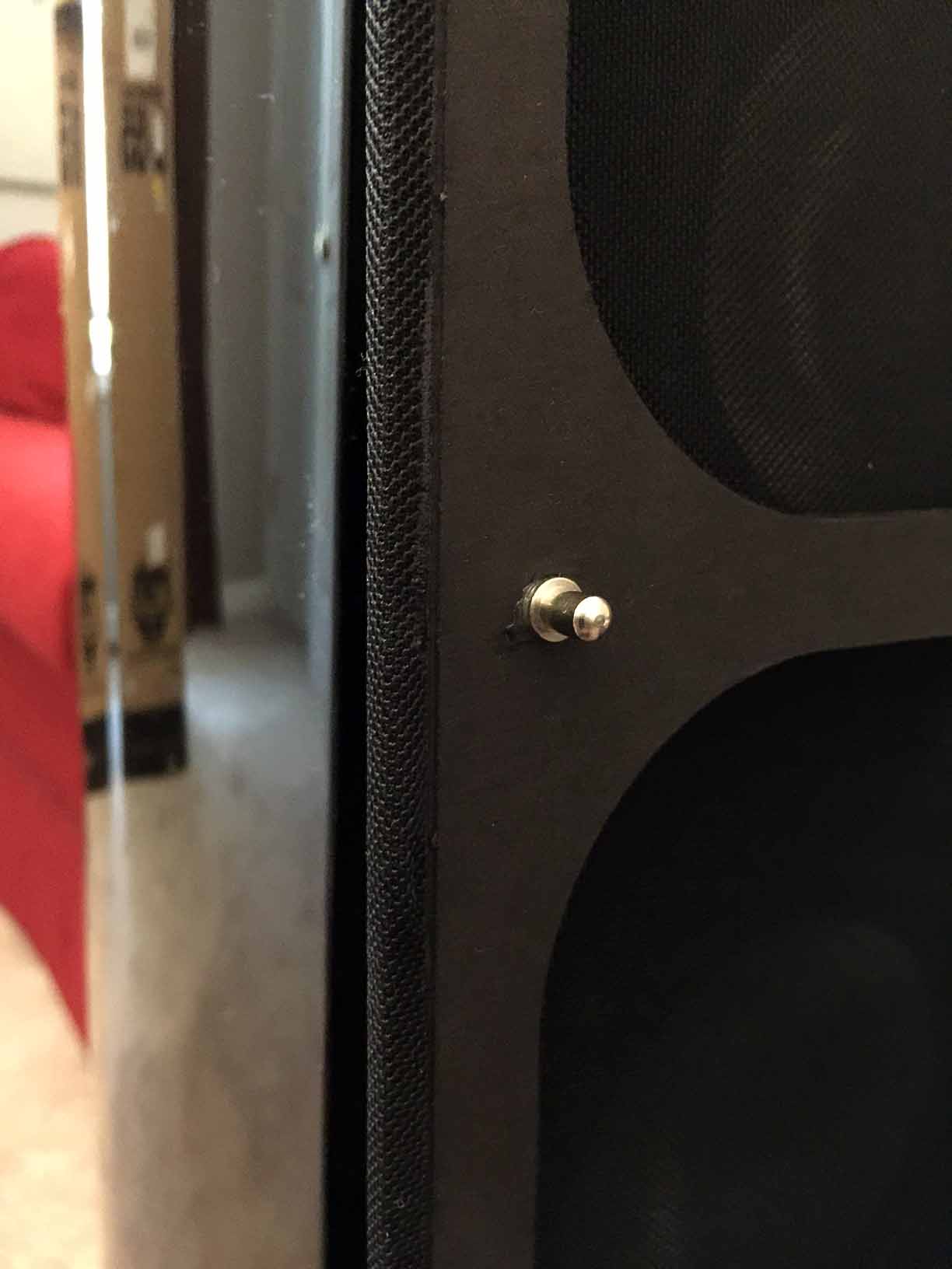

The speakers themselves were covered in a nice cloth bag to protect the cabinet’s gloss black finish. The grille was already attached to the speaker, not in a separate bag as with some other speakers. The grille frame was made from machined MDF, with nice attention to smooth inner surfaces and a good black paint job with no light spots or ‘misses.’ The grille attachment method was short metal dowels that push into small rubber receptacles on the front baffle. This is halfway between the really nice way of doing things (embedded, invisible neo magnets that grab reciprocal invisible magnets just under the speaker’s front baffle surface) and the clunky ‘old-fashioned’ way of doing it (big ball-ended plastic grille “trees” that push into large unsightly rubber receptacles.) Clearly, RBH didn’t want to spend the money to tool a plastic grille frame, nor incur the expense and added manufacturing complexity of the neo magnet grille attachment scheme. Their approach strikes me as a very good compromise. It saves money and it doesn’t scream “This is a budget speaker!” to the consumer. The grille is a non-event. It doesn’t impress you with its quality and cleverness and it doesn’t detract from the product’s aura and “feel.” It’s neutral, which is a win for RBH. I’ve made these kind of product decisions a thousand times at Bose, Boston Acoustics and Atlantic Technology. This was well done.
Grille Frame with Small Metal Pins (left pic) ; Speaker in Protective Bag (right pic)

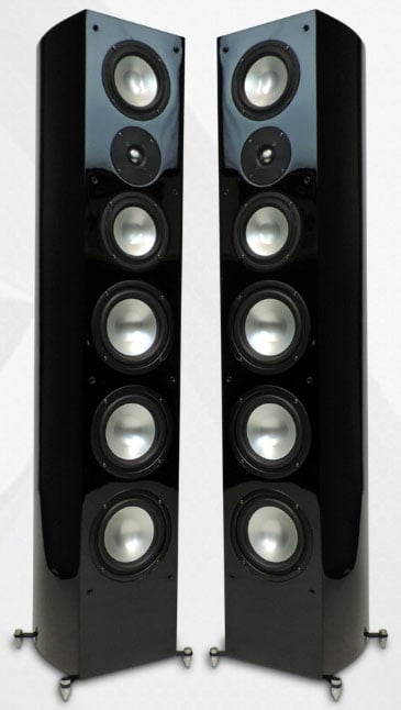

RBH R-55E Drivers and Cabinet
The R-55E is a 3-way design, with a triple 6 ½-inch aluminum-cone woofer section and an M-T-M MF-HF section with dual 5.25-inch aluminum-cone midranges flanking a 1-inch ‘aluminized nano-silk’ dome tweeter.
They have pretty good bass extension, definitely deeper and stronger than the B&W CM8 and Paradigm Prestige 75F. It’s a dual vented design; from my look inside the cabinet, all three woofers appear to share the same internal volume and the two rear ports serve to tune the entire bass section as one. Interestingly—and to RBH’s everlasting credit—there weren’t any foam cylinders included so the user could “plug one or more of the ports.” Many—too many—otherwise credible companies provide foam port plugs so the user can ostensibly change the speaker or subwoofer from a vented design to a sealed design.
That’s so bogus. A speaker designed to be vented can’t be made into a sealed speaker simply by plugging the holes. Not into a good sealed speaker. True acoustic suspension systems have drivers with completely different Thiele-Small parameters than a vented system. A real sealed system woofer has a far lower free-air resonance and higher compliance than a vented woofer, because in a real acoustic suspension system, it’s the trapped air spring in the sealed cabinet that provides the woofer’s restoring force, not the driver’s mechanical suspension (its surround and spider). If you simply take a vented woofer and block the holes, you’ll end up with a remarkably un-optimized system, with a far-higher bass cutoff than would be the case if it were an optimally designed AS system to begin with. I shake my head when I see vented systems offered with “port plugs.” RBH didn’t do that. Kudos to them.

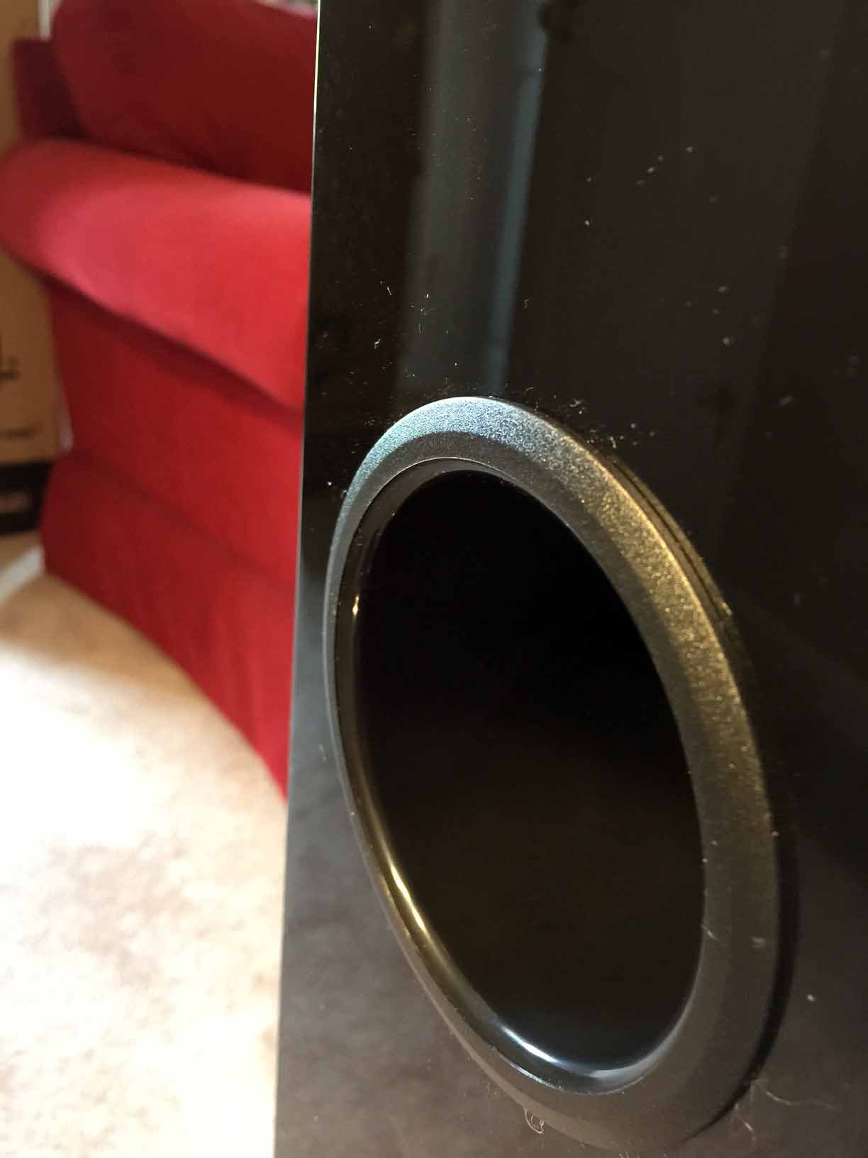

I was a little surprised that the rear ports are not nicely flared to reduce the possibility of audible port chuffing at high SPLs. The ports are slightly smoothed around the periphery but not actually flared. Companies like RBH don’t tend to do a lot of custom tooling for standardized parts. (Tooling is the process by which 3D computer programs direct a cutter to bore out solid blocks of metal, so plastic or aluminum can be poured in to make custom parts. The creation of brand-new tooling is very expensive, so much so that smaller companies refer to “tool” as a “four-letter word.” Port tubes, woofer-midrange baskets, terminal cups, etc,--all of these kinds of things already exist from various suppliers, so there is no need for a company to incur the cost and create it from scratch. Full-flared port tubes exist in every manner of size and shape, so I’m surprised RBH didn’t pick one.)
Editorial Note by Shane Rich: Regarded Flared Port Tubes
While it would have looked nicer to incorporate flared ports, the velocity of air through the 2 standard ports of the R-55E is low enough at MAX SPL’s that it just wasn’t necessary to use in this case.
Flared ports look good, but truth be told, at the SPLs where port turbulence might be audible, there’s “so much else going on” at that high volume that the listener likely would not be overly bothered by any audible chuffing. This is just one of those features that speaker manufacturers tend to include to satisfy all those get-a-life reviewers who pick on little details. Like me, I guess.
Did I hear any chuffing during my auditioning of the 55E’s? No. Would RBH have made a slightly more positive impression, visually, if they’d opted to spend another buck on a flared port? Yes, probably. Would they sell one more because of a flared port or sell one less because they don’t have it? Probably no change, either way, but it’d be a few bucks less profit times the number of speakers they sell. If they sell 5000 of these in year times 2 dollars less profit, that’s 10 grand less, right out of their pocket. That’s a lot of Internet ads or a nice raise for the Head Engineer, so he’ll stay with the company. Those are the kinds of real-world decisions product/marketing people have to make all day long. It’s not as easy as “outsiders” think, that’s for sure.
Port not flared, not flush-mounted

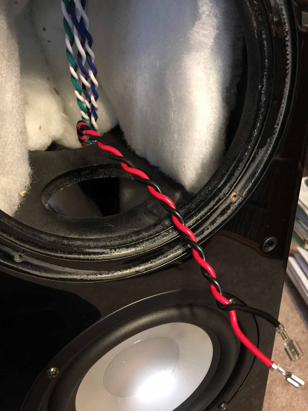

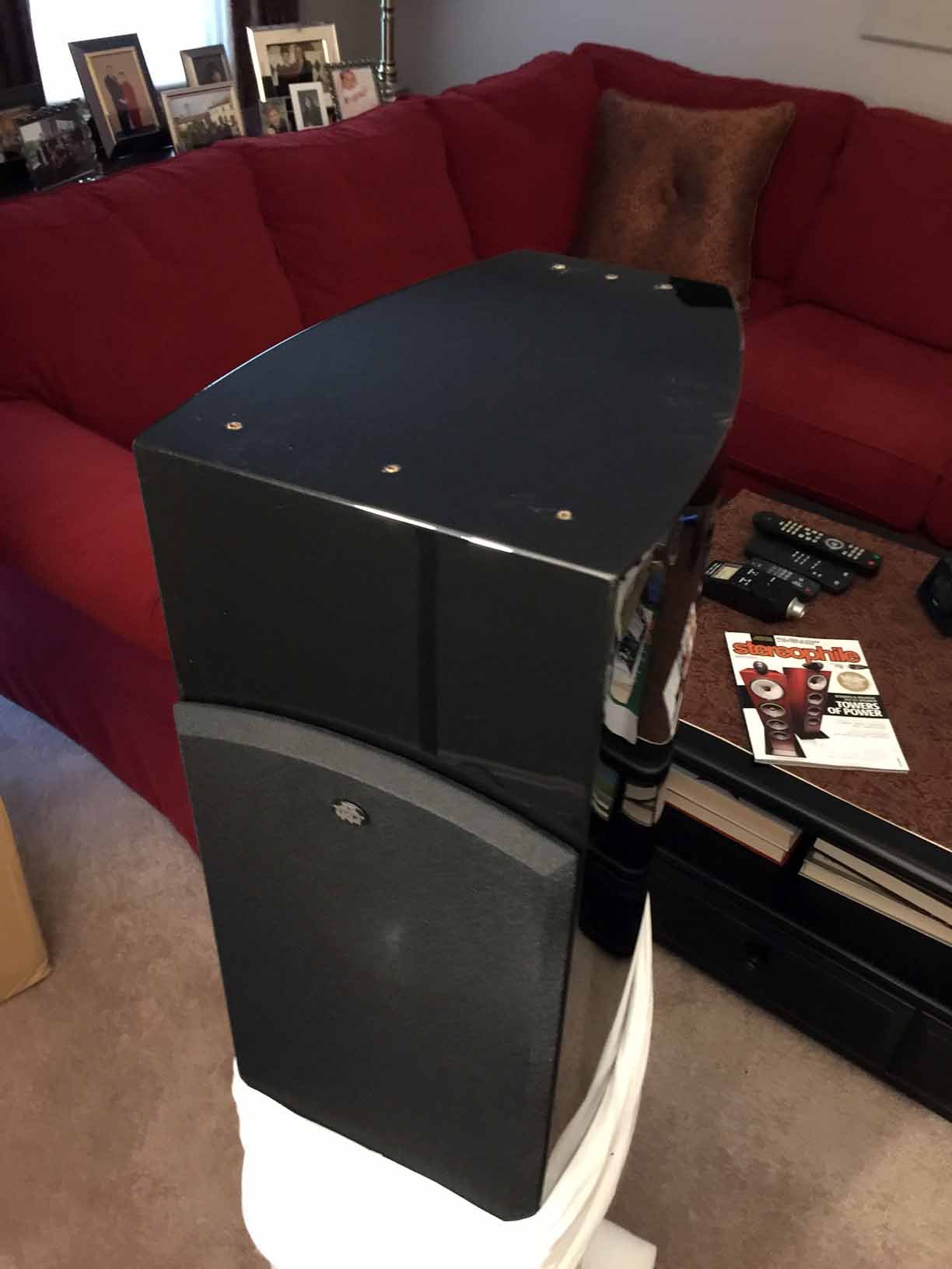

The cabinet itself is a 4-foot tall, slender tower with a wider front baffle tapering with curved sides to a narrow rear panel. The ports and terminal cup are on the rear panel.
My cabinets were finished in gloss black paint. The finish was beautiful—smooth, lustrous and expensive-looking, with no “orange-peeling” imperfections to mar the surface. Very nicely-done and quite impressive. The speakers themselves didn’t weigh as much as I thought they would considering their size—they’re 55 lbs., which is a little on the lightweight side for a 4-foot-tall tower with five drivers using large, heavy ceramic (not neodymium) magnets. The cabinet itself has a ¾-inch MDF front baffle (and I presume ¾-inch side and rear panels as well), plus two nice internal windowpane braces in the woofer section, between woofers 1 & 2 and 2 & 3. The braces themselves were ½-in MDF. The MF-HF MTM section was enclosed in a sub-enclosure of MDF, which also serves to brace the top portion of the cabinet. There was a generous amount of internal damping material to suppress internal cabinet resonances.
Windowpane
brace and internal stuffing
Note the
twisted pair wiring to reduce undesirable mutual coupling.
There is a definite acoustic benefit to the cabinet’s curved side panels in addition to it just being a nice-looking visual design: The curved panels tapering to a narrower rear baffle mean that the speaker does not have large parallel interior walls. Non-parallel cabinet walls are inherently less prone to internal standing waves and other audible resonances. The curvature of the side panels also imparts great strength to that panel—more so than a flat panel of similar size—so the need for excessive panel thickness and over-exuberant internal bracing is lessened. A rectangular cross-section cabinet of the same height with thicker panels and more internal bracing would weigh perhaps 10 pounds more. The RBH cabinet is a “smart” cabinet and doesn’t need great bulk to achieve the requisite strength and freedom from resonance. The “knuckle rap test” on the big side panel revealed a mostly high-pitched and well-damped sound character, with the middle of the panel having a slightly lower tone and more hollow quality than the upper and lower portions. But in no way did the cabinet have the “empty oil barrel” sound one hears from a thin-walled cabinet with minimal (or no) internal bracing. This is a solid cabinet, weight notwithstanding.

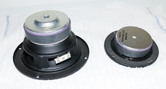

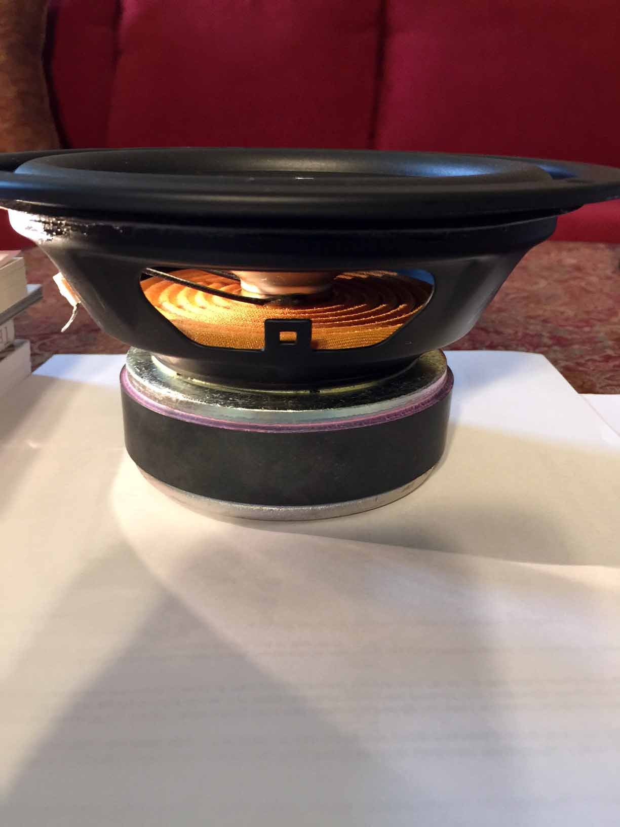

The drivers were conventional, straightforward designs. Unlike the Paradigm Prestige 75F that I reviewed last year, RBH doesn’t use any special tweeter lenses or woofer surround geometries, and so they don’t waste our time with any laughable marketing fodder like “Perforated Phase-Aligning (PPA™) Tweeter Lens” or woofers with “Overmolded Active Ridge Technology (ART™). Bless their hearts.
The woofer has a large ceramic magnet, a stamped-steel frame, and what looks to be a 1-ince voice coil. This is plenty large for a 6 ½-inch driver, and remember, there are three of them, so power handling will be just fine. Also, since the input power is being split between three drivers, no one of them is being driven too hard, which keeps the distortion low, even at high SPLs. The aluminum cone was light and stiff and seemed nicely damped by the rubber surround when I gave it the oh-so-precise “fingernail flick” test. (It takes years of training to perfect that. It’s not for amateurs.)
Aluminum cone 6 ½-inch woofer
The tweeter was simply a conventional 1-inch silk dome, with a very faint spray of something silvery on it. Is it actually aluminum or just silver paint? Impossible to tell. RBH calls it an "Aluminized nano-silk dome,” so we’ll give them the benefit of the doubt and say it’s a thin layer of aluminum. A tweeter like this with a thin “vapor deposit” of metal over a fabric substrate supposedly combines the stiffness and pistonic accuracy of a metal dome with the smooth, non-resonant character of self-damping cloth. The highs were smooth and detailed without being harsh, so whatever it’s made of, it does its job well.
All three woofers work in tandem to cover the bass range. Measuring the actual piston diameter in the generally-accepted manner of mid-surround to mid-surround yields a tick less than 5.5”, so the driver’s radiating area is just shy of 242 inches. Three drivers x 242 in = 722 inches total bass radiating area. For comparison, a standard 10-inch woofer with a 9-inch piston is 642 inches and a standard 12-inch woofer with a 10.5-inch piston (assuming a nice beefy surround) is 872 in. So the 55-E has an effective woofer “size” somewhere in between a 10 and 12-inch woofer, which should yield some nice bass weight and punch. And it does, as we’ll see later in the listening tests.
The M-T-M upper frequency section is notable for its very low 120Hz woofer-to-midrange crossover frequency. Remember, if the driver’s diameter is smaller than the wavelength of the frequency it’s reproducing, the dispersion is very wide. If the driver is larger than the wavelength being reproduced, the driver will “beam” its output forward like a flashlight.
Such a low W-to M crossover is very desirable when using large-diameter woofers, since a 12-inch woofer (10.5” piston) will get very directional by around 1200Hz. (Do the math: 13560 /piston diameter = Critical Directional Frequency, or CDF.) Crossing over an octave lower than the CDF (600Hz for a 12-inch woofer) is very good design practice. That will make the speaker almost omnidirectional in the forward hemisphere, over a nearly 180˚ angle.

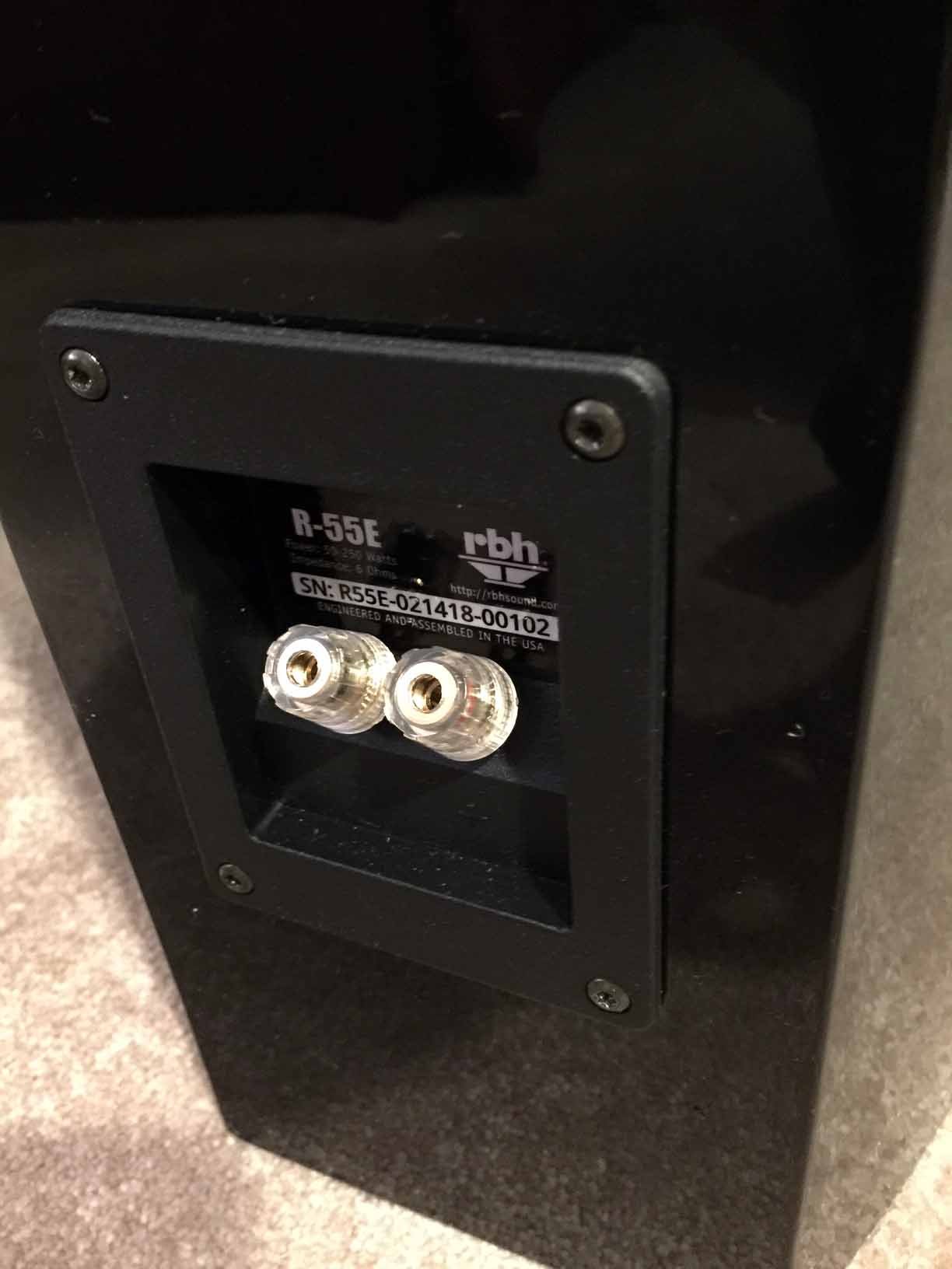

There is only one set of binding posts, at the bottom of the rear panel. The terminal cup is not flush-mounted with the surface of the cabinet, another indication of selective cost-cutting on RBH’s part. The ends of the posts do not have the usually-required plastic CE (European) safety plugs, like I’m used to seeing. My guess is that RBH doesn’t sell into the EU market, so there is no need for those annoying plastic caps here in the U.S. If you want to use banana plugs instead of bare wire to connect the speaker wire to the posts, you’re free to do so. The posts themselves have a nice-sized hole to accept bare wire and that’s how I connected them, with 14-ga wire. Nice, easy, and secure. The ”bi-amp” feature in speakers is very close to audio snake-oil in my estimation. The actual audible benefit of so-called “bi-amping” or “bi-wiring,” especially when you’re still going through the speaker’s internal passive crossover is highly debatable, to say the least. I’d venture to say—with an extremely high degree of confidence—that simply moving the speaker’s location by six inches closer to or farther from the wall behind it will cause a far more definite, audible difference than “bi-amping,” especially if the amplifiers involved (a single full range or two for bi-amped) are not pushed into distortion. However, that’s a can of placebo worms best left unopened in this review.
Binding Posts in Non-Flush-Mounted Cup

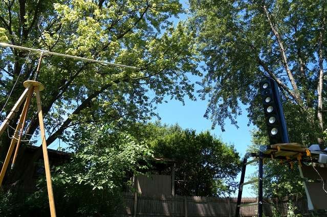

RBH Sound R-55E Floorstanding Speaker Measurements & Analysis
Measurements Conducted By: James Larson

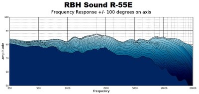

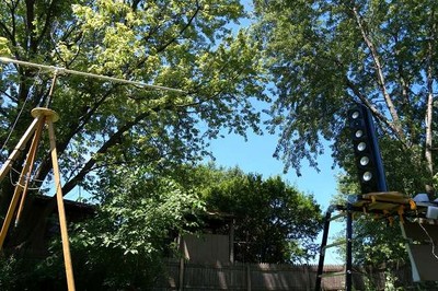

The RBH R-55E Tower speakers were measured in free air elevated to a height of approximately 4 feet with the microphone at a 90” height to be level with the tweeter. Measurements were gated at 5 ms. At this windowed gate, some accuracy is lost below 400 Hz and is totally lost below 200 Hz. The microphone was placed 2 meters away from the speaker at a height level just below the tweeter. The below graphs use 1/12 octave smoothing.

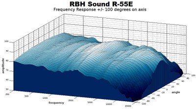

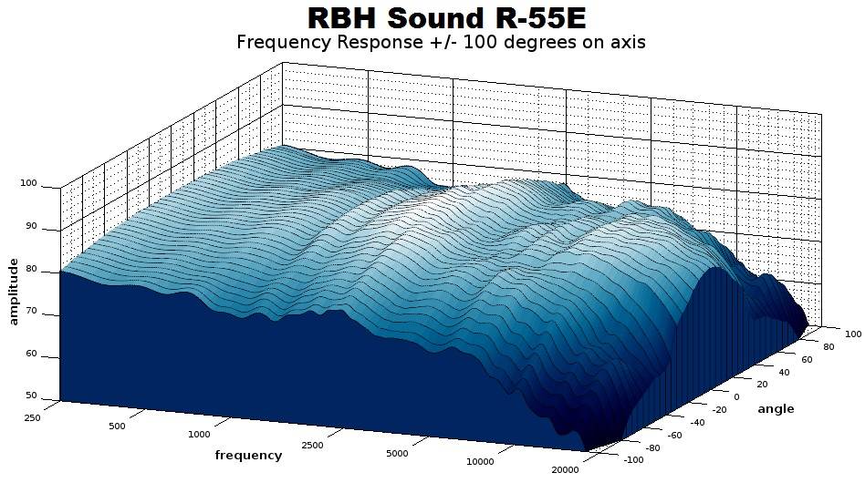

RBH R-55E Horizontal Response +/- 100 degrees: 3D view

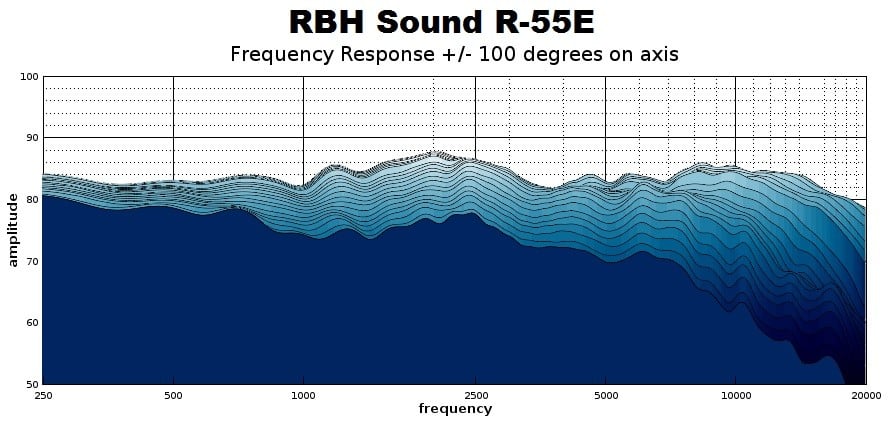

RBH R-55E Horizontal Response +/- 100 degrees: 2D view
The above graphs depict the R-55E’s direct-axis and horizontal dispersion out to a 100-degree angle in five degree increments. Here we can see the source of the upper-midrange brightness that Steve noted. It takes the form of a low Q rise of a few dB centered at 2 kHz. I would expect a response like that to be audible but not severe, as Steve mentioned. The rest of the range is relatively flat. Since this rise is a resonance that occurs at every angle, it can easily be addressed with equalization. The R-55Es show themselves to have admirably wide dispersion with good response correlation from direct axis to off-axis angles. This means that its reflected sound should have similar tonality to the direct sound, so a room heavy in acoustic treatments isn’t needed to make these speakers sound better. It also means these speakers do not have a small ‘sweet spot’; they ought to sound good anywhere in a broad angle in front of them. This characteristic has always been a strong point of RBH speakers.

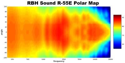

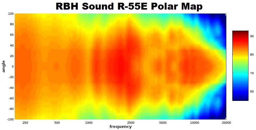

RBH R-55E Polar Map of its Horizontal Response
The above graphs show the same information that the preceding graphs do but depict it in a way that offers new insight regarding these speakers’ behavior. Instead of using individual raised lines to illustrate amplitude, these polar maps use color to portray amplitude and this allows the use of a purely angle/frequency axis perspective. The advantage of these graphs is they can let us see broader trends of the speaker’s dispersion behavior more easily. Outside of the extra midrange energy at 2 kHz, we see a very consistent level of energy as we move off axis. The only frequency that tapers off at a higher rate off axis is the very high treble band, but that is true of nearly all speakers. The response out to 10 kHz is still strong even at a 50-degree angle. There won’t really be any bad seats in the house with this kind of dispersion unless the listener is seated at an extreme angle with respect to the speaker. Those who want a full sound projected over a wide area would do well to consider this kind of dispersion pattern.

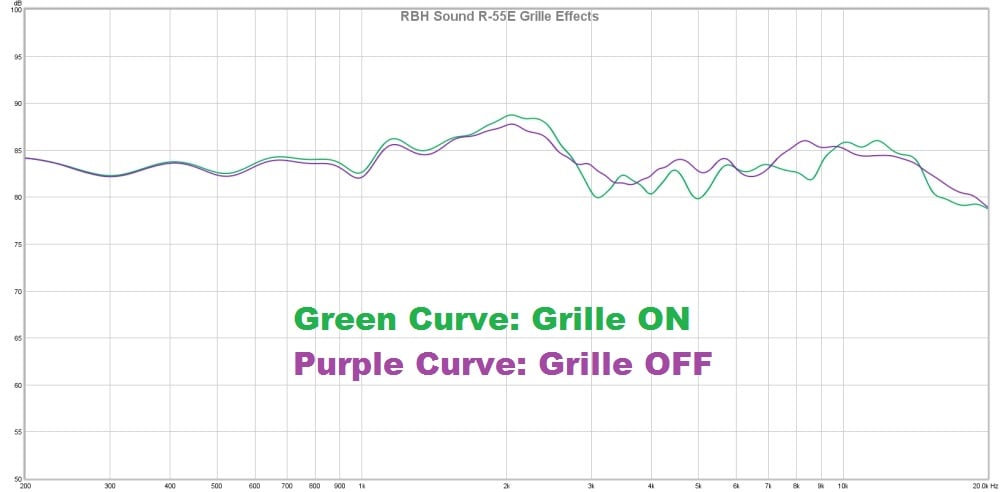

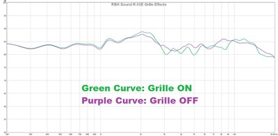

RBH R-55E Direct Response: grille on and grille off
The above graph depicts the effects on the direct axis response of the utilization of the grille. While I always take this type of measurement, I don’t normally include this graph in reviews, since the differences don’t tend to be very significant. However, the use of the grille here is a bit more impactful on the response than normal. It wouldn’t make a major audible change on the sound character of this speaker, but it certainly does not improve the response. As usual, for the best sound, leave the grille off.

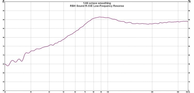

RBH R-55E groundplane
bass response
The above graph shows the RBH R-55E’s low-frequency responses that I captured using groundplane measurements (where the speaker and microphone are on the ground in a wide open area). At a glance, one might guess that the 80 Hz to 90 Hz region is the tuning point of this speaker, but that is not the case. The port tuning frequency of the R-55E is just below 40 Hz, as we can see below in our impedance measurement. We can see this in the low frequency response when we look a bit closer and see a 12/dB octave slope below the bump centered at 90 Hz and then a steeper roll-off below 30 Hz. This was done to use boundary gain to shore up the low frequencies, since tower speakers are normally placed near walls or corners. If the R-55E has a flat response down to 40 Hz, typical tower speaker placement would balloon the bass for a ‘boomy’ effect. The roll-off that we see in the R-55E lends itself to more natural sounding bass, at least when placed near walls or especially corners. If these speakers were placed in an open area that had no proximity to nearby walls, they would likely sound a bit thin for ostensibly full-range speakers. The specified frequency response window of 35Hz to 30kHz +/-3dB that RBH states for the R-55E should be taken to mean in-room response. Anechoically, this is not the case, but, in practical, real-world use, it would have that kind of window.

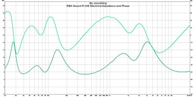

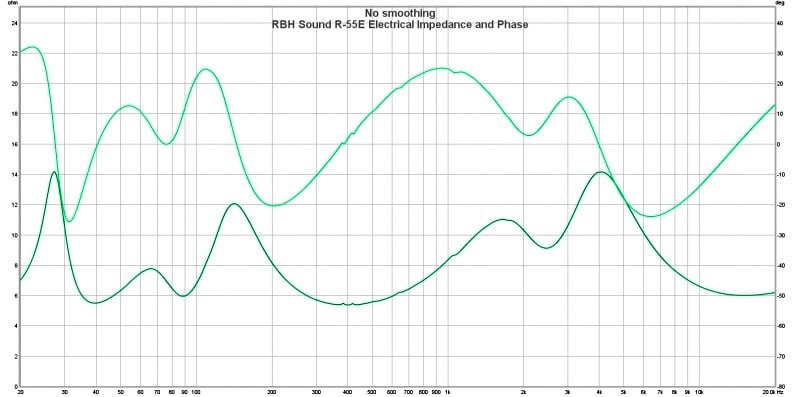

RBH R-55E Impedance and Phase Response
The above graphs show the electrical behavior of the RBH R-55E speakers. RBH specifies the R-55Es to be 6-ohm speakers, and this is a fairly conservative rating. Some manufacturers would call this kind of load 8 ohms, which might be pushing it, but it is certainly more benign than a 4-ohm load. The toughest part of this load occurs in the low frequencies where there are some steep phase angles at impedance minima, but those still occur above 5 ohms. Essentially any AVR or amplifier should be able to drive this speaker without worry. RBH specs the sensitivity of the R-55Es speakers at 88dB for 2.83v at 1m. Our measurements show 87dB (well, 86.963dB but we will call it 87), which is pretty good agreement. That is about what one would expect from a design like this- it’s not a low sensitivity nor is it especially high. Most mid-range AVRs will have enough power to drive these speakers to quite loud levels, but the R-55Es could safely handle a good deal more amplifier power than mid-range AVRs are capable of, if users wanted to add an outboard amplifier to really rock out.

without realizing that at 2:33 there is a sustained low-20s Hz tone (about
three seconds long) that just rises up from the floor and absolutely dominates
the room.
Very few full-range passive speakers will reproduce this tone, since most full-range speakers—even quite excellent, expensive ones—will only respond, honestly, down to 35-40 Hz or so. My reference speakers are sealed systems with dual 12” woofers (with the very shallow 12 dB/octave rolloff inherent in acoustic suspension systems), rated very realistically down to -3 dB @ 28 Hz. With a little room gain by virtue of being within a foot of the wall behind them, per the manufacturer’s recommendation, they are quite flat in my room down to the lower 20s. At the 2:33 mark of this cut, fed with 400 distortion-free watts, they make dogs cower and babies cry.
Unlike most other mid-priced/mid-sized floorstanding speakers I’ve reviewed, the RBH R-55E did not ignore the 22Hz tone at 2:33 as if it didn’t exist. It actually hinted that the tone was there. It wasn’t strong or prominent by any means, and if you didn’t know that there was a 3-second-long 22Hz tone on the recording, you really wouldn’t have any idea just from listening to the RBH’s by themselves. But I do know that tone is there and therefore I was impressed that the R-55E hinted at it.
The other thing I was impressed by was the R-55E’s poise in the presence of strong bass below its usable range. It didn’t overload, it didn’t distort, the presence of that tone didn’t cause havoc with the rest of the music. The R-55E simply hinted at it, while continuing to go about the rest of its business in a commendably relaxed, coherent manner, even at relatively high levels. Very impressive.
