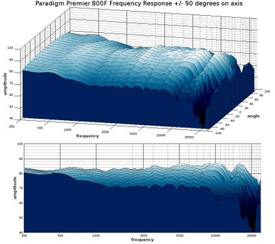

- Frequency Response (On-axis): ±2dB from 50 Hz - 22 kHz
- Frequency Response (30° Off-axis): 2dB from 50 Hz - 18 kHz

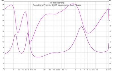

- Impedance: Compatible with 8 ohms

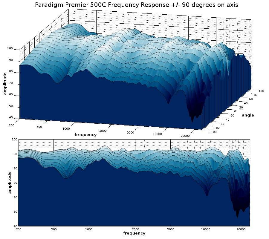

- Frequency Response (On-axis): ±2dB from 75 Hz - 22 kHz
- Frequency Response (30° Off-axis): 2dB from 75 Hz - 18 kHz

- Well-controlled off-axis behavior
- Agreeable electrical load for most amplifiers

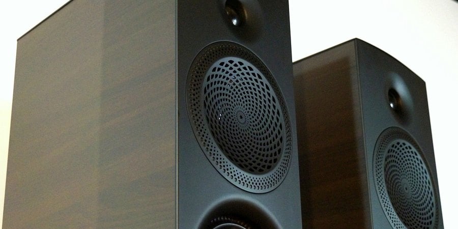

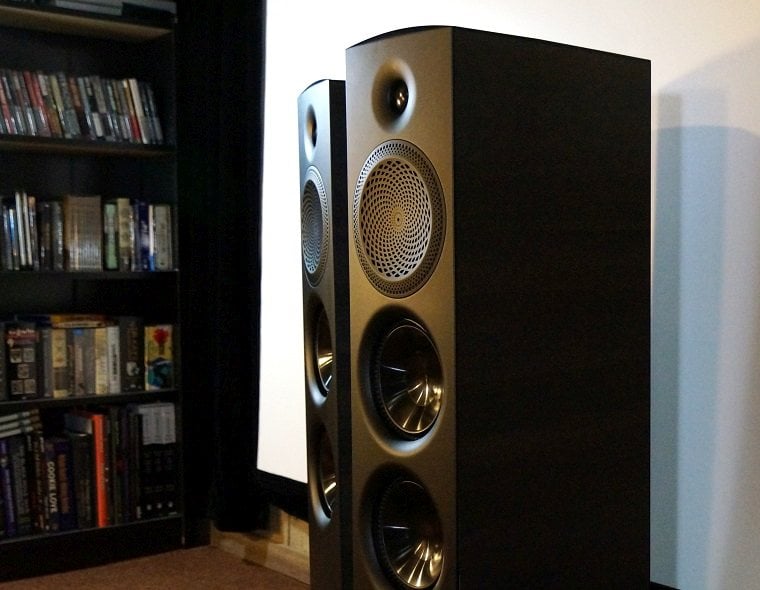

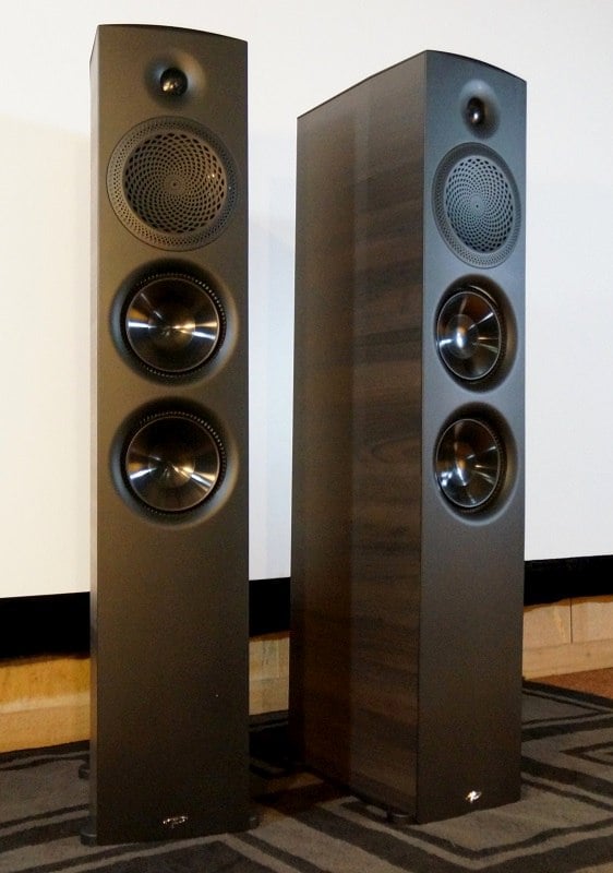

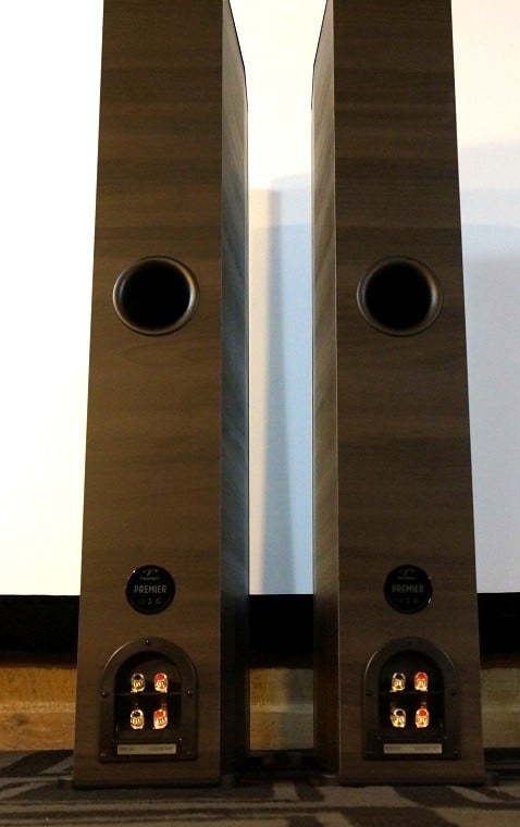

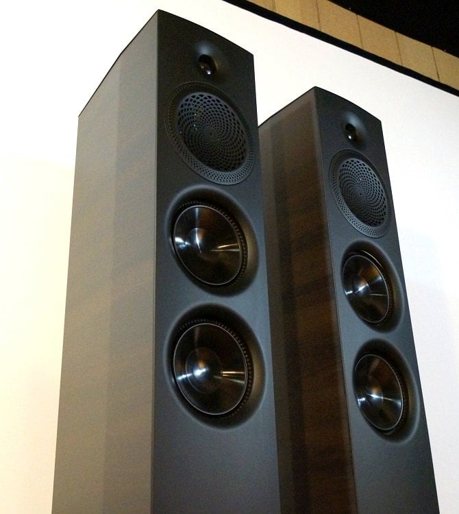

Appearance

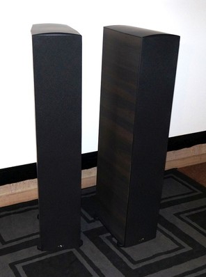

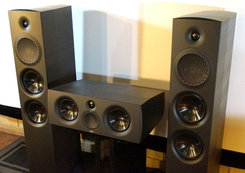

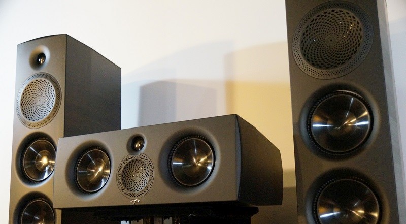

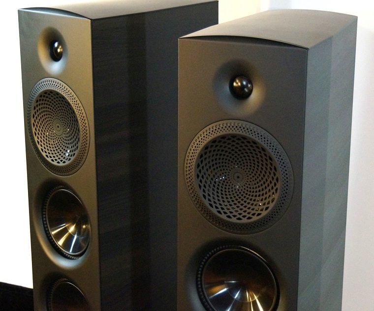

One aspect that begs comparison between the Premiers and Personas is their appearance. There is no doubt that the Premier speakers are imitating the style of the Persona speakers, however, it is not simply a carbon-copy. The Premier speakers are acknowledging the fact that their engineering is directly inspired by the Persona line. The Premier speakers are a bit more stylistically toned-down from the Persona speakers, with a front-baffle of muted black instead of the high-gloss and more colorful baffles of the Persona speakers. The cabinet finish options are more conservative as well, with gloss black, gloss white, and an espresso grain. Our review units came in the espresso grain finish, which is very tasteful but also low-key. The drivers are the only ‘expressive’ visual elements of these loudspeakers in this finish, so with the grille on, they are a bit unremarkable. Some folks will like that, but personally, I prefer my loudspeakers with a bit more visual personality, so I leave the grilles off. I don’t mind that my speakers look like speakers, although I would object to an ugly speaker. Some folks think that speakers look ugly period, as though loudspeakers should be ashamed of their function, and grilles are made for these people so that their loudspeakers turn into blank boxes.

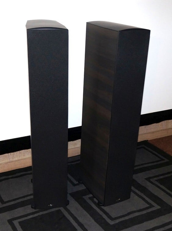

While the grilles turn these speakers into inconspicuous black boxes, their ‘ungrilled’ appearance gives us more to talk about. As with the Persona speakers, the Premiers use Paradigm's distinctive PPA lens on the tweeter and mid-range driver. These kaleidoscopic woofer covers are bound to become an iconic design feature for Paradigm, and I think they will pay off more as a brand badge than for whatever sound quality advantage they bestow. They give these speakers an undeniably interesting look. Complementing the patterns of the PPA lenses are the ribbed surrounds of the ART woofers along with the semi-metallic sheen of the cones. The gentle curve of the front baffle along with the lack of visible screws for the driver frames or even visible grille guides (the grille magnetically attaches to the speaker) serve as a smooth backdrop to the ornate look of the drivers themselves. The front of the Premier speakers minus the grille looks, well, cool. It is stylish without being loud or gaudy.
The
shape of the cabinet assists in the aesthetic that the front establishes. The
top of the cabinet is a rounded soft black piece that is a visual extension of
the front baffle assembly. The side panels taper back a bit for a more
streamlined effect as well. Those who are using the Premiers in a system with a
projector will want to go with the espresso grain finish since it is a very
non-reflective, flat finish and will not redirect much light to the screen.
Altogether, the Premier speakers look very nice; they are sharp, restrained,
and clean- but without being boring.
Design Analysis
We
will start our design analysis of the 800F speakers first and then discuss the
500C. The 800F speakers are three-way ported tower speakers that use two 6.5”
bass drivers, a 6.5” mid-range driver, and a 1” aluminum dome tweeter. The bass
driver and mid-range driver cones are made from polypropylene, and both use
inverted ART surrounds. ART is the name Paradigm has given to their patented surround
design
that uses a pleated ‘ribbing’ over the length of the surround; it is an acronym
which stands for Active Ridge Technology. Supposedly, ART allows for more headroom than conventional
half-roll designs. When typical surrounds are stretched at high excursions,
particularly in the inward-stroke, deformations can occur from the high
tension, and these deformations can cause distortion or even tears in the
surround. This ridged surround design by Paradigm supposedly reduces these
deformations by directing material stress to points that can better cope with
it due to the shape of the surround. Paradigm claims that ART allows 1.5 times
the excursion for the same surround roll that results in a 3 dB increase in
headroom.

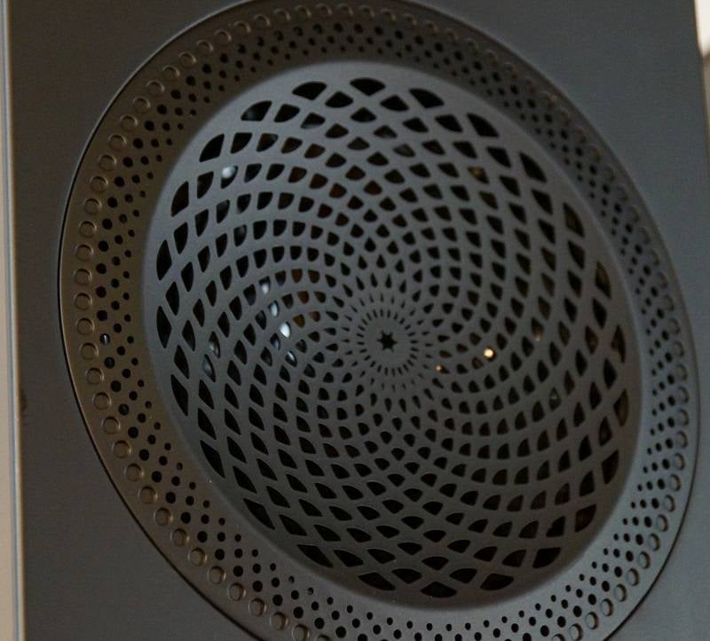

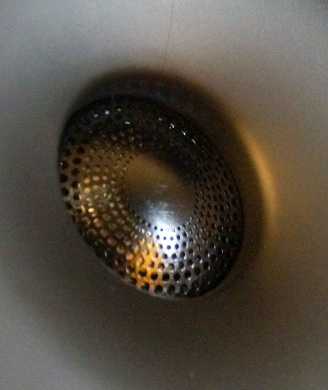

As was mentioned before, the mid-range driver and tweeter use Paradigm’s patented PPA lens that comes from the Persona series. Paradigm claims these nifty-looking grilles that cover the mid-woofer and tweeter, which stands for ‘Perforated Phase-Aligning Driver Lenses’, also serves a function similar to phase plugs, in that they prevent frequencies generated by different areas of the cones from conflicting with each other, which can happen at frequencies with a shorter wavelength than the diameter of the cone. In the pattern cut into these ‘driver lenses,’ we can see the larger holes start from the outer rim and become smaller as we move inward toward the center. Higher frequencies will be more affected by regions of the grille with smaller perforations, so they will be more greatly hindered by the central region of the driver lens. This means that the higher frequencies generated by the more recessed center of the cone will be blocked from interacting with those same frequencies that are generated by the more forward edges of the cone. Supposedly, this will help to optimize all the sound generated by the cone to keep better phase-coherence which will make for a smoother frequency response.
Paradigm Perforated Phase-Aligning Driver Lenses (midrange - left pic ; tweeter -right pic)
The tweeter uses Paradigm’s ‘X-PAL’ pure aluminum dome composition and is mounted in a shallow waveguide in the front baffle which should help to control dispersion and raise efficiency. Regarding the cabinet, the front baffle has a rounded shape that should help reduce diffraction effects. The tapering of the side-panels might also help to reduce standing modes inside the cabinet by the elimination of parallel surfaces, and this could reduce cabinet resonances. Paneling and bracing within the cabinet use ¾” thick MDF but the front baffle uses 1” thick MDF. No doubt this thickness accounts for the bulk of the hefty 53 lbs. weight. There is a large 3” heavily flared port in the back panel. The port has a foam screen in the back so things don’t get stuck in the cabinet from children who like to hide objects. The grille also helps to protect the speaker and is more than just fabric overlaying a simple frame. The frame is a grid of hard plastic lattices that give the drivers more protection than bare fabric. What’s nice about the frame is that it is thin and low-profile, so this grille likely won’t contribute as much diffraction as most grilles would, especially since the plastic section around the tweeter is removed. The 800F comes with two different feet that can be used, rounded rubber caps for hard floors or metal spikes for carpeted flooring.

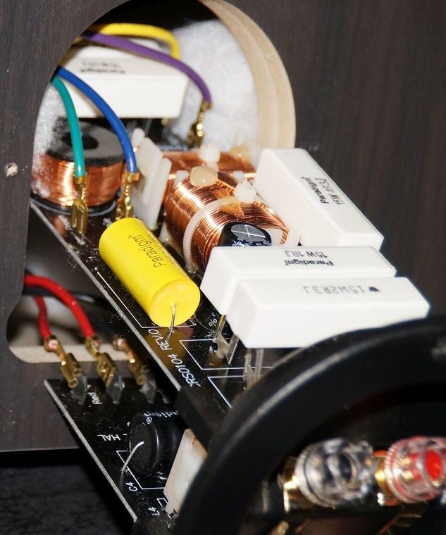

Paradigm Premier 800F Crossover
The crossover circuit is a fairly substantial piece with an array of capacitors, inductors, and resistors. Paradigm definitely did not cheap out on the crossover, as can be seen in the picture. It creates 2nd order electro-acoustic slopes at 700 Hz and 2.5 kHz. The 800F is bi-ampable, so if the user wanted to power the woofers separately from the mid-range driver and tweeter, they have that ability.

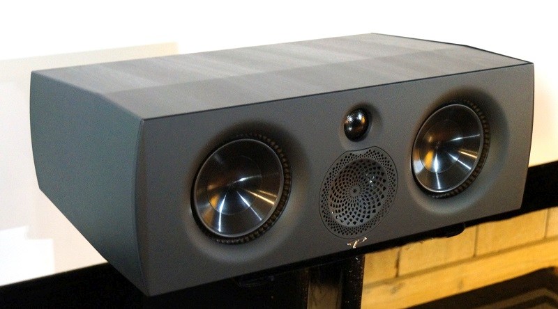

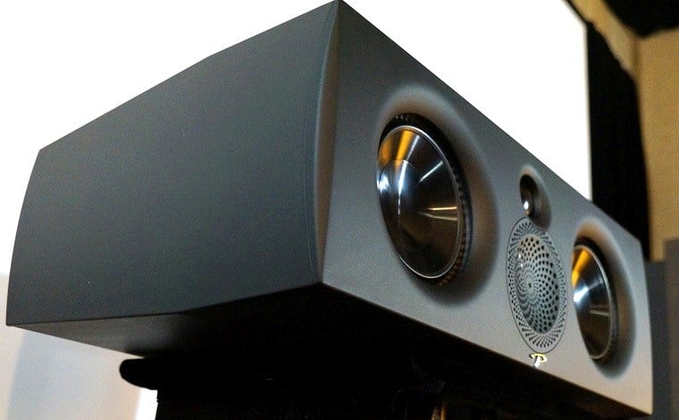

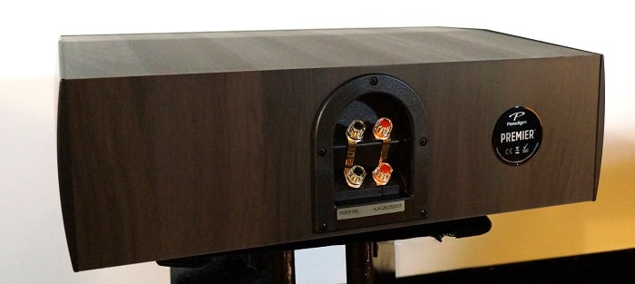

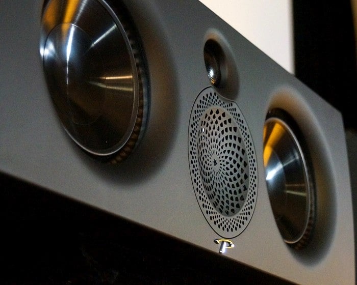

Paradigm Premier 500C Center Channel

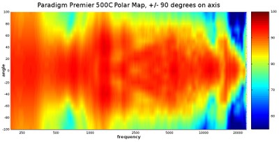

The 500C center channel speaker has a lot in common with the 800F, as would be expected, so we will focus on their differences rather than similarities. The 500C uses similar but smaller bass drivers and mid-range driver, at 5.25” and 4”, respectively. Crossover between the mid-range driver and bass drivers has been lowered to 600 Hz which will help reduce off-axis lobing effects for a greater range of frequencies. The crossover circuit is similarly complex to the 800F speakers, and the 500C is also bi-ampable. The 500C is a sealed design, so no ports are present. One possible reason for the decision to go sealed on the 500C speaker, aside from the naturally smaller cabinet, is that Paradigm thought this speaker more than likely would be placed near boundaries and so wanted a low-frequency response that is characteristic of a sealed speaker which will more naturally benefit from boundary loading. One interesting design decision worth pointing out here is that the larger Premier center speaker, the 600C, mainly differs from the 500C in that it uses larger bass drivers and passive radiators which should greatly increase the low-frequency dynamic range. The outer woofers on the 600C look like regular bass drivers but are in fact passive radiators. This design decision is much more sensible than merely making them additional bass drivers, as that would have made a mess of the lobing patterns that horizontally aligned drivers will inevitably have.

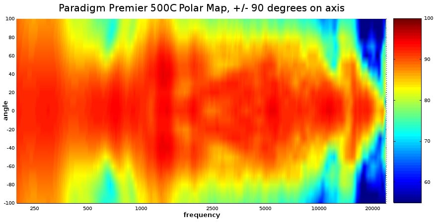

Paradigm
wisely went for a three-way design with a vertically-aligned tweeter and
mid-range driver on the 500C which greatly increases its off-axis performance
over the more typical two-way designs. Although there will still be some
off-axis lobing effects, much of it will be relegated to frequency ranges below
the room’s transition frequency. In other words, conventional room acoustics of
bass frequencies will screw up the sound far more than the adverse effects of
lobing would within that range. The 500C doesn’t come with feet but does come
with self-adhesive rubber pads that can keep the speaker from resting directly
on a hard surface. Overall, the 500C should be a good match for any of the
other Premier speakers.

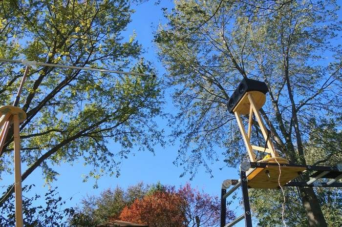

The Paradigm Premier 800F speakers were measured in free-air at a height of 4 feet at a 2-meter distance from the microphone, and the measurements were gated at a 5-millisecond delay. In this time window, some resolution is lost below 400 Hz and accuracy is completely lost below 200 Hz. The Paradigm Premier 500C speaker was measured in free-air at a height of 7.5 feet at a 1-meter distance from the microphone, and the measurements were gated at an 8.5-millisecond delay. In this time window, some resolution is lost below 250 Hz and accuracy is completely lost below 110 Hz. Measurements have been smoothed at a 1/24 octave resolution.

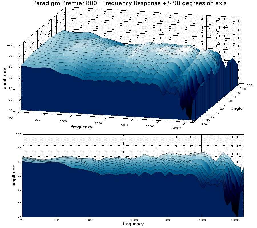

Paradigm Premier 800F and 500C Horizontal Response +/- 90 degrees
The above graphs depict the Premiers’ direct-axis and horizontal dispersion out to a 90-degree angle in ten-degree increments. Both the 800F and 500C exhibit nicely neutral responses. The 800F has a very slight elevation in its response from 5 kHz to 10 kHz. This might make it sound just a tad forward and maybe a bit more detailed when compared to a perfectly neutral speaker, but the difference would not be huge. We do see a slight dip in the 800F response at 15 kHz that falls down to 10 kHz as we move off axis, and the movement in frequency with respect to angle suggests some kind of diffraction effect or comb filtering. My guess is that this the result of the PPA lens on the tweeter since its design would suggest that more higher frequencies would be occluded on direct axis than off-axis angles. Regardless, it is an audibly negligible aspect that is of more interest for reasons of acoustic science than anything that would be heard. Since it occurs at such a high frequency, it will not have a serious impact on the sound. Most adult men have a substantial amount of high-frequency hearing loss at 15 kHz, and there is very little recorded content that is important in that region anyway. It is mostly just heard as ‘air’ or a hint of ambiance by those who are able to hear sound in that range.
One aspect to note about these graphs is the beautifully uniform dispersion of both speakers, especially the 800F speakers. The dispersion is wide and, more importantly, uniform, which is to say that the off-axis response resembles the direct axis response. This is important because much of what we hear from a speaker is not sound coming directly from the speaker itself but reflected sound from all the in-room surfaces. This means that the behavior of the off-axis response will have a major effect on the sound character of the speaker, and a simple direct axis measurement is not sufficient to characterize the performance of a speaker. This is why we at Audioholics give so much prominence to off-axis measurements in our reviews. The 500C speaker does well in this regard, and the 800Fs perform very well.
We do see evidence of the crossover from the bass drivers to mid-range driver on the 500C measurement: there is a horizontal lobing pattern that forms above 500 Hz at off-axis angles. Relative to other center speakers, it is quite mild and shouldn’t have a very serious effect on the sound. Paradigm could get rid of it if they had used a lower crossover frequency from bass driver to mid-range driver, but they may have decided that the higher power-handling of the bass drivers in that frequency range was a better trade-off. That was likely a wise decision, even if it resulted in a mild flaw in this measurement, which, again, isn’t likely to be readily audible and certainly not objectionable. The 500C also has the angle-dependent high-frequency dip as seen on the 800Fs, which supports the theory that it is due to the PPA lens on the tweeter. The 500C’s response isn’t quite as pristine as the 800Fs, but it is still very good, especially when you compare its off-axis dispersion against two-way MTM speakers.

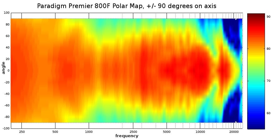

Paradigm Premier Horizontal Response +/- 90 degrees: Polar Map
The above graphs show the same information that the preceding graphs do but depict it in a way that can offer new insight regarding these speakers’ behavior. Instead of using individual raised lines to illustrate amplitude, these polar maps use color to portray amplitude, and this allows the use of a purely angle/frequency axis perspective. The advantage of these graphs is they can let us see broader trends of the speaker’s behavior more easily. The measurements for both the Premier speakers are good, but there are some similarities and differences that are worth briefly discussing. Both speakers have very good coverage out past a 40-degree angle from the direct axis, so anyone sitting within an 80-degree wide angle in front of them should hear a full sound, except perhaps for the very high frequencies which do fall off as we move away from the direct axis.
One similarity between the 800F and 500C speakers that we see is the nature of the high-frequency null. It does seem to grow wider as we move away from the direct axis. Off-axis evenness is pretty good, but we do see a bit of waist-banding in the 800F a bit above 1 kHz. There is also some waist-banding in the 500C in upper bass and lower mid-range due to the bass drivers causing phase cancellation with each other at outer angles. The cancellation is not bad and doesn’t even really start until a 50-degree angle off-axis.
What is interesting to note is the difference in width of dispersion for the mid-range drivers between the 800F and 500C. The mid-range on the 800F has a narrower dispersion pattern, and this is partly due to it much larger 6.5” cone than the 500C’s 4” cone. However, that doesn’t seem like it would be enough to account for these speaker’s nearly inverse behavior at the band just above 1 kHz where the 500C generates sound at a very wide angle as opposed to the 800F, which is slightly constrained compared to the rest of its frequency range. Above 2500 Hz, they are much more alike, and that is undoubtedly because they have the same tweeter that is used in the same range. When comparing the mid-range dispersion responses between these speakers, I am guessing that perhaps the high-pass filter on the 800F, a 2nd-order electro-acoustic slope at 700 Hz, is having a more profound effect on the lower end of 6.5” midrange. Ultimately, when factoring off-axis dispersion, these speakers are really only timbre-matched where the tweeter takes over. That isn’t unusual though; very few speaker sets that have a dedicated center speaker are fully timbre-matched. If any exist, I have not seen them.

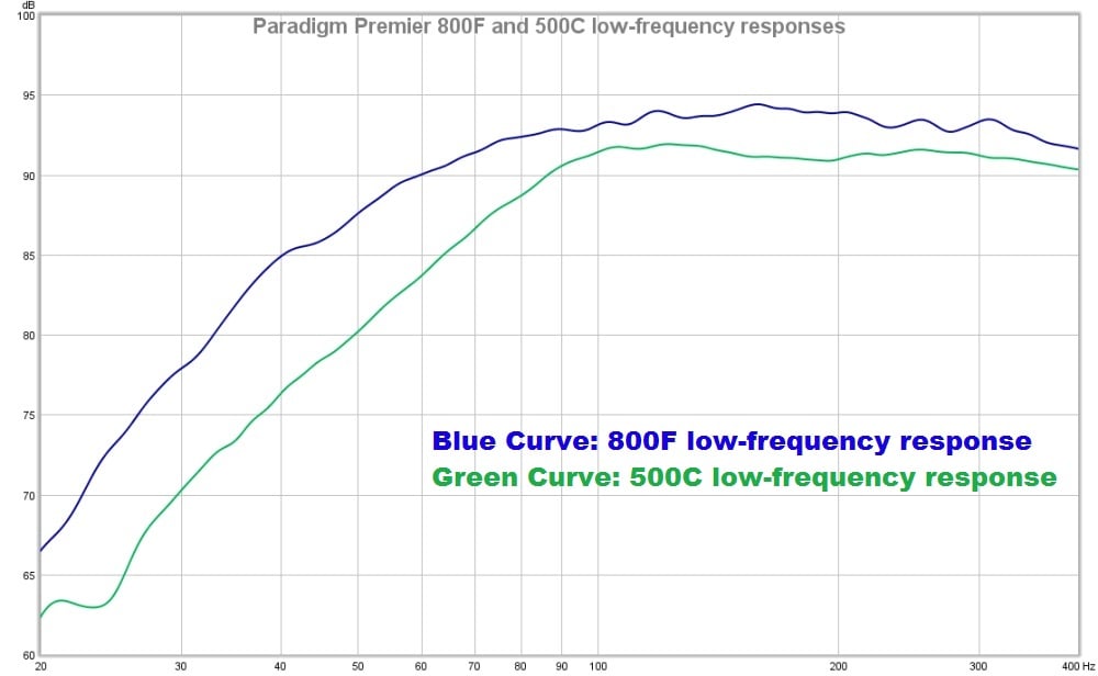

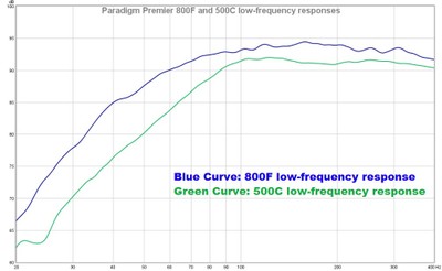

Paradigm Premier 800F and 500C groundplane bass response
The above graph shows the Paradigm Premier 800F and 500C low-frequency responses that I captured using groundplane measurements (where the speaker and microphone are on the ground at a 2-meter distance in a wide open area). The 800F looks to have an anechoic F3 of around 60 Hz, but the slope of its low-end rolloff doesn’t become precipitous until about 40 Hz. 40 Hz looks to be the port tuning of the 800F, but port output contribution seems to be less than that of driver output. Paradigm may have voiced it this way in order to avoid too much boundary gain that can occur with having a totally flat response down to port-tuning in low bass frequencies. The in-room F3 is likely to be much lower than the anechoic F3 that is shown in this graph. The same is true for the 500C since it has a gradual 12dB/octave low-end slope that is characteristic of sealed speaker designs. The 500C’s F3 looks to be a bit below 90 Hz.

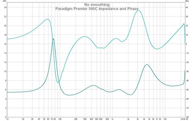

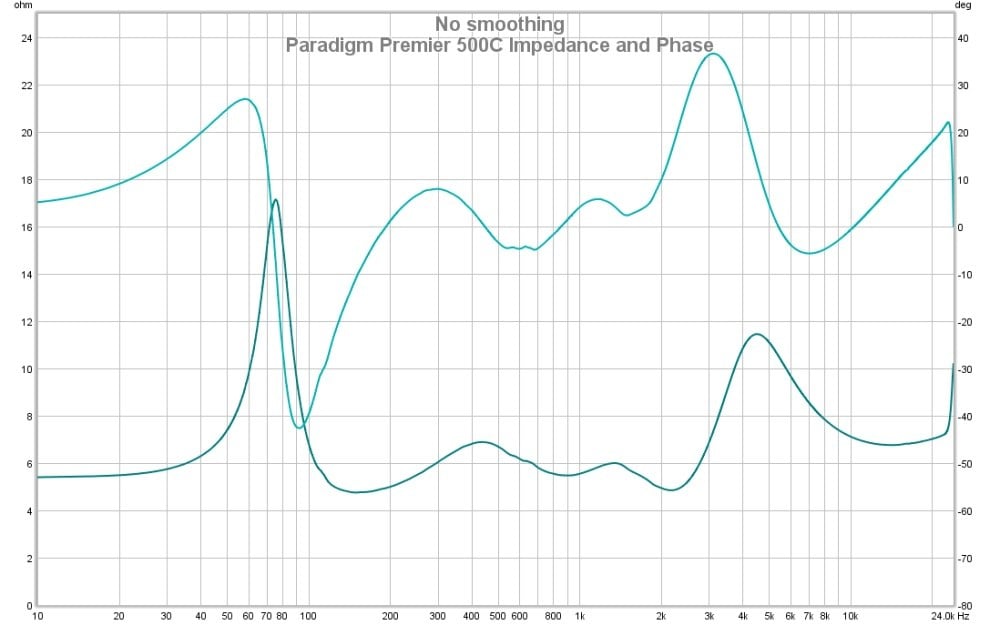

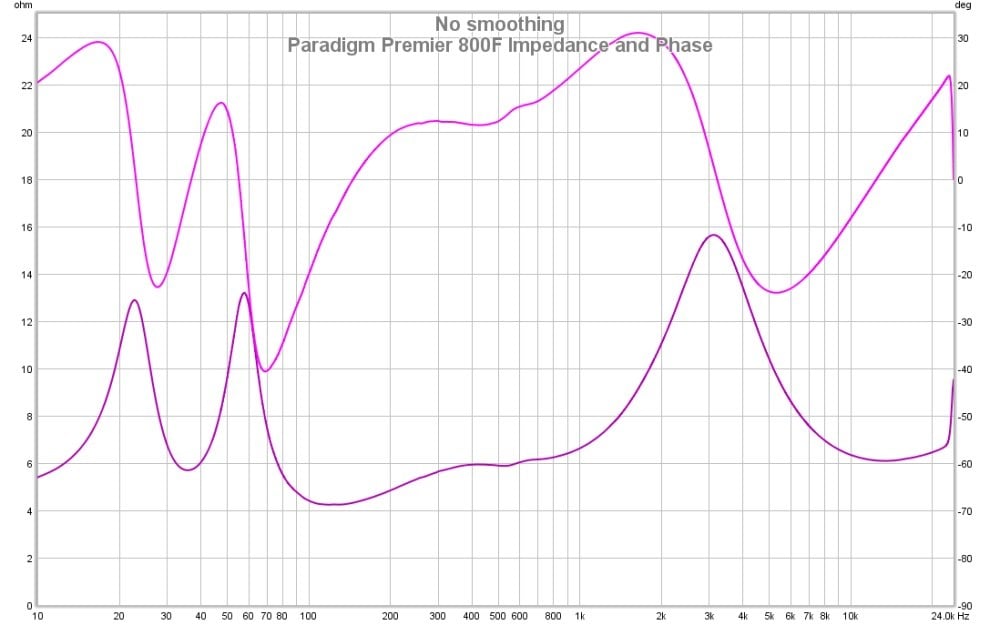

Paradigm Premier 800F and 500C Impedance and Phase Responses
The above graphs show the electrical behavior of the Premier 800F and 500C speakers. Paradigm specifies the impedance of these speakers as “compatible with 8 ohms.” That spec is a little bit evasive in my opinion, but it’s obvious that these speakers will not present a serious problem for most AVRs or amplifiers. The 800F does see a dip to nearly 4 ohms centered around 150 Hz where there is a steep phase change as well. That might be a problem for a very flimsy amplifier if these speakers are played loud, but it is the only area that poses a challenge. Everywhere else is a relatively benign load. One thing we can see from these measurements is that the port tuning point for the 800F looks to be just above 45 Hz. We can also see the resonant frequency of the bass drivers in the 500C is about 75 Hz. The 500C doesn’t quite have as severe of an impedance minima as the 800F but its nominal impedance looks to be a bit lower on average. Entry-level AVRs might have a problem with this speaker set if they are cranked hard, but outside of that scenario, there is no need to worry. It’s not likely that anyone who buys these speakers will pair them up with an entry-level AVR anyway.
Sensitivity measurements for 2.83v at 1 meter were measured at 88.8 dB for the 800F and 89.7 dB for the 500C. This is close to Paradigm’s spec for this rating which is 89 dB anechoic for both speakers. It was slightly unusual that the 500C managed to be a tad more sensitive than the 800F considering the design differences, but this can be explained by the 500C’s somewhat lower average impedance. Anyway, these sensitivity measurements are typical for speakers of this design type and are pretty good. A powerful amplifier is not needed to reach loud levels with these speakers since a couple watts is already more than enough to drive them to over 90 dB at 1 meter. These speakers are relatively efficient.

listening to them. However, if Paradigm could address the off-axis burst of
energy in the 500Cs just above 1 kHz, they would not just be a good match for
the 800F speakers but could viably serve as more than just a center speaker. In
fact, if Paradigm evened out the mid-range dispersion, I don’t see why they
couldn’t make for good left or right front speakers as well, despite their
intended role.
One criticism I might level is that there isn’t any really good reason for a bi-amplification option and that it is an unneeded manufacturing expense. I understand the supposed benefits of bi-amplification- that intermodulation distortion can be reduced- but a well-designed speaker shouldn’t have serious levels of intermodulation distortion from any kind of amplification method. I think the 800F and 500C speakers are well-engineered enough so that intermodulation distortion is not a problem no matter how it is amplified. So by providing the bi-amplification option, Paradigm is more bowing to market pressure to add a near useless feature. Granted the cost increase to add this feature isn’t likely to be large, but it just increases the chances that the user will end up misusing it and degrading the sound of these speakers. In other words, it will probably end up doing more harm than good. However, this isn’t really a fair criticism against these particular speakers, since I have reviewed many bi-amplifiable speakers in the past and didn’t ding them for including this feature. I am just stretching to find anything to complain about with this speaker set because they are a solid design that don’t have any serious flaws. Nonetheless, I would prefer to see bi-amplification left to speaker designs that could realistically benefit from it in a tangible way, and those speakers are mostly very powerful speakers intended for large-venue reinforcement or live-sound applications, not home audio products.
Paradigm 500C Center Channel
With that petty
nit-picking out of the way, let’s go over the high points of the Paradigm
Premier speakers. For me, their chief attribute is their high sound quality:
these are a terrific-sounding set of speakers. I can’t really pick out a
specific aspect they do especially well in because they are such a
well-balanced design. They image well, they are tonally-neutral, they have very
good dynamic range, and they have reasonably uniform off-axis dispersion. It
all adds up to a great listening experience. As I mentioned before, they don’t
play nice with very low frequencies at high output levels, but no tower
speakers or center speakers in this price range could. Since they are such a
neutral and well-balanced design, they are blind to content; they will sound
good with anything (unless the content wasn’t intended to sound good). The
800Fs would make as good a two-channel music speaker as they would be a great
part of a surround sound system. And by using a three-way design with a
vertical tweeter and mid-range driver, the 500C center speaker mostly avoids
the lobing patterns that plague conventional MTM center speakers horizontally oriented.
