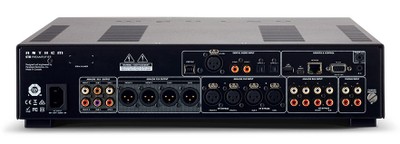

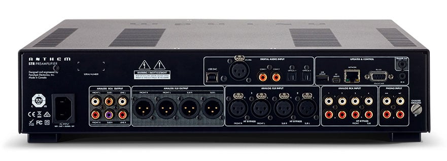

Anthem STR Preamp Back Panel
The Anthem STR Preamp has a wide array of I/O connectivity for a two-channel preamp. A full complement of balanced and unbalanced inputs and outputs, Toslink and coax, as well as a USB DAC and balanced digital input (rare option) are bestowed upon this product. A network connection is included, which is there for firmware updates but more importantly it makes Anthem ARC room correction setup a breeze by allowing you to network to it without having to connect the calibration microphone directly to the unit. Very slick. The top plate is more rigid than it looks. This thing just spews great build quality with no details left unturned including the radiused edges on the front panel.

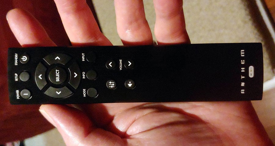

Anthem STR Brushed Aluminum Remote
The user interface is accessible via the 4-inch TFT display that boots up with the Anthem logo during power up that is akin to watching Window 95 boot up on a PC, although much quicker in Anthem's favor. The menu options are extensive, allowing virtually endless configurations for speaker and bass management settings including level and delay control, and tone control. You can customize inputs source levels and assignments, as well as create virtual inputs (for a total of 32), to enable ARC on/off allowing for easy on-the-fly comparisons. The remote control has no backlight or display, but has all of necessary buttons to navigate the front panel OSD. It's small enough to be mistaken for an Amazon FireTV remote which I've done in my theater room several times while reaching for it in the dark.

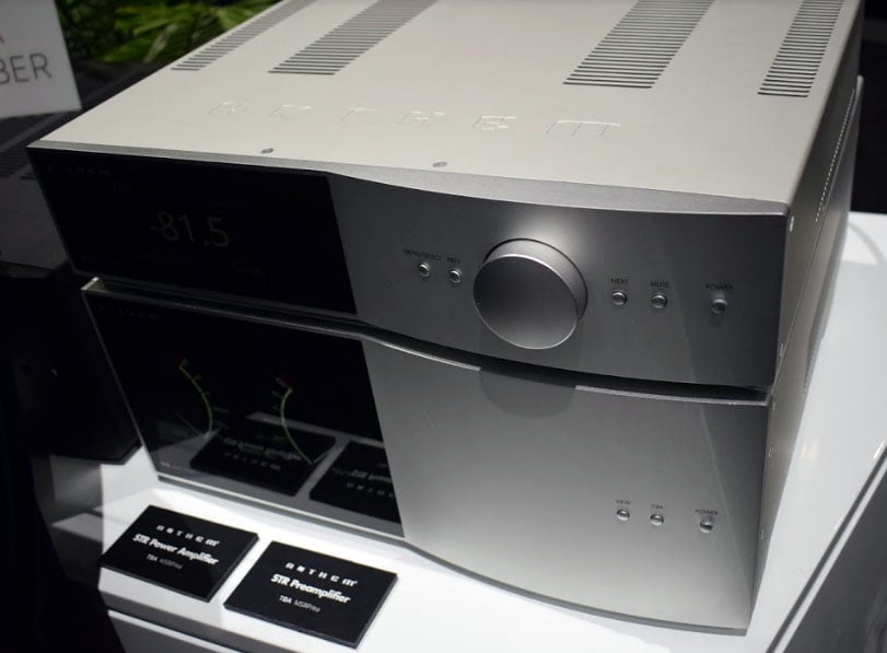

STR Power Amplifier Build Quality & Features

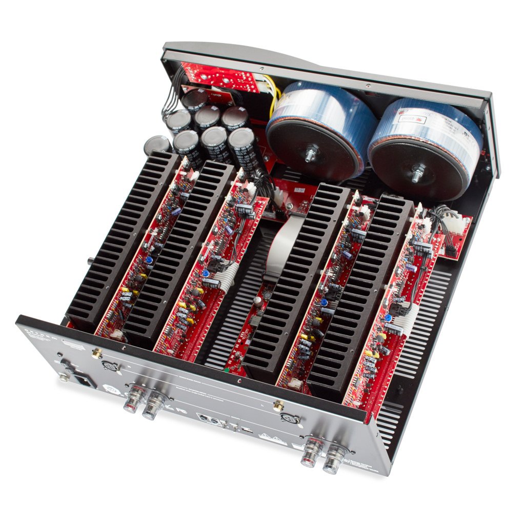

The STR amplifier is a brute. Upon first look one wouldn't think so but as Scotty used to say "She packs quite a wallop." It's rated at 400 watts/ch (8 ohms, 2ch driven) and 600 watts/ch (4 ohms, 2ch driven) with a conditional rating (more on that later) of 800 watts/ch (2 ohms). It's a traditional Class AB design with a linear power supply featuring dual 600VA toroid transformers (one for each channel).
Note: Anthem claims that this is a long-term temperature rating for the transformers (a thermal switch is built-in). They can deliver substantially more than that continuously for several minutes.
There are two independent capacitor banks, one for each amplifier. Each amplifier channel has 4 x 8,200 uF (32,800uF total) 100V power supply capacitors (so each +/- rail has two in parallel). This is just shy of 100uF/watt (40,000uF for 400 watts) that is a rule of thumb many amplifier designers employ in no compromise designs. Anthem doesn't employ rail fuses on this design, which would increase ESR. That’s a fancy term for resistance, which is an undesirable attribute. Instead, they employ two 10A slow blow fuses (for the 120 V product), one for each transformer. Anthem takes things one step further by employing a soft turn on circuit. Power is first applied through NTC thermistor in-rush current limiters. Then the NTC’s are bypassed. This associated circuitry eliminates a pop on sound you get with many amplifiers during initial power up while the NTC reduces the power sag on an outlet when all gear turns on simultaneously.
The output stage essentially combines two amplifiers per channel (8 output devices each for a total of 16 per channel) in a bridged tied load configuration which allows for double the output power. Anthem claims the STR amplifier "benefits from their proprietary input topology—a unique departure from the classic differential input stage," but no elaboration on that point is provided. Anthem employed a cascoded complementary feedback input stage on the STR amplifier which is said to reproduce the sound that approximates the linearity of Class A operation without the inefficiency. Anthem uses no rail fuses on this amplifier but instead employs a sophisticated DSP for "advanced load monitoring" the outputs and protect from fault conditions or over temperature.

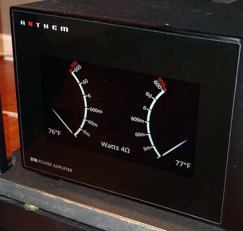

Anthem STR Amplifier TFT Power Meter Display
Note you can set the meters to properly read power into 8, 4 and even 2 ohm loads!
In fact, perhaps the coolest thing about the STR amplifier that you won't find elsewhere is their 7-inch TFT graphic control display that not only provides a posh power meter for both channels, but also shows the status of the amplifier including the ability to monitor heatsink temperature and load condition. The STR amplifier will actually warn you if the line voltage drops below nominal operation (108Vrms, domestic) or if excessive high frequency content is detected on the output. These are great countermeasures to ensure you protect your equipment, especially those delicate tweeters in your speakers.
I've always wanted an amplifier with big power meters on the faceplate but short of spending 10k+ on a McIntosh, there are few options on the market. Anthem decided to put a modern twist on the power meter by going digital. They are quick responding meters unlike predecessors of lesser design. This means you get to see real-time power usage and can even specify if the nominal impedance of your speakers is 8, 4 or 2 ohms to get accurate power readings.
Anthem STR Power Ampilfier
Notice the dual heatsinks per channel and Dual Toroidal Power Supplies
The STR amplifier has both unbalanced and balanced inputs along with dual triggers, which can trigger off the STR preamp and a secondary preamp should you use the HT Bypass Mode of the STR preamp.

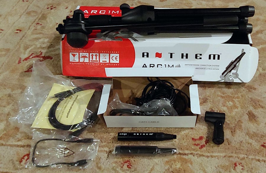

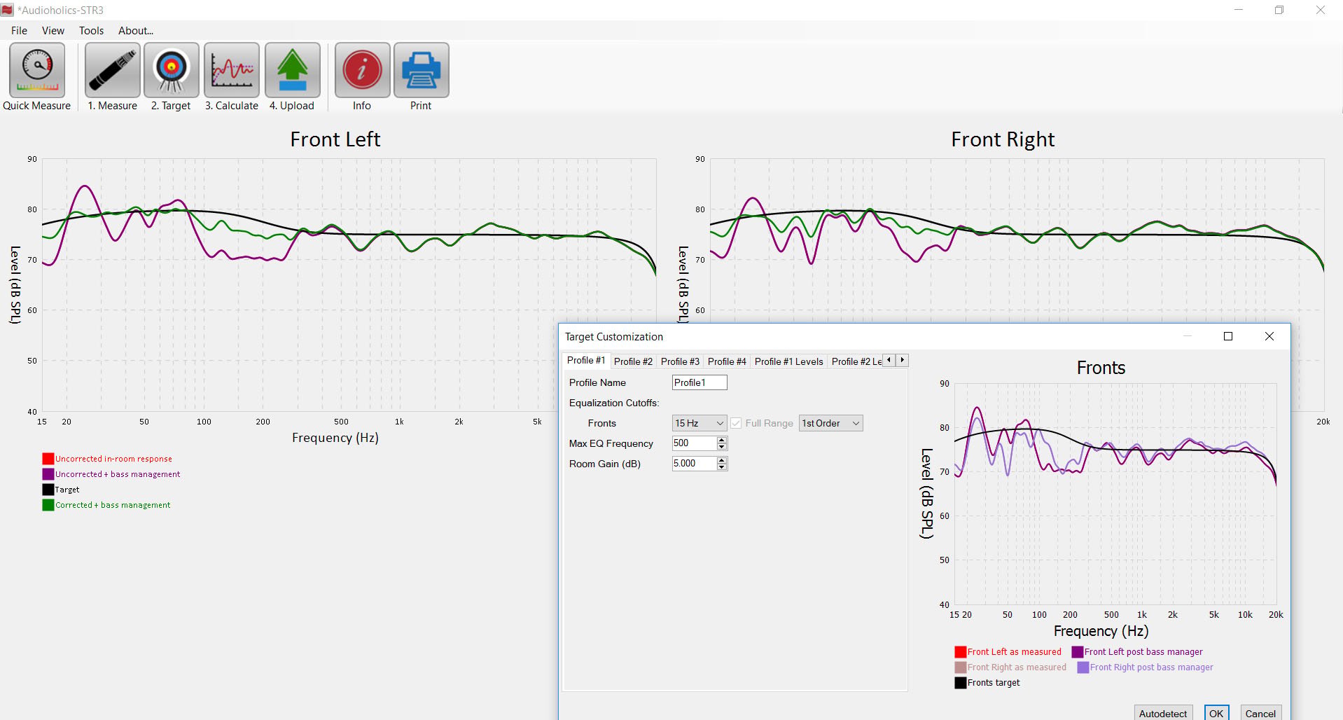

Anthem ARC is a new room correction software to me so I wanted to really dive in deep to see how it performed. I found the system was quite intuitive and plan on doing a dedicated YouTube video on it in the near future to better illustrate.
Anthem ARC can be used in 3 different ways:
- included microphone plugged directly into the PC via USB with STR on the same network.
- included microphone plugged into a tablet or smartphone (3.5mm or USB depending on IOS or Android).
- using tablet or smartphone built-in mic.

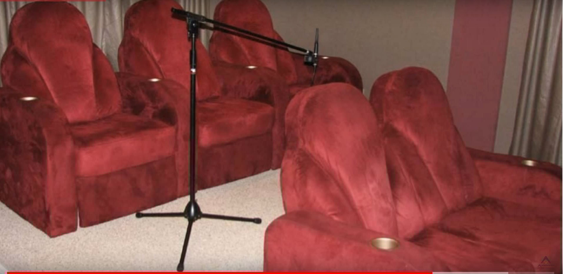

The mobile app is likely most convenient but for best results you really should load the Anthem ARC software on your PC and use the included calibrated microphone. I chose this route along with the USB connection so I didn't have to worry about the cable not being long enough between the STR preamp and my seating area. I found it incredibly ingenious that Anthem allows for networking their preamps with ARC since this is especially useful if you're calibrating a system where the processor is NOT in the same room as the speakers.
When placing the microphone for calibration, it's important to consider the following for best results:
- place the microphone pointing straight up, seated ear level position at the primary money seat with a clear line of sight path to ALL speakers.
- don't place the microphone in outlier seated areas of the room. Instead stick within a 3 ft radius from the primary seat for best results.
Note: I must point out that the test sweeps are extremely LOUD. You can't lower the level with the master volume while the calibration is running. ARC attempts to calibrate at 75dB at the listening position. If this is too loud for you, either wear some earplugs during the setup, or go into the software and lower the level before initiating the calibration.

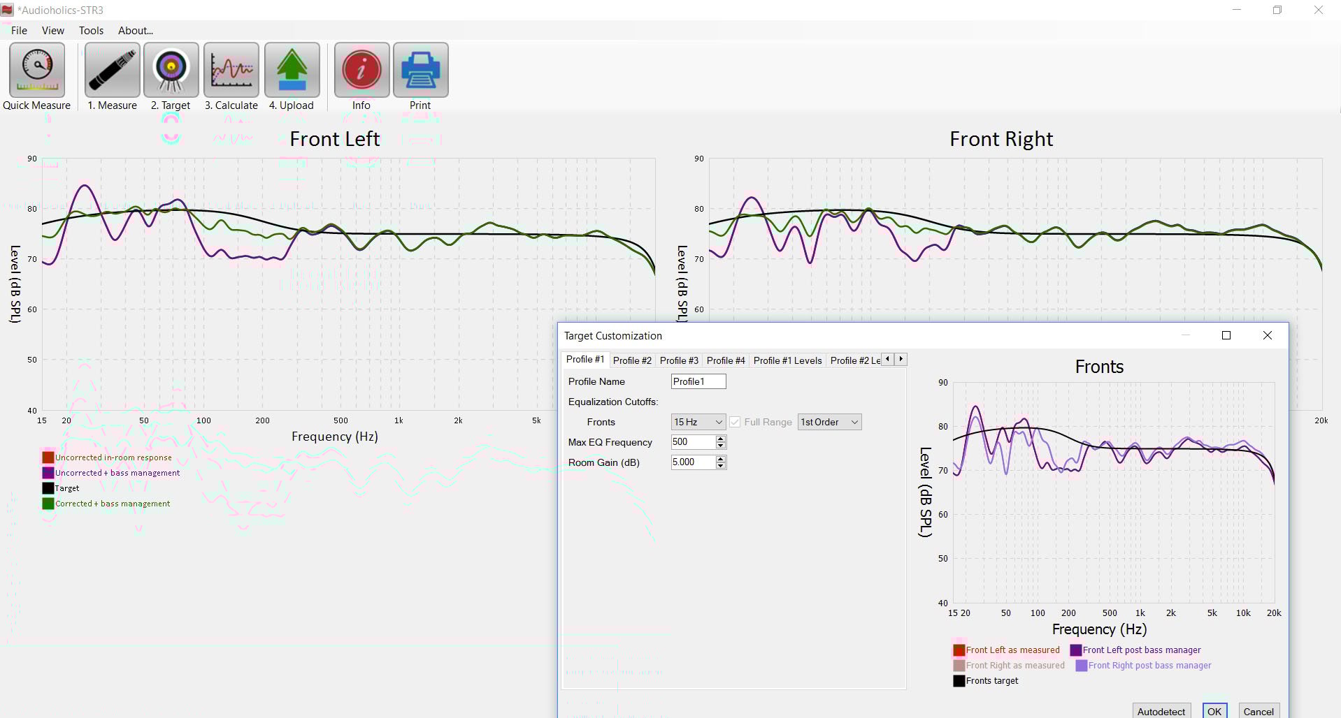

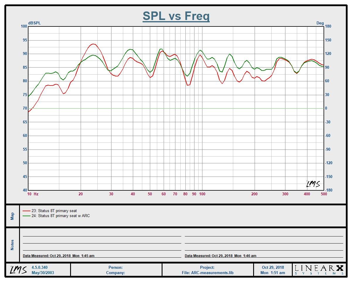

After running 6 positions, with ARC default calibration settings engaged, I was ready to roll. ARC allows for adjustment of the HPF slope and frequency, and range of correction (up to 5kHz) but it does NOT let you alter the curves in any other way like some of their competitor room correction systems do. ARC also set's speaker level but surprisingly does NOT adjust speaker distance. If you want to fine tune distances, you will have to do this in the STR preamp speaker settings menu.
ARC Calibration Results
I did some initial listening to compare ARC on/off via digital sources and found the bass was a bit too lean and the upper midrange energy was a tad lowered compared to ‘off’ for my liking. So, I went back in and limited the correction to 500Hz and adjusted the HPF from 20Hz, 4th order to 15Hz, 1st order and bumped the room gain up from the default setting of 3dB to 5dB. Voila! This was MUCH better! Bass was slightly deeper, and tighter than ARC disabled, and the mid frequencies were similarly good with ARC turned on or off.
Editorial Note about ARC Calibration Levels vs. Analog Direct:
When I enabled ARC for analog sources, I found I initially preferred ARC off which was due to a level drop of 3dB ARC made to calibrate my system to a 75dB reference. This was only noted on analog sources when compared to analog direct which does NOT retain level calibration settings. The simple fix to allow me to compare apples to apples was to zero out the speaker trim settings to rerun my comparisons.
One thing that's important to note, is if you start with really good speakers and have good room acoustics, a room correction system worth its salt should alter the sound above the room transition frequency (the point where the room no longer dominates speaker behavior, usually 300-500Hz in small rooms) very little. That's because at lower frequencies, the room dominates the sound but at higher frequencies (above the room transition frequency) the speakers dominate the sound. ARC was doing exactly what it was supposed to be doing which was NO harm, something I've not found to be true with some competing room correction systems. In fact, when I sent the calibration file to Anthem, they were quite taken with the little amount of correction ARC was doing above a 500Hz before I limited the bandwidth of correction. Again, if you've got a very linear speaker system such as mine with lots of midrange surface area to radiate a higher proportion of direct sound to the listening area, you just don't need or want much EQ correction.

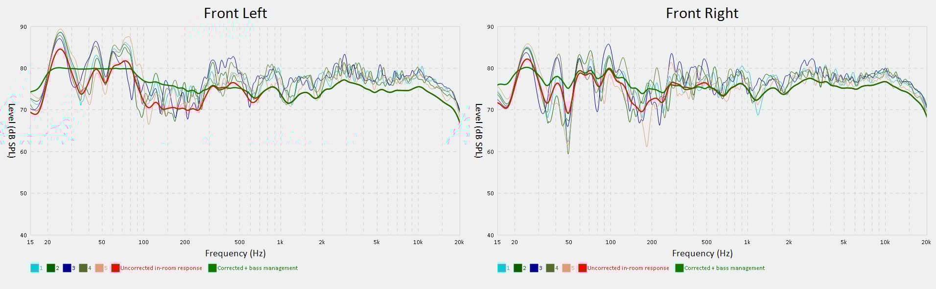

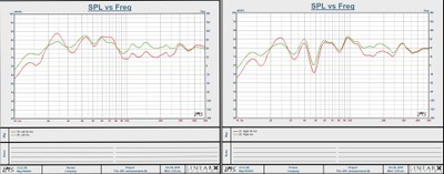

I was impressed with the measurement reporting ARC provides in their software. Many competing room correction systems give a very pretty before and after graph that has no basis in reality but instead is often just a target curve. This was not the case with ARC. Instead, ARC measures at 48kHz sampling rate, post processes, then smoothes to 1/12th octave resolution for individual measurements and 1/6th octave for combined measurements. These are actual useful graphs and I was able to replicate their results with my own measurement software. It was reassuring to know ARC was basing its corrections on the acoustical reality of my speaker to room interface instead of some sci-fi fantasy that you often get with competing systems. They even offer the option to PDF the results so you can have them for your records or a calibrator can hand them to their customer to prove that he or she has earned his pay for the day by proving your system NOT only sounds better with ARC but it also measures better too!

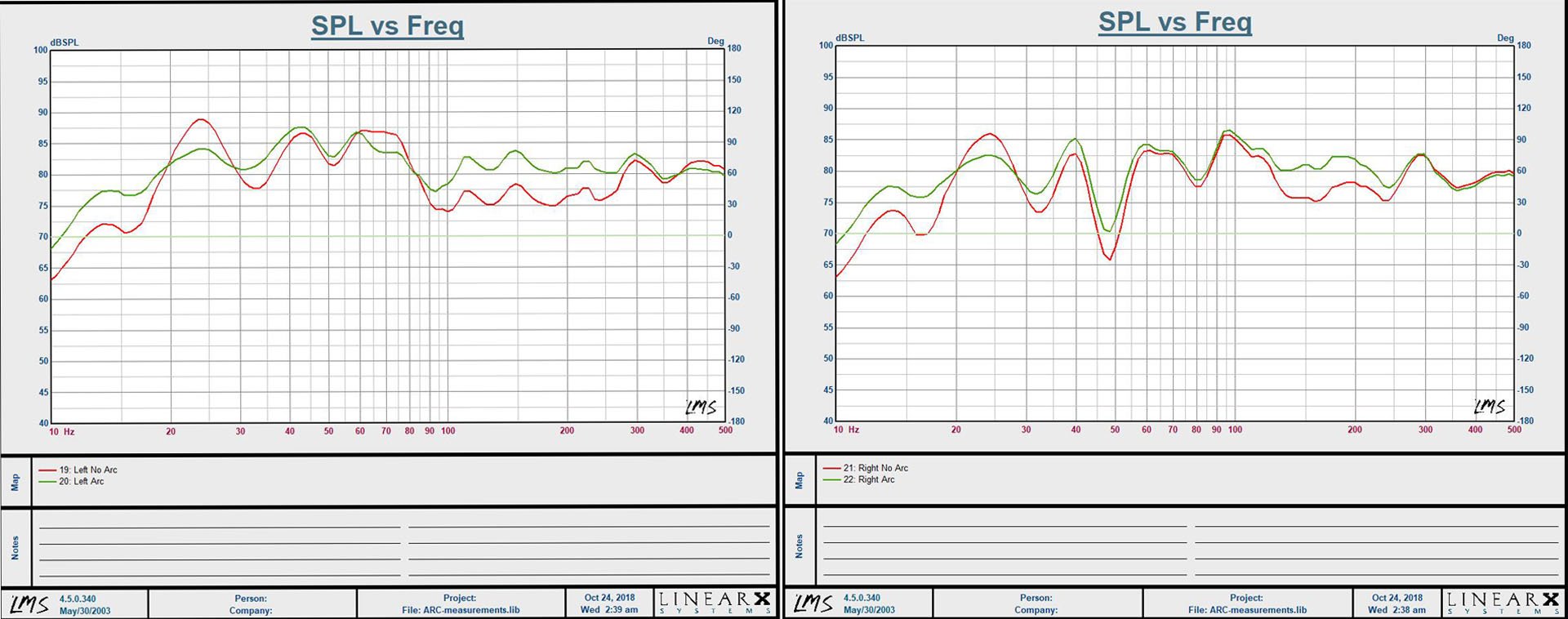

Anthem ARC Calibration Measurements of my Reference Speakers at the Primary Listening Seats
Anthem ARC Calibration Before/After Results with some Tweaking
As you can see, my left and right speakers measure very similarly above the room transition frequency at my listening position despite the fact that I don't have a symmetric room (right wall further away than left). With the bass tweaks I previously mentioned, my after-calibration response actually has better extension below 20Hz and ARC did a great job correcting a gap in the 100-300Hz for both speakers which was an audible improvement.
In-Room Measurements Averaged (1/6th Octave Smoothed)
No ARC - red traces ; ARC engaged - green traces
This is the averaged response across all 6 points approximately located where I ran ARC calibration. The measurements were taken from 10Hz to 500Hz where I limited ARC room correction. As you can see, they track pretty closely to what the Anthem measurement system measured. ARC improved a suckout in the 100-200Hz range that I've struggled with in my room. The room mode at 25Hz was also flattened a bit while a good boost was added below 20Hz. I of course could have further reduced bass energy below 25Hz but this sounded so good like this, I didn't want to thin the bass out.
Note: Only apply very low frequency bass boost if your speakers have true low-end extension at high SPL. My reference speakers each have (3) high excursion 10" drivers that exceed our Extreme Bassaholics room size rating. It's usually not advisable to be bass boosting a small tower speaker with a couple of 6" or 8" mid-bass drivers.
Both Speakers at Primary Listening Seat (1/12th Octave Smoothed)
Unfortunately ARC doesn't allow you to see the combined measured response of both speakers so I did this myself using my LMS system to see how much bass response was improved in the system as a whole at the primary listening seat. With no ARC, my speakers measured +/-8dB from 18Hz to 500 Hz. With ARC engaged, this not only increased my low-end bass extension but also tightened the response to +-5dB from 12Hz to 500Hz. This is an excellent measurement and explains why things sounded so tight and accurate in my listening tests.

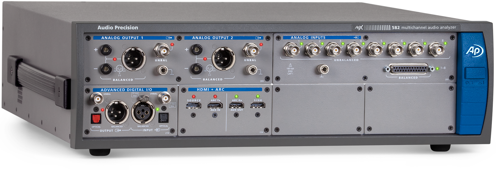

All measurements
were conducted using our Audio Precision APx585 8 Channel HDMI Audio Analyzer.
Unless otherwise noted, all tests were conducted on the balanced connections of
the STR preamp and power amp.

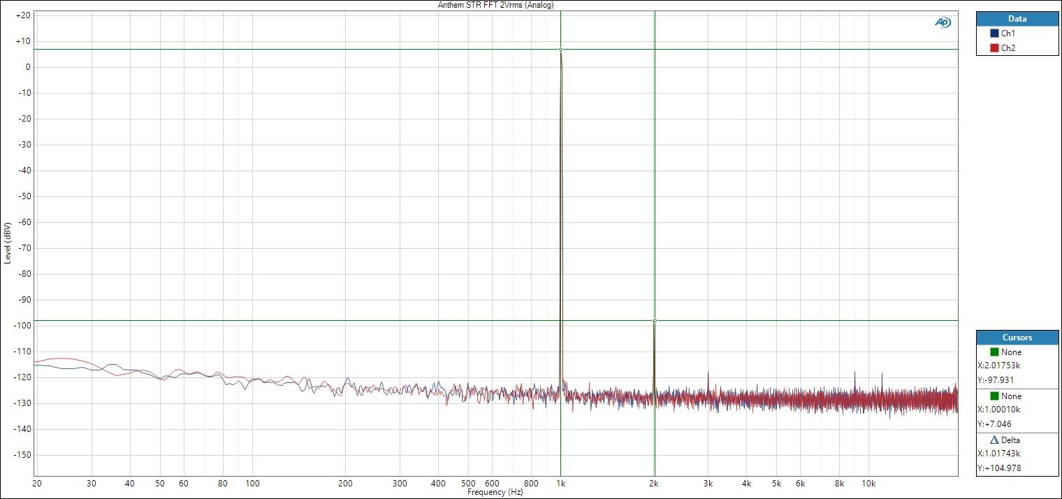

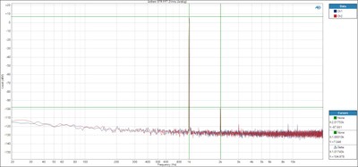

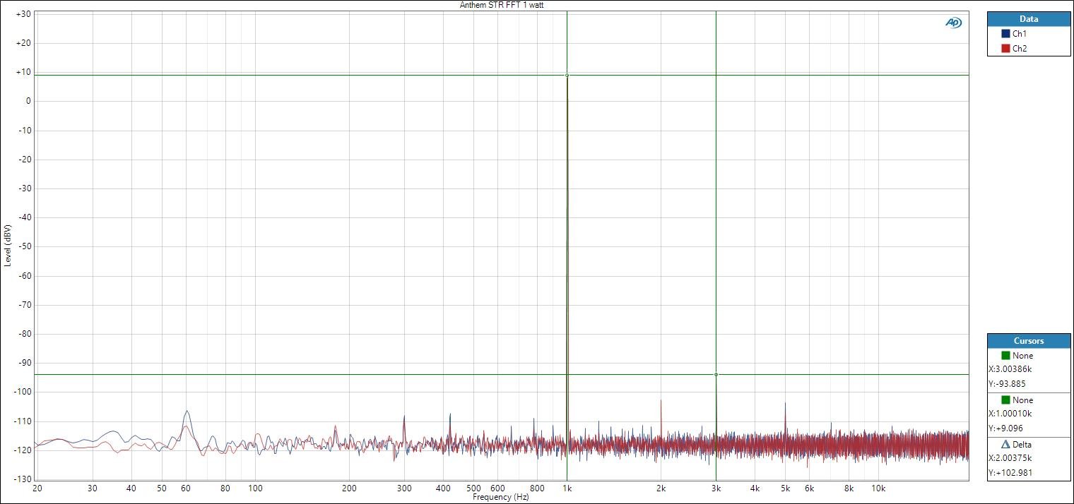

I verified the STR Preamp was able to deliver 3.3Vrms (RCA) and 6.6Vrms (XLR) unclipped as specified by Anthem.
At 2Vrms out via the balanced outputs, the STR exhibited a squeaky clean FFT output with the 2nd order harmonic being 104dB below the fundamental. I remeasured this via a 0dBFS digital source at the same output level and noted the 2nd order distortion of the FFT was about 2dB higher.
Anthem STR Preamp Out FFT Distortion Analysis @ 2Vrms

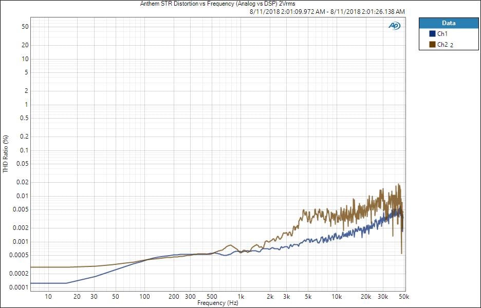

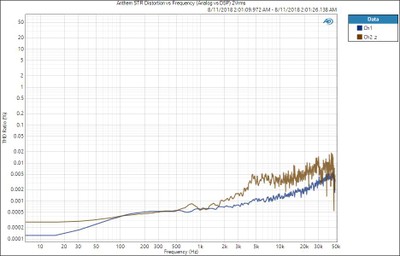

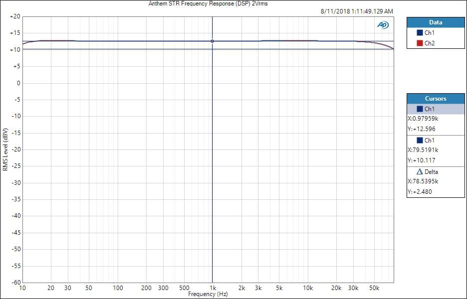

I directly compared THD (distortion) vs Frequency (Hz) of the analog direct path vs. converting the analog signal to digital (ADC) via the internal DSP. As you can see below, with DSP engaged, distortion rises slightly above 2kHz but still exceedingly low nonetheless.
Anthem STR Preamp THD Analog vs DSP

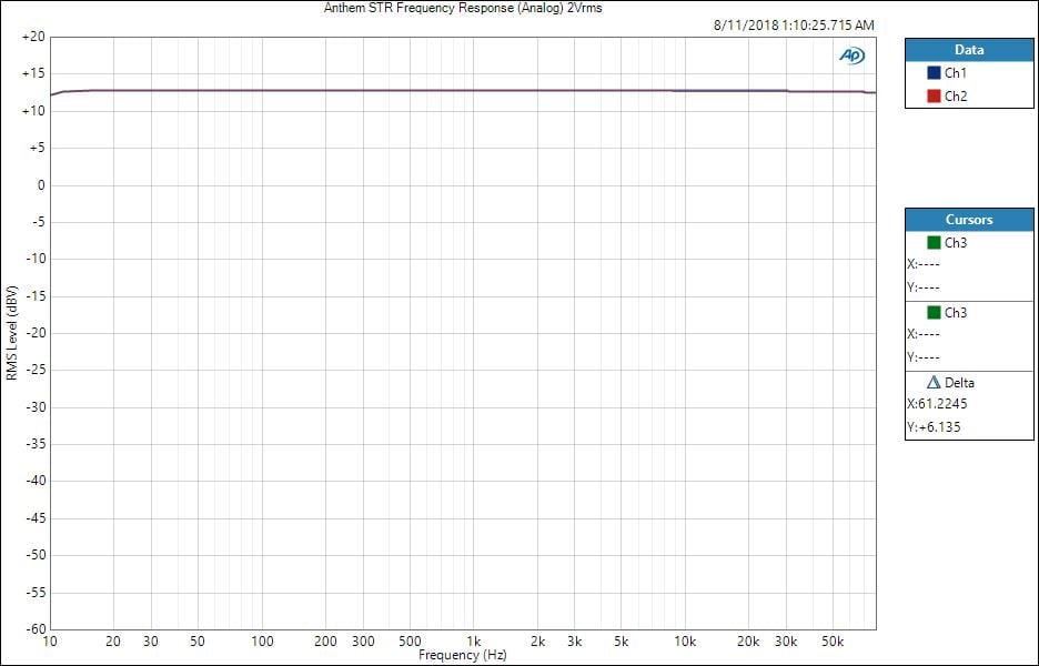

In analog bypass mode the -3dB pt of the STR preamp exceeded the bandwidth of my test gear (80kHz) with +/- 0.41dB ch-ch deviation. But, with DSP engaged, the STR still exhibited excellent frequency response -2.5dB @ 78kHz.
Anthem STR Frequency Response - Analog (left) vs DSP engaged (right)

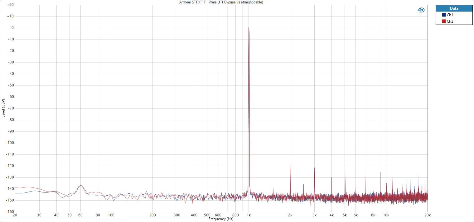

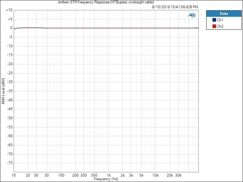

I compared the HT Bypass feature vs. just a straight through cable and didn't measure any discernible differences, which should put every audio purist at ease that they can use this feature without any sonic, let alone measurable, penalties.
Anthem STR HT Bypass vs Straight Thru Cable Frequency Response
Anthem STR HTBypass vs Straight Thru Cable FFT Distortion
Note: The residual harmonics shown in the FFT above the 1kHz test tone (i.e. -120dB @ 2kHz) are a limitation of the audio measuring equipment, not induced by the STR preamp.

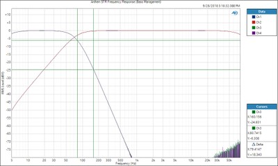

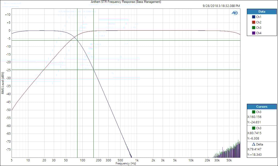

Anthem STR Bass Management
I measured the HPF and LPF responses of the bass management circuits and measured the -6dB pt and perfect 24dB/oct slope of the LPF and -3dB pt and 12dB/oct slope of the HPF at the selected 80Hz crossover frequency. Most home theater receivers wish they offered precise bass management like we've seen here in this two-channel preamp.

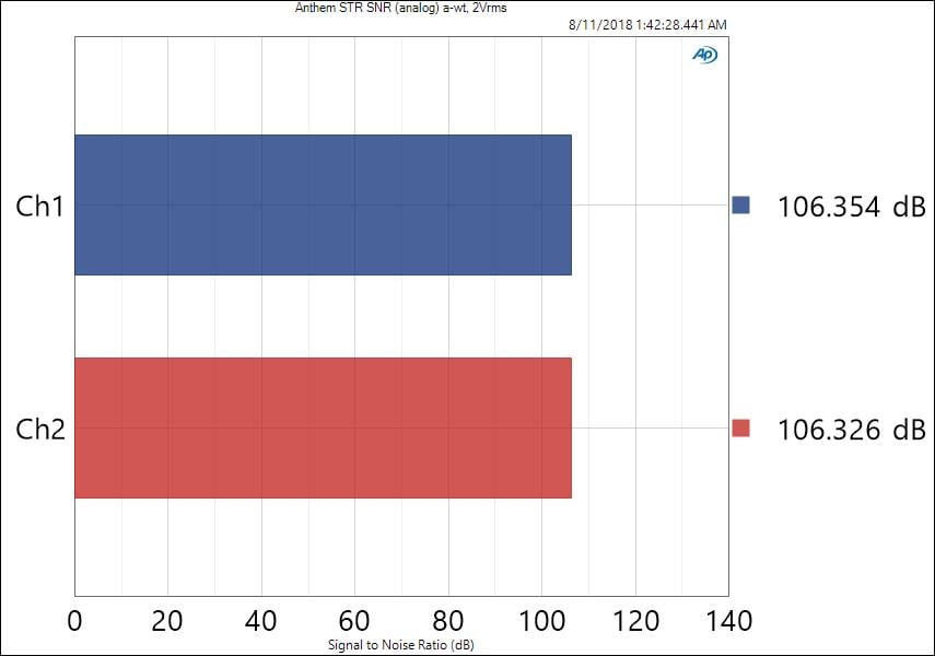

Anthem STR Signal to Noise Ratio @ 2Vrms - Pure Direct
With 1Vrms in and 2Vrms out, I measured 106dB SNR (a-wt) and 110 dB (a-wt) driving a digital input with 0dBFS and 2Vrms via the balanced output.
Anthem claims 120 dB (a-wt) for unbalanced and 118dB (a-wt) for balanced at 2Vrms output level. They got these higher figures by driving the inputs at 2Vrms (unbalanced) and 4Vrms (balanced), respectively, while measuring 2Vrms output ,which is good for specmanship but not very practical in real world usage. You can see by simply altering the input level of my test from 1Vrms to 4Vrms, would yield a 12dB higher value or (106+12) = 118dB (a-wt) validating their spec for the balanced output. This measurement is very good nonetheless. The STR preamp has very low noise.

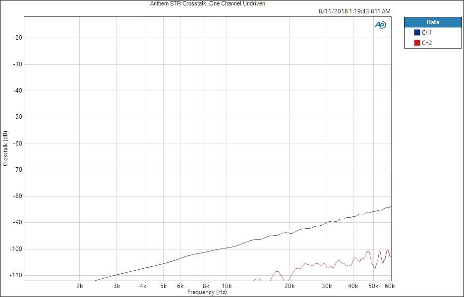

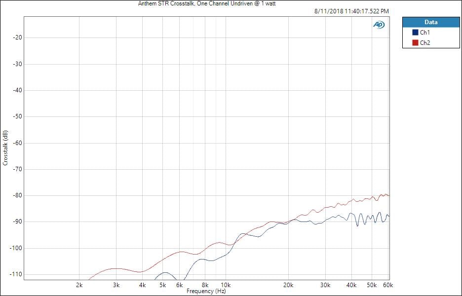

Anthem STR Crosstalk vs Frequency
I did measure a difference in crosstalk between the left/right channels, but the levels were so exceedingly low that it's nothing more than academic to note. -90dB at 20kHz is an excellent measurement and proves the STR preamp has excellent stereo separation.

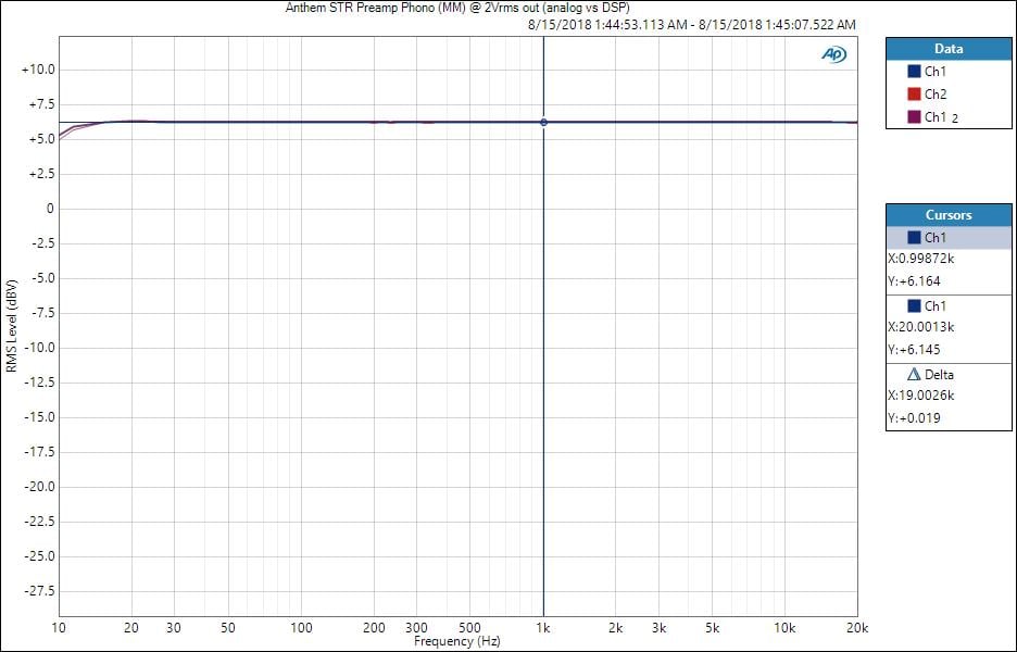

Phono Preamp
Anthem STR Phono Preamp RIAA Curve Analog Direct vs DSP ADC Conversion
The ADC on the STR is again proven superb as can be seen by how transparent it is vs. the analog direct path in the above frequency response curve. using Inverse-RIAA EQ curve, I measured phono out with 30mVrms input, 2 Vrms output+-.05dB from 10Hz to 20kHz.

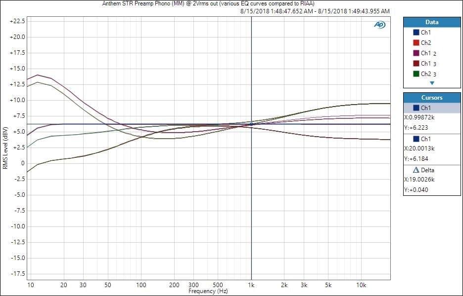

Phono Preamp Frequency Response Curves
I measured the various phono response curves that the Anthem STR offers to show you exactly what each do. The EQ inverse RIAA curve was used to measure the standard response and all other curves were directly compared. For the majority of my vinyl listening, I used the standard RIAA EQ but those with a large collection of older jazz recordings may wish to experiment to determine what sounds best.

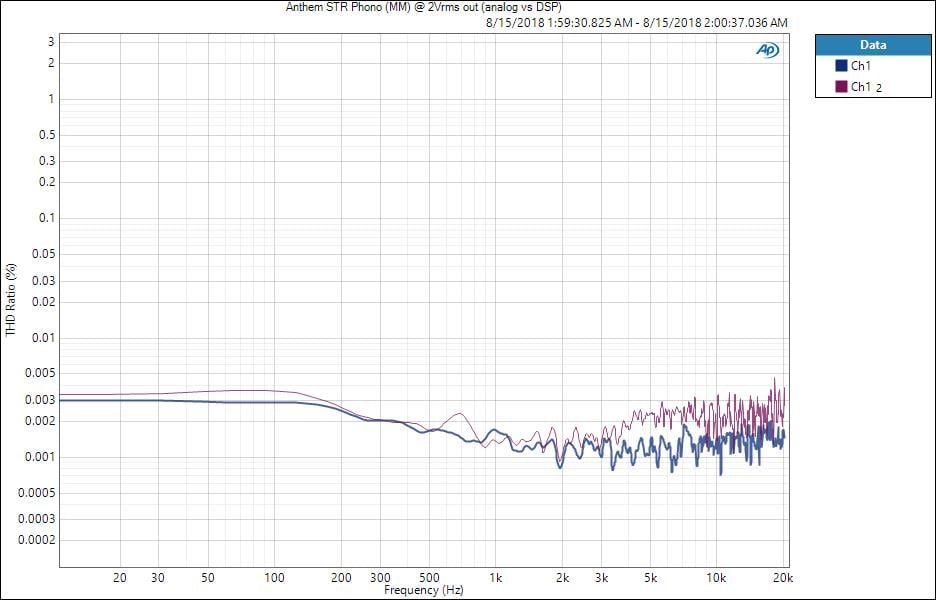

Using a 10mVrms input signal, I measured distortion from the phono output (MM) at 2Vrms out, which was excellent as you can see in the above graph. Using the ADC to enable ARC room correction should NOT have any deleterious effects on sound quality as distortion at 20kHz is < .005% which is well below audibility (arguably around .1%).

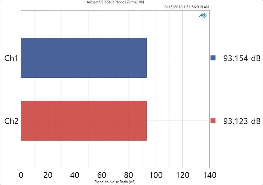

Anthem Phono Preamp SNR @ 2Vrms
Once again my SNR #'s are much lower than Anthem's since they are apparently driving the inputs at near clipping to achieve their ratings. If I exceeded 30mVrms input, HF at 20kHz rolls off and HF distortion increases so all my tests were done at 10mVrms input and achieve an excellent rating of 93dB SNR (a-wt). 10mVrms is more than sufficient drive to represent the output voltage of a MM cartridge. I believe Anthem spec'd their SNR at around 90 mVrms at 1kHz to achieve their 110dB (a-wt) SNR rating.

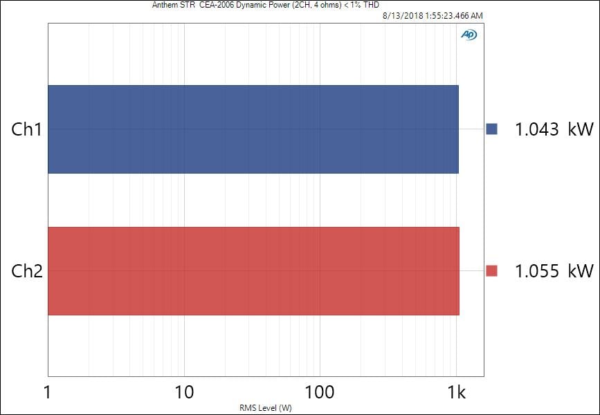

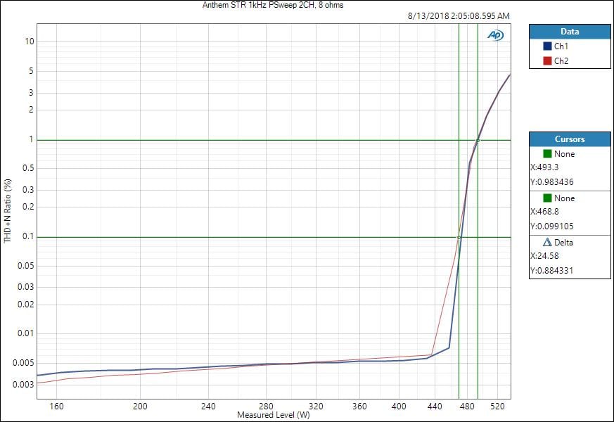

Power Measurements
Using our Audio Precision APx585 8-channel HDMI analyzer, we conducted a full barrage of multi-channel amplifier tests on Anthem STR per our Amplifier Measurement Protocol. We tested power using three methods all of which were taken at < 0.1% THD + N:
- Continuous Full Power Bandwidth (CFP-BW) from 20Hz to 20Khz into 8 and 4-ohm loads (up to two-channels)

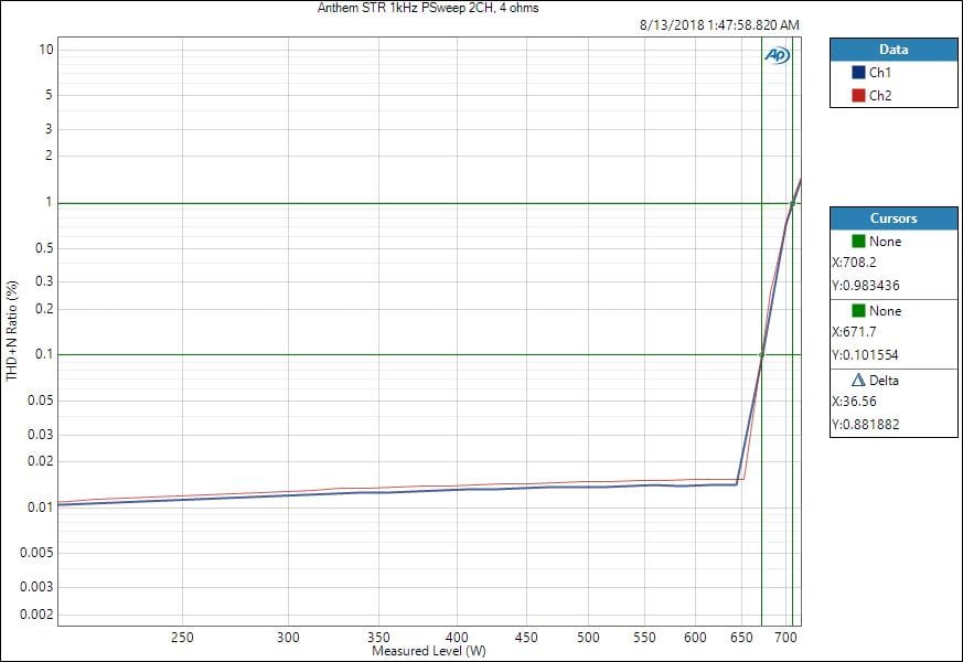

- 1kHz Power Sweep vs Distortion (1kHz PSweep) - popularized by the print magazines, this is an instantaneous power vs. distortion test at 1kHz. The problem with this test is it often masks slew-related and or frequency response problems some amplifiers exhibit at the frequency extremes, and thus inflates the measured power results. It does provide an instant gratification # for consumers to argue over on the forums so we are now incorporating this test to please the masses.
- Dynamic PWR - 1kHz CEA-2006 Burst Method testing. This is a dynamic power measurement adopted from the car industry, similar to IHF method only a bit more difficult for an amplifier and more representative of real musical content.
Keep in mind most review publications don't do continuous power measurements and they usually publish power measurements into clipping at 1% THD + N. Our measurements are very conservative as we use a dedicated 20A line with no Variac to regulate line voltage. We constantly monitor the line to ensure it never drops more than 2Vrms from nominal, which in our case was 120Vrms.
For more info on amplifier measurements, see: The All Channels Driven (ACD) Test

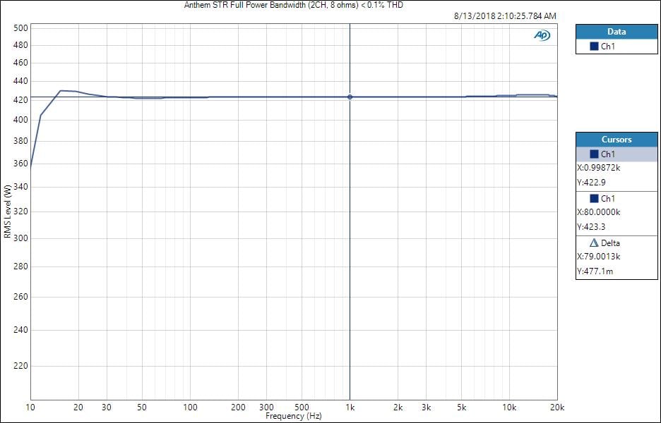

Anthem STR CFP-BW (2CH) Power Test - 8 ohms
With two-channels driven, the 400 watt/ch rated STR delivered 422 watts/ch for full bandwidth 20Hz to 20kHz at < 1% THD at 8 ohms and 622 watts/ch at 4 ohms under the same conditions.
Anthem
STR 1kHz ACD (2CH) Power Test - 8 ohms (left pic) ; 4 ohms (right pic)
With a 1kHz sweep test, the STR was able to muster an impressive 493 watts/ch at 1% THD and 468 watts/ch at 0.1% THD with 2ch driven into 8 ohms and 708 watts/ch at 1% THD and 671 watts/ch at .1% THD+N with 2ch driven into 4 ohms. This should be plenty of power to drive virtually any loudspeaker since I found the STR had no issues driving my own reference speakers (Status Acoustics 8T) which dip down to 2 ohms in the bass region.
Anthem STR Dynamic (2CH) Power Test - 4 ohms
The STR performed well for 1kHz CEA 2006 short dynamic burst tests by delivering over 1 kwatt of power with 2ch driven at 4 ohms.
# of CH | Test Type | Power | Load | THD + N |
1 | CFP-BW | 451 watts | 8-ohms | 1% |
2 | CFP-BW | 422 watts | 8-ohms | 1% |
2 | CFP-BW | 622 watts | 4-ohms | 1% |
1 | 1kHz Psweep | 499 watts | 8-ohms | 0.1% |
1 | 1kHz Psweep | 522 watts | 8-ohms | 1% |
1 | 1kHz Psweep | 723 watts | 4-ohms | 0.1% |
1 | 1kHz Psweep | 764 watts | 4-ohms | 1% |
2 | 1kHz Psweep | 468 watts | 8-ohms | 0.1% |
2 | 1kHz Psweep | 493 watts | 8-ohms | 1% |
2 | 1kHz Psweep | 671 watts | 4-ohms | 0.1% |
2 | 1kHz Psweep | 708 watts | 4-ohms | 1% |
2 | Dynamic PWR | 651 watts | 8-ohms | 1% |
2 | Dynamic PWR | 1043 watts | 4-ohms | 1% |
*1 | Instantaneous | 800 watts | 2-ohms | < 1% |
Anthem STR Power Measurement Table
* Note: The STR amplifier is rated at 800 watts/ch, 2 ohms (3 seconds), but I was unable to verify this with a sweep test without tripping the protection mode. I was able to verify the power claim by doing an instantaneous power test at 1kHz for under the time duration specified.
Anthem STR FFT Distortion Analysis (1 watt, 8 ohms)
The Anthem STR amplifier produced a very low noise floor (-120dB). At 1 watt, the 3rd-order harmonic residual dominates but it's exceedingly low at -102dB below the 1kHz fundamental.
Anthem STR CH-CH Crosstalk (1CH, Undriven)
The channel-channel crosstalk was excellent measuring -90dB at 20kHz again proving the STR series has superb stereo separation approaching true monoblock performance from a 2ch package.

STR series of products works, especially with regards to ARC room correction.
I've seen some bizarre recommendations about how one should calibrate a system
such as ARC not only from consumers but from professional installers that
really don't understand basic physics. You can't just place the microphone in
the room at random locations to allow ARC to calibrate and expect good results.
Instead, best results are achieved when following our recommendations listed in
this review. Post calibration is also critical in getting the most out of this
system. Find a reputable dealer that will take the time to set this system up
correctly in your room.

Remote Control | ![]() ![]() ![]() |
