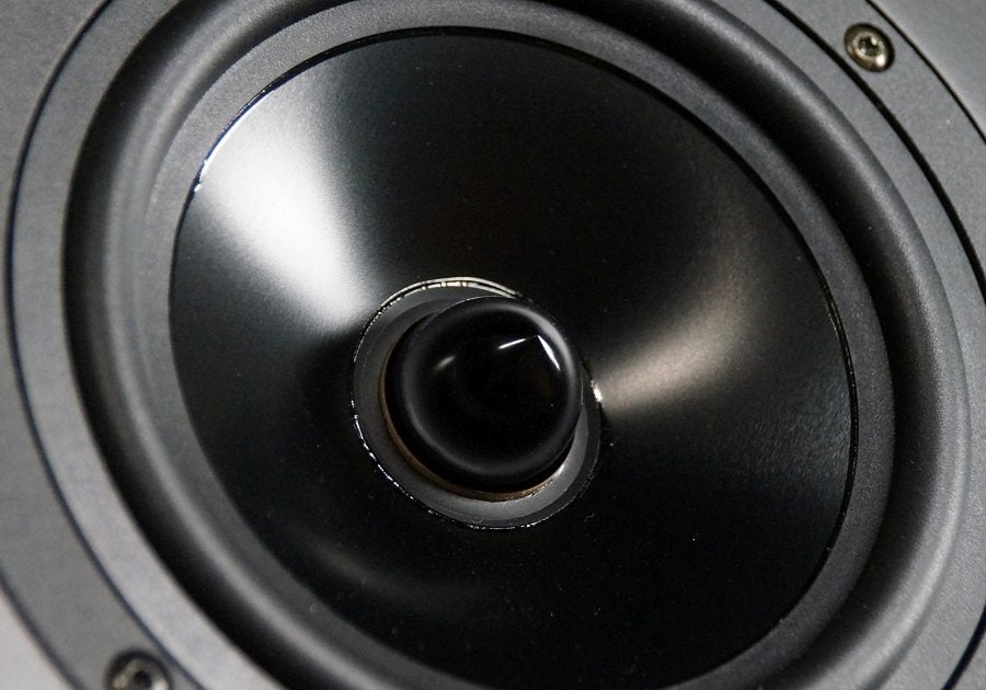

Midrange:5-1/4" (133mm) cast aluminum truncated basket, black alu cone, solid metal phase plug

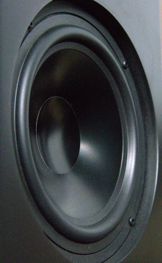

Bass: 8” (203mm) cast aluminum basket, aluminum cone woofer (black anodized)

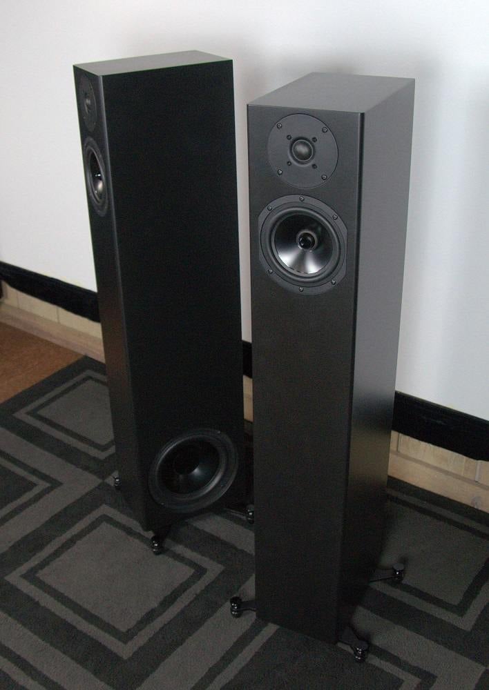

RBH Sound 85-i - Subwoofer like bass from a modest tower?
For a good few years now, RBH Sound hasn’t had any offerings in the entry-level segment of the loudspeaker market, likely due to their shift from China to the USA in manufacturing. The fact is that China can manufacture most consumer electronics goods far more inexpensively than can be done in the US, and this makes it difficult to find a profit in larger volume and lower margin speakers. However, the supply chain problems during the COVID-19 years taught American consumer electronics companies that dependence on Chinese manufacturing can be a double-edged sword. In order to have a more reliable supply chain, RBH went through the painful move to US manufacturing, and now that the shift to domestic cabinet manufacturing is complete, they are set to offer loudspeakers over a wider range of prices. For this reason, RBH Sound has now brought back their entry-level Impression series loudspeakers which are surely the lowest-cost loudspeakers made in the USA in their class. In for review today is the Impression 85-i, their 3-way tower speaker from this series featuring a side firing 8" woofer with subwoofer like bass, a 5 1/4" midrange and 1" fabric dome tweeter for a modest asking price of $1,195/pair. In evaluating these speakers, we will ask how they fare against other floor-standing speakers in their class? How do they perform, and can American manufacturing still compete with Chinese manufacturing for the cost? Let's now dig in to find out…

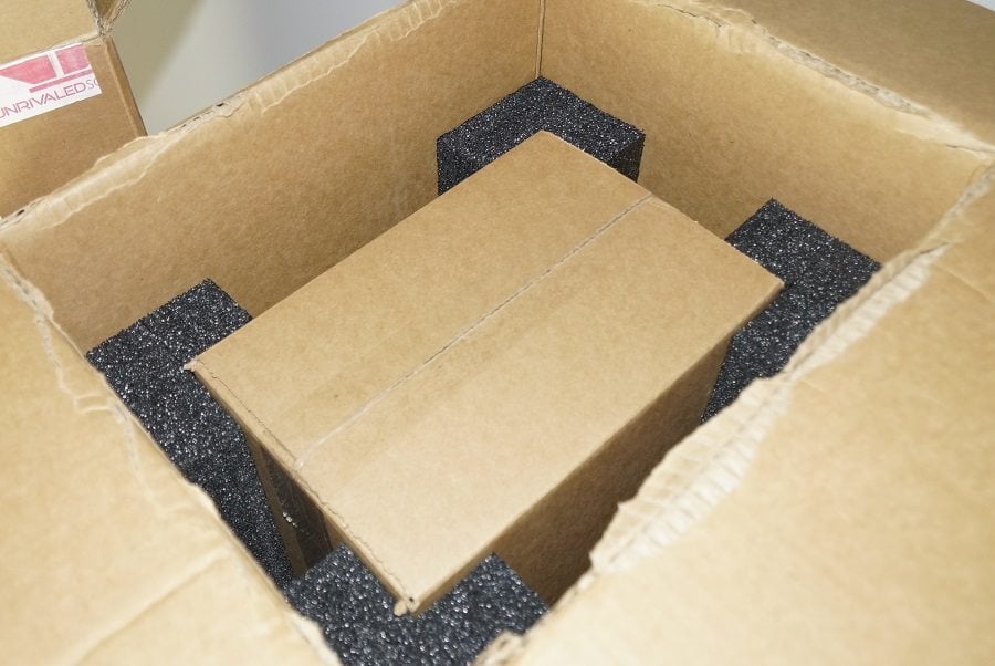

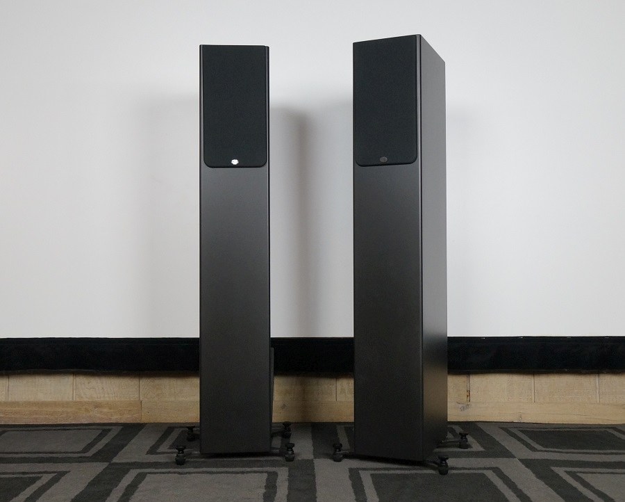

RBH Sound Impression 85-i Packing and Appearance

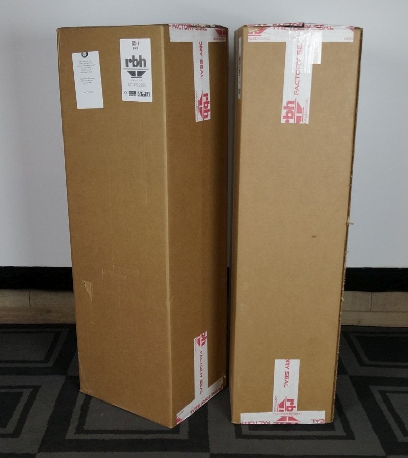

The RBH 85-i towers are not large speakers so they do not arrive in big boxes at your doorstep. The speakers are double-boxed, but the inner box lies underneath some polyethylene foam blocks that sandwich the top and bottom and also the vertical edges. Inside the inner box, the 85-i speakers are wrapped in a soft foam bag to protect against scuffs. Make sure not to cut deeply when opening the inner box since it is essentially right on top of the speaker, otherwise, your cutting tool will cut into the speaker’s finish. Overall, the 85-i speakers are well-packed against rough shipping, and I have seen more expensive speakers use flimsier packing than these.

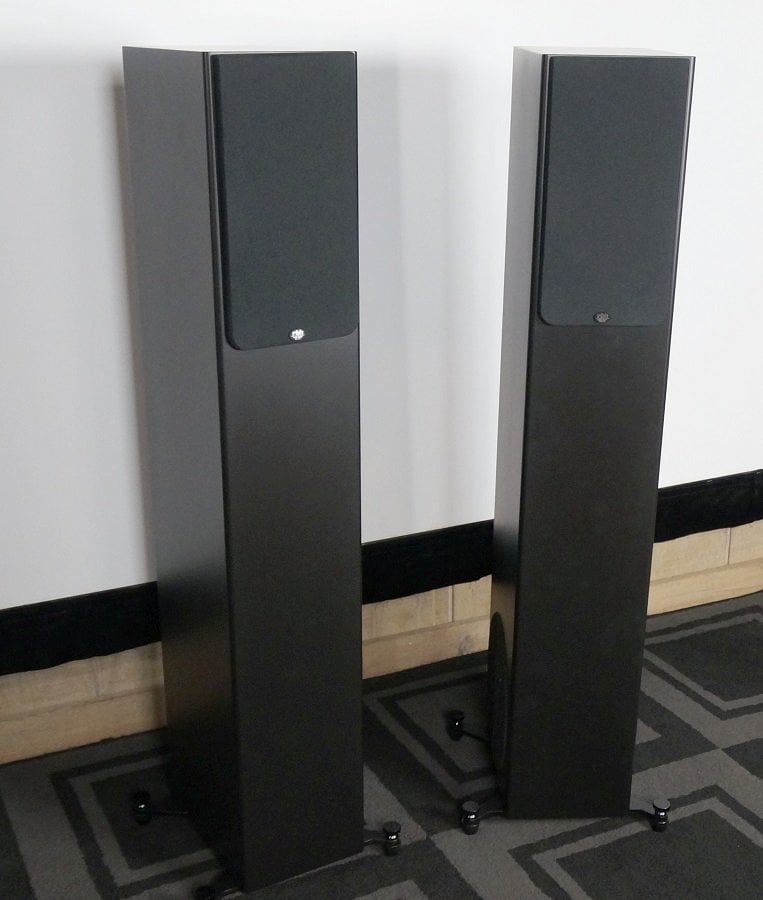

Once unpacked, the 85-is stand as a pair of modest tower speakers that have a simple, clean look. Without grilles, the only distinguishing features of the speakers are the drivers. Outside of the drivers, they are black towers with a satin black finish and rounded vertical edges. Since the drivers are all black, they don’t do a whole lot to stand out visually. It may be for the best that RBH eschews any other styling cues since speakers that are this small could get busy-looking quickly if ornamentation is applied to them. There are two grilles for each speaker: one to cover the front drivers and one to cover a side-firing bass driver. Users can opt for the grilles if they want to have an even more minimal appearance for the speakers. The front grille does have a small RBH badge near the lower edge, so the speaker doesn’t have to be completely featureless. The grilles use magnetic adhesion (unusual at this price) so they don’t have grille guides marring the front baffle. One nice touch is that the speaker has a true satin black finish instead of a faux-’satin black’ textured vinyl. It doesn’t have the finest satin black finish on the market, but at least it is an authentic one unlike many other speakers in its segment. Buyers who want a finer satin finish will need to step up to costlier speakers from RBH.

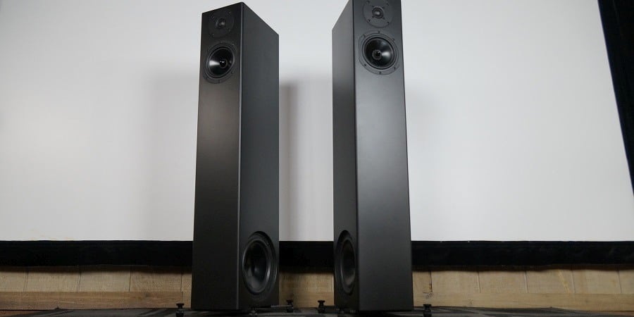

RBH Sound Impression 85-i Design Analysis
As floor-standing loudspeakers go, the 85-i is not especially complex, but it does have some notable attributes that set it aside from the competition (outside of its US manufacturing). Let’s start our discussion of the 85-i from the top with the tweeter. The tweeter appears to be a normal 1” fabric dome, and that is a perfectly fine recipe for a good tweeter. It does use a ferrite magnet which has a ⅝” thickness and a 2 ¾” diameter. Many inexpensive speakers use neodymium tweeters with no heatsinking, but Ferrite is often a better magnet because of its superior thermal dispersion; more surface area means more area in which to radiate heat. The midrange is a 5.25” aluminum cone with an actual solid phase plug. Some loudspeaker drivers in this class look like they have a phase plug, but the ‘plug’ are attached to the moving assembly and are cosmetic only. It also has a cast aluminum basket instead of a stamped steel frame (again unusual at this price). Cast aluminum is usually a better option over stamped since it’s often more rigid and paramagnetic.The tweeter and midrange driver have a separate sealed compartment in the cabinet, so the backwave pressure from the bass driver does not interfere with the midrange cone and vice versa. The bass driver has an 8” diameter and also uses an aluminum cone. It has a ¾” thick magnet with a 4 ¼” diameter, and the motor’s venting is done through the backplate.

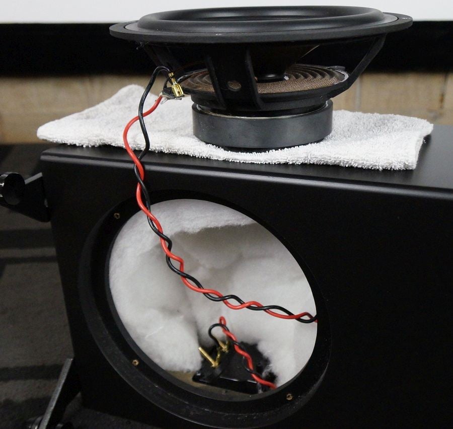

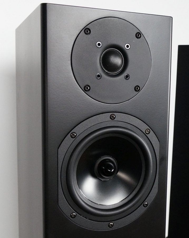

These crossover frequencies do give the midrange a lot of bandwidth, and an advantage of that is that there isn’t going to be any phase distortion from crossover filters over a wide range of speech and music spectrums. Those looking for a loudspeaker that should be good for speech intelligibility in particular may have a very good choice in the 85-i.
One interesting feature of the crossover circuit is the use of a self-resetting poly-switch. This protects the tweeter by raising resistance above certain electrical current levels that would place the driver’s voice coil in danger. There are some much more expensive speakers that have passed through my hands that I wish had this feature (I admit to having killed a tweeter or two). The RBHs are all internally wired with thick twisted pair cabling to minimize losses and crosstalk; a nice detail for a speaker of this price class.
The enclosure is made from high-density fiberboard (again, unsual at this price) instead of medium-density fiberboard, so it is a bit tougher than the norm. It uses 1/2” thick panels, and there is a window-pane brace about ⅔ of the way up the cabinet. Porting is done through a rear-mounted slot port. The slot port construction, tweeter/midrange compartment interior panels, and window pane brace help to make the enclosure quite inert. There is a generous amount of acoustic stuffing to help damp internal waves as well. This is a well put together speaker for its class of product!

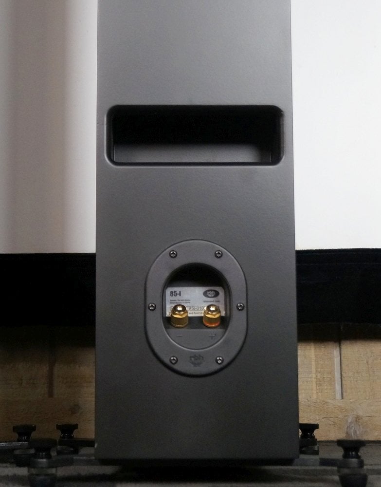

The 85-i uses a single pair of 5-way binding posts set in a terminal cup. Thankfully, RBH Sound has avoided the audiophile nonsense of using dual binding posts for a modest home audio speaker. The feet are some rubber domes that are mounted on aluminum outriggers. As was said before, the grilles use magnetic adhesion, and it does provide a good hold; some other speakers that had magnetic grilles had pretty weak force to hold the grilles on, and they could be knocked off easily. Thankfully, this is NOT the case with the RBHs.
Zooming out at the overall design, it can be seen that the 85-i is a lot more like a typical bookshelf speaker mounted on a subwoofer than ordinary tower speakers. This can be seen in the 100Hz crossover frequency as well as the low mounting of the bass driver (a benefit for minimizing ground bounce). That should help the 85-i attain deep bass extension for a smaller tower speaker, although it does come at the expense of dynamic range since the midrange has to deal with a lot of the mid-bass frequency band. That shouldn’t be a problem since I don’t think many people will be rocking these speakers loud enough to notice. These aren’t large tower speakers, and I would imagine that people will set their expectations accordingly. Nonetheless, I would guess that they will have more than sufficient dynamic range for a typical living room or bedroom system. But this is all just speculation based on looking at its design, so let’s now hear for ourselves how all of this audio engineering adds up in some real-world listening…

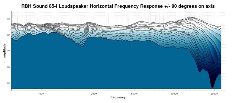

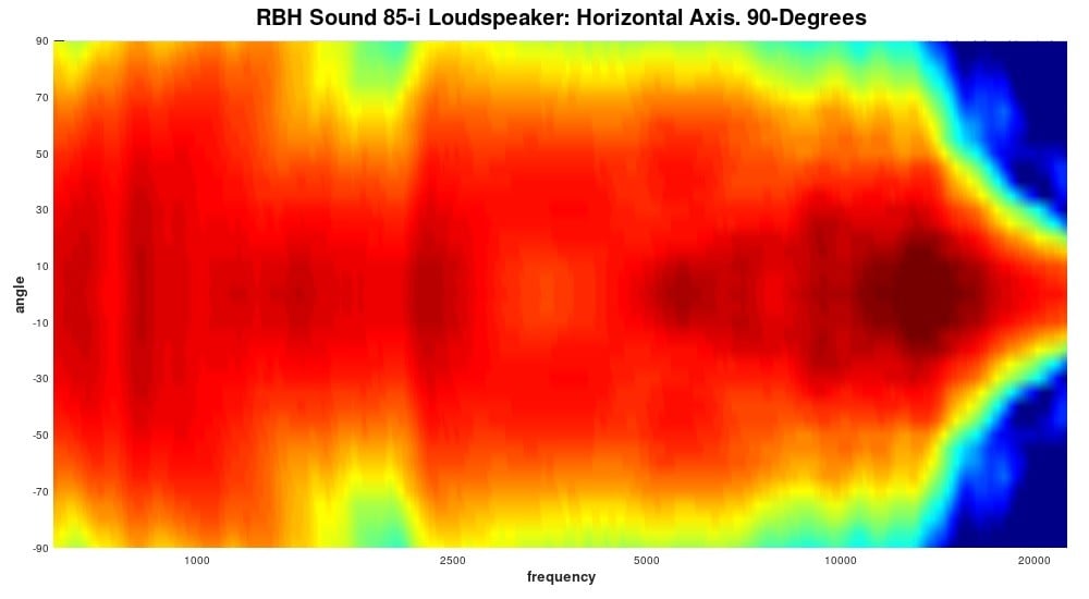

RBH Sound Impression 85-i Loudspeaker Measurements

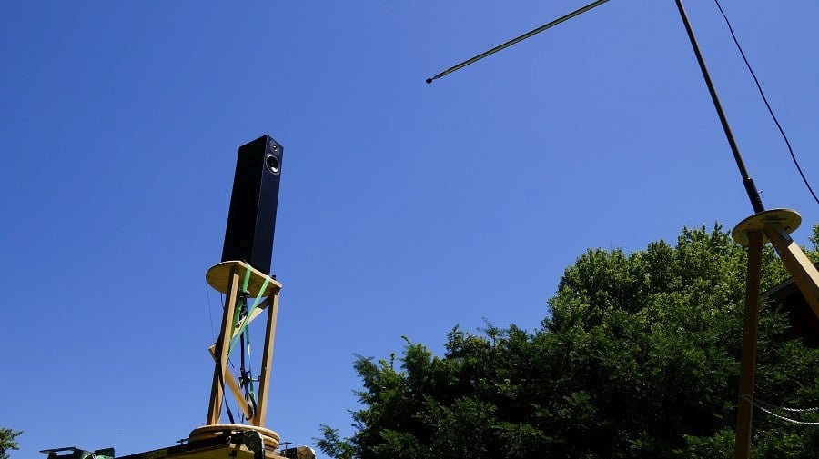

The RBH Sound 85-i was measured in free air at a height of 7.5 feet at a 1-meter distance from the microphone, and the measurements were gated at an 11-millisecond delay. In this time window, some resolution is lost below 250Hz and accuracy is completely lost below 110Hz. Measurements have been smoothed at a 1/24 octave resolution.

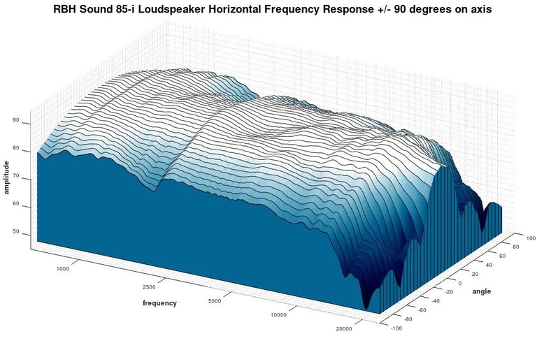

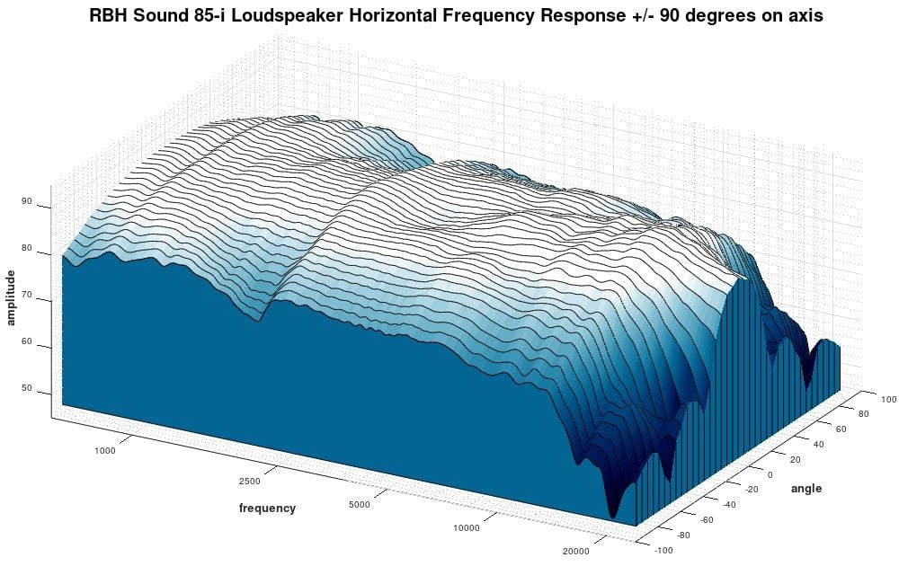

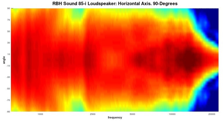

The above graphs depict the speaker’s lateral responses out to 90 degrees in five-degree increments. More information about how to interpret these graphs can be read in this article: Understanding Loudspeaker Review Measurements Part II. While this is not a flawless showing, there is a lot to like here, and it does explain some of what I heard. The midrange is well controlled and has a very flat response. At and near the on-axis response, we do see a somewhat elevated treble response, and this is what I heard in my own listening when I had the speakers angled to face me directly. Off-axis, this elevated treble calms down and becomes even with the rest of the frequency range. In fact, off-axis, the response becomes very neutral. We do see a slight directivity error develop at the hand-off from the midrange woofer to the tweeter, but it is not severe, and I wouldn’t expect it to manifest into any significant audible issue.
The above polar map graphs show the same information that the preceding graphs do, but they depict it in a way that can offer new insight regarding these speakers’ behavior. Instead of using individual raised lines to illustrate amplitude, these polar maps use color to portray amplitude, and this allows the use of a purely angle/frequency axis perspective. The advantage of these graphs is that they can let us see broader trends in the speaker’s behavior more easily. For more information about the meaning of these graphs, we again refer the reader to Understanding Loudspeaker Review Measurements Part II.
Here, we can see that the 85-i is a pretty wide dispersion loudspeaker and offers coverage over a broad area. We have at least a 50-degree angle off axis where these speakers will retain a full sound. We would have even more if we ignored that off-axis notch below 2.5kHz where the midrange integrates with the tweeter, but no one is reasonably going to be trying to listen outside a 50-degree angle, so it doesn’t matter much. The tweeter keeps a fairly wide dispersion up to a high frequency. Typical dome tweeters on a flat baffle usually have their tweeters begin constricting dispersion well below 9kHz, but the 85-i starts constricting its dispersion at around 14kHz. When it does start to beam, it does so at a rapid rate, and those who want to be met with high treble above 14kHz will want to angle the speakers to face them directly. However, without equalization, that treble will be a bit elevated.

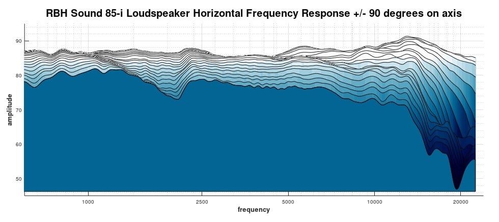

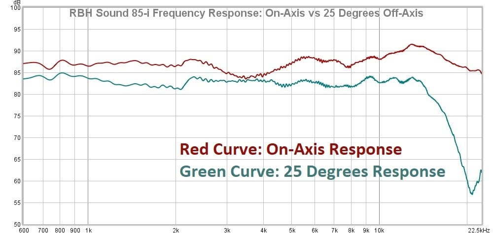

The above graph compares the on-axis response against a 25-degree off-axis response that would typically be where a listener would be with respect to the speaker where the speaker pair facing straight ahead rather than toed-in to face the listener directly. In my own listening, I felt the high frequencies were a bit aggressive when I had the speaker angled to face directly at my listening position, but when I angled them to face forward in parallel, the sound was a lot smoother to my ears. This graph explains why that is. In the on-axis angle, there is a dip at 3.5kHz that accentuates a rise in treble above that point which peaks at about 14kHz.This makes for a somewhat forward sound that, while it wasn’t immediately bothersome, I found to be a bit fatiguing after awhile. However, after angling them to simply face outward, I was met with a pleasant and balanced sound that I could listen to perpetually. In fact, the tweeter’s bandwidth at this angle is nearly ruler flat up to 14kHz. Above that range, output drops off precipitously, but there isn’t much content at such high treble frequencies nor do many adults hear well in that range anyway. Some users might prefer the hotter on-axis treble, and to get that, simply angle the speaker to face the listening position directly.

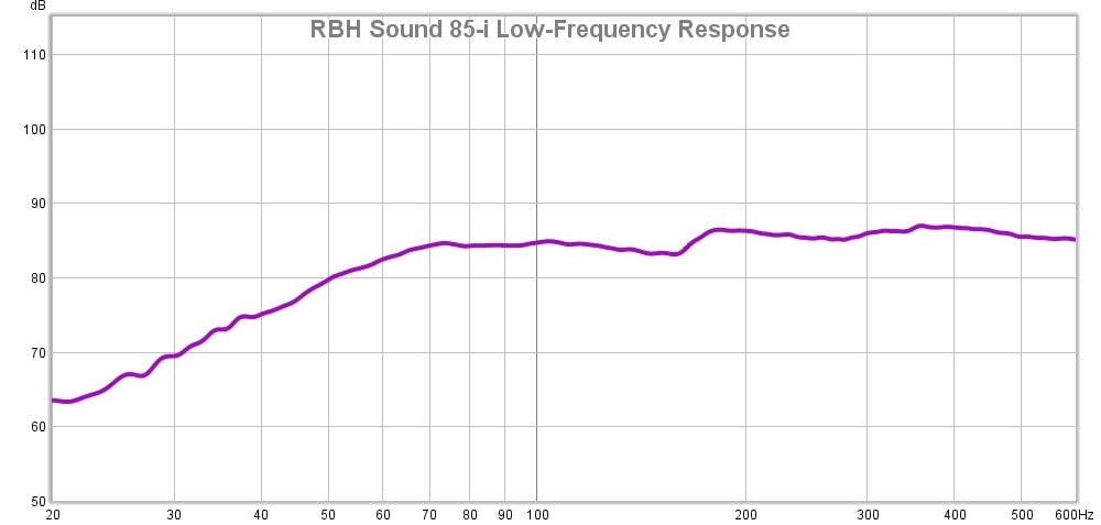

The above graphs show the 85-i speaker’s low-frequency responses that I captured using groundplane measurements (where the speaker and microphone are on the ground in a wide-open area). The low-pass filter point on the bass driver made it difficult to get a fair representation of the low-frequency behavior of this speaker, and it is possible that the port-produced output is a bit under-represented here. In my listening room, I had a good bass response down to a bit below 30Hz, so while I think that the port response is a bit damped relative to the bass driver, it probably isn’t quite as damped as what is being shown here. My room doesn’t get a whole lot of gain either, so I think anyone in a small to medium sized room will have even stronger bass below 30Hz. Something to note here is that there is a slight ridge that develops just under 200Hz, and this comes from how the midrange blends with the bass driver. With such a far distance separating the two and such a low crossover frequency between them, it would be hard to get a ruler flat low-frequency response, but that’s okay since any normal room acoustics will royally disfigure the response. The room dominates the response at such low frequencies, and your acoustic situation will be what is heard far more than the native response of the speaker.

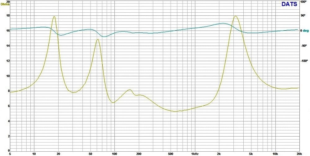

The above graph shows the electrical behavior of the 85-i speaker. This is a very benign load and will be friendly to any amplifier that it is hooked up to, even very inexpensive ones. RBH specifies this to be ‘6 ohm nominal,’ and that is correct, but I think many other manufacturers would more liberally specify the same impedance response as 8 ohms. The minima occurs at around 600Hz and bottoms out at just over 5 ohms, but it happens at a very shallow angle of phase. This is one of the easier electrical loads I have seen, and few amps in the world would have any problems driving this speaker. One other item of interest to note here is the dip in the low-frequency saddle which gives an indication of the port tuning frequency, and it happens at 30Hz, so even though these speakers aren’t large as towers go, they are still rather deep digging in bass.
I measured sensitivity to be 85dB at 1 meter for 2.83v which is a bit below RBH’s own spec of 87dB, although RBH does not specify the context of its sensitivity spec. The 85-i is not an especially efficient tower speaker and has about the same sensitivity as one would normally find in a bookshelf speaker. Two design aspects that bring its sensitivity down are its size and its low-frequency tuning. It’s trying to wring deep bass out of a modestly-sized enclosure, and efficiency must be sacrificed for that to happen. Nonetheless, it isn’t badly inefficient, and normal AVRs will have enough power to drive the 85-i speakers to pretty loud levels. However, people with 15-watt chip amps or 5-watt tube amps should not expect monster SPLs out of them.

RBH Sound’s 85-i is not perfect, but its only significant weakness is not severe
and can easily be corrected for by simply placement angling. Its treble is a
bit hot when the speaker is facing the listener directly, but if angled to face
forward in parallel, it has a very neutral and balanced sound. Those listeners
who prefer their sound to be a bit more forward and crisper can toe-in the
speaker at various angles until they get the sound they want, but personally I
prefer a more laid back sound than an aggressive one. So, in a sense, you can
EQ this speaker by just adjusting the angle of its position. This is a flaw in the sense that the tonality is not consistent across
the width of the speaker's dispersion. However, I don't consider it a major
issue, as users can still achieve the desired sound by experimenting with
toe-in angles.
