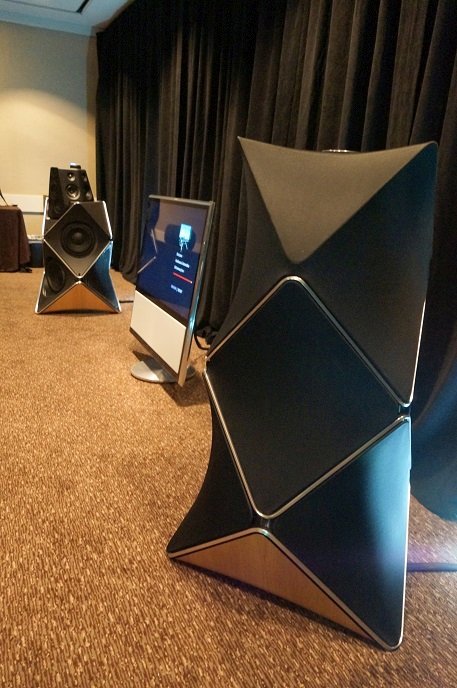

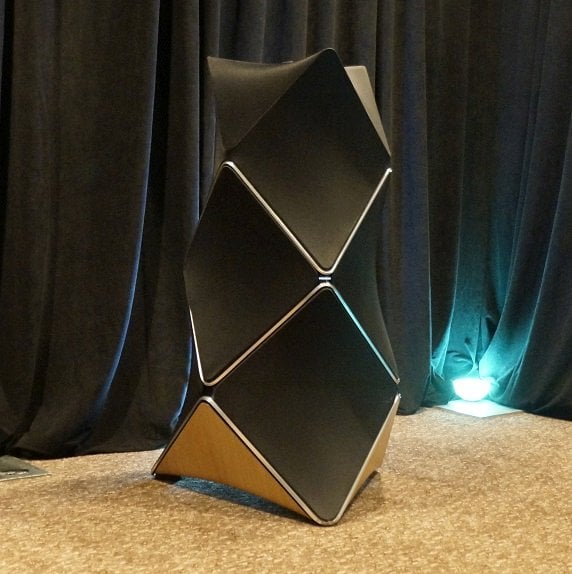

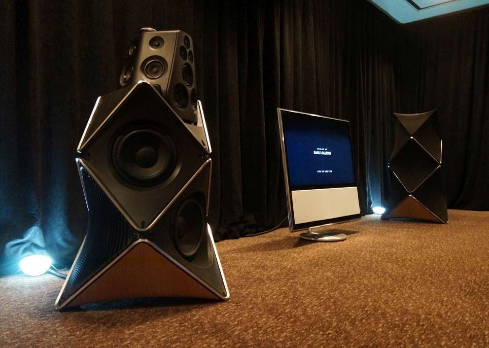

Bang and Olufsen Beolab
90
MSRP: $84,990 / pair
The Bang and
Olufsen Beolab 90 packs more technology in its 300 lb aluminum block cabinet
than you can shake a s
tick at. It has 18 drivers (seven 1” tweeters, seven 3”
midranges, three 10” bass drivers, and a 12” bass driver), and each driver has
their own amplifier and DAC. In total, the Beolab 90 has an immense 8,200 watts of
amplification for each speaker. The drivers wrap all around the cabinet, but
the speaker is configurable so you can determine the directivity of the
sound projection. Directivity can even be controlled by a smartphone app, which also has its
own room correction equalization program, likely needed since ordinary room
correction routines would not optimally handle a strange beast such as the
Beolab 90. In room, the Beolab sounded superb and had dynamic range to spare,
and the B&O reps made sure you knew it. The Beolab 90 hit hard yet sounded
clean. With grille on, it looks like a modern art sculpture, but with grille
off, it looks like something that would be giving Dr. Who trouble. I wouldn’t
mind owning a pair of these!

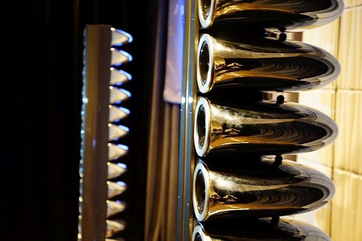

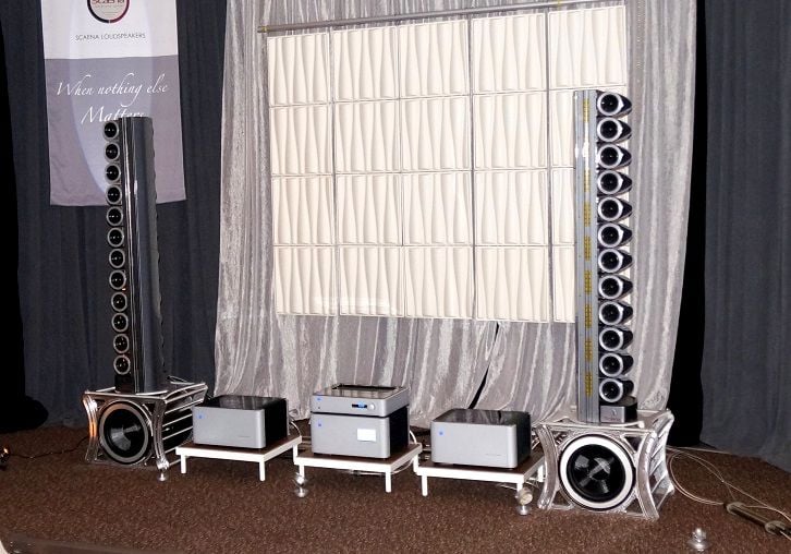

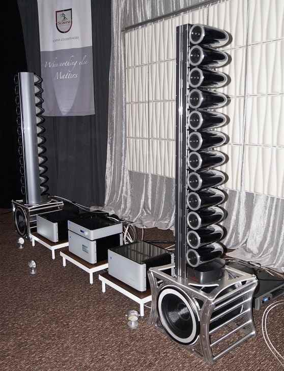

Scaena Soho
Loudspeakers MSRP: $56,000 / pair
Scaena
brought a new line array this year to AXPONA dubbed the Soho. The Soho uses twelve midrange
drivers, each in their ow
n enclosure, nine ribbon tweeters, and one 12”
subwoofer for each speaker. Each midrange enclosure is designed to minimize
backwave acoustic radiation from interfering with the cone, and each midrange
enclosure is separated from each other with elastomer compound balls so their
individual vibrations do not transmit to other enclosures. By having such small
enclosures, baffle diffraction problems are reduced, and the speaker as a whole
is claimed to have very wide and even dispersion. One interesting fact about
line arrays such as the Soho is that the reduction in loudness as a function of
distance is halved in comparison to point-source designs; in other words, if
you double your distance from a line-array, the SPL drop-off is only half of
that of a typical loudspeaker. That, plus the multiplicity of drivers, give the
Scaena speakers a tremendous amount of dynamic range. The sound in the Scaena
room was superb. The reps were playing some female vocal backed with an
acoustic guitar, and the sound was rich, clear, and vivid.

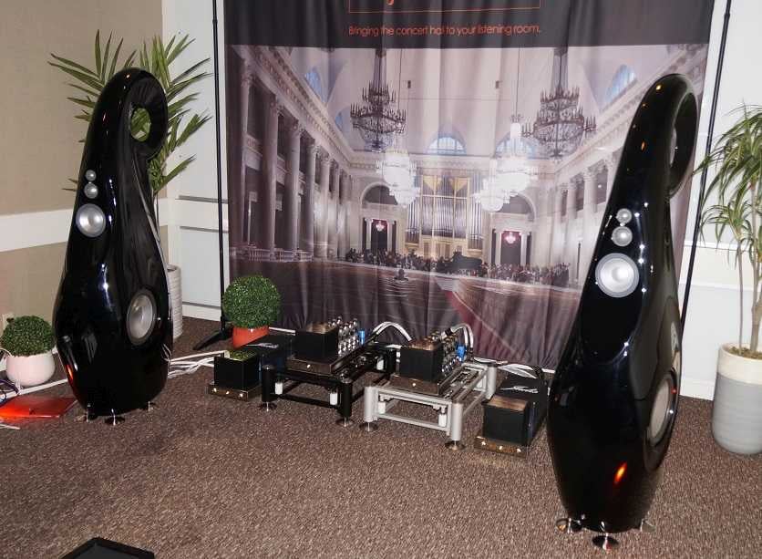

Vivid Giya G1 Series II
MSRP:
$68,000 / pair
The Vivid
Giya G1 Series II looks more like a musical instrument rather than a music
playback system, or in its blac
k color, almost like a treble clef symbol in musical
notation. Though it may look strange, it sounded very good. In my time in the
Vivid room, something operatic was playing, and the Giya G1 Series II speakers
sounded surprisingly nice. I suppose I was expecting it to sound as strange as it
looked, but I found the opposite to be true. The odd appearance isn’t just for
show. There is function behind that form. The loopy structure at the top of the
Giya is there to dampen backwave acoustic radiation that is generated by the rear
side of the cones of the bass drivers. The looped top portion is a tapered tube
that funnels the backwave radiation through a narrowing tube that is loaded
with damping material. While this still excites cabinet resonances, they are
much easier to control than typical loudspeaker cabinet designs. In the lower
part of the cabinet the Giya has two 12” bass drivers which are mounted on opposite
sides of the cabinet and are also mechanically connected together. This way
they impart no rocking motion on the cabinet since the inertia of the moving
masses are cancelled out. These are just a couple of the innovations of the
Giya G1 Series II speakers, and you can learn more about them at the Vivid
website.

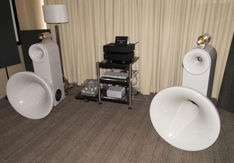

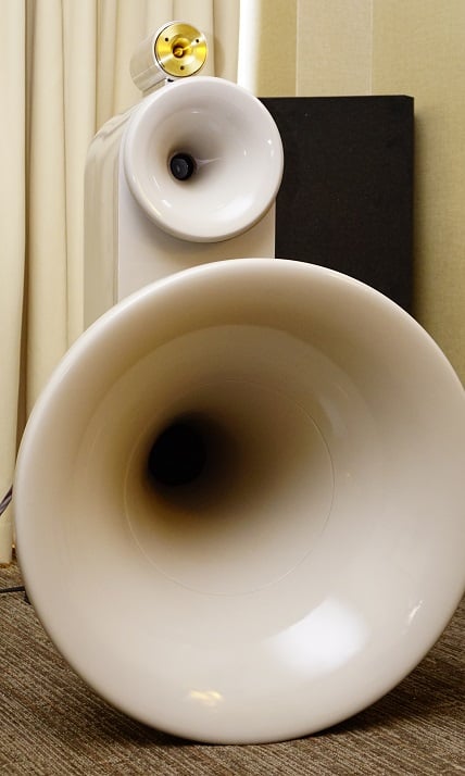

Sadurni Acoustics
Miracoli Product Page,
MSRP: $24,000 / pair

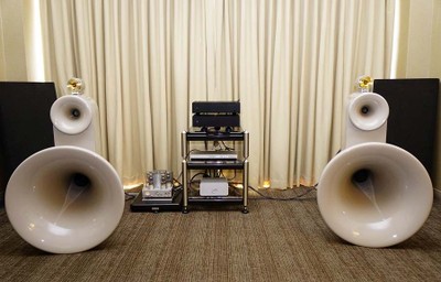

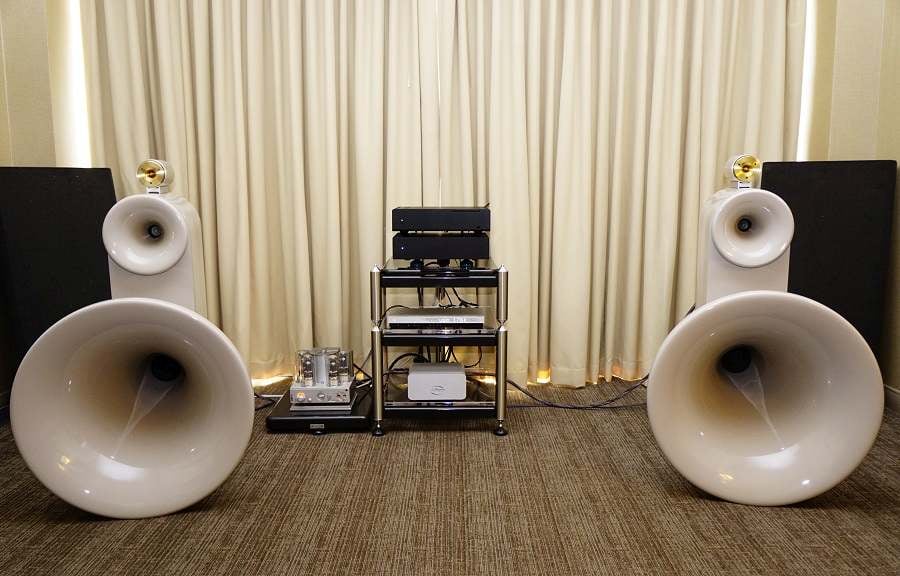

In
loudspeakers, there are horns and then there are horns. The Sadurni Acoustics M
iracoli speakers are certainly a
member of the later group. They may not be the first image that comes to mind
when the phrase “home audio loudspeakers” is spoken, but they do have an
unconventional beauty about them. They're a four-way speaker, and what may be
surprising to those uninitiated with loudspeaker horns is that lower, large 3’
diameter horn is only for upper-bass output and does not play back deep bass.
On the lower part of the main cabinet there are two 8” servo-controlled
subwoofer drivers (courtesy of Rythmik Audio) in a dual opposed configuration
that take bass below 100 Hz. The 3’ diameter upper bass horn is loading a
specially made 8” woofer using a compression chamber and a 4” throat. The horn
above that one loads a midrange driver that Sadurni claims to have one of the
strongest magnetic flux densities in the industry. The tweeter at the top is a
Fostex super-tweeter using a magnesium diaphragm. The speaker is rated at 110
dB sensitive, which may well make it one of the most sensitive home audio
speakers available. Even a single watt amplifier can give these speakers an
incredible amount of headroom. In my time in the Sadurni room, instead of
listening to the usual demo material, we decided on some Fatboy Slim. It may
not be the best content to exhibit the finer qualities of a loudspeaker, but on
the Miracolis, it was still a lot of fun.

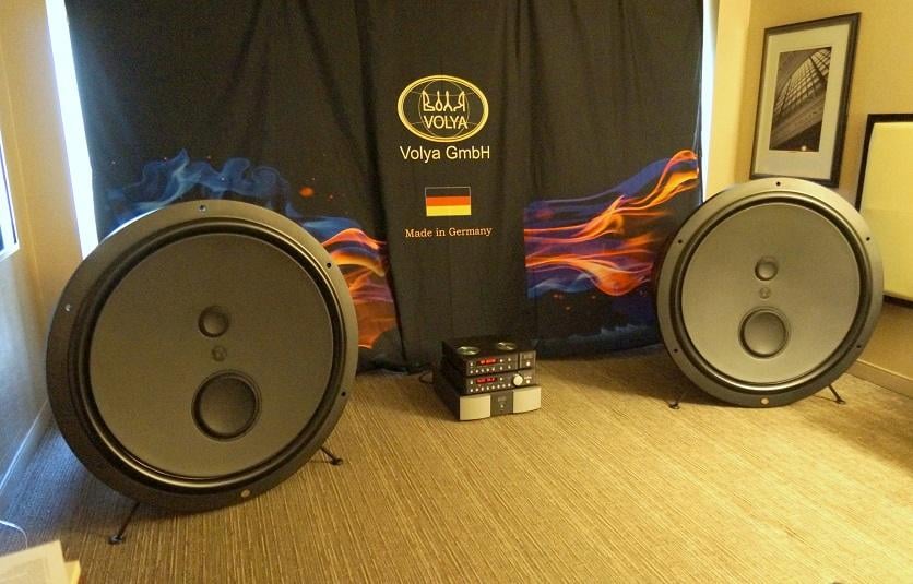

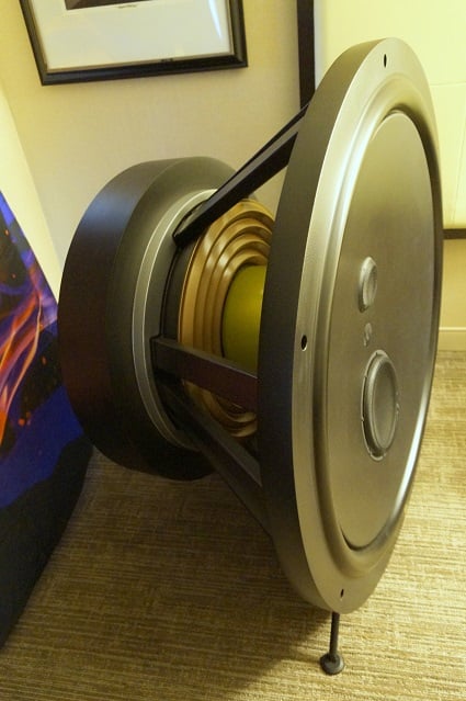

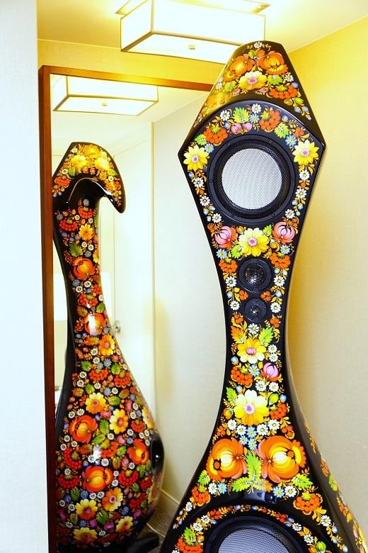

Volya Audio No Limits
Product Page, MSRP:
$33,000 / pair (est.)

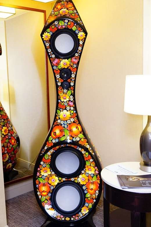

One of the
more eccentric speakers at
AXPONA was the Volya Audio No Limits set. The No
limits speakers are shaped like enormous loudspeaker drivers. They are a 3-way
speaker using an 11” bass driver, a 5” midrange, and a 1” tweeter. All the drivers
are ceramic and made by Accuton. I tried to ask the Volya representative about
pricing, but it was too loud in the Volya room to understand his answer since
one of the guests asked them to crank some heavy metal which they
enthusiastically obliged. Digging around the internet brings up a €30,000 price, equal to about US
$33,000/pair. These speakers do more than just play heavy-metal; they are literally
made from heavy metal and weigh nearly 420 lbs each.

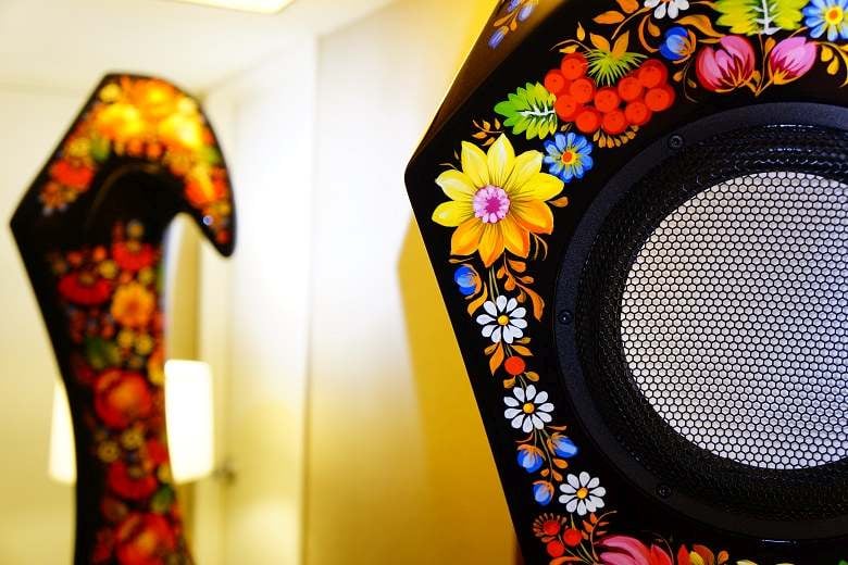

Also in the Volya room was an individual Bouquet speaker on passive display which brought together audio equipment and visual art in a more feminine manner. The Bouquets are individually hand-painted by a Ukrainian folk artist in a style known as Petrikovsky painting. Painting the Bouquets is done very carefully, and, because if this, each pair takes from four to six months to complete. Why choose between having speakers in a room or a painting when you can have both? The design on the Bouquets were lovely and intricately detailed.

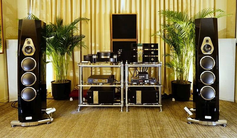

Tidal Akira Product Page, MSRP: $219,000
/ pair
If there is an equivalent brand to Rolls-Royce in
audio, it most certainly is Tidal. Tidal manufactures some of the most
luxurious audio devices ever conceive
d, and few manufacturers can match them
for opulence. The Akira loudspeakers certainly carry on in this tradition. They
are filled to the brim with high-value materials. For example, did you think
the diamond tweeters in the B&W 800 speakers were decadent? Well, you might
want to sit down for this, because the Akiras have a 5” diamond midrange driver,
and not diamond coated either; the cone is made of 13 carat diamond through and through. The
binding posts are made of silver, as are many of the electrical components of
the crossover such as the capacitors, resistors, and inductors. The cabinet is
made from a proprietary material that Tidal calls Tiralit, which Tidal claims
has the rigidity of hard materials like metal but with the resonance absorbing
behavior of soft materials like wood. Probably the only way that the Akiras
could be more lavish is if the cabinets were made from solid gold (but perhaps
we shouldn’t be giving Tidal any unwholesome ideas). The sound that I
heard while I was in the Tidal room was quite good; a blues recording was
playing and the imaging and detail was crisp and well-defined. I definitely
wouldn’t mind having a pair of Akiras in my listening room, over-the-top luxury
construction notwithstanding.

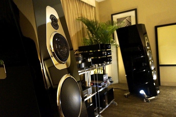

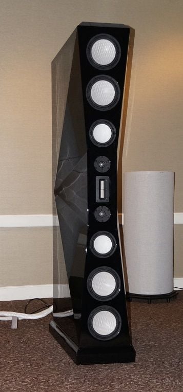

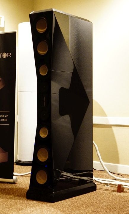

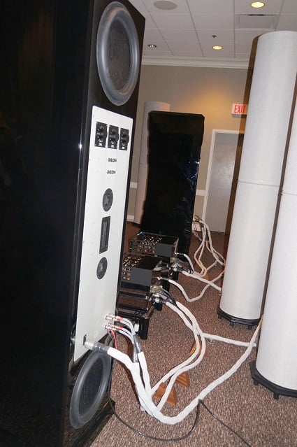

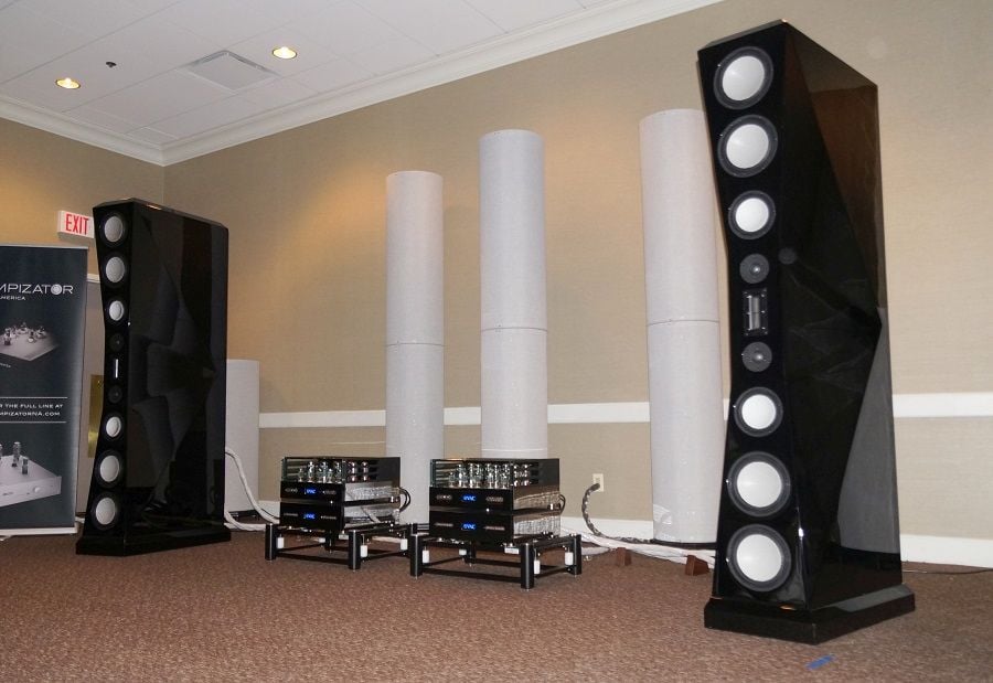

Von Schweikert Ultra 11 Product Page,
MSRP: $295,000 / pair
The Von Schweikert Ultra 11 speakers had to be the
most discussed speaker at AXPONA this year. Every ye
ar there is always one
manufacturer who brings their totally over-the-top, excessive flagship speaker,
and for 2017 Von Schweikert decided to be that exhibitor. This nearly $300k
speaker set was quite intimidating and resembled a gloss black monolith from
2001: A Space Odyssey when viewed from a side profile. They did sound very good
and had headroom to spare. If Tidal are the Roll-Royce of speakers, these
things would be something like the Bugatti Veyron. They are very powerful, with
an array of drivers nearly adequate to fill a small concert venue. From the
middle going outward of this ‘expanded MTM’ design we have a 5” aluminum ribbon
super tweeter, two beryllium dome tweeters, two 7” ceramic midranges, and four
9” midbass drivers. On the back side, there are two 15” subwoofers (looks like
they used Dayton Ultimax drivers), another 5” ribbon super tweeter, and two
more dome tweeters aided with wave-guides. Each 15” subwoofer driver is given
its own 1,000 amplifier. There are all kinds of different ways to adjust the
sound of the Ultra 11s and obviously they are intended for larger rooms. The
Ultra 11s sounded terrific, but there is something vaguely sinister about their
appearance, as though they could be the subject of a Stephen King story, but
perhaps that is simply my overactive imagination at work... I hope.
