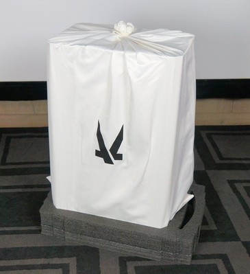

1723 packing   1723 bagged
Packing was good for the 1723 Monitors, but it needs to be since they all ship by parcel post from their warehouse in the Netherlands. They were packed in a sturdy cardboard box with edge protectors all around. They were sandwiched between two polyethylene pieces with another piece protecting the middle - a good idea for the shape of this speaker. Inside, the speaker was covered in a drawstring rayon sack to protect it against scuffing and moisture, a very elegant touch! Furthermore, they come shipped with cotton gloves to handle the speaker without leaving fingerprints on the finish. That is certainly going the extra mile and shows pride in their product.

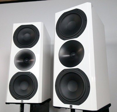

1723 pair grille  1723 pair2
Once uncovered, the 1723 Monitor is quite an attractive speaker of its type, that being a large stand-mount speaker. It had an unexpectedly fine gloss white finish over a front baffle with beveled edges and some sleek-looking drivers. The bass drivers had a clean, satiny luster, and the tweeter had a similarly silky sheen mounted in a brushed aluminum waveguide. There are included grilles that use magnetic adhesion, so there are no grille guides on the front baffle, which preserves a very clean look. The grilles have a light rounded shape so they look a bit nicer than just black fabric hung over a frame, although I think the speaker looks nicer without the grille. The rear-mounted binding post plate also had a brushed black aluminum finish with rhodium-plated binding posts and jumpers. Overall, it’s big but very classy-looking. The 1723 Monitor also comes in a matte white, matte black, and a gloss black finish. Not having seen the other finishes in person, I have to think that the gloss white would look the nicest, but given the stylistic sensibilities seen here, I am sure they all look very nice.

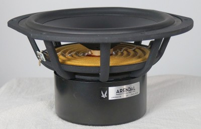

 1723 woofer   1723 bass driver4
The two 8” woofers of the 1723 Monitors use long pulp fiber cones with an inverted dustcap and an nitrile-butyl rubber surround. Removing the driver from the cabinet, it looks to have a 1” diameter voice coil, a shielded motor, and venting done under the spider. Shielding can keep more of the magnetic flux within the motor assembly, but it isn’t seen much anymore since it was mostly used to prevent stray magnetic fields from interfering with the picture of CRT screens. The motor is hidden behind the shielding, but the driver is fairly heavy and solid, so I would guess it has a pretty hefty magnet. Arendal’s literature states that it uses an aluminum shorting ring, suspension optimized by FEA analysis, and copper-clad aluminum wiring for the voice coil. It looks like a capable driver, and two 8” cones have nearly the same surface area as a 12” cone, so the bass system of the 1723 Monitors should have a pretty serious dynamic range.

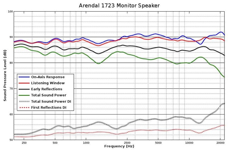

The Arendal 1723 Monitors were measured in free-air at a height of 7.5 feet at a 2-meter distance from the microphone, and the measurements were gated at a 10-millisecond delay. In this time window, some resolution is lost below 250 Hz and accuracy is completely lost below 110 Hz. Measurements have been smoothed at a 1/12 octave resolution.
1723 spin-o-rama
The above graph shows the direct-axis frequency response and other curves that describe the speakers’ amplitude response in a number of ways. For more information about the meaning of these curves, please refer to our article Understanding Loudspeaker Measurements Part 1. While this measured response isn’t quite as perfect as what is shown on Arendal’s product page, it still is quite good nonetheless. The on-axis response exhibits a slight treble elevation from 2.5kHz to 10kHz, and this might make the speaker sound a bit bright if listened to at a dead-ahead angle. We can see from the ‘listening window’ curve, which is a much more important curve in determining the character of the speaker’s sound, that slight treble brightness does get ameliorated not far from the on-axis angle, so, on the whole, I wouldn’t expect this speaker to be bright. Indeed, that wasn’t my experience in listening to the 1723 Monitors, but I didn’t listen to them right on-axis. Another feature of this graph that we can see is a small crossover dip at 1.5kHz which might add a slight recess to some sound in that region, but it won’t have a dramatic effect on the sound relative to a speaker with a flat response there. The ‘early reflections’ curve is very nicely flat, which means that much of the off-axis sound should have a very neutral character overall as well as the resultant acoustic reflections. Abetting that flat ‘early reflections’ curve is a very smooth early reflections directivity index, and that indicates that the 1723 Monitors have very good directivity control and would be very predictably equalized for those who want to change the tonal balance of the sound.

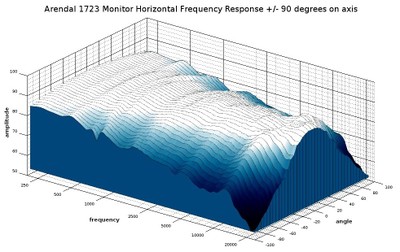

1723 waterfall response 3D
 1723 waterfall response 2D

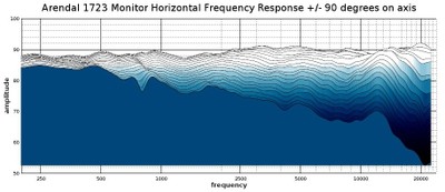

The above graphs depict the 1723 Monitor’s lateral responses out to 90 degrees in five-degree increments. More information about how to interpret these graphs can be read in this article: Understanding Loudspeaker Review Measurements Part II. In these graphs, we get a better look at what exactly is occurring at off-axis angles. Here we see the 1723 Monitor’s superbly controlled directivity. The waveguide is really putting in work in maintaining a consistent dispersion out past 10kHz. There is an off-axis bump past 10kHz, but that isn’t likely to be a significantly audible artifact except perhaps for an elevated ambient sensation for those whose hearing still senses that frequency range. If we look closely, we can see the elevated on-axis treble settle down fairly quickly as we move off-axis. The small crossover dip stays pretty steady across all angles, which isn’t quite like some speakers where the crossover dip can get worse at further off-axis angles.

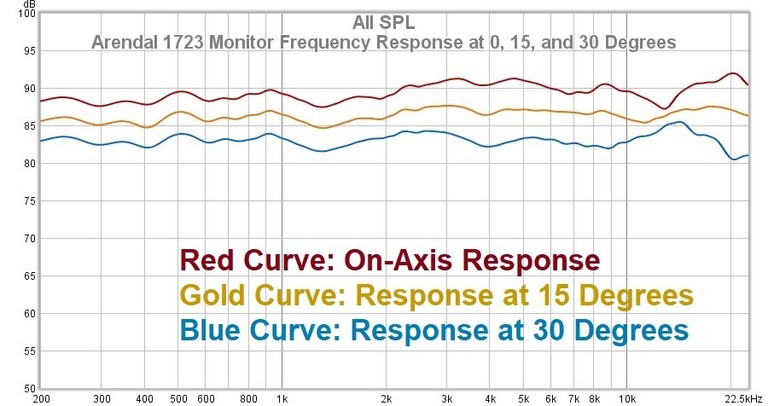

1723 responses at 0 15 30
Expanding the view from the previous graph, the above graph takes a close look at the on-axis response and compares it to the 15 and 30-degree angle responses. The on-axis angle has a slightly elevated treble response, while the 15-degree angle is very nicely flat, and the 30-degree angle is very slightly recessed in the treble region. The angle at which you hear the direct sound from the speaker will play a major role in the overall tonality that you experience, and with the 1723 Monitors, you can adjust their tonality simply by angling the speaker for a different direct response. While this is true of most speakers, the directivity of the 1723 Monitors enables the user to temper the response using angle positioning with a better degree of control since the changes only affect the tweeter’s range, but it does so smoothly throughout the tweeter’s frequency band. So the toe-in angle acts like a tone control on the tweeter. If you want a brighter, more forward sound, aim the speaker directly at the listening position. If you want a neutral, more balanced sound, give the speakers a 15-degree angle aim at the listening position. If you want a warmer and more mellow sound, use a 30-degree or greater aim at the listening position. The magnificently flat response at 15-degrees also makes these a superb candidate for the above-mentioned time-intensity trading positioning on account of their controlled directivity.

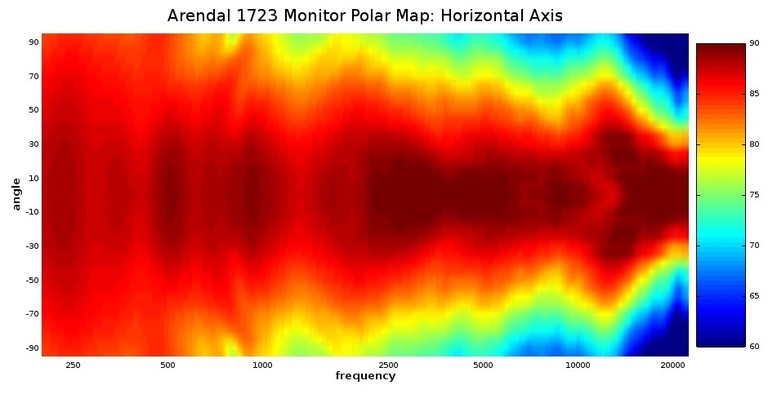

1723 horizontal polar map
The above polar map graphs show the same information that the preceding graphs do but depict it in a way that can offer new insight regarding these speakers’ behavior. Instead of using individual raised lines to illustrate amplitude, these polar maps use color to portray amplitude and this allows the use of a purely angle/frequency axis perspective. The advantage of these graphs is they can let us see broader trends of the speaker’s behavior more easily. For more information about the meaning of these graphs, we again refer the reader to Understanding Loudspeaker Review Measurements Part II.
From the polar map of the 1723 Monitors, we again see some very nice directivity control. Output rapidly falls off outside of a 50-degree angle, but it is fairly uniform up to then. One significant feature is the dark red center blotch which indicates a steady output range of nearly 90dB; it holds a relatively stable pattern within a 30-degree angle meaning that this speaker will have the most consistent sound within that angle. Outside of 30-degrees, it is OK until 50-degrees, but I think few listeners will be seated that far off-axis.

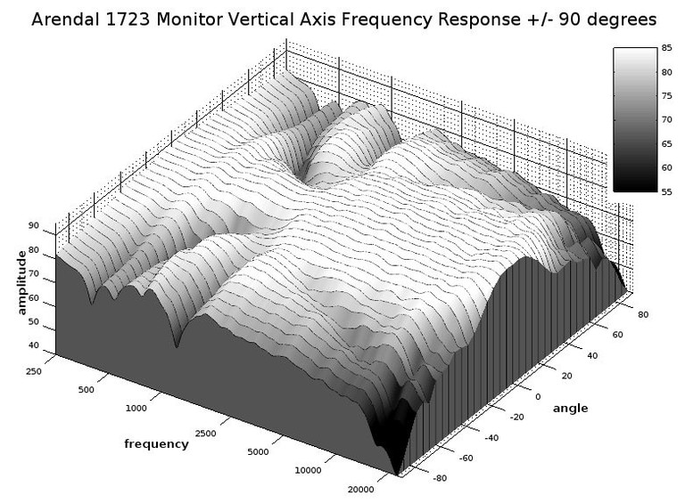

1723 vertical waterfall response
The above graph shows the 1723 Monitor’s response behavior along its vertical axis where zero degrees is directly in front of the tweeter, negative degree values are below the tweeter, and positive degree values are above the tweeter. It should be said here that the vertical response isn’t nearly as critical as the horizontal response, so an imperfect vertical dispersion is much less of a problem. The vertical dispersion is good and is pretty much what I would expect to see from an MTM design such as this. Off-axis cancellation starts taking a bite out of the bass driver’s frequency band, and lobing patterns develop from the woofers fighting each other as their respective distance from the microphone becomes unequal. One unusual and counter-intuitive aspect of the vertical axis is that the tweeter’s dispersion widens as frequencies increase. Normally the opposite occurs, although many waveguides can sustain a wider dispersion out to higher frequencies. However, I don’t recall seeing this before. It is an interesting feature but a largely academic one, since such high frequencies do not reflect as easily as midrange frequencies, and therefore the audible consequence is likely nill. The overall lesson of this graph is that it’s best to be listening to these speakers within a 15-degree vertical angle of the tweeter, but that is almost certainly how these speakers will be set up anyway.

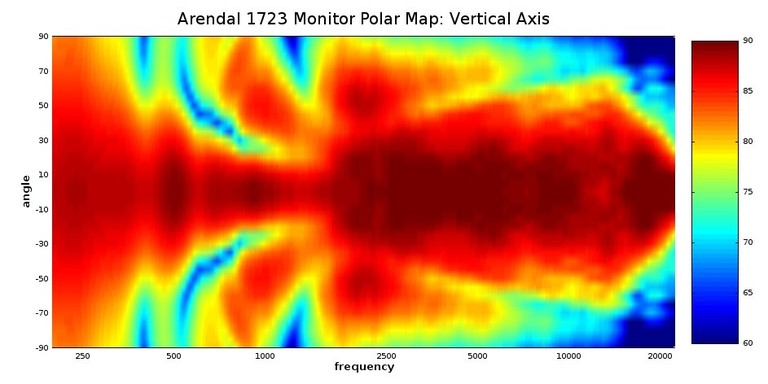

1723 vertical polar map
The above graph shows the vertical response pattern of the 1723 Monitor in a polar map. I don’t normally include this graph in reviews, but since the 1723 Monitor will have identical performance on a vertical plane to the 1723 Center in a horizontal plane, I thought it would be good to include it to illustrate the performance of the 1723 Center’s horizontal dispersion pattern. The MTM design of the 1723 Monitor/Center makes a lobing pattern along the axis of the woofers inevitable at off-axis angles. As discussed above, the woofer cancellation starts to take a toll on the response up to the 1.5kHz crossover point at about a 20-degree angle. So if the user is going to have a 1723 Center speaker, they should be seated within 20 degrees on either side of the on-axis angle for a full sound. (Audioholics has discussed the matter of MTM center speaker designs at length in these articles: Vertical vs Horizontal Center Speaker Designs, Vertical vs Horizontal Center Speaker Designs - An Alternate Perspective, and Center Channel Speaker Design Additional Considerations).

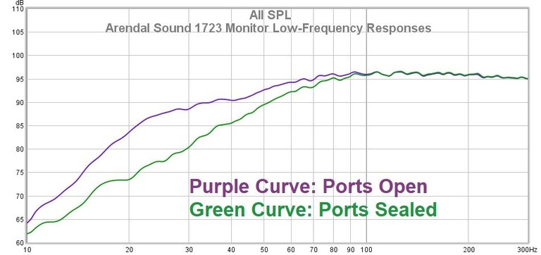

1723 Low Frequency Responses
The above graphs show the 1723 Monitor’s low-frequency responses that I captured using groundplane measurements (where the speaker and microphone are on the ground in a wide-open area). The 1723 Monitors come with port plugs so the user can configure the speaker for a sealed response. The ported low-frequency response of the 1723 Monitors is very good and flat down to 60Hz. The response does taper off a bit down to port tuning which looks to occur just above 30Hz. Room gain will shore up the deep bass, so, in any normal-sized room, users will get a significant boost in bass. On the whole, the ported response is very deep for a stand-mount speaker. We normally see this kind of extension in tower speakers. One thing to note is that we seem to get a deeper extension than the graph shown on Arendal’s product page for the 1723 Monitor. Port output seems to be pulled down about 10Hz deeper in my measurements compared to what Arendal shows. Low-frequency responses can vary quite a bit per measurement technique, so this discrepancy wouldn’t be surprising on its own. However, when we see what the electrical performance is like below, we see that this difference is more than just an acoustic anomaly of the measurement technique.
The sealed response is fairly textbook below 80Hz, and that is exactly the kind of slope recommended by THX. Of course, users do give up headroom by sealing the ports, but it does make it easier to blend the speakers in with the subs, especially if it needs to be done manually. In most circumstances, however, I would recommend these speakers be operated with ports open.
