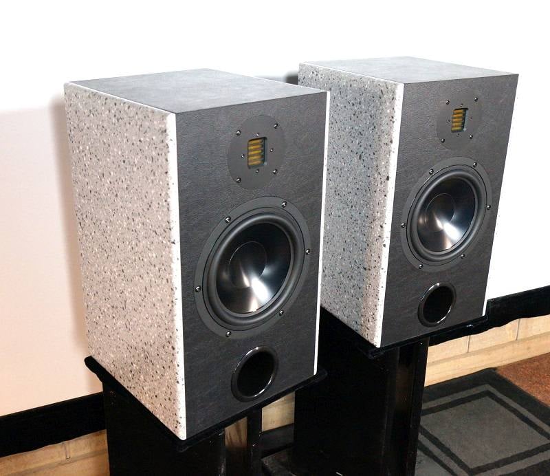

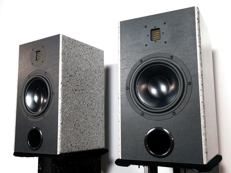

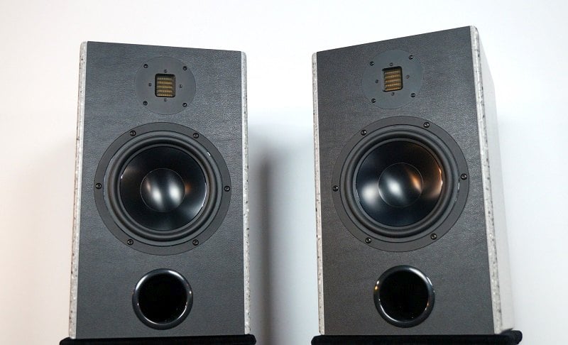

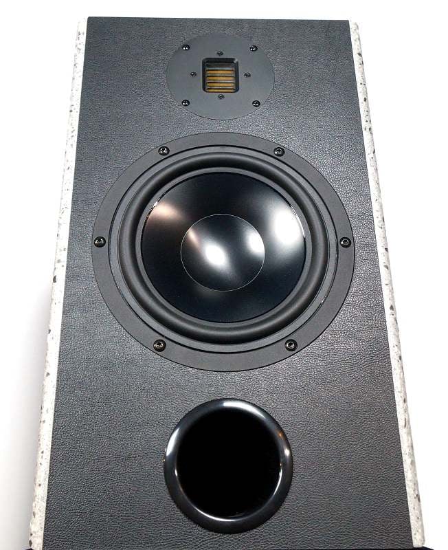

Packing and Appearance

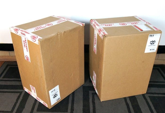

The PM-8s arrived well packed, but they had better be, given the
weight and their cost of $2,000 each. These are very heavy for studio monitors,
weighing twice as much as most of the monitors I have dealt with to date. They
came double boxed with thick polyethylene blocks sandwiching the speakers along
with edge protectors to reinforce the box edges. Once out of the packing, they

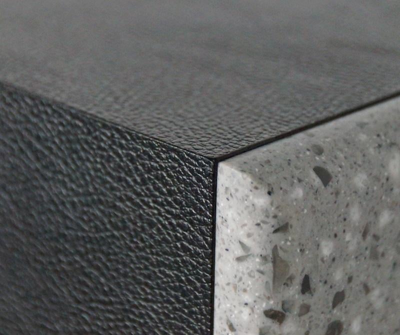

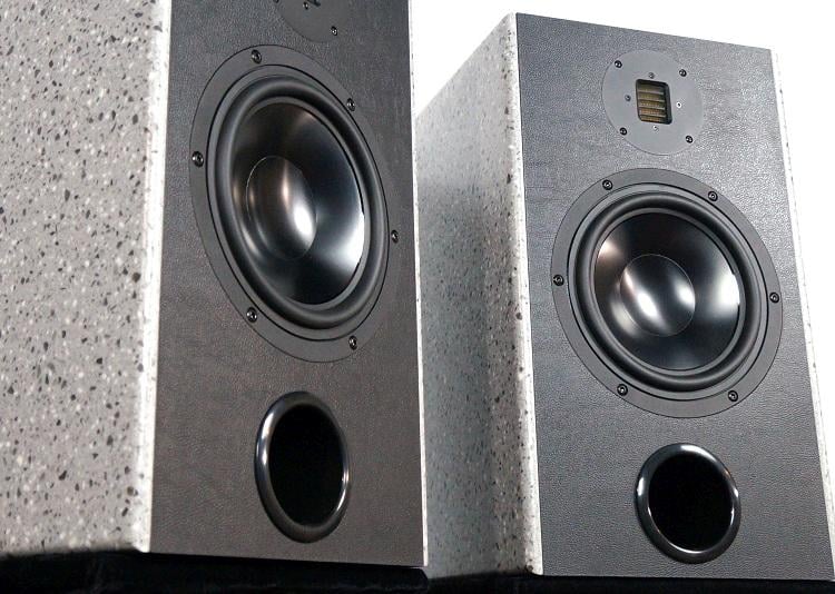

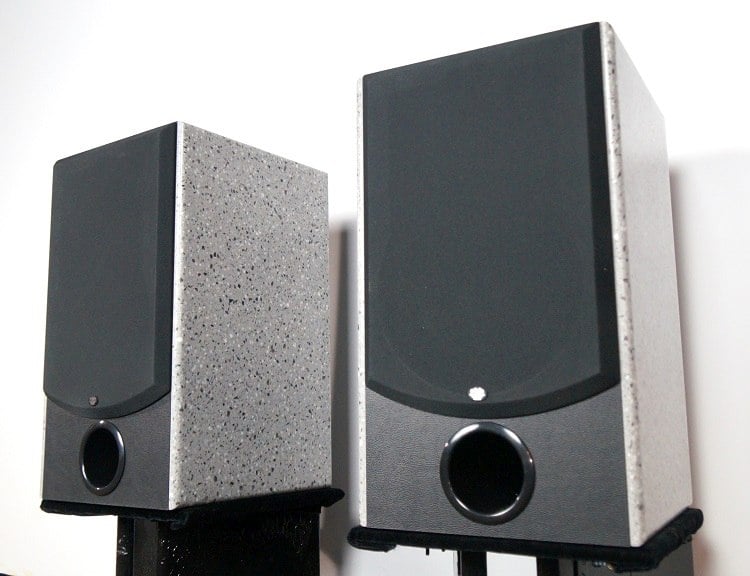

PM-8s are revealed in their full majestic glory. These are large studio
monitors, and, as if to emphasize their stately size, there are ½” slabs of
polished engineered stone attached to the side panels. That is an unusual
design decision by RBH Sound, to say the least. Most studio monitors don’t really
make too much of a concession to aesthetics, and they are a product more often
driven by function than form. Perhaps it is because RBH is a newcomer to the
studio monitor market that they thought a monitor should look so fancy. Or
perhaps they are trying to separate themselves from other manufacturers who
tend toward a utilitarian appearance in their monitors. To be fair, the PM-8s
do come in a version that does not have these engineered stone accent panels,
and that version carries a significant $400/ea or $800/pr savings. However, they have a lot
less visual charm, and, of course, the panels do have a functional purpose as
well, which we will discuss in the ‘Design Analysis’ section below.
Outside of the accent panels, the PM-8s are finished in a flexible laminate that almost resembles leather. It is more durable than conventional vinyl veneers, and you don’t have to worry about fingerprint smudges marring the finish. It looks nice and ‘leathery’ without being leather. The majority of the front baffle is occupied by a beefy 8” black aluminum cone with a 1.4” AMT tweeter hovering above it. The PM-8 can also be ordered with a silver metallic aluminum cone, but I think I like the look of the black cone just a tad more. There is a large port mounted on the lower end of the front baffle. One oddity about the PM-8s is that they are a studio monitor with a grille. Home audio speakers use grilles for aesthetic purposes (to hide the drivers) and for practical reasons (to protect the drivers), but studio gear isn’t normally very concerned about aesthetics and so very few monitors have grilles. Since they are workplace tools mostly just used around professionals, they aren’t as subject to physical abuse and so don’t really need grille protection. The grille itself is a formidable piece made with a ⅝” thick frame wrapped with a black, acoustically transparent fabric. It uses magnetic adhesion so there are no grille guides on the front baffle. Its inclusion among other design cues leads me to believe that RBH Sound expects the PM-8 to be used as a home audio speaker as well as a studio monitor. It looks higher-end than a studio monitor needs to, and I think that RBH wanted a speaker that will see use both in studios and in homes.

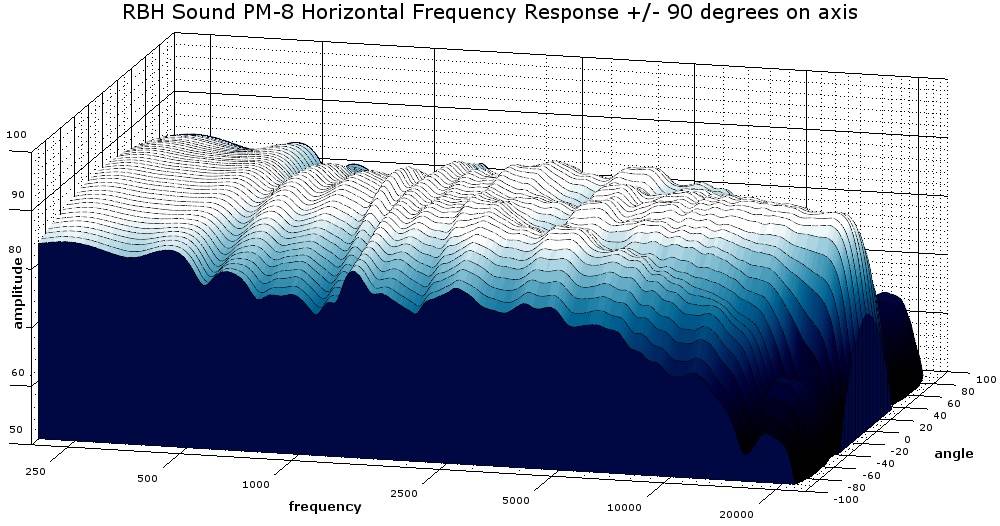

Design Analysis

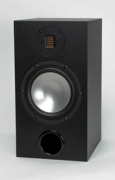

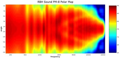

The PM-8 is a big monitor. RBH’s product page states it is
intended for either near-field and far-field use, so the large size is a
consequence of the wider dynamic range it must have in order to accommodate
far-field use. You can’t get serious bass extension as well as serious dynamic
range in bass from a small cabinet, as that is prohibited by physics. As for
near-field use, a requirement for that is the design can not have the drivers
separated too far apart because the further apart that the drivers are, the
greater the distance needed for their respective sound fields to integrate.
This is why we don’t recommend that most tower speakers be used at proximity
closer than two meters, especially a three-way tower. The center-to-center
spacing of the drivers on the PM-8 seems close enough that it could easily work
for near-field duty, so while the speaker may be somewhat large, the sound
should integrate at a close distance.

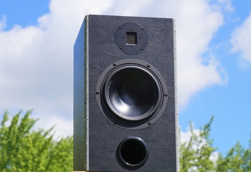

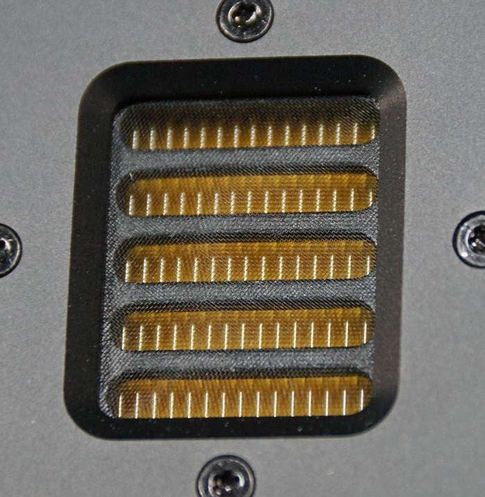

The PM-8 looks to be using some high-quality components.At the top, it uses a 1"x1.39" AMT that was the best performing AMT tweeter that RBH Sound could source. AMTs normally have a dynamic range advantage over dome tweeters, especially in higher frequencies, so even though the AMT in the PM-8 is not especially large, it should still be able to pack a punch even in non-near-field listening distances. AMT tweeters can vary in quality by quite a wide range, and we have seen very problematic AMTs in inexpensive speakers that would have been better off simply using domes, and we have seen very well-behaved AMTs, but usually in more expensive speakers. To date, some of the best we have seen were manufactured by Aurum Cantus (used in RBH Sound SVTR System), so that bodes well for the tweeter in the PM-8.
The woofer uses an 8” aluminum cone and is the same bass driver
seen in RBH’s flagship SVTR speakers. It has a sizable ½” surround and looks to
be very capable. Aluminum is a very good material for a woofer diaphragm on
account of its light weight combined with high stiffness. Its only drawback is
that the stiffness can make for some fierce breakup behavior in upper
frequencies if it is not low-passed sufficiently, but that is not at all a
problem for the PM-8 since it uses an active DSP crossover network. In fact,
the crossover uses a 48dB/octave slope, which would not at all be practical
with a passive design. That should be more than sufficient to keep the woofer
out of trouble. RBH also dopes the aluminum cone and uses a propriety butyl rubber surround to dampen cone resonances. The digital signal processing abilities of the amplifier gives
the speaker engineers far more freedom to control the performance of the
speaker than traditional passive methods.

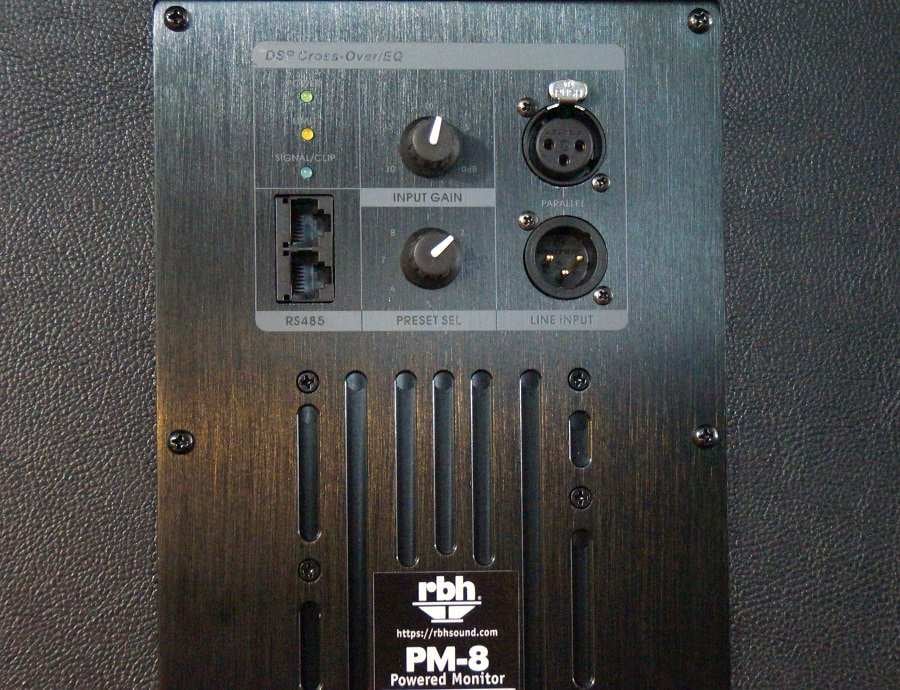

The PM-8 has built-in Class-D amplification with separate amplifiers for the tweeter and woofer. The tweeter is given 150 watts of power and the woofer is given 250 watts, for a total of 400 watts per speaker, with a 2,500Hz crossover frequency. That is a tremendous amount of power, especially when considering that in typical passive speakers, there is quite a bit of loss occurring in the crossover network. The Class-D topology grants further efficiency by converting a lot more electrical current into power for drivers compared to more common Class-AB amplifiers that lose substantially more electricity as heat.
Speaking of efficiency, what is majorly beneficial for the efficiency of the PM-8 is the sheer size of it. Smaller loudspeakers can produce bass, but the power demands for low-frequency reproduction skyrockets as the enclosure size shrinks. This is a speaker with a large enclosure and a tremendously powerful amp, so it almost maxes out what can be done to increase low-frequency dynamics. In order to get the most from the cabinet, the PM-8 uses a very large front-mounted port that has a 2 ¾” diameter with a 9 ¾” depth. That is the kind of port that wouldn’t be out of place in a subwoofer, and it should provide the PM-8s with prodigious low-frequency capability.
Regarding connectivity, the amp only has an XLR input, but RBH
provides RCA to XLR adapters so that those who only have consumer-grade
preamplification will not have to purchase additional components to get the
speakers working. Nonetheless, I would encourage buyers to get a pre-amp with
balanced XLR outputs to ensure the cleanest signal path. After all, if you are
buying $3,000+ monitors, it is worth spending a few hundred extra for a decent
preamp (I can highly recommend the MOTU M2 for an inexpensive but
high-performance pre-amp with balanced outputs). The PM-8 also has a balanced
output in case the user wants to daisy chain another device on the same signal
such as a subwoofer. RBH tells me that they hope to add an AES digital
connection in the near future.
The amp has only two controls: a gain knob and a preset selector knob. The preset selector knob has eight settings that optimize the PM-8 for near-field or far-field use, implements an 80Hz high-pass filter for use with a subwoofer, trims the tweeter output by 3dB, and also changes the low-frequency extension. There are also three LEDs: one that indicates power, one indicating when the limiter is engaged, and an input signal indicator.
The cabinet is a stout affair that uses ¾” thick MDF paneling with two window braces to reduce panel resonance. The optional engineered stone side panels would also be extremely effective at eliminating panel resonance, although it does so at a very hefty surcharge. The internal sidewalls are lined with polyurethane foam and much of the interior space is filled with polyfill type stuffing. Those measures should be very effective at damping inner pressure waves. This build quality is very solid, as one would expect of a speaker at this price point.

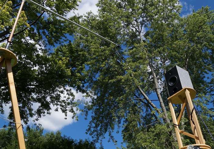

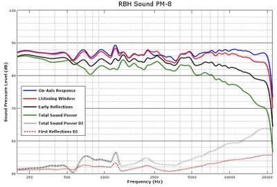

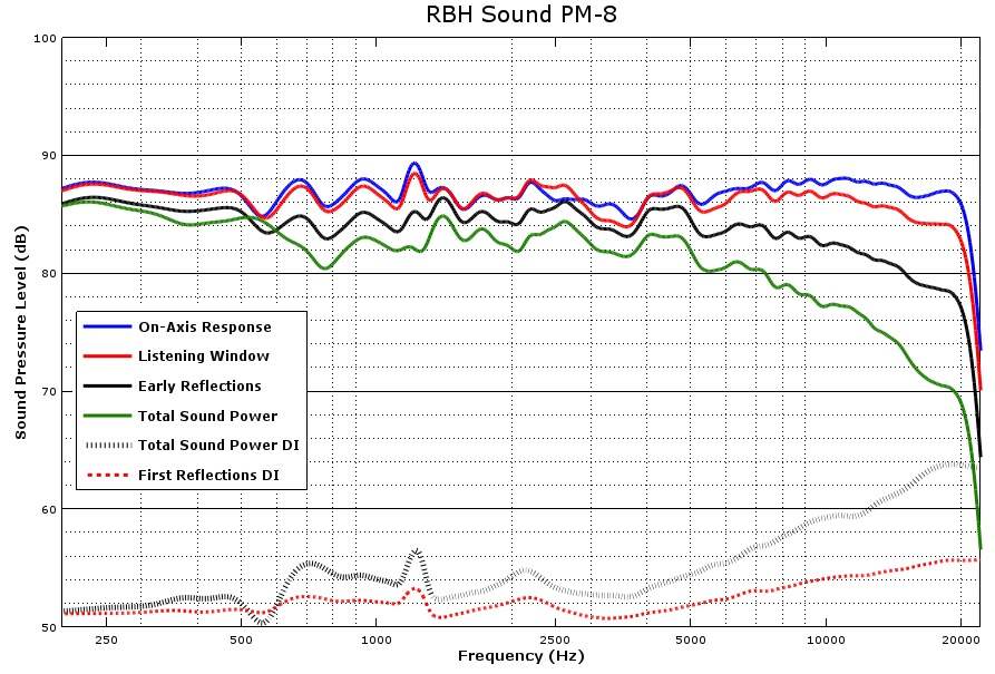

The RBH Sound PM-8 was measured in free-air at a height of 7.5 feet at a 1-meter distance from the microphone, and the measurements were gated at an 11-millisecond delay. In this time window, some resolution is lost below 250 Hz and accuracy is completely lost below 110 Hz. Measurements have been smoothed at a 1/12 octave resolution.
The above graph shows the direct-axis frequency response and other curves that describe the speaker’s amplitude response in a number of ways. For more information about the meaning of these curves, please refer to our article Understanding Loudspeaker Measurements Part 1. While there are some ripples throughout the midrange, the overall response of the PM-8 hews pretty closely to a central amplitude line, so this speaker has a good tonal balance much as I heard in my listening sessions. What the PM-8 doesn’t have is any broad peaks or dips that would color the sound. The narrow ripples are much less audible and don’t contribute much to the sound character. This kind of response is what one would hope for in a studio monitor. It will reproduce the source signal with little coloration added. We do see that the directivity is a bit imperfect, but it is not wildly imbalanced. For the most part, everything shows very good performance.

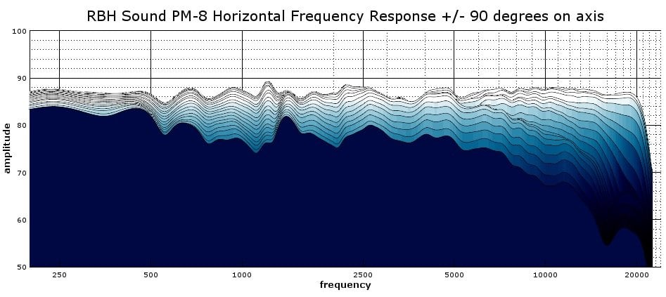

The above graphs depict the speaker’s lateral responses out to 90 degrees in five-degree increments. More information about how to interpret these graphs can be read in this article: Understanding Loudspeaker Review Measurements Part II. Here we get a better look at the slight directivity incongruities that caused some roughness in the directivity indexes in the lower midrange. The off-axis sags a bit after 50 degrees or so. However, keep in mind this is not some major flaw, and I only point it out for academic curiosity rather than a damning critique. It may well be audible if you were listening outside of a 50-degree angle, but realistically no one is going to listen at that angle. It is possible that it could have some discernible impact as an acoustic reflection versus a speaker with perfect directivity, but even then I doubt very much that the difference would be serious since this directivity flaw isn’t very severe. Something else that we do get a clearer view of is how much the tweeter beams at high frequencies. This is seen more with dome tweeters than AMT tweeters, but the PM-8 does squeeze the high treble at off-axis angles. It’s not a serious flaw either since most of the frequency range where the beaming becomes substantial is above 10 kHz. There isn’t a whole lot of content that high, and it isn’t a range that is meaningfully subject to acoustic reflections. If you want to be met with treble flat to 20kHz, you should be listening within a 20-degree angle of the on-axis response.

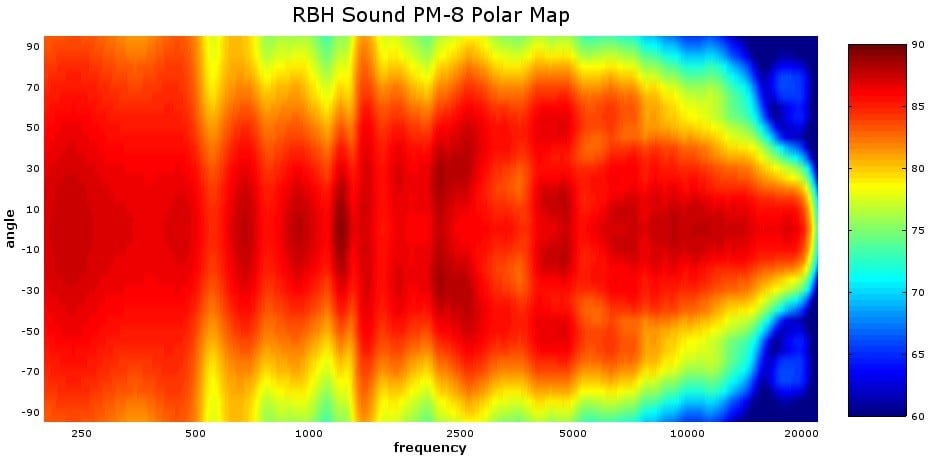

The above polar map graphs show the same information that the preceding graphs do but depict it in a way that can offer new insight regarding these speakers’ behavior. Instead of using individual raised lines to illustrate amplitude, these polar maps use color to portray amplitude, and this allows the use of a purely angle/frequency axis perspective. The advantage of these graphs is they can let us see broader trends of the speaker’s behavior more easily. For more information about the meaning of these graphs, we again refer the reader to Understanding Loudspeaker Review Measurements Part II.
From the above polar map, we can see that the PM-8’s dispersion pattern gets a bit ragged at off-axis frequencies but the bulk of the projected sound remains confined within certain angles. Much of the raggedness is higher-Q peaks and dips which aren’t all that audible, as was explained before. So, while the off-axis response doesn’t exhibit perfect uniformity, it isn’t likely to be seriously deleterious as acoustic reflections.

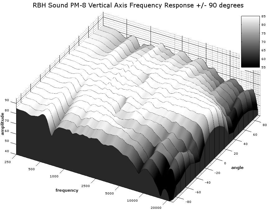

The above graph shows the PM-8’s response behavior along its vertical axis where zero degrees is directly in front of the tweeter, negative degree values are angles below the tweeter, and positive degree values are angles above the tweeter. There is a lot to like about this response. Typical speakers tend to have a large gap in the vertical off-axis response around the crossover frequency. This is because as the microphone moves off-axis, the difference in distance between the drivers becomes significant, and that distance difference causes phase cancellation within the range of shared frequencies which they reproduce. The shallower the slope of the crossover design, the larger the cancellation null that occurs in the vertical off-axis response. Sometimes these nulls begin to set in at just ten degrees above or below the on-axis angle. Because of these cancellation nulls, it is usually recommended to be listening to the speaker where the tweeter is level with the listener’s ear, where the drivers normally have equal distance from the listener.
As a consequence of their steep 48dB/octave crossover slopes, the PM-8s exhibit very little crossover cancellation. In fact, the vertical off-axis response is unusually good. These speakers may well be usable on their sides, in contrast with many other two-way speakers in this class. Many studio monitors use waveguides in an attempt to limit vertical dispersion based on the idea that acoustic reflections off of desktops or mixing consoles degrade the sound. Implicit in that idea is that the vertical dispersion patterns of most two-way designs are badly flawed. RBH Sound takes a different approach: they do not limit the vertical dispersion but rather ensure that it has good correlation to the on-axis response. In other words, there is no need to confine the vertical dispersion if the reflections that it produces are benign. Aside from the matter of reflections, PM-8 users benefit from this excellent vertical dispersion by being able to listen at lower or higher angles and still be met with a full sound as opposed to many other speakers of this type.

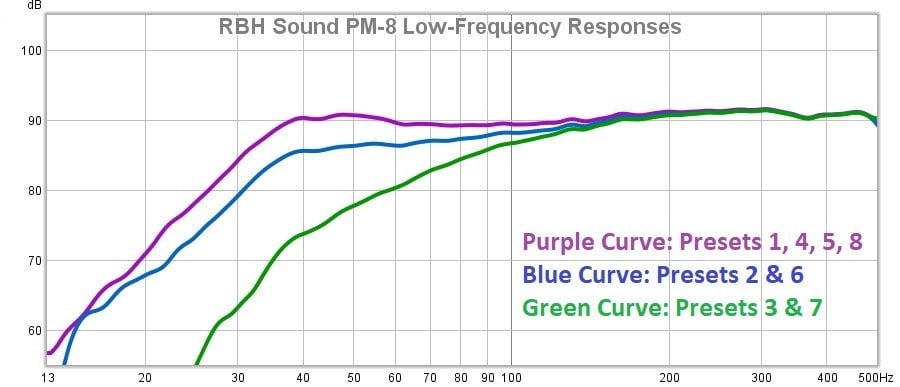

The above graphs show the PM-8’s low-frequency responses that I captured using groundplane measurements (where the speaker and microphone are on the ground in a wide-open area). This graph depicts the low-frequency responses of each of the presets that affect the low frequencies. The purple curve for presets 1, 4, 5, and 8 shape the response for situations where no boundary or room gain is expected (or also if the user just likes a lot of bass). The blue curve for presets 2 and 6 is the low-end response intended for situations where room gain will give an acoustic boost to low-frequency output, and that response attempts to compensate for the boost. The green curve is the response for presets 3 and 7, which set a high-pass filter for use with subwoofers. While room acoustics will invariably screw up the low-end response, the PM-8 puts out a nicely smooth or linear response for whatever preset it is used in.

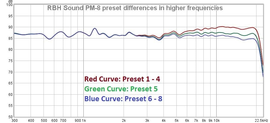

The above graph exhibits the changes that can be made to the PM-8’s treble response using the preset knob settings. The red curve represents presets 1 through 4 and is intended for further distance placements that can attenuate higher frequencies. The green curve represents preset 5, which is also intended for far-field placement but shelves the high frequencies by 3dB. The blue curve represents presets 6 through 8 and is the response intended for near-field placement. Preset 5 gives the most neutral anechoic response from these options, but those who are looking for a more detailed, forward sound might enjoy presets 1 through 4 more, and those looking for a slightly more relaxed sound use presets 6 through 8.

The ability to alter the response with the preset knob is also an advantage for those who want to tailor the sound to their tastes or who want to use a subwoofer in a system without bass management. Being able to high-pass filter at 80Hz along with the XLR outputs make it easy to incorporate subwoofers without needing extra processing gear. Many studio gear setups don’t have easy bass management like a typical home audio AVR, so those features can be advantageous.

The PM-8’s build quality is also very good, befitting a speaker of this price point. The accent panels are a pretty significant surcharge at an additional $400 per speaker, and individual buyers will have to decide whether it is worth it to them. The accent panels really do give these speakers some serious heft though, and make them feel and look more like a high-end home audio speaker than a studio monitor. Buyers should keep in mind that the accent panels are made from engineered stone and can be had in a variety of colors and stone mixtures, and inquiries should be made to RBH Sound to see what can be had. Outside of the accent side panels, the textured laminate surface is certainly a cut above the usual plastic or vinyl finishes that most monitors have in both appearance and durability. Those who want their studio gear to look high-end, as well as sound high-end, will want to give a close look to the PM-8s.
