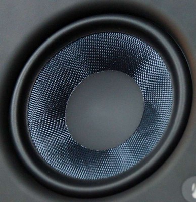

The 8” woofer uses a woven composite cone that has a beefy-looking surround. It uses a ¾” thick, 4” diameter magnet on the motor that is vented through the pole piece. Underneath the woofer is a slot port. PreSonus claims a 35Hz low-frequency extension but doesn’t give a window for that figure. That extension spec needs more context to be meaningful, but we will get a look at the extension in the measurements. The woofer is driven by a 75-watt amplifier and the tweeter is driven by a 65-watt amplifier for a combined total of 140 watts of amplification using a class A/B amplifier (although none of that is specified as peak, RMS, or continuous). The crossover frequency between woofer and tweeter is listed as 2.2kHz. The specs also list a 105dB maximum peak SPL at 1 meter, and that should be adequate loudness for pretty much anyone.

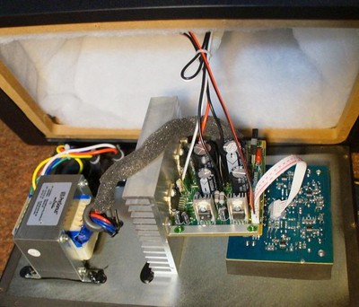

Internal look at the Amplifier of the ERIS E8 XT

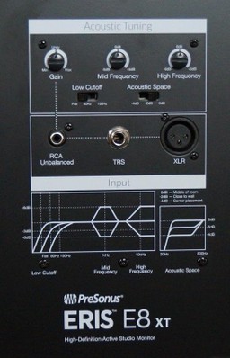

Connectivity is comprised of balanced XLR and TRS inputs and an unbalanced RCA input. There are a host of controls that can alter the frequency response to compensate for different acoustic conditions. A boundary gain level switch can cut the low-frequencies by 2 or 4 dB which can come in handy where the E8 XT has to be placed near surface boundaries which can disproportionately boost bass. There is a high-pass filter that can come in useful if the E8 XT is paired with a subwoofer in a system with no bass management. It can set the filter frequency at 100Hz, 80Hz, or let the speaker go as low as possible. That high-pass is a really good idea since most ‘prosumer’ audio systems don’t have an easy way to blend a sub in with the speakers; this allows the speaker to cross over to the sub in a much more controlled manner, especially since most subs have adjustable low-pass filters. The E8 XT also has knobs that can boost or cut the midrange frequencies or treble by 6 dB. Along with these response shaping controls, there is a gain knob.

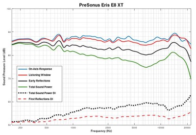

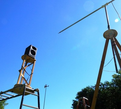

The PreSonus Eris E8 XT speaker was measured in free-air at a height of 7.5 feet at a 1-meter distance from the microphone, and the measurements were gated at an 11-millisecond delay. In this time window, some resolution is lost below 250 Hz and accuracy is completely lost below 110 Hz. Measurements have been smoothed at a 1/12 octave resolution.
The above graph shows the direct-axis frequency response and other curves that describe the speaker’s amplitude response in a number of ways. For more information about the meaning of these curves, please refer to our article Understanding Loudspeaker Measurements Part 1. Overall, this is a good showing, with a flat response that falls within a +/-2dB window up to a peak around 15 kHz. The peak in high treble isn’t likely to be an audible issue, as many people have trouble hearing that high and there is not much content that high anyway. The only thing that might color the sound is the wide but shallow dip centered around 7 kHz. That might slightly recess treble a bit, although I didn’t notice the treble to be at all recessed during my listening. We can see from the directivity indexes that directivity is pretty well-controlled until high treble frequencies. The blip around 700 Hz is likely just a port resonance and shouldn’t do much to color the sound.

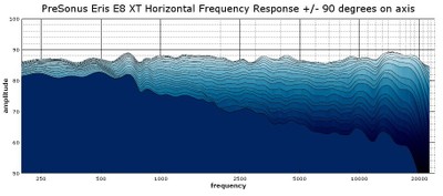

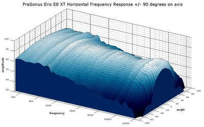

The above graphs depict the speaker’s lateral responses out to 90 degrees in five-degree increments. More information about how to interpret these graphs can be read in this article: Understanding Loudspeaker Review Measurements Part II.
What are the most notable features that we can see from these graphs is just how well directivity is matched between the drivers and also how well the waveguide is working over the entirety of the forward direction of the speaker. The overall directivity control is excellent with a high correlation between the on-axis response and off-axis responses. That is abetted by the generally good linearity of the response at pretty much every angle. This speaker should have a tonally balanced sound over a wide angle of area, so you don’t need to be listening with the speakers facing you directly to get a good sound. Acoustic reflections should also have a similarly good tonality so that users will not need acoustic treatments to secure a good sound. It also allows for predictable equalization for those who want to adjust the sound character for something they may prefer more. A speaker with this flat of a response both on and off axis should do well in its task of being a studio monitor as well as listening at home for enjoyment. It largely sends out what is put in with not much deviation, and that is as one would hope for from a studio monitor.

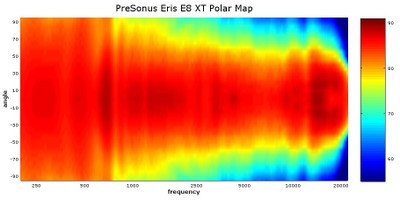

The above polar map graphs show the same information that the preceding graphs do but depict it in a way that can offer new insight regarding these speakers’ behavior. Instead of using individual raised lines to illustrate amplitude, these polar maps use color to portray amplitude, and this allows the use of a purely angle/frequency axis perspective. The advantage of these graphs is they can let us see broader trends of the speaker’s behavior more easily. For more information about the meaning of these graphs, we again refer the reader to Understanding Loudspeaker Review Measurements Part II.
First of all, yes, I know what this graph resembles, so you can stop snickering. It’s just a plot of the acoustic performance of a loudspeaker, so stop being such a child about it. OK, look, I will admit, it is a little funny, but if we can grow up a bit and just assess the loudspeaker performance here, this does show the same excellent directivity control that was seen in the above graph. We can see very little drop-off in output all the way out to 50 degrees. Thanks to the waveguide, the treble doesn’t even begin to beam until it gets near 20 kHz. That gives these speakers a 100-degree angle of coverage over the forward direction with little change in loudness or sound character. This is terrific performance for monitoring or home audio applications.

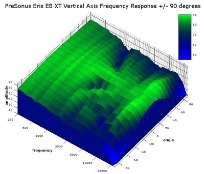

The above graph shows the E8 XT’s response behavior along its vertical axis where the zero degrees angle is directly in front of the tweeter, negative degree values are below the tweeter, and positive degree values are above the tweeter. Something a bit unusual can be seen here, and that is where the cancellation null begins below the on-axis angle. All two-way loudspeakers where the drivers are separated by any distance will exhibit a cancellation null at some point. Normally, loudspeaker makers try to keep that point as far away from the on-axis angle as possible, but in the Eris E8 XTs, the null begins at just 10-degrees below the on-axis angle. That is a bit of a problem, and the reason why that is a problem is that often monitors are mounted at a higher position than the listeners in a mixing console setting, so there is a chance that the sound engineer could be sitting in a spot below the on-axis angle, even though recommended industry practice is that near-field monitors be at ear level. That puts them in a position where there is a response hole centered at the crossover frequency.
While the response below the on-axis angle is a bit worse than usual, the response above the on-axis angle is better than normal. The E8 XT monitor holds a flat response out to a 20-degree high angle. This means that the lobe where the drivers’ sound integrates is tilted upwards a bit more relative to typical speakers. If you have these mounted above the listening position, make sure they are angled downward so that the tweeter is aimed at or just below the listener’s ears. So long as you are listening on-axis or within 20-degrees above, you will be met with a very neutral sound. If you are setting them up for home use, try using a somewhat smaller bookshelf speaker stand that puts your ears slightly above the tweeter to get an optimal sound. Once the E8 XT’s lobe is understood, it can actually be leveraged to give these speakers better placement flexibility than normal speakers.

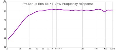

The above graphs show the Eris E8 XT’s low-frequency responses that I captured using groundplane measurements (where the speaker and microphone are on the ground in a wide-open area). This is another terrific showing, a superbly neutral response that is flat down to 50 Hz with a strong response down to below 40 Hz. This is the type of response one would hope for given that these are studio monitors. If the response was exaggerated or ‘hot’ in bass regions, content creators would be mixing in less bass than they think which would result in an inadvertently thin-sound in the end product. Port tuning looks to be maybe 37 or 38 Hz. PreSonus claims a 35 Hz extension, but they didn’t specify a window for that frequency, and looking at our measurements, that looks to be a -10dB point. So the E8 XT’s have very good extension but not quite flat-to-35 Hz extension, which isn’t very plausible given this speaker’s design anyway. However, room gain can shore up the low-frequencies so it should be fairly common to get a flat response down to 40 Hz in-room, especially in medium to smaller rooms.

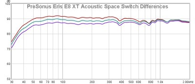

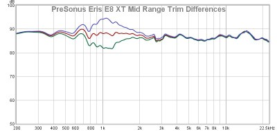

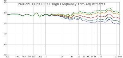

The above graphs exhibit a few of the changes that can be made to the response using some of the controls on the amp plate. There are a lot of different ways to alter the response, and these are just a handful of some of those altered responses. The default settings seem to result in the flattest response anechoically, except for the “acoustic space” switch, where the ‘-2dB’ setting seems to be more in line with the rest of the range. Low frequencies, which are very subject to in-room acoustic effects, are better changed through room measurements along with a capable equalizer, although if these speakers are going to be placed near a boundary such as a wall or especially a corner, users should probably set the “acoustic space” switch to ‘-4dB.’
For monitoring purposes, the “Mid Frequency” knob and the “High Frequency” knob should be left at the 12 o’clock position where they provide the most neutral response. The ‘Mid Frequency’ knob may seem like a strange way to be able to adjust the response since changes from the 12 o’clock position could only result in a bad sound, but PreSonus explained to me that is basically the point of that control; it is for recording engineers to check how their mix translates to cheap speakers that can often have a peakish midrange response like clock radio speakers or older car speakers. The “High Frequency” knob is useful for those who want either a more mellow sound or a slightly more aggressive sound for recreational listening, but it shouldn’t be used for monitoring at anything other than the 12 o’clock position.
