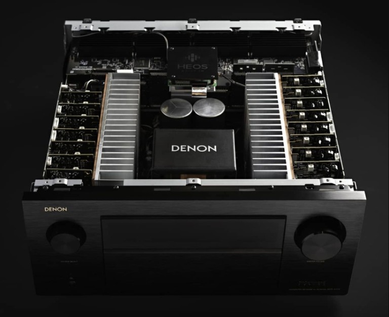

Denon AVR-A1H topless
Denon’s press materials promise electrical and mechanical parts that are “Hi-Fi grade,” but thanks to Matthew’s reporting, I can offer more detail. The AVR-A1H uses a new amplifier module (shared with other models in the Denon lineup) that uses a high-current 4-pin transistor. The 4th pin is a thermistor that allows the amplifier to track temperature changes and re-bias itself automatically. Very cool. As you might expect for a 15-channel amplifier, the power supply is enormous —  the E-Core transformer is reportedly the largest ever included in a Denon receiver. Not since the venerable AVR-5805 have we seen such a beefy power supply in an AVR.

The AVR-5805 had a fifth foot at the center of the chassis to support its massive toroidal power transformer (borrowed from the AVR-5803) and two additional E-Core transformers borrowed from the AVR-2805!) The AVR-5805 employed multiple high voltage (80V) capacitors (4 x 33,000uF = 132,000uF, or 66,000uF per rail). According to Denon, the two additional EI core’s for the AVR-5805 were to supply power on both analog and digital circuits individually, not for driving the power amplifier section. Due to advancements in circuit design, the AVR-A1H doesn't need such a huge power transformers any more to power analog or digital circuity.
The block capacitors for the power amplifier are indeed of “unprecedented size” for Denon, rated at 33,000µF each (compared to 22,000µF each in both the AVR-X8500H and the 110th Anniversary AVR-A110). The power supply capacitors are custom-made for Denon by Japan’s Nichicon Corporation. These are 4-pole capacitors — a 4-pole filter is created by the arrangement of the internal capacitor coils, yielding a filter that leads to much lower inductance, according to Matthew Poes. The power transformer, which sits on a 2mm-thick copper plate, is 41% heavier than the one used in the X8500H. In fact, at a whopping 25.4 pounds, the power transformer in the AVR-A1H is nearly 4.5 pounds heavier than an entire AVR-X2800 receiver!

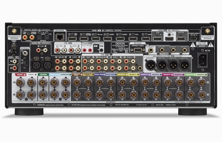

 Denon AH1 Backpanel
Denon AVR-A1H Back Panel View - Note 17 Speaker connections and 4 XLR sub outs!
