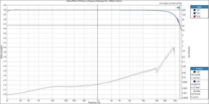

Denon PMA-A110 Frequency Response and THD+N @ rated Power (8 ohms)
The PMA-A110 exhibited extremely linear bandwidth (-3dB @ 62kHz) even up to full rated power (80 watts/ch, 2CH driven) and at very low distortion levels (<.02% THD+N). I measured similarly low distortion when driving a 4 ohm load when slightly exceeding full rated power (165wpc, 2CH driven).

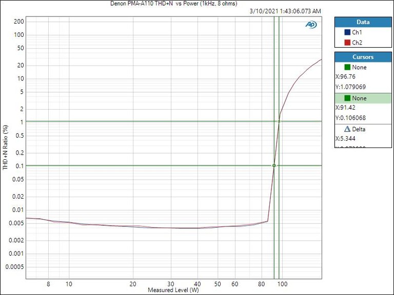

Denon PMA-A110 Power Sweep vs Distortion ( 8 ohms)
The PMA-A110 exceeded its 80wpc 8-ohm rating by delivering 91wpc at 0.1% and 96wpc at 1% THD+N, both channels driven into an 8-ohm load.

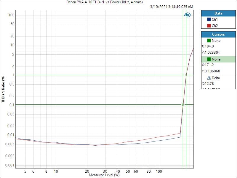

Denon PMA-A110 Power Sweep vs Distortion ( 4 ohms)
The PMA-A110 exceeded its 160wpc 4-ohm rating by delivering 171wpc at 0.1% and 184wpc at 1% THD+N, both channels driven into an 4-ohm load. I reran this test into 2-ohm loads and 218 @ 0.1% THD+N and 253 watts at 1% THD+N.

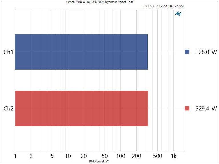

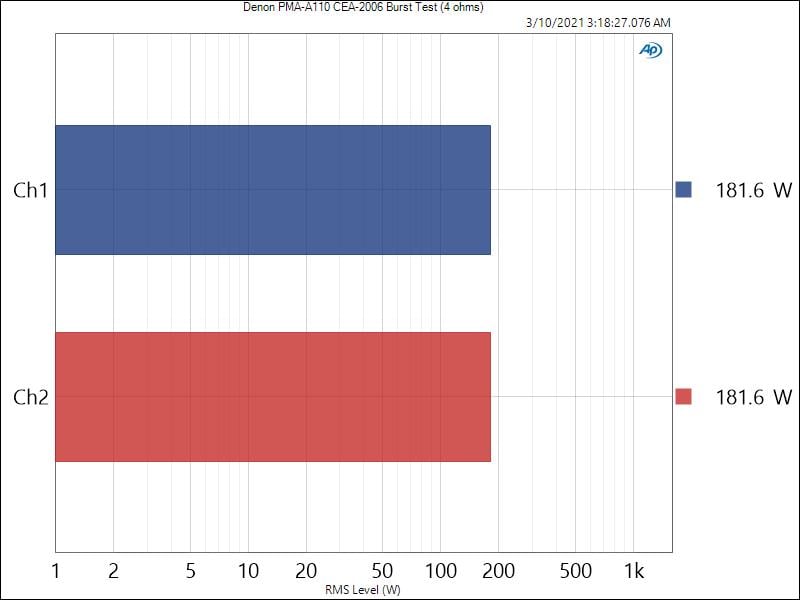

Denon PMA-A110 (2CH) Dynamic Power Test - 4 ohms
Denon PMA-A110 (2CH) Dynamic Power Test - 2 ohms
Usually an amplifier outputs more power during a CEA-2010 dynamic burst test but my results were roughly the same as the 1kHz power sweep tests for 8 and 4 ohm loads. Denon claims this is to be expected since the PMA-A110 is designed to eliminate the effects of power supply regulation due to output current. Specifically at the voltage amplifier stage, it is optimized and controlled to be driven constantly for rated output.  Yet, when I drove the PMA-A110 into 2-ohm loads, it was able to manage 328 watts both channels driven at 1% THD+N. That's a lot of power from an "80-watt" rated integrated amplifier!

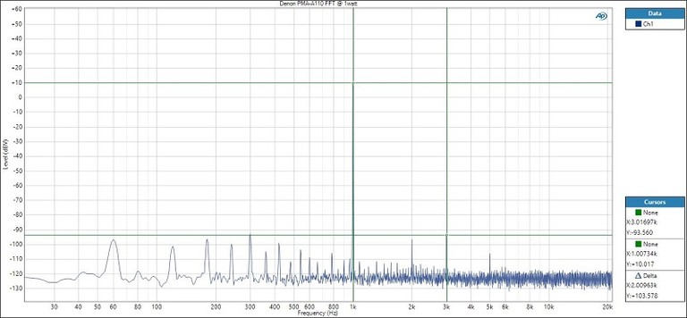

Denon PMA-A110 FFT Distortion @ 1 watt output
There was slight 60Hz hum and associated harmonics measured <-90dB due to transformer leakage flux but this is inaudible. The 3rd order harmonic was 103.5dB below the fundamental which is an excellent result. The first watt of the PMA-A110 is free of noise and distortion that should make every audiophile happy. But what about at full rated power?

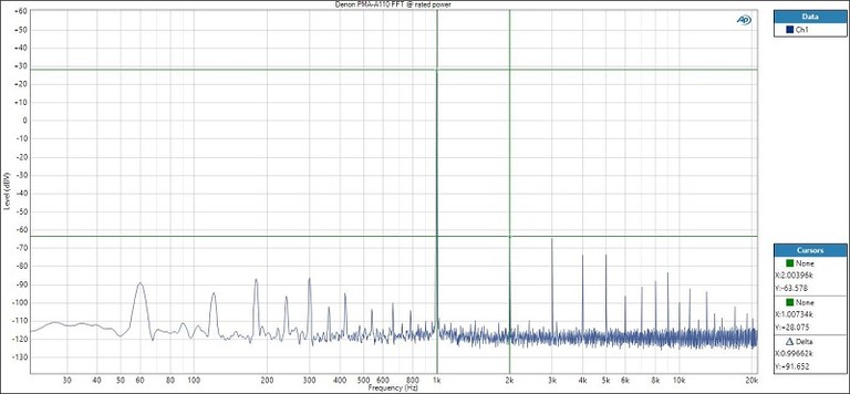

Denon PMA-A110 FFT Distortion @ full rated output
Similarly rated AV receiver amps usually exhibit lots of harmonic distortion when driven at full rated power. The PMA-A110 is a much different animal. 2nd order distortion was > 91dB below the fundamental at full rated power. This is an excellent result.

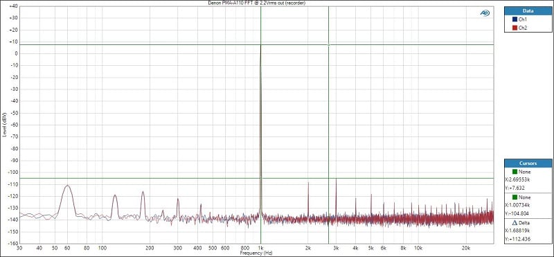

Denon PMA-A110 FFT Distortion 2.2Vrms Recorder Output
The Denon PMA-A110 doesn't have variable preamp outputs but it does have a fixed level output called "Recorder Out" which exhibited very low distortion as can be seen with the 3rd order harmonic -112dB below the fundamental.

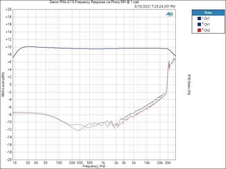

Phono Output Frequency Response and Distortion (THD + N)
 Denon PMA-A110 Phono Pre-Out MM Frequency Response and Distortion vs Frequency
Using the original 3-time constant RIAA curve, I EQ’ed the AP to get the expected flat response of the phono preamp. Input signal was 10mVrms with 1 watt measured at the speaker outputs into an 8-ohm load. Unfortunately when I saved the files for the phono measurements, the right vertical axis figures were not displayed since I didn't have them in full screen. Needless to say, distortion was under 0.05% THD+N at 20kHz.  SNR was measured to be 89dB (A-wt) which is excellent.

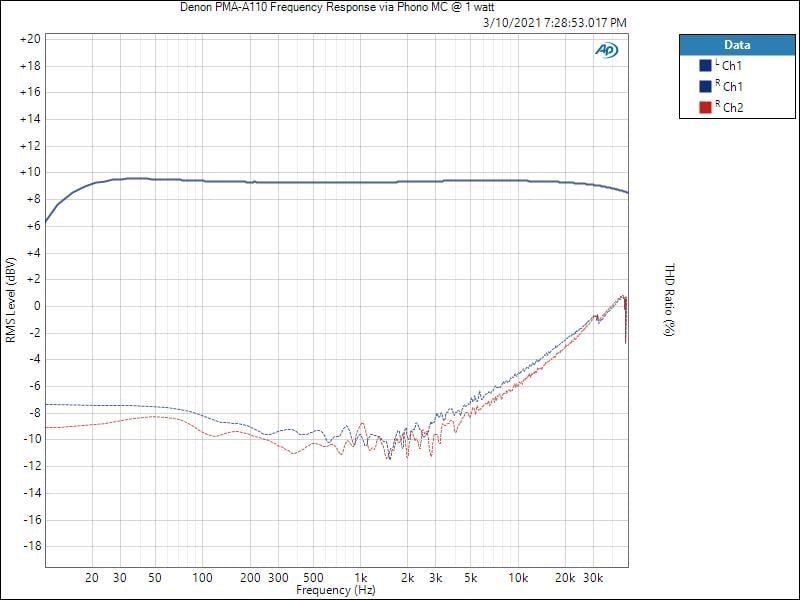

Denon PMA-A110 Phono Pre-Out MC Frequency Response and Distortion vs Frequency
I repeated this measurement for the MC phono setting. Input signal was 2mVrms with 1 watt measured at the speaker outputs into an 8-ohm load. Unfortunately when I saved the files for the phono measurements, the right vertical axis figures were not displayed since I didn't have them in full screen. Needless to say, distortion was under 0.05% THD+N at 20kHz.  SNR was measured to be 80dB (A-wt) which is again a good result.

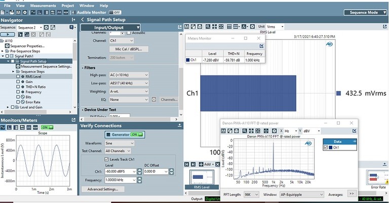

Signal to Noise Ratio and Dynamic Range (AES-17)

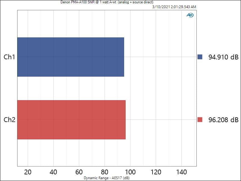

 Denon PMA-A110 SNR @ 1 Watt
With a 0dBFs signal to the COAX input, and 1 watt output, I measured 85dB (A-wt) and 95dB SNR (A-wt) with source-direct engaged. I noted the left channel measured between 1-2dB better SNR than the right channel depending on the test conditions which I attribute to layout differences between the channels. This is academic and not something audibly perceptual.

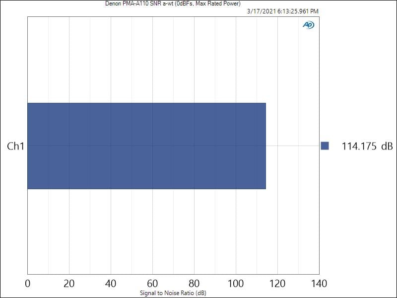

 Denon PMA-A110 AES-17 Dynamic Range @ Rated Power
With a 0dBFS 192kHz, 24-bit input, I measured 114dB at  full rated power out (A-wt). Using the standard -60 dBFS input test signal per AES-17 standard, I measured 120dB indicating the PMA-A110 does NOT truncate a 24 bit signal and is capable of achieving 20 bits of SNR which is exemplary low.

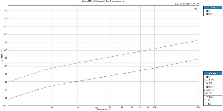

Denon PMA-A110 CH-CH Crosstalk
The channel-channel crosstalk was about as good as I've measured on the higher end AV receivers from Marantz and Denon. There is about an 11dB difference in crosstalk between the channels which I confirmed is close to their measurement of 10dB. -60dB at 20kHz is still very good channel-channel isolation.
