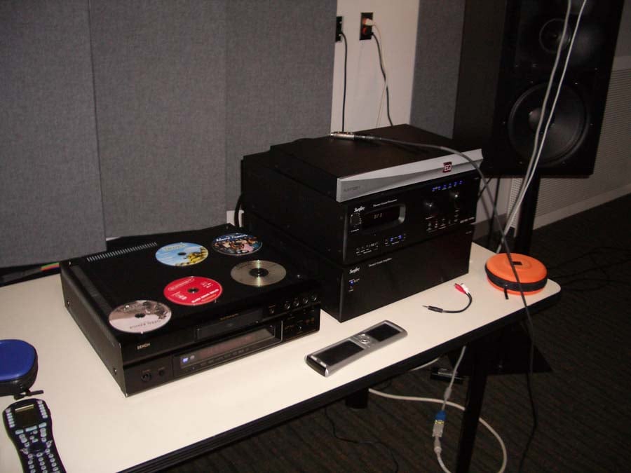

Surround Sound Demos[IMGP2542001]
While we sat in the Immersive Audio Lab, we were given a brief history of surround sound including Tom Holman's direct involvement with the birthing of these technologies. He was the first to call discrete surround sound a "5.1 system". As most home theater enthusiasts know, 5.1 stands for Left Front, Center, Right Front, Left Surround, Right Surround, Subwoofer (a limited bandwidth channel, hence the .1). The demo discussed our previously mentioned limitations of conventional 5.1 formats which included the lack of convincing front to back panning of information. According to research, human hearing has degraded localization capability at 90 degrees. The benefit of 10.2 allows for a more naturalistic surround presentation since it provides the critical height and width data our brains are most perceptually sensitive to.
At this point, our brains were nearly saturated with digesting all of this fascinating information and were finally ready to hear some demos. Audyssey conducted some demos in conventional 5.1 and in 10.2 to compare and contrast the experience.
First up was a Diana Krall demo. She was on stage with bassist backing her while she introed her band. The sound was expansive with the walls of the room virtually disappearing. There seemed to be no disconnect between hearing her in the Immersive Audio Lab vs actually being at the live performance. The only thing missing (and thankfully so) was the usually annoying viewer(s) behind us shouting or singing along off key while Diana was singing "All or Nothing at All".
The next track was a chorus and pipe organ piece by Tom Vigneri. The venue was Methuen Hall. In 10.2 you literally felt immersed into the hall. The recording was done with 24 individual mic scattered around the stage, with some located above the chorus and positioned at two different heights in proximity of the organ. Some of the mics were used to capture hall ambience as well as direct sound from the soloists. There was also a mic position facing the wall for capturing back channel information.
In 10.2 you really had that "live" experience. A quick switch over to conventional 5.1 collapsed the front soundstage, making the listening space seem much smaller and sonically dull. We no longer had the impression of the "live" experience which our ears quickly adapted to upon instantly hearing. The leap in sound quality between 5.1 to 10.2 is comparative to first hearing a 2CH recording vs a dedicated 5.1 recording. Once you hear the latter, it's difficult to go back to the former.
What was truly impressive about this recording was its authentic rendering that we've simply never heard in any conventional 5.1 recording. Chris told us the success of this recording had largely to do with the fact that when you record and mix the tracks yourself, and know the composer, it really goes a long way in ensuring you've captured and produced an accurate multi channel rendering of the experience.
Last but not least, we heard the beautifully recorded Herbie Hancock Butterfly song which we learned consisted of 48 original tracks that they remixed especially for this project.
In 10.2, the mix had a very pinpointing and enveloping soundstage which was undoubtedly thanks to the height and width channels. A good portion of this experience was lost once we switched to conventional 5.1. The recording now took on a dryer more sterile feeling.
