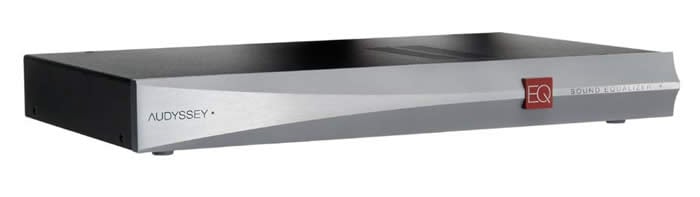

Audyssey MultEQ Pro Sound Equalizer Review
- Product Name: MultEQ Pro Sound Equalizer
- Manufacturer: Audyssey Laboratories
- Performance Rating:
- Value Rating:
- Review Date: October 10, 2006 19:00
- MSRP: $ 2500

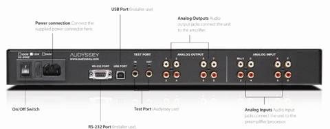

Analogue input: 8 channels,
unbalanced Room correction: MultEQ XT filter for each channel applied at sub/sat splice |
SNR: 108dBA Connections: RS-232 port, USB 2.0, 4 pairs analogue RCA (unbalanced) outputs, 4 pairs analogue RCA (unbalanced) inputs, test port (Audyssey use only) |
- Unprecedented calibration ability
- Delivers 8x more bass accuracy than MultEQ XT receiver-based version
- 2 X accuracy over MultEQ XT above low-bass region
- Unit appears transparent within system
- High value for installers & integrators
- Highest quality DACs and ADCs utilized
- Requires professional setup and calibration for best results
- Requires optimal speaker placement for best results
- Lower cost speakers may not exhibit desired performance envelope
- Typically requires separates or amplifier
- 8 pairs of RCA interconnects required for full utilization
- No +12V Trigger

For consistency's sake the Sound Equalizer's eight channels were configured in the same standard rotation format as is built into most receivers and pro-pros. Starting with the Denon AVR-3806's eight external outputs going to the Audyssey Sound Equalizer's eight analog inputs the channel assignments are:
Denon left front ext out > Audyssey analog input #1
- Denon center ext out > Audyssey analog input #2
- Denon right front ext out > Audyssey analog input #3
- Denon right surround ext out > Audyssey analog input #4
- Denon right rear/left rear ext outs > Y-connector > Audyssey analog input #5
- Denon left surround ext out > Audyssey analog input #6
- Denon subwoofer ext out > Y-connector > Audyssey analog inputs #7 & #8
Assignments from the Audyssey to the Outlaw Audio 7075 amplifier or direct to the front and rear subwoofers were:
- Audyssey analog out. #1 > Outlaw Audio 7075 left front input
- Audyssey analog out #2 > Outlaw Audio 7075 center input
- Audyssey analog out #3 > Outlaw Audio 7075 right front input
- Audyssey analog out #4 > Outlaw Audio 7075 right surround input
- Audyssey analog out #5 > Outlaw Audio 7075 right rear surround input
- Audyssey analog out #6 > Outlaw Audio 7075 left surround
- Audyssey analog out #7 > Front Infinity Intermezzo 1.2 subwoofer
- Audyssey analog out #8 > Rear Infinity CSW-10 subwoofer
