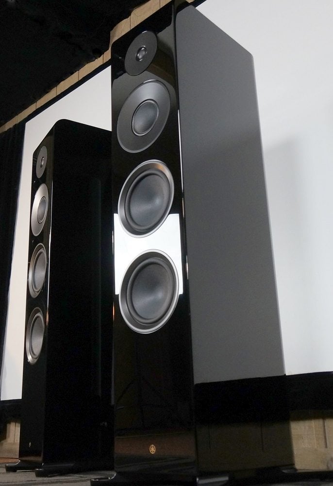

Yamaha NS-2000A Appearance

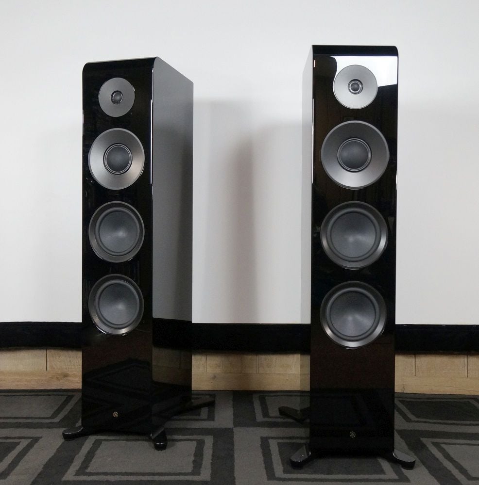

The NS-2000A speakers play it safe as far as a luxury appearance goes, and that is not at all a bad thing. They haven’t taken any aesthetic risks, and I would guess the reason is because these get a much more worldwide distribution than most speakers in this segment, so they have to be able to appeal to as many buyers in the world as possible. Piano black does that, especially in a finish so fine that it matches Yamaha’s pianos. The NS-2000A speakers only come in a black gloss finish, the same application as is performed on Yamaha’s grand pianos. Indeed, this has to be among the finest gloss finishes I have seen, with no hint of orange peeling or cloudiness in the slightest. The sides of the cabinets are like black mirrors on account of their pristine reflectivity. The application of such a fine finish has to constitute a very significant fraction of the manufacturing budget of these speakers. Outside of the gorgeous piano black finish, the drivers also present a clean, uncluttered appearance. The domes and cones of the drivers share nearly the same dark gray color and luster, and the trim rings are also simple pieces mounted into the front baffle. The NS-2000A speakers don’t have many other visual features outside of the drivers except for the rounded top edge of the front baffle and a small Yamaha badge in the lower edge. The outriggers do a great job of carrying the simplicity to the floor, and they almost look like an extension of the cabinet itself. Something else worth noting are the binding posts and the plates they are mounted on; these are some of the nicer binding posts I have seen with thick polished brass pieces on a powdered aluminum plate.

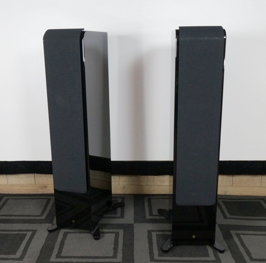

Users who want an even cleaner appearance can hide the drivers with a magnetic grille which is just some black fabric stretched over a frame, but these speakers are already so minimalist that the grille doesn’t do a lot more to uncomplicate their looks. These speakers look better without the grille, so I would only use the grille where the drivers might need protection from children or pets (or dumb adults). The NS-2000As look great. Some shoppers in this segment might want something a bit more wild, but no one will complain about their looks in having a set of these in their living room.

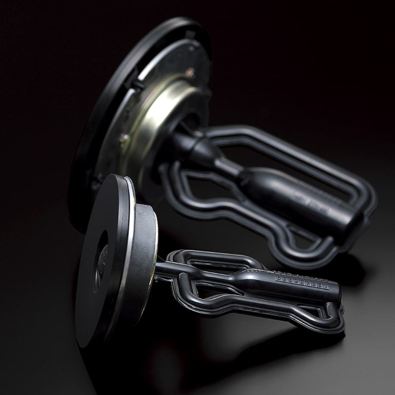

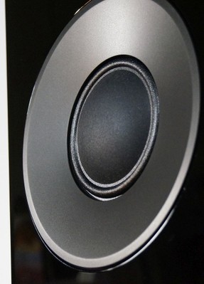

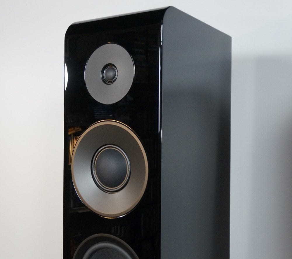

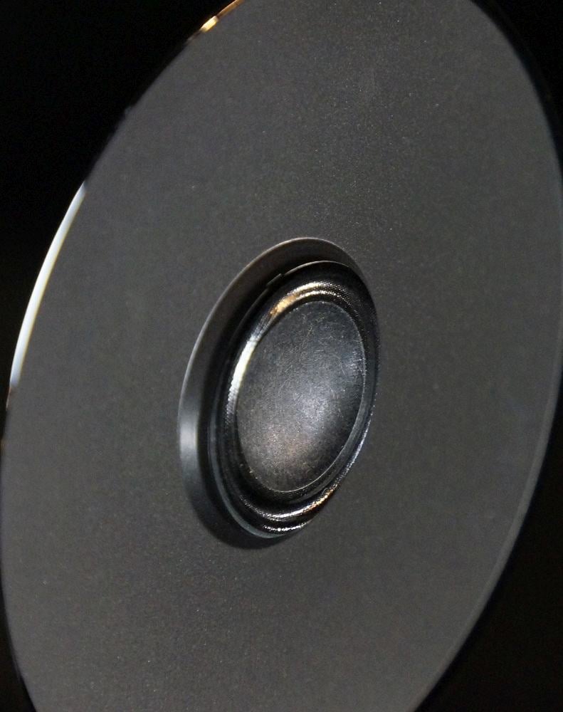

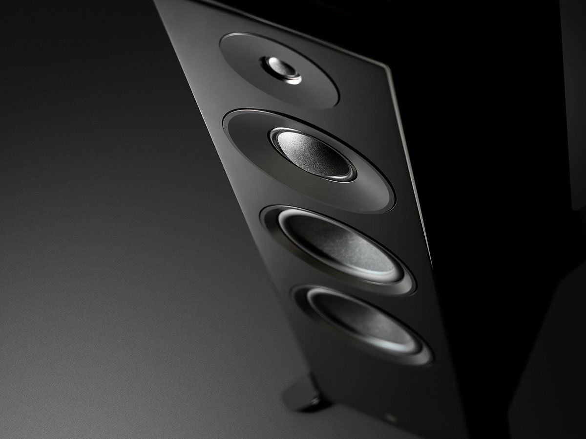

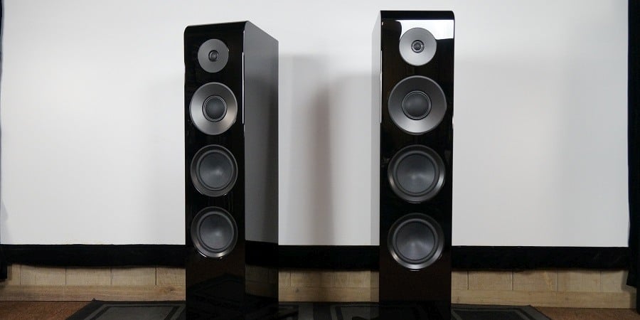

Let’s begin our design analysis of the NS-2000A at the top with the tweeter. The tweeter is a 1” dome made from a blend of materials that Yamaha calls ‘Harmonious Diaphragm’ which has the key ingredient of Zylon. Zylon is a synthetic polymer developed in the 1980s and sees use in a wide number of applications due to its high tensile strength, stiffness, low weight, and thermal stability; all qualities that make it perfect for loudspeaker diaphragms. Zylon’s elasticity properties rival that of Beryllium, so the ‘break-up’ modes that occur in driver cones will be similarly pushed into higher frequencies than typical cone materials. This allows the drivers to play over a much wider frequency band without cone resonances creeping into the reproduction thereby distorting the intended sound. Indeed, the NS-2000A’s specs boast a frequency response spec out to 65kHz with a -10dB window.

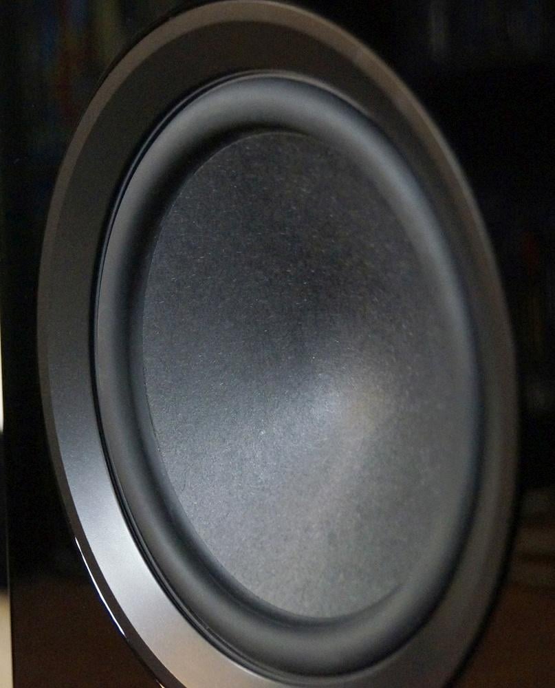

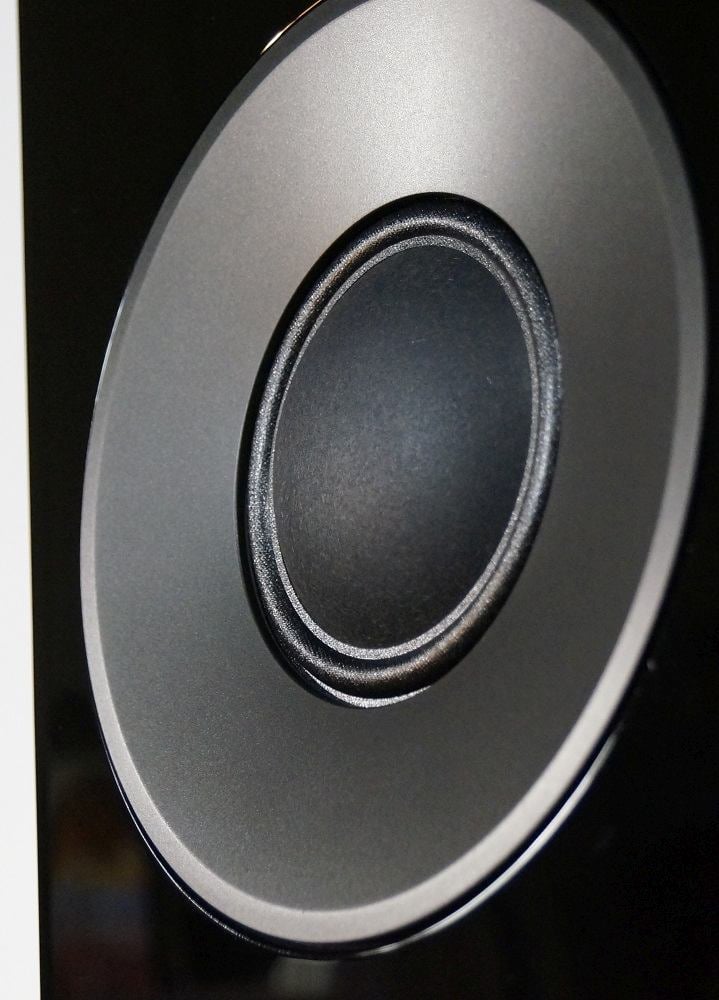

All of the drivers in the NS-2000A use the ‘Harmonious Diaphragm’ material. The 3 ¼” mid-range dome in the three-way NS-2000A is also composed of this material and is given a very wide 750 Hz to 3.5 kHz bandwidth. If the ‘Harmonious Diaphragm’ material behaves in the way that Yamaha claims, they could get away with a 3.5kHz crossover frequency without resorting to a steep filter on the midrange. A relatively high crossover frequency should give the tweeter a break and allow it to play at a higher loudness level than if it had used a more typical crossover frequency. Likewise, the 750Hz bass woofer to midrange transition gives the midrange a break from driving the lower frequencies which should lead to less distortion and higher output. A 750Hz crossover frequency is about an octave higher than most three-way speakers use, but the two 6 1/2” bass drivers will have a much easier time playing that upper octave than a single 3 ¼” driver. These high crossover frequencies should allow a wider dynamic range, although they may make for a tighter listening axis over vertical window, or, to put it another way, listeners won’t want to listen too far above or below the tweeter’s height otherwise phase conflicts will start to deform the response and degrade the sound.

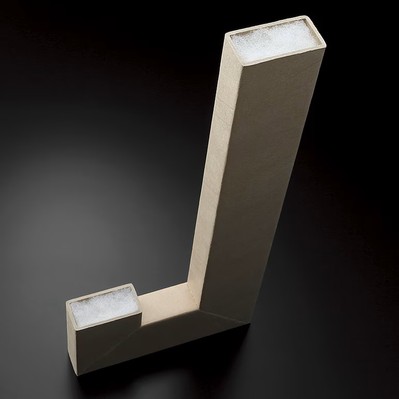

The tweeter and midrange driver are enclosed by an attachment that Yamaha calls the ‘resonance suppression chamber.’ This redirects the backwave pressure of the domes in a manner that reduces modal resonances on the domes of the midrange and tweeter. This is similar to what transmission lines can do but uses a smaller but more complex arrangement instead of the long tapered tubes of transmission lines. Instead of simply absorbing backwave pressure from the diaphragm by damping the pressure waves through lots of soft acoustic absorption material, the Resonance Suppression Chamber redirects the back waves through different paths that rejoin and ends up canceling out resonances. This is a clever way to deal with backwave radiation but must have involved some enormously sophisticated computational modeling.

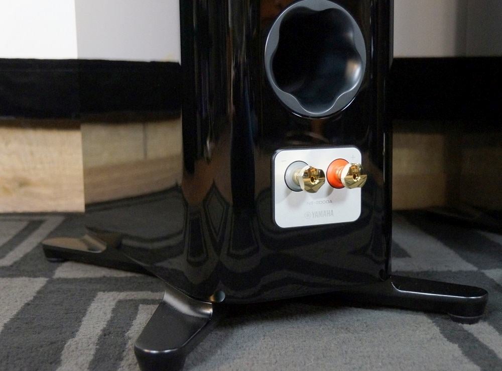

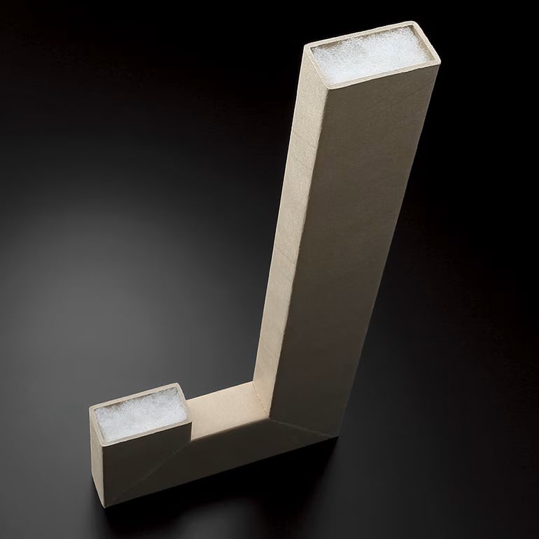

The lowest frequencies are produced by a rear-mounted port that has a swirl effect in the flaring that Yamaha calls the ‘twisted flare port.’ They claim it reduces port noise, presumably by increasing laminar flow of air from a vortex-like effect.
The enclosure is carefully modeled using finite element analysis so that internal bracing is used intelligently instead of just going all out on sheer mass to reduce panel resonances. Laser vibrometers are then used to verify that the resonances are reduced. It's a heavy and solid cabinet and has a luxury-class feel. One interesting thing used in the enclosure is something that Yamaha calls the “Acoustic Absorbers’ which are a pair of pipes that produce resonant frequencies that cancel out internal cabinet modes. Normally, loudspeakers will use a lot of internal stuffing to eliminate standing waves, but Yamaha has come up with a more elegant and sophisticated solution that targets specific significant modes. The cabinet is planted on a metal base with outriggers that give users the option of using either spiked feet or rubber feet. The outriggers and feet do give the cabinet some good stability, and it wouldn’t easily be tipped over. The speakers connect to wire by a pair of brawny-looking five-way binding posts. With a single set of binding posts, there is no option to bi-amp or bi-wire, and that is probably for the best. The grille is acoustically transparent black fabric stretched over a sturdy plastic frame, and it attaches to the speaker by magnets. The plastic frame probably does create some diffracting surfaces, so for the best audio performance, the speaker should be used without the grille. However, the effect the grille has on the sound is not likely detrimental enough to have a major impact on the sound.

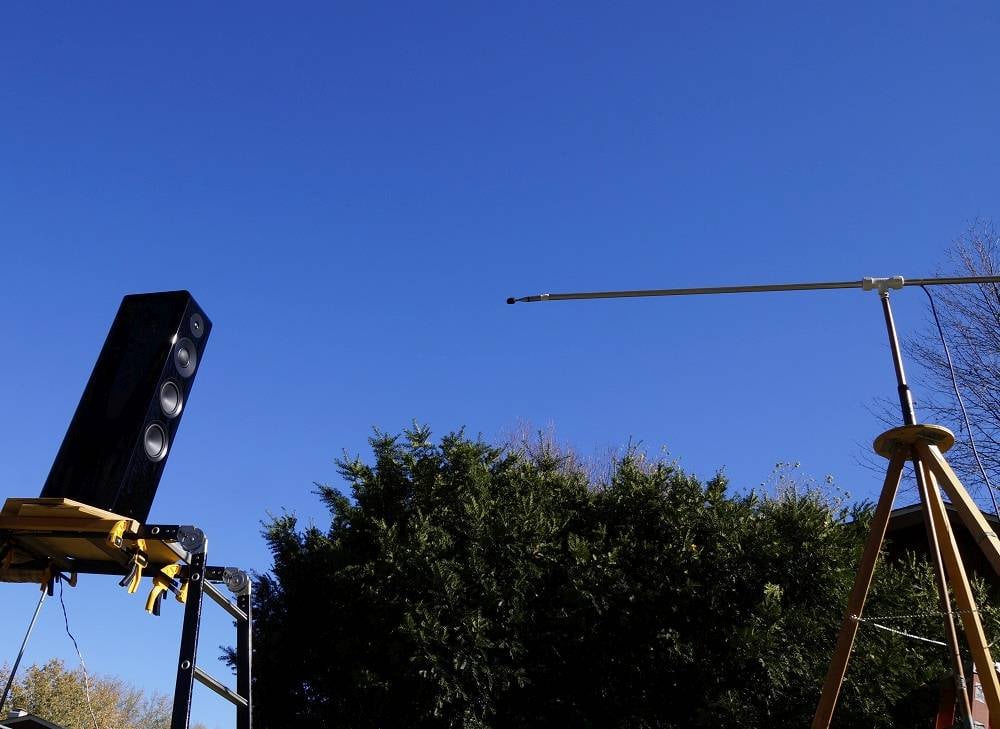

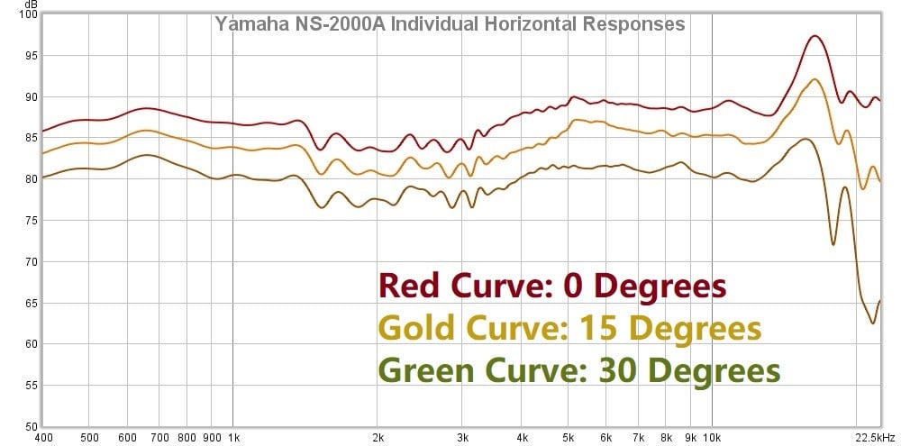

The Yamaha NS-2000A Tower was measured in free-air at a height of 4 feet at a 2-meter distance from the microphone, with the microphone raised to an 8’ elevation that was level with and aimed at the tweeter center. The measurements were gated at 8 milliseconds. In this time window, some resolution is lost below 400 Hz, and accuracy is completely lost below 200 Hz. Measurements have been smoothed at a 1/24 octave resolution.

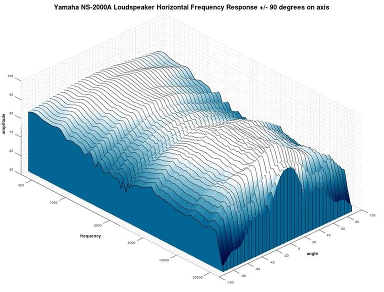

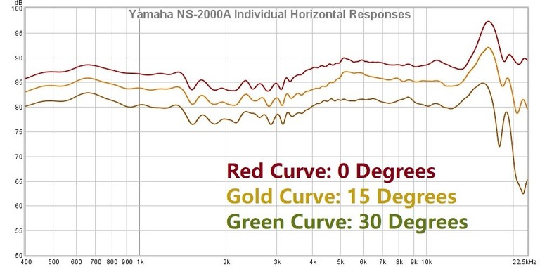

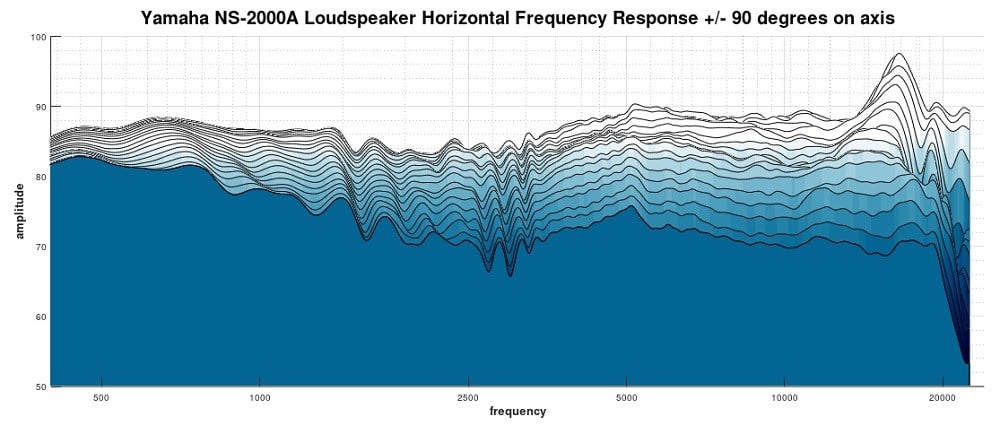

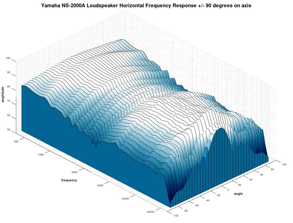

The above graphs depict the Yamaha NS-2000A’s direct-axis and horizontal dispersion out to a 90-degree angle in five-degree increments. Information on how to interpret these graphs can be read in this article: Understanding Loudspeaker Review Measurements Part II.
The first feature about these graphs that leap out is a spike in upper treble centered around 16.5kHz. To those who think this is a serious audible problem, I can assure you that it is not. That is just too high in frequency to have a significant audible penalty. There is not much content that high, and most peoples’ hearing in that range is very insensitive. If anything, it might add a bit more ‘air’ to some recordings for those people who still retain some hearing in that range. What is of much more consequence is how recessed the midrange is. Around the on-axis response, it looks like the midrange is down nearly 5dB from the tweeter. That should be pretty audible. As we move off-axis, the tweeter’s level goes down considerably relative to the off-axis angle. In my own listening, I didn’t notice an especially hot tweeter, but I did not have the speakers angled to face the listening position. I did feel the treble was crisp but not quite sibilant. Having such a recessed midrange seems to be a strange decision, because the Xylon midrange is what makes the NS-2000A special in Yamaha’s NS line-up outside of the NS-5000A. It’s almost like the midrange is slightly padded down in the crossover circuit. I have to think Yamaha deliberately voiced these speakers this way because it would be very easy to level-match the midrange driver in the crossover circuit; so why didn’t they do it? I can’t blame Yamaha too much for that since I thought the speakers sounded good, but again, I didn’t have them angled on-axis to face the listening position. At an on-axis angle, that tweeter has to be pretty spicy. The tweeter itself is pretty well-behaved throughout its bandwidth until we get to that upper-treble spike. I am not sure what is causing that spike, and I don’t think it’s a break-up mode since it’s not retained off-axis.
The above polar map shows the same information as the preceding graphs but depicts it in a way that can offer new insight regarding these speakers’ behavior. Instead of using individual raised lines to illustrate amplitude, polar maps use color to portray amplitude, and this allows the use of a purely angle/frequency axis perspective. The advantage of these graphs is they can let us see broader trends of the speaker’s dispersion behavior more easily. More information about interpreting this graph can be read in this article: Understanding Loudspeaker Measurements Part II.
The polar map of the NS-2000A looks like a rook chess piece turned over on its side. One interesting aspect on this graph to note is how the tweeter holds a fairly constant level of off-axis energy out to nearly 20Khz. If I had to guess, I would say that this is the reason for the tweeter’s boosted on-axis level; Yamaha was more concerned about the tweeter’s dispersion than its on-axis response. Most dome tweeters start to narrow their dispersion in higher frequencies, very often around 10kHz. The narrowing of dispersion is called beaming, and this tweeter doesn’t do that at all. However, were the on-axis response linear all the way to the top, the off-axis would definitely constrict and have a narrower angle of acoustic output to the top. So the trade-off that must be decided for the designer is to have a hot on-axis upper treble with smooth off-axis upper treble or to have a smooth on-axis upper treble with recessed off-axis treble. What makes all the difference here is how the speakers are going to be set up; will they be facing the listener or will they be facing ahead in parallel lines? Since most people angle the speakers to simply face straight ahead, I think that Yamaha might have made the right call here, although all of this happens in such a high frequency band that this is nearly an academic matter rather than anything of real-world consequence.
In the graph, we also get a look at the recessed midrange. If Yamaha had only boosted the midrange output by about 3dB, they would have very good directivity matching with the tweeter as well as a flatter response over all angles. I don’t understand why they didn’t do this; it would have been a more textbook perfect speaker. Given the midrange’s dispersion, I wouldn’t listen to these speakers past a 40-degree angle, not that many people would listen at such a far off-axis angle.
In this graph, we get a closer look at a few of the responses of the NS-2000A over some horizontal angles. Here we can see how the treble starts to calm down at off-axis angles. At the on-axis response (0 degrees), the treble is quite hot relative to the midrange, but at a 30-degree angle, it is only slightly elevated. A 30-degree angle would be around where many listeners would be seated relative to the speakers if they are facing straight forward in parallel aim. Yamaha suggests only a slight toe-in for the NS-2000As, but I would say just face them for a perpendicular angle off the back wall unless you like spicy treble.

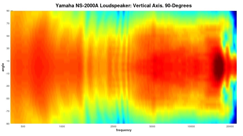

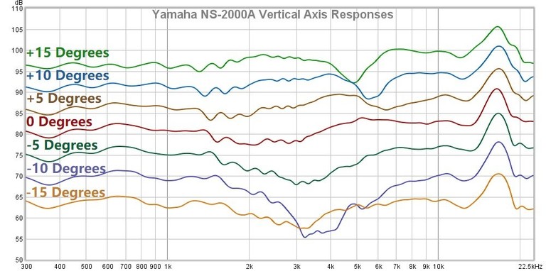

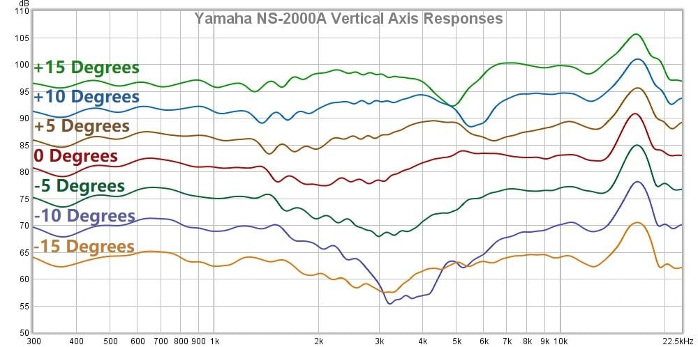

In the above graph, we get a look at the NS-2000A’s frequency responses per vertical angle. This speaker is best listened at tweeter height or maybe just above tweeter height, because it doesn’t take long before phase cancellation starts having effects on the vertical axis responses. This is the penalty of having high crossover frequencies between the drivers without having very close center-to-center spacing between them. There is a relatively narrow window of vertical angles that the tweeter will play nice with the midrange driver. With a 39” height, the tweeter isn’t mounted especially high, so this shouldn’t be a problem for most listeners, but those with low-slung seating might want to pass on these speakers.

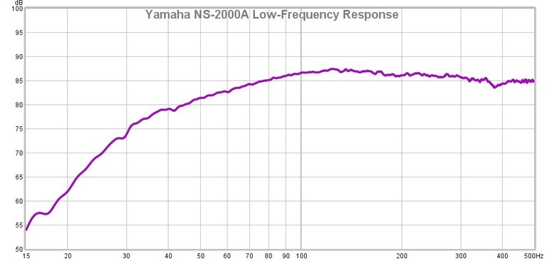

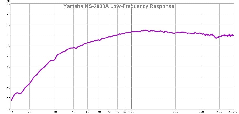

The above graph shows the NS-2000A’s low-frequency response captured using ground plane measurements (where the speaker and microphone are on the ground at a 2-meter distance in a wide-open area). In this graph, we see a fairly well-controlled bass response with a slight tapering of output as frequencies go down to port tuning which is around 30Hz. Below port tuning, the response dives at the expected fourth-order rolloff. In my room, I had a pretty strong response down to a bit below 30Hz, and I do not benefit from a whole lot of room gain. These speakers have a relatively powerful bass response, and most users will not feel the need for subwoofers to compliment them.

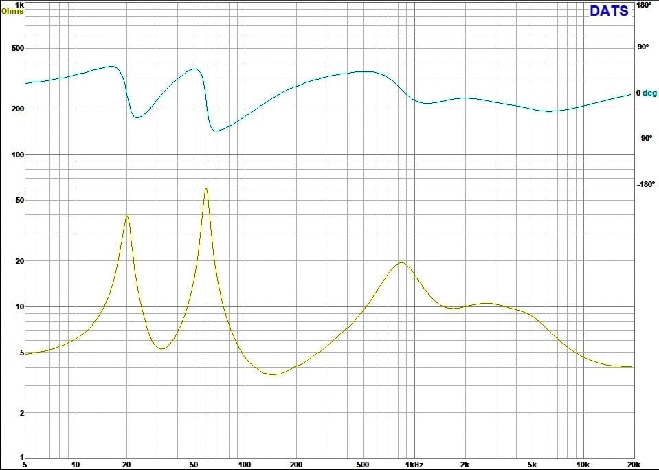

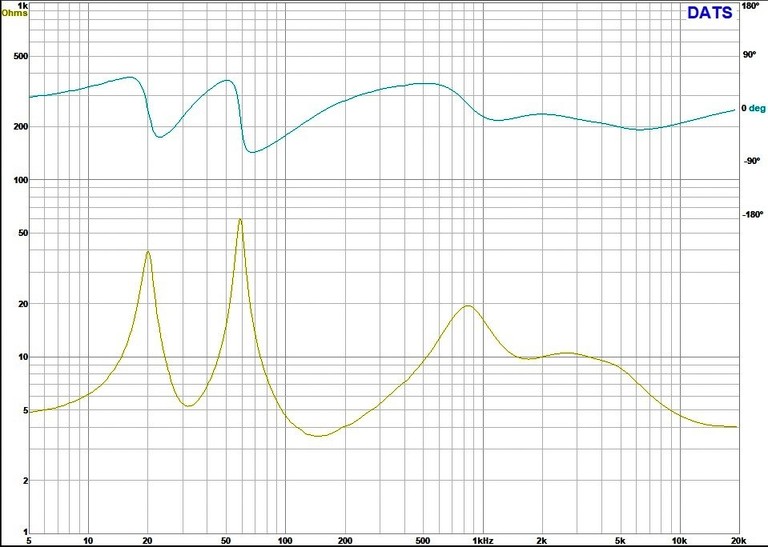

The above graph shows the electrical behavior of the NS-2000As. Yamaha specifies these speakers to be a 6-ohm speaker with a 3.5-ohm minima. I would just consider them to be a 4-ohm speaker. This is not an excruciating electrical load for amps nor is it totally undemanding. A competent amplifier will be needed, but users won’t need a super-amp. Yamaha’s own R-N2000A would be pretty sweet to pair with these speakers, but the R-N1000A would work just fine as well.
