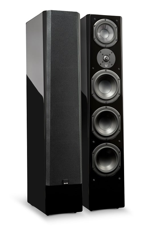

SVS has recently released a new entry into their popular ‘Prime’ speaker line, and their new loudspeaker takes the Prime speakers to new heights (literally, since it is taller than any of the others). It is the new top dog of the Prime series, and SVS has rightfully named it the ‘Prime Pinnacle.’ The Prime Pinnacle is a three-way, five driver tower speaker, much like the regular Prime Tower, and one might be forgiven for thinking it is just a bigger and beefier version of the Prime Tower since that is what it looks like on the outside, but there is considerably more to it than that. In many respects, it is a very different design than the other Prime speakers. The Prime Pinnacle uses the same tweeter and same bass drivers as the other Prime speakers, but that is about it. And, unlike the other Prime speakers, the Prime Pinnacle uses three bass drivers, so it should be capable of a bit more low-end punch than the rest of the series. That is about it for similarities, except for the aesthetics of the speaker.

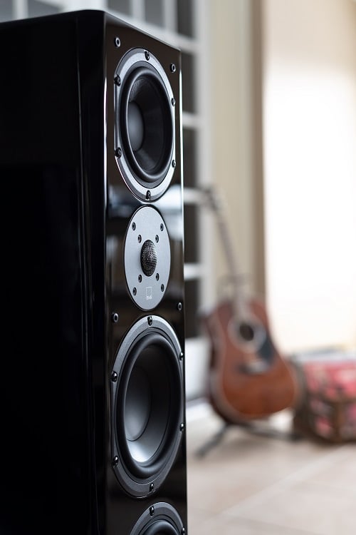

As for the differences, let’s start with the brand new midrange driver. Unlike the midrange in the Prime Tower and Prime Center speakers, the Prime Pinnacle midrange brings in some of the features found in the midrange of the higher-end ‘Ultra’ series since it uses a glass fiber cone as opposed to the polypropylene cones found in the other Prime midrange drivers. This lighter, stiffer cone material may allow the midrange to behave better over a larger range of frequencies. It’s a larger cone too, at 5.25”, and that should increase its dynamic range. The larger cone diameter may also help for a more controlled directivity as well.

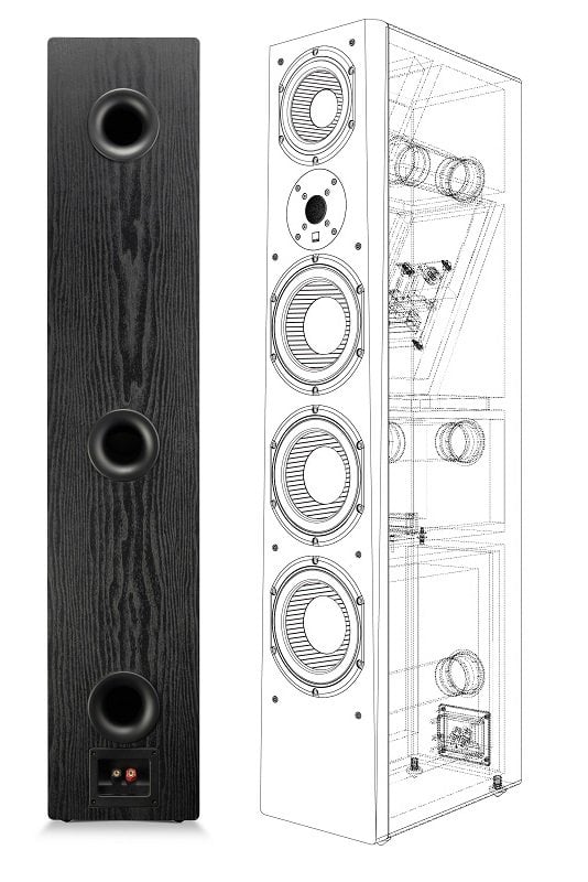

While the Prime Pinnacle uses the same bass drivers as is found in the other Prime speakers, it arranges them in an interesting new way with respect to how tower speakers are traditionally designed. Each bass driver is housed in its own separate ported compartment, and that, of course, means that each driver has its own port. It’s not unusual for tower speakers to seal off the midranges and tweeters in order to prevent backwave pressure from interfering with their diaphragm motion, but SVS is using a totally different design strategy in keeping the bass drivers separate. By isolating each of the bass drivers in its own compartment, there is a lot more flexibility in how the low-end response can be shaped by the designer. Each compartment can have a different resonant frequency, and that can add up in a variety of ways to achieve any kind of low-end target curve by the designers. What’s more, if the bass seems too thick, the end user could also just seal a number of the ports which will temper the low-end response. While SVS does not intend for the Prime Pinnacle to have its ports sealed and did not design it to be operated that way, anytime less bass is desired from nearly any speaker, making an airtight seal in a port is always an option. Unlike other multi-ported speakers, it looks like that would work well with the Prime Pinnacle since sealing one of its ports would not increase airflow in other ports which can result in port turbulence at lower levels. Also, in making all of these internal compartments for the bass drivers, that has the additional benefit of reinforcing the cabinet side-walls for a very rigid and well-braced enclosure.
