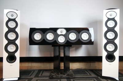

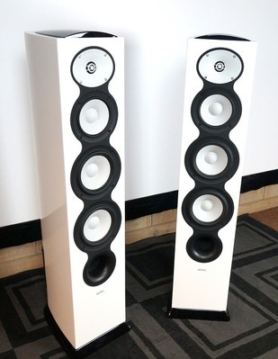

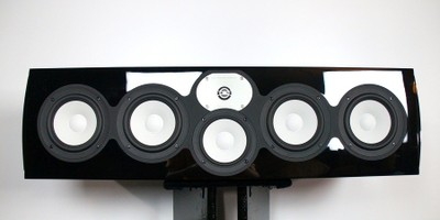

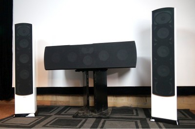

Performa logo.jpgAs with the M126Be speakers, the F226Be and C426Be are very attractive speakers. The only people who would think they are ugly are those who just hate the appearance of speakers, period. I received gloss white F226Be speakers and a gloss black C426Be center, but the PerformaBe speakers can also be had in metallic silver and Walnut as well. The gloss finish on the PerformaBe speakers is pristine. While the speakers I received wasn’t quite a matched set, the way in which they mismatched played very nicely off of each other. The white cones are surrounded by black trim, with the rest of the speaker having a solid color gloss. The cabinets are gracefully curved and end in a rounding in the back. The F226Be speakers have a high-gloss ‘top cap’ on them that, as I had said about the M126Be speakers, gives them an almost automotive styling. The center has these ‘top cap’ pieces mounted on its sides. Everything on these speakers has a gleaming polish except for the cones and trim around the drivers.
 Revel F226Be Towers & C426Be Center Channel Speakers (no grilles left pic; grilles on right pic)
If the whiteness of the drivers is too aesthetically loud for some folks, they can just use the grilles to blank out the front baffle. The grilles attach magnetically, so there are no grille guides to blemish the front baffle. These speakers look so much better without the grilles though, in my opinion. The grilles should only be used to protect the drivers in situations where children (or clueless adults) could potentially push in the dustcaps of the cones. One unavoidable visual aspect of the C426Be is that it is a big center speaker. At nearly 40” wide, it is just about as wide as many tower speakers are tall. It isn’t likely to fit in the shelving slots of many entertainment centers (however if you intend to place a speaker of this caliber in a location as bad as an entertainment center shelf slot, shame on you!). Potential buyers will want to be sure that the C426Be’s size can be accommodated.
The F226Be and C426Be speakers are expensive speakers, and they look like it. Let’s now take a look at the design to see if the level of engineering matches the price as well as the aesthetics…

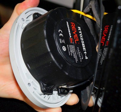

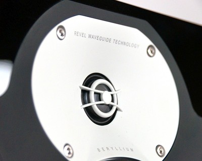

The use of beryllium for the tweeter diaphragm is heavily touted as a selling point by Revel. Revel’s desire to bank on their use of Beryllium likely comes from the fact that it is quite expensive to use, but it does have ideal properties for use as a tweeter dome.
To quote from our review of the M126Be which uses the same tweeter and waveguide:
This is on account of its low weight combined with its very high stiffness; this Audioholics article on how to identify high fidelity loudspeakers discusses the matter of diaphragm composition and Beryllium’s advantages. It is three times stiffer than conventional diaphragm materials such as aluminum but exhibits three times the damping and is only half the weight. The reason why it isn’t more widely used is expense: I am told that an aluminum dome normally costs under 25 cents whereas a Beryllium dome costs over 30 dollars (and that's not counting the motor structure or other parts of the driver itself). The Beryllium tweeter is mounted in Revel’s latest generation waveguide so that directivity is better controlled than previous Revel waveguides. When we remove the tweeter driver from the cabinet, it is absolutely massive and is by far the largest tweeter motor I have personally seen to date. Part of the reason why it is so large is because of the two 3 ⅓” ceramic magnets which give the tweeter a major boost in sensitivity. Ceramic magnets also have the advantage of better heat dissipation over the Neodymium magnets that most tweeters use.
One of the reasons why Beryllium is so expensive is that it is a highly toxic material to manufacture with, although the end result as a tweeter diaphragm is not dangerous (so long as you don’t eat your tweeter or vaporize it and breath in the fumes). Many special measures must be taken in order to safely process it, and these extra measures are a major contributing factor in their cost.

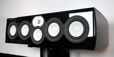

The midrange driver and bass driver cones are made from a material that Revel calls ‘Deep Ceramic Composite’ aluminum which is anodized aluminum. The anodization that Revel uses is, to quote Revel’s product page, “a plasma electrolytic oxidation process that uses a plasma discharge to create a coarse ceramic coating on both sides of the aluminum core”. This should result in a somewhat higher-performing cone material than the regular aluminum. The ceramic sandwiching of the aluminum should help to damp the break-up modes that occur at higher frequencies which may not be fully suppressed by the crossover circuit.

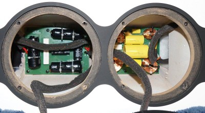

The bass drivers are low-pass filtered at 260Hz on the F226Be and 210Hz on the C426Be, and both filters use 3rd-order slopes. The midrange drivers crossover to the tweeter at 2.1kHz with a 2nd-order slope on both speakers. The F226Be tweeter uses a 3rd-order high-pass filter while the C426Be uses a 2nd-order high-pass filter. Taking a look at the F226Be crossover circuit, we can see it is a fairly extensive piece with 18 elements altogether, with some large iron-core inductors and electrolytic capacitors in the bass driver’s filter, and a slew of air-core inductors, resistors, and polypropylene film capacitors in the midrange and tweeter’s circuit. The crossover in the C426Be was partially obscured by stuffing but looked to be a similarly formidable affair. Both speakers have dual binding posts for those who want to bi-wire or bi-amp the midrange/tweeter and bass driver separately.

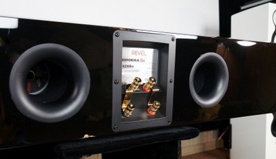

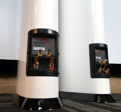

There is some serious engineering put into these speakers....
The cabinets are made from ¾” MDF. The midrange driver in both speakers is housed in a compartment that is internally sealed from the rest of the enclosure so that the backwave radiation of the bass drivers do not affect it. The midrange driver compartment as well as two window braces help to strengthen the enclosure. The C426Be is chocked full of acoustic stuffing throughout while the F226Be has bunched up acoustic stuffing in the top and bottom of the enclosure. One interesting detail is that the shape of the waveguide in the C426Be has been altered to accommodate closer spacing to the midrange driver. This helps to reduce the cabinet height as well as lessens the off-axis crossover cancellation lobe on the vertical axis. The front-firing port on the F226Be has a somewhat short 5 ½” length with a 2 ¾” diameter and is heavily flared on both ends. The C426Be has two rear-mounted ports with 8” lengths and 2 ¾” diameters. Both speakers come with port plugs for those who want to seal the ports for reduced bass output and extension. The F226Be comes with spiked feet that can be installed for those who don’t want the cabinet base itself resting on a surface. The C426Be has feet of differing heights that can be used to adjust the angle of the speaker.
As we can see from this analysis, there is some serious engineering put into these speakers, which is what one would hope for in speakers of their pricing. Let’s now give them a listen to hear how all of this sophisticated design adds up in practice…

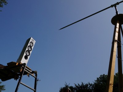

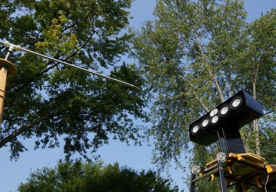

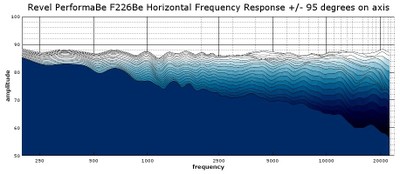

The PerformaBe speakers were measured in free-air at a height of 4 feet at a 2-meter distance from the microphone, with the microphone raised to a 7’ elevation that was level with and aimed at the tweeter center. The measurements were gated at 8-milliseconds. In this time window, some resolution is lost below 400 Hz and accuracy is completely lost below 200 Hz. Measurements have been smoothed at a 1/12 octave resolution.

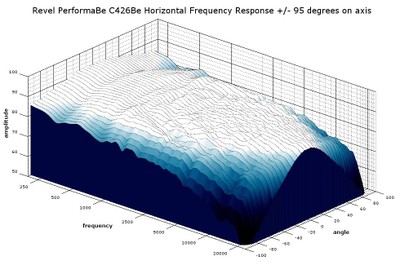

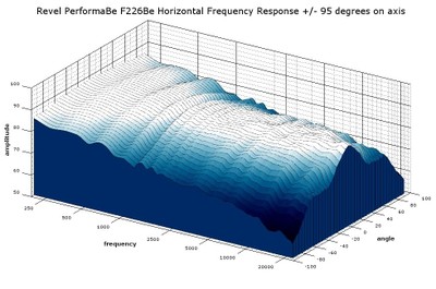

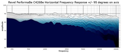

This is excellent performance and is something we have come to expect from Revel.
The above graphs depict the PerformaBe speakers’ direct-axis and horizontal dispersion out to a 95-degree angle in five-degree increments. Information on how to interpret these graphs can be read in our article Understanding Loudspeaker Review Measurements Part II. This is excellent performance and is something we have come to expect from Revel. Both speakers have a very flat response as well as a smooth off-axis response. Both speakers exhibit relatively wide dispersion, although, for some reason, the C426Be seems to have somewhat wider dispersion than the F226Be across the midrange and treble bands even though they use the same midrange driver and tweeter. Perhaps that is due to the much wider baffle of the C426Be as compared to the F226Be. What we can see from these graphs is that these speakers are very neutral. They produce an accurate sound over a wide angle in front of them. The listener does not have to be seated in a precise location to receive a full, balanced sound, so these speakers do not have a small ‘sweet spot.’
Referring to our discussion in the ‘Design Analysis’ segment of this review about the design of the C426Be which will supposedly thwart off-axis cancellation nulls so endemic to traditional center speakers, we see here that Revel’s strategy works, and we can hardly see any evidence of cancellation from the horizontally aligned woofers. This center speaker’s coverage is superlative, and its technical attributes are ideal for a center speaker. It is so good that it could easily be used as front left and right speakers too if the user wanted, and it would sound terrific. Of course, it would be unusual to use horizontal speakers as front left and right speakers, but the C426Be is an unusually good speaker.

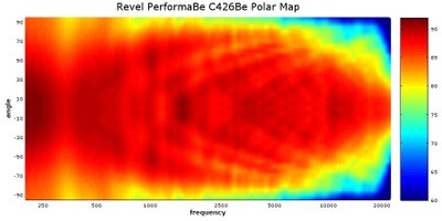

the Revel C426Be is an unusually good speaker.
The above polar map shows the same information in the preceding graphs but depicts it in a way that can offer new insight regarding these speakers’ behavior. Instead of using individual raised lines to illustrate amplitude, polar maps use color to portray amplitude, and this allows the use of a purely angle/frequency axis perspective. The advantage of these graphs is they can let us see broader trends of the speaker’s dispersion behavior more easily. More information about interpreting this graph can also be read in our article Understanding Loudspeaker Review Measurements Part II.
The Revels should sound great in the acoustic environment of any normal domestic room without acoustic treatments.
One thing we can see from these graphs is just how well-controlled the PerformaBe’s dispersion behavior is. There isn’t really any angle where there is some peak or dip that breaks the flow of the response. There is some tightening of the response at very high treble, but that occurs in a range that isn’t audible for many listeners, and there is sparse content in that range anyway. We get a better look at how much wider the C426Be’s dispersion is then the F226Be. The F226Be maintains a strong response out to about 60 degrees off-axis, while the C426Be’s response doesn’t see much drop off in energy until almost 90 degrees. One might argue that there is no need for good behavior at such an extreme angle since no one is going to listening to these speakers at nearly a right angle relative to their forward direction. However, the response to that is much of the sound we hear from a speaker isn’t direct sound from the speaker itself but reflected sound from nearby surfaces. Even if the direct sound is perfect, the sound quality of a speaker can still be diminished if the off-axis response is poor. So having such a wide and well-controlled response is not just about having a broad area of coverage for listeners, it is about ensuring the reflected sound is as good as the direct sound. Another advantage of this is that it does away with the need for lots of acoustic treatments for the system to sound good. These speakers should sound great in the acoustic environment of any normal domestic room without acoustic treatments.

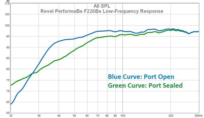

The above graph shows the PerformaBe speakers’ low-frequency response captured using groundplane measurements (where the speaker and microphone are on the ground at a 2-meter distance in a wide-open area). The complexity of the C426Be made measuring its low-frequency response a bit tricky, but I think I have captured a fair approximation of its true anechoic low-frequency response. It shows the relative extension that can be had between sealing the ports since users do have the option of sealing just one port if they wanted. Revel supplies port plugs in case users want to reduce bass output for situations that might give bass too much of a boost such as placement very close to room boundaries. One thing that users can do with the C426Be is just seal one port for a lower tuning frequency. Revel doesn’t state that can be done, and it isn’t how they intend the speaker to be operated. Sealing just one port does reduce headroom in bass, and the port can be overdriven into turbulence much more easily, however it is one way to get deeper bass which might come in handy when the user doesn’t have a subwoofer. With both ports open, the tuning point of both the C426Be and F226Be seems to be a bit under 40Hz. If you seal one port on the C426Be, the tuning point looks to drop to 30Hz. Completely sealing either speaker considerably reduces deep bass output. One reason users might want to seal the port is to eliminate the phase rotation that occurs at the transition to port-generated output in order to make the speakers easier to integrate with subwoofers.

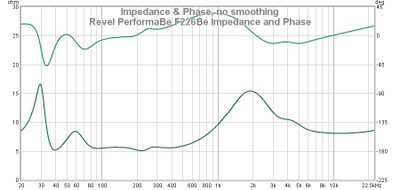

The above graphs show the electrical behavior of the PerformaBe speakers. Revel specifies both speakers as 8 ohms for nominal impedance. That may be true by their calculations, but much of the impedance for both speakers lay quite a bit lower than 8 ohms. The entirety of the mid-bass and upper bass regions hover around 5 ohms, and there is a pretty steep phase angle at the port tuning frequency of both speakers which also occurs at 5 ohms. This is not a particularly difficult electrical load but it is not so benign as a thoroughly 8-ohm speaker either. I wouldn’t run these speakers on an entry-level AVR, but my guess is that not many people who buy speakers in this price range are going to run their speakers on a $300 AVR, so I don’t think this will ever be a problem. I measured sensitivity for the F226Be at 88.0dB for 2.83v at 1 meter with the C426Be at 90.8dB for 2.83v at 1 meter. That is pretty standard sensitivity for a tower speaker of the F226Be’s design specifications and relatively high sensitivity for a center speaker but not surprising given the outlay of drivers on the C426Be.
The C426Be center may well be one of the best performing center speakers on the market right now at any price.
