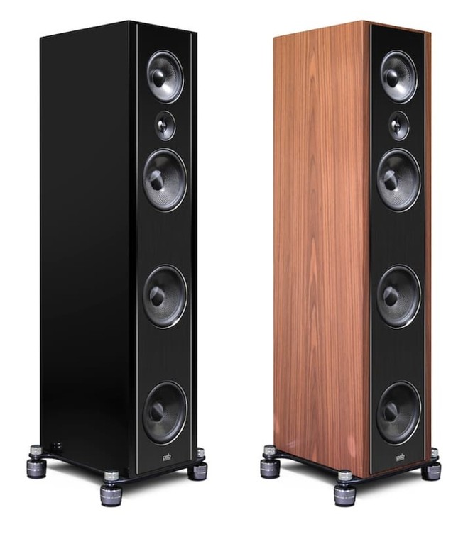

The Synchrony T600 utilizes a trio of 6.5-inch woofers and a 5.25-inch midrange driver, all featuring woven carbon-fiber cones, mass-loaded rubber surrounds, die-cast aluminum baskets, and an advanced motor structure that ensures a constant magnetic force in the gap of the voice coil. The B600 stand-mount uses a single 6.5-inch mid-woofer. The 1-inch titanium dome tweeter used in both the T600 and B600 employs a neodymium magnet, and is cooled by ferrofluid. The tweeter sits inside a waveguide that’s approximately 2.75 inches in diameter. Directly in front of the tweeter is a custom-designed acoustic lens that is said to improve dispersion and off-axis response. Together, these new drivers result in “wider bandwidth, higher maximum output, higher efficiency, better power handling, and reduced harmonic and intermodulation distortion,” according to PSB. The blending of these drivers is handled by the most advanced crossover that PSB has ever built, using high-voltage poly film capacitors and oxygen-free wire. All of PSB’s literature mentions an “amplitude-perfect Linkwitz-Riley acoustic crossover,” for both the T600 and B600. Indeed, a careful look at the spec sheets reveals that the B600’s crossover is a 4th-order Linkwitz-Riley centered at 2200Hz. And in the T600, the crossover from the midrange to the tweeter is a 4th-order Linkwitz-Riley centered at 1800Hz. But the bass-to-midrange crossover at 450Hz is a 3rd-order, Butterworth design. And as you’ll see in a moment, there is even more crossover complexity at work within the woofer system. The prize for all this design work is said to be a “remarkably flat frequency response, so that every sound you hear is true to nature.”

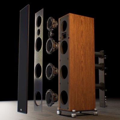

The new Synchrony speakers feature MDF enclosures with more extensive internal bracing than in any other PSB speaker in the company’s history. The goal of this bracing is, of course, to minimize cabinet resonances, which can blur transients and cause uneven response. Taking this concept a step further is the new 5mm-thick solid aluminum plate that covers most of the baffle’s surface on both the T600 and B600. The aluminum plate is designed to suppress “baffle talk” — the excitation of the front baffle by vibrations coming from the drive units, or from other parts of the cabinet. The aluminum plate is decoupled from the rest of the enclosure by 10 “isolation cups,” which work with the plate to help preserve the fine detail that can be lost when the baffle is allowed to vibrate. Standing just over 41 inches tall and weighing in at 77 lbs, the Synchrony T600 has a fairly substantial cabinet that is divided into 4 separate chambers. The midrange driver and tweeter share a sealed chamber at the top of the tower, while each of the three woofers gets its own identically-tuned, rear-ported chamber. This configuration is designed to break up standing waves inside the enclosure. The T600 towers sit on four outrigger stabilizers, each of which attaches to a slightly customized version of the IsoAcoustics Gaia II isolators. The IsoAcoustics isolators decouple a floor-standing speaker from the floor it sits on and prevent mechanical energy from being reflected back into the enclosure. The isolators are designed to provide “a high degree of isolation while resisting lateral movement and oscillations to maintain alignment with the listening position.” The result is said to be a wider soundstage with more precise imaging, and improved detail and transients. (I have heard a few demonstrations at audio shows, and was surprised at how effective these devices seemed to be.) A set of 8 IsoAcoustics Gaia II isolators costs $600 if purchased separately. Clearly, Paul Barton is convinced that they work well enough to include them with every pair of Synchrony T600s.
The (three) woofers are a transitional design, meaning all woofers produce low frequencies, but the bottom woofer rolls off before the middle woofer, which rolls off before the upper woofer, and only the upper woofer rolls off to the midrange driver, which then rolls off to the tweeter.
— Paul Barton

Like PSB’s previous flagship floorstander, the Imagine T3, the T600 is a transitional-array design, with three woofers that cover progressively narrower frequency bands as you move down the speaker. The top woofer covers the entire bass region, from the lowest frequencies all the way up to the crossover point with the midrange driver. The middle woofer starts at the bottom as well, but rolls off much lower, well before the midrange crossover point. Finally, the bottom woofer plays only the lowest frequencies. Barton says that this unusual woofer array produces smoother bass response because it “randomizes” the phenomenon of floor bounce, in which the low-frequency sound waves that bounce off the floor interfere with the sound coming directly from the woofers. Each Synchrony T600 has 3 bass-reflex ports in the rear of the speaker. The T600s ship with 2 sets of port plugs, so users can experiment and customize the bass output to better suit their listening rooms. You can leave all 3 ports open, or plug any one port, or any 2 ports. During the live stream, Barton mentioned that a user might even get the best results from plugging different ports in the left and right speakers, depending on the room setup. If you like to tweak, choosing the best-sounding combination among the many possible permutations will be part of the fun of setting up a new pair of speakers. For some, it may sound a little daunting. But the tweaker’s delight doesn’t end there. Also on the rear of each T600 are 3 sets of binding posts, allowing for bi-wiring/bi-amping, or tri-wiring/tri-amping. Or, as Barton mentioned in the video presentation, you can short out the bottom woofer. “By shorting the bottom woofer,” he explained, “you’re only reducing some of the very lowest frequencies, which could complement the way in which you set this up in your room.”

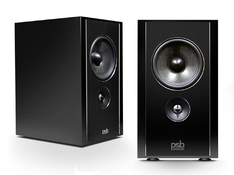

B600 stand-mount speaker is, of course, quite a bit more straight-forward. But
according to PSB, its 6.5-inch carbon-fiber woofer and 1-inch titanium dome
tweeter deliver “wider bandwidth, higher
distortion” when compared to any previous 2-way stand-mount from the company.
Like its larger sibling, the B600 boasts a remarkably flat frequency response,
extensive internal bracing, and the 5mm-thick solid aluminum plate on the baffle.
You might expect, as I did, that the optional 24-inch-tall stands designed to
support the B600 (which sell for $600/pair), would include a version of the
IsoAcoustics isolators. But you’d be mistaken. Instead, PSB did something much
cooler. On the bottom of each B600 speaker, there are four small isolation
feet, custom-designed by IsoAcoustics for this application. In the livestream,
Dave Morrison from IsoAcoustics explained that these tiny feet are just
scaled-down versions of the larger isolators used on the T600. And because they
are attached to the bottom of the B600 speaker itself, the user can enjoy the
sound-quality benefits with any speaker stand, not just the dedicated
ones offered by PSB. The dedicated stands do provide a non-resonant connection
to the IsoAcoustics isolation feet, along with the additional stability of a
bolted connection.
