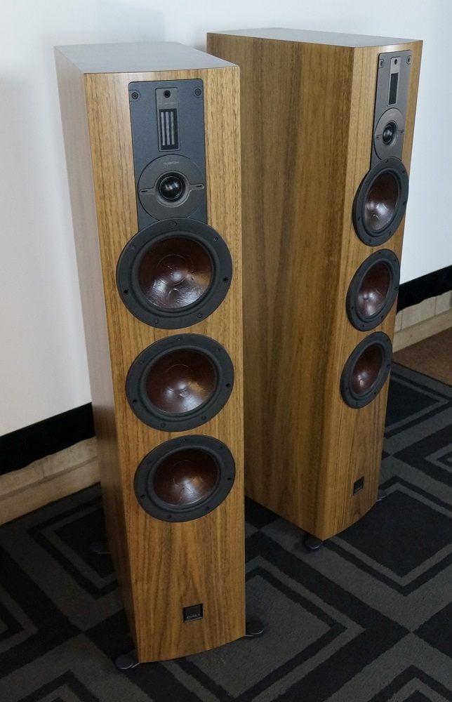

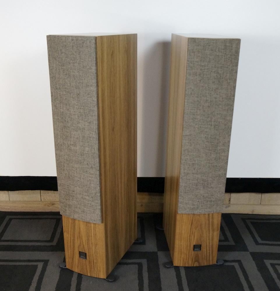

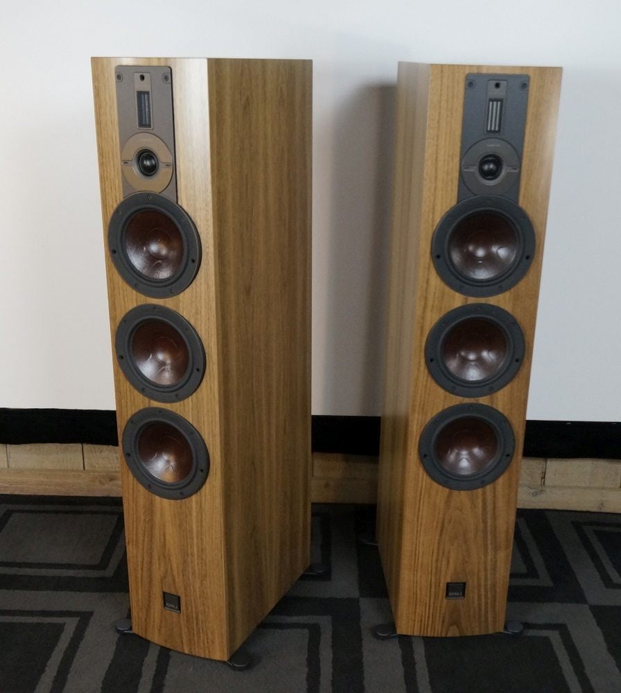

The RUBIKORE 8 speakers play it safe as far as styling goes. They don’t look bad at all, but they don’t take any big styling risks, so other household members aren’t likely to object to their appearance (unless they just don’t like the sight of loudspeakers at all). They can be had in a high-gloss maroon wood veneer, high-gloss black, high-gloss-white, or natural walnut with a satin sheen. I received the walnut finish, and the surface was so smooth that at first I thought it was a vinyl finish (you can imagine my surprise: a vinyl finish on a $12k/pair speaker!) However, touching the surface and more closely examining the wood grain did confirm it was a real walnut finish. It’s simply a finer walnut than anything I have seen up to now. If I were to consider buying some RUBIKORE speakers, I would opt for the maroon finish since it nicely compliments the color of the driver’s cone.

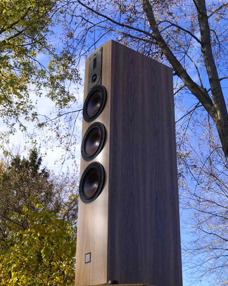

The front baffle has some curvature on it to help make the speakers look less boxy, and it works. The drivers are installed on some mounts that slightly project them out from the front baffle. The tweeters are installed on an black aluminum plate. The outriggers and feet are small and don’t contribute much to the appearance. An included grille does hide the drivers, and it uses an interesting multi-colored fabric that has a furniture aesthetic. Overall, the RUBIKORE 8s look nice, but I don’t think the walnut finish looks $12k/pair nice. They look a bit too plain for that cost, at least for myself but that is entirely a matter of personal taste. Some people will prefer the walnut finish, but I think the other finishes hit those luxury notes better.

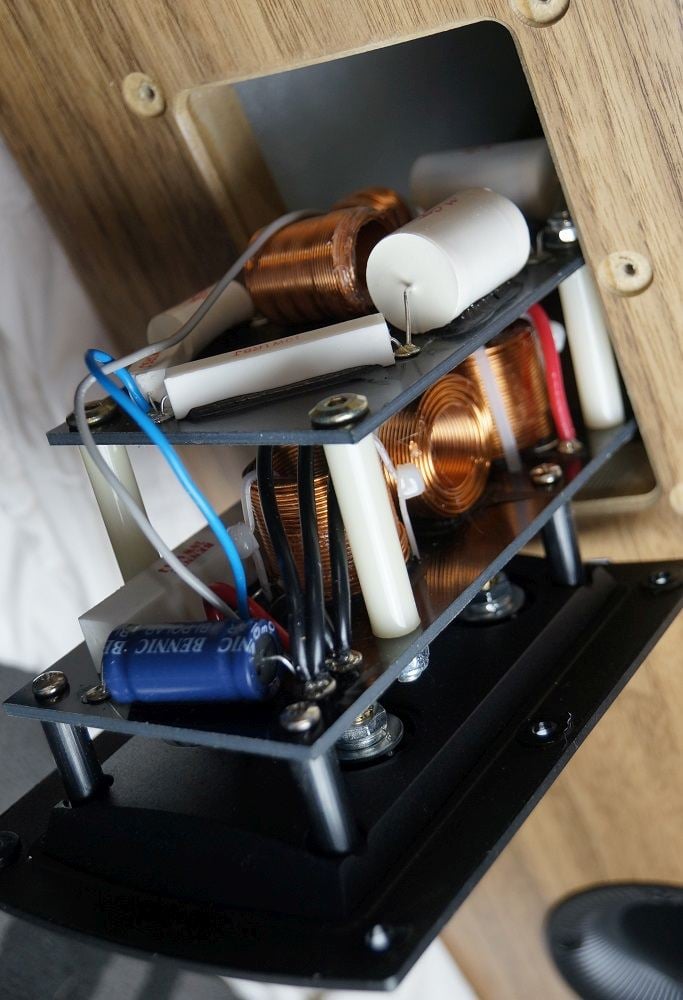

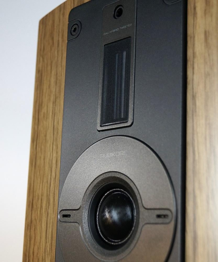

The tweeters use a two-way system with the crossover between them occurring at 14kHz with the upper tweeter functioning as a super tweeter. It’s a complicated crossover network, and what it does is more closely emulate a point source sound emanation by placing more focus on the drivers that have the greatest bandwidth. That would be the lower tweeter and upper midrange driver, and the speaker’s reference axis, or its intended point source location, would be somewhere between those two components.
Let’s
now talk about the drivers themselves, and we will start by taking it from the
top with the tweeters. The vast majority of loudspeakers only have one tweeter
to reproduce treble, but the RUBIKORE 8s have two, a 1 1/8” dome tweeter and a
planar tweeter. The dome tweeter is given the majority of the bandwidth, and
plays from 2.4kHz to 14kHz. DALI touts this dome’s lack of ferrofluid in the
magnetic gap of the motor. Many tweeters use ferrofluid to help cool the coil
as well as center the former. However, ferrofluid can damp the motion of the
moving assembly since it is immersed in a liquid instead of free air. Removing
ferrofluid allows freer motion of the dome, and it can also prolong the life of
the speaker since ferrofluid can dry out as the years go by thereby altering
the tweeter’s intended performance.
That dome tweeter’s bandwidth sort of leaves the planar tweeter to act as a super tweeter I say “sort of” as its function is more than just to supplement the highest frequencies. The planar tweeter is also there to compensate for the dome tweeter’s narrowing of dispersion at higher frequencies. Most dome tweeters begin to ‘beam’ or restrict the angle of projected sound at higher frequencies, so at the low end of their bandwidth they project sound at a wide angle, but as frequencies rise, that angle narrows, so that at the very top of their bandwidth, the sound is really only coming out directly in front of the tweeter and nowhere else. Other tweeter designs such as ribbons, planars, and AMTs, can avoid this behavior, largely by virtue of the dimensions of their diaphragms. DALI is aiming for a broad dispersion from the bottom to the top of the loudspeaker’s bandwidth, but that can’t be done with a dome tweeter alone, so DALI uses a planar to radiate widely where the dome starts to contract its acoustic radiation.
Readers might ask, why not just use a planar tweeter for the entirety of the treble bandwidth? It would surely simplify the design. The problem is that many light and wide radiating tweeters like planars and ribbons don’t have a lot of dynamic range at the lower end of their bandwidth. Domes can be much more powerful and robust and are able to displace a lot more air. Air displacement demands increase dramatically to maintain the same SPL as frequencies fall; Given the same SPL, the transducer’s demand for air displacement quadruples for every octave it's trying to play lower. So DALI is trying to get the best of both worlds here: wide dynamic range and wide dispersion in high frequencies. Readers can learn more about this ‘Hybrid Tweeter’ system from DALI’s tech page: Hybrid Tweeter - A DALI Trademark.

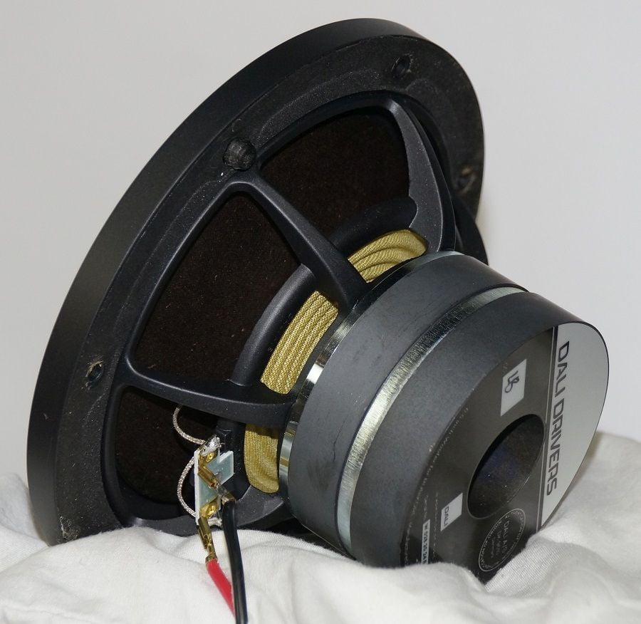

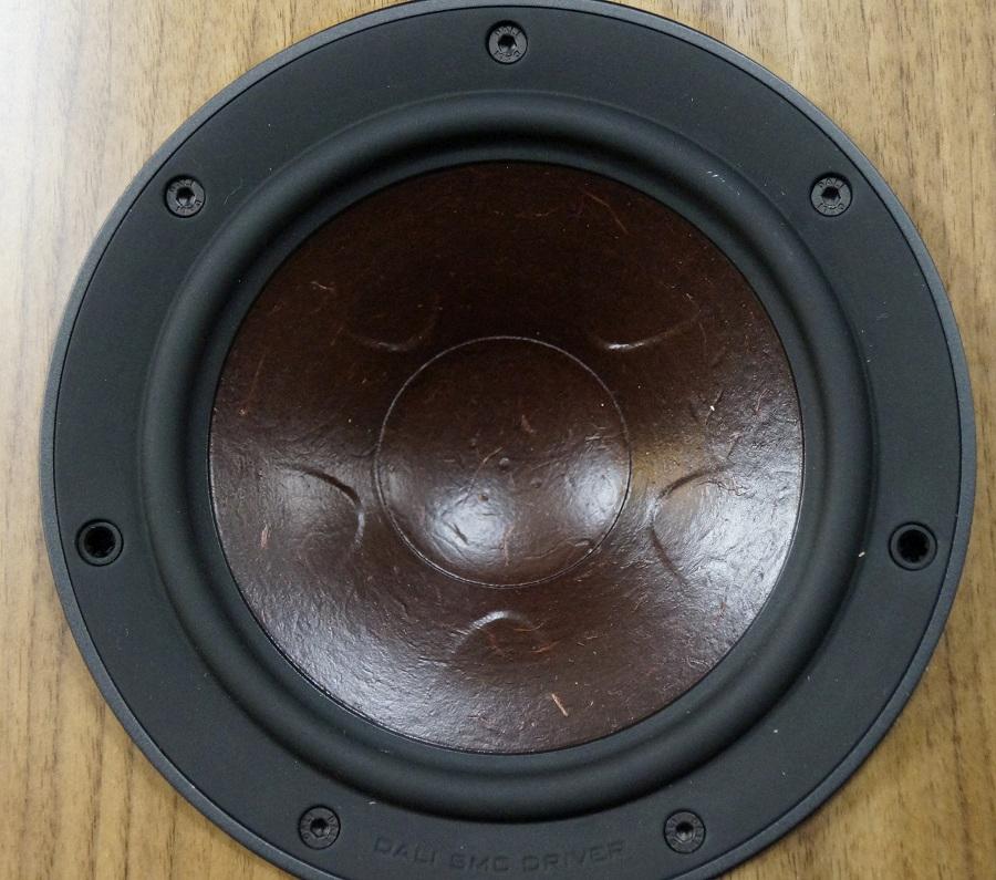

Moving on to the woofers, the RUBIKORE 8s use three 6.5” woofers using a cone that DALI calls the ‘Clarity Cone.’ The ‘Clarity Cone’ is a composite of paper and wood fiber that has been formed into a very particular shape and then treated with a unique lacquer. The paper/wood fiber material offers a good stiffness while still being light-weight. The embossed shape helps to stave off ‘break-up’ effects- cone deformation at high frequencies which can cause major response problems- by adding structural reinforcement in areas prone to bending modes where the cone would naturally begin to bend at high frequencies. This allows the driver to play at a higher bandwidth which reduces the need for steeper crossover filter slopes and thus less phase distortion.
The cones are mounted to a cast-aluminum basket by way of a very light rubber surround and a progressive spider. The suspension system is designed to maintain a linear throw without inhibiting motion until the moving assembly hits very high excursion levels. DALI prides themselves on a ‘low loss’ design philosophy, so the surround should offer very little resistance at nominal operational ranges.
The motor uses two big magnetic discs, but one disc functions as a bucking magnet which has reversed polarity of the primary magnet and refocuses the magnetic field toward the gap instead of becoming lost by straying out behind the motor. This helps to elevate sensitivity and thus increases the dynamic range of the drivers.
The motor structure uses DALI’s SMC magnet system. In areas around the voice coil within the motor, namely the pole piece and top plate near the magnetic gap, DALI uses a material called SMC or ‘Soft Magnetic Compound.’ What SMC does is transmit the magnetic field without being electrically conductive. Typically, iron would be used in these areas, but while iron is good at carrying a magnetic field, it also has some electrical conductivity which can degrade the linearity of the driver. The advantage of using SMC in these areas is a major reduction in eddy currents and hysteresis and thus reduction in odd-order harmonic distortion and an increase in upper-frequency sensitivity. For those who want the gory details about SMC use in drivers, DALI's tech page describes it: PATENTED SOFT MAGNETIC COMPOSITE (SMC), but the reader can also refer to the patent for a more precise description: Patent US9036859B2 Electromagnetic Drive Unit.
The
enclosure is a stout affair but not overbuilt. Panels are all ¾” MDF. The
enclosure is divided by a solid brace between the upper woofer and the two
lower woofers, and there are three cross braces stiffening the sidewalls. There
is a gob of acoustic stuffing for internal damping. I have certainly seen more
brawny cabinets at this price point, but I have to question how much good all
of that extra mass does after a certain point. I think that DALI gets the job
done for a non-resonant enclosure but doesn’t go overboard just to have mass
for the sake of feeling heavy. Some people might be disappointed by this, but
it doesn’t bother me.

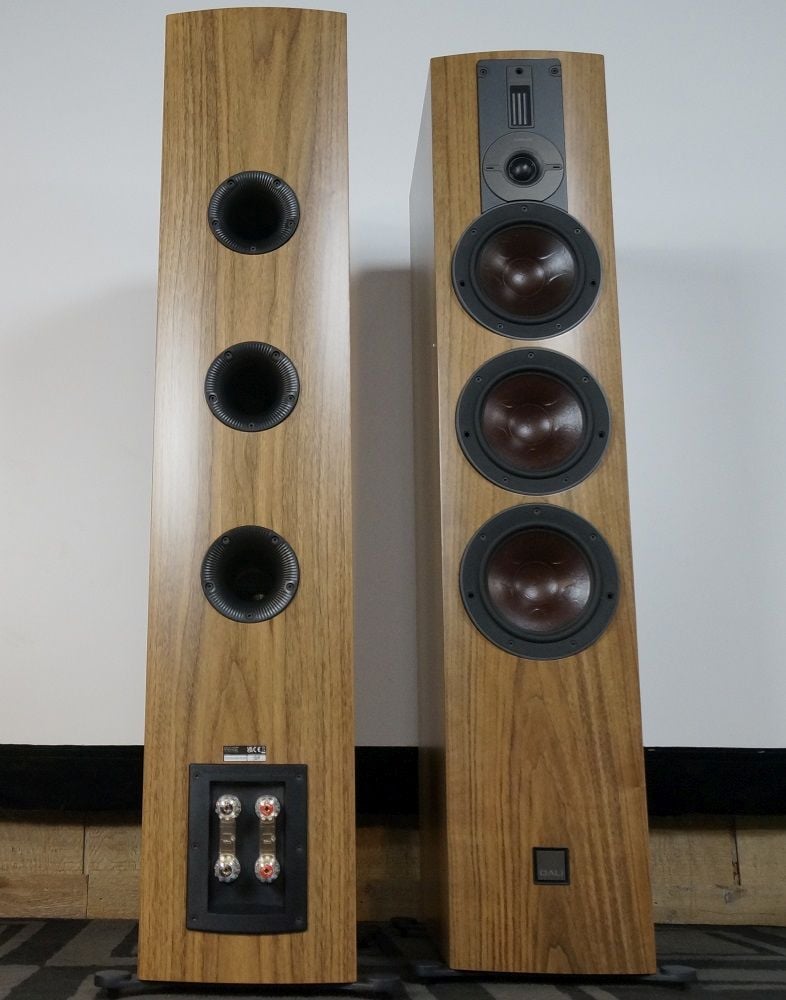

There are three ports that are mounted right behind each woofer. DALI positions them there because they say that there will be the lowest latency and most efficient transfer of energy from being at close proximity, but I have to question this claim as ports interact with the air pressure from the entire internal compartment and not just directly with the backwave pressure from the driver itself. The ports use DALI’s ‘Continuous Flare Port’ design. Instead of just a straight port with flared ends, the RUBIKORE speakers use continuously flared ports for their entire length. Research from JBL and Bose has shown that shaping the entire port instead of just flaring the ends can help to minimize port turbulence, so this design should allow higher output levels from the port than typical port designs.

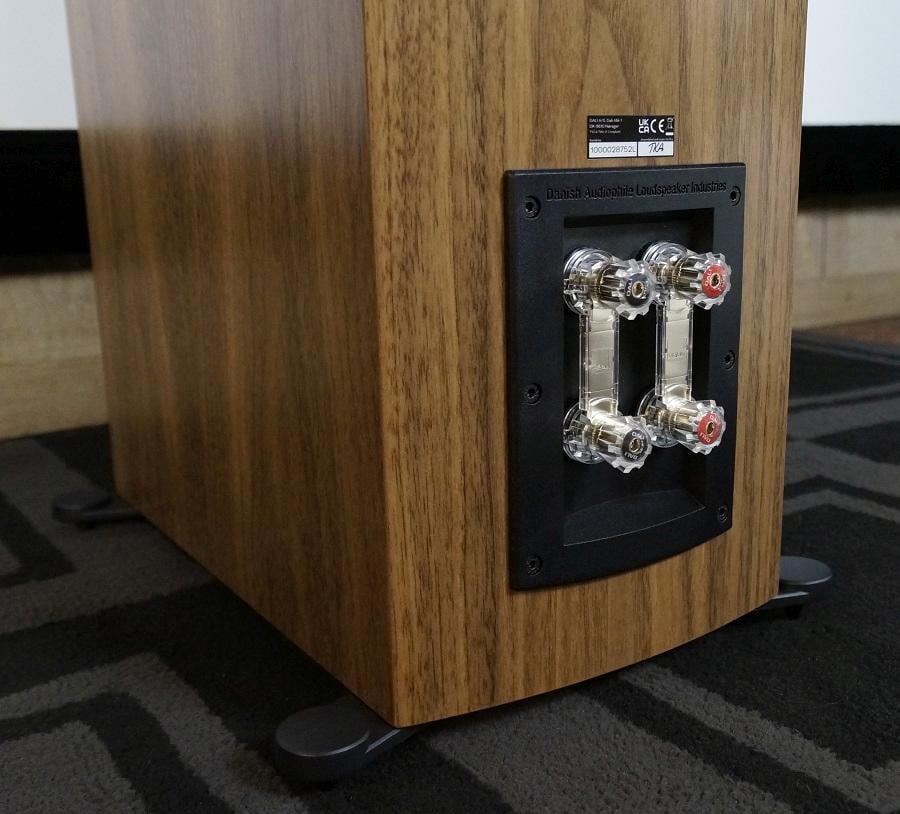

The RUBIKORE 8 speakers use a pair of five-way binding posts mounted in a plastic terminal cup. The posts are gold-plated at contact points, and are covered with plastic to protect against corrosion elsewhere. These binding posts can accept spades and banana plugs easily, but it was a little tricky to connect them with bare wires. The crossover circuit is mounted to the back of the terminal cup and uses a whole throng of components over two boards. The physical complexity of the circuit is not surprising given the design. DALI actually uses their SMC technology in inductors that would normally use iron cores. Their SMC technology fills in for iron, and it has advantages over air-core inductors as well. Compared to air core, SMC core inductors have lower DC resistance, shorter signal paths, and less vulnerability to cross-talk. Compared to iron core, SMC core inductors have significantly lowered current distortion. DALI also uses high-grade Mundorf film capacitors for tighter tolerances.
The RUBIKORE 8 can be bi-wired or bi-amped. I don’t think these speakers could handle so much power or have such a stringent impedance load where either bi-amping or bi-wiring would make sense. The people who are buying a $12k/pair speaker set will also be able to afford an amplifier that can sufficiently power them with no problems. I know it’s ticking off a standard feature checkmark for high-end speakers, but it’s a feature that often creates more problems than can lead to useful solutions. Just keep the jumpers in place and amplify these speakers with a single competent amplifier.
The RUBIKORE 8s rest on the floor on some spiked feet that are mounted on outriggers. It gives the speakers a good footing on the floor, but the outriggers and feet are pretty rudimentary for a set that DALI touts as ‘premium.’ These aren’t bad outriggers, but I feel that in this instance DALI should have included a nicer feet set at this price
The design as a whole is rather intricate, much more so than one would catch at a glance. It promises wide dispersion and wide dynamic range and its emphasis on point source emission should lead to good imaging. Let’s now see how much of that plays out in some actual listening…

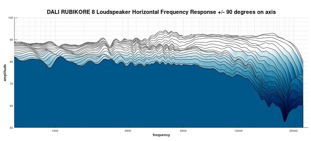

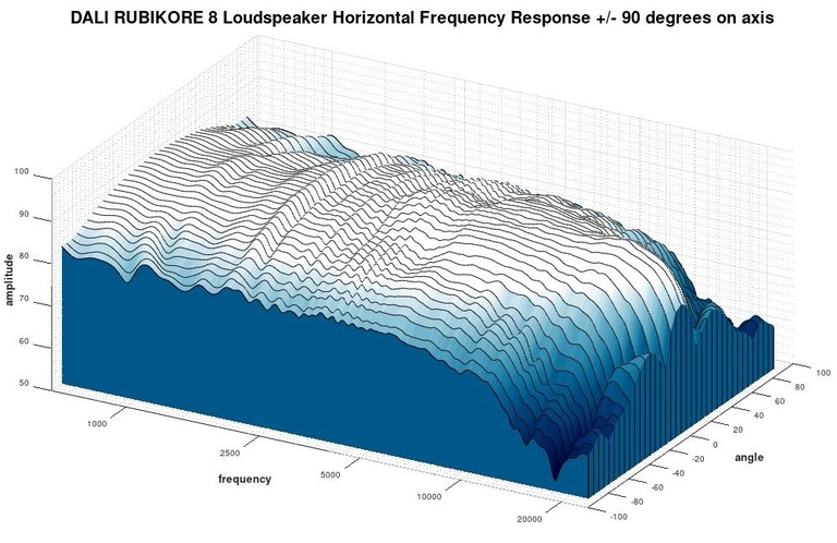

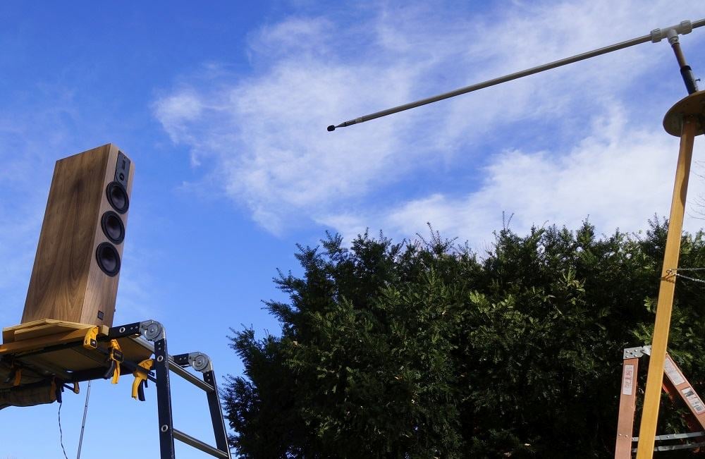

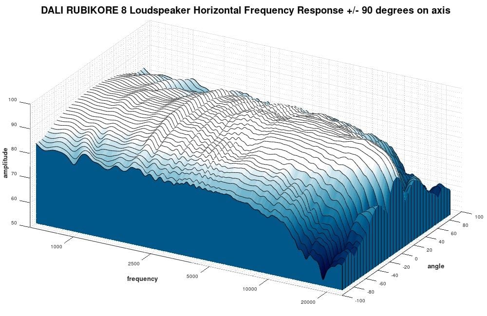

The DALI RUBIKORE 8 Tower was measured in free-air at a height of 4 feet at a 2-meter distance from the microphone, with the microphone raised to an 8’ elevation that was level with and aimed at the tweeter center. The measurements were gated at 8 milliseconds. In this time window, some resolution is lost below 400 Hz, and accuracy is completely lost below 200 Hz. Measurements have been smoothed at a 1/24 octave resolution.

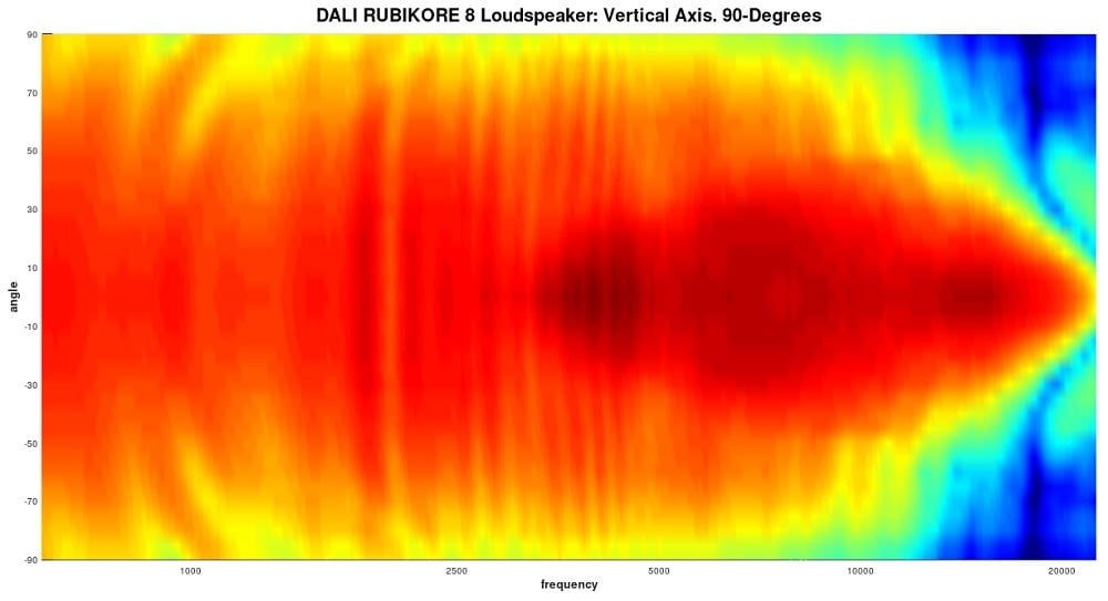

The above graphs depict the DALI RUBIKORE 8’s direct-axis and horizontal dispersion out to a 90-degree angle in five-degree increments. Information on how to interpret these graphs can be read in this article: Understanding Loudspeaker Review Measurements Part II. The reference axis used for measuring was on the dome tweeter. I would say the most noteworthy aspect of this measurement is how the tweeter’s bandwidth changes when moving to an off-axis position. On-axis, we can see that the tweeter’s level is somewhat elevated with respect to the rest of the bandwidth, but it falls fairly precipitously around 20 degrees off-axis or so. If you listened to these speakers on-axis -that is to say have them facing directly at you- you would be met with a more forward and treble-heavy presentation, but if you face these speakers straight ahead in parallel vectors while seated between them, you would be listening at a much more neutral presentation. DALI stresses not to toe-in the RUBIKORE speakers, and this must be why, but those who want a hotter and more detailed sound could toe these speakers inward to acquire that. Aside from the discrepancy in treble levels from on to off-axis angles, there isn’t a lot else to discuss except to say that the midrange is pretty neutral and well-controlled.
Some people might consider such changes in tonality based on angle to be a flaw and think that loudspeakers should retain the same character at all angles to be the ideal, but I think there is room for both approaches. Both can yield a great sound. The drawback to the approach taken by the RUBIKORE speakers is that users have to know and understand the nature of the speakers to use them optimally. Some audiophiles might blithely assume that the intended axis is the on-axis response and set them up accordingly and then feel that they have too aggressive of a sound. However, if they take the time to look at the user manual or read reviews like this one, they will know better.
The above polar map shows the same information as the preceding graphs but depicts it in a way that can offer new insight regarding these speakers’ behavior. Instead of using individual raised lines to illustrate amplitude, polar maps use color to portray amplitude, and this allows the use of a purely angle/frequency axis perspective. The advantage of these graphs is they can let us see broader trends of the speaker’s dispersion behavior more easily. More information about interpreting this graph can be read in this article: Understanding Loudspeaker Measurements Part II.
In this graph, We do get another look at the hotter treble on-axis in the dark red patches. Again, move off by about 20-degrees and it mellows out. Something else we see here is how the dome tweeter narrows dispersion as it moves up in bandwidth, hence DALI’s decision to add a planar tweeter to sustain a wider projection of sound in the upper treble. It kind of does, but I decided not to use the dome tweeter and not the planar tweeter as a reference axis for measuring for two reasons. Firstly, the planar is mounted a bit high, and I think it is slightly above where most people will be listening. Secondly, it doesn’t widen dispersion by a whole lot and mostly only brings up the treble level a bit more. Nonetheless, the RUBIKORE 8 maintains a wide dispersion out to a fairly high frequency, about 10kHz as seen here, before it narrows. The dispersion is pretty consistent out to 80-degrees, so I would characterize this as a very wide dispersion loudspeaker, and I think this is what helps it have such an expansive and enveloping soundstage.

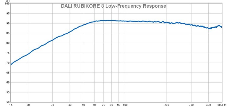

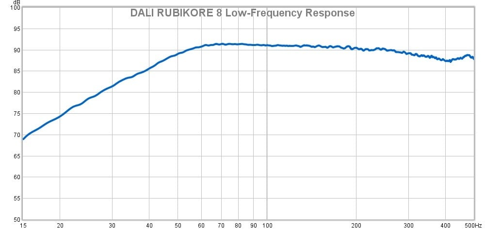

The above graph shows the DALI RUBIKORE 8’s low-frequency response captured using ground plane measurements (where the speaker and microphone are on the ground at a 2-meter distance in a wide-open area). In this graph, we can see that the RUBIKORE 8s have a nicely flat response down to 60Hz after which there is a gradual roll-off. Many tower speakers have this kind of roll-off since a totally flat response down to port tuning tends to boost the bass in most normal home acoustic situations. This is very typical, and there isn’t anything to complain about here. In my room, which does not get much low-end gain, I still had a strong response until just below 30Hz from the RUBIKORE 8s.

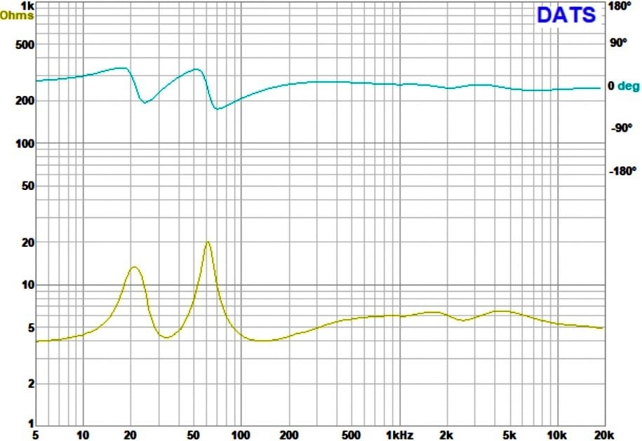

The above graph shows the electrical behavior of the RUBIKORE 8s. DALI specs them as 4 ohm nominal loudspeakers, and that is what our measurements show. This is not a particularly hard load, and the impedance does not even dip below 4 ohms. One interesting thing to note is how stable the impedance and phase is in the tweeter’s bandwidth. One would expect a more wooly response given DALI’s hybrid tweeter system, but instead it stays within a pretty narrow range of impedance. User’s will not need a super-amp to run these speakers; any competently designed amplifier will be fine with them. Something else to note is the tuning point of the ports which can be seen as the bottom of the saddle dip in the low frequencies, and looks to be just above 30Hz. It’s a deep enough tuning frequency for the vast majority of music material, but for those who want powerful near-infrasonic bass, it would be worth adding a deeply-tuned subwoofer.
I measured the sensitivity to be 89.8dB at 2.83v for 1 meter. This is very close to DALI’s own specification of 90.5dB under the same circumstances. That is about what one would expect for a tower speaker of this size and design which usually range from 88dB to 90dB sensitive. That makes the RUBIKORE 8s a fairly sensitive loudspeaker, and they will not need a monster amp to get loud.
