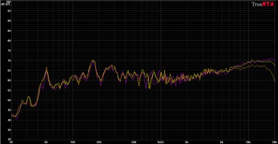

For measurements, I used TrueRTA with a Behringer ECM8000 mic and an M-Audio Fast Track Pro external soundcard. For amplification I used a Sherbourn 2/75B amp. This setup gives me a lot of flexibility as to where and when I can do measurement. To start with I placed the speakers in my Ready Acoustics treated AV Rant podcast room. This room is small but extremely dead with 19, four inch thick panels lining the walls and ceiling and straddling all the corners. While the room isn't exactly an anechoic chamber, it is a heck of a lot deader than most people would ever experience and almost every wife on the planet allow in their home. To start with I measured the speakers 1 meter on axis.

Boston Acoustics RS 334 One Meter On Axis 1/24th Octave
(note - not a 1 watt measurement)
I measured the Boston Acoutics RS 334s at one meter between the tweeter and the top woofer. As you can clearly see the RS 334s are generally pretty linear from 100Hz up to 6kHz where there is a general trend up. This is pretty common in speakers there the high end is a bit accentuated. Consumers, especially those in retail settings, are listening to numerous speakers and will tend to prefer those with a hotter high end. This is not an extreme change though at only about 5dB over the average of the rest of the response.

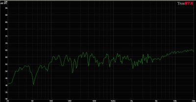

rs334_meas_half
Boston Acoustics RS 334 1/2 Meter, 1/24th Octave
Purple - On Axis, Yellow - 15 Degrees off, Orange - 30 Degrees Off
This graph gives us a little more information. As is often the case, off axis response takes a toll most on the high end response. This allows the end user to "tune" the speaker by adjusting the toe in. With the RS 334, the on axis response has the most high end energy with a light reduction at 15 degrees off and a more dramatic one at 30 degrees. For those looking for the flattest possible response, you're going to want to sit off axis from the speaker. There also seems to be a bit of a dip in the response in the midrange/upper bass. This was not as visible in the one meter measurement so will not be an issue.
