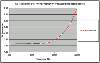

All cable lengths measured were 20 feet and divided by their length for a normalized per foot measurement. At low frequencies the results illustrate Rs being lower than Rdc, which is inaccurate, as Rs tends towards Rdc as frequency approaches zero or DC. The LCR measurement derives Rs from signal phase and amplitude, while a DC meter measures exactly what it is looking for, thus this discrepancy is likely due to a meter resolution issue, as the meter in AC mode does not sport the high accuracy it would in DC mode. The cable should ideally be modeled as multiple parallel resistors, and those resistors treated as a lumped element in series with an ideal inductor.
Each resistor is a frequency dependent element, and the inner ones fall out as the frequency increases. It is important to note the difference in measuring techniques, and caution the reader not to attempt to derive any relationships with the two numbers, as the absolute accuracy between the methods has not been established. However, the rising trend of Rs vs frequency is indicative of increased Rac due to skin effect and should also be noted.

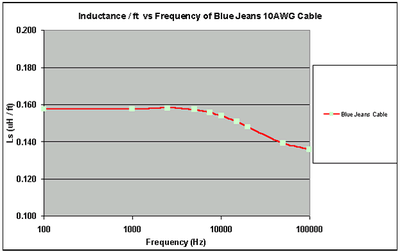

Inductance was about what I expected - around 0.160uH/ft. We like to see cable inductance below .200uH/ft to minimize high frequency rolloff for long cable runs. This cable is well within our guidelines. The slight decrease in cable inductance above 20kHz is a result of minimized internal inductance due to skin effect. This is an inaudible and barely measurable phenomenon and is only discussed herein for academic purposes.

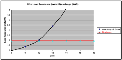

The DC resistance of the 5T00UP measure just a tad under 2mohms/ft which is 10AWG equivalent at DC as specified by Blue Jeans Cable. This is an extremely low resistance speaker cable making it ideal for long runs throughout the home with minimized losses.
We see a slight rising AC resistance with frequency above 20kHz attributed to skin effect, but practically speaking a non-issue for the application of high fidelity audio especially since even at 50kHz it maintains an equivalent 14AWG resistance.

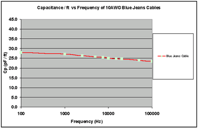

Capacitance was about what I suspected, ringing in at 25pF/ft. We like to see cables measure under 50pF/ft. This ensures there won't be any stability issues for long runs on marginally stable amplifiers with high unity gain crossing, or excessive high frequency roll off on amplifiers with high output impedances driving a reactive loudspeaker load. The reason for the slight decrease in capacitance with increasing frequency is likely attributed to measurement error of measuring a distributed device (speaker cable) with a measurement tool (Magnetics Analyzer) designed to measure lumped elements (magnetics, electrical circuits, etc).
