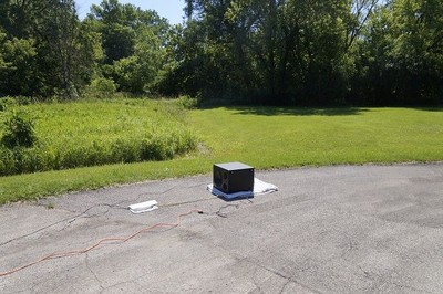

The Hsu Research VTF-1 mk3 was tested using ground plane measurements with microphone at a 2 meter distance in an open setting with well over 100 feet from the nearest large structure. The sub was tested with woofer and port side facing the microphone. The subwoofer’s gain was set to maximum, phase was set to 0, and the low pass filter was left off. Weather was recorded at 70°F and 43% humidity.

The above graphs show the frequency responses of the VTF-1 mk3 in various configurations. In its vented configurations, we can see the VTF-1 does sport a nicely flat response. Of course, the single ported mode does have a more extended response that is flat out to 30 Hz as opposed to both ports open which is flat down to 40 Hz. Our measured responses do not quite meet the stated window of responses by Hsu Research, but it is close. It is so close that the difference could easily be due to slightly different measurement methods. One feature to note is the extended high frequency response; this is a subwoofer that could feasibly be used with a crossover point as high as 300 Hz if the user wanted. While that is not practical in the vast majority of setups, it certainly doesn’t hurt anything and might be fun to experiment with for those who are curious.
