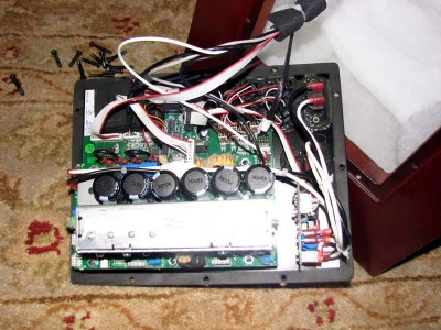

Inside the box, we see some big differences between the original DD-15 and DD-15+ subs.  The DD-15 has no internal bracing baffles whereas the DD-15+ has a clearly implemented baffle brace that is also bolted to the heavy driver for further reinforcement.  A quick knuckle tap on both cabinets reveals the DD-15+ produces a solid thud while the DD-15 has a more hollow or resonant sound character.  This alone in my opinion is a marked improvement that I am glad to see in a product of this caliber.
DD-15+ Amp
Velodyne DD-15+ Amplifier
The Velodyne DD-15+ boasts a digitally controlled class D amplifier section (up to 95% claimed efficiency at full load) that is said to deliver 1250 watts rms power and 3000 watts dynamic power (same as the original DD-15).  The amplifier, which is separated into two sections, occupies the entire back plate. One board is dedicated to the power supply supporting the transformer and main fuses. The second tiered board supports the preamp functions and six power supply capacitors. There is a small heat sink to the side of the capacitors while the majority of the circuitry lives under a grilled metal housing to reduce radiated RFI noise inherent in high frequency switching amp designs. Based on the power consumption rating of 12 amperes listed on the back of the unit at the standard 120 volts we get a power rating of P = 0.95(12A * 120V) = 1368 watts which exceeds the 1250 watt power rating that with a slo-blow fuse leaves little to suspect the rated power of the amplifier.

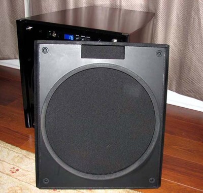

DD-15 Grille
Velodyne DD-15+ Grille Cover (notice no flimsy plastic here)

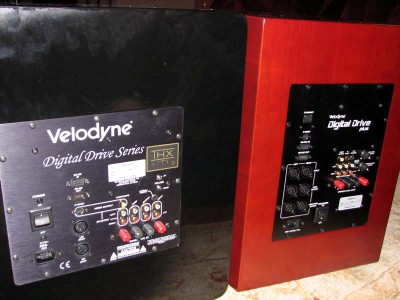

The build quality of the Velodyne DD+ series of subs is obviously raised considerably compared to their predecessors, not only in driver mechanics and cabinetry, but in the actual grille cover, too.  I don't think I've ever encountered a sturdier or heavier grille cover on a subwoofer before.  The grille is actually constructed of 1" thick MDF (no flimsy plastic) and finished and stained satin black with cloth wrapped on the outside which looks and feels great.  It looks very clean installed on the sub since it recesses into the front baffle for a nice flush look.  Velodyne knows the driver in these subs have a lot of stroke and require not only a rigid cabinet but a grille cover as well.  You don't typically get this type of build quality in less costly subwoofers - which, in my mind, helps partly justify its rather hefty price tag.

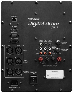

DD15 & DD15+ backviews
Backpanel view of DD-15 (left pic) & DD-15+(right pic)
What is most interesting is the original DD-15 and DD-18 subs were THX Ultra2 certified.  The new DD+ replacements no longer carry the THX logo or certification.  This is an obvious cost cutting savings for a company that can undoubtedly pass THX spec without the sheet of paper by now.  As indicated in our measurements, the DD-15+ walks all over the DD-15 and you don't need a THX stamp of approval to acknowledge it.  We've noticed a trend with numerous manufacturers that THX certify their first generation of new products but not the successor products.  This allows the manufacturers to offer a next generation product that exceeds the performance of the original while keeping the retail price the same (or sometimes less) by not expending margin for the THX stamp of approval.
DD+ Amp plate
Velodyne DD-15+ Backpanel View
Like the DD-15, the DD-15+ has one of the most comprehensive connection panels we've ever seen on a subwoofer.  The DD-15+ takes it up a few notches with the inclusion of all balanced connectors (nice touch) and an Ethernet connection for firmware updates.  The only connections missing are speaker level outputs, but I can't imagine anyone buying a sub of this caliber would be hooking it up speaker level and using the bass management of the sub for their satellite speakers no less.
DD15+ no grille
Velodyne DD-15+ Frontpanel View (with grille removed)
The front of the DD15+ is where the microphone and USB connections are made to run auto setup and self-EQ options. There are also a volume and crossover potentiometers adjustable in 1dB and 1Hz increments, respectively.  Velodyne claims the volume adjustments are actually .4 to .5dB incremental depending on the actual output level setting.  Gone is the backlit Velodyne logo that illuminated anytime a DD series sub was powered up.  I really missed this feature and wish Velodyne would have at least incorporated some indication when the DD+ sub goes active other than simply listening for it (although it's hard to miss).  This is especially handy in situations where users are employing multiple subs in their theater room and want to give a quick spot-check around the room to ensure all of the subs are powered on before playing a demo to a first-time listener.  There is an option via the remote called "light" which turns the front panel display on, indicating volume level, but it stays on all the time rather than just when the sub is active with a signal present.  Perhaps they will consider changing this in a future firmware update.

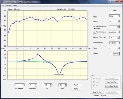

PC Interface
Velodyne DD+ PC Interface Software Display
 While this new interface software is cool, Velodyne really missed the boat by not incorporating a higher resolution display output to actually produce usable measurements (something we've been requesting for many years now).  Once again we are limited to virtually useless 1/3 octave smoothed graphs.  While these graphs look impressive by giving bragging rights to fellow DD+ owners on the forums, they do little to actually show you what's going on in the room.   Velodyne acknowledges this tool is meant to assist setup and not serve as a measurement device, but my argument is, why not go all the way and provide better ability for installers and more tech savvy consumers?
The blue curve below in my LMS plot is the actual in-room response measured after the DD+ software ran auto-EQ for just one DD-15+.  As you can see this looks much different than the extremely smoothed and prettier curve above generated by Velodyne.
EQ Measurements
In-Room EQ Results for DD-15+
Red - no EQ, Blue - auto-EQ, Green - self-EQ
I wasn't able to produce beneficial results using Velodyne's auto-EQ system.  I attempted to run it twice and both times it did NOT adjust EQ settings, just level, phase and crossover settings seemed to be affected.  Self-EQ actually came closer to giving a better "after" result by taming a room mode in the 20-30Hz range.
I found the manual EQ to be the best option for my setup and proceeded accordingly for integrating both DD-15+ subs into my reference system.

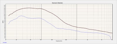

Using my antiquated, yet accurate, LMS measurement system, I took a DD-15 and DD-15+ outdoors to run some 1 meter groundplane measurements to discover the true performance differences between these subs.  My objective was to validate Velodyne's claim that the DD+ series of subs have a 4-5 dB output advantage over their respective replacement models throughout the entire bandwidth the sub would be used (20Hz to 80Hz).
DD-15 Sweeps
Velodyne DD-15 SPL vs Frequency (1 meter groundplane)
DD-15+ Sweeps
Velodyne DD-15+ SPL vs Frequency (1 meter groundplane)
DD-15 Max Compare
Velodyne DD-15 vs DD-15+ Max SPL vs Frequency Comparison (1 meter groundplane)
Both subs were set at their factory settings with a subsonic filter of 16Hz, 24dB/oct slope with the LPF disabled.  Changing this subsonic frequency and slope settings does affect the extension of the sub which explains why higher output #'s could be achieved through other 3rd party measurement results under the same measurement test conditions.
DD15+ HPF Settings
Velodyne DD-15+ In-Room Nearfield Measurement of HPF Settings
Green: 24dB/Oct, 16Hz; Yellow: 18dB/Oct, 16Hz; Red: 12dB/Oct, 16Hz; Blue: 6dB/Oct, 16Hz

As you can see, below 70Hz, the new DD-15+ walks all over the original DD-15 with up to 7dB output advantage at 20Hz.  This most definitely exceeds Velodyne's claim of 4-5dB more output across the board.  In fact, the DD15+ has about a 3dB output advantage at 20Hz to the original DD-18 we reviewed a few years back.  The DD-15+ does, however, rolloff more sharply above 70Hz, which was a bit disappointing. We like to see subs flat to at least 80Hz to ensure a more seamless blend with smaller satellite speakers.  The original DD-15 and DD-18 subs, for example, are ruler flat out to 100Hz.   We can only suspect that the added voice coil inductance of the new DD+ driver is acting like a Low Pass Filter (LPF) making the DD-15+ -3dB down at 80Hz compared to its 40-50Hz output levels.
Editorial Note about Continuous Sweep testing vs CEA Burst Testing
Our sweep tests were conducted at a constant input level across the entire bandwidth whereas CEA burst tests are typically conducted at discrete frequencies (ie. 20Hz, 25Hz, …etc) by varying input voltage until max SPL per a fixed distortion limit is achieved at each test frequency.  Our tests reveal max SPL where the subwoofers begin to compress but there is typically more output left above the compression point of each subwoofer if the subwoofer under test is not amplifier limited. For more info on this, read our 2010 Subwoofer Shootout Measurements Overview article.
The compressor circuit implemented by Velodyne worked flawlessly just like we've found on all prior Velodyne products we've reviewed in the past.  In fact, one could argue that their circuit works too well in that it’s a bit too conservatively implemented sacrificing some output to ensure no audible distortion or distress of the system.  You simply cannot overdrive this sub or hear any mechanical noise emanate from the box or the driver at any given time.
That being said, if one wants a very close approximation to max output of this sub per CEA burst testing method, you can simply add 3dB to all of my sweep measurements above as follows:
