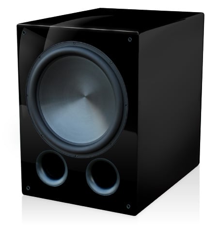

Rythmik FV15HP Subwoofer Introduction
The Rythmik FV15HP is a self-powered front-loaded vented
subwoofer featuring a custom 15" Aluminum-cone driver and 600 watt
amplifier that utilizes a very unique servo-feedback system
for minimizing loudspeaker distortions, even at very high output levels (where
of course it is MOST important, since that is where subwoofers are quickest to
reveal their failings). Weighing in at
120lbs and standing two feet tall, this sub is an imposing presence, and when
excited will let you know in no uncertain terms it is in the room. Keep it away from glass or china or neighbors
prone to calling the police if they think the side of the building was just hit
by a truck. This sub goes from being
completely silent to massively loud in a few milliseconds. Priced at $1199, it's not a lightweight, and
requires more than a little bit of real estate.
From
its high output capabilities, true 20Hz extension, and ability to play clean
and distortion free, the Rythmik FV15HP is an impressive addition to any
high-performance, high end system, at a truly economical price. Read on for set-up recommendations and to see
how the Rythmik measured up in our exhaustive test suites to get a better
understanding of its superb output capabilities.

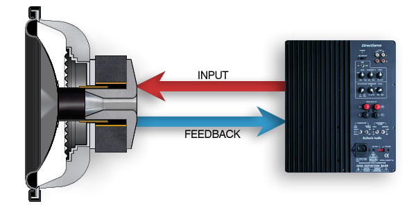

The root-cause of thermal
compression (the real-time loss of speaker efficiency resulting from high power
applied to the voice coil) is that high power creates high temperatures causing
the VC resistance to increase, which causes it to draw less power from the
amplifier. In Rythmik's DirectServo
subwoofers, the feedback is sent from the sensor output, not the amplifier
output. As a result, when voice coil
resistance increases, the servo will cause the power amplifier to increase
output until its senses the output reaches the desired level. (What it would be
without thermal compression).

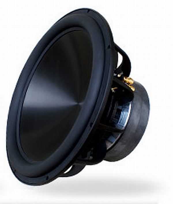

The Driver (Subwoofer)
For use in the home, a 15” driver
is about as big as anyone is going to need, unless of course they are truly
unsatisfied till they can see the walls moving and shaking. A 15” driver has about 56% more surface area than
a single 12” speaker. Bottom line is for
the same excursion, you are moving more air with less motion, and for a
subwoofer more motion usually equates with more distortion. (This all assumes
of course, you have some clue as to how to design a good subwoofer driver and motor,
and don't end up putting the wrong VC or magnet or steel together). If the
designer is able to thermally couple the VC former (bobbin around which the
wire is wound which couples the VC rigidly to the cone) to that large aluminum
cone, then he is able to get a great deal of heat-sinking out of it. Since all
that surface area exposed to the air in the room is going to tend to keep the
temperature of a thermally conductive former (read aluminum, not Kapton) which
is bonded to this cone LOW, it will, therefore also keep the VC wire cool. This boils down to being able to handle more
power. More power into the VC
with less heating equals more power out.
(Ka-Boom!) Now with a 600 watt
amp, one should not really be able to burn up a 3 inch diameter voice coil,
because your peaks will be limited to about 1200 watts, and your RMS power is
likely not going to be any higher than about 300 watts. (That leaves you only
6db of dynamic range, which is really no where near enough for an accurate
subwoofer performance.) For a 15”
speaker, 300 watts or less should be easy.
Except but for the fact that many things can and do go wrong. I have one customer who is using a “600 watt”
18' speaker with a 4” diameter VC in a box with a 320 watt amp, and they
routinely see the speakers being returned by DJ's who have burned out the
VC. In short, it can and does happen
that things go horribly wrong. While it
is the job of the amplifier to send a clean signal to the speaker, if the user
is demanding more than the system can provide, something has to fail. That is where compressors, filters, and in
the case of the Rythmik, sensors come to the rescue. In this instance, Rythmik really did their
homework as we found this sub to be unbreakable in our torture tests.

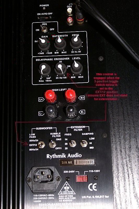

I had a number of usage problems with the
Rythmik H600PEQ amplifier which left me feeling less than satisfied
with the design of the product. First of
all, the markings on the amp are confusing, and much better information is
required to make it clear how the low pass filtering works. Take a close look at the amplifier to see
what I mean. While the switch above the AC power cord input is marked “EXT/12”
there is nothing external about it. This
switch simply disconnects one of two 12db/octave low pass filters in series
with the signal, and is still connected to the bottom center knob which is used
to vary the frequency of the variable 12db/octave filter. With the switch (bottom left) pointed at “80
Hz/24”, you don't get 80 Hz/24db per octave unless you make sure that knob
(bottom row center) is rotated to 80 Hz as well. I found this both confusing and frustrating,
as the nomenclature (white silkscreen on the amplifier panel) was in my
opinion, less than clear on this point.
While it is a beautiful thing to know that Rythmik is a small enough
company that when you call them, you can get the boss on the phone to explain
it to you, I suspect few of us using this amp for the first time would figure
out the meaning of its markings without making that phone call. If you've another filter to use instead of
the filter built into the amp; or better yet, in addition to it, I would use
it. In theory, having one second order
(12db/octave) filter to vary is a good way to fine tune the transition band of
the crossover region (that range of frequencies where BOTH the subwoofer and
the mid-high speakers have outputs which are significant and add together), it
would sure help to know what the designer had in mind before you start using
the product. Read the literature twice, then
call them anyways if you can't properly setup the subwoofer to your
satisfaction.

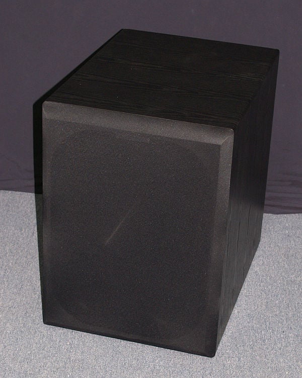

Visual Impressions

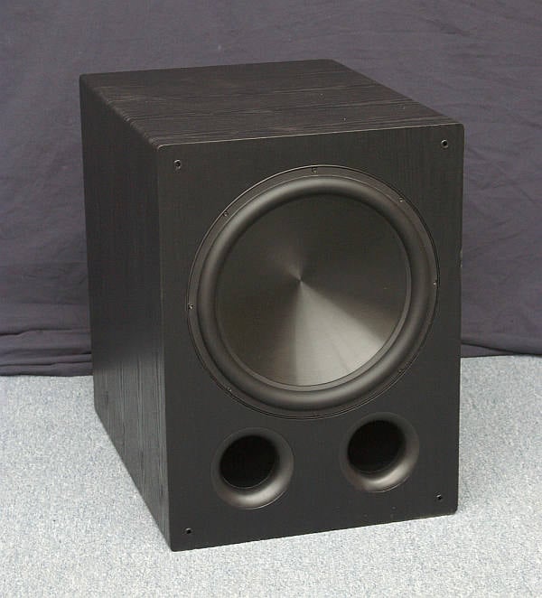

The finish of the
Rythmik is essentially a utilitarian black vinyl covering, the
likes of which you have seen many times, and have come to expect when shopping
for bargains in the speaker department.
It is so nondescript, no one would object to its presence or find it
particularly appealing or annoying. When
I placed it outside for ground plane testing, I found it was actually making
bubbles in the vinyl. I do recognize this is not an outdoor product and
by doing this, I exposed this black sub (remember black absorbs heat) to over 2
hours of direct sunlight which caused the PVC to become very hot. When I took
it out of direct sunlight, and put it back indoors, All of the bubbles went
away completely on their own!. It was
almost like it had a sunburn, and after coming out of the sunlight, everything
went back to normal. Easy fix! Rythmik has claimed to have both replicated
the problem, and found a solution. So
this finish issue dies with my review sample but the consumer is still advised
to NOT use this product outdoors since like all of the other subs we've tested,
it is not weatherproof.

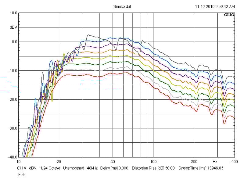

Rythmik FV15HP Subwoofer Measurements and Analysis
The first part of testing was to measure the frequency response from a modest output, all the way to the point where the system was clearly compressing and had hit the output wall, so to speak.
Rythmik FV15HP Subwoofer Frequency Response at Various Output Levels
The Rythmik sub was unique in one way during the compression testing vs frequency. As you can see from the curve above, at the highest output level (the gray curve, as this sweep, 14 seconds long from 400 Hz to 10 Hz) triggered the sensor or compressor about the time we hit 80 Hz. As the signal continued to sweep lower, in a very short period of time, the compression released, allowing the signal to peak again right at about 60 Hz, and then before it got down to 50 Hz, the compressor becomes active again. This happens AGAIN at about 32 Hz, and as you can see as the sweep runs lower, the compressor releases and then returns several times in quick succession. Now it could be argued that music does not have any sweeping tones that range across more than a decade (400 to 40 Hz is one decade) and last 14 seconds in length. They would be quite correct. However, I cannot help but relate this to instances where I was listening to music and the output seemed to suddenly jump out as if the volume control was being rotated without any help from my fingers. I would suggest that the use of a longer hold time or integration time be considered based not so much on the signal sweep test shown above, but on my own sense that the sub seemed to go from too quiet, to just too loud all on its own frequently during its operation.
As we can clearly see from the curves above, frequency response is NOT independent of level, and if the system is pushed hard enough, it will roll off below 30 Hz, yet at lower power outputs, is certainly flat down to 20 Hz. (Red curve) at the bottom.
Editorial Note about the Limiter Feature of the FV15HP Subwoofer
The limiter in FV15HP is defeatable. However, I had chosen to test the subwoofer with limiter ON. The curves with limiter off should be smoother and without this short hold time issue I noted. As for this hold time duration issue, it is a design trade-off. Shorter hold time can recover fast and provides more output over the same period of time. On the other hand, my preference is to have longer hold time duration as I stated above. I tested the H600PEQ amplifier with my review unit which engaged the limiter with the power switch set to "auto". Since that time, the amp has been updated to the H600PEQ2 model with a discrete on/off switch for the limiter.

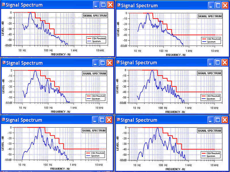

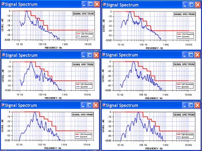

CEA-2010 Test Results
On to the CEA 2010 testing. To understand the meaning behind the graphics below and testing methods used, please refer to the prior article (Subwoofer Shootout Measurements Overview) on this method. The process is a simple one. Drive the input to the system to the point where either the amp, its compressor, or its speaker simply refuses to give you more output, or the distortion created at that output level exceeds the CEA “redline”. In EVERY system tested, the result (if not the peak SPL) was similar in one regard. At the highest frequencies in the sub's bandwidth, we ran out of amplifier power, or the compressor refused to put out more power than the amp could cleanly deliver. At the lowest frequencies, the subwoofer runs out of excursion. This is completely normal and what is to be expected. It may also explain why the CEA standard does not bother testing higher than the center frequency of 63 Hz. Below is a spectrum capture of the Rythmik FV15HP system at maximum usable output from 20 to 63 Hz in 1/3rd octave steps.
Rythmik
FV-15HP CEA-2010 Distortion Test Results
Rythmik FV-15HP | CEA Test Performance | |
Frequency | Maximum Peak SPL @ 1 Meter | RMS SPL @ 2 Meters |
20 Hz | 116.5 dB | 107.5 dB |
25 Hz | 122.0 dB | 113 dB |
32 Hz | 126.8 dB | 117.8 dB |

Max SPL Output Data of the Rythmik FV15HP Subwoofer (1 meter groundplane)
Update: 3/08/12
In order to make it easier for our readers to compare our CEA data between subwoofers tested prior to our new Subwoofer Measurement Protocol, we scaled our 1 meter peak CEA data to 2 meter RMS by subtracting 9dB for each frequency. We also corrected our 1 meter data to peak by adding +3db from our first review which more closely matches the test data collected by Josh Ricci on the same review sample.
Discussion of Measurements
What is noteworthy about this sub, is that the second order distortion components at the three lowest test frequencies, are extremely low. Usually, 2nd order distortion components are those which are the most prevalent, and arguably the least objectionable. Removing them creates the largest measurable reduction in THD (in almost all circumstances) yet second order is the least objectionable of all the harmonics, hence the CEA tolerance of it is in excess of the tolerance for any other components. (Music is, mostly harmonics after all.) Second order distortion at 20, 25 and 32 Hz were so low in fact that with the normal 1/12th octave smoothing, the second harmonic is no where to be found in the spectrum curves. It appears that this is where the servo-feedback excels and Rythmik's claims of low distortion are validated.
The differences in outputs between 40, 50 and 63 Hz should be considered so small as to be negligible. Any decrease from one frequency to the other is likely caused by a small amount of VC heating, such that if I had tested from higher to lower frequency, these three numbers would likely have been reversed. In fact, the repeatability of these numbers should be considered no greater than within 1db. While I am listing them to three significant figures, we need to remember that precision is not accuracy, and that any other speaker within a db of these numbers is likely to be close enough that we will not be able to reliably or consistently hear a difference.
