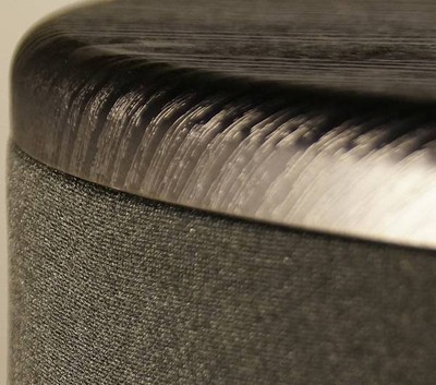

Appearance
The atypical shape of cylinder subs is not one which everyone will find to their liking. However, SVS has tried to make it as palatable as possible by covering the sub with an attractive black fabric and giving it a black oak veneered top. The top is also available in a black gloss finish for an extra $50. The aesthetic strategy seems to be to make the PC-2000 as innocuous as possible, since that black fabric is like a light silk. In fact, it was difficult to get a picture of the PC-2000 that gave it more detail than just a black shape. Personally, I was not bothered by the appearance of the PC-2000, but in a brightly-lit room with a more traditional décor, I could see how it could clash. On the other hand, it might fit nicely in a more modern interior. In a dimly-lit corner, the PC-2000 should disappear rather well, and its light-absorbent covering would make it a great choice for rooms with projection screens, where light-reflective objects can reduce contrast in the picture. Its small footprint makes it easy to tuck away in a corner, and, if one needed to increase its spousal-approval-factor, maybe a plant could be set on top of the sub (so long as it is only the plant that gets watered and not the subwoofer).
One minor note is the power status light on the PC-2000 is quite bright, so while the subwoofer generally tries to be inconspicuous, that light, especially if facing the listener, is difficult to ignore (although it is not intended to face the listener). There is certainly no question whether the sub is standby mode or not. In a dedicated home theater room with a projector-lit screen, the status light could definitely interfere with the picture if facing the screen. The light can be easily blocked by construction paper or electrical tape, so it is not a big deal. As long as the user is willing to do something like that, the PC-2000 is still an ideal choice for rooms where light-control is a concern.

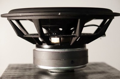

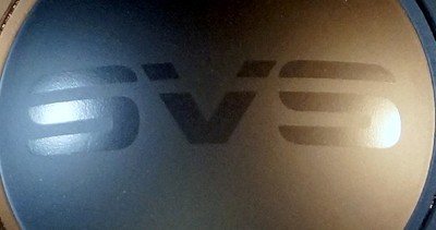

SVS PC-2000 12" Subwoofer Driver
The SVS PC-2000
driver is based on the Tymphany Peerless XXLS platform, which has long been
renowned for its very low inductance and high linearity. The XXLS (which stands
for Xpanded Xtra Long Stroke) is a pricey driver to buy on its own, and the one
used in the PC-2000 is customized for SVS’ application. Ed Mullen, SVS’s
Director of Technology, said that they went through 17 iterations of the driver
for reasons of performance, durability, and reliability before all criteria and
design goals were met. Let’s go over a few of the driver’s features: a sturdy
cast aluminum basket holds the cone and motor sections together. Two ¾” stacked
magnets provide the voice coil a powerful magnetic field. Venting is done
through the voice coil former just under the cone through a series of holes. An
aluminum cone provides a stiff but light exterior and likely greater durability
than conventional paper cones. Dual shorting rings are used to short out
induced current created by the motion of the charged voice coil within the motor.
A Nomex spider provides stiffness against horizontal motion while allowing
smooth vertical motion and should be able to retain its shape even after a long
time and heavy use. Everything taken together, the PC2000 driver looks to be a
finely-engineered work with an emphasis on linearity and durability.

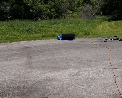

Outdoor ground plane testing of the SVS PC-2000
The PC-2000 was tested using ground plane measurements with microphone at a 2 meter distance in an open setting with well over 100 feet from the nearest large structure. The sub was tested on its side with woofer facing the mic; keep in mind that the orientation of the sub with respect to the microphone will always affect measurement results. The subwoofer’s volume knob was set to maximum, and its low-pass filter was switched off.

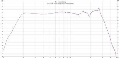

SVS PC-2000 Frequency Response
The frequency response is impressively flat, as usually is the case on SVS subwoofers. The PC2000 could easily be used in a system with a crossover as high as 200 Hz, if need be. The tuning point looks to be around 17 Hz. Our frequency response measurement is very close to SVS’s claim of +/- 3dB from 16 Hz to 260 Hz. Were the sub measured in an orientation with port and woofer equidistant from microphone or port facing microphone, the measurement would likely have fallen well within SVS’s claimed window of response. But near-ruler flat from 20 Hz to 170 Hz is nothing to sneeze at. This is a very linear subwoofer.

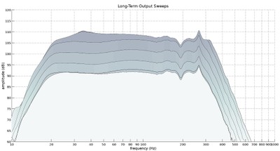

SVS PC2000 Long-Term Output Compression
Testing for long-term output compression was done by first conducting a sweep tone where 50 Hz hit 90 dB, and then we conduct further sweeps by raising the gain by 5 dB until no more output could be squeezed out of the subwoofer. We then went back and measured a sweep with the 90 dB at 50 Hz gain level again to see how the recent strain of such a rigorous exercise affected the frequency response. We can see the PC2000 keeps its base frequency response intact at all but the highest sweep. While a slight bump emerges at 35 Hz at the highest output level—the absolute most output the PC-2000 can give—it still retains a fairly flat response. This is very good compression behavior, and a tribute to the digital limiting of the Sledge amplifier. We see a slight drop in the final post-stress 50 Hz/ 90 dB sweep compared to the first 50 Hz/ 90 dB sweep, and this is due to the lower resistance in the driver’s voice coil as a result of the lingering heat from the maximum output sweeps, but such a small difference would scarcely be audible. Some chuffing was present in the very deep frequencies in the highest output sweeps, but the PC-2000’s port kept turbulence in check for the most part. The frequencies where the chuffing occurred were mostly below the tuning point, where it is not a good idea to throttle any ported sub. The advantage of having chuffing kept in check until nearing the sub’s performance limits is it lets you know when more sub is needed without damaging the sub itself. Chuffing itself does not damage the subwoofer, but running the sub at its limits for long durations can.

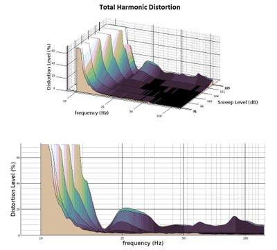

SVS PC-2000 Total Harmonic Distortion levels for output levels as percentages
The total harmonic distortion measurements in the above graphs correspond to the long-term compression sweeps; they are the harmonic distortion measured during those sweeps. The distortion is presented here as a percentage of the fundamental, or how much of the sound produced by the subwoofer was distortion versus intended test tone reproduction. The most obvious feature of the graph is the skyrocketing distortion below port tuning, especially at high drive levels. This is characteristic of any ported subwoofer and should not be held against the PC-2000. If you want distortion-free infrasonic frequency playback, you will want sealed subwoofers- and a lot of them! Something else to note is the bulge of distortion reaching 20% THD centered around 30 Hz in the 115 dB sweep level. 20% may seem like a lot, but that is at the subwoofer’s maximum drive level, and it very likely would not be audible during program material. However, while it isn’t likely to intrude on your enjoyment of whatever content is being played back, if you are pushing the sub that hard, it is time to get a more powerful sub or more subs. Regularly throttling the subwoofer to it limits certainly constitutes abuse, and the sub will not last under those conditions.
The real star of these distortion measurements is the very low distortion at nominal to high drive levels. At the 111 dB sweep, the PC-2000 basically stays below 10% THD to well under 20 Hz. At nominal levels for the 106 dB sweep and under, the PC-2000 is, for practical purposes, distortion-free. This is consistent with what is seen in the burst tests; the PC-2000 remains very clean, and only runs into any significant distortion at the very edge of its performance envelope.
SVS PC-2000 Component Harmonic Distortions as percentages
The above graphs break down the composition of the harmonic distortion into individual harmonics. One interesting feature is, much like the burst tests showed, that the odd-order harmonics seem to outweigh the even-order harmonics, but they are mostly only kicking in at the maximum output level, and they are respectively more prevalent than even-order products in upper bass frequencies. We can also see that the distortion below the subwoofer’s tuning frequency is comprised of all measurable harmonics. Higher-order harmonics arise as the PC-2000 attempts to reproduce deeper frequencies.

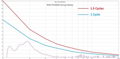

SVS PC-2000 measured group delay
Group delay is the measurement of how much time it takes for individual frequency bands of an input signal to be produced by the speaker. It can indicate that some frequency components are developing slower than others or are taking longer to decay. Group delay measurements of the PC-2000 show nothing to be concerned about. As with most other ported subs, we see some stored energy around port tuning, but it doesn’t even come close to anything audible. Generally speaking, we want group delay to be below 1.5 cycles for mid-bass frequencies, although deep bass frequencies can tolerate greater amounts of group delay before becoming audible. As with many other metrics, the PC-2000 demonstrates very good control over group delay. In conditions where overhang is heard with the PC-2000, it’s likely due to room acoustics, not to any kind of sluggishness of the subwoofer itself.

has all the performance of its box-shaped counterpart yet has a much smaller
footprint and lighter weight; in other words, all the advantages without the
disadvantages. The PC-2000’s good CEA-2010 showing nets an Audioholic’s
Bassaholic Large Room rating, signifying that it should be able to provide
satisfying bass levels in rooms of 3,000 cubic feet to 5,000 cubic feet (read
about our Bassaholics Room Size Rating System). If you can afford it, I would still go
for multiple subwoofers, regardless of room size, for the sake of smoothing out
the low-frequency response. The extra dynamic range doesn’t hurt either, and
the small footprint makes it easier to fit multiples, which is certainly an
advantage in small rooms.
