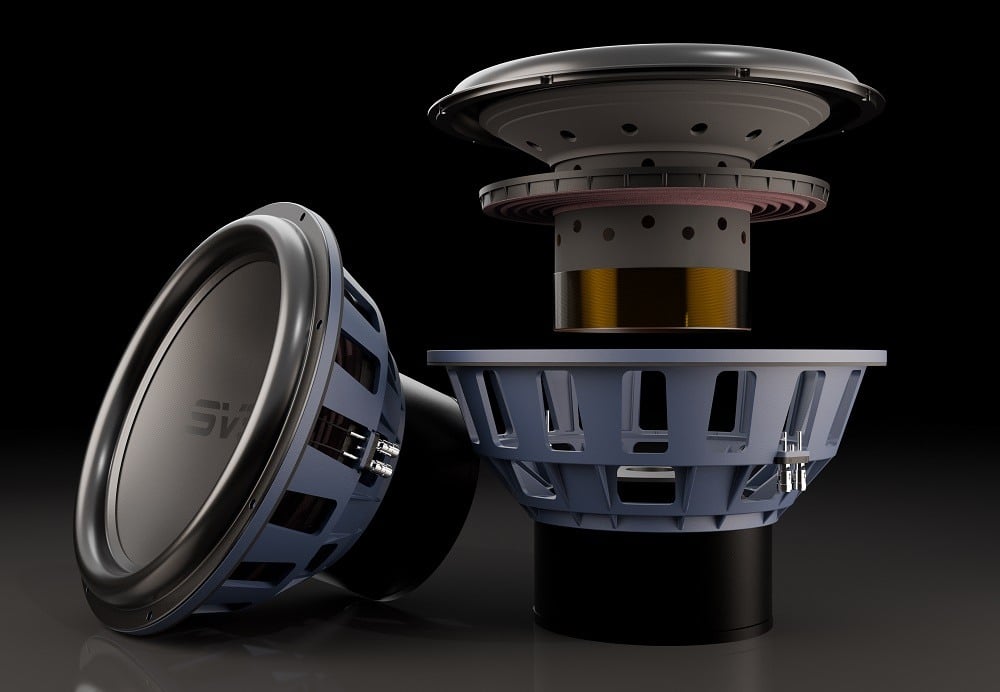

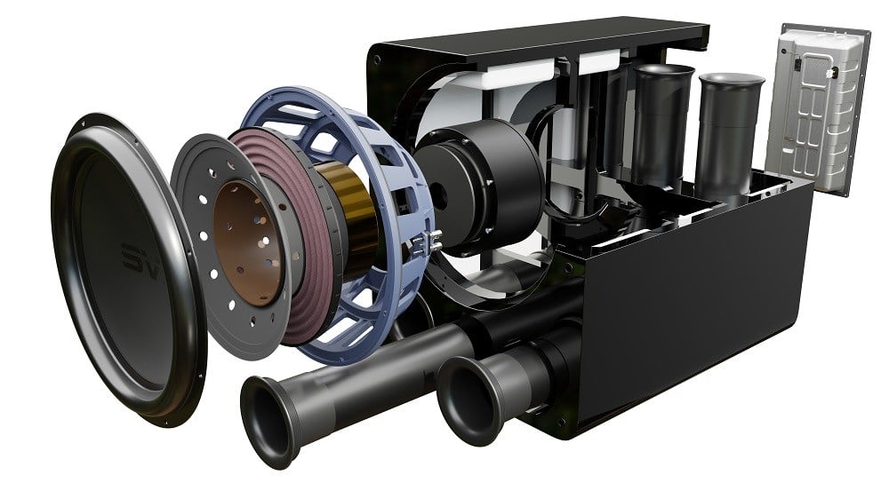

In both subs, SVS has increased the driver diameter to 17 inches, which should provide more displacement than the 16-Ultra series due to the increased cone surface area alone. The driver employs a similar motor topology from the 16-Ultras, but it now splits the single 8-inch voice coil of that model into two voice coils. Splitting a single voice coil into two can present an easier load for the amplifiers, as they would encounter less resistance, which can enhance long-term reliability. The ported model has also switched to an overhung motor design for higher sensitivity, particularly increasing output capability in the mid-bass region. SVS still uses the substantial 55-pound ferrite magnet, making the motor an absolute powerhouse. In our reviews of the SB16-Ultra and PB16-Ultra Subs, the sheer weight of this motor necessitated internal braces to support the driver, and we would expect the 17-Ultra R|Evolution series to be no different.
The processing power of the amplifier's DSP chip has increased from 50 MHz to 290 MHz, which should be more than sufficient to handle complex processing on top of the incoming signal with lightning-fast speed. This allows the 17-Ultras to now support a built-in automated room correction program. As many home theater enthusiasts know, no matter how perfect the sub’s own response is, typical room acoustics can significantly deform that response since the room’s dimensions are always smaller than the wavelengths of low frequencies. This is why equalization is more important for bass than for any other range, which was always the biggest advantage of room correction programs such as Audyssey or Dirac. It’s a valuable feature to have on the subwoofer itself, especially for systems that lack outboard automated room equalization programs, such as simpler two-channel systems or more professionally oriented production setups. SVS's room correction utilizes a smartphone app that uses the microphone on the phone itself, so no extra microphone is required. The extra processing power of the 17-Ultras also enables more bands of parametric equalization for those who want to manually shape the in-room response.
The amplification power of the 17-Ultras has been increased to 2,800 watts, up from 1,500 watts in the 16-Ultras. This is a substantial increase but may raise concerns for those worried about tripping the breaker on a typical 15-amp circuit. SVS has addressed this by enhancing system efficiency and constantly monitoring the incoming AC. As mentioned earlier, the driver now employs a dual voice coil system, which helps the amplifiers manage the impedance load more effectively. There are two amplifiers, and they utilize bridge-tied load (BTL) amplification so that both channels are powering both coils. One amplifier amplifies the positive phase signal, while the other amplifies the negative phase signal, effectively doubling the voltage compared to using just one amplifier channel. BTL amplification can theoretically achieve four times the output power compared to a traditional single-ended configuration. The amplifiers are also arranged in parallel per rail for higher output current. Power draw is constantly monitored in real-time via Power Factor Correction with an onboard line conditioner, allowing the amplifier to draw as much power as it needs without overwhelming a 15-amp circuit.
