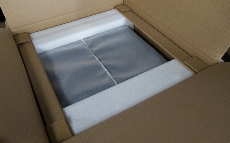

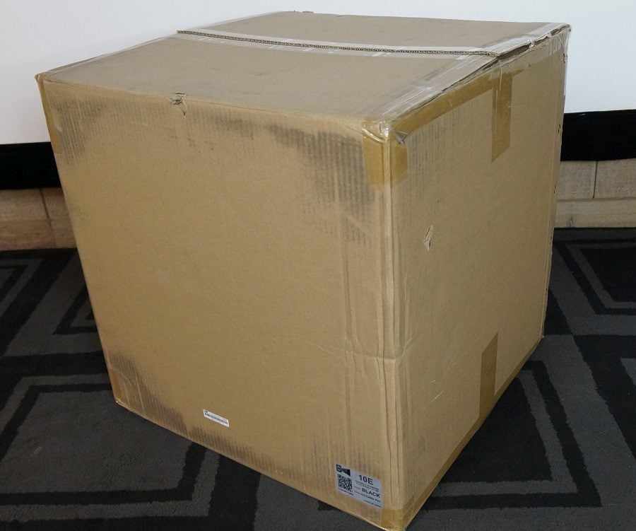

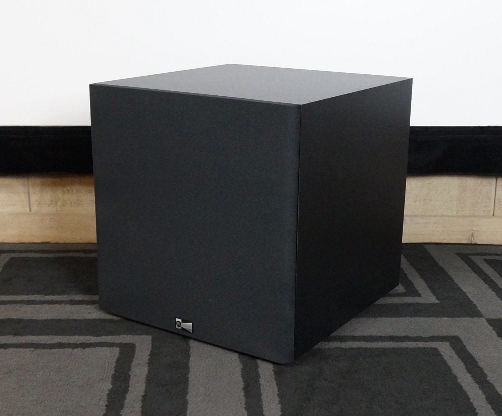

The Speedwoofer 10E arrived at my doorstep in a modestly-sized box and was surprisingly well-packed for such a low-cost sub. It was double-boxed and had edge and corner protectors inside the inner box. Four polyethylene foam blocks lined the top and bottom of the sub to protect against shocks. The sub was wrapped in a soft foam sack to protect against scuffs. The level of packing is more than sufficient to withstand the usual abuses of parcel shipping services.

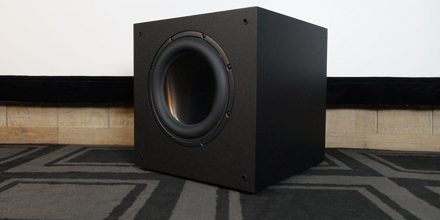

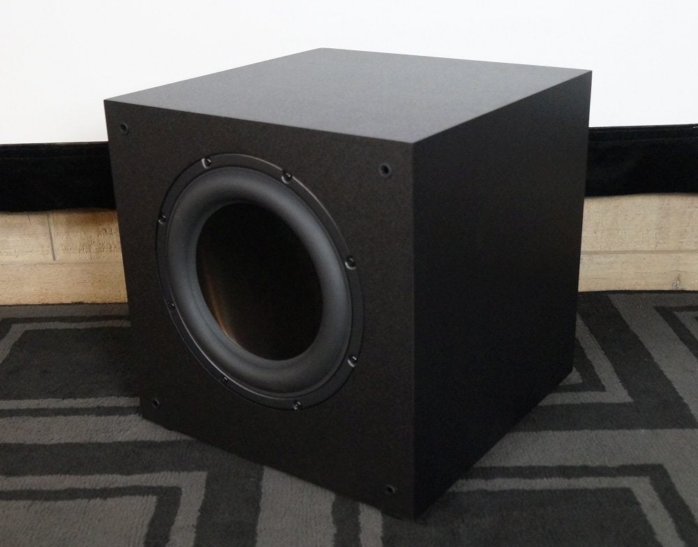

Once unpacked, the Speedwoofer 10E stands as a rather innocuous subwoofer that doesn’t draw much attention to itself. It’s not large, and it doesn’t make any stylistic flourishes that are especially notable. Without the grille, it’s just a black box with a woofer installed. The edges are not rounded unless the grille is installed since only the grille has rounded edges. The finish is a textured vinyl which is very common with budget subs and speakers. The finish is not bad-looking, and it is fairly durable and is resistant to scuffs and fingerprints. The only real visual feature is the woofer itself, the surface of which is covered by a smooth, concave black-anodized aluminum dust cap. It’s a good-looking driver and looks similar to the cones in RSL’s other subs. There isn’t much else to say about the appearance of the 10E; it is a fairly plain-looking sub, not bad but certainly not fancy, and its low cost probably prohibited RSL from making any striking stylistic moves such as curved cabinetry or higher-end finishes.
RSL Speedwoofer 10E Subwoofer Design Analysis
In the broad strokes, the Speedwoofer 10E is a lot like the 10S but with features removed and certain build aspects taken down a notch for a lower manufacturing cost. But the overall design remains the same, and RSL’s most distinct design attribute is their “Compression Guide” tuning system. This unique feature lies in the cabinet’s internal construction; the interior space is divided into three different chambers where the backwave pressure from the rear of the cone can compress and expand in a manner that reduces resonances. It seems to borrow from transmission line theory, which can get quite complex. Within the sub, there is a solid diagonal piece that stretches from the lower front of the enclosure to the upper rear, so there are two larger compartments in the enclosure. The upper rear of the sub is open so that the backwave goes over it into the lower compartment. There is an opening in the front of the lower compartment that opens up to a slot port, which extends to the back of the sub. The larger chambers divided by the diagonal piece are filled with a thick batting material for damping internal waves.
As I have said in previous reviews of RSL subs that contain this system, I couldn’t say how efficacious the Compression Guide Technology really is versus traditional ported systems, but RSL’s other subs performed well, and, if nothing else, it does add a good deal of rigidity to the sidewalls of the cabinet. The MDF enclosure is already fairly well put together for its price range, with a 1” thick front baffle and ¾” thick sidewalls and braces, as well as corner braces to reinforce the edges. The cabinet construction and sidewall rigidity imparted by this design make the 10E a much more solid sub than ANY other in its segment.

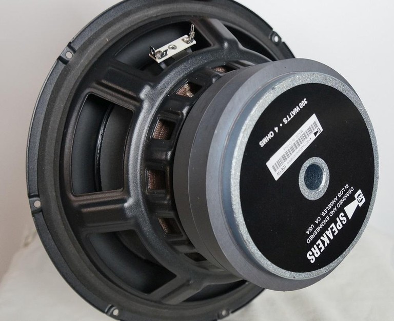

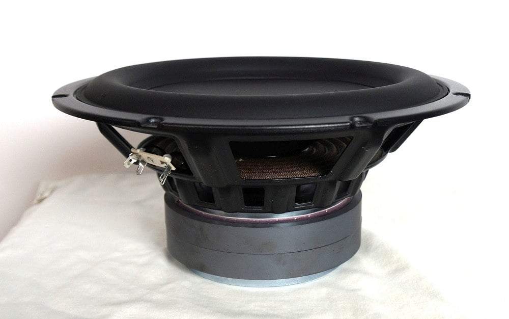

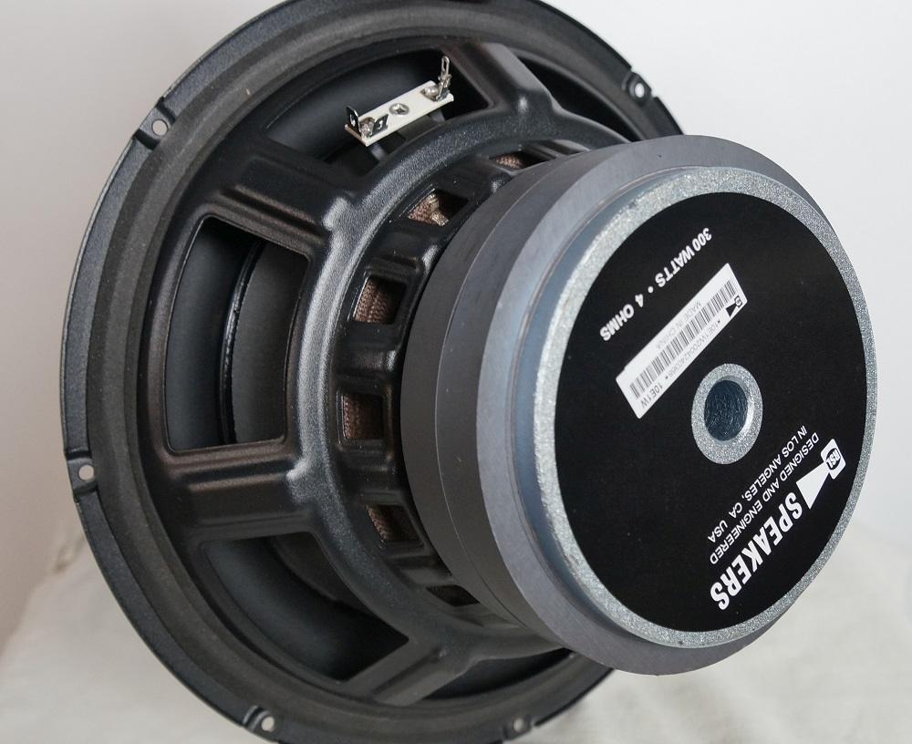

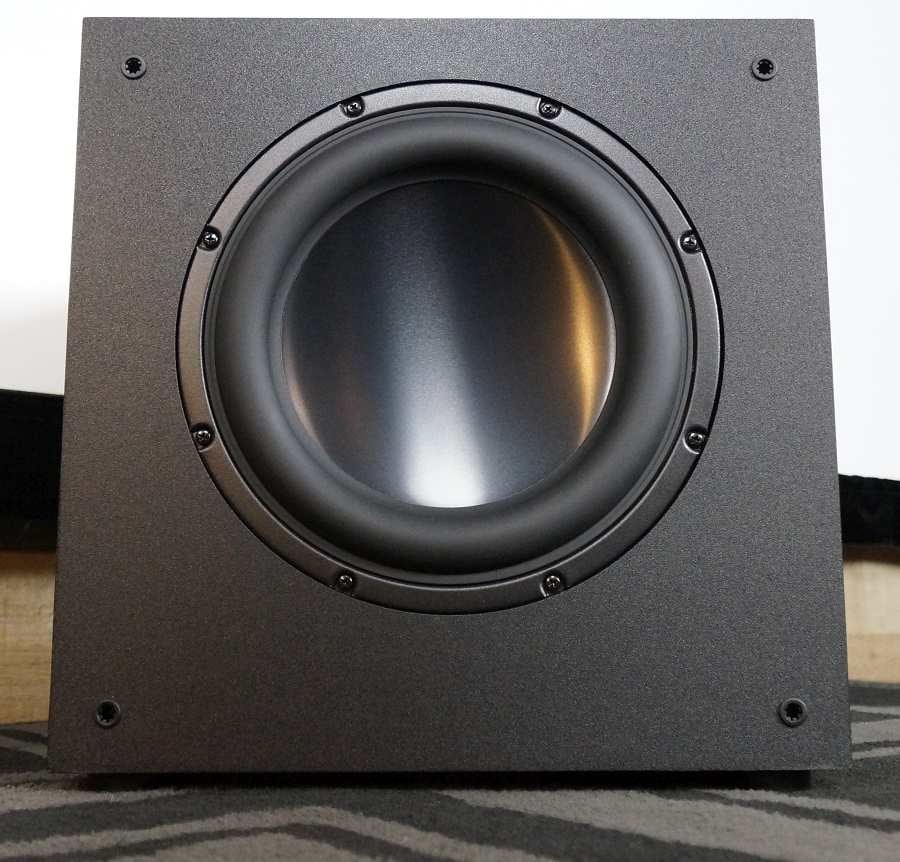

The driver looks to be above average for this segment as well. It uses a Kevlar-reinforced paper cone with an anodized aluminum dust cap. It is attached to the basket using a beefy nitrile-butyl rubber surround and a poly-blended spider. The basket uses a stamped steel frame, but the frame has lots of bumped-out ridges which add to its overall stiffness. The motor uses a double-stack of magnets which add up to a 1 5/16” thickness and a 5 ½” diameter. Venting is done under the spider as well as through the pole piece.

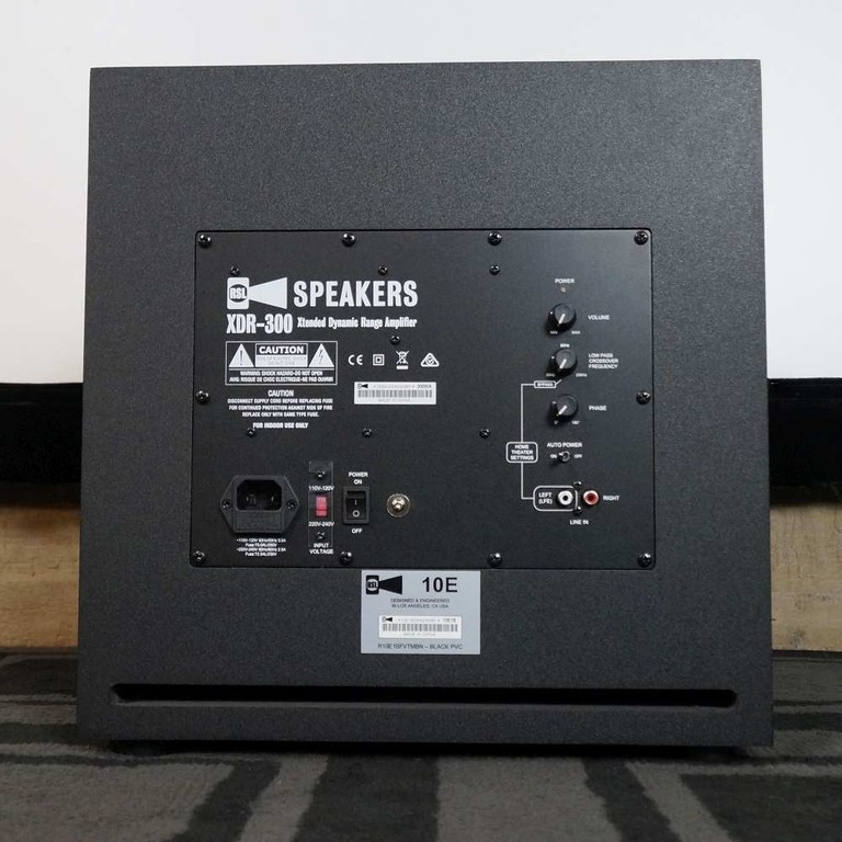

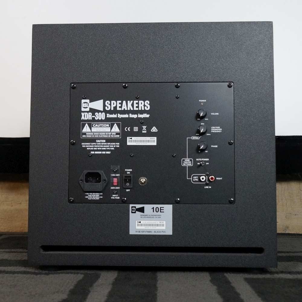

The driver is powered by a 300-watt RMS amplifier that uses a class-D design. The amp panel controls are only the bare necessities with a volume knob, a low-pass filter knob that goes from 30Hz to 200Hz and bypass, and a variable phase knob. Connectivity is limited to a left/right pair of line-level inputs. The crossover filter uses a 12dB/octave slope. There is also an auto-power switch and an on/off switch. I do think the labeling of the auto-power switch is a bit convoluted. You can set the auto-power to “on” or “off,” and I think that most people will see that and assume that “off” powers down the amp, and “on” puts it in a standby mode. However, what “off’” really does is stop it from going into a standby state. I made the mistake of flipping the auto-power switch to “off” thinking it would no longer amplify signals, and I thought something was wrong after it continued to function and produce sound. After looking closer at the labeling, I realized my mistake, but I think that a lot of other users will make the same assumptions that I did, given its labeling.
The Speedwoofer 10E feet are fairly typical cylindrical rubber pieces that should do well at damping vibrations and not scratch any hard flooring. The grille is held in place by typical rubber grille guides. With the grille on, the front vertical edges of the sub have curved corners, so it might not cut or jab anyone unfortunate enough to brush against it. Without the grille, all the edges are hard 90-degree turns. Much like RSL’s other subs, if the user has kids or pets, it would probably be best to use this unit with the grille on, not just to protect the cone but to protect against injury from anyone running into a hard edge. Its matte black finish makes it a light sink, so users should take care not to place it near any commonly used walking path, because it could be hard to see in low-light conditions, and, given its height, household occupants could bump their shins against a hard ninety-degree edge, and that would surely sting.

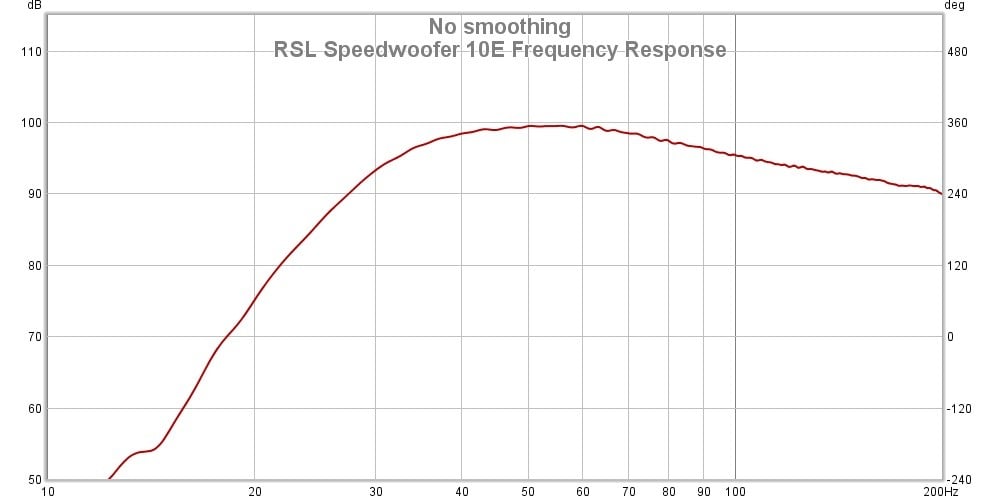

RSL Speedwoofer 10E Subwoofer Measurements

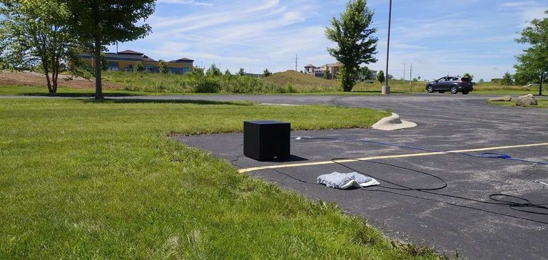

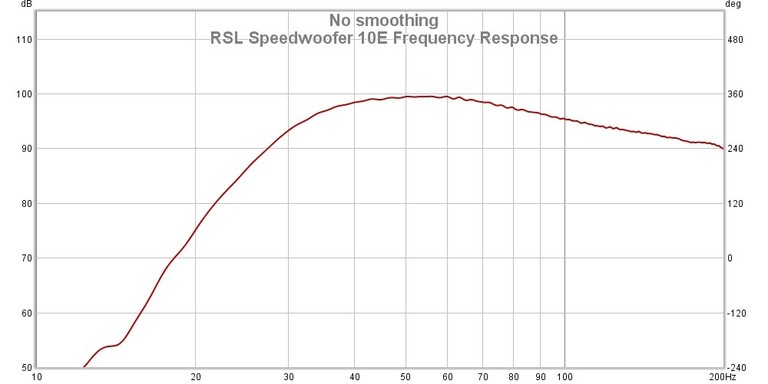

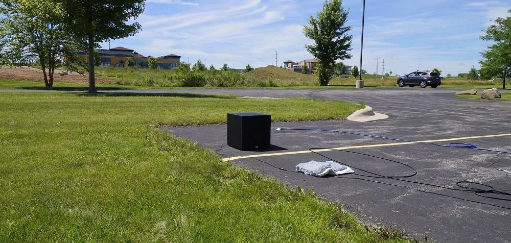

Testing on the RSL Speedwoofer 10E was conducted with the microphone facing the woofer at a 1-meter distance with measurements scaled back to a 2-meter distance by subtracting 6dB. The temperature was recorded at 60F degrees with 90% humidity. The subwoofer’s gain was set to maximum; the phase was set to zero, and the low pass filters were set to bypass.
The above graph shows the measured frequency responses for the RSL Speedwoofer 10E subwoofer. Since this measurement was taken with the microphone facing the woofer, some port-produced output may not be fully represented here, so the 10E may extend a bit deeper than what is shown, though not by a lot. That being said, with this kind of response, users can expect a solid in-room response below 30Hz, though probably not 20Hz. Nonetheless, a sub-30Hz response is very good for a sub of this size and pricing. We also get an extended high-frequency response which is nice to see. The upper end of this response allows for higher crossover frequencies, which means the 10E can be mated with smaller speakers that may not have enough low-end extension to hit the standard 80Hz crossover frequency. At its pricing, it’s not unthinkable that it could be paired with smaller budget speakers that would require a higher crossover so that there is no gap in the response. Some budget subs don’t have much high-end extension above 100Hz, but the 10E is one that can be used with smaller loudspeakers.

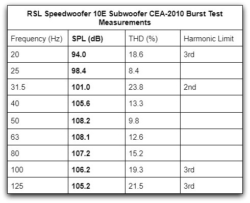

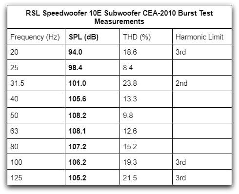

The above CEA-2010 measurements are short-term bursts that show the subwoofer’s clean peak SPL before heavy distortion sets in. Our measurements have been referenced to 2-meter RMS, which is 9dB down from the standard requirement for the measurements to be shown at 1-meter peak. However most publicly available CEA-2010 measurements are shown at 2-meter RMS, so we followed that convention.
The Speedwoofer 10E puts out some very
respectable numbers for its price class, especially for deep bass. Against much
more expensive subs, yes, it doesn’t have monster deep bass output, but against
other subs in the same price class, it is exceptional. And with 105dB+ for
everything above 40Hz, it has a decent punch for musical frequencies. In my
opinion, the 10E is making some very reasonable trade-offs with the kind of
output exhibited here. With the enclosure size they decided on, they could have
tuned it higher for more mid-bass punch but very little deep bass, or they
could have tuned it lower for lower frequency extension but a much lighter
punch in mid-bass frequencies. Instead, they went for a good compromise between
the two. This sub will have some rumble for movie effects but also a good thump
for kick drums. It achieves a nice balance for its size. This set of
measurements earn the Speedwoofer 10E our Bassaholics “Medium” Room Rating,
meaning it should be suitable for room sizes up to 3,000 cubic feet. To learn
more about Audioholics’ Bassaholics Room ratings, please look at this article: Bassaholic Subwoofer Room Size rating Protocol.

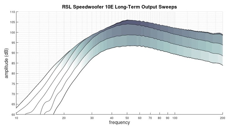

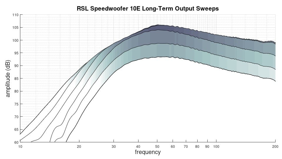

Testing for long-term output compression was done by first conducting a 20-second sweep tone where 50Hz hit 90 dB with the subwoofer 1 meter from the microphone (graph has been scaled to 2 meters for easy comparison with our other review measurements). We then conduct further 20-second sweeps by raising the gain by 5dB until no more output could be wrung out of the subwoofer. These tests show us the long-term continuous headroom that the subwoofer is capable of.
The Speedwoofer 10E does fine in this testing when its size and price are considered. It can put out a continuous 100dB at 30Hz and above. High drive level compression only shaves a bit off the low end, and the response doesn’t change that much ,even when pushed full-throttle. There is not much else to say except that, as with the basic frequency response measurement above, these measurements were taken with the woofer facing the microphone, and that does shortchange port output a bit, so there would be a bit more bass in low frequencies than what is reflected in this graph.

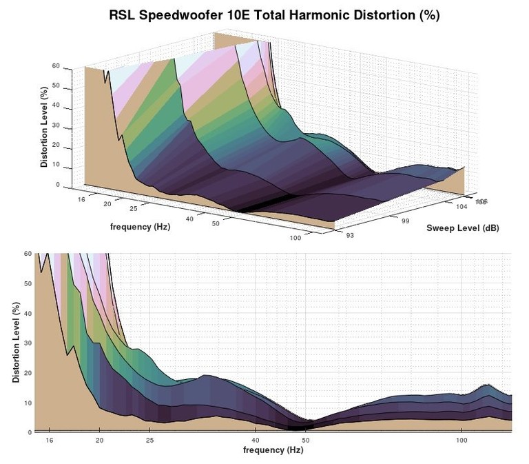

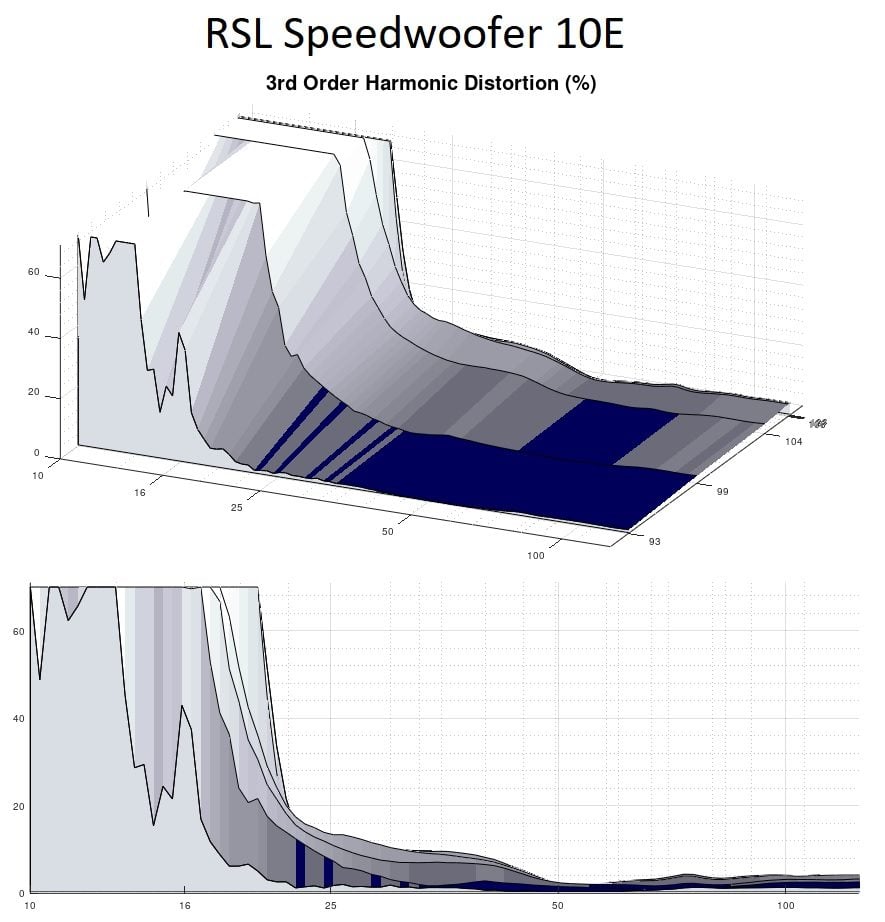

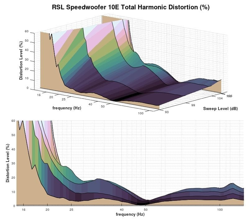

The above graph shows the corresponding total harmonic distortion to the long-term output graph. Essentially, it depicts how linear the subwoofer remains for the corresponding drive level seen in the long-term sweeps. The quantity being measured is how much of the subwoofer’s output is distortion, shown here as a percentage.
Again, we have a good set of measurements considering the cost of the Speedwoofer 10E. At the highest drive levels, it can be made to produce a fair level of distortion, but not a whole lot, and we have seen plenty more expensive subwoofers not keep as much composure when pushed to the limits. Keep in mind that the sharp rise in distortion that happens as frequencies drop nearer to 20Hz is where the sub dramatically loses output, so that stuff isn’t likely to significantly intrude on the sound. The region of interest for us is the stuff at 25Hz and above. At nominal levels of 90dB or lower, we can see distortion will be at 5% or less, likely a lot less at lower loudness levels. Above 100dB, distortion levels do kick up a bit, and the last few dB of output are accompanied by a notable rise centered at around 30Hz. However, in my testing, while the sub could be heard to audibly distort, it didn’t sound like it was self-destructing like some other budget subs I have tested. Strain on the driver was evident, but I was never worried it was on the verge of death, so the 10E does have some good limiters that keep it from self-harm on high signals. So as long as some sanity is used in operating the 10E, audible distortion will never be an issue, and even if it is pushed to the limits, users can have peace of mind that it won’t beat itself to death.

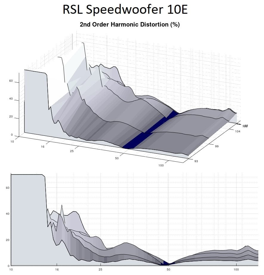

The above graphs depict measurements of the constituent harmonics from the long-term output sweeps and are what the total harmonic distortion measurements are composed of for the 2nd and 3rd harmonics. These individual harmonics can give us a clue as to what might be the cause of some quirk or non-linearity. We are only showing the 2nd and 3rd here because they more or less reflect the higher even-order and odd-order behaviors, although higher-order harmonics tend to be much farther down as a percentage of distortion compared to the second and third.
The above graphs reflect very typical driver behavior. At lower drive levels, we can see much of the harmonic distortion is composed of even-order products. This is probably due to inductance given the steady rate at which it increases with the drive level. As the driver reaches the limits of its linear excursion, odd-order products become prominent in lower frequencies. The motion of the moving mass is being restricted at both ends of its throw, and that is creating additional tones on top of the fundamental source signal. The good news is that, in music ranges above 40Hz, any distortion that the 10E can produce is even-order, which is a lot less noticeable than odd-order harmonics. This sub will have a very clean sound with music sources, even at high drive levels.

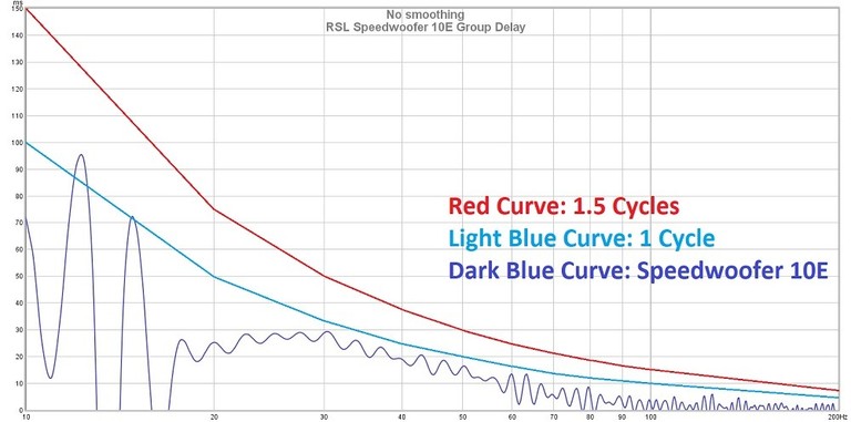

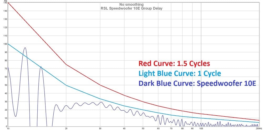

Group delay is the measurement of how much time it takes for individual frequency bands of an input signal to be produced by the speaker. It can indicate that some frequency components are developing slower than others or are taking longer to decay. It is generally thought that 1.5 sound cycles are needed for group delay to be audible at bass frequencies, although there is an argument that group delay should remain under 20ms to be completely unnoticeable, but that is likely meant for mid and upper bass frequencies.
The Speedwoofer 10E puts up a good showing in this measurement, and it generally keeps port-contributed output under 1 cycle until well under the port tuning frequency, where there is no more significant output. Mid-bass hangs under 10ms, and the 10E doesn’t exceed our minimum standard of audibility of 20ms until near 40Hz, so the sub WON'T have a laggy or delayed sound, especially in common music frequency bands. This is a great showing for such an affordable subwoofer.
