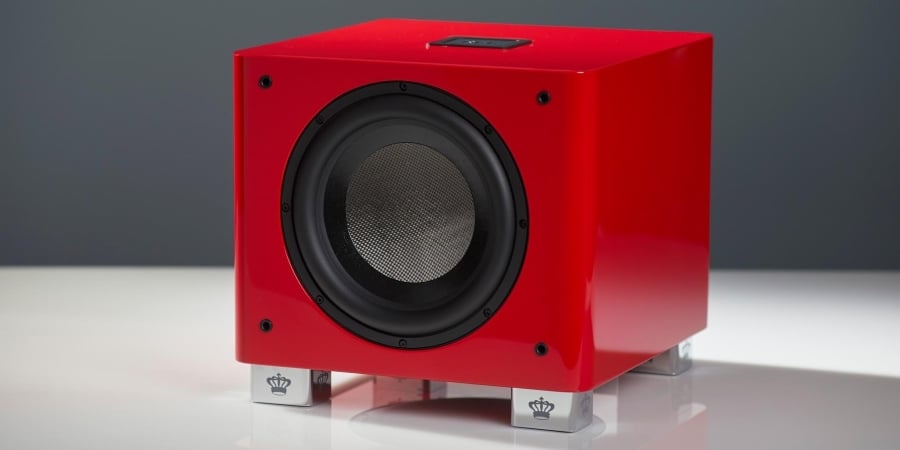

The regular T/9x ($1,500) comes in black or white, and is one of REL’s most popular models because it’s a great all-rounder. It performs admirably for both music and theater in typical living-room systems that aim for a reasonable compromise between style and substance. It doesn’t deliver single-digit bass, but I know from experience that it sounds superb, especially in pairs. It’s the flagship of REL’s Serie T/x range, which is the brand’s entry-level offering for music-focused performance (as opposed to REL’s Serie HT, which focuses on theater performance). Despite its flagship status within Serie T/x, the T/9x is not a large sub. Its 10-inch forward-firing driver and 10-inch down-firing passive radiator are built into a beautifully-made cabinet measuring 13.4 inches tall, 14.5 inches wide, and 15.5 inches deep. This compact size is one of the reasons why it’s so popular. Now this same form-factor is available in a fetching Rosso Corsa Red paint. It’s the same paint that adorns Italian sports cars from brands like Ferrari, Maserati, and Alfa Romeo. REL’s high-gloss, hand-polished finishes are really exquisite, so I’d expect the T/9x Red to look even better in person than it does in photos. There are seven coats of Rosso Corsa paint on the T/9x Red.

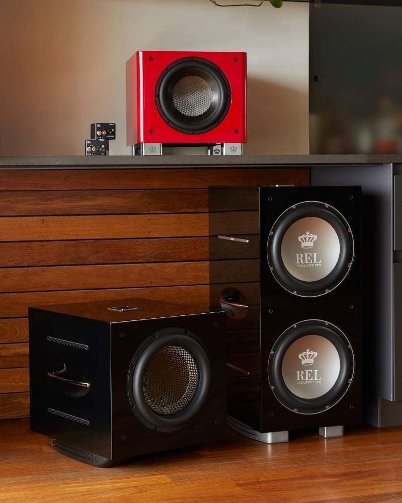

T9x Red vs Larger RELs

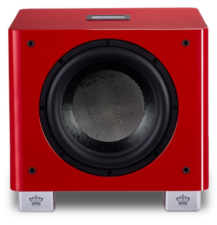

REL’s owner and lead designer, John Hunter, says that this particular paint costs an astonishing $600 per gallon! That ridiculous figure helps to explain the $150 price increase over the standard T/9x, but luckily your money isn’t being spent on paint alone. The T/9x Red also includes some upgrades that affect sound quality. The driver has been upgraded over the standard version, resulting in a 25% price increase over the original driver. The standard T/9x driver is made from a composite of air-dried white paper, stiffened by an aluminum center cap. In the T/9x Red, the aluminum is replaced by a 6-inch, pure carbon fiber center cap. The center cap is responsible for holding the structural integrity of the cone intact when it’s under pressure. The louder the sub plays, the more important the center cap becomes. The stiffer center cap reportedly results in better bass articulation. The use of carbon fiber also reduces the weight of the cone’s moving surface by 10 grams and increases the driver’s overall sensitivity by 1.2 dB. The result, according to REL, is a driver that’s quicker off the line, and more dynamic than the standard version. The improved driver allowed REL’s engineers to retune the driver’s suspension, making it a bit stiffer and “more like a sports car,” according to Hunter. “It goes a little bit deeper and it hits a little harder,” he said in a video explaining the new sub. “(The T/9x Red) is very reactive, and it stops and starts even quicker than the (standard) T/9x.”

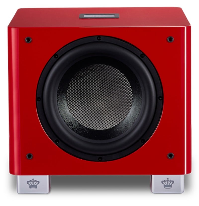

T9X Red no grille

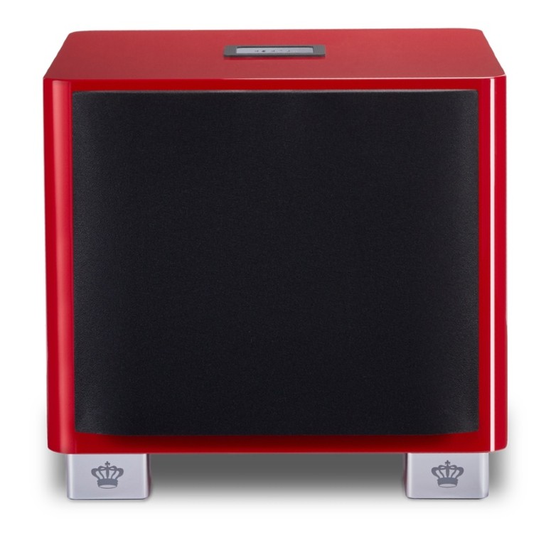

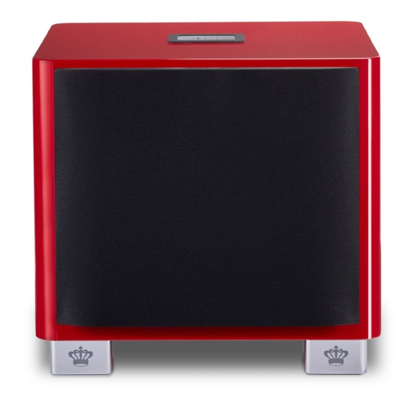

T9X Red w grille
As I said from the start, the fact that this sub is not just another black box will certainly play a part in making it a popular choice, particularly among those audiophiles who lean toward contemporary design. I don’t know how well it would blend in with the decor in my girlfriend’s 1908 Craftsman-style home in Seattle, but I’d be willing to find out. In addition to the racing red paint, the T/9x features other style flourishes, including a chrome and carbon-fiber top badge, and metal feet that undergo a three-day chroming process. Copper, nickel, and chrome are meticulously layered, with each coat being given a day to set before adding the next. Many readers might balk at this level of attention to detail, and it’s true that these aesthetic choices don’t affect performance. But for others, looks matter, even in audio. The REL T/9X is available for purchase through our channel partner Audio Advice.
