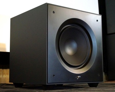

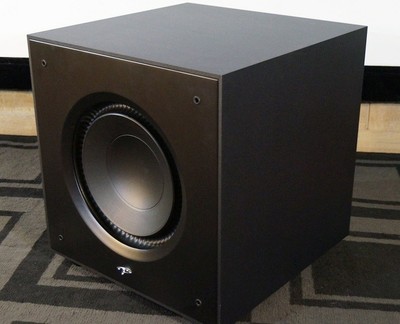

Appearance
The Defiance subs arrived in a very robust cardboard box and were sandwiched between thick foam pieces that gave the subs a good amount of clearance from the box sides and sufficient shock protection for a bumpy ride. Normally packing is a bigger deal for products that are available only directly from the manufacturer, but since audio business is increasingly being done through e-commerce, more products like these will be received by shipped home delivery, so packing still matters for these subwoofers. The Defiance subs were well-packed, and I would expect them to be able to withstand rough shipping.

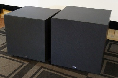

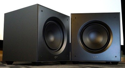

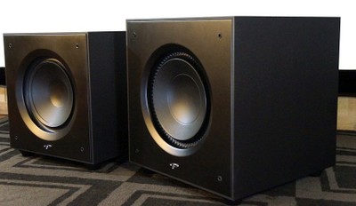

Paradigm Defiance V12 (left subs) and X12 (right subs)
Unpacking the Defiance subs revealed two stylistically minimalist subwoofers that are reminiscent of two recently reviewed subwoofers, the MartinLogan Dynamo 600X and 1600X. The Defiance subwoofers are starkly cube-shaped and devoid of any other particular features outside of their flush-mounted, front-firing woofers. The edge lines are clean and very angular. These enclosures embrace their cube shape rather than trying to soften them by rounding off edges or going for rectangular dimensions. The subwoofers have a satin black finish that is more like a very finely textured black rather than a smooth finish. The front baffle almost looks like a painted aluminum, so it appears to be a bit higher-end than it really is. The drivers for both subwoofers use inverted surrounds, but the X12 surround has a ribbed shape that makes it a bit more visually interesting. Both cones use inverted dustcaps so the woofer appearance is that much cleaner.
The Defiance subs come with grilles, and the grilles simply hide the drivers and make the sub look more cubish, almost like an abstract building block. If you hate the sight of woofers, these grilles do a great job of masking them. With grilles on, the subwoofers become very simple objects, visually speaking. They become dark cubes with only a small Paradigm ‘P’ insignia at the lower front as their only distinguishing feature. For those who want perfectly flat, featureless surfaces, that insignia looks like it could be easily removed. As always, I prefer the appearance without grilles; these are some nice-looking woofers, in my opinion. Since the appearance of these subwoofers is so simple, they could fit in a wide variety of décors, from traditional to modern. They will not clash with many interior design schemes, and their low-key finish would make them fade into most rooms if tucked somewhere out of the way.
The Defiance subwoofers are stylish without being conspicuous or flamboyant. They are clean-looking and inoffensive, but not uninteresting. Personally, I like the way they look, and I don’t think many people would object to their austere aesthetic.

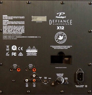

We should also talk a bit more about the Defiance wireless signal system. The Defiance WT Wireless Module is sold separately and does away with the need for a physical wire for the signal. Omitting the signal cable can greatly increase the availability of potential placements for the sub, and since the placement of the subwoofer is so critical in getting good sound, this can be a very significant assist in sound quality. The Defiance WT Wireless System uses 2.4 GHz dynamic frequency selection and error correction. The receiver end of the Defiance WT system is powered by the subwoofer itself and so does not need to be plugged into a power outlet. The Defiance WT Wireless Subwoofer System has a 50-foot range, so it should be able to handle any conventional domestic room size without a problem.

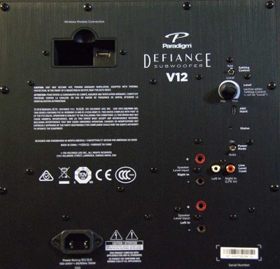

Paradigm Defiance V12 backpanel (left pic) X12 backpanel (right pic)

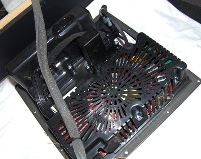

Let’s now discuss the more traditional nuts-and-bolts design aspects of the Defiance subwoofers. We will begin by talking about the amplifier. Both the V12 and X12 plate amps have left/right line-level RCA and speaker level inputs, although the X12 also has as a dedicated LFE input, whereas the LFE input is shared on the right RCA input on the V12. The X12 also has a dedicated 3.5mm trigger input which allows for a dedicated power-on signal from the receiver or preamplifier. The X12 amplifier is a lot more powerful than the V12 amplifier: 650 watts RMS vs. 120 watts RMS respectively. If all other things were equal, that extra power would translate into an approximately 7.3 dB increase in headroom alone, but, as we shall see, all other things are not equal.

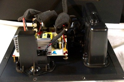

Paradigm Defiance V12 amplifier (left) and X12 amplifier (right)

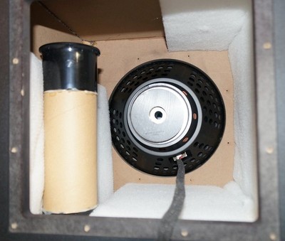

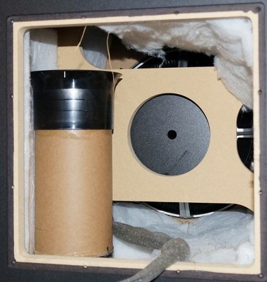

Paradigm Defiance V12 cabinet interior (left) and X12 cabinet interior (right)
One unequal point between the X12 and V12 is the cabinet size; the X12 has a significantly larger cabinet at 3.8 cubic feet vs the V12’s 2.9 cubic feet. This difference matters. Larger cabinets make for more efficient systems and lower resonant frequencies, and these are always good things for subwoofers. The larger enclosure can accommodate a larger port, and that means more low-frequency output for the same amount of wattage. The X12 takes advantage of the larger enclosure to use a larger 4” diameter, 14” long port versus the V12’s 3” diameter, 12” long port. The X12’s port is heavily flared at both ends too, which should help to reduce turbulence noise (“port chuffing”). The X12 has more internal stuffing, and it also has a windowpane brace. The V12 does not have any internal bracing, but it will not need bracing nearly as much, because it is using a smaller cabinet and a less powerful amplifier and driver, so the enclosure paneling will not be subject to nearly as much internal pressure.

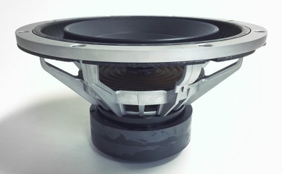

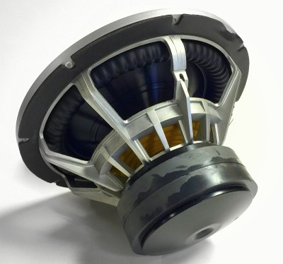

Paradigm Defiance X12 driver (image courtesy of Paradigm)
Speaking of the drivers, the X12 driver looks to be much more formidable than the V12. That isn’t to say that the V12 driver looks bad but rather both drivers are commensurate with their price points. The V12 driver uses a stamped steel frame and a single 5” diameter, 1” thick magnet with a 1.5” voice coil whereas the X12 driver uses a cast aluminum basket and two 1” thick magnets with a larger 6” diameter and 2” voice coil. Given the much more powerful amp in the X12, it is safe to assume that it will have a more massive voice coil as well. While the V12 driver looks adequate for the task, the X12 driver appears to be a real powerhouse.
The X12 driver has a ribbed shaping in the surround that Paradigm calls the ‘ART’ surround. ART is the name Paradigm has given to their patented surround design that uses a pleated ‘ribbing’ over the length of the surround; it is an acronym which stands for Active Ridge Surround. Supposedly, ART allows for more headroom than conventional half-roll designs. When typical surrounds are stretched at high excursions, particularly in the inward-stroke, deformations can occur from the high tension, and these deformations can cause distortion or even tears in the surround. This ridged surround design by Paradigm supposedly reduces these deformations by directing material stress to points that can better cope with it due to the shape of the surround. Paradigm claims that ART allows 1.5 times the excursion for the same surround roll that results in a 3 dB increase in headroom.
One slight oddity that we see is the V12 driver has a bucking magnet applied on the back of its motor. Bucking magnets were used to control stray magnetic fields from interfering with exterior objects such as CRT displays and cards with magnetic strips, but they are not often seen used much anymore. When I asked Paradigm about the inclusion of the bucking magnet, they said that they can be used as a cost-effective way of adding more magnetic flux to the motor.

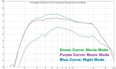

Frequency responses for the modes of the Defiance V12 (left) and X12 (right) subwoofers
The above graphs depict the frequency responses for the Defiance V12 and X12 subwoofers for their available modes. ‘Music’ mode yields the flattest response, where ‘Movie’ mode allowed a bit more lower bass oomph. Listeners who prefer more accuracy should go with ‘Music’ mode, although ‘Movie’ mode looks like it would be more fun on movie night with an action movie playing. Both subs have a similar range, with the low-end knee at about 25 Hz with the high-end stretching to 200 Hz. These aren’t the absolute deepest digging subs, but 25 Hz is enough to capture about 99.5% of low-frequency musical content and perhaps 90% of low-frequency movie content. In order to be tuned deeper, a much larger enclosure would be needed to achieve the same output capability, or output capability would have to be sacrificed to use the same sized enclosure, so a 25 Hz tuning is a sensible tuning frequency that catches much of the deep bass but without needing huge cabinets. High-end extension to 200 Hz is always a welcome feature because there are a variety of situations where users could feasibly take advantage of higher crossover points. That is something I always look for, and I think that its importance can often be understated.
One thing to note is that the ‘Night’ mode was not measured on the same SPL level as the other modes. This is because the ‘Night’ mode would not permit the subwoofer to reach the same SPL levels, so the ‘Night’ mode curve that you see there isn’t just a measure of its bass response, it's a measure of the maximum output levels of that mode. This mode is intended to be the ‘considerate’ mode when listening to content at night but not wanting to bother other people within the same household. The ‘Night’ mode response shape makes sense because deep bass is what travels through walls and obstacles most easily and is what will be heard most readily in any nearby rooms. Something else we can note from comparing these graphs is that the ‘Night’ mode on the X12 permits much more output than the ‘Night’ mode on the V12. This would suggest that ‘Night’ mode is set for relative output capability rather than absolute SPL for the Defiance subwoofers.

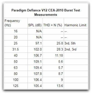

Paradigm Defiance V12 (left) and X12 (right) CEA 2010 Measured Data - 2 meter (RMS)
The above CEA-2010 measurements are short-term bursts that show the subwoofer’s clean peak SPL before heavy distortion sets in. Our measurements have been referenced to 2-meter RMS, which is 9 dB down from the standard requirement for the measurements to be shown at 1-meter peak. However most publicly available CEA-2010 measurements are shown at 2-meter RMS, so we followed that convention. Rows with N/A and no data values means that the subwoofer was not able to produce passing results.
Viewing the V12 data, we can see that it isn’t tremendously happy in deep bass. It can dig down to 25 Hz, but at 31 Hz and below, it certainly has its limits in that region. At 40 Hz and above it is performing at a much higher level and manages to exceed 109 dB at 50 to 63 Hz, which is impressive when its enclosure size and modest amplifier is considered. The V12 is not an output monster, but this level of performance will be sufficient for most people’s needs- the kind of people who need a nice-looking, discrete subwoofer that is unobtrusive. It will certainly give some gusto to the bass in music and movies, but it isn’t going to be knocking the walls down.
The X12 sports a very different level of performance. It is well over twice as powerful across the board, averaging roughly an 8 dB output advantage overall, which is nearly three times as powerful. Its 20 to 25 Hz performance is respectable, and its 31 Hz measurement is very good, but at 40 Hz and above it is an absolute powerhouse considering that it is using a 12” driver in a medium-sized enclosure. In fact, in that range, those are the kind of numbers I would expect to see from a decent 15” subwoofer, not a 12” sub. While the V12 performed at a level that I expected, the X12 surprised me and very much exceeded my expectations for what it could do. It is a subwoofer that does deep bass well, but its mid-bass performance is excellent. 117 dB+ is a prodigious amount of headroom. Distortion is kept in check as well; while the X12 isn’t totally distortion free at the limits of its performance envelope, it doesn’t exceed 17% THD at 20 Hz and above, and any distortion would be inaudible for any real-world content. The story between these subs is that if you can handle the somewhat larger enclosure of the X12 and the doubling of the price, you will be rewarded with very powerful bass that can be felt as well as heard.

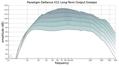

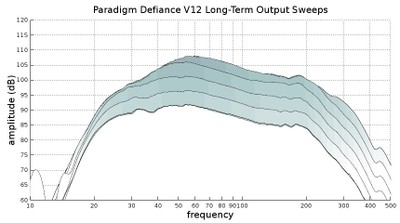

Paradigm Defiance V12 (left) and X12 (right) long-term output compression
Testing for long-term output compression was done by first conducting a 20-second sweep tone where 50 Hz hit 90 dB with the subwoofer 2 meters from the microphone. We then conduct further 20-second sweeps by raising the gain by 5 dB until no more output could be wrung out of the subwoofer. These tests show us the long-term continuous headroom that these subwoofers are capable of. In the graph for the V12, we see significant port compression above the 100 dB sweep where mid-bass output continues to increase but not deep bass output. A larger enclosure and port might have allowed more port output. However, a larger subwoofer would defeat the point of this sub where its size makes it more practical than those giant subwoofers. Its 40 Hz to 100 Hz headroom averages around 105 dB which is certainly not shabby for a subwoofer of its size and specs.
As with the burst measurements, the X12 proves to be much more powerful. We see similar output deltas between these subs that we saw in burst testing: two to three times as much output capability across the board with even larger differences above 80 Hz. From 40 Hz to 100 Hz, the X12 averages around 115 dB. This is the range of the vast majority of music recordings and here the X12 hits hard. If you like your music loud, the X12 will oblige you. As with the V12, we do see significant port compression at the low end that starts at the 100 dB sweep. I would love to see what this driver and amp could do in a larger cabinet with larger ports, but one of the charms of this subwoofer is the outstanding performance that can be had from such a modest size.

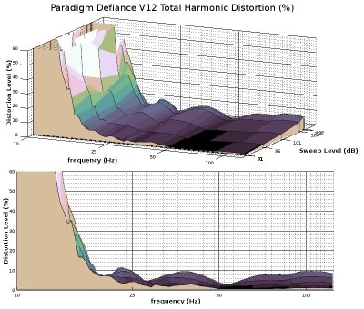

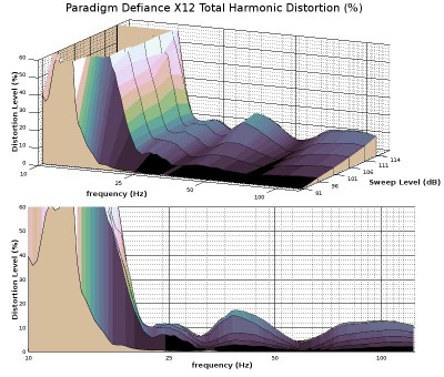

Paradigm Defiance V12 and X12 Total Harmonic Distortion per output level
The above graphs show the corresponding total harmonic distortion to the long-term output graphs. Essentially, they depict how linear the subwoofer remains for the corresponding drive level seen in the long-term sweeps. The quantity being measured is how much of the subwoofer’s output is distortion and is shown here as a percentage. Examining the V12’s measurements, we see that it nicely keeps harmonic distortion under 10% THD at 20 Hz and above, no matter how hard it is pushed in these tests. That is a very good result, but it is curious that it does seem to run contrary to the burst measurement data which shows 25% THD and noise at 25 Hz and 28% THD and noise at 31.5 Hz. In other words, the V12 is much better behaved in long-term testing than burst testing. One possible reason for this is that the V12 can be pushed harder for just a moment, and that is enough time to drive it much further past its linear operating range. When I take a close look at the burst testing data to try to explain this discrepancy, I see that the major component of the distortion comes from the 2nd harmonic. Port compression can often result in even-order harmonic distortion, so it may be that the port is able to be more easily overloaded in bursts than in continuous tones. Either way, low distortion operation, even if only for a certain type of signal, is not an unwelcome feature.
The X12’s THD profile is a lot more what one would expect from comparing its burst test measurements. It is allowed to be pushed to slightly greater distortion quantities than the V12, but that may be because the V12 simply doesn’t have the amplifier power to push its driver into distortion above very low-frequencies. The X12’s amplifier is more than five times as powerful as the V12 amplifier, so it has way more force on tap, and it is not surprising that, even as beefy as the X12 driver is, it is being pushed a bit harder by its amp than the V12 is able to push its driver. Something that has to be kept in mind when comparing the V12’s THD measurements to the X12’s THD measurements is that while the X12 can be driven into greater quantities of distortion, it is still a much cleaner subwoofer than the V12. The reason is that the X12 stays cleaner for the same drive level, and it will reach far greater output levels than the V12. Decibel for decibel, the X12 is the higher-fidelity subwoofer. However, both put up a very good showing overall; neither sub rises above 5% THD above 30 Hz at a 95 dB sweep, and the X12 pretty much stays below 5% THD at the 100 dB sweep for that same frequency range. That is well-controlled and highly-linear behavior.

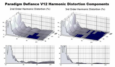

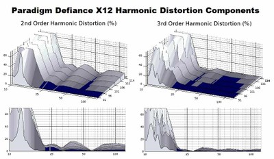

Component Harmonics of the Defiance V12 (left) and X12 (right)
The above graphs depict measurements of the constituent harmonics from the long-term output sweeps and are what the total harmonic distortion measurements are composed of for the 2nd and 3rd harmonics. These individual harmonics can give us a clue as to what might be the cause of some quirk or non-linearity. We are only showing the 2nd and 3rd here because they more or less reflect the higher even-order and odd-order behaviors, although higher-order harmonics will likely not be as abundant in quantity as the 2nd and 3rd harmonics.
One attribute that the measurement sets for both the V12 and X12 have in common is that the major contributing distortion component is the 2nd harmonic. Given its broadband range and steady rise with increasing output levels, I would guess it is a product of induction. Induction in loudspeaker drivers is when the changing magnetic field from the movement of the voice coil next to the stationary permanent magnet causes a counter-current that can interfere with the initial current thereby inhibiting linear motion that is faithful to the source signal. Fortunately, even order harmonics are not as audibly easy to detect because their relationship with the fundamental often makes them sound like a natural part of the timbre of the recorded object. Of course, in large enough quantities they will begin to sound unnatural, but the Defiance subs do not run into distortion that heavy. Even at its absolute highest drive level, the Defiance doesn’t run into enough distortion that it would be audible or concerning, and at every level outside of the highest drive level, distortion quantities are minute. The distortion profile of both the V12 and X12 is ultimately quite good. These subs can’t easily be pushed into making an incorrect noise.

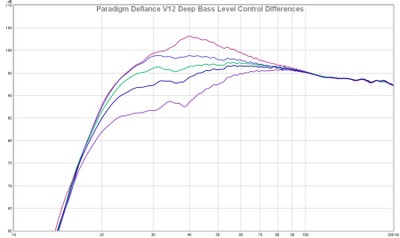

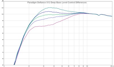

Effects of the ‘Deep Bass Level’ Control settings on the Defiance V12 (left) and X12 (right)
One of the controls on the Defiance’s subwoofer control app is a control called the ‘Deep Bass Level.’ As its name implies, it adjusts the level of deep bass output on the Defiance subwoofers. This can be handy for toning down bass in rooms that get a lot of room gain and can consequently end up with a bloated sound from too much deep bass gain. It can also be handy for this who want to spruce up the low-frequency effects sounds on movie night or just like the sound and feel of heavier deep bass. Each graph exhibits the effect of a +5, +10, -5, and -10 dB adjustment on the ‘Deep Bass Level’ control with the center curve being zero, i.e., no adjustment. The region most affected by this control seems to be the 30 to 40 Hz band.

While the X12 is an output monster and the V12 isn’t quite that, both
subwoofers sport very good baseline performance. They both have a
fairly neutral response (in music mode) and both keep to very low
distortion levels. Their time-domain performance is exemplary; the group
delay measurements for these subs should serve as a wake-up call to
those who still think that ported subs suffer from overhang compared to
sealed subwoofers. Both the Defiance V12 and X12 are legitimately
high-fidelity subwoofers. They will accurately reproduce whatever signal
that is sent to them. While typical room acoustics will inevitably
degrade up their superb playback abilities, the user can be assured that
any qualitative problems with the bass sound will not be due to the
Defiance subwoofers themselves. The addition of the Anthem ARC Mobile
App will help to alleviate some of the deformations that the room will
have on the response as well. Another good aspect of their performance
is that they are well-protected against being over-driven; you can’t run
these subs so hard that they will bottom out or put the driver at risk
for damage. The digital limiters work very well in keeping these subs
from potentially harmful drive levels.
