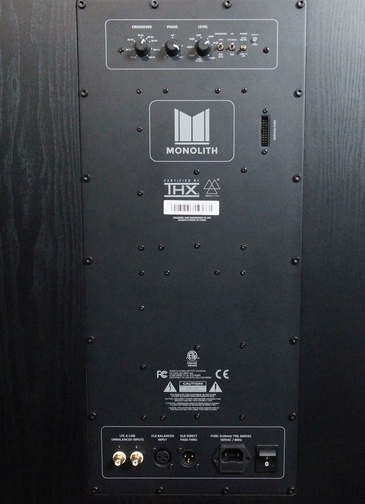

- Inputs: RCA stereo input/output, XLR

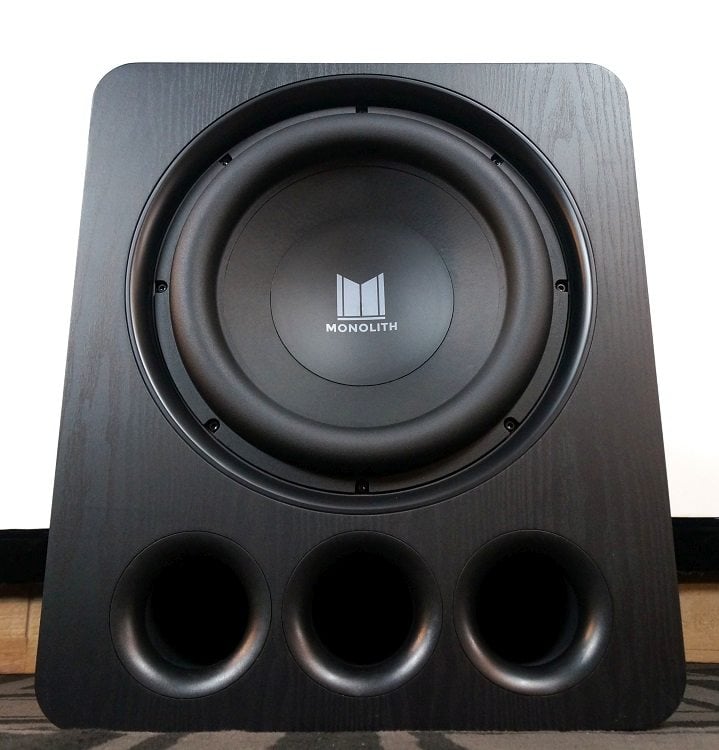

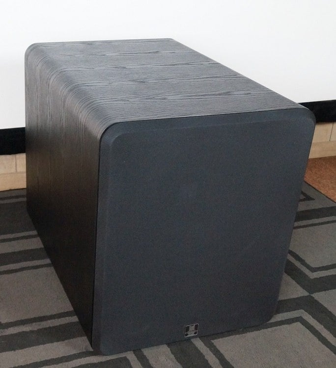

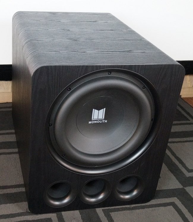

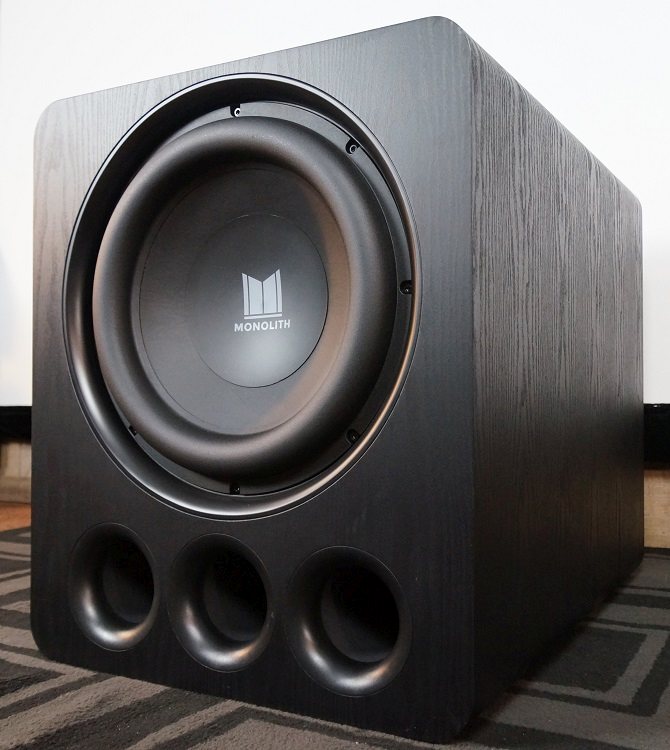

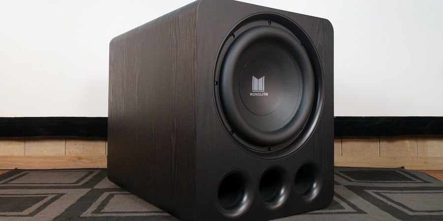

The Monolith 13" arrived at my house in an enormous box which promised a monster subwoofer inside. The box edges were reinforced with edge protectors, and the sub was sandwiched between two large, stiff foam caps. The sub was covered in a large drawstring cotton sack to help protect the sub against scuffs and scratches as well as moisture. The packing is good and is in line with other subs we have seen in this category. Packages like this are pretty brutal for parcel delivery drivers, and Monoprice ought to consider just sending them on pallets since many parcel delivery services don’t seem to value the well-being of their drivers (in my experience).

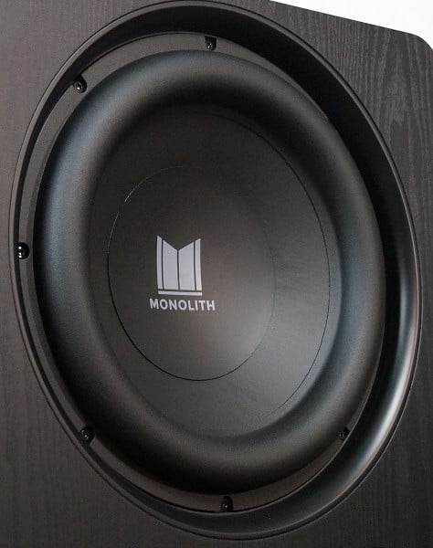

Once out of the packing, we see a large black sub with a black oak veneer similar to what the other Monolith subs have had. Unlike the other Monolith subs, the Monolith 13” has rounded corners, and that goes a long way towards giving it a bit more dignified style than the others, which looked a bit more ‘raw.’ What is more is that the driver is sunk into the front baffle so that the surround is flush with the front edge, also giving the 13” a more upscale appearance than its lower-end siblings. On top of that, the grille uses magnetic adhesion, so there are no grille guides pocketing the front baffle. The grilles themselves have rounded edges as well, so they look a bit more cordial than the other Monolith subs. While it is essentially a big black box much like the other Monolith subs, this one is definitely more polished looking and may get a passing aesthetic grade from other household members whereas the others wouldn’t.
With the grille on, it is pretty innocuous, aside from its sheer size; not beautiful but not offensive, just plain. Without the grille, the Monolith 13” is a much more interesting-looking object. The most notable visual feature is the beefy-looking driver; the surround is huge. Monoprice specifies this as a 13” cone, but it looks much larger. An inverted dustcap bears the Monolith logo. Under the cone are three flared ports, which ensure some real firepower. This sub looks like it means business. It has the feeling of a race car at rest; it is just begging for a real track to chew on.
Design Analysis of Monolith 13" Sub

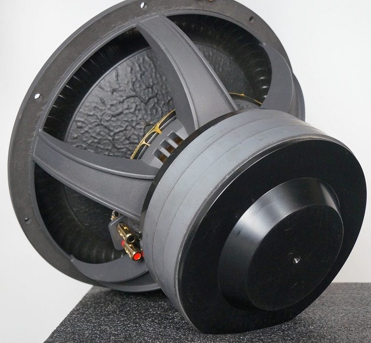

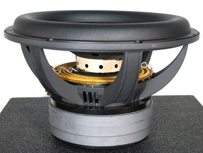

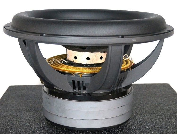

The Monolith 13” is, as its name implies, a subwoofer using a 13” driver. But this isn’t just any 13” driver; this is an absolute monster of a 13”. The motor is huge and comprises the bulk of the 49 lbs. weight of the driver. It features a triple stack of magnets that total 2 1/2” height and an 8 1/2” diameter. It has a heavily bumped-out backplate for high excursions, and venting occurs under the spider. It uses a very large diameter voice coil with the former having a 4” diameter, and it’s going to need that space to handle the 1,800 watts that the amplifier can put out. It uses dual voice coils and so has binding posts on both sides of the frame. Such a large voice coil is sure to be a source of problematic inductance, so to fight against that, Monoprice has installed two aluminum shorting rings which should go a long way to eliminating inductance and all the problems it brings. The cast aluminum basket for the driver is very large; it measures 15” from frame edge to frame edge, and most other subwoofer manufacturers would simply call this a 15” driver, but the moving surface area is that of a 13”. The driver uses the basket of a 15” so that there is room for the spider and surround which the wide diameter of the basket supplies. This larger space is needed because it is more difficult to have the right suspension compliance for high excursions in smaller baskets since smaller suspension areas normally entail tighter compliance and therefore shorter throws. This is doubly true for this driver because the large diameter of the voice coil former takes up so much space. The surround is also quite sizable with a 1” height and 1 ¾” width; that should enable the moving assembly a very long throw before high tension restricts motion. The underside of the surround has a radial grooved structure that could possibly assist in keeping surround deformation more uniform at high excursions, thus reducing distortion.
Such a beast of a driver will need a serious amplifier to take full advantage of its capabilities, and Monoprice has provided one with a 1,800 watt RMS class-D design. It is made up of four 500-watt modules, and it presumably uses them in a way that maximizes the performance of the dual voice coil design. The amp features the usual spread of controls but also includes a variable phase knob instead of a phase switch and a THX mode selector. Connectivity is a pair of RCA inputs and an XLR input and XLR pass-through. The THX Selector switch allows switching from THX performance to an extended mode. The THX mode assures a very clean and tightly controlled response but rolls off deep bass extension at a higher frequency in order to preserve extremely low levels of distortion. The ‘Extended’ mode grants the user deeper bass but at the cost of higher distortion.

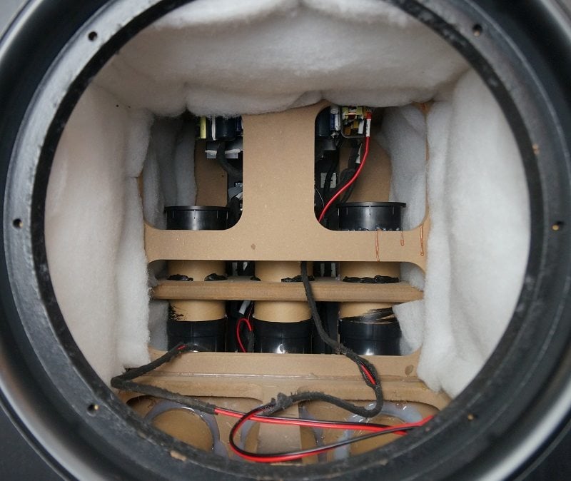

As with the other Monolith subs, the enclosure is made from high-density fiberboard instead of the traditional medium-density fiberboard. High-density fiberboard is, of course, heavier than MDF and composes the majority of the Monolith 13”s 150 lbs. weight. It has four pieces of internal bracing, and two of these braces also serve to hold the ports solidly in place. With a 22” depth and then a right turn for a 14” height, they are large ports and could use the additional support. The ports have an approximate 3 ¼” diameter and are flared on both ends. There is a polyfill-type stuffing lining the interior side panels, and the internal corners are lined with some corner braces to help strengthen the edges. The feet are the same type used on the other Monolith subs that I have complained about in the past; they are hard rubbery cones that do not give the cabinet much clearance from the floor. I wish Monoprice would use feet that give a bit more clearance. There are six feet with a pair in the middle of the cabinet to give the whole of the enclosure more support, which is not a bad idea given its weight. One interesting build feature is that part of the amplifier is mounted on the top of the cabinet. I would guess this is done so that all four amp modules aren’t right next to each other, making for better thermal management. Either that, or it was simply easier to assemble two boards with the amp modules mounted on them rather than placing them all on one board.
Port plugs are included for the option to take full advantage of the deeper extension of ‘Extended’ mode or to run the subwoofer in a sealed mode. If the user wants big output below 20Hz, they can seal one of the ports and set the operating mode to ‘Extended,’ or, if the user wants to shut down port output entirely, they can seal all the ports and substantially reduce all output below 40Hz. I don’t see the point in buying a large sub and then using it in a sealed mode. The point in making a sub as large as the Monolith 13” is in large part to get that deep bass extension. Maybe if the user’s room is small and they are getting too much room gain to sound good, then sealing the ports is a way to deal with that, but even then equalization is a better option since it doesn’t eliminate deep bass headroom.

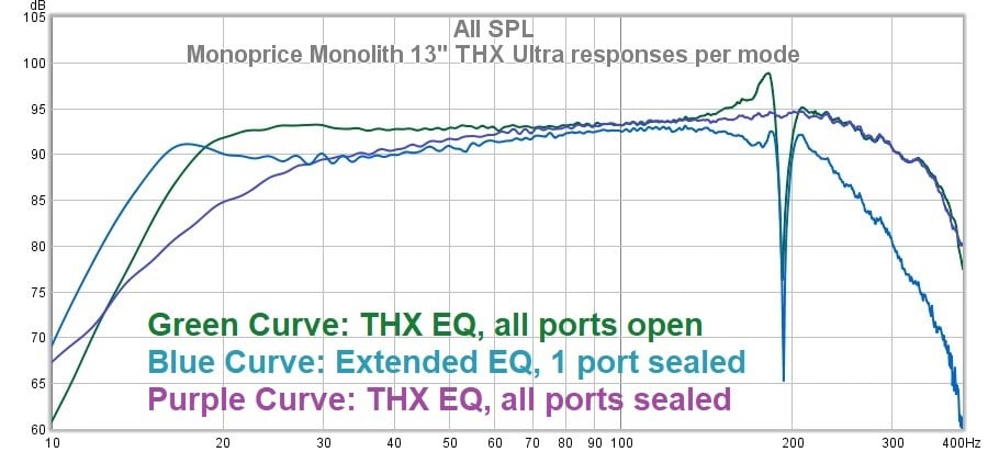

Monoprice Monolith 13” THX Ultra Subwoofer Measurements

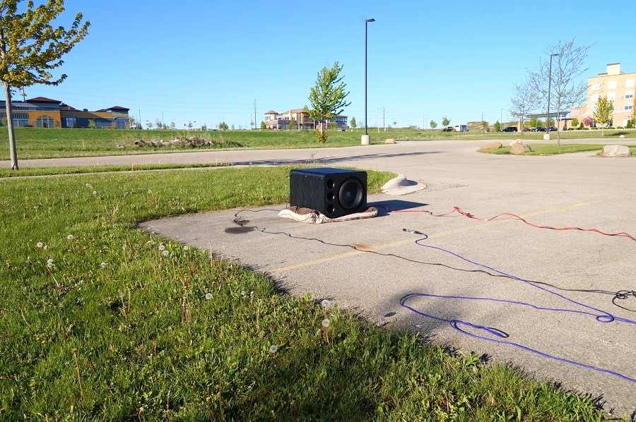

The Monolith 13” THX Ultra was tested using ground plane measurements with the microphone at a 2-meter distance in an open setting with well over 100 feet from the nearest large structure. The subs were tested with woofer facing the microphone. The temperature was recorded at 45F degrees with 77% humidity. The subwoofers’ gain was set to maximum, phase was set to 0, and the low pass filters were left off.
The above graphs show the measured frequency responses for the Monolith 13” THX Ultra subwoofer. As with other Monolith subwoofers, we see a beautifully flat response down to 20Hz in the ‘THX’ EQ mode. Sealing a port and setting the EQ mode to ‘Extended’ gives the user a few more hertz of extension but at the cost of a neutral response. Sealing all ports naturally reduces low-frequency output. While the Monolith 13” enables the user to do this, there is not much of a reason to buy such a huge sub only to run it in a sealed mode; that defeats much of the purpose of this subwoofer. Any of the modes deliver a strong response to nearly 200Hz, and the sealed mode and THX mode with all ports open can even get up to 300Hz. This makes experimentation with higher frequency crossover points possible, and that can help address more room modes through placement rather than equalization as well as use more of the subwoofer’s dynamic range in mid-bass frequencies rather than the loudspeaker.

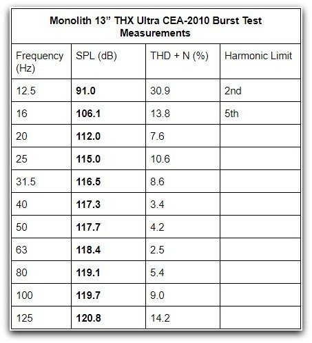

Monolith 13" THX Subwoofer CEA 2010 Measurement data at 2-Meter RMS
The above CEA-2010 measurements are short-term bursts that show the subwoofer’s clean peak SPL before heavy distortion sets in. Our measurements have been referenced to 2-meter RMS, which is 9 dB down from the standard requirement for the measurements to be shown at 1-meter peak. However most publicly available CEA-2010 measurements are shown at 2-meter RMS, so we followed that convention. The Monolith 13” produces a very strong set of measurements here, and that is what I was expecting based on its pedigree as well as the specs of the sub. This thing is ridiculously powerful all the way down to 16Hz. What is more is that its distortion numbers are terrific even when being pushed as hard as possible. It cannot be pushed into any significant distortion above 16Hz no matter what. Go ahead and crank the volume to the max; 112dB with only 7.6% THD is a nearly supernatural sound. 118dB+ mid-bass is nothing to scoff at either. Most subs and speakers have to make a trade-off of very wide mid-bass dynamic range or low deep bass extension, but the Monolith 13” does both fantastically.

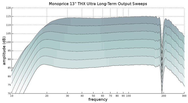

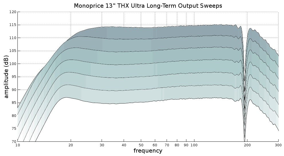

Testing for long-term output compression was done by first conducting a 20-second sweep tone where 50 Hz hit 90 dB with the subwoofer 2 meters from the microphone. We then conduct further 20-second sweeps by raising the gain by 5 dB until no more output could be wrung out of the subwoofer. These tests show us the long-term continuous headroom that the subwoofer is capable of. These tests were run with all ports open but with the subwoofer set to the ‘Extended’ EQ mode in order to maximize output. The Monolith can maintain a steady 115dB from 30Hz and above when driven to the edge of its performance envelope, and that is a staggering performance level. This is another terrific set of measurements, and we see the response undergoes very little change until the final sweep. Most subs will alter the response shape well before this point. What that means is that the Monolith 13” will not change its sound character very much based on loudness, so long as it does not encounter very much nonlinear distortion. So now let’s look at nonlinear distortion…

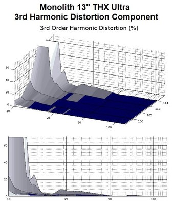

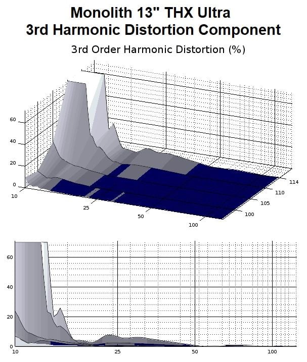

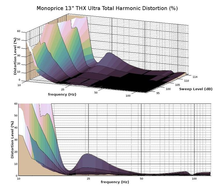

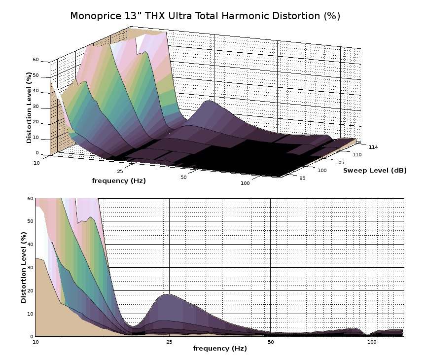

The above graphs show the corresponding total harmonic distortion to the long-term output graphs. Essentially, they depict how linear the subwoofer remains for the corresponding drive level seen in the long-term sweeps. The quantity being measured is how much of the subwoofer’s output is distortion and is shown here as a percentage. What we see here is that the Monolith 13” maintains very good distortion levels that only get pushed up somewhat at the highest drive level, and even then only just above port tuning which is where we would expect the most driver motion. Below the highest drive level, distortion stays below 10% where it should be inaudible. At nominal drive levels, it hovers around 1% THD. Until you max out the volume, this is a very clean and high-fidelity subwoofer, and even at maximum output levels it is still mostly well behaved except around 25Hz. That notch of distortion is unlikely to intrude in any realistic listening situation and probably wouldn’t be apparent unless you were listening closely to sine wave tones.

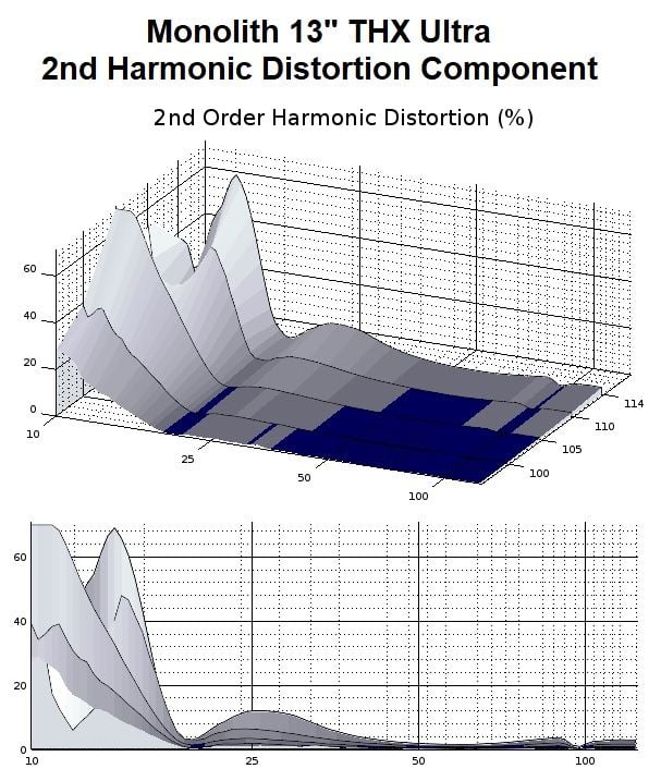

The above graphs depict measurements of the constituent harmonics from the long-term output sweeps and are what the total harmonic distortion measurements are composed of for the 2nd and 3rd harmonics. These individual harmonics can give us a clue as to what might be the cause of some quirk or non-linearity. We are only showing the 2nd and 3rd here because they more or less reflect the higher even-order and odd-order behaviors, although higher-order harmonics tend to be much further down as a percentage of distortion compared to the second and third.
Examining these graphs, we see that the Monolith 13” runs into more odd-order distortion than even order. The 3rd harmonic spike at 25Hz is indicative of the driver reaching the limits of its linear throw in both directions, and since that comprises the bulk of the distortion between the 2nd to 3rd, it says that the driver is fairly balanced in terms of excursion. There is some 2nd harmonic distortion, and that is not too surprising since the Monolith 13” has such a large voice coil and that will yield some induction effects, although Monoprice has taken substantial efforts to mitigate them. Indeed, the even-order distortion here is so low as to be insignificant. What is impressive is seeing just how far the driver can move at 25Hz yet still be shy of 20% THD. I am sure that we will be seeing Youtube videos of Monolith 13” owners throttling the subs in low frequencies to show off the driver’s tremendous throw. However, the thing to keep in mind is that it is easy to create a long-throw sub; the hard part is not losing linearity in that long throw. The Monolith 13” sustains a great deal of linearity for a tremendous amount of excursion.

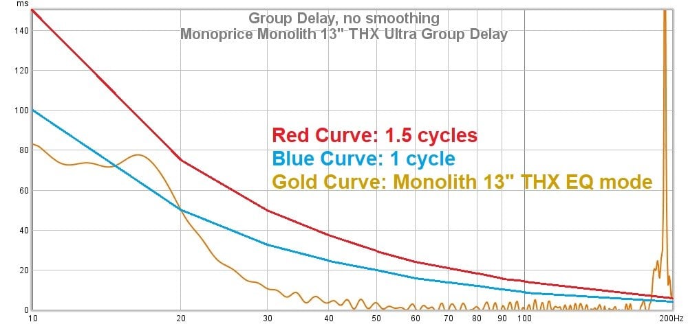

Group delay is the measurement of how much time it takes for individual frequency bands of an input signal to be produced by the speaker. It can indicate that some frequency components are developing slower than others or are taking longer to decay. It is generally thought that 1.5 sound cycles are needed for group delay to be audible at bass frequencies, although there is an argument that group delay should remain under 20 ms to be completely unnoticeable, but that is likely meant for mid and upper bass frequencies. The Monolith 13” turns in a terrific measurement with group delay not exceeding 20ms until around 25Hz. The time-domain behavior on display here is phenomenal. Delay does ramp up at port tuning, as it does with all ported subwoofers, but it is very well-controlled, and delay at such deep frequencies are very likely inconsequential since human hearing is so insensitive in that range. In the range that matters, virtually the entire mid-bass range, we see some of the best group delay measurements that I have yet tested. Whenever you hear someone say that ported subs are ‘slow,’ remember this chart and laugh at them.
