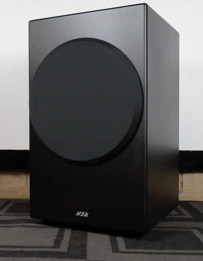

Hsu Research VTF-TN1 Packing and Appearance

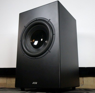

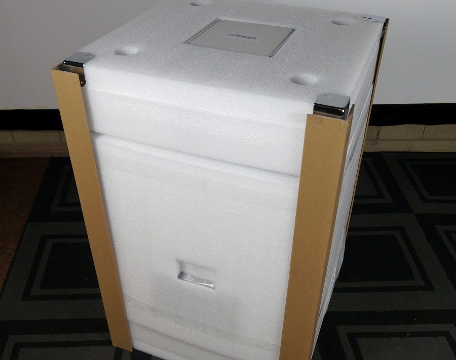

Needless to say, a large sub like the VTF-TN1 came in a large, sturdy box. Inside the box, the sub was completely covered with polyethylene foam blocks which is a step up from most subs which only have foam tops and bottoms. There are some very stiff edge protectors along the vertical edges. One interesting detail is that the corners of the polyethylene blocks have some metal corner protectors. Hsu tells me that this helps to diffuse the energy that hits the sub when it is dropped on a corner. Corner drops are one of the most common causes of shipping damage because all of the kinetic energy is focused on one point of the sub, and these corner guards should help to spread that out over a larger area. Inside the foam blocks, the sub came wrapped in a plastic back to protect against liquid spills and moisture, and underneath the plastic, it came wrapped in a soft foam sack to protect against scratches and scuffs. This level of packing should protect the VTF-TN1 against the rough shipping practices of the major parcel shipping services.

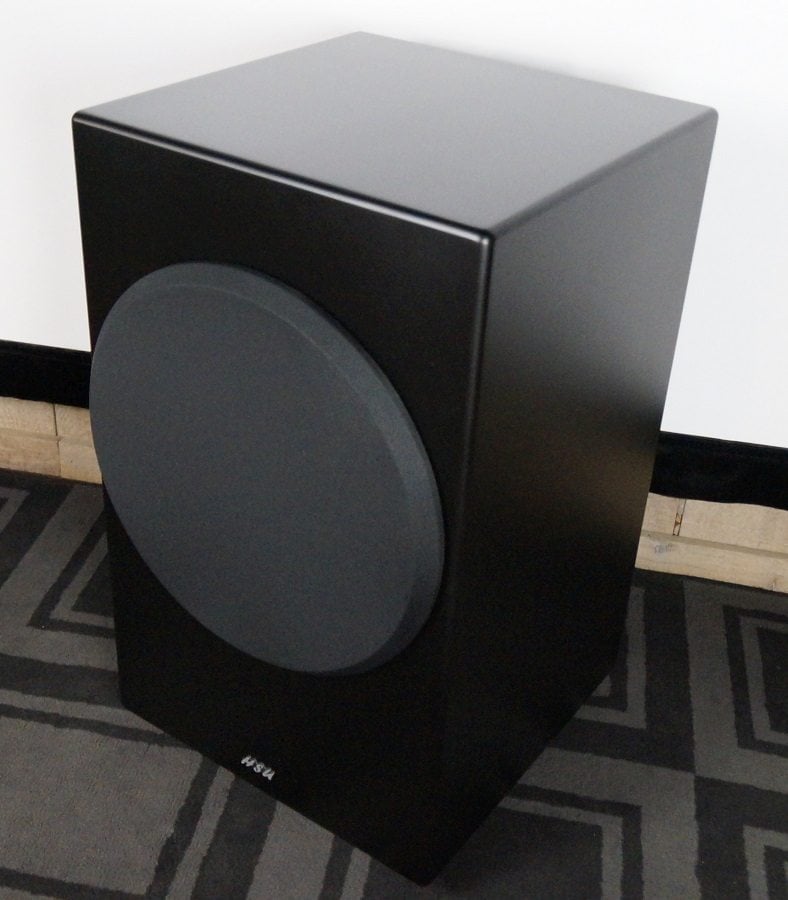

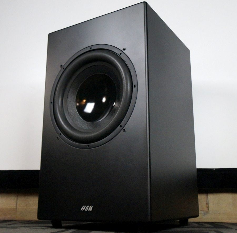

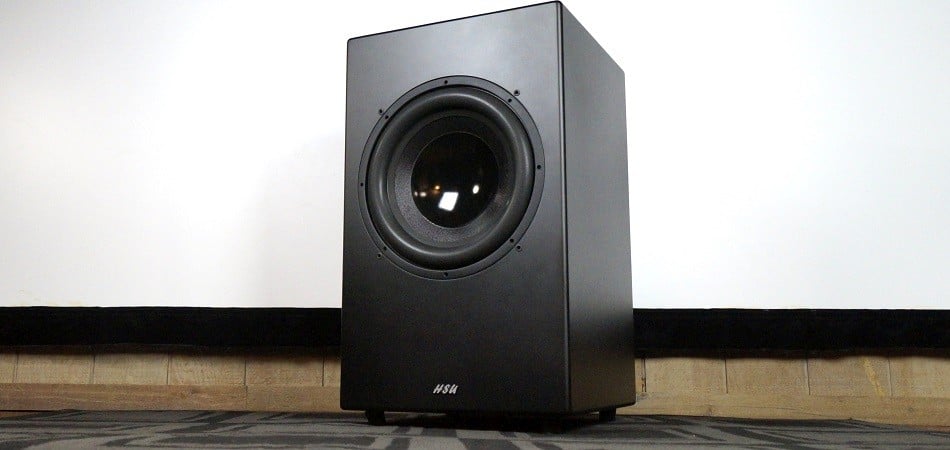

Once unpacked, we are met with a monolithic tome of a sub that only has the woofer and a Hsu badge at the lower edge to distinguish it. Outside of those distinguishing traits, it is a simple and minimal-looking piece of audio equipment. The satin black finish and rounded edges do help to soften its appearance, but they can’t hide the fact that it is a big subwoofer. This isn’t something that can be bought and hidden in a corner with the hope that other household occupants will not notice. The supplied grille can be used to hide the woofer for those who want to simplify its appearance even more, but users will need to accept its size (it is about 2.5 ft tall, 1.5 ft wide, and 1.5 ft deep). One aspect that makes it look so large is that it trades width and depth for height. Most subs and loudspeakers use depth to hide the true size of the enclosure, but Hsu opted to save user’s floorspace instead, so the VTF-TN1 was made to be more practical than eye-pleasing. I do prefer the aesthetic of the VTF-15h MKII with its interesting triangular ports. Nonetheless, as large subs, the VTF-TN1 is not bad-looking but a bit unusual compared to most subwoofers in this class.

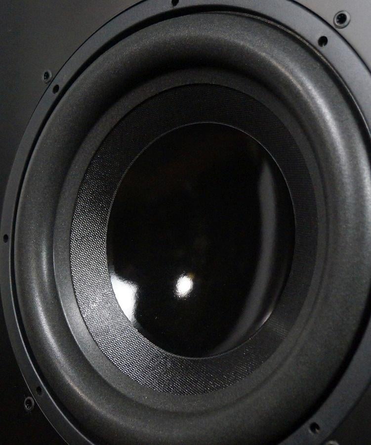

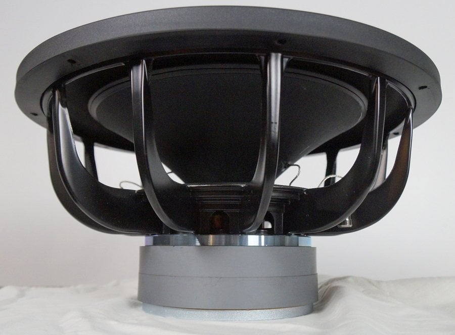

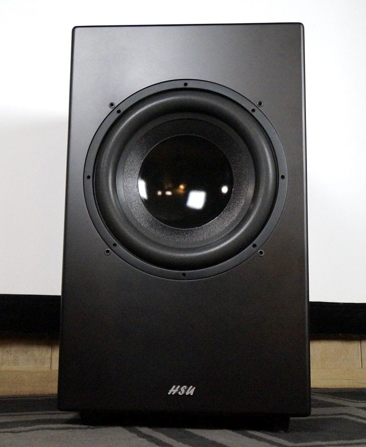

Let’s dig into the design analysis of the VTF-TN1 by starting with its driver. The cone is a fiberglass-impregnated paper cone with an inverted dustcap which is attached to the frame by a beefy nitrile-butyl foam surround. The basket is a cast aluminum design using 12 thick spokes that lead to the motor. The motor uses a 2” stack of two magnets that have a 6.75” diameter. The pole piece is undercut for a better magnetic field symmetry, and multiple shorting rings reduce induction effects which lessens even-order distortion as well as increases the driver’s bandwidth. Venting is done both underneath the spider and through the pole piece. It’s a capable driver and remains largely unchanged from what was used in the VTF-15h MKII.
It is powered by a 600-watt RMS class-AB amplifier that is one of the few in this segment that eschews DSP filters. It is an all-analog amp which brings some advantages as well as disadvantages. One disadvantage is that the amp controls can’t be as fine as what can be had with many DSP amps, especially those with app control. I don’t regard this as a big deal since most of the calibration of the subwoofer should normally be done through the receiver or processor end, not on the sub itself. On subs, I normally recommend users just set the phase to zero, low-pass filter to bypass, and the volume to a medium-to-high setting, and let the receiver/processor do the rest. There are exceptions for those who want to tweak their systems to perfection, but for typical users, that is a good standard practice. Another strength of DSP amps is that they can have much more sophisticated limiters during playback to ensure that the sub can’t be harmed from over-driving, thermal conditions, or poor electricity sources.

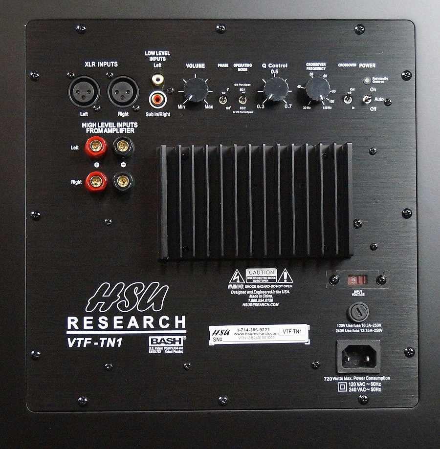

Hsu’s amp is a BASH design that combines some of the efficiency strengths of class-D designs with the fidelity of class-AB designs (although that description is a simplification). Connectivity consists of a pair of RCA inputs, XLR inputs, and speaker-level inputs. XLR inputs allows it to easily be integrated into higher-end systems or pro-audio systems that usually use balanced connectivity. Speaker-level inputs enable it to be easily used in very simple two-channel systems that don’t have bass management.
In addition to the usual controls of a volume
knob, phase switch, and low-pass filter (30Hz to 120Hz), the VTF-TN1 has an
operating mode switch which is important when changing the port tuning. The
operating mode switch has an ‘EQ1’ setting, which is what the sub should be set
to where only one port is open, and an ‘EQ2’ setting where the user can run the
sub with both ports open, one port sealed, or both ports sealed. Make sure that
one of the ports is sealed when running the sub in ‘EQ1’ mode as that mode’s
filter can NOT fully protect the driver when both ports are open. Configuring
the sub to ‘EQ1’ with a single port open enables the sub to achieve the deepest
bass, and using ‘EQ2’ with both ports open will allow more port-generated
output around its tuning frequency. While sealing both ports is an option, it’s
not one I recommend, because why buy a large ported sub if you aren’t going to
take advantage of the ports?

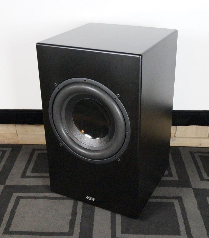

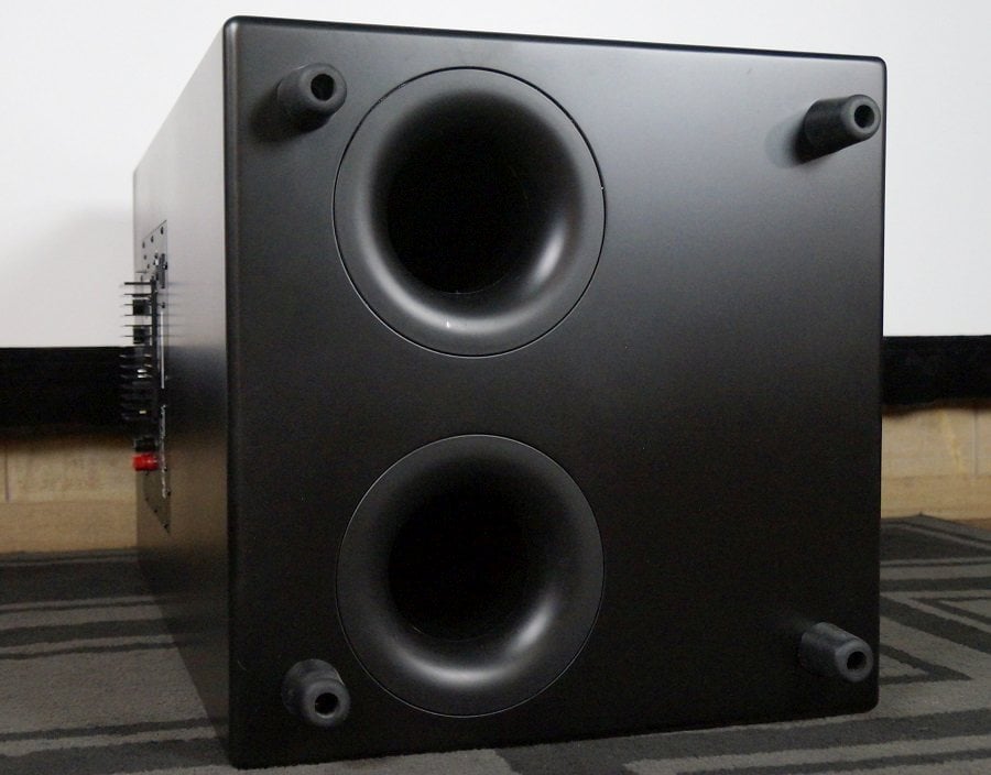

The enclosure is an unusual one in that it trades depth and width for height. Most subwoofers use depth as the dimension to increase internal space, and that can make the unit look more innocuous and furniture-like, but it does use a larger footprint. The VTF-TN1 is a tall boy. One advantage of the TN1’s smaller footprint is that it makes it easier to facilitate a multi-sub system since there may be more places that the subs can go in more circumstances. As regular readers know, Audioholics strongly advocates for multi-sub setups wherever possible since the acoustic destructiveness of room modes can be mitigated by the optimal placement of multiple subwoofers. For those who want to know more, Audioholics has many articles on the subject, but a good introduction can be read here: Room Modes and Standing Waves.

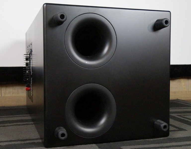

Another advantage to a taller sub is that it can have down-firing ports that do not need bends to increase port length. Many ported subs with very low tuning frequencies have bending in their ports to achieve such deep tuning, but those bends have to be handled very carefully to not dramatically increase port turbulence. The ideal is to simply not have bends. The VTF-TN1’s design allows it to attain this ideal as well as have the advantage of down-firing ports. By using down-firing ports, the VTF-TN1 gains additional loading from the confined floor space underneath the sub that may increase its lower-frequency output even more. Down-firing ports are also great at masking unintended port artifacts such as chuffing should that occur, so it reduces the audibility of any port related misbehavior.
The port tuning frequencies are 15Hz for a single port open, and 18Hz for both ports open. These are unusually low port tuning frequencies, especially at this price point. That could make the VTF-TN1 a very compelling choice for those who are chasing deep bass on a limited budget.

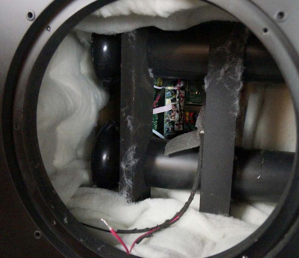

The enclosure is made from MDF and uses a 1 ¼” thick front baffle. There is a top and bottom brace as well as two mid braces shoring up the side panels’ strength. There is also corner bracing lining the enclosure edges. Sheets of acoustic stuffing line the interior panel sides. The feet are some tall rubber cones that look to give the ports enough breathing room to operate well, even in thick carpeting. The ports are heavily flared on both sides and have a 4” diameter with a 25” length. They are some of the larger ports I have seen on a subwoofer. Some small polyurethane pucks are included to provide an air-tight seal for those who want to plug the ports. The grille attaches to the enclosure via grille guides onto some metal tabs; the metal tabs are nice since plastic tabs have a habit of snapping off.
Taking a long view, the VTF-TN1 is a subwoofer that places function over form. The decision to exchange depth for height is probably going to alienate buyers who are chiefly concerned with aesthetics, but those prioritizing clean deep bass at high output levels look to have a great choice here. But let’s see that for ourselves in some real-world listening…

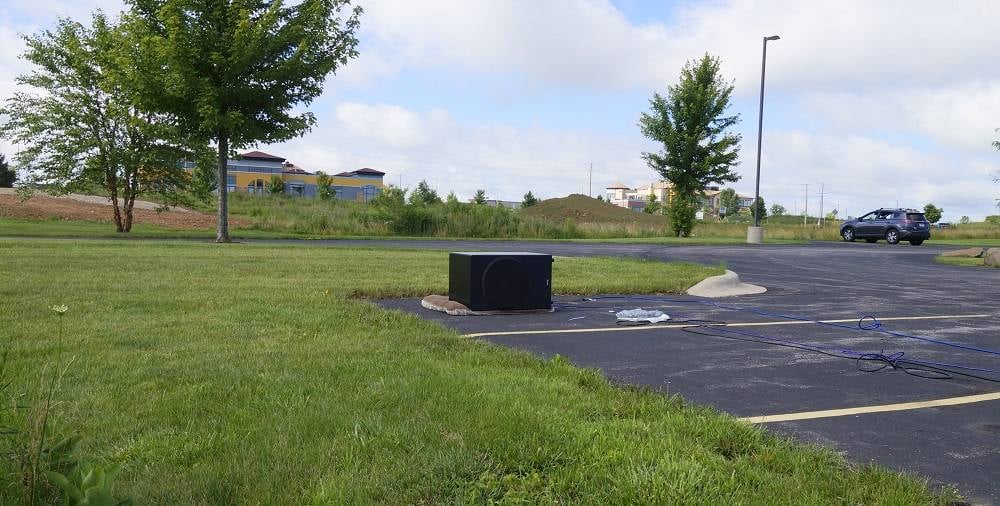

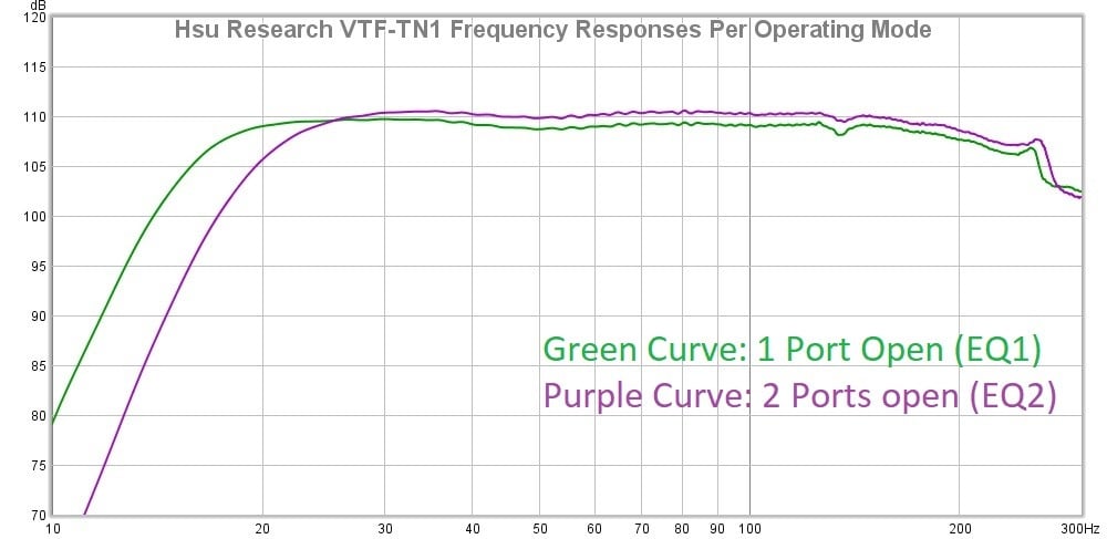

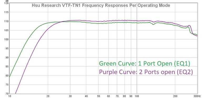

Testing on the Hsu Research VTF-TN1 was conducted with the microphone facing the woofer at a 1-meter distance with measurements scaled back to a 2-meter distance by subtracting 6dB. The temperature was recorded at 60F degrees with 90% humidity. The subwoofer’s gain was set to maximum, the phase was set to zero, and the low pass filters were set to bypass.
The above graph shows the measured frequency responses for the Hsu Research VTF-TN1 subwoofer. The shown responses are measured from both ports open and one port sealed with the Q control set to 0.7 for both. The responses are ruler flat from port tuning all the way up to 200Hz. These measured frequency responses are nearly ideal, and Hsu did not need to resort to DSP equalization to acquire them. This is what happens when you put a good driver in an optimal enclosure with carefully tuned port design. Something to note is the upper-frequency extension out past 200Hz. This allows higher than typical crossover frequencies which can better help to address room modes in multi-subwoofer systems. It also gives the system more dynamic range in mid-bass frequencies.

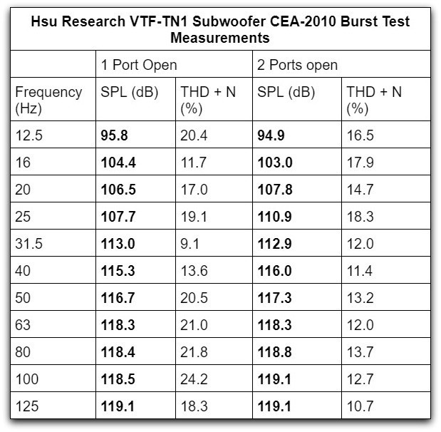

The above CEA-2010 measurements are short-term bursts that show the subwoofer’s clean peak SPL before heavy distortion sets in. Our measurements have been referenced to 2-meter RMS, which is 9dB down from the standard requirement for the measurements to be shown at 1-meter peak. However most publicly available CEA-2010 measurements are shown at 2-meter RMS, so we followed that convention.
The VTF-TN1 puts out some impressive
numbers with some real low-frequency output combined with a lot of mid-bass
punch. Both operating modes measured here exceed 100dB at 16Hz, but the single
port ‘max extension’ configuration allows cleaner deep bass and more output at
port tuning at such a deep frequency. With both ports open and sub set to ‘max
output,’ 20Hz to 25Hz performance is improved. Above that range, the headroom
is about even, although we are seeing a bit more distortion in single port mode
at the highest drive level. These numbers are largely a match with Hsu’s own
reported numbers give or take a decibel or two depending on frequency. The
tremendous mid-bass output is a good argument for experimenting with the
higher-than-typical 80Hz crossover frequency, especially in a multi-sub system.
118dB and higher is pretty prodigious output and is definitely something you
can feel in your chest. These numbers certify the VTF-TN1 to achieve our
Bassaholics ‘Extreme’ room rating meaning it should be able to handle a room of
up to 6,500 cubic feet in its ‘max output’ mode (2 ports open), and it gets our
‘Large’ room rating in its max extension’ (1 port open) mode.

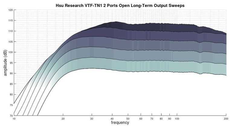

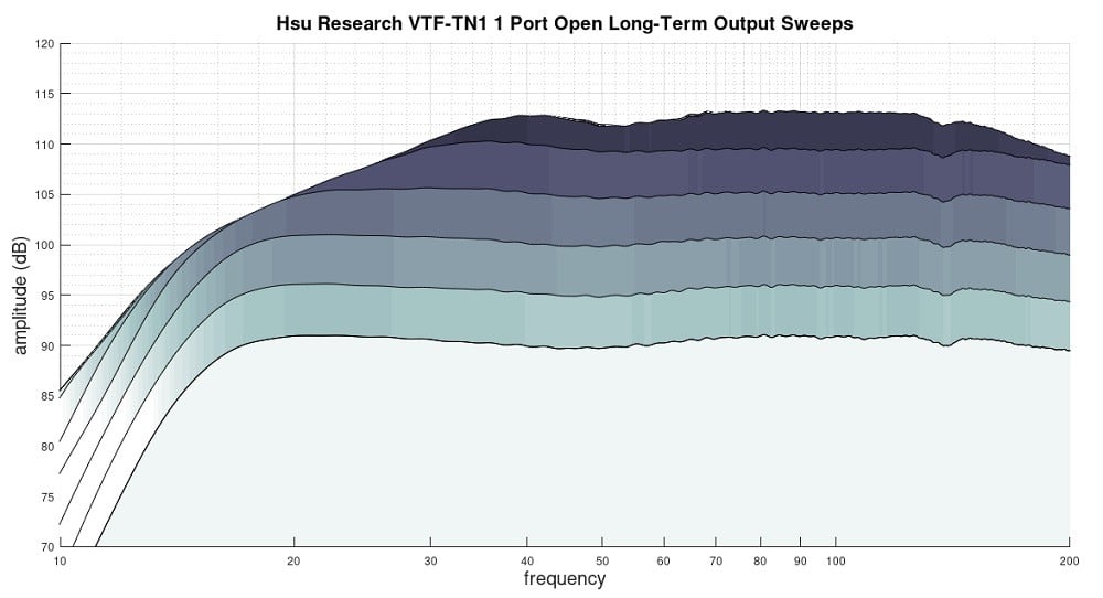

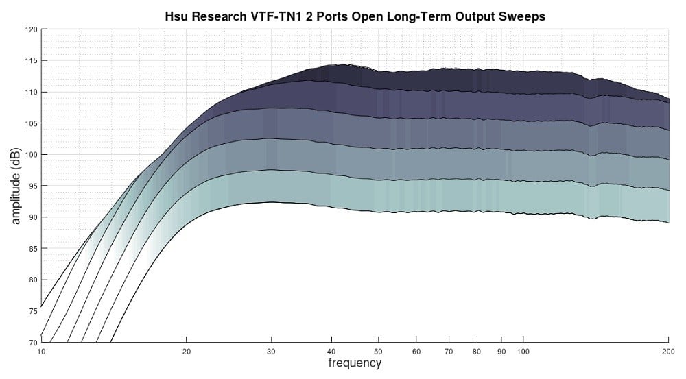

Testing for long-term output compression was done by first conducting a 20-second sweep tone where 50Hz hit 90 dB with the subwoofer 1 meter from the microphone (graph has been scaled to 2 meters for easy comparison with our other review measurements). We then conduct further 20-second sweeps by raising the gain by 5dB until no more output could be wrung out of the subwoofer. These tests show us the long-term continuous headroom that the subwoofer is capable of.
Both operating modes of the VTF-TN1 permit a great deal of output with most of the bandwidth exceeding 112dB continuously, but on the whole, the ‘max output’ mode with both ports open does offer more headroom overall. We can see how halving the port volume reduces port generated output, and the sub compresses output more at port generated frequencies when one of the ports has been sealed. With a single port open, the highest two sweeps compress on the low end, but with both ports open, the TN1 only compresses the response shape at the last few dB. It’s no surprise that leaving the ports open enables the greatest dynamic range. Use the sub with both ports open and the EQ control set to ‘2EQ’ for the most punch.

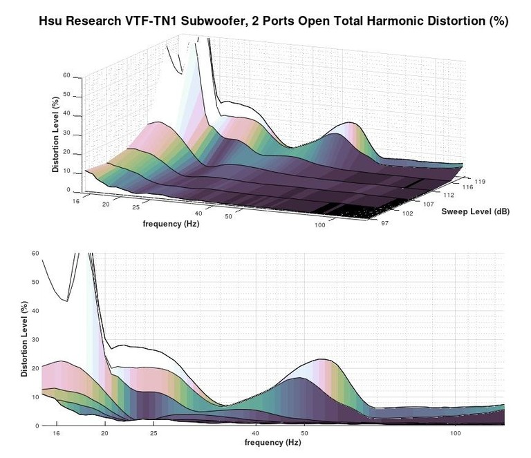

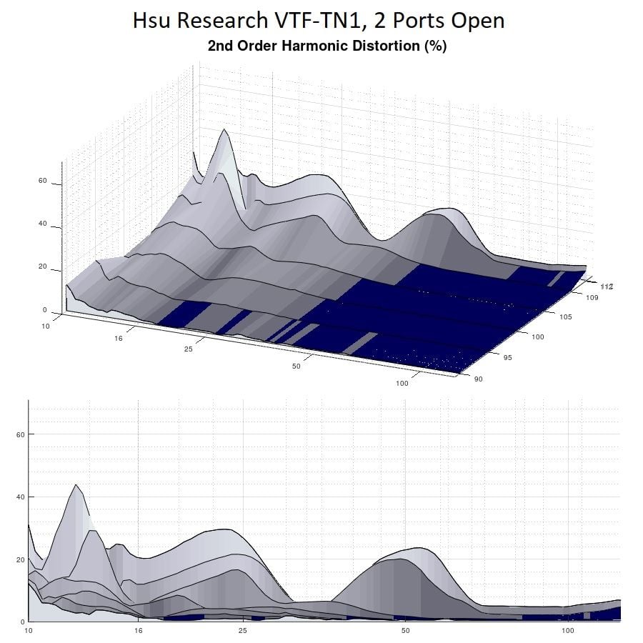

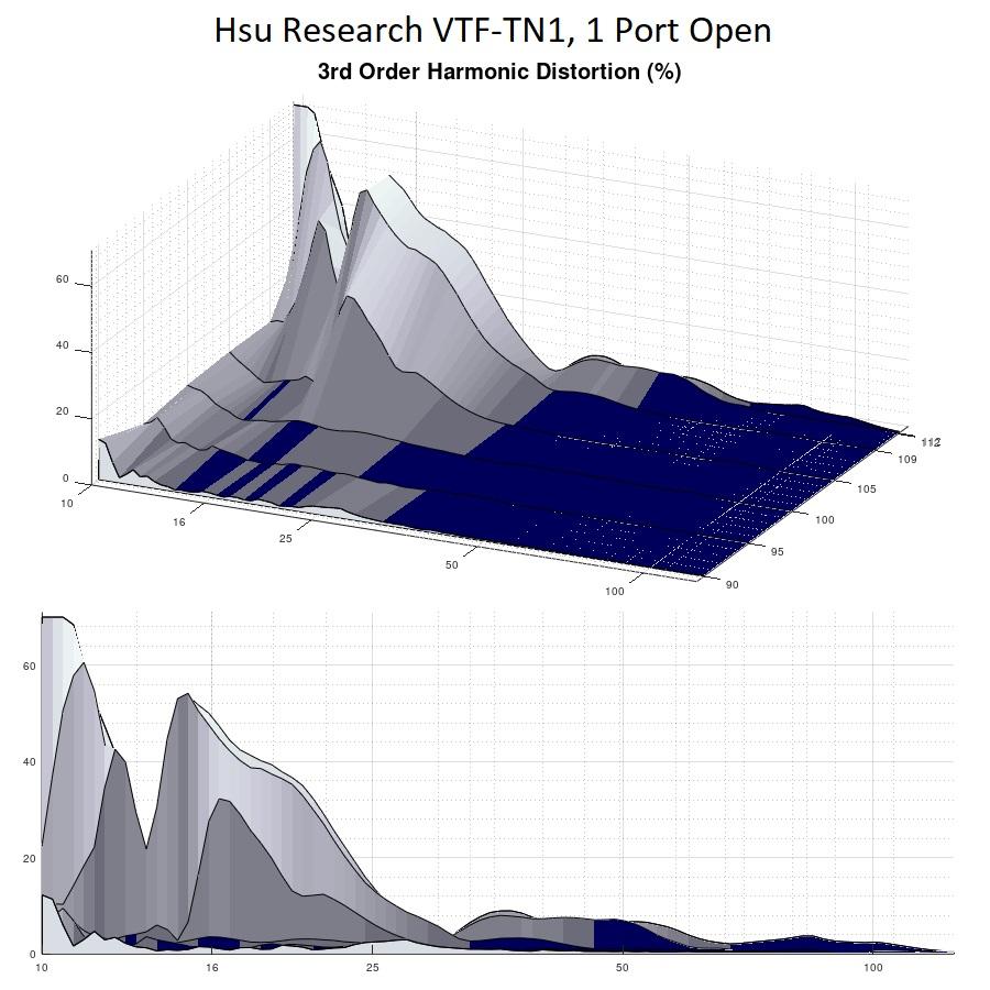

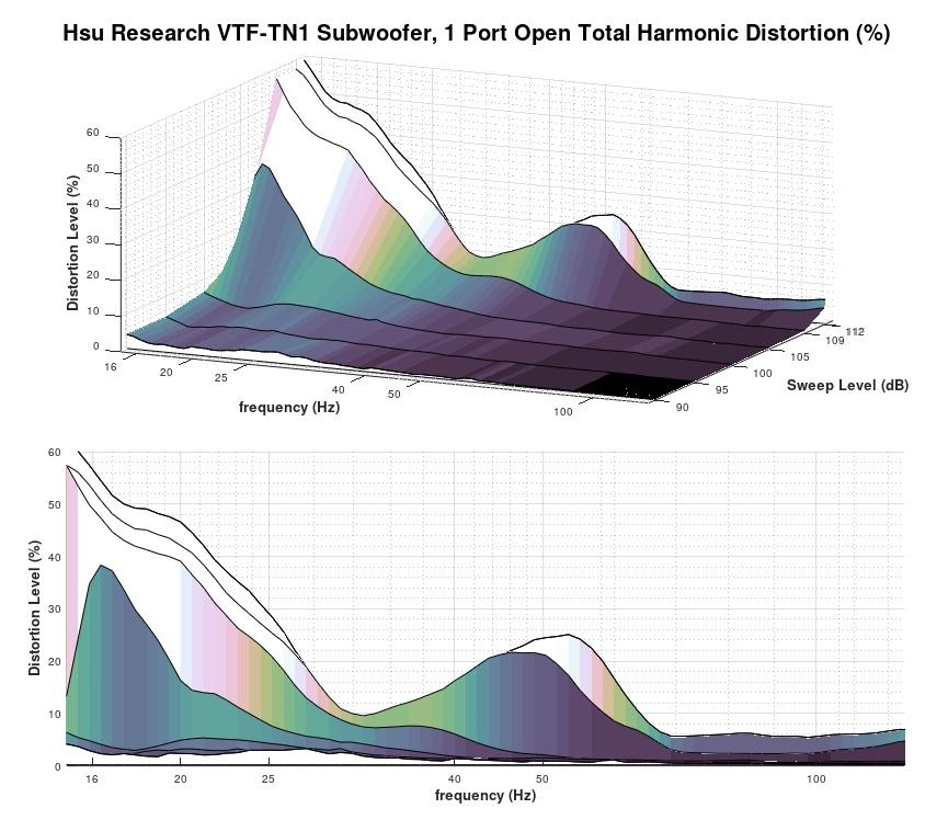

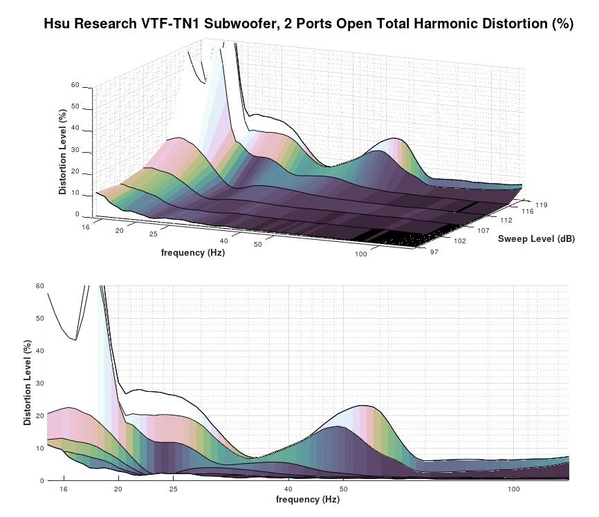

The above graphs show the corresponding total harmonic distortion to the long-term output graphs. Essentially, they depict how linear the subwoofer remains for the corresponding drive level seen in the long-term sweeps. The quantity being measured is how much of the subwoofer’s output is distortion and is shown here as a percentage.
The VTF-TN1 can be made to produce significant distortion but only at very high drive levels. At nominal drive levels, distortion products are essentially nonexistent, even at very low frequencies. As would be expected, distortion crops up at the lower frequencies first when the sub is starting to be pushed hard. Using the sub with both ports open and set to ‘2EQ’ offers the most clean headroom. Were DSP available, limiters could be set up to prohibit output levels and frequencies where distortion occurs but only at the expense of headroom. The good news is that users will rarely drive this sub to levels where distortion as a percentage runs above single digits. It is only at the last 5dB where distortion starts rising across the bandwidth as we approach a continuous 110dB of output. Up until the highest drive levels, the VTF-TN1 is an extremely clean subwoofer.
The above graphs depict measurements of the constituent harmonics from the long-term output sweeps and are what the total harmonic distortion measurements are composed of for the 2nd and 3rd harmonics. These individual harmonics can give us a clue as to what might be the cause of some quirk or non-linearity. We are only showing the 2nd and 3rd here because they more or less reflect the higher even-order and odd-order behaviors, although higher-order harmonics tend to be much further down as a percentage of distortion compared to the second and third.
In order not to deluge the readers with graphs, we will only show the harmonic distortion components for one operating mode, since the ratio of odd-to-even harmonics is largely the same for any ported operating mode of the VTF-TN1. In this ‘max extension’ mode with a single port open, the distortion generated is a mixture of even and odd harmonics. As the driver hits its maximum excursion limits, the way it begins to ‘clip’ the output results in a complex mixture of distortion products. This isn’t bad or good, and every driver will produce distortion when pushed hard, but some will veer toward even or odd harmonics as the main bulk of distortion output whereas the VTF-TN1 produces a bit of both. Because of this complexity, these graphs are mainly of academic interest, and pretty much the only way they will result in anything relatable to audible experience is if the user blasted a sine wave at maximum drive levels.

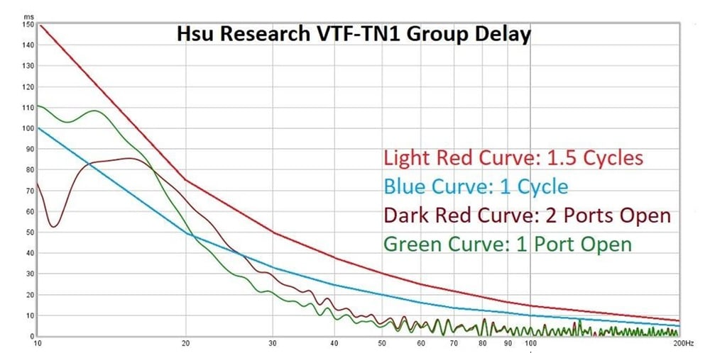

Group delay is the measurement of how much time it takes for individual frequency bands of an input signal to be produced by the speaker. It can indicate that some frequency components are developing slower than others or are taking longer to decay. It is generally thought that 1.5 sound cycles are needed for group delay to be audible at bass frequencies, although there is an argument that group delay should remain under 20ms to be completely unnoticeable, but that is likely meant for mid and upper bass frequencies.
The group delay shown by the VTF-TN1 is quite good, and it doesn’t even pass our ‘worst case scenario’ of 20ms until below 40Hz which is well below the frequency range of the vast majority of music content. The sub sounds sharp and it measures likewise. Plugging a port does bring the group delay down a bit from about 18Hz to 50Hz, but I doubt that will translate into anything even remotely audible. Running it in sealed mode will bring group delay down in that range a bit further, but I would discourage anyone from running the TN1 in a sealed operating mode since it sacrifices a lot of deep bass output for a small decrease in group delay. The TN1 does not exceed a cycle of group delay until very deep bass frequencies, which is expected given its very low port tuning frequencies. Those looking for a sub that has good transient behavior as well as big deep bass have a great choice here.

distortion up until its highest drive levels. Its time-domain behavior is
terrific as well with all mid-bass frequencies staying under 10ms of group
delay and deep bass never even touching 1.5 cycles of delay. That shows proper
ported subwoofer design, and those who think ported subs sound laggy or slow
should hear a VTF-TN1 in a properly calibrated setup.
