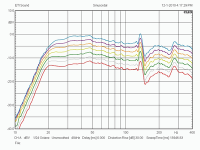

The first part of testing was to measure the frequency response from a modest output, all the way to the point where the system was clearly compressing and had hit the output wall, so to speak.
Funkywaves Frequency Response at Various Output Levels
Only some slight compression can be seen at the top most curve. If I had to guess (I am guessing) I would say this lessening of output is due to turbulence of air through the port. Since the curve does not tilt up prior to the cutoff (Like the Hsu does) it indicates the Driver is not losing motor force, nor should it be as the port and amp are doing all the heavy lifting at 20 Hz. Like all the other systems, this box was tested at 1 meter, lying on its side, microphone placed midway between the center of the port and the center of the driver so as to get the most accurate reading with the microphone very close. A 14 second sweep was used, and the data was smoothed to 1/24th octave resolution. (Translation, we don't make our curves with a ruler and graph paper like some folks...). We can also see that this driver loses about 3db of sensitivity from 50 Hz, by the time it reaches 100 Hz.
