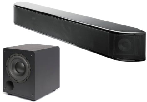

Atlantic Technology released the FS-7.0 a while back and they've reported success with the unit. For CEDIA this year, they've released an updated version of the unit, called the FS-7.1, with improved voicing, a new enclosure, and an upgraded companion subwoofer, the SB-900. First the surround bar.

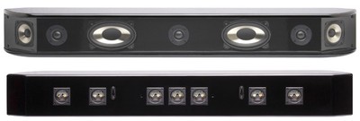

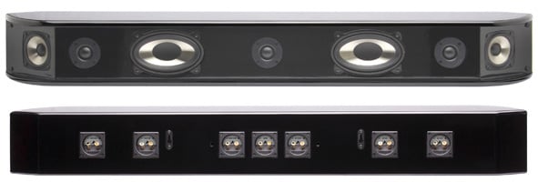

The FS-7.1 has eschewed the boxy enclosure of the FS-7.0 for angled sides. This places the side drivers at an angle into the room rather than pointing straight out to the side walls. This angling is designed to improve the surround effects by lessening the reliance of the FS-7.1 on the side walls. The speaker uses two 4" by 6" drivers on the front baffle are paired with three 1" tweeters. On the sides they have a single 3.25" driver. Each of the woofers are a dual voice-coil driver that handles more than one channel. The two on the front handle the left (or right) front channel and "half" of the center channel. The woofers on the sides handle both the side and surround channels.
fs-71-front-back
When you look at the back of the speaker, you'll find seven speaker-level inputs (binding posts) indicating that you'll need a receiver to power this speaker. These are the push-type terminals so you'll need to employ a bare-wire connection. Atlantic Technology has included adhesive rubber feet for either shelf mounting (they have larger ones for angling the speaker) or to attach to the back if you wall mount with the keyhole mounts. Threaded inserts are included which can be used for suitably equipped flat-panel TV mounts.
The SB-900 is the successor to the SB-800. The SB-900 has an 8" long-throw woofer in a ported enclosure that dips down to 32 Hz. The FS-7.1 has a low end response down to 75 Hz (well within the recommended 80Hz crossover point suggested by THX) and should mate well with the SB-900. The SB-900 sports a 125 watt amp in a 13" by 13" by 11" box. This should be small enough not to offend the sensibilities of most spouses. The SB-900 is rated for medium sized rooms which Atlantic Technology defines as 1800-2500 cubic feet. Out of the box you'll need a wire to connect a wire from your receiver to your SB-900 but Atlantic Technology does offer an optional wireless solution (WA-50) for $200.

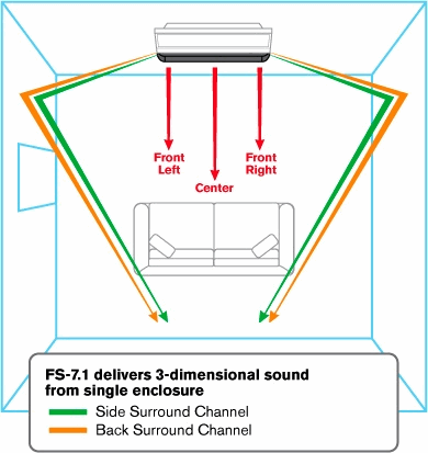

Okay, let's get serious here, there isn't a statement in this passage that isn't either irrelevant or false (save, arguably, one). "Instant hit?" We'll have to take your word on that one. Let's face facts, though, having seven channels on a soundbar is like having five wheels on a car. Sure, for people that count wheels, it is impressive. For people that care about performance, they know that that extra wheel (or extra channels in this case) aren't indicative of increased performance and very well may do the opposite. Also, saying that angling the speakers on the side in any way alleviates the reliance on the side walls is ridiculous, especially when you include this graphic in your press release:
AT-diagram
Maybe I'm not seeing something here but it looks like the side walls are still pretty much in play. Sure, the angled speakers are at least pointed into the room but it isn't like they don't need the side walls to operate correctly. This graphic also, ironically, shows just how irrelevant the surround back channels are in a surround bar. Given that the two channels are coming from the same driver, bouncing off the same wall, and reaching the ear at the same time, if anything, the surround back channels would confuse the listener's ear even more than having the side channels alone. Plus, for those that might use those channels for a powered Zone 2, you've just unnecessarily tied up two amps in their (most likely) budget receiver that doesn't have amps to spare.
