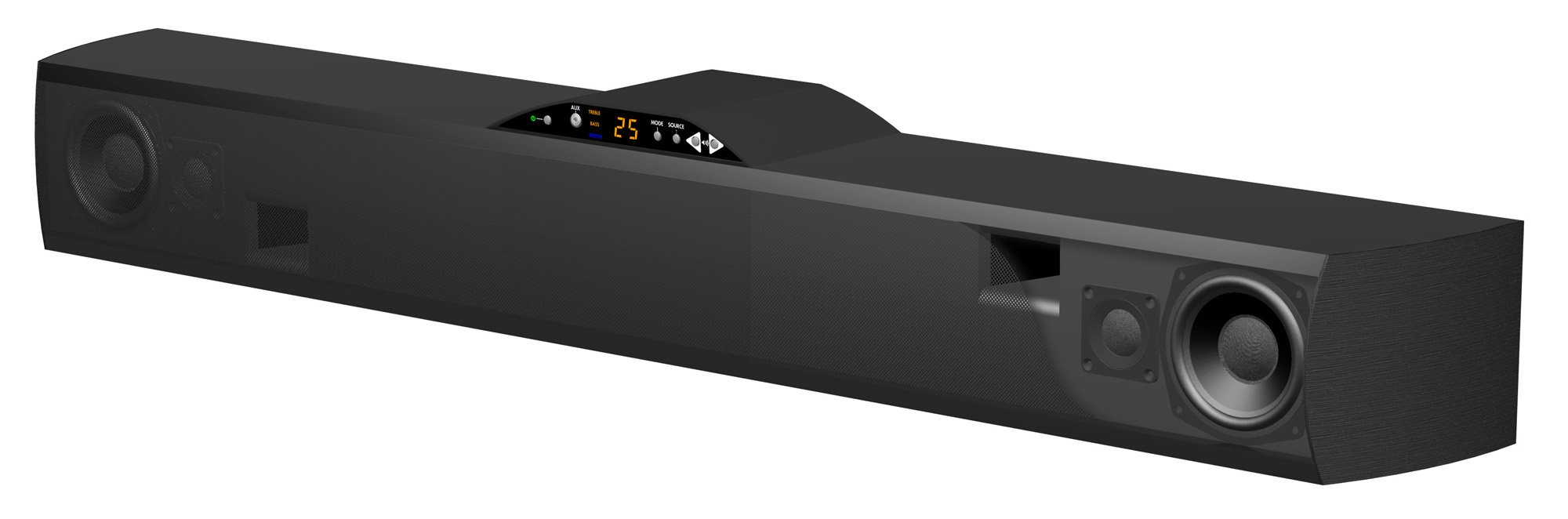

Atlantic Technology revealed their new H-PAS PowerBar 235 which, like their H-PAS tower speakers debuted at last year's CEDIA Expo, is said to defy the laws of physics producing deep rich bass beyond conventional speakers in its size class.
Using the company's patented H-PAS™ bass technology, Atlantic Technology is so confident in this product that they are marketing it as the world's first Soundbar that doesn't need an external powered subwoofer to provide satisfying bass output. The PowerBar 235 does sport a subwoofer out to be mated with their SB-900 subwoofer for those wanting even more bass impact. The H-PAS PowerBar 235 is a two-channel powered sound bar with digital surround processing for 3 & 5 channel simulated output, all contained in a single 42- x 5¼- x 5¾-inch cabinet with stated frequency response down to 47 Hz at -3dB. The built in amplifiers provide 2 x 30 watts to a pair of 4" midbass drivers and 1/2" tweeters. It has two analog inputs and 1 digital toslink input.
The Atlantic Technology H-PAS PowerBar 235 can be wall
mounted beneath a video display or inverted for shelf mounting. To
accommodate these different modes, the control panel display can be
electronically rotated for correct view in either configuration.
Alternate display labels are also provided for both orientations.

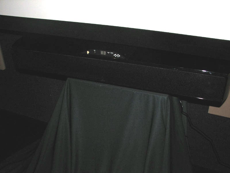

Peter was so pleased with the results of this product that we had to
take a few minutes out of our busy schedule covering CEDIA 2011 to take a
listen. Needless to say, my wife absolutely loved the demo. Her comments were that it sounded quite enveloping and she actually forgot she was listening to a soundbar during the demonstration. I must admit walking into this demo skeptical until after only a few moments when I heard the products true potential. The demo room was packed with other interested enthusiasts, so I crept around the back of the room listening at various positions. No matter where I was, I found the bass extension was satisfactory and the vocals were nice and clear. I did hear some driver lobing when shifting my position from left to right but that is to be expected with any mid/tweeter array horizontally mounted. This is an something virtually all soundbars suffer from since they don't have the real estate to place the drivers vertically. I did ponder if one day Atlantic Technology could use a coaxial driver to completely eliminate this issue. However, considering the sound output the H-PAS Powerbar 235 was producing in the demo room, I'd certainly take one as is for a secondary bedroom and surely be quite satisfied. Peter asked us to guess at the retail price. I shouted out $900 and he came back with a price tag targeted to be a couple of hundred lower. WOW!
After the demo, we even checked under the Soundbar to search for a hidden sub but instead we found old Outlaw boxes used to prop up the product. Good one Pete :)
I was unable to take pictures with the PowerBar 235 grille cover off since it was a prototype design which was a bit finicky to be handled. Do expect a detailed review of this amazing and unique product coming from us soon however! Getting this product in our own acoustical environment on familiar source material will really help us understand the product's true potential.
