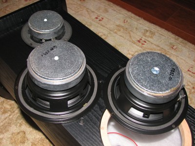

The Drivers
I was quite taken to find drivers with such substantial motor structures in such a modestly priced system. Instead of getting the typical ½” dome tweeter with wimpy neodymium slug magnet (like found on more expensive models from some of the big name brands), Pioneer used a real 1” soft dome tweeter with a powerful ferrite motor structure and a waveguide in the entire speaker lineup to improve sensitivity, low end response, and control directivity. The SP-FS52 towers sport three 5 ¼” stamped basket woofers. The two bottom bass drivers employ vented pole pieces to reduce turbulence under the dust cap and improve thermal venting. This is a detail absent on drivers from some Internet-Direct speaker companies selling bookshelf speakers for more money than this entire 5.1 system! The SP-BS22-LR and SP-C22 utilize 4” versions of these drivers.

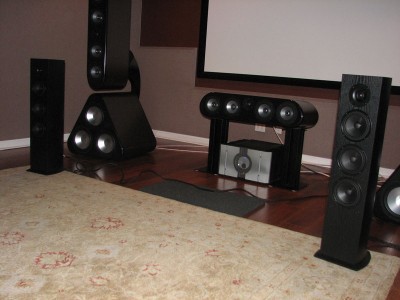

Listening Scenario #2 Audioholics Showcase Theater Room
For the second scenario, I positioned the Pioneer SP-FS52 towers about 5ft from sidewalls and around 8ft from the back walls and spread apart about 10ft from each other, which was about two feet shy of the distance from my primary listening position. After experimenting, I found they sounded their best with little toe-in since the top end of these speakers is a bit pronounced. I used my Marantz PM-11S2 200wpc integrated stereo amplifier and the Oppo BDP-105 Blu-ray as the source connected balanced. All interconnects were furnished by Blue Jeans Cables (1694A Coax) and Kimber 8PR speaker cables with WBT compression banana plugs. I also connected the entire SP-FS52 5.1 system to the Emotiva UMC-200 and matching UPA-500 5-channel amplifier for multi-channel music and movie listening.

on the Blu-ray transfer over the original theatrical release. The SP-C22 did a commendable job showing this
off, though I did feel the vocals were a bit sibilant. I left the grille on and
didn’t angle the center channel up as high to tame it. The system sounded well blended as a
whole. The SP-BS22-LR’s were serving
well as surround duty (bass-managed to small) and the SP-FS52 towers did
exceedingly well running full-range to supplement the bass for the little
SW-8MK2 subwoofer. The sub did provide a
good deal of tactile feel but it just couldn’t produce the last octave of bass
present in this movie. I did detect a
lot of port chuffing when I was driving the sub hard, but don’t forget my demo
room is almost 6,000ft3. Let me make this perfectly clear; in a
small room this sub would behave much better.
