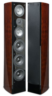

EMP E55Ti Floorstanding Speakers
When it comes to tower speakers that look great and actually sound good, EMPTek offers some of the best budget solutions from what we’ve tested. The E55Ti ($795/pr) is a significant upgrade over the older E5Ti ($500/pr) which we feel is worth the price difference. The E55Ti’s just have a much bigger and more effortless sound to them and their tall stature just makes for a great visual impression. It's a 6 driver tower boasting (3) 6 1/2" bass drivers, dual 5 1/4" phase plug mids arranged in an MTM configuration with a 1 " fabric dome tweeter sandwiched in the middle.

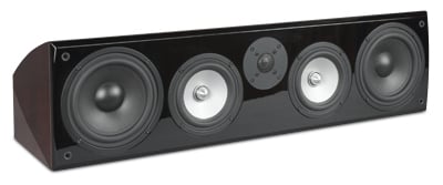

EMP E56Ci Center Channel Speaker
EMP’s original center channel E5Ci ($220) is a standard horizontally oriented MTM featuring dual 5 1/4” phase plug mid drivers and a 1” soft dome tweeter. It just doesn’t have the output capabilities to keep up with the E55Ti towers which is why they recently introduced the E56Ci ($450/ea) matching center channel. The E56Ci center channel is a 5 driver – 3-way rear ported speaker. It boasts dual 5-1/4” poly matrix midrange drivers nestled with their 1” silk dome tweeter. An additional 6-1/2” polypropylene woofer is located at each end of the cabinet to extend bass response which EMP rates at 50Hz (-3dB). This speaker has dual rear ports but doesn’t come with port plugs for those installing it into a cabinet. Hopefully after reading this mini-review, EMP will remedy that.

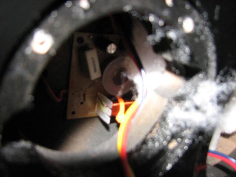

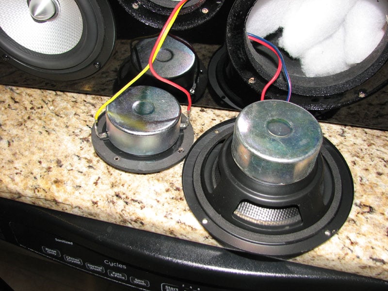

EMP E56Ci Center Channel Inside Look (drivers left pic; crossover right pic)
The E56Ci is quite a large center channel (31” wide) with an unobtrusive design. Its tapered cabinet and narrow height (8”) makes it fit in either above a display on a cabinet shelf or below it stand-mounted. I took apart the E56Ci to get a look at the internals. The E56Ci cabinet construction is very similar to the rest of their speakers (0.6” side walls and 1.2” thick front baffles). Thickening up the front baffle really adds a lot of rigidity to the speaker where it’s needed most and allows EMP to get away with slightly thinner than normal sidewall cabinets which also ultimately saves on shipping weight. While these speakers aren’t built to the standard of a multi thousand dollar speaker system from the likes of Revel, Usher Audio or RBH Sound Signature Series products, their construction and the materials used are on par with products in this price range and even slightly higher in some aspects. The drivers feature stamped baskets, which again is pretty standard for this price class of speaker. The crossover has a mix of air-core inductors and poly caps for critical circuit components and iron chokes for areas that aren’t as critical and also cost prohibitive than better performing and larger air-cores. The E56Ci is rated at 6-ohms with a sensitivity of 87dB / 1 watt and recommended for usage with 50-175 watts though we’d always recommend choosing more not less power amps when selecting your power source.

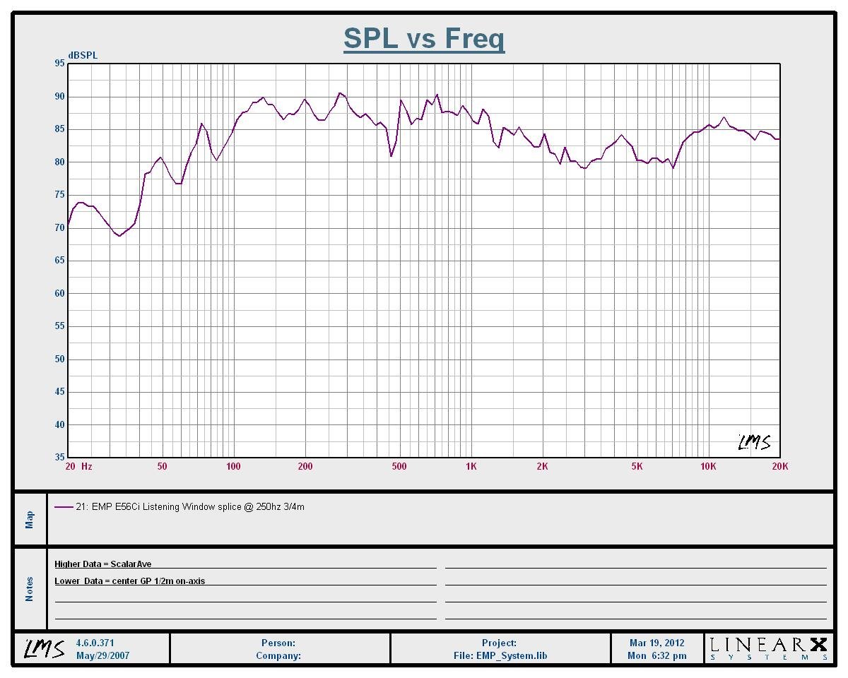

EMP E56Ci Center Channel ¾ Meter In-Room Frequency Response without Port contribution

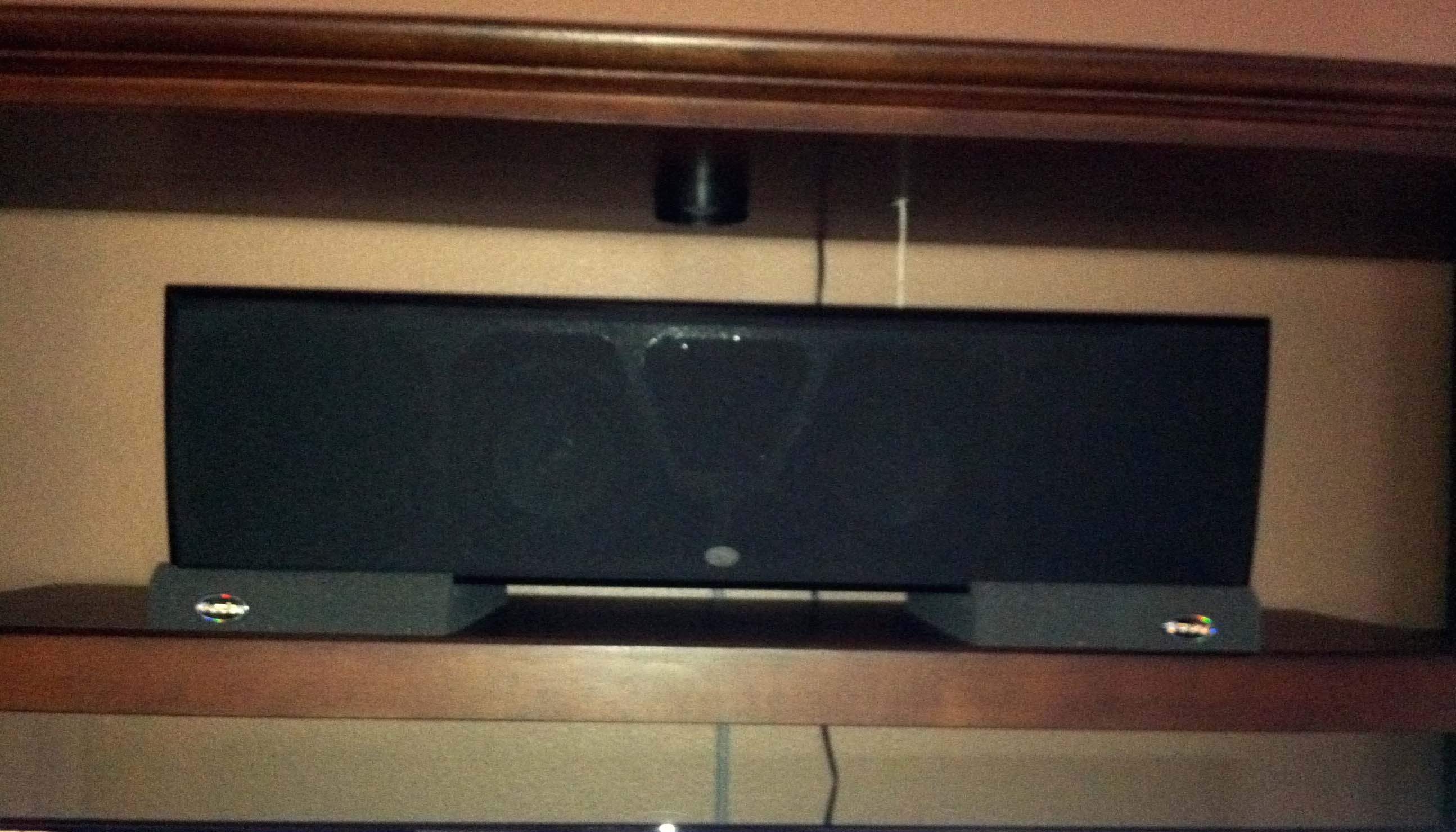

After installing the EMP E56CI center channel speaker into the entertainment center, I took five in-room measurements at 3/4 meters (+- 15 deg horizontal, +-15 deg vertical, and on-axis) averaged them and spliced them at 250Hz with an additional 3/4 meter groundplane measurement I made to derive a “listening room” response curve. The -5dB dip in the 2-5kHz range is exaggerated because the mic was a bit too close to the speaker to produce a fully converged farfield response. I purposely did this to remove as much of the room influence from the measurement as possible without having to apply gating or smoothing to the measurement. This also means the port contribution wasn’t factored in so you can expect more bass extension than what is shown in this measurement. Regardless, the response of this speaker is very linear both on and off-axis and the speaker produces good usable bass extension down to the 60Hz range.
EMP E56Ci Center channel with Auralex Mo-Pads
When installed in the wall unit, I
initially measured a nasty peak at 250Hz which I determined was caused by
resonance between the speaker and surface of the furniture it was installed in. To resolve this, I installed a pair of Auralex
Mo-Pads which decoupled the speaker from the cabinet and also slightly tilted
it down towards the listening area. I also
crossed the speaker over at 80Hz to reduce the bass output which was necessary
from the excessive boundary gain caused by it being placed into an enclosed
area. This was a great tweak that ultimately
made a significant impact on performance, most notably in vocal intelligibility
which I will discuss in the listening portion of this article.

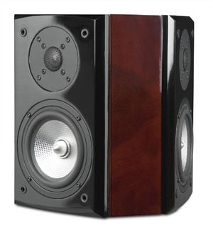

EMP E55Wi Surround Speakers
I’ve
been waiting for EMP to release an on-wall surround speaker since they launched
the brand a number of years ago. The E55Wi ($499/pr) has two sets of 5 ¼”
mid drivers with phase plugs and 1” silk dome tweeters located on two baffles
90 degrees apart. The drivers are all
in-phase meaning it’s a bi-pole type surround speaker. The goal is to provide a wide
surround field . EMP chose to make all
the drivers in phase because most people installing their speakers are only doing
5.1 systems. Personally I like a hybrid
variant where the forward firing tweeters are out of phase (dipole) to help
better diffuse the surround soundfield at the listening position. If you are running back channels, you may
prefer this as well. To accomplish this,
simply remove the forward firing tweeter, reverse the phase and reinstall it
for both speakers. I recommend trying
both ways to see what you prefer in your situation. If you’re listening habits favor movies over music, you
most likely will want the forward tweeter out of phase.
Hanging the E55Wi’s was a breeze. I simply got me some concrete anchors, drilled them into the desired location on each wall separated by the same distance as the holes on the back of the speaker, inserted the screws leaving about ½” protrusion, and hung them like a picture frame. I was a bit disappointed EMP didn’t include the hardware to do this but I keep a large stock of concrete anchors in my tool box since my wife is always having me hang things around the house.

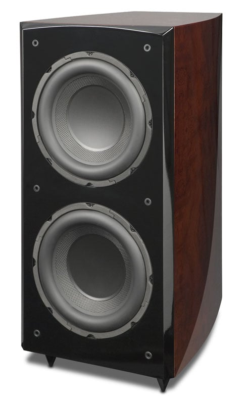

EMP ES1010i Subwoofers
I just completed a fairly comprehensive review of the new EMP ES1010i subwoofer. It’s basically a 250 watt powered dual 10” bottom ported sub with similar construction and aesthetics as the other EMP Impression series products.
Prior to taking delivery of these subs, I was a bit reserved in recommending them knowing their low end output was a bit limited. But, my sister-in-law wanted the subs to match the rest of the system and also not occupy too much floor space. Surprisingly the ES1010i’s provided ample slam when run in pairs and with the E55Ti towers operating full-range. Having four 10” drivers and six 6 ½” drivers playing bass into the room was truly an energizing experience. At $499/ea these subs represent a good value and produce good bass in a very attractive and relatively compact form factor.
In order to maximize performance of this system while also preserving the aesthetics of the listening space which also functions as a family room open to a formal dining room, dual subs was a must but placement was challenging.
My sister-in-law under estimated the size of her wall unit and I was biting my nails when I initially saw it placed against the front wall of her room thinking I wouldn’t have enough space for the E55Ti’s and the ES1010i subwoofers. I’ve always been pretty good at the game Tetris so I took my chances and moved stuff around till I got one of the subs to fit.

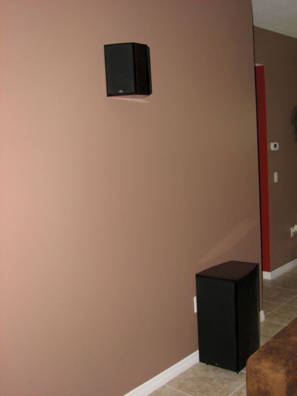

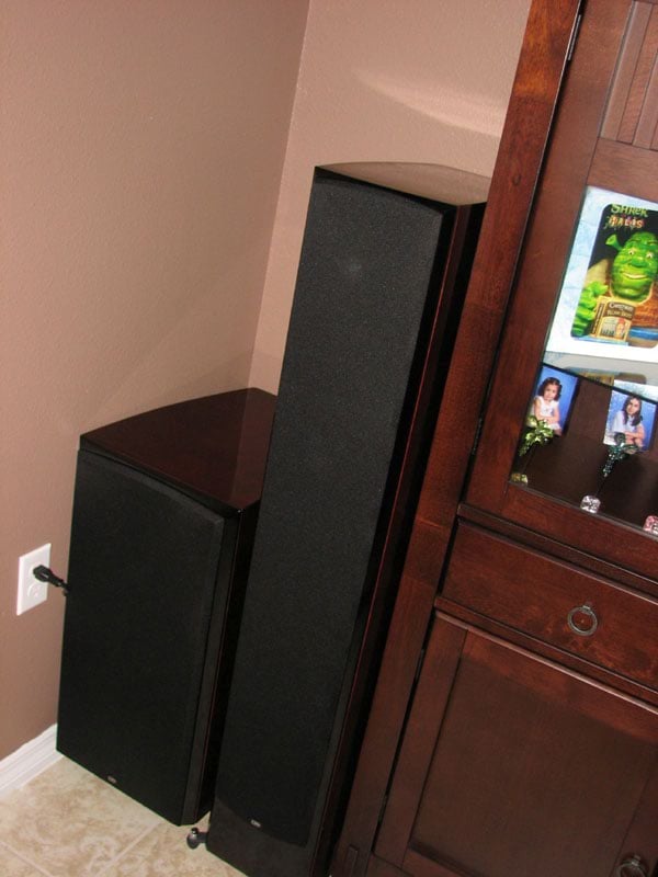

EMP ES1010i with E55ti tower (left pic); ES1010i & E55Wi Surround (right pic)
I diagonally located the other sub on the opposing wall. This produced a pretty darn near ideal response across the entire couch facing the TV which is where they’d spend most of the time sitting and listening. The response on the far left couch wasn’t as good but it was also pretty far off axis from the display too. I always reserve such a less than desirable location as the “mother-in-law seat” and in this case mine was quite content sitting there.

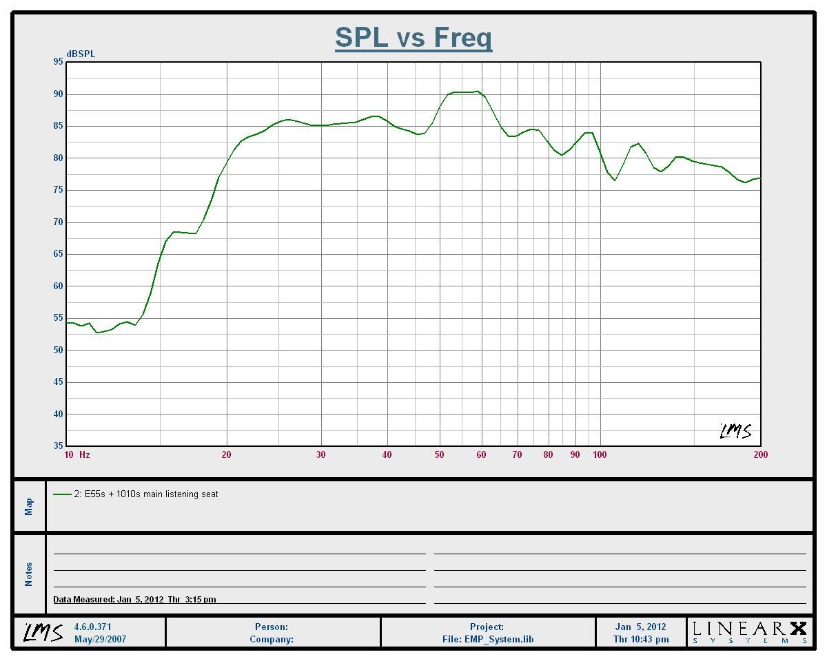

EMP E55Ti towers + Dual ES1010i Subwoofers In-Room Frequency Response @ Listening Area
As you can see, the response is very even from 200Hz down to about 25Hz with a gradual roll off (-5dB) at 20Hz. This measurement is NOT smoothed and was taken at 12ft where the primary couch is located.

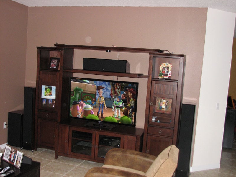

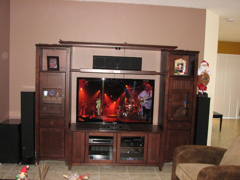

Words cannot adequately describe how much I loathe installing audio equipment into entertainment centers. They almost NEVER have enough depth to accommodate amplifiers or large receivers and the back-wall cutouts are either non-existent or too small to accommodate anything more than dental floss thick wiring. To make matters worse, the furniture my sister-in-law purchased did NOT permanently affix the horizontal shelf holding the center channel to the main body. Any slight move of either horizontal rack caused the shelf to completely collapse which it actually did and almost crushed my neck in the process. I sputtered numerous colorful metaphors at the furniture company under my breath as I warned both them and my sister-in-law about this and they both assured me the furniture would be secure when I was ready to install the equipment. Suffice it to say, the furniture company had to come back, replace the now broken shelf and use L-brackets drilled into each cabinet rack (like I requested) to ensure this wouldn’t happen again. Seriously, this process literally takes less than five minutes to do and not only stabilizes the furniture but also infinitely increases safety to the installer. I dedicated this much real estate in this article to this very important point because I could have literally become paralyzed over such a ridiculous and avoidable oversight.
A/V Components installed into Furniture
With the furniture secured, I drilled out bigger cutouts in the back to route the cabling (all furnished by Blue Jeans Cable) and power cords. I installed all of the components including an Ethernet hub to provide a wired Internet connection to the Samsung Display, Oppo BDP-93 Blu-ray player, Yamaha RX-A1010 A/V receiver and Nintendo Wii. This was necessary to tap into all of the networking features this system offers such as: Internet Radio, Pandora, Netflix and the iPhone App to control the receiver via your iPhone or iPad device.
I managed to fit one ES1010i sub in the left front corner while positioning the E55ti towers adjacent to each side of the entertainment center and applied slight toe-in directed towards the center “money seat”. The outriggers were installed on the E55Ti’s to provide stability which is essential since my sister-in-law has a rather active 9 year old boy and a lot of visitors. Nothing is worse than watching one of your tower speakers from across the room take a dive from an accidental bump as you run in slow motion yelling “NO!” powerless to stop it. For the second ES1010i subwoofer, which was located on the right rear wall diagonal to the front left sub as previously mentioned, I placed electrical tape on the back panel controls to prevent people from tampering with its settings. This was important since the plate amp was facing the dining room, well within the line of site of curious visitors entering the room. The E55Wi on-wall surround speakers were mounted about 3 feet above ear height (seated position) on the side walls slightly behind the listening area. The TX-615 in-ceiling speakers were positioned about 8 feet apart. I left all tone controls to flat and did NOT pivot the tweeter since the speakers were firing directly down to the listening area (though a few feet back from the couch) from the ceiling and thought it was a better option to have the drivers firing slightly off-axis to provide a more diffuse soundfield.
I configured the bass management in the Yamaha RX-A1010 A/V receiver as follows:
- Mains: Large
- Center / Surrounds: Small
- Bass Output: Subwoofer + mains (routes main channel bass to both main speakers and sub)
- Crossover: 80Hz
I level matched all of the speakers to 75dB using my OmniMic calibrator kit SPL meter set to slow response, C-wt). The sub channel was deliberately set 3dB hot for added impact. I set speaker distance based on physically measured distances, while I manually adjusted subwoofer distance until I got the best blend between the main speakers and subs for the two primary seats, again using the OmniMic sweeping between 20Hz to 200Hz.
I absolutely loved how the Yamaha RX-A1010 communicated with the Samsung Display and FIOS TV box via HDMI. It automatically switches sound between the TV speakers (when the RX-A1010 is turned off) to the home theater speakers (when the RX-A1010 is turned on). You can even use the remote control from your HDMI compliant TV to control volume level on your RX-A1010! For the first time in my installation history, I was able to install a single cable (HDMI) from the receiver to the TV utilizing just one input on the display to handle all source types (ie. composite, component, HDMI) coming into the A/V receiver without any operational hiccups. If my sister-in-law only realized how cool this was. Her biggest worry now was to switch between 1 of 3 sources: AV1 for FIOS, AV2 for Blu-ray or AV3 for Nintendo Wii. Her 8 year old son was able to figure this out in minutes and explain it to her… after only a few days of repetition. I configured the network so she was able to stream Pandora, Netflix and also use her iPad to control the receiver. these are very cool features which only a few years ago didn’t exist in home theater at any price!

The E56Ci center channel was again providing a solid anchor for vocal dialogue while the E55Wi surrounds were filling the room with diffuse sound effects. There were times when my sister-in-law thought there was something wrong with the surround speakers since she didn’t hear them. I proved to her they were on by muting those channels and explained to her that you don’t always want to “hear” or “localize” the surround speakers. I may revisit another day and reverse the tweeter polarity on the front tweeters of her E55Wi surround speakers to see if an even more diffuse surround field would be preferred for movies without hindering music applications.
Overall

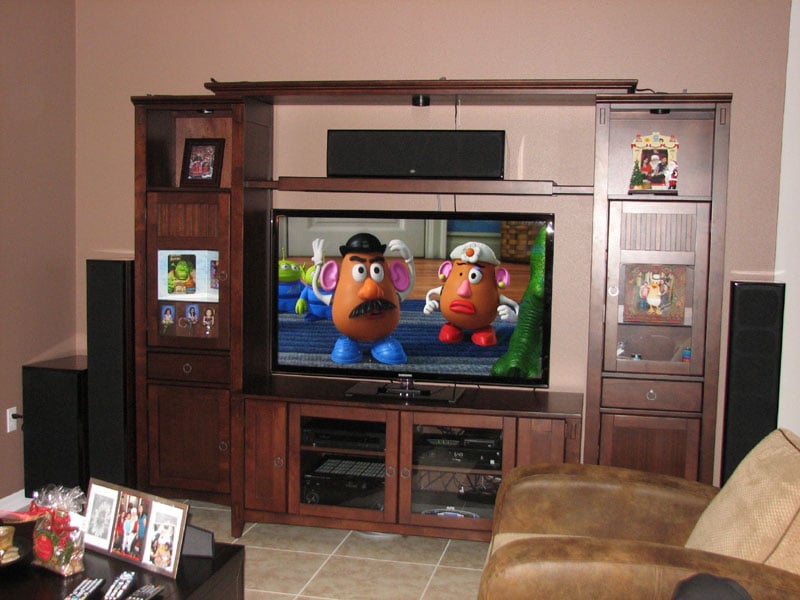

I was quite pleased with the end results of installing this system. Despite the rather constrained space in the room,
I still successfully implemented tower speakers and two subs, a monster center
channel and two sets of surround speakers to make it a true 7.1 A/V system. This system produces really good sound, can be
played extremely loud to satisfy her partying needs, and it looks great in the
process of doing it. I think the speaker choice
