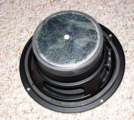

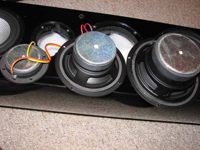

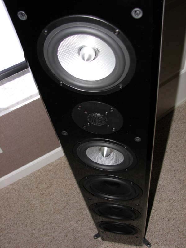

Driver Complement

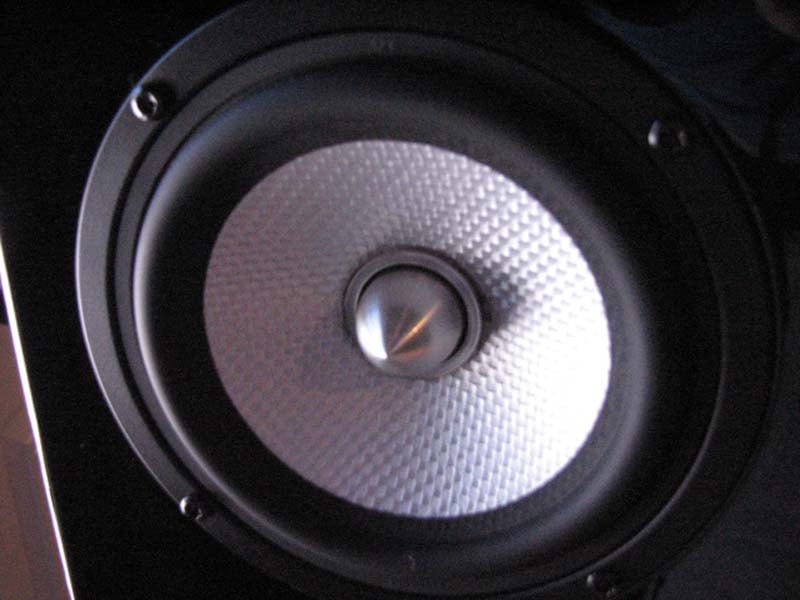

The E55Ti is a six driver, vented, 3-way tower speaker system. The three bottom bass drivers are 6-1/2 inch poly-matrix woofers while the midranges consist of dual 5-1/4 inch aluminized poly-matrix woofers with phase plugs configured in a D’Apollito driver arrangement with the1-inch fabric dome tweeter sandwiched in between. All of the woofer baskets are stamped, which is typical in this price range. The tweeter has an actual ferrite motor structure as opposed to neodymium typically found in compact designs. In most cases, I personally prefer ferrite over neodymium as the latter tend to thermally compress more at high output levels without a proper heatsink. It is worth mentioning we have tested speakers employing neodymium designs that did quite well.
While examining the bass drivers more
closely, I was a bit surprised to see the gasket was applied towards the
interior of the driver frame instead of the outer frame. I asked EMP about this and they informed me
that a gasket for the outer frame of the driver is ineffective for this type of
frame because the metal around the edge of the driver is very thin. This does not afford a very good surface for
gasketing and does little to nothing to prevent resonance from being
transferred to the cabinet. In fact, using a gasket that extends to the edge of
the frame can cause issues. A previous
version of the RBH MC-6CT used a full frame gasket with this type of frame and
they had to change to an "inside-only" gasket like what is being used
in the EMP E55Ti towers.

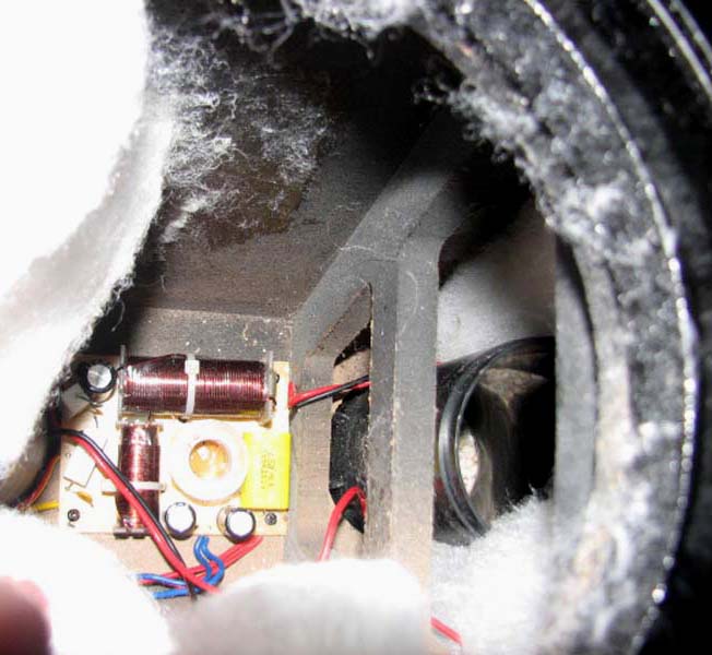

Crossover Topology
The crossover circuit topology is
asymmetrical between the tweeter and midrange drivers. The tweeter uses a Mylar
capacitor and air core inductor for the high pass filter, while the midrange
has no low-pass filter components and is designed to use the natural acoustic
roll-off of the driver. The net effect
is a second order acoustic slope between the midrange and tweeter. The high and low pass stages of the crossover between the midrange and woofers
are both second order and use electrolytic
capacitors and steel core inductors. We’ve seen some 3-way towers in the past
that ran a single 5-1/4” midrange driver to its lowest usable frequency and
below, to yield slightly more output in the 50-80Hz region but the trade-off
was audible compression and distress when the driver was being overdriven. This was caused by high output levels
listening to material with heavy bass content, in combination with the lack of
LF protection (the high pass section) on the midrange drivers. We are pleased
EMP didn’t take this approach as we feel the midrange drivers should be drawing

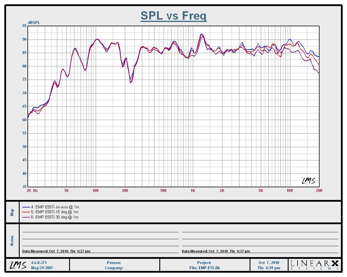

amplifier power only within their primary bandwidth. Looking further at the E55Ti crossover we see
a couple of ceramic resistors used to pad the level of the midrange, as well as
a poly switch device used for tweeter protection. Many manufacturers use these devices, also
known as PTC's, to protect the tweeter during large sustained output which
while rarely occurring in real program material, but always occurs when using a sweeping sine
signal generator to measure speakers at high output levels which is what our
LMS measurement system uses. More on this point later.

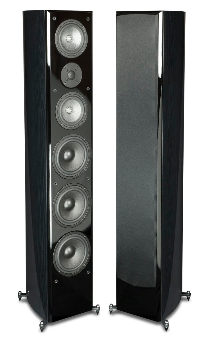

The EMP E55Ti contoured cabinet design is truly impressive. In fact, the aesthetics are so nice that RBH Sound recently launched their new SX Signature line with similar cabinet shape to replace their standard black boxy style cabinets they’ve been using for many years. The front baffle of the EMP E55Ti is a whopping 1.2" thick which is rare at this price point. The cabinet sidewalls are all .6" thick. Inside the cabinet, there are two H braces for reinforcing the woofer section of the cabinet. There is also a separate enclosure for the midrange and tweeter drivers which effectively functions as a half brace between the bottom midrange and upper woofer. The bass drivers also utilize the airspace at the back of the cabinet behind the midrange and tweeter enclosure.

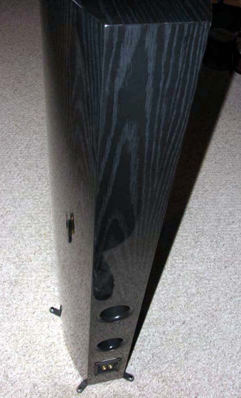

The cabinet is rear-ported. The dual ports have effectively the same performance as a single 3.7" diameter port which wouldn’t fit in the cabinet due to its narrow profile. Having a large port reduces distortion and non linearity's at high SPL's and allows the speaker extended dynamic range compared to a speaker design that is tuned lower for maximum bass extension. In other words, the EMP's are optimized for playing loud within the usable range of the small drivers, rather than using the ports to extend the bottom below where the speaker is naturally effective.

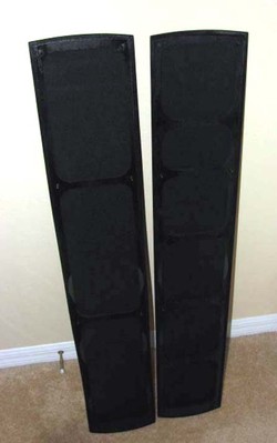

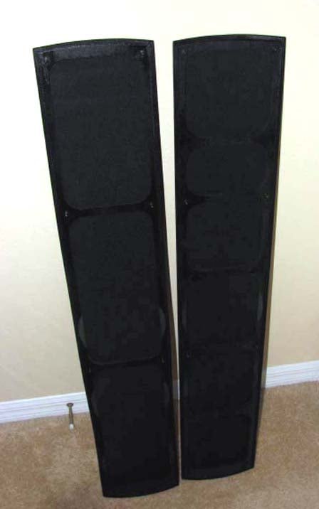

EMP E55Ti Grille (rev 1 left pic) ; (rev 2 right pic)
The EMP E55Ti's are, unfortunately, not bi-wireable or biampable. Instead, there is a single pair of 5-way gold plated binding posts towards the bottom of the speakers to connect to your amplifier
The grilles of the EMP E55Ti towers are quite impressive. Instead of the thin flimsy plastic grill covers most speakers in this price class have, the E55 grilled are framed with MDF, including five (5) horizontal supports (rev 2 only) and a tightly woven fabric to minimize losses. You just don't expect this kind of detail to build quality and cabinet finish at this price point. EMP has done a really nice job with the cabinet design, fit and finish of this product.

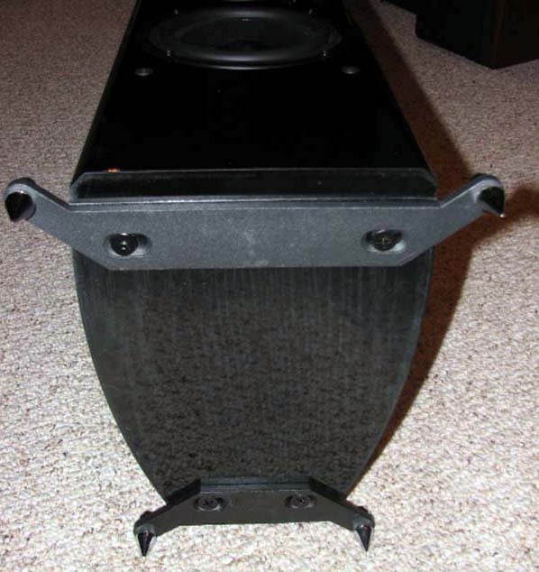

The
Outriggers
For those with a foot fetish, one of the coolest features of the new EMP E55Ti towers is their feet. Standing almost 4 feet tall, a thin tower like the E55Ti's need a stabilizing mechanism, especially for those that have children. Simple spikes under the speaker won't suffice. Hence EMP employed a very snazzy outrigger system. The outrigger system creates a wider support base for the cabinet. Simply flip the speaker upside down, screw in the outriggers, install the feet and you're done. The wide outrigger goes to the front of the cabinet while the smaller outrigger goes to the back. During my measurement testing, I detected a weird resonance at about 205 Hz and was perplexed by it until I realized I didn't tighten the feet enough. It’s a good idea to use a pair of pliers to completely tighten the feet, to eliminate any potential for rattles.

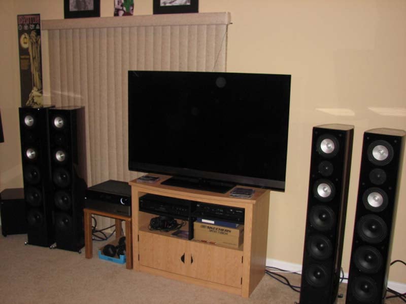

Listening Scenario #1: Friend's Home EMP E55Ti (rev 1) vs EMP E55Ti (rev 2)
In the first scenario, we connected the new pair of E55Ti and original pair of E55Ti side by side to a Harman/kardon HK 3490 stereo receiver using SPK A and SPK B outputs to switch between pairs. The cables were Kimber 8PR and the source was the Denon DVD-1920CI connected via Sonicwave toslink to the HK 3490. Both pairs were level matched so it was as easy as flipping the SPKA/SPKB button on the remote to do an instantaneous comparison to hear how the old vs new EMP’s compared to each other.
Listening Scenario #2 Audioholics Showcase Theater Room
For the second scenario, I positioned the E55Ti towers about 5ft from sidewalls and around 8ft from the back walls and spread apart about 10ft from each other which was about two feet shy of the distance from my primary listening position. After experimenting, I found they sounded their best with moderate toe-in since the top end of these speakers is a bit laid back and my room is both large (6,000ft^3) and acoustically treated. I used my Marantz PM-11S2 200wpc integrated stereo amplifier and the Denon DVD-A1UDCI Universal Blu-ray player as the source connected via balanced cables. All interconnects were furnished by Blue Jeans Cables (1694A Coax) and Kimber 8PR speaker cables with WBT compression banana plugs.
Prior to engaging in this dedicated listening test, I did some comparative listening tests of the original E55Ti’s to a pair of Axiom Audio M60v3s and Klipsch RF-62s before setting up our $1k Floorstanding FaceOff. For these tests I used the Axiom A1400-8 amplifier and my Denon AVP-A1HDCI processor. I will reference my notes in those tests in this review whenever appropriate.
Listening Tests
Unless otherwise stated, all listening tests were conducted without a subwoofer in two-channel configuration with the EMP E55Tis set to “large” in the A/V receivers bass management.
Listening
Scenario #1(left pic); Listening Scenario #2 (right pic)

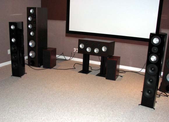

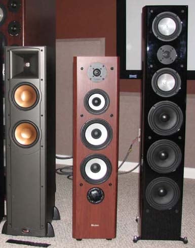

Again, using the Audioholics demo CD, I did some comparisons between the EMP E55Ti (rev1), Axiom Audio M60v3 and Klipsch RF-62 tower speaker systems. All speakers were level matched and switching was done instantaneously.
Fourplay
- Amoroso
This
track has great bass, piano, guitar and plenty of percussive sounds to test the
top end of the speakers as well. The
Axiom M60v3's really gave a nice presentation of full-range sound here with
deep extended bass, and nice detailed highs.
Switching over to the EMP's, all of the sudden Lee Ritenour's guitar
came alive. Instead of being recessed in
the background it popped forward sounding more like a listening session at a
live studio recording. The Klipsch on
the other hand were like Axioms on steroids. They simply had the most bass and
treble out of the three speakers. A
casual listener wanting a lot of boom and sizzle with the ability to play LOUD
will absolutely love and likely prefer the Klipsch speakers over the Axiom's or
EMPs.
Sade - Hang on to
Your Love
This was a fun song to compare the three speakers to. I felt the Axioms conveyed the most detail in
the highs, most noticeably that "cha cha" percussion sound emanating
from the left speaker. The Axiom's also
had a nice deep bass extension almost sounding as if a powered sub was thrown
in the mix. The Klipsch literally
sounded like they were gonna tear down the house with this track. Oodles of bass and treble, they sounded like
a wall of sound but were unfortunately more two-dimensional sounding than the
other speakers in this comparison and the vocals had too much sibilance for my
taste. While the EMP's didn't win for
bass extension or conveying top end detail, they sounded the most balanced to
my ears. The vocals sounded rich and
vibrant without ever sounding sibilant, especially as the volume was cranked
up. The Axioms at high volume lost some composure in the midrange in my opinion. Comparing
these speakers revealed that all three brands exhibited respectable
performance, but the ultimate winner depended on listener preference and the
type of music one listens to. I could
see consumers that listen to more acoustic based music with lots of vocals and
percussions preferring the EMPs, while those listening to rock or more
industrial type music would lean towards the Axioms and R&B, Rap listeners
going for the Klipsch. As Bugs Bunny
used to say, "one mans meat is
another mans poison". If you're
a vegan, you’re out of luck.

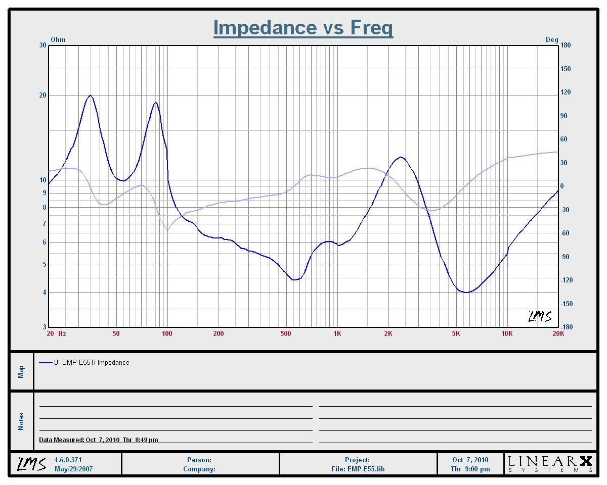

Impedance / Phase Measurements of the EMP E55Ti
The EMPtek E55Ti speakers appear to be tuned into the 55Hz region as indicated by the saddle point in the impedance graph. There are two impedance minimas at 500Hz and 5kHz where the speaker dips down into the 4 ohm region but at low frequencies where most of the amplifier power will be spent on demanding bass content, the E55Ti's are seen as a high impedance (10 ohms) making them a relatively easy load to drive. The 4 ohm dips could have and should have been avoided to make them an easier load for any amplifier to drive. My personal feelings are that EMP could have put a bit more effort into optimizing the impedance of this speaker, at least in measurement, as I didn't find the E55Ti's to be a difficult load to drive for any of the amplifiers I tested them with.
Calibrating my measurement system so that it sent out 1 watt into a 6 ohm load (2.44Vrms), I measured system sensitivity and found the E55Ti's measured around 88dB 1 watt/meter which is what EMPtek claims for this product.
In-room
1 meter SPL vs Frequency EMP E55Ti (1/12rd octave smoothed)
blue
trace: on-axis; red trace: 15 deg
off-axis; purple trace: 30 deg off-axis
Since the EMP E55Ti's aren't biampable, I was unable to disconnect the tweeter to do a summed nearfield response which simulates an actual anechoic response. Instead I did in-room 1 meter measurements which are pretty accurate above the room’s transition region which in this case is around 300Hz. The measurement below that region is dominated by room interaction including the suckout centered around 200Hz which is caused by ground bounce between the microphone and floor. This suckout is NOT an attribute of the speaker but instead a measurement anomaly and should be ignored. Aside from the bump slight above 1kHz, the E55Ti's exhibited extraordinary linear response from 300Hz to 20kHz maintaining a +- 2dB variance and that’s an in-room measurement folks! This is the type of response curve we are used to seeing in RBH Sound products and glad they are following that design philosophy through for the EMP brand as well.
There is definitely no over-emphasis of high frequencies in this speaker like I often find on other budget designs which in my opinion is purposely done to attract the more casual listener. Instead, EMP voiced this speaker as tonally neutral as possible. I would actually challenge them to raise the tweeter level 1dB for more appeal as many consumers are simply not used to listening to tonally neutral speakers and may find the EMP's bland upon first listen, especially when directly comparing against brighter speakers. Because of the lack of overemphasis of high frequencies, many listeners, myself included, would find a moderate toe-in of these speakers quite useful. Not only does it help better focus the speaker, but it also livens up the top end, especially for those in acoustically controlled listening spaces.
It's clear that the E55Ti's aren’t a bassy speaker with an estimated rolloff of 12dB/Oct below 55Hz. But this is where a good sub really helps extend the range of this product to make it a full-range tower that can play at high sustained SPL levels to match the output of the sub better than most bookshelf speakers can do given their size and driver compliment limitations.
Because
of the PTC device in series with the tweeter, I was unable to do compression
testing that exceeded 105dB SPL (1 meter) since both my LMS and FFT system
generate continuous test tones that trip the device. We are working on a method to create burst
test tones to more accurately measure power compression in loudspeakers. Suffice it to say, I never heard the PTC
device trip or lower the tweeter level in any of my listening tests where I
exceeding 105dB levels (about the output level of a jackhammer).

EMP Impression E55ti's will sound best with their grilles off. This can be said with virtually all speakers
