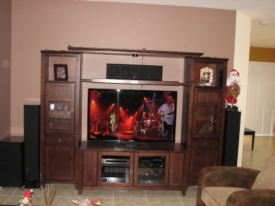

In order to maximize performance of this system while also preserving the aesthetics of the listening space which also functions as a family room open to a formal dining room, dual subs was a must but placement was challenging.
My sister-in-law under estimated the size of her wall unit and I was biting my nails when I initially saw it placed against the front wall of her room thinking I wouldn’t have enough space for the E55Ti’s and the ES1010i subwoofers.  I’ve always been pretty good at the game Tetris so I took my chances and moved stuff around till I got one of the subs to fit.
Sub 1    Sub 2
EMP ES1010i with E55ti tower (left pic); ES1010i & E55Wi Surround (right pic)
I diagonally located the other sub on the opposing wall.  This produced a pretty darn near ideal response across the entire couch facing the TV which is where they’d spend most of the time sitting and listening.  The response on the far left couch wasn’t as good but it was also pretty far off axis from the display too.  I always reserve such a less than desirable location as the “mother-in-law seat” and in this case mine was quite content sitting there.

Words cannot adequately describe how much I loathe installing audio equipment into entertainment centers.  They almost NEVER have enough depth to accommodate amplifiers or large receivers and the back-wall cutouts are either non-existent or too small to accommodate anything more than dental floss thick wiring.  To make matters worse, the furniture my sister-in-law purchased did NOT permanently affix the horizontal shelf holding the center channel to the main body.  Any slight move of either horizontal rack caused the shelf to completely collapse which it actually did and almost crushed my neck in the process.  I sputtered numerous colorful metaphors at the furniture company under my breath as I warned both them and my sister-in-law about this and they both assured me the furniture would be secure when I was ready to install the equipment.  Suffice it to say, the furniture company had to come back, replace the now broken shelf and use L-brackets drilled into each cabinet rack (like I requested) to ensure this wouldn’t happen again.  Seriously, this process literally takes less than five minutes to do and not only stabilizes the furniture but also infinitely increases safety to the installer. I dedicated this much real estate in this article to this very important point because I could have literally become paralyzed over such a ridiculous and avoidable oversight.
EMP System Install
A/V Components installed into Furniture
With the furniture secured, I drilled out bigger cutouts in the back to route the cabling (all furnished by Blue Jeans Cable) and power cords. I installed all of the components including an Ethernet hub to provide a wired Internet connection to the Samsung Display, Oppo BDP-93 Blu-ray player, Yamaha RX-A1010 A/V receiver and Nintendo Wii. This was necessary to tap into all of the networking features this system offers such as: Internet Radio, Pandora, Netflix and the iPhone App to control the receiver via your iPhone or iPad device.
I managed to fit one ES1010i sub in the left front corner while positioning the E55ti towers adjacent to each side of the entertainment center and applied slight toe-in directed towards the center “money seat”. The outriggers were installed on the E55Ti’s to provide stability which is essential since my sister-in-law has a rather active 9 year old boy and a lot of visitors. Nothing is worse than watching one of your tower speakers from across the room take a dive from an accidental bump as you run in slow motion yelling “NO!” powerless to stop it. For the second ES1010i subwoofer, which was located on the right rear wall diagonal to the front left sub as previously mentioned, I placed electrical tape on the back panel controls to prevent people from tampering with its settings. This was important since the plate amp was facing the dining room, well within the line of site of curious visitors entering the room. The E55Wi on-wall surround speakers were mounted about 3 feet above ear height (seated position) on the side walls slightly behind the listening area. The TX-615 in-ceiling speakers were positioned about 8 feet apart. I left all tone controls to flat and did NOT pivot the tweeter since the speakers were firing directly down to the listening area (though a few feet back from the couch) from the ceiling and thought it was a better option to have the drivers firing slightly off-axis to provide a more diffuse soundfield.
