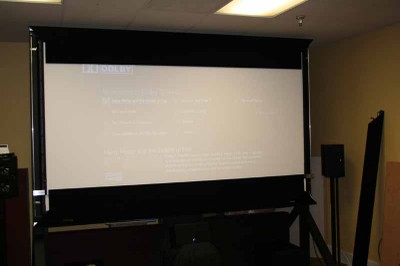

carada-mask1.jpgCarada unveiled, for the first time, its new Masquerade automated masking system at the Audioholics 2007 State of the CE Union Event. To say that this is an industry-changing product (at least in terms of price to market) would be an understatement. Sold for the price of some competitors' fixed wall screen systems (just $2499 for a 110” diagonal) the Masquerade offers full horizontal masking up to 2.70:1, meaning that all of your widescreen movies can now be watched without those often annoying black bars.

Physically, the screen has a 6.25-inch wide frame that is 3.75-inches deep. In our demo we mounted it overtop a simple Carada Precision series screen which we inverted so as to get the screen as close to the masking material as possible. While you certainly don't need to do anything special to make the Masquerade work with your screen, we were trying to really tweak this system for the ultimate effect. The result was minimized shadowing and a smooth, clean mask that left many people initially thinking that the room contained a simple 2.35:1 screen... until we flipped the switch and converted it into 16:9. The mask is that good, it simply absorbed all available light from the black bars overshooting the main image. The effect left more than few jaws on the floor. The screen was also under heavy-duty use during the weekend event and we never once witnessed it stick or lose calibration during the course of demoing hours and hours of great high definition video material. I'd say reliability looks very good so far.
