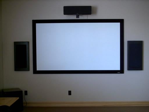

Proceeding with the installation, I picked up the assembled frame and attached it to the upper bracket. Using a tape measure, I made sure the screen was perfectly centered on my wall. Make sure you have dry clean hands or wear clean cotton gloves when handling the screen frame as to not soil the velvet finish.
I marked the entire inside frame area on the wall with a pencil and carefully removed the screen frame from the wall. When installing a fixed screen, I have always either painted the area behind the screen flat black or used black indoor/outdoor carpet or black fabric behind the screen material. This helps minimize and absorb the light that is bounced back off light colored walls behind screen material.
I prefer to use the inexpensive black indoor/outdoor carpet available at many home improvement stores. It is easy to install. All you need to do is cut it to the inside dimensions of the screen frame and staple it to the wall that you previously marked out with the screen frame temporarily installed. Just make sure that the black material is stapled tightly to the wall so it does not touch the screen material.
Moving along, I carefully removed the screen material from its plastic bag but leaving it on the roll it was shipped in. With the screen lying with the back facing up, I placed the screen material at the top of the screen and began snapping the screen material to the frame carefully unrolling it a little at a time. If you do it this way you will reduce the risk of scratching the Brilliant White material. It will take a little effort to snap the screen material to the frame because it has to stretch, just alternate from side to side a couple of snaps at a time.
Then do the top and then the bottom. As I inspected the material, I noticed
that the material was of high quality. It is very uniform and the fit onto the screen frame was
perfect.
All that's left to do is hang the screen. I did this installation myself with no assistance, but I have installed many screens. This fixed screen was by far the easiest I have ever installed. For the last step of the installation, it may be wise to have an assistant to help you.
Carefully pick up the screen. The screen material is now fixed to the frame facing outward. Note: if you wear glasses, have big buttons on your shirt, or you are wearing jewelry take care not to scratch the screen material or let dirty hands come in contact with it. New white cotton gloves are very cheap and handy when handling your new screen.
Lift the top of the screen over the top bracket and make sure it is seated in
the gap on the back of the frame.
Now center the frame on the wall and the upper bracket. Light
tapping on the side of the frame will move the screen in either direction. Now that the screen is
centered, pull down with light pressure on the bottom of the screen and attach the bottom bracket. The
screen should now be tightly fixed to your wall check for level and center and you are done. The
installation process took me about 1-1/2 hours to complete. This was by far the easiest fixed frame
screen I have installed. The directions are easy to understand and follow.

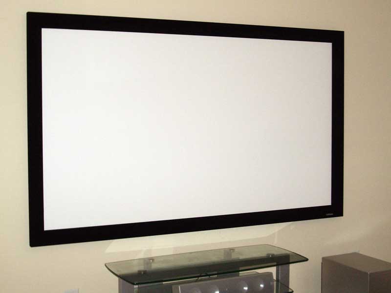

Now that I had the Carada Screen installed, I was able to give it a very close examination. The screen frame is absolutely marvelous. Its wide contoured frame is elegant and the mitered corners are cut so precise and assembled so tightly there is no visible seam. The Black Hole velvet coating is classy. The screen hanging on the wall even with no image projected on its surface looks like a fine piece of art.
I called my wife into our family room to get her reaction after the installation was complete. Her comments were, "Wow that looks gorgeous." Of course the next thing she said was, "how much did you spend on that?" Smiling the whole time, I told her. The next comment was, "You're kidding!" That rarely happens to the home theater enthusiast. I savored the moment wishing I had recorded the conversation for future reference.

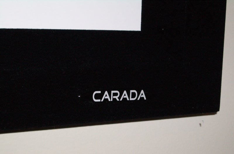

The Criterion Series screens come with some significant upgrades from their Precision Series counterparts. Here are some of our favorites:
3.25"x1.5" 6063 T-5 Aluminum Frame w/Black Hole
Trim
The most visually-striking change to the Criterion Series is the presence of a new 3.25 x 1.5 custom extruded aluminum frame. This frame is nearly identical to other, more expensive screen manufacturers but is a custom-designed solution made and manufactured by Carada. Like other high-end screens, the frame is covered in a matte velvet trim that help eliminate over-spill from the projector. This allows you to completely fill the frame and maintain a nice clean edge. M ovie theaters use the same principle when they matte the feature film screens with heavy motorized black drop cloth material.

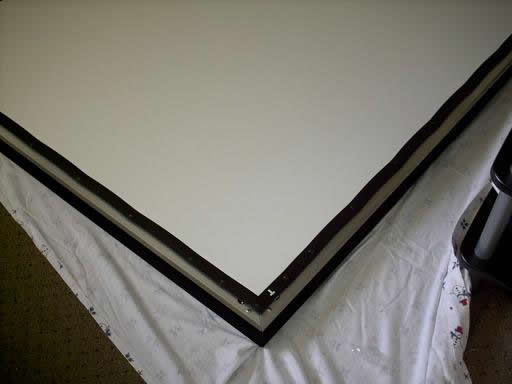

After you have the wall brackets in place you can proceed to attach the screen. M ake sure the frame is laid out face down on a carpet or other smooth, soft surface. Next, unroll the entire screen and place it on top of the frame. Be sure that you unroll it so that the snaps are on the correct side and the part of the screen labeled with a "T" is oriented at the top of the frame. At this point, you simply work your way around the screen, alternating directions periodically, but always working outward without skipping over any snaps. It was at this point that I realized the small creases in the screen material that I had noticed earlier were completely going away. After I snapped in the screen there was nothing but a completely smooth, evenly-stretched surface. The last snap will be extremely difficult, but over all I think the effort required to snap in the screen makes up for itself in the wonderfully flat, tensioned surface.
After you are finished attaching the screen, get someone to help hang it on the attached wall brackets. The frame will need to be carefully lifted up and then lowered onto the brackets. At this point adjust for centering the screen properly on the wall. Once it's centered, push the bottom over the lower bracket for a snug fit against the wall (this last step may take some help and reconfiguring as it requires an exact fit.) That's all there is to it!

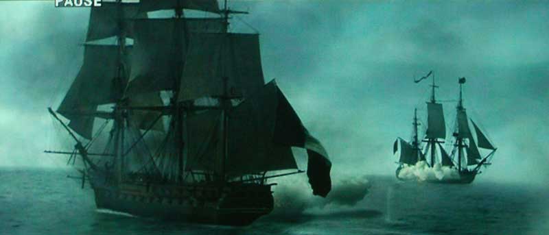

While I'd love to go over every nuance and detail I experienced while watching movies on the Criterion screen, I'll save the evaluations for the DVD and projector reviews. Suffice it to say, the Carada Criterion performs a superb job of giving back the light it receives. The goal of any screen is to accurately portray the picture you are projecting - and the Criterion does that with flying colors (pun intended.) Featured here are some images I snapped that show the excellent color and detail that can be realized from this screen. Our camera, a Pentax Optio S5i doesn't perfectly capture the colors due to the limitations of the camera, but it gives you a taste.
The Carada Criterion projector screen offers a bargain alternative to the fixed screen wall systems offered by the name brand companies. The seamless Brilliant White screen material, with its 1.4 gain and thicker density, nearly mimics the performance of the popular Studiotek 130 screen, though further testing would be needed to see just how close it comes. I think that those looking to acquire the look of a professional installation on a budget would do well to consider Carada's new Criterion series screens - the pricing, performance and ease of use make it hard not to.
